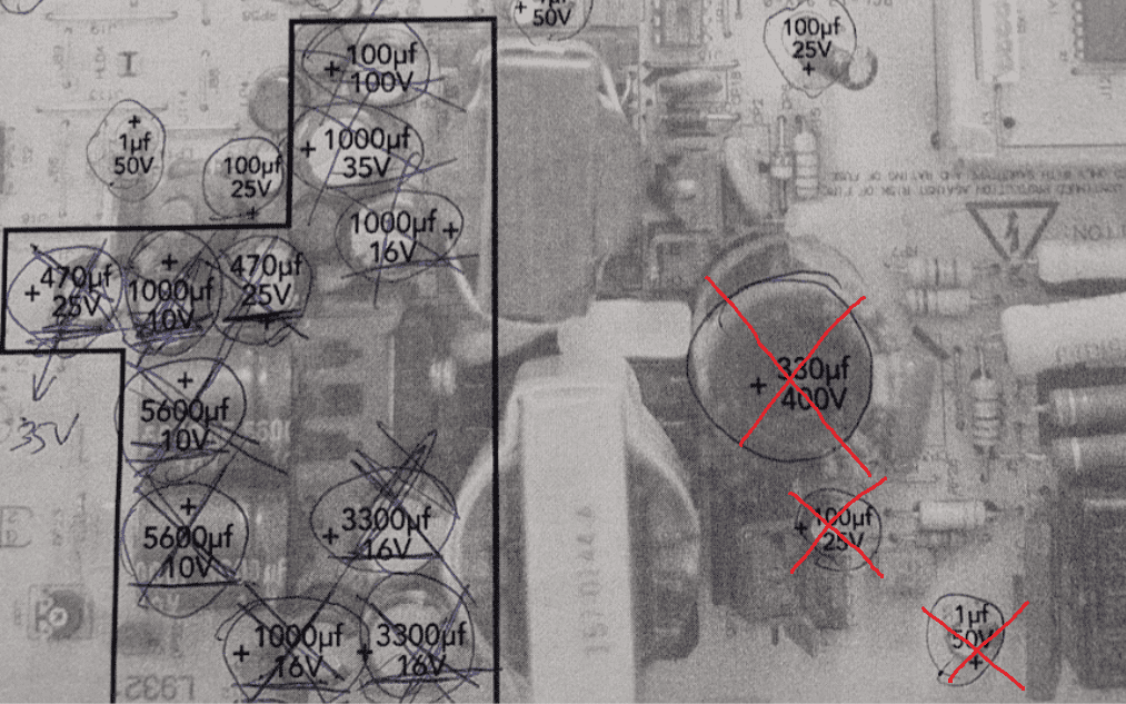

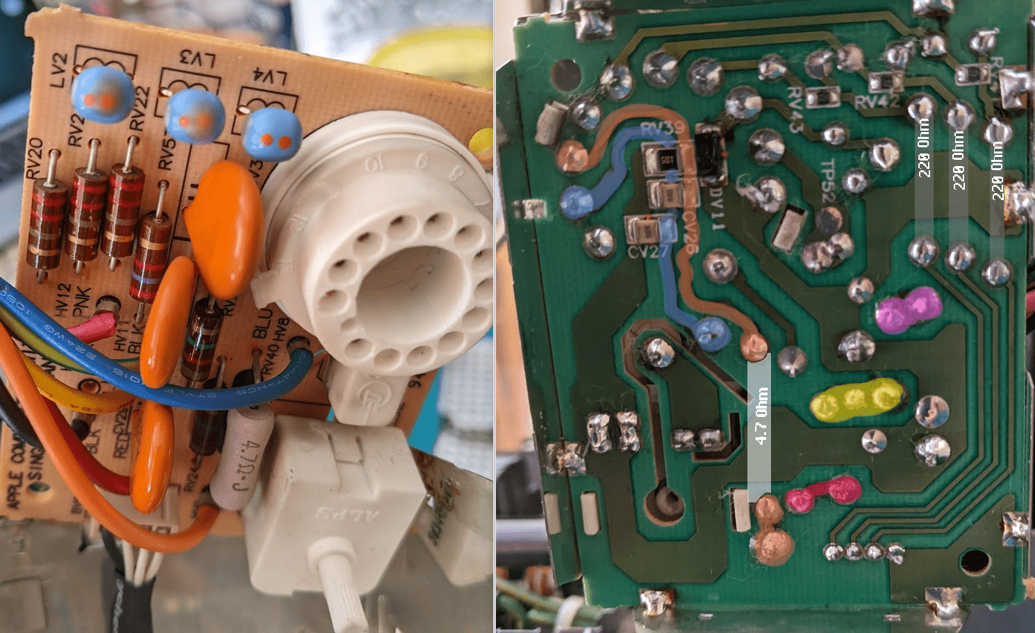

I then replaced these caps right before the transformer (the 3 marked by a red X) on the primary side:
This seemed to have removed the ramp up, ramp down instability problem and the fan is always rock solid from now on. I also test 11.44 V on the 12 V rail and 4.84 V on the 5 V rail. Still not getting any chance to let the keyboard be the one to soft power start the computer and the screen doesn't come fully still. (I hear the degauss though).

-Recap the rest of WHOLE DANG analog board (ie 100% of the console5 kit)
no change

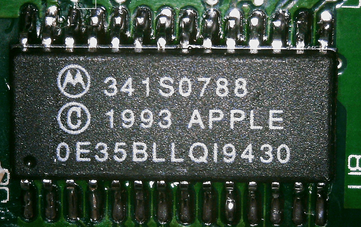

-Clean the CUDA chip (responsible for ADB and soft power)
no change

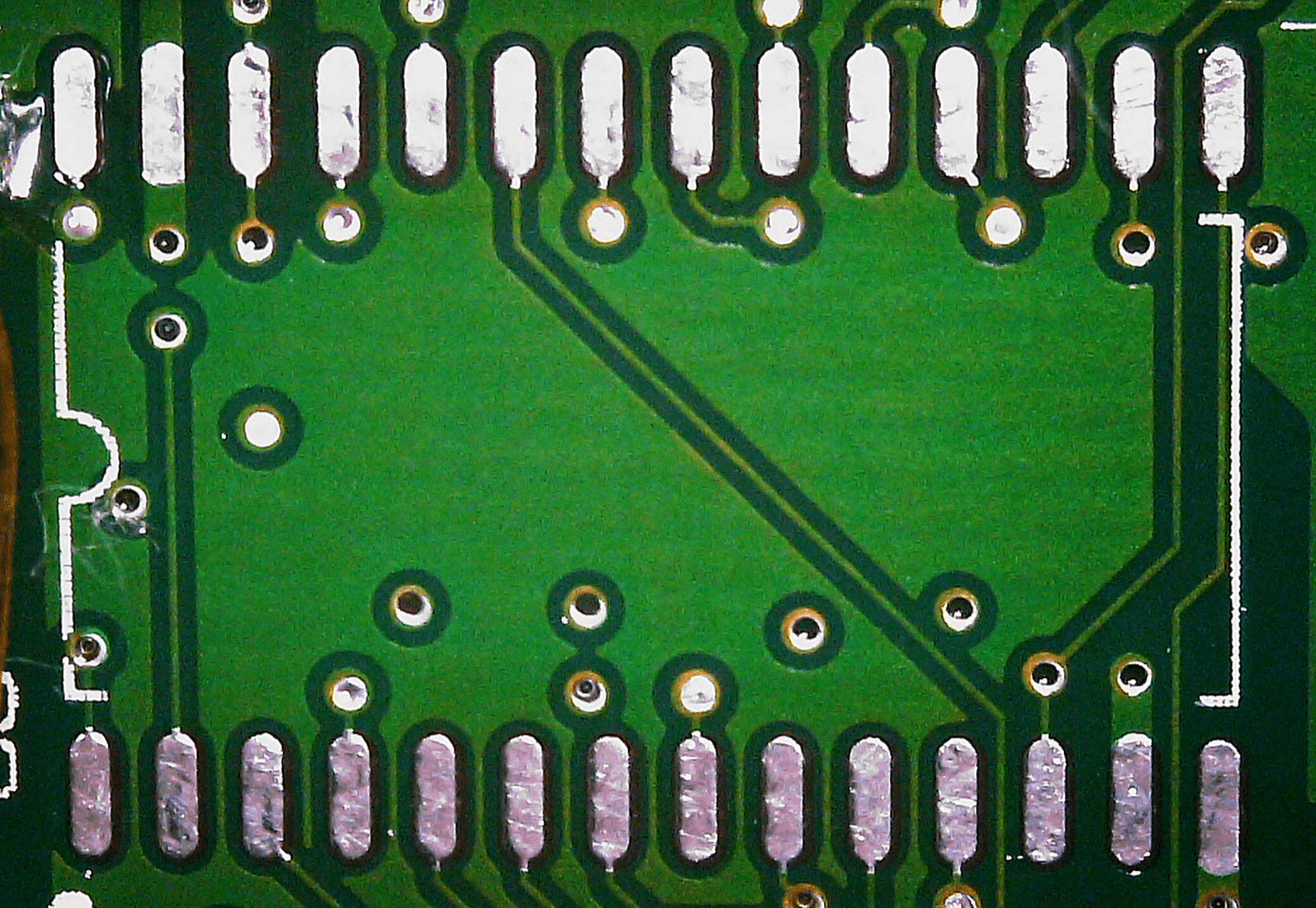

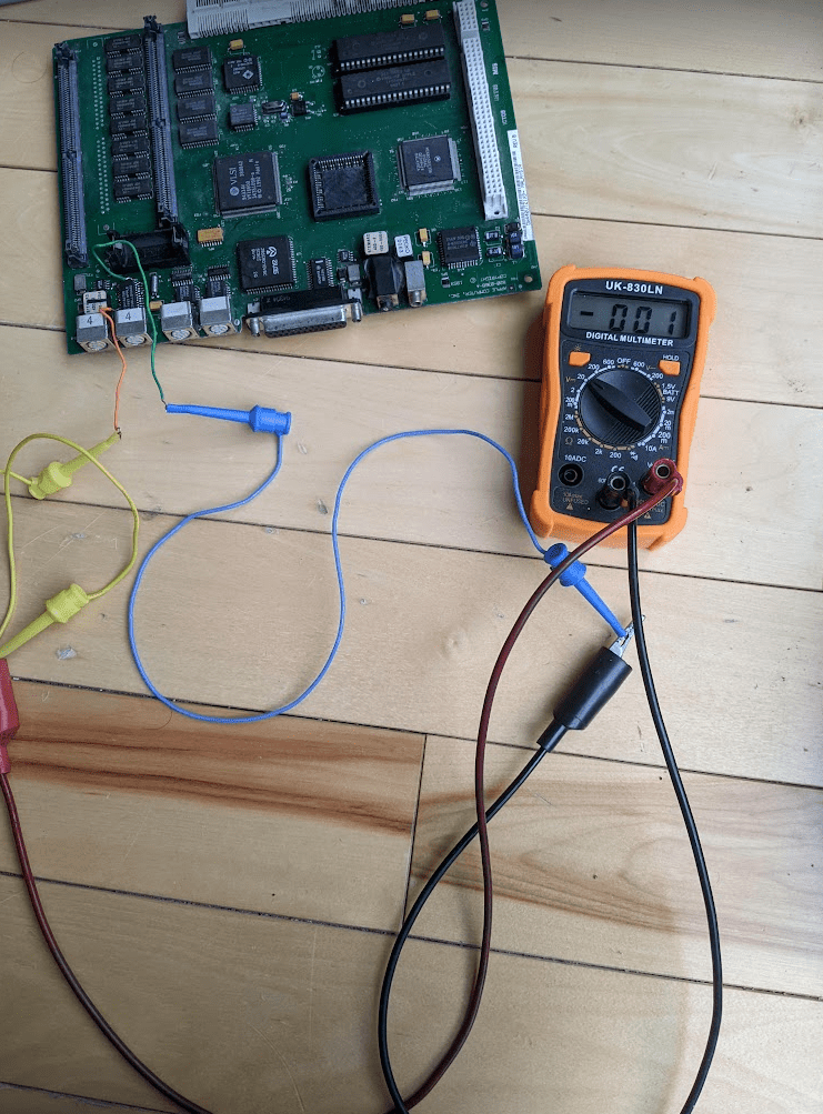

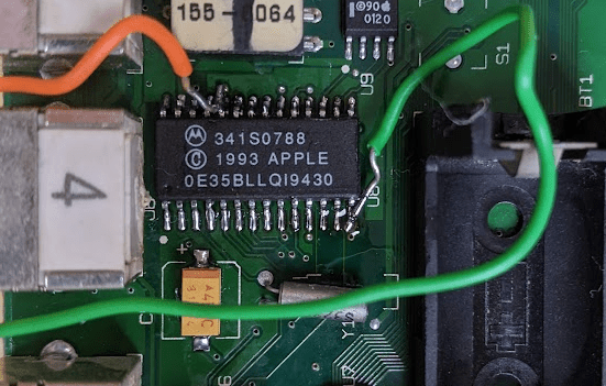

Ok, I used this pinout (ADB socket on the back of the logic board)
soldered wires directly on the Apple CUDA 341S0788.
pin14 = GND (could have used so many other points but whatever)
pin25 = PS_ON pin.
Continuity to either of those went correctly on the socket at the back.

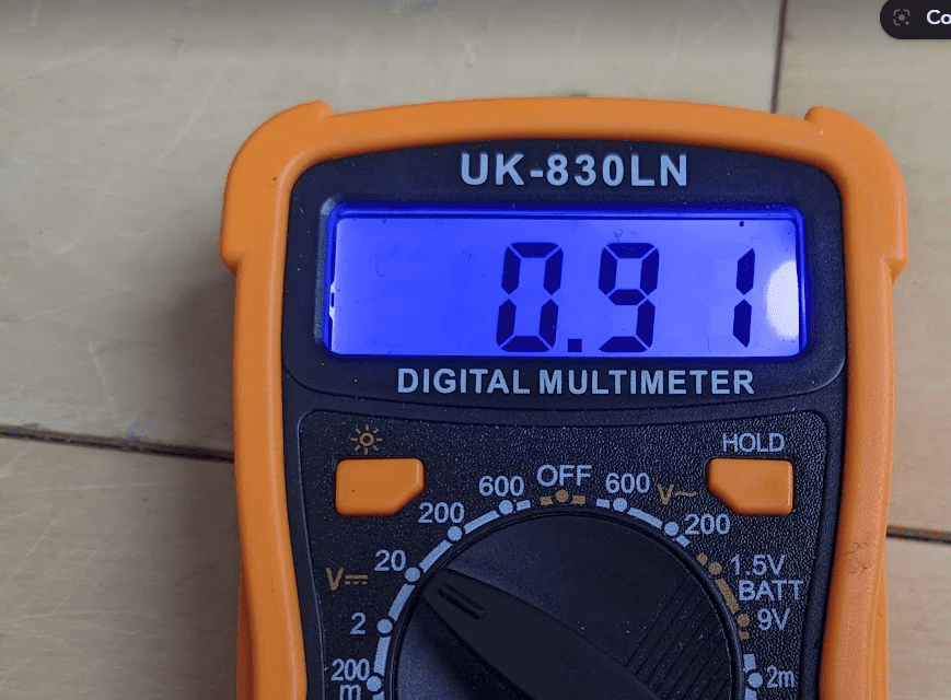

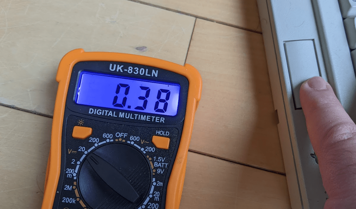

LED off, fan off, and here are the voltages I get between these 2 pins:
No keyboard press: (0.91 V)
Soft power keyboard press: (0.38 V)
is it me or the standby voltage should be much higher than 0.92 V?

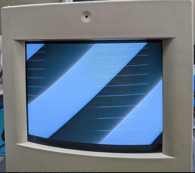

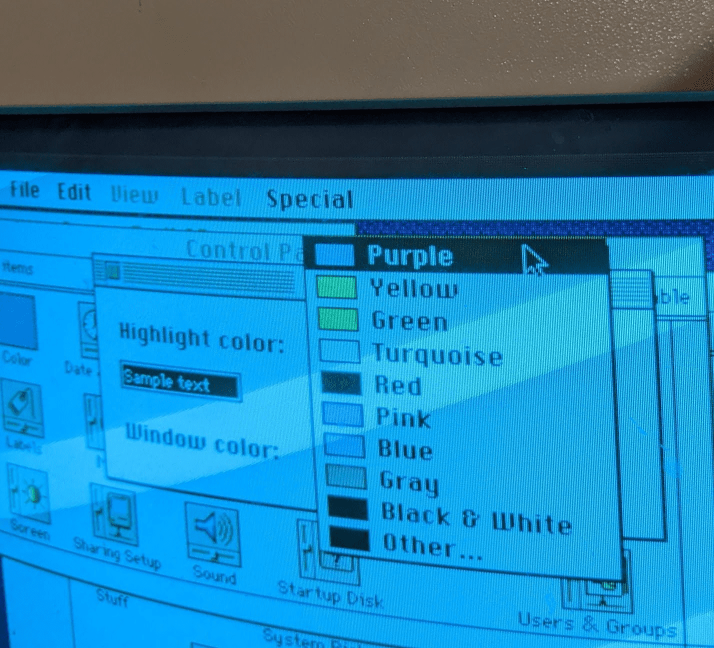

I got a very non-blue image at first:
Getting to System 7.1 and doing stuff after more than a month is a mixed bag of feelings. The process was kinda random to get to this point.

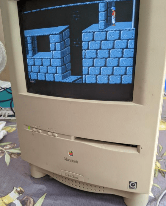

I tried to push its operation some more with a game. The sound works beautifully. The contrast works well. After 10 minutes inside the game, the blue canon popped into working condition. So there's something thermal going on.

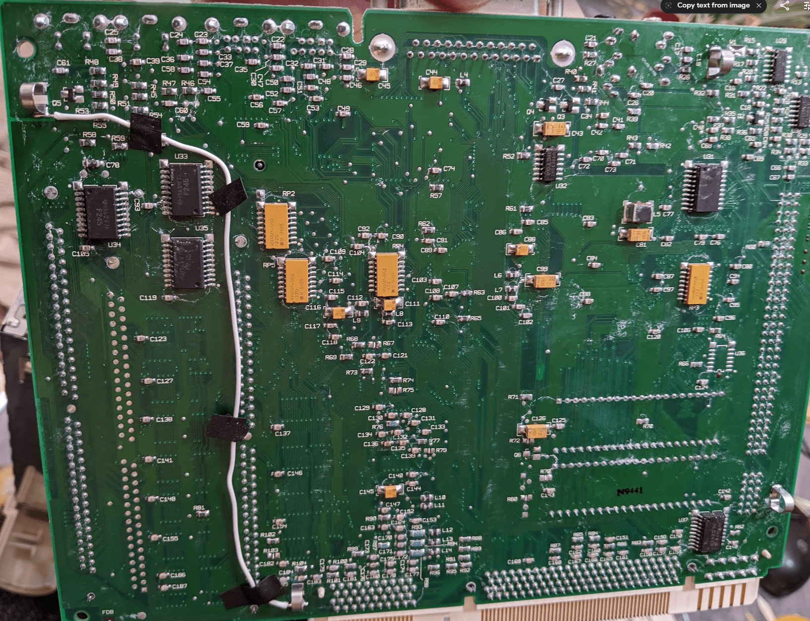

I achieve solid control of the soft power mechanism. I soldered a wire between 2 ground loops underneath the logic board like so:
As you can see in the picture, there are 4 of these "rings" total on this LC550 logic board. I soldered a wire to bring them all galvanically linked. They are NOT located perfectly with regards to the RF shield sitting inside the case underneath the board. 3 are connected together via the traces in the board itself but the lone one near the edge connector ISN'T and absolutely depends on being in contact with the RF shield. The RF tab that's supposed to touch it is a few cm offset and will NOT make contact unless you cut a new bendable tab at a new matching location.
With so many people having trouble with the EGRET/CUDA chip, of course the dominant advice I got was to verify if it was dirty to the point where I desoldered it and cleaned it up and its pads, risking putting too much heat on it with the hot air station. The volume of help received that way floods the message boards across the years on the internet and is even amplified by sound problems for some macs. But it turns out it wasn't my problem. Every time I seemed to lose control of the soft power mechanism, it was due to a bad insertion of the board bending a metal tab out of alignment.

Suggestion #3 had me poring over traces once again, and redo all 13 pots x 3 points of the back potentiometers of the CRT (horizontal + vertical + background drive levels, etc).
I started to get sloppy and started playing with the PP1 potentiometer blindly (but carefully) as well as the 13 pots at the back. The best I could get was this overbright image, but still with retrace lines that are supposed to be blanking as part of the horiz refresh:
I disassembled the cage around the neck board to see if anything was burned out. I reflowed 100% of the connections there. I checked for continuity and found something concerning 2 cables that are connected on one end of the flyback transformer are continuous between each other, and this link goes all the way to the neck board:
This could be perfectly normal for someone well versed in CRT technology, but I'm not that person. I think my noob question is a valid one to ask at my level of knowledge: why are 2 separate cables used, that go over 2 separate lines on the neck pcbs if they're just connected with each other? If they are connected at slightly different places in the flyback winding, what does this accomplish? I spent an hour + worrying about a short somewhere, but there's nothing that could explain how they're linked together except inside the flyback and done in such a way that's deliberately designed that way, but for a reason that escapes me.
Anyway, another day passes after this latest impasse and getting a cooler head the next morning, I mull over reading about retrace lines on old tv sets and I want to go with the idea that over voltage causes these retrace lines too - I remember you could achieve this state by over driving a brightness knob on some sets. It dawns on me that this is the main function of the G2 potentiometer on the right side of the AB, near the horizontal deflection circuit. I finally hunt down a perfect hex bit match for this and just try to lower it and ...
Finally get the retrace lines under control.

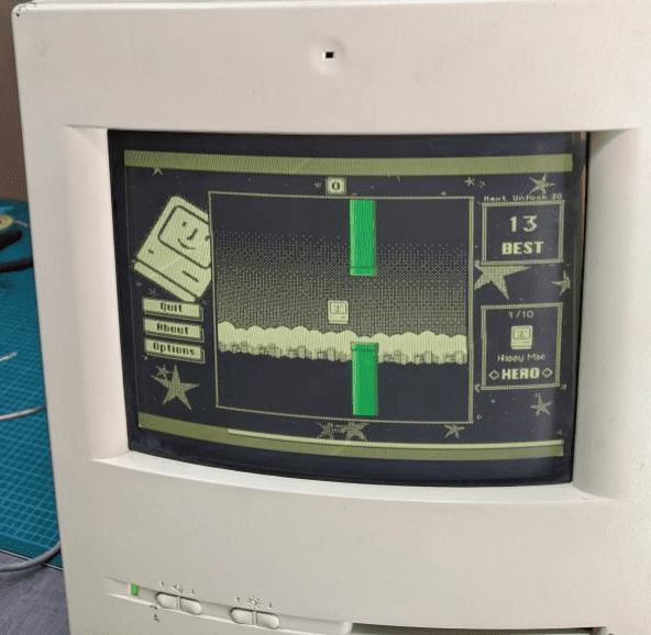

Now that my tinkering space is coming together gradually, putting up the Color Classic is no longer such a pain with the previous limited space. I'm working on stabilizing it some more.

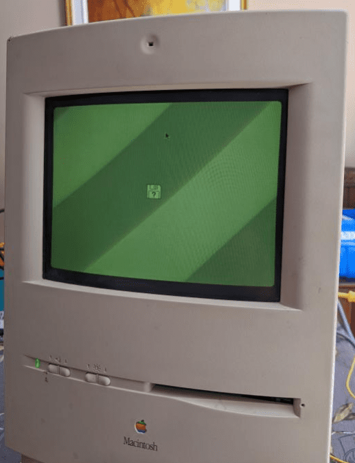

I can fire it up and profit from somewhat balanced colors, but the red suddenly stops after a few minutes and it looks like this:
What should be the steps I do to verify everything?
A) tweak the pots related to the red background / red brightness?
B) specifically check bad solder joints by lightly tapping with a non-conductive stick?
C) invest in high voltage testing equipment to make sure the vaccum tube is properly energized?

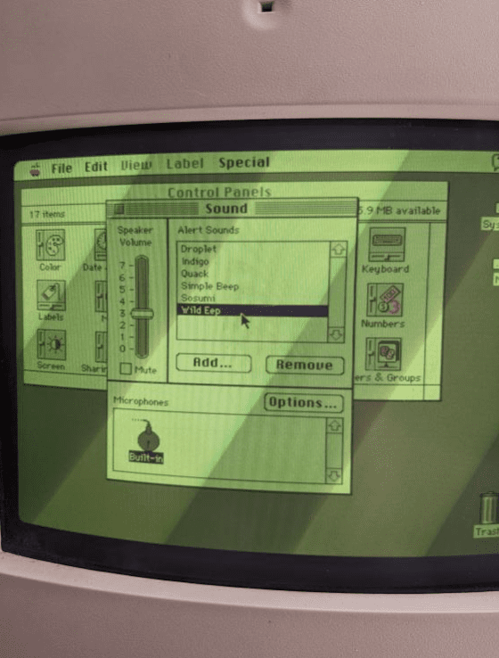

Also, the sound is garbled, but I may have a marginal ground loop to bottom-of-case RF shield plate contact that explains it. Gotta test it further.
The chime is pretty good sounding, but then every sound thereafter is heavily garbled. What could cause most sound to fail except the chime??
