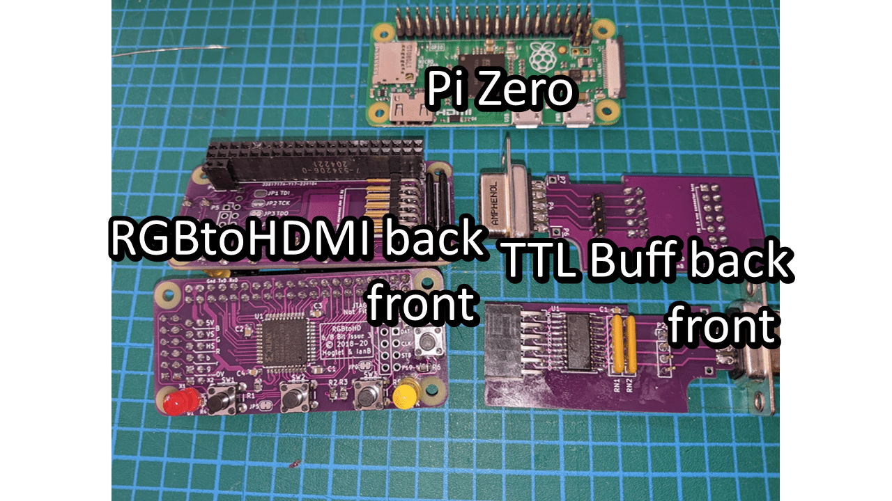

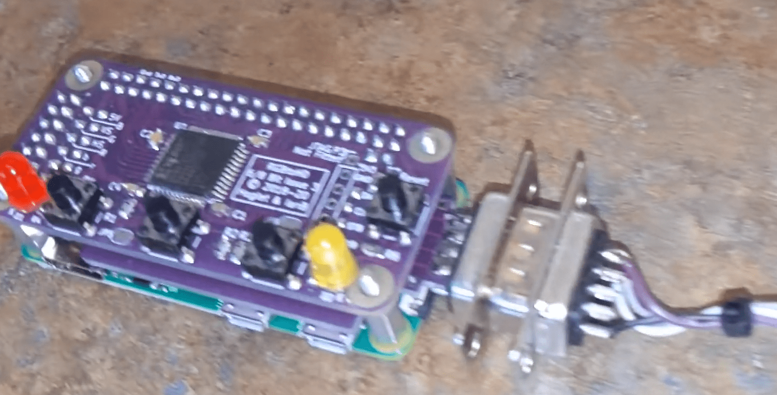

Specific board (hat board to the pi zero) I got to make sure I didn't gamble on something that strayed too far from what Adrian did:
I got the deprecated RGB 6/8 bit board here: https://github.com/hoglet67/RGBtoHDMI/wiki/Bill-of-Materials-(6-and-8-Bit-Boards) and had it made either with PCBWay or JLCPCB, I forgot which.
I also got the PC TTL buffer extender board, very important since it has diode chips to prevent the signals from returning to your mac:
For the CPLD chip that's used by the hat board, they were available on mouser or digikey back then when I sourced my material, no idea if it's still easy to get. Good luck!

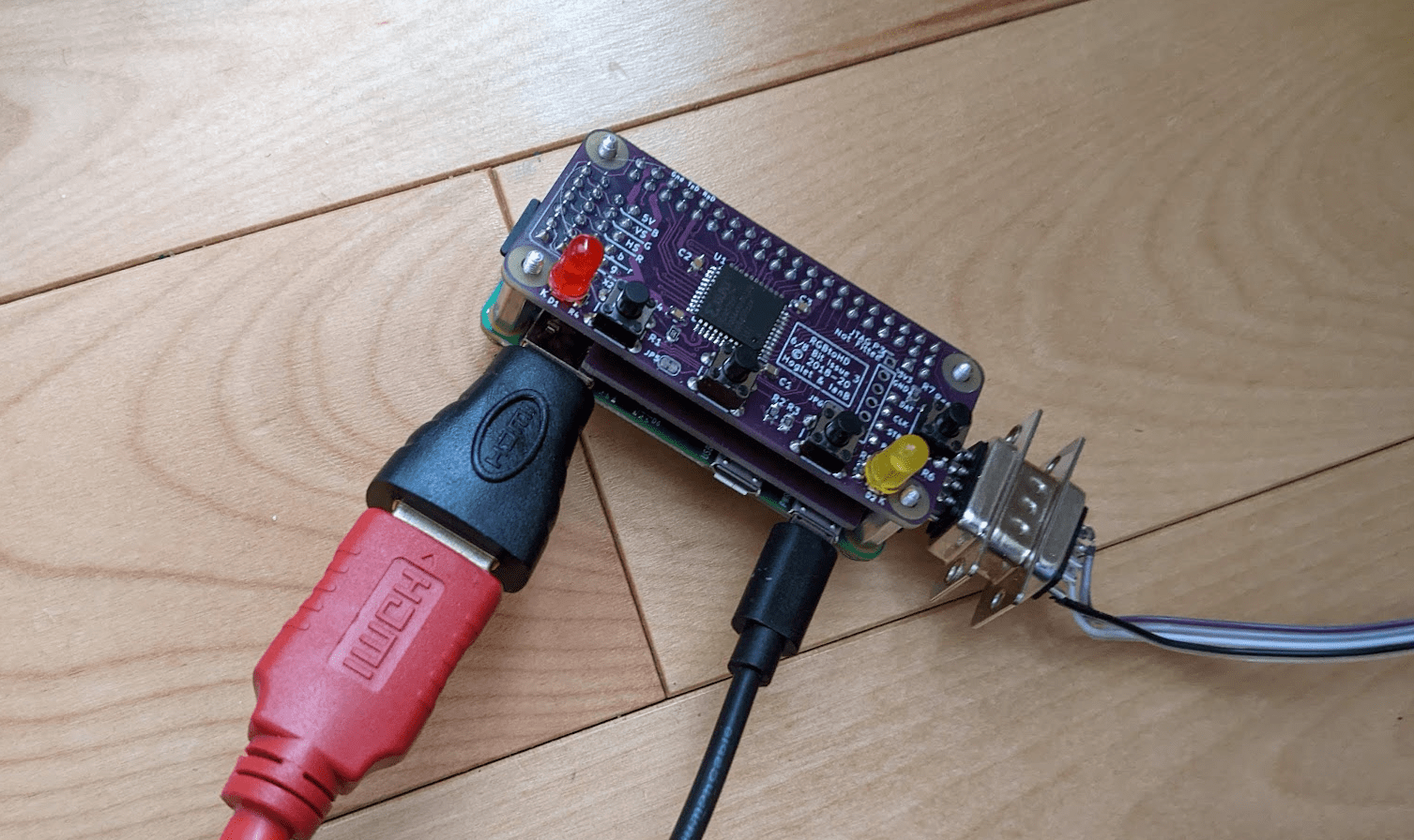

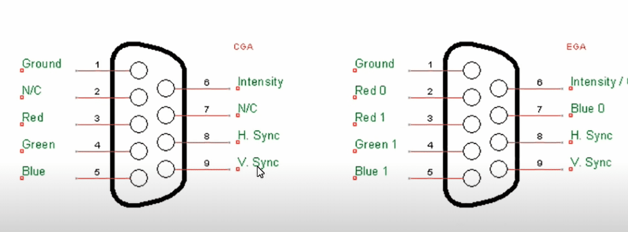

When you finalize the assembly, you'll need a small HDMI to regular HDMI converter and for the actual link to the wires that come out of my compact macs, I used a DB-9 (aka DA-9) connector, the same used for CGA / EGA PC monitors. You're just using 4 pins out of it. I used the great documentation in the above github page.
(older version where I had stripped soft wire ends that weren't very solid in the DA-9 connector pins)

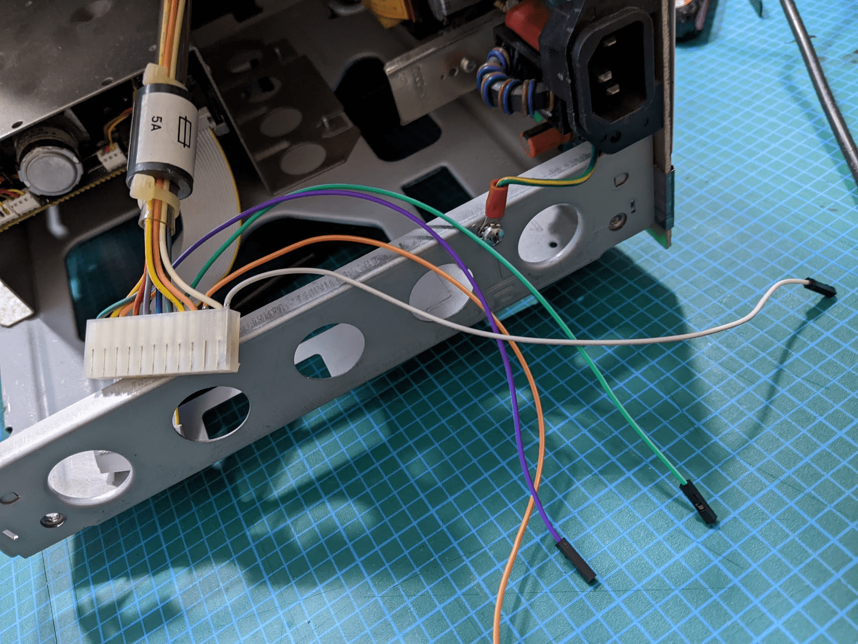

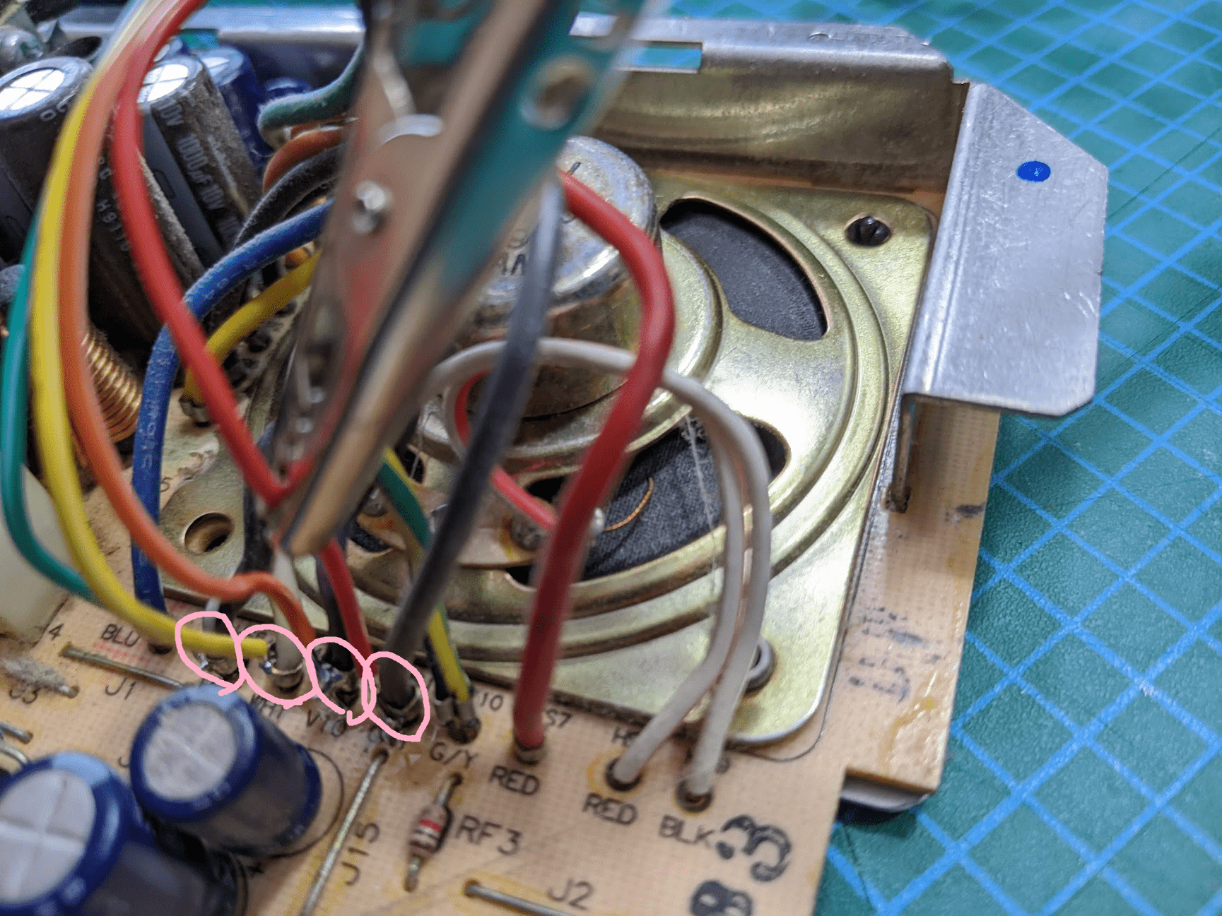

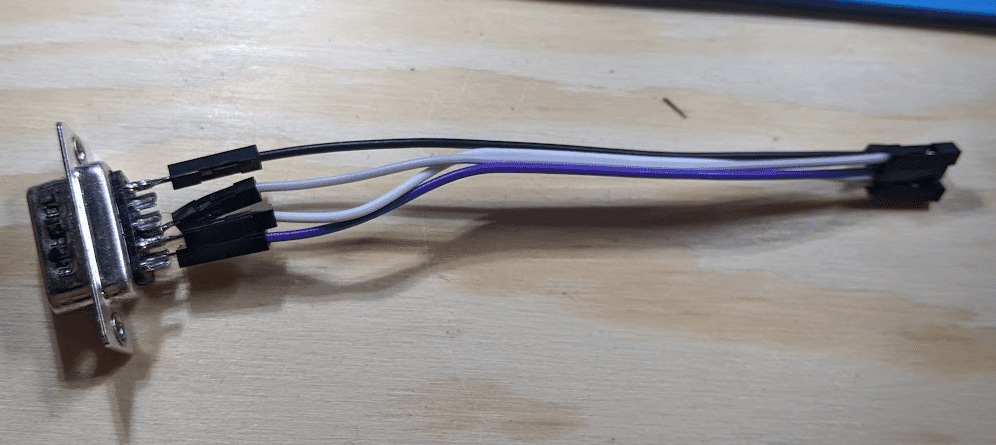

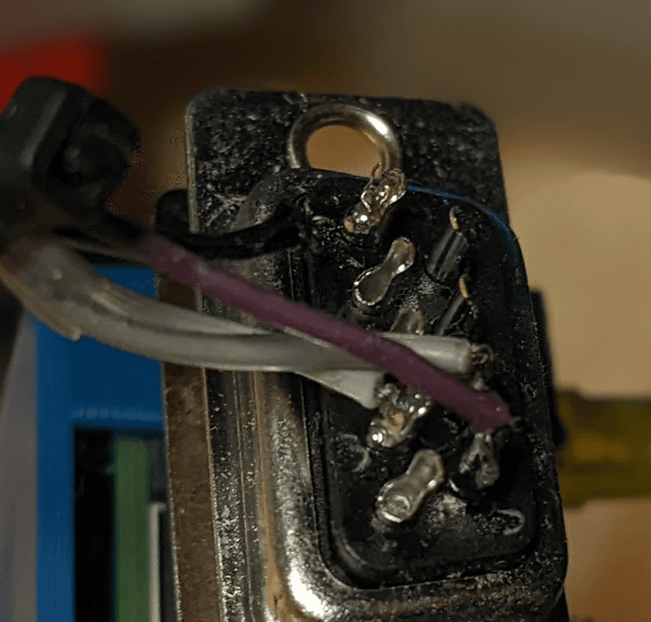

The RGBtoHDMI in 1-bit mode uses 4 wires (hsync, GND, vsync and signal) and here's where I soldered my wires on my Mac Classic 1, on the analog board in cramped spaces near the microphone:
(view from inside the connectors, ie where the wires connect inside the cable.)
white to pin 4 = green 1 = "signal"
gray to pin 8 = h sync
violet to pin 9 = v sync
black to pin 1 = ground)
(revised "version" where I soldered male dupont ends for added robustness)
(as shown here, those 4 wires are soldered to the pin sides of a male DB9 connector, which itself is plugged into a female DB9 connector soldered on the RGBtoHDMI buffer TTL board)
Next up is where I soldered my wires inside my Mac Classic 1 - it's awkwardly on the analog board near the speaker. In hindsight, don't do this, use the same shove-inside the connector between analog and logic on the logic side. I did it this difficult way just to exactly reproduce Adrian's video back then while I was unsure of many steps.

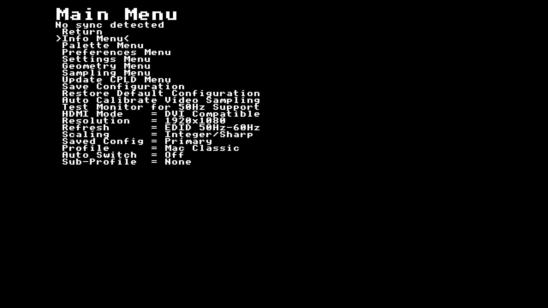

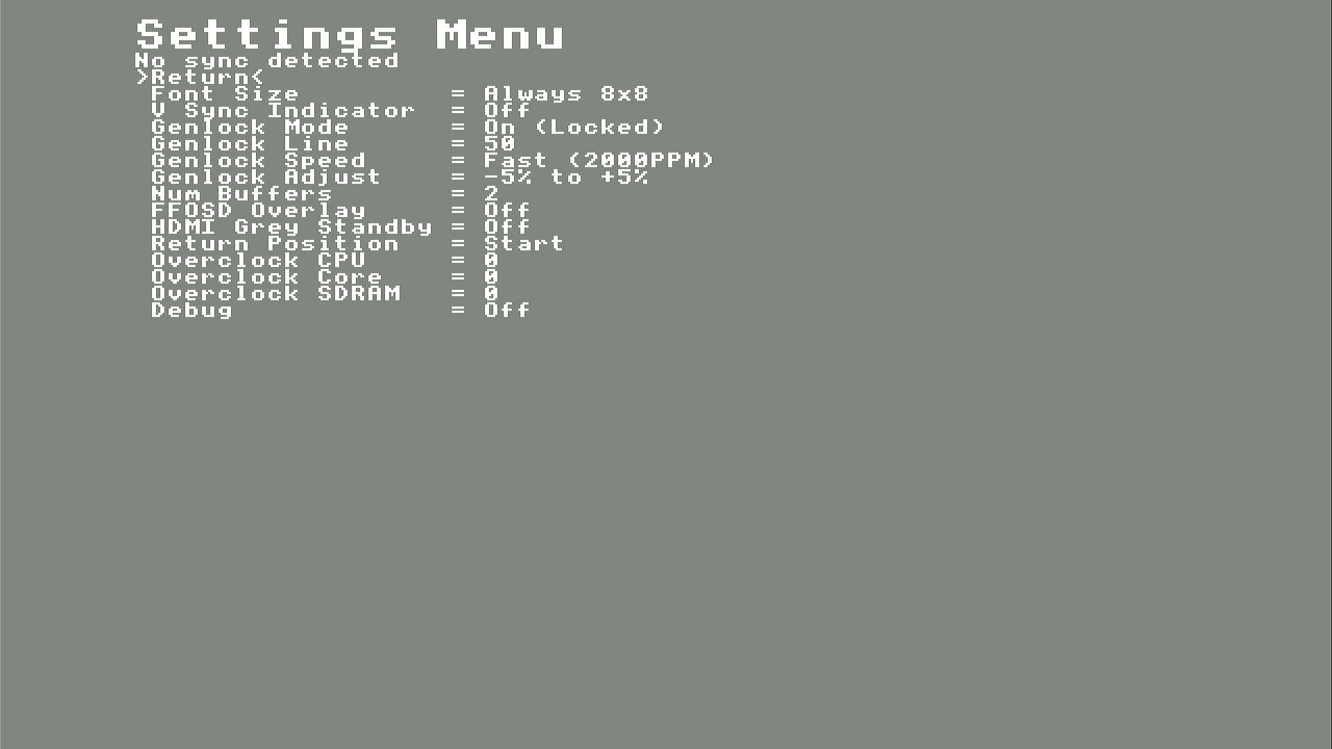

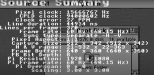

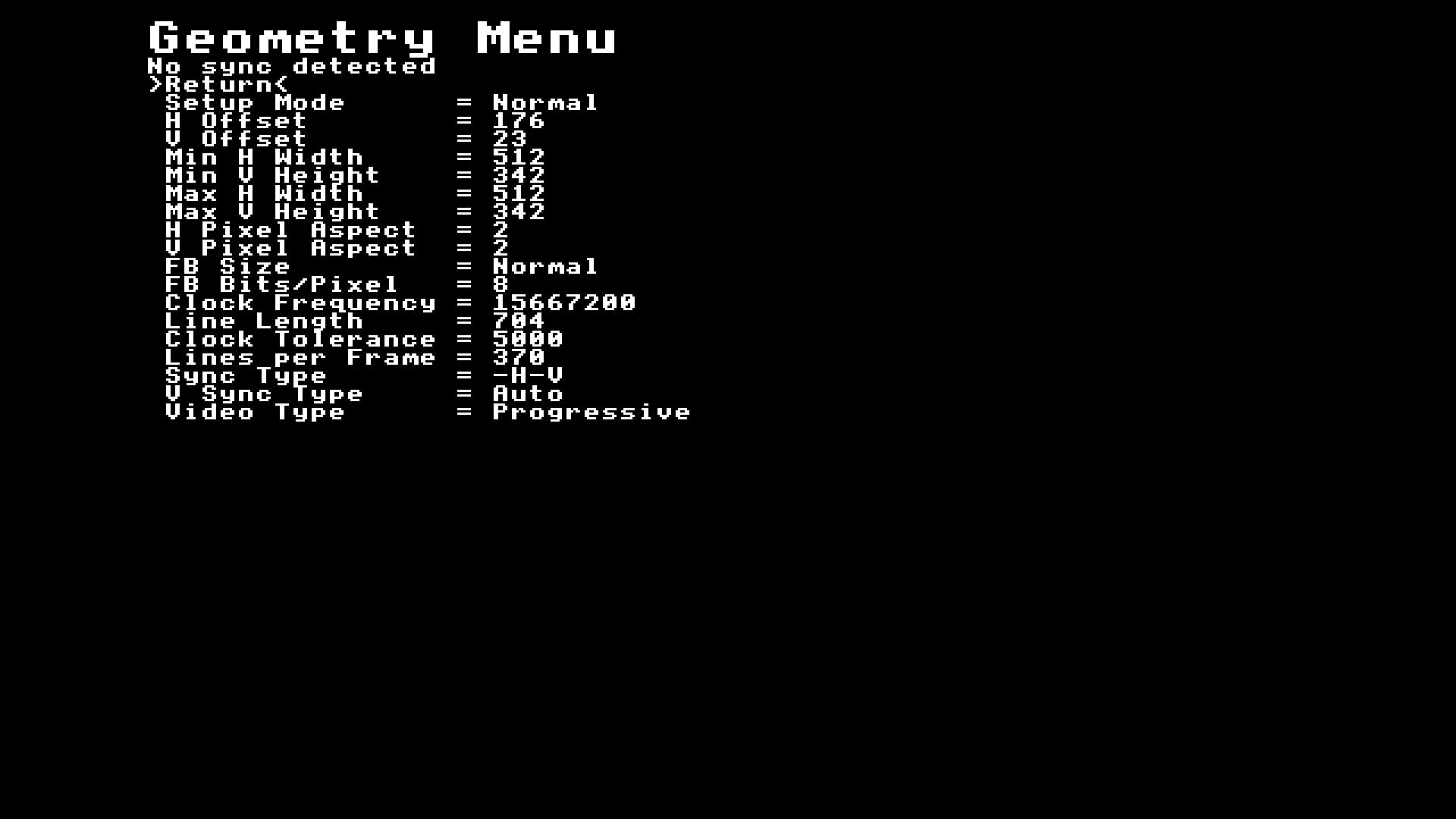

Here's my configuration txt file for it
sampling=0,0,0,0,0,0,0,0,0,5,0,0,0,0,0,0,7,0,0,100,255,100,255,100,255,255,255
geometry=172,22,512,342,512,342,2,2,0,1,15667200,704,5000,370,1,0,0

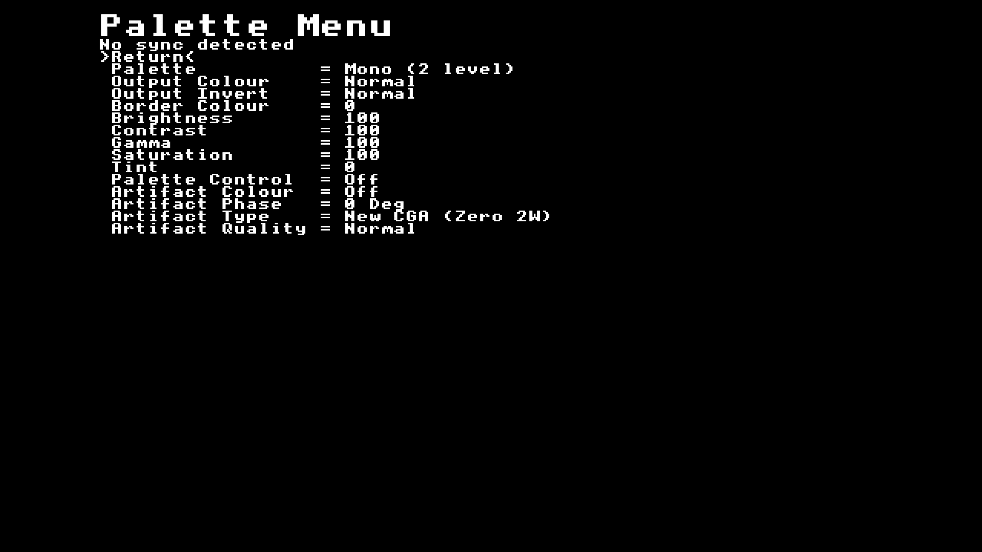

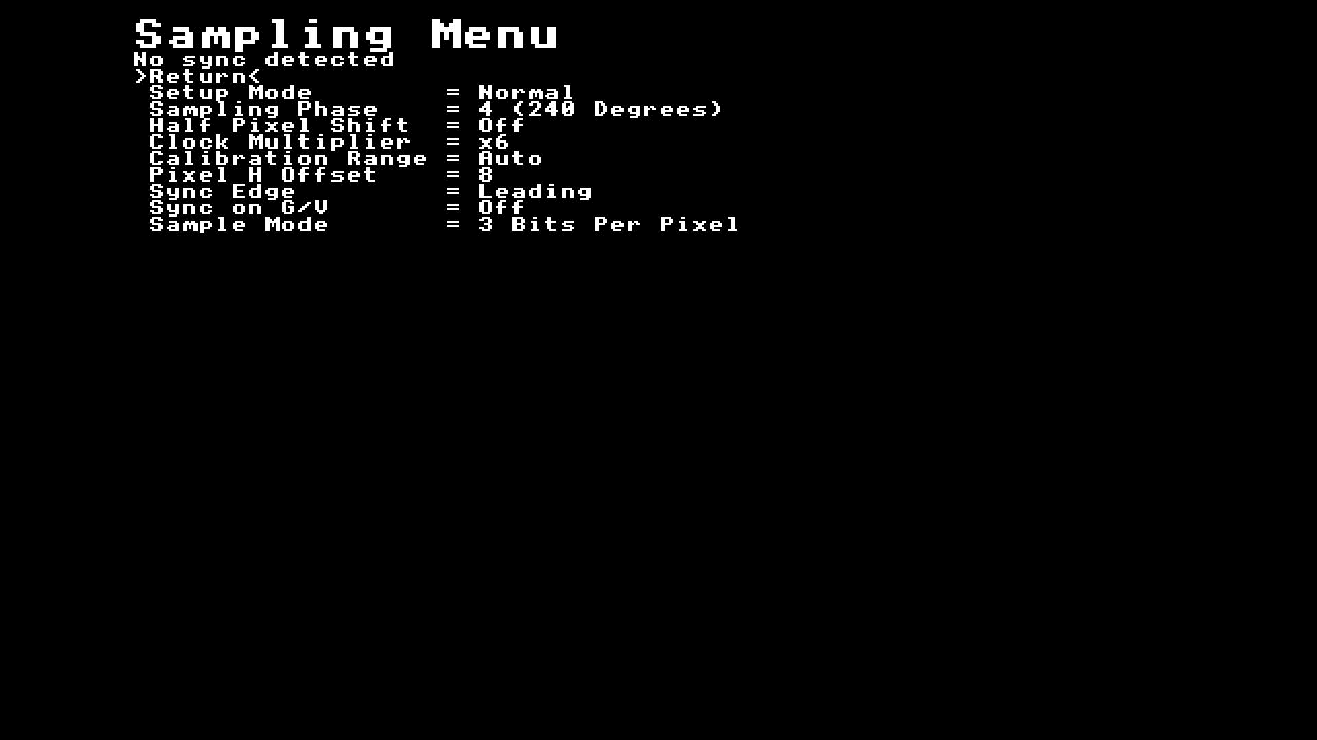

and here's my configuation file for it:

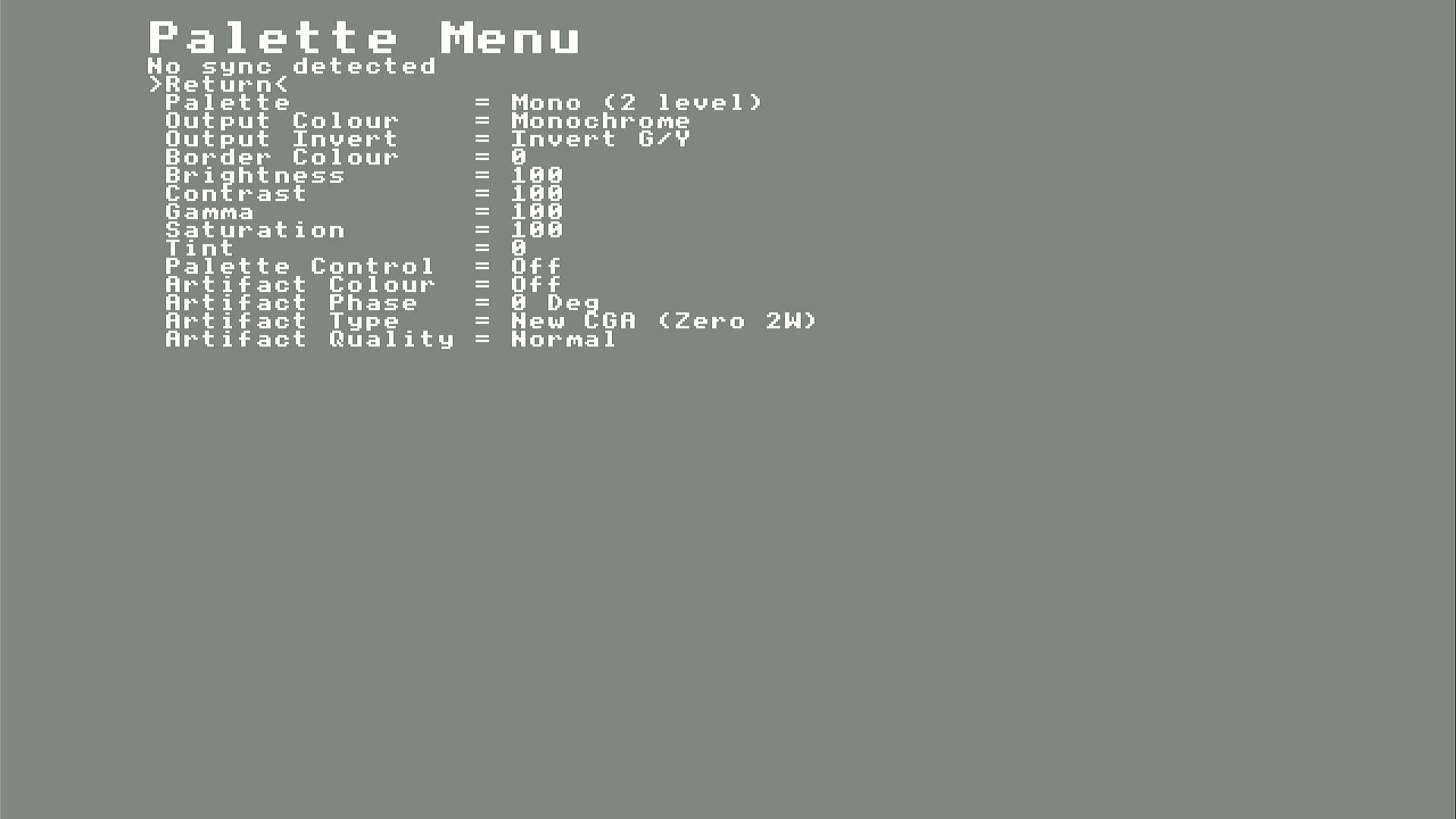

sampling=4,4,4,4,4,4,4,0,1,0,1,0,0,0,0,0,0,1,0,0,100,256,100,256,100,256,0,256
geometry=168,6,512,342,512,342,2,2,0,0,15667200,704,5000,370,1,0,0
palette=Mono_(2_level)
output_colour=1
output_invert=2
scanline_level=0
font_size=0
num_buffers=1

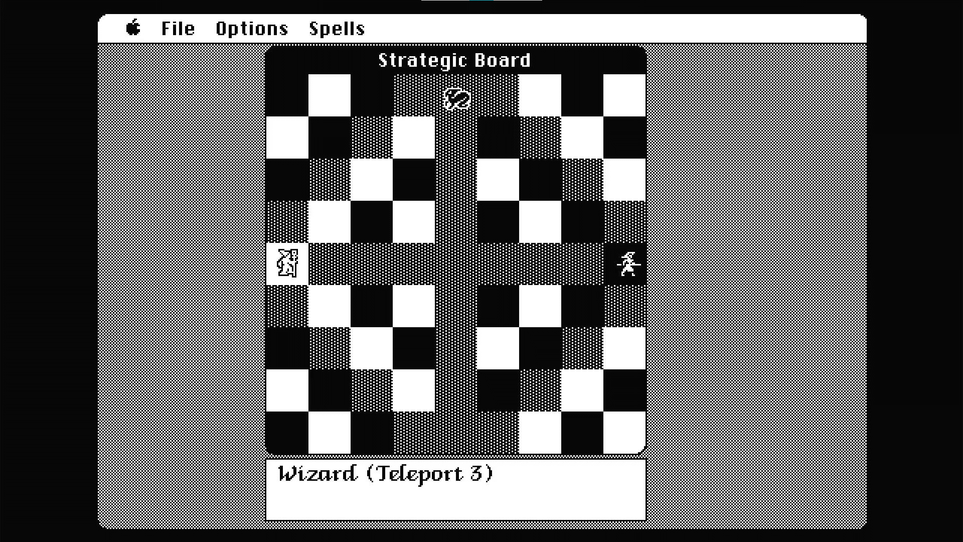

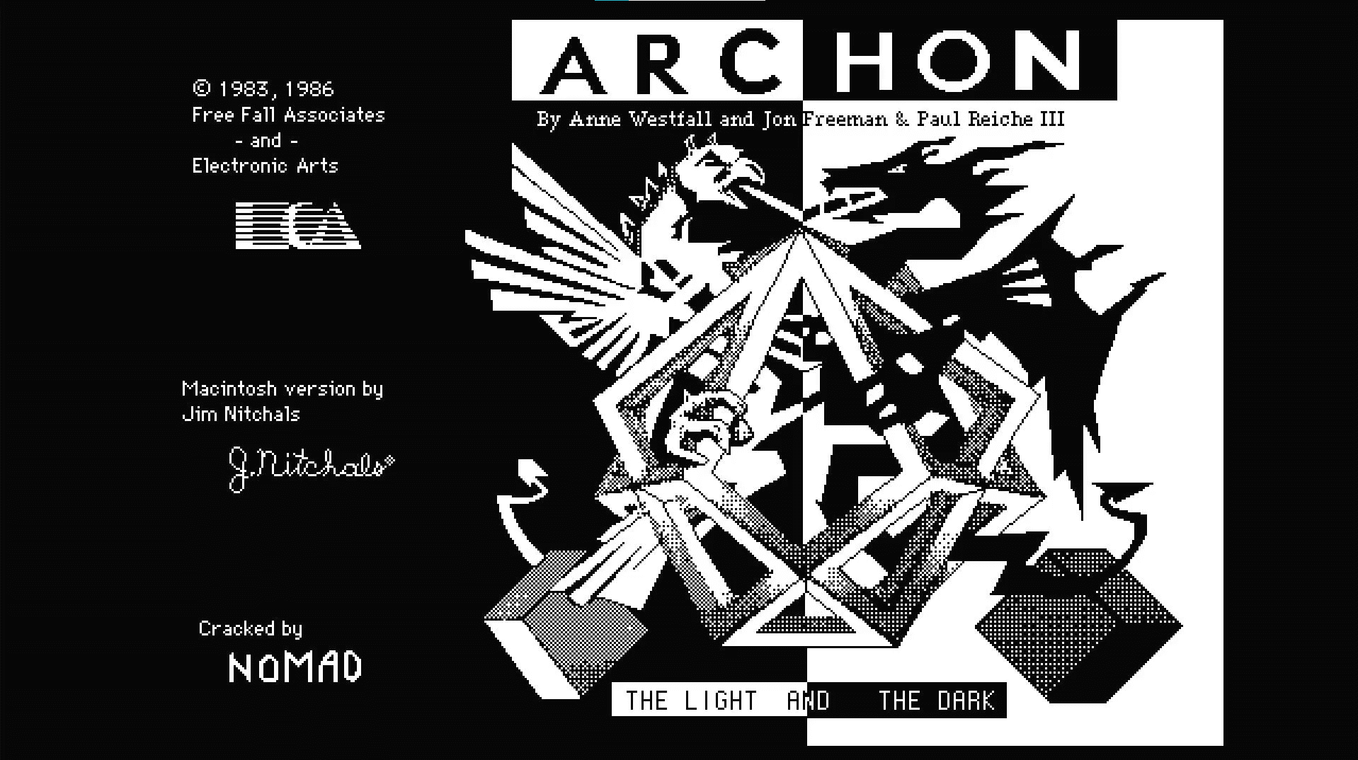

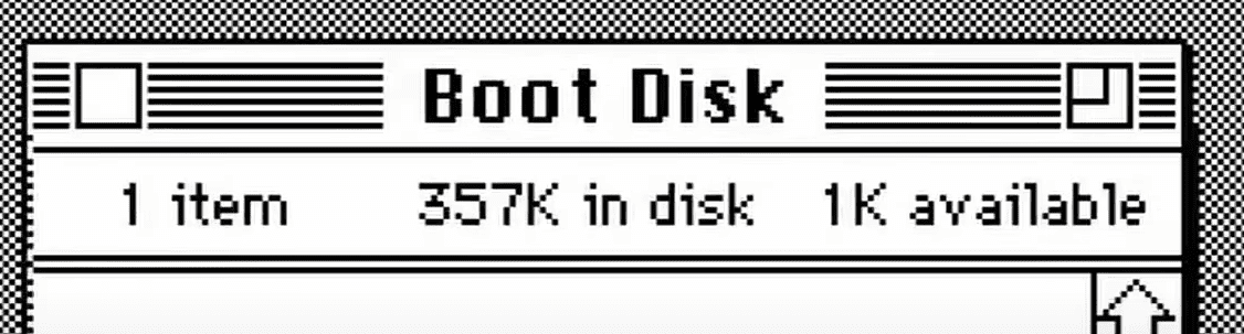

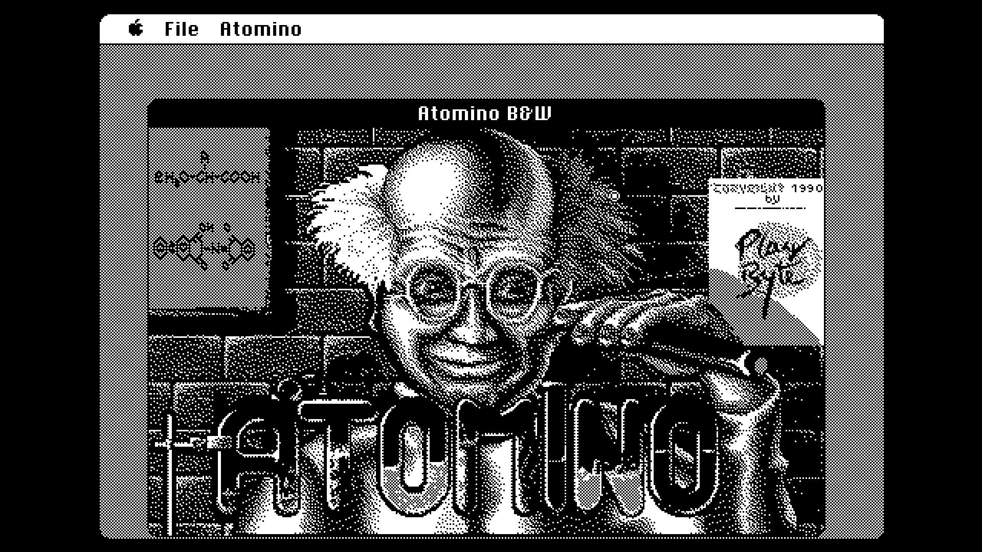

Example image captures (click to see in full view without resizing dithering that ruins some of the patterns)

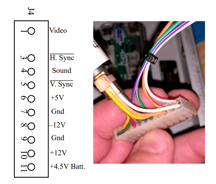

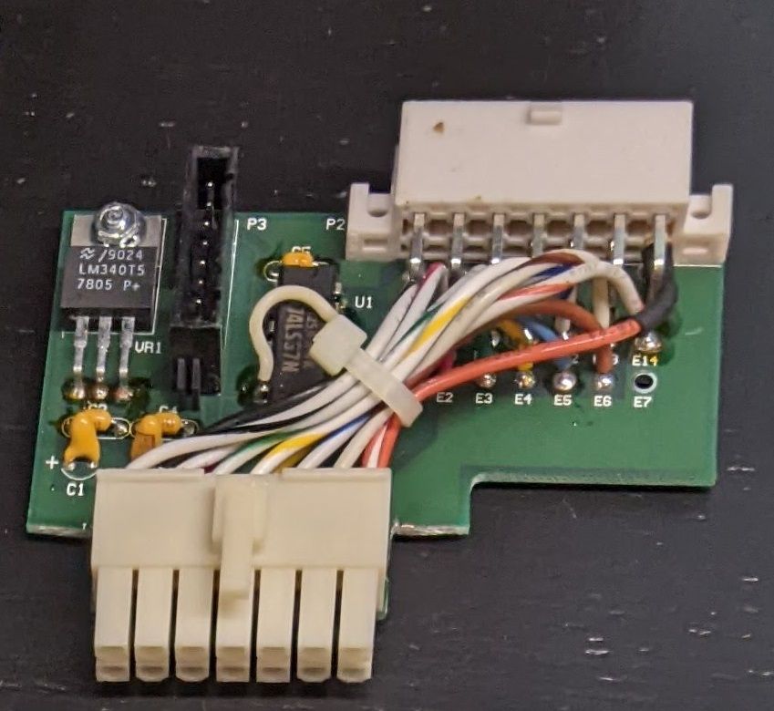

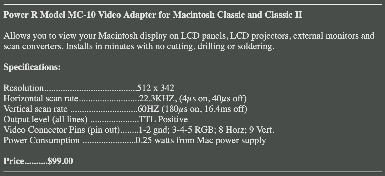

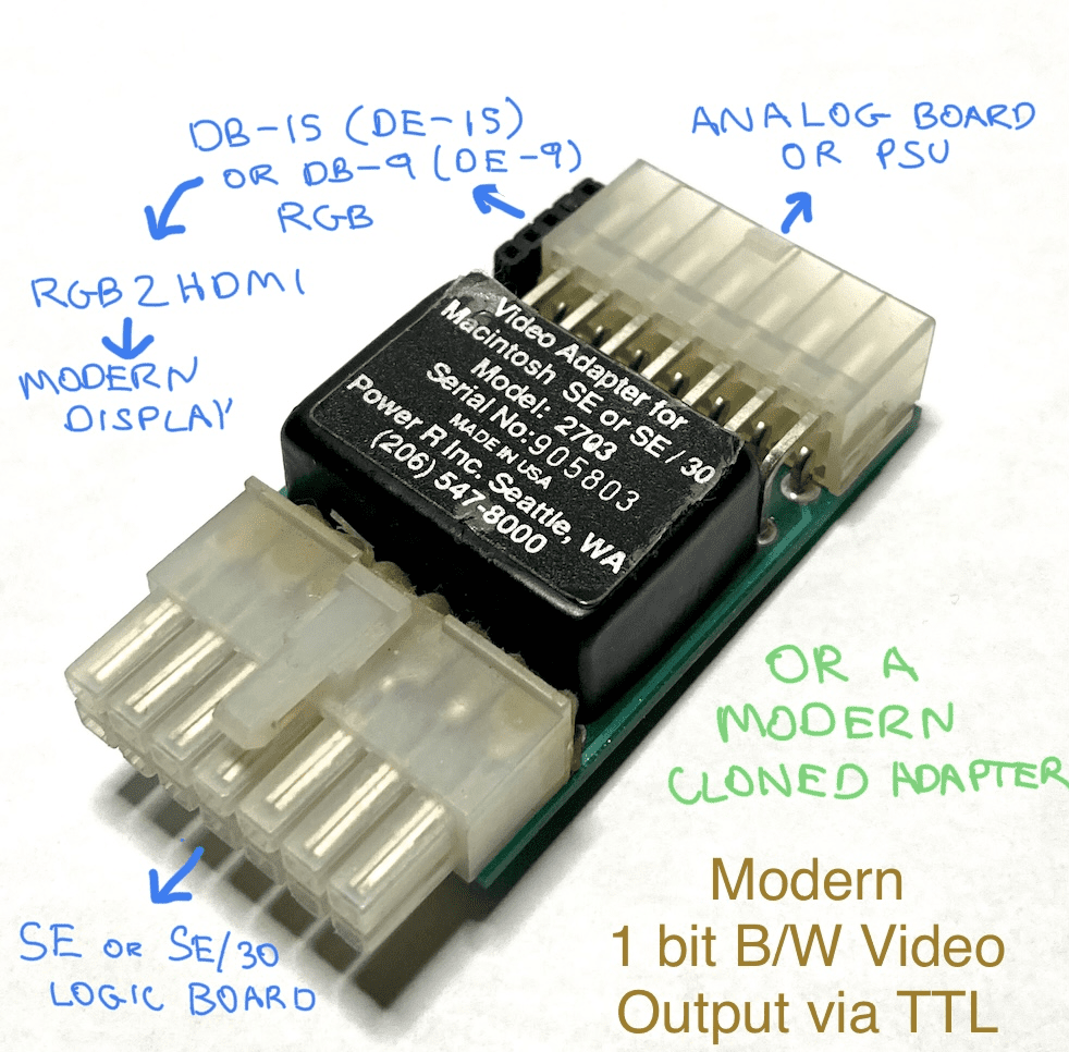

Awesome, @Mu0n! Adrian's video inspired me to have my SE/30 send TTL video to an external display. :)

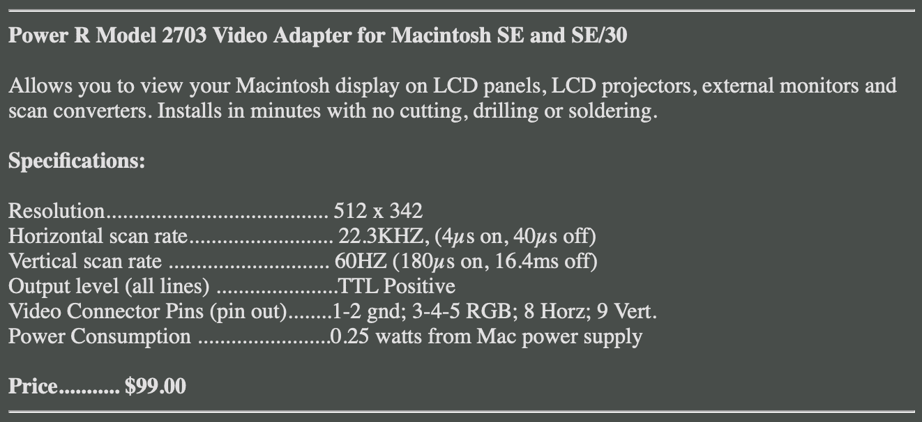

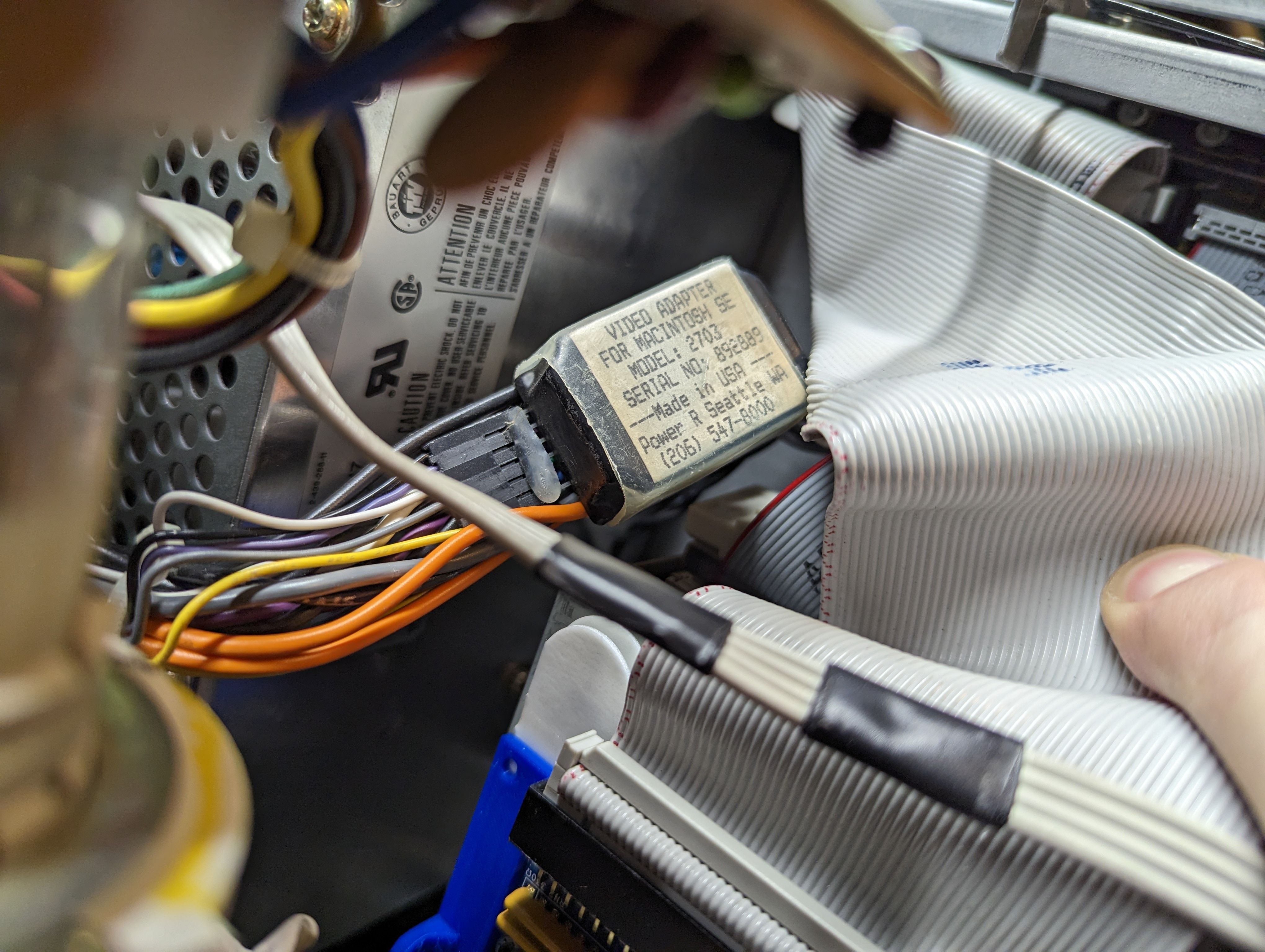

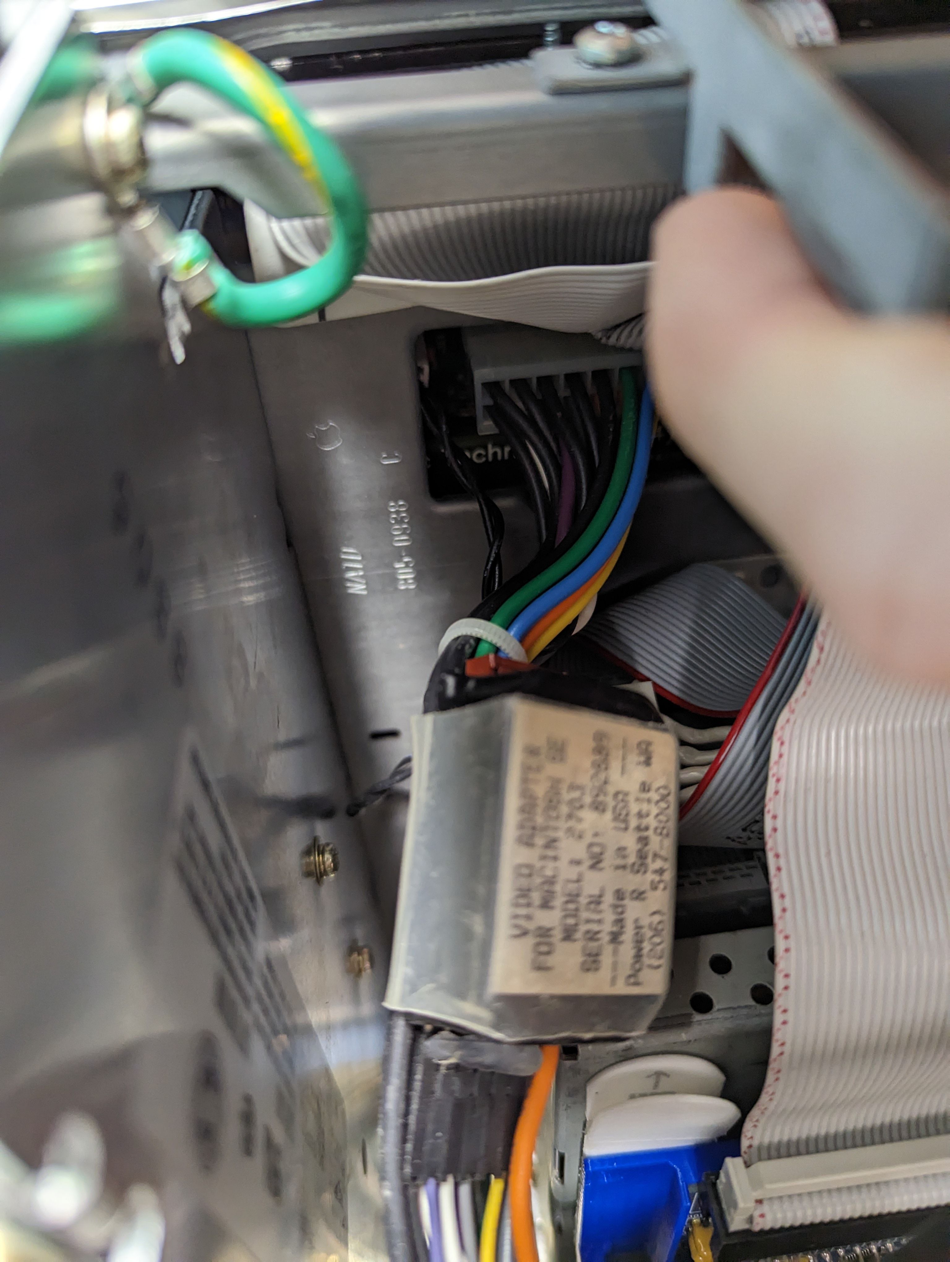

For the SE and SE/30, the process is the same except for where to tap in the video via wires or adapter to get the TTL video out to the RGB2HDMI. I have this PowerR TTL video adapter for the SE/30. From that, @Stephen created a TTL video adapter for the 128k, 512k, and the Plus. 🤓
Now, if only we could extend since the mirroring is the only option. 🧐
Reactions: Paralel
Reactions: Paralel and rdmark

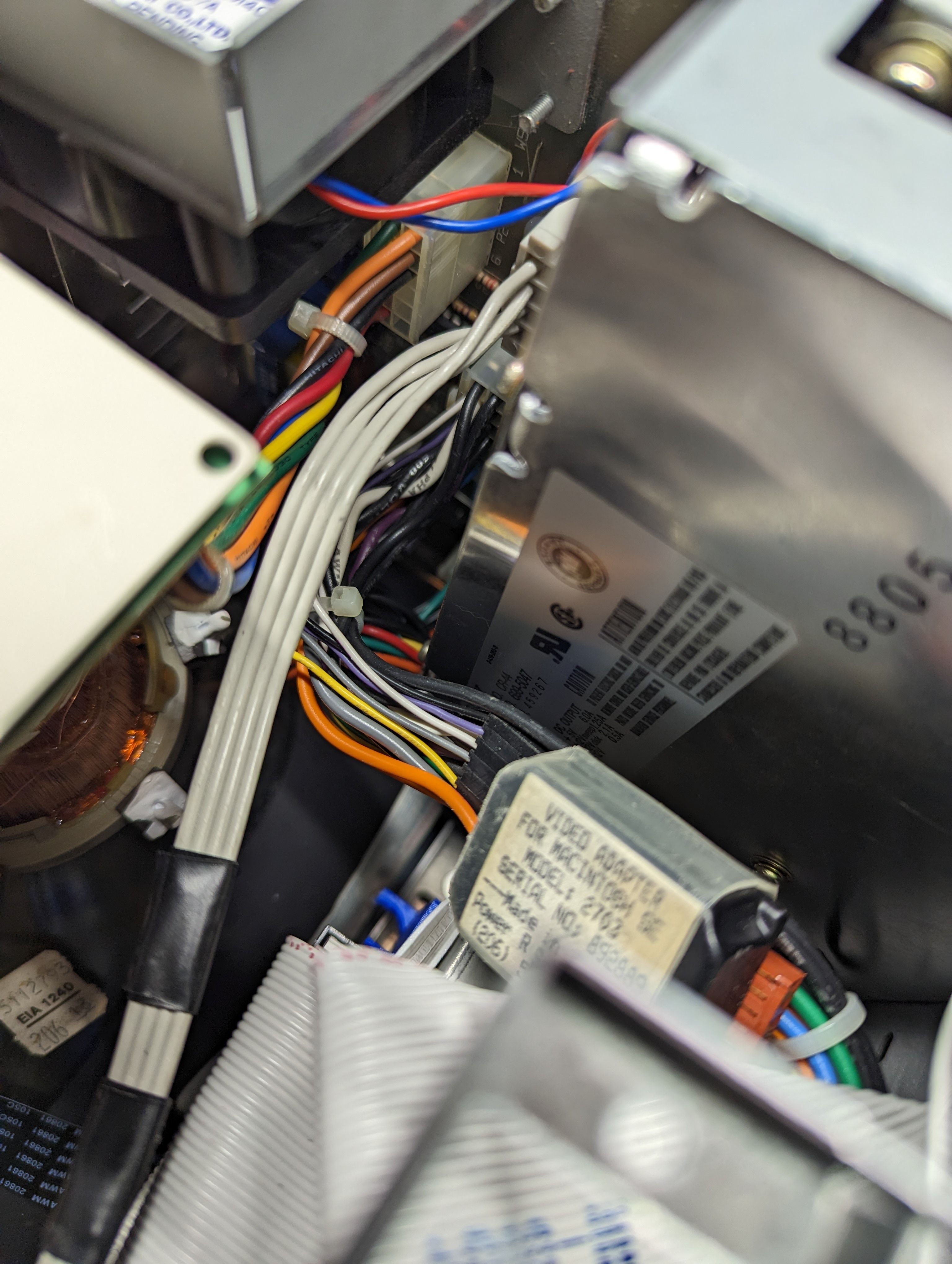

Yeah, very basic. Check this out:
I found one of those in my SE, but it's inline with the analog board wiring harness instead of mounted on a PCB with passthrough connectors:
PXL_20230318_142527299.jpg PXL_20230318_142514464.jpg PXL_20230318_142459652.jpg PXL_20230318_142421983.jpg

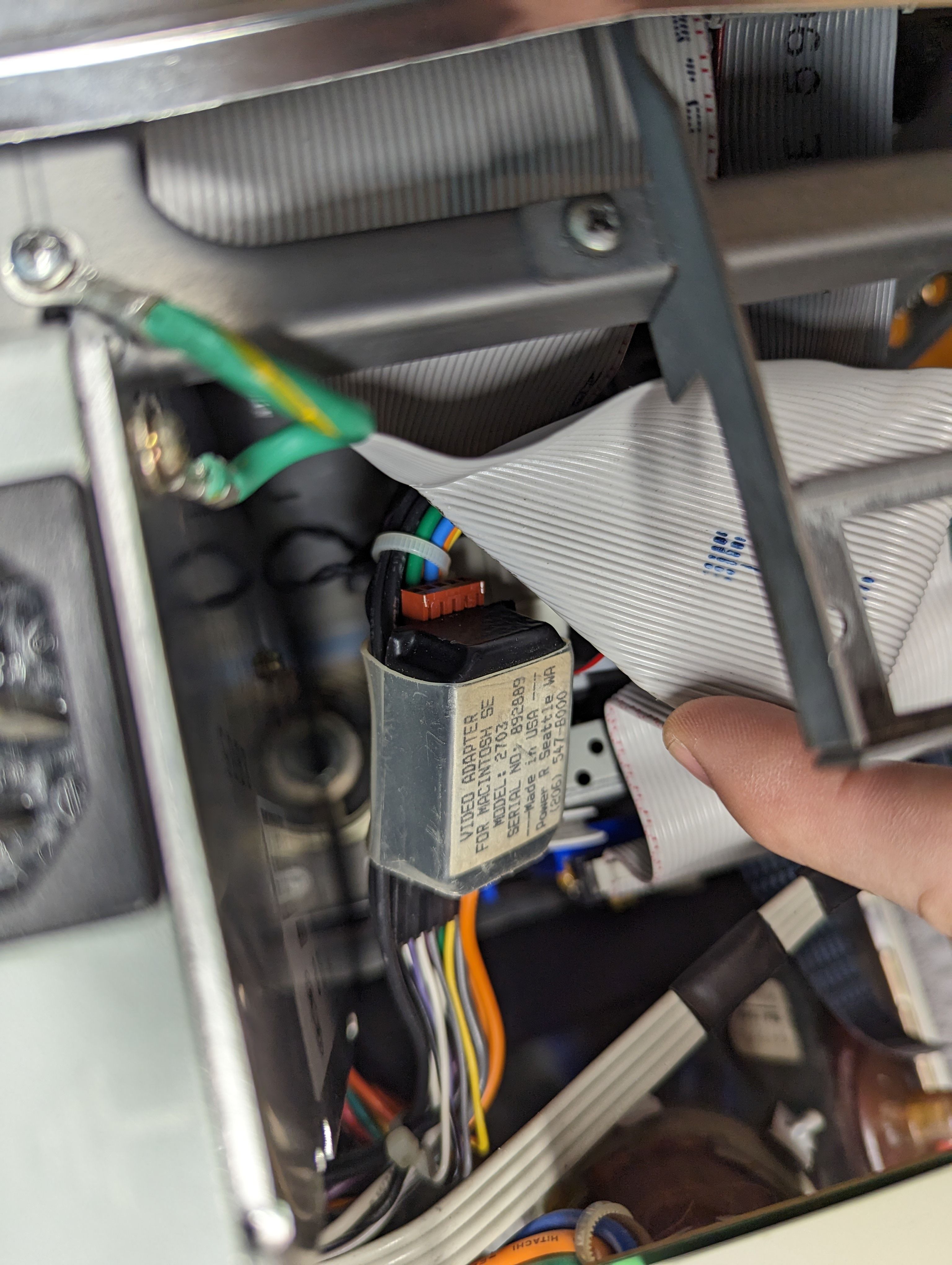

Also found this thing in my Classic that serves a similar purpose:
I've been wanting to build an RGB2HDMI for awhile now to try these out, but I just now got my hands on a PI Zero. So, I'll be referring to this thread soon!
Yes. That is the Power R model 2703.
Connectors are necessary due to the cramped space in the compact case. You already have the connectors ready and the video adapter in place in your SE, whereas I will need to find or build the right connectors to put that in my SE/30.
Is that the Power R model MC-10? Does it have any labels anywhere?

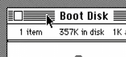

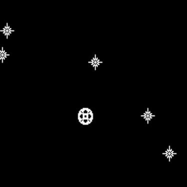

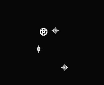

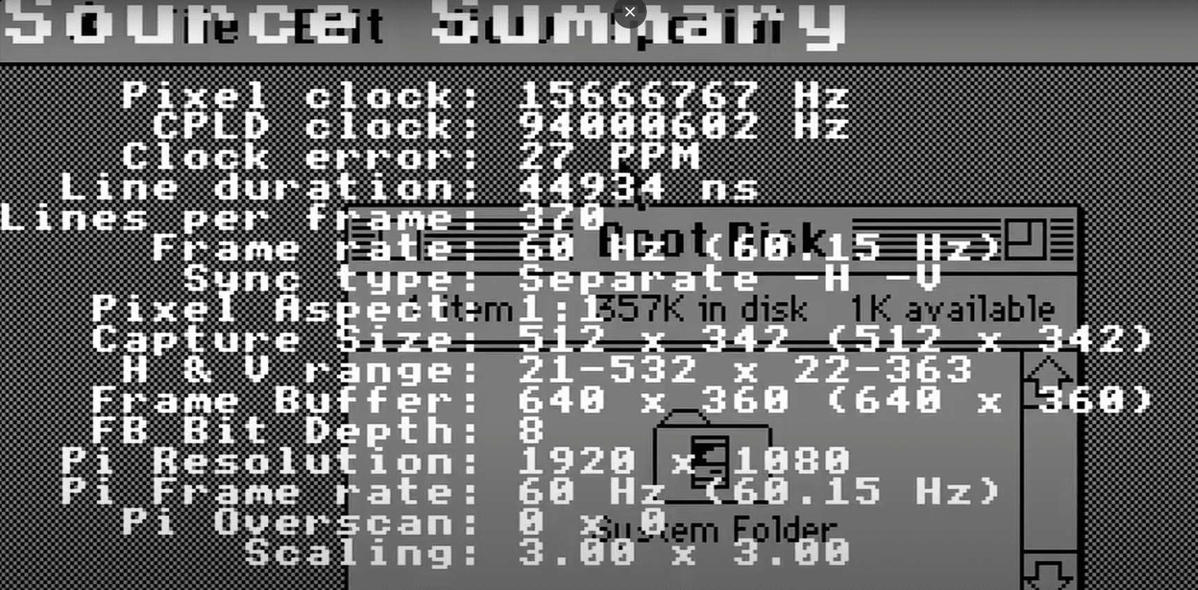

@Mu0n, I saw your reply under this FB post by @Ron's Computer Videos today, which brought me back to this thread. I re-watched the Adrian's Digital Basement video you linked in your opening post and noticed that during his Crystal Quest game play, the display is stretched vertically. Note how the objects which should be round are not. They are taller than they are wide. So is it really pixel perfect in his video? Or is it pixel perfect but we can just correct for that vertical stretching by changing the height on the vintage Mac's analog board?
You mentioned on FB today that you've been using your setup for over a year, so you've no doubt seen this. Thanks.
I had to go back to his video to understand what you were talking about.
Here's his video where the URL timestamp will get you to a moment where you can see Crystal Quest:
Here's a still of that moment:

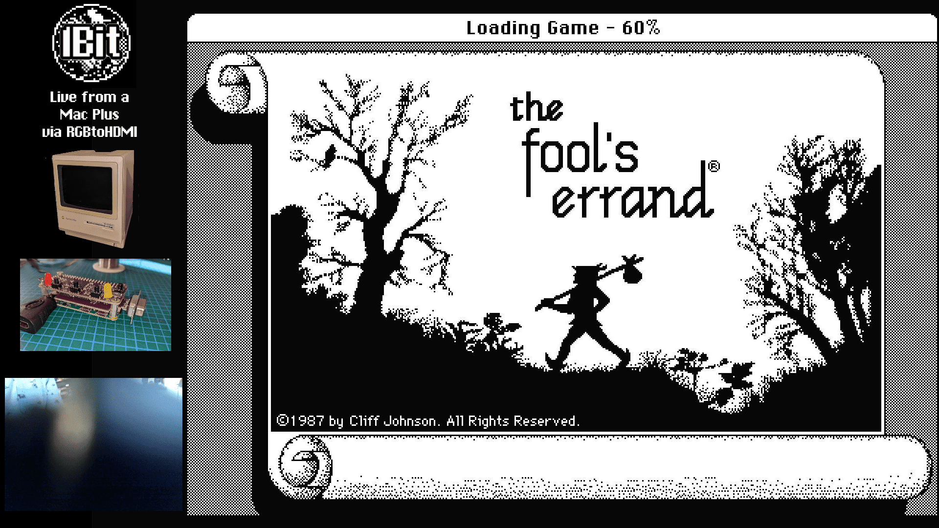

Here's one of my OWN videos playing Crystal Quest as well, featured on my channel. I used my Mac Classic 1 back then, so the comparison is extremely on point. I hadn't done my Plus at that time. Currently, the one active RGBtoHDMI I have is instead installed on one of my Mac Pluses. I have a free RGBtoHDMI floating destined for my SE/30.
Again, still of it:
As you can see, I avoided the problem altogether. I remember I couldn't make my device work with his settings exactly as is, I had to fiddle around. I don't know if the changes affected what I received as a video image. It's possible it's a difference in video capture equipment as well.

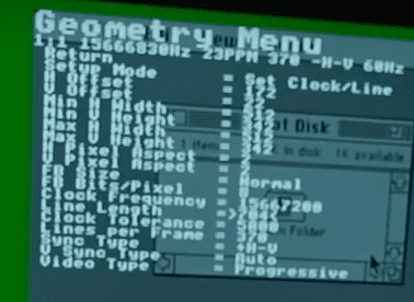

if you check his fiddling of the settings of the RGBtoHDMI during his video, the geometry seems to be very similar:
Mine:
His:
Also, his settings in Crystal Quest seem to get "tall" pixels after he made the switch to Main Menu/Scaling/Interpolate 4:3/Soft
Before the switch:
After the switch:
I did not make such a switch.

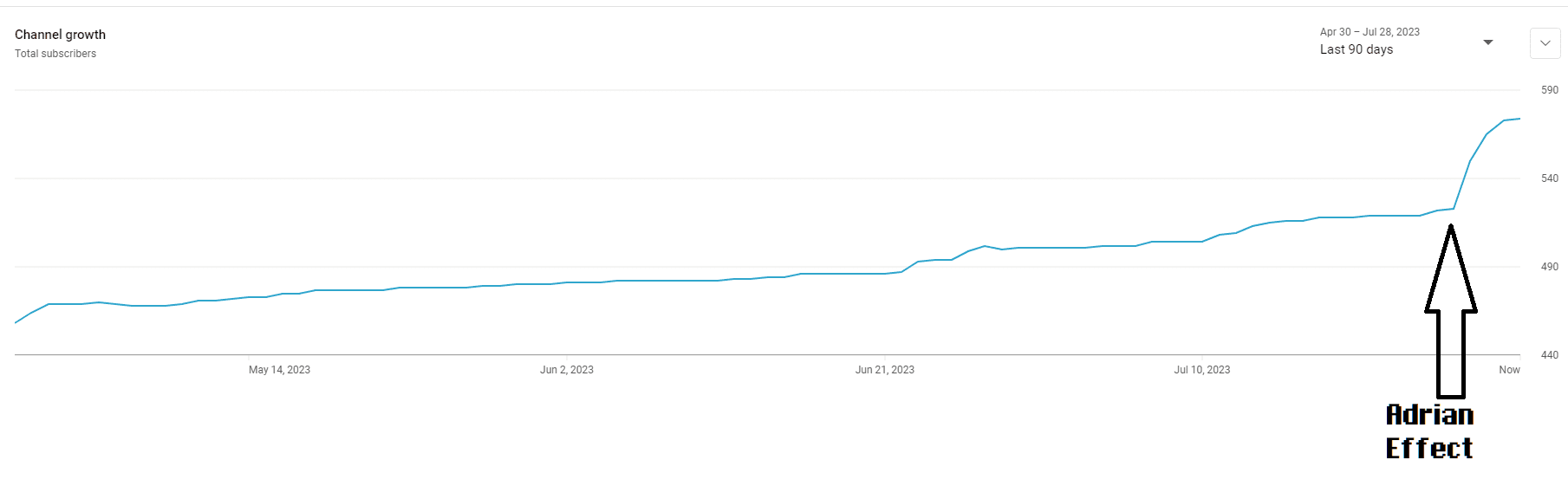

My channel was sitting at 523 subs on the morning of July 27th. Since he posted that video on July 27th, I'm looking at 574 subs today on the morning of July 29th. This is despite having only posted one new video in July only on my channel.
Here's the Adrian "effect" visually:

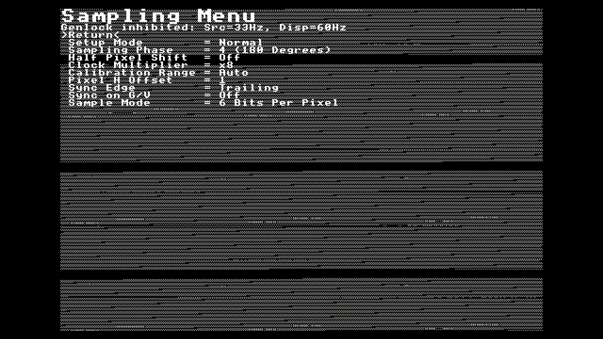

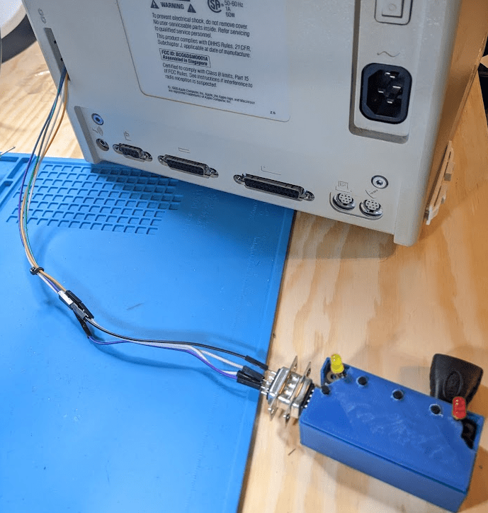

I'm trying to install a RGBtoHDMI to my Mac SE/30 and I get an unstable image. Anyone else deal with this exact machine?
Taking the Classic profile I have that's stable on my Classic 1 and just flipping the polarity to H+V+ does not do the trick so far.
edit -
ok I'm an idiot. wire colors are hard to get right past midnight. I inverted hsync and vsync because I thought I could match colors between the SE/30 and my stuff still not done but on right path now
