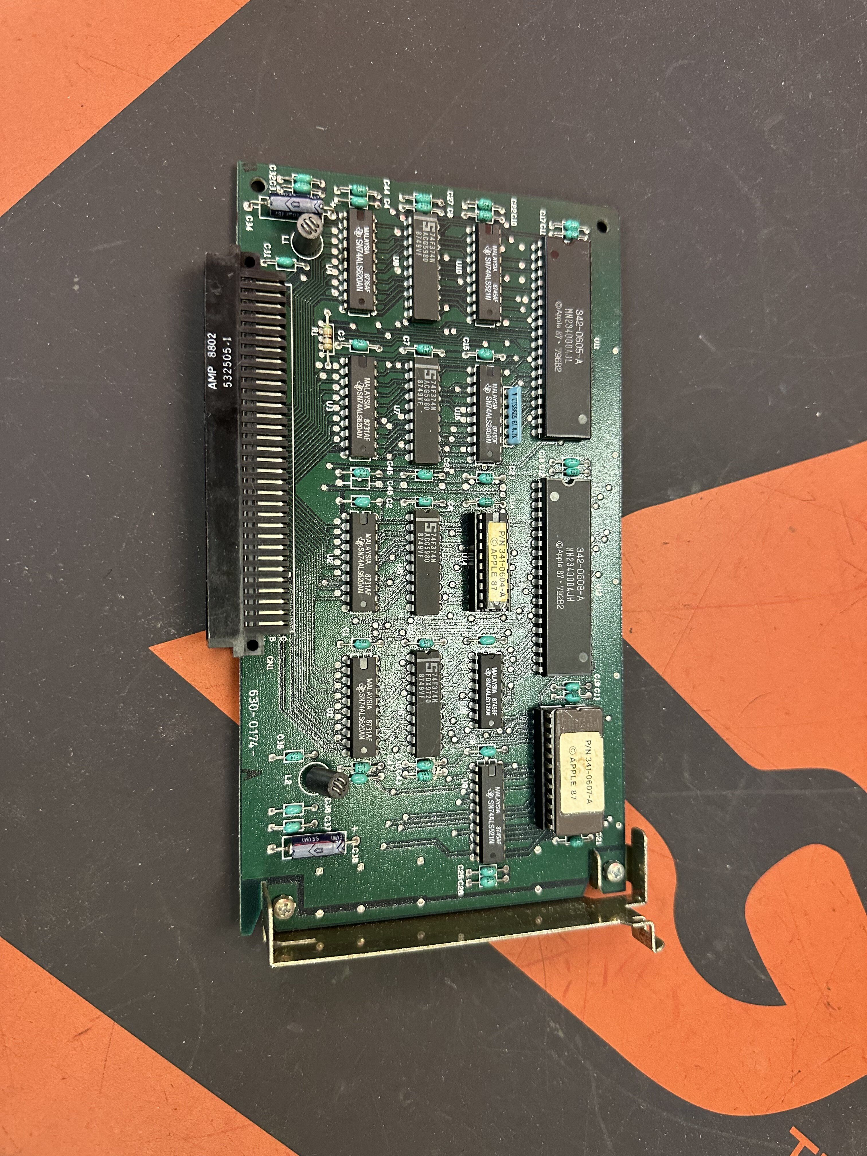

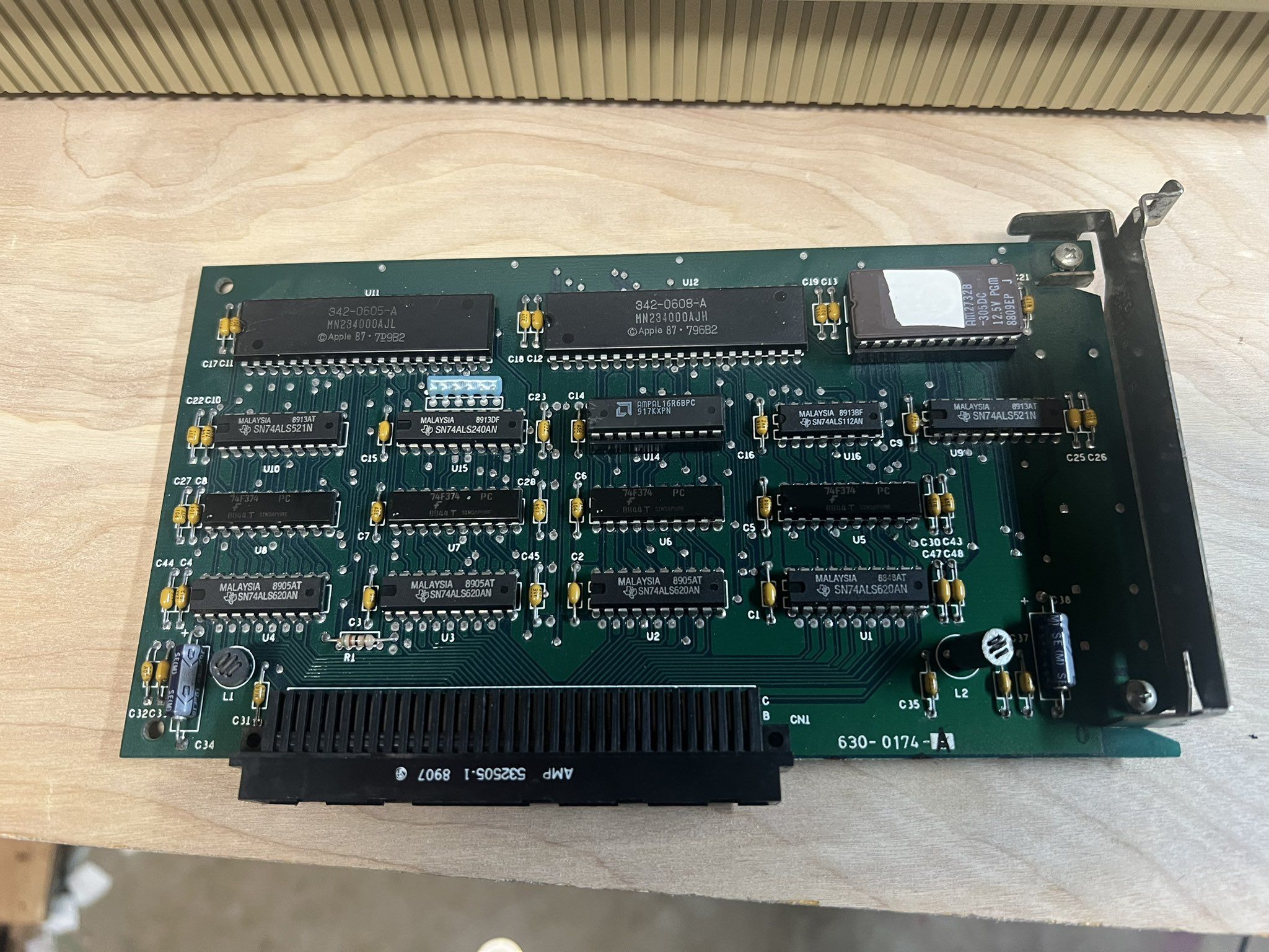

I've recently acquired this interesting Apple KanjiTalk Font NuBus card... and I'd love to learn more about what it does and it's purpose, etc.
Doing some research, I've found other websites (example from okqubit.net) wondering what this is. I'm assuming it may have something to do with some software limitation on the Macintosh that benefited or required this type of card to use the potentially thousands of characters Kanji has.

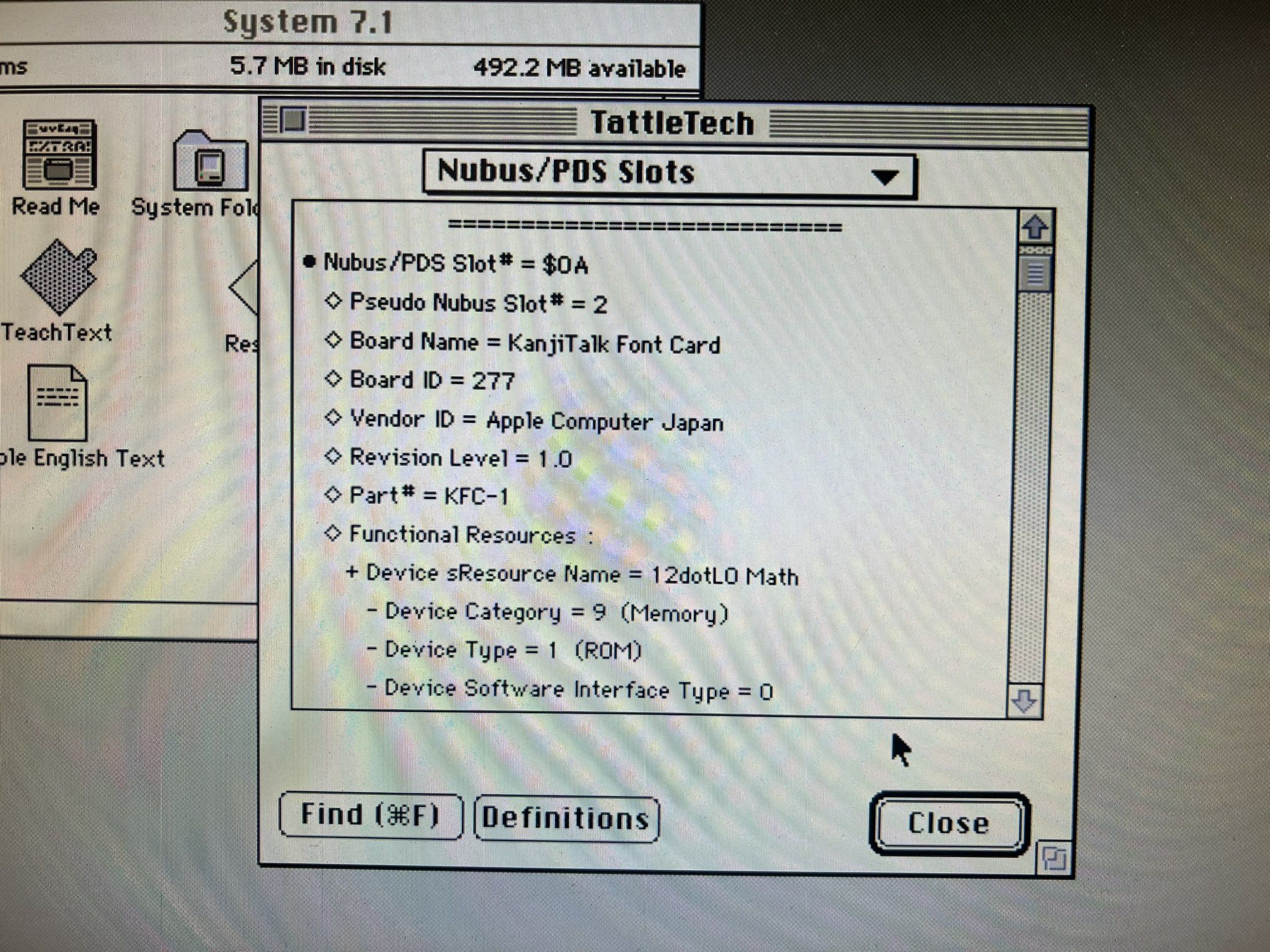

I've installed the card in my Macintosh IIx and tried booting to System 7.1 (English) and System 6.0.7 (Kanji) and KanjiTalk (7.0). Nothing seemingly changes on the surface of the operating system. However, I'm sure I may be missing a software component to take advantage of the card.

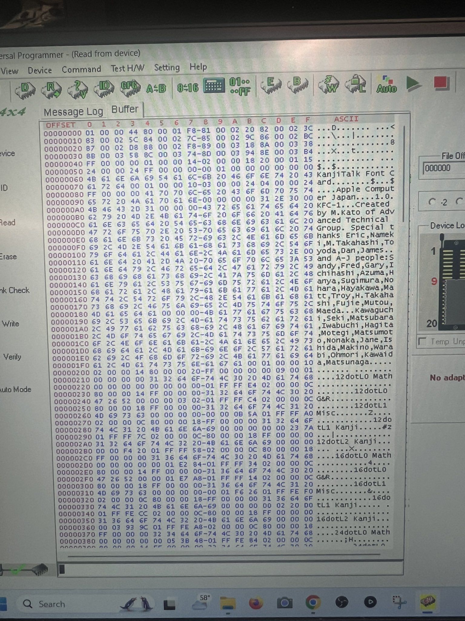

Here is a dump of the ROM (AM2732B) from the card: ROM dump
Oddly enough, there is no Apple Computer specific markings on the card. Maybe this card was used for development purposes?
I'm attaching some images, hopefully we can figure out how to use this card, as I think it'll be fun. 😄

The declaration Rom simply list a bunch of resources, but no actual code (primary/secondary init or driver):

That and the category/type suggest it's just ROM storage. Each of the resource above has an entry of type '128', which seem to contain 8 bytes of data. They are for instance:
Code:
Found entry 128 offset 504
Found resource entry 128 offset 32 (0x00000020)
Unknown resource entry 128
                raw data: 0x00000000
                raw data: 0xe4ffff01
                raw data R: 0x00000000
                raw data R: 0x01ffffe4
Found entry 129 offset 544
Found resource entry 128 offset 20 (0x00000014)
                raw data: 0x02030000
                raw data: 0xc4ffff01
                raw data R: 0x00000302
                raw data R: 0x01ffffc4
Where 'R' is the same data but byte-reversed (little/big-endian). Might some form of indexing in the card slot space.
You could see if you can access data at the beginning of the slot space - beware if there's nothing there the mac will crash with a bus error. If you know the slot number (it's documented by apple for most NuBus machines in DCDMF3), you can have the most trivial of console applications displaying the value pointed by (0xF0000000 | slot << 24) in 32-bits mode (e.g. "printf("0x%08x\n", *(unsigned int*)(0xFC000000));" for slot $C). If you get a result instead of a crash, there's something there... but it could be somewhere else in the card space (the Rom itself is at the end of the slot space in 24 and 32 bits mode).
Edit: also I would guess the 12dot/16dot/24dot in the names is a font size, and there three groups of 5 fonts in Kanji?
Edit2: if we take the first number for an offset or a size, then it grows faster for (the presumed) larger font sizes, which is logical for bit-mapped fonts. it also suggests a fairly large amount of a data (hundred of kilobytes), which you couldn't keep in a boot floppy and would be wasteful even on a hard drive in the early days of the II series. Having such large amount of data in ROM would make sense if the board wasn't excessively expensive vs. magnetic storage.
Reactions: trs and Mac84

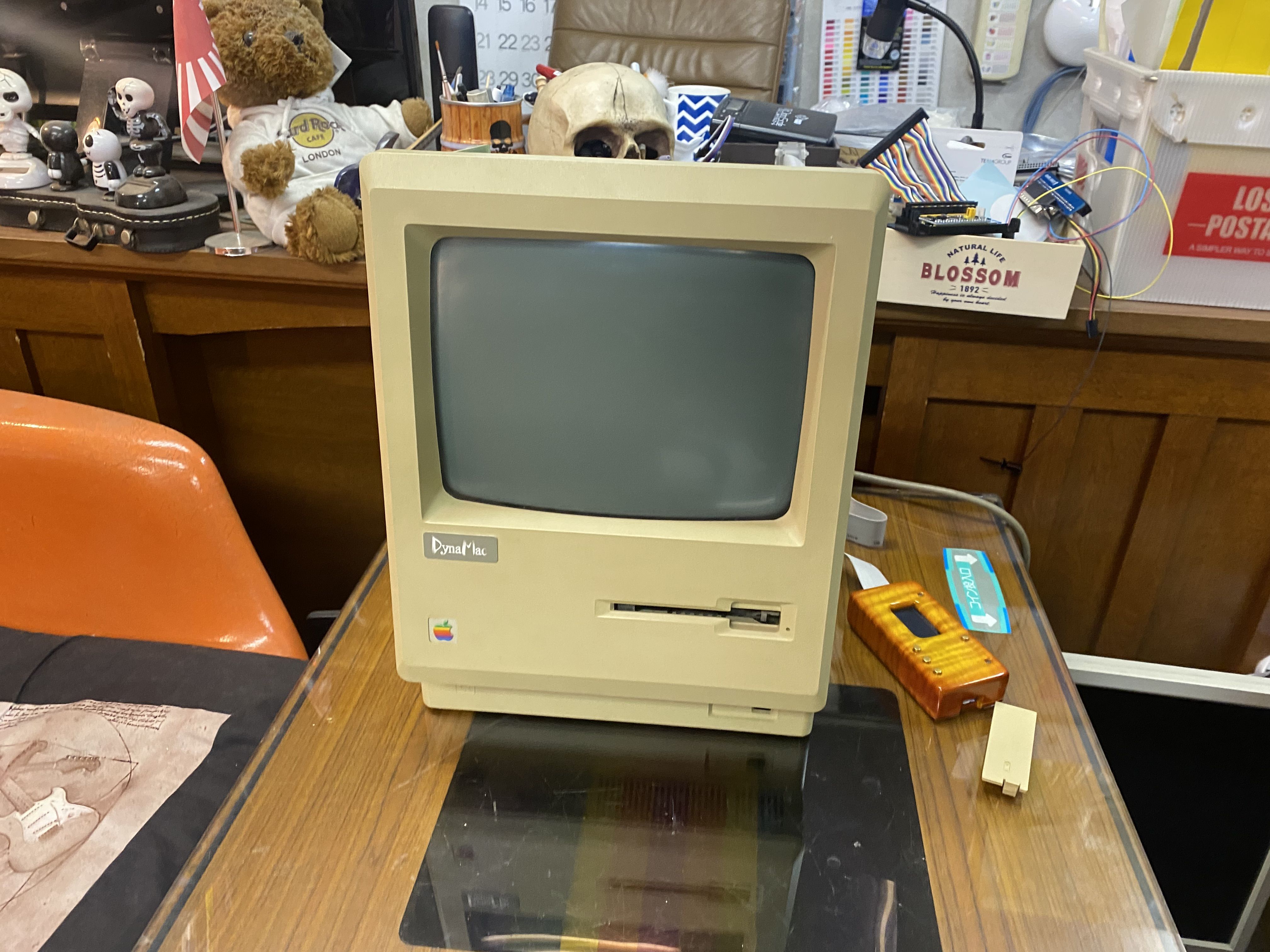

In addition, not only MacintoshII but also Mac512K has a model called DynaMac only for the Japanese market. This was equipped with a Kanji-ROM card directly connected to the 68000 like an accelerator card.
This is a DynaMac I'm in the process of repairing. I think it was about two years ago. Unfortunately, it was owned by a friend and upgraded to MacPlus, but he showed me the Kanji ROM card for this.

From a look at the PCB it seems the 4kb declaration ROM is just part of it. The two MN234000 seem two 512KX8 masked ROMs, so my guess is that this card maps 1MB of Kanji font data into the address space, which seems to make sense.

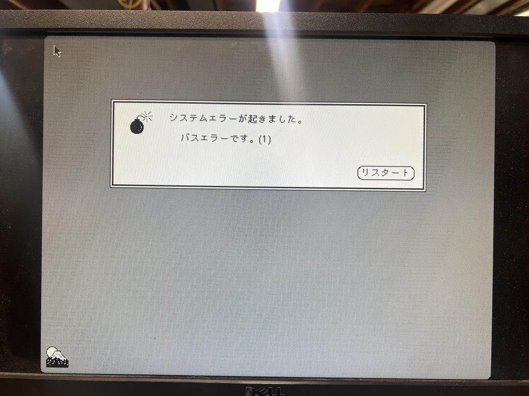

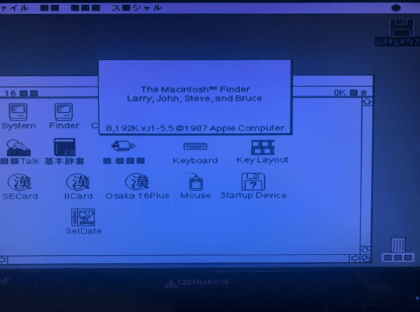

Thanks to @fogWraith I spent some more time pulling my hair out about this. o_O
I switched from my Mac IIx to my Mac II, as the Mac II can run pre-System 6 versions of the Mac OS. This seems to be what the KanjiCard wants installed.
Sadly, whenever I have the KanjiTalk NuBus card installed, the Mac acts very, very odd. Random boot loops, the FloppyEmu restarting frequently, system hangs and bombs... And even without it... it is finicky, so there is something wrong... somewhere.

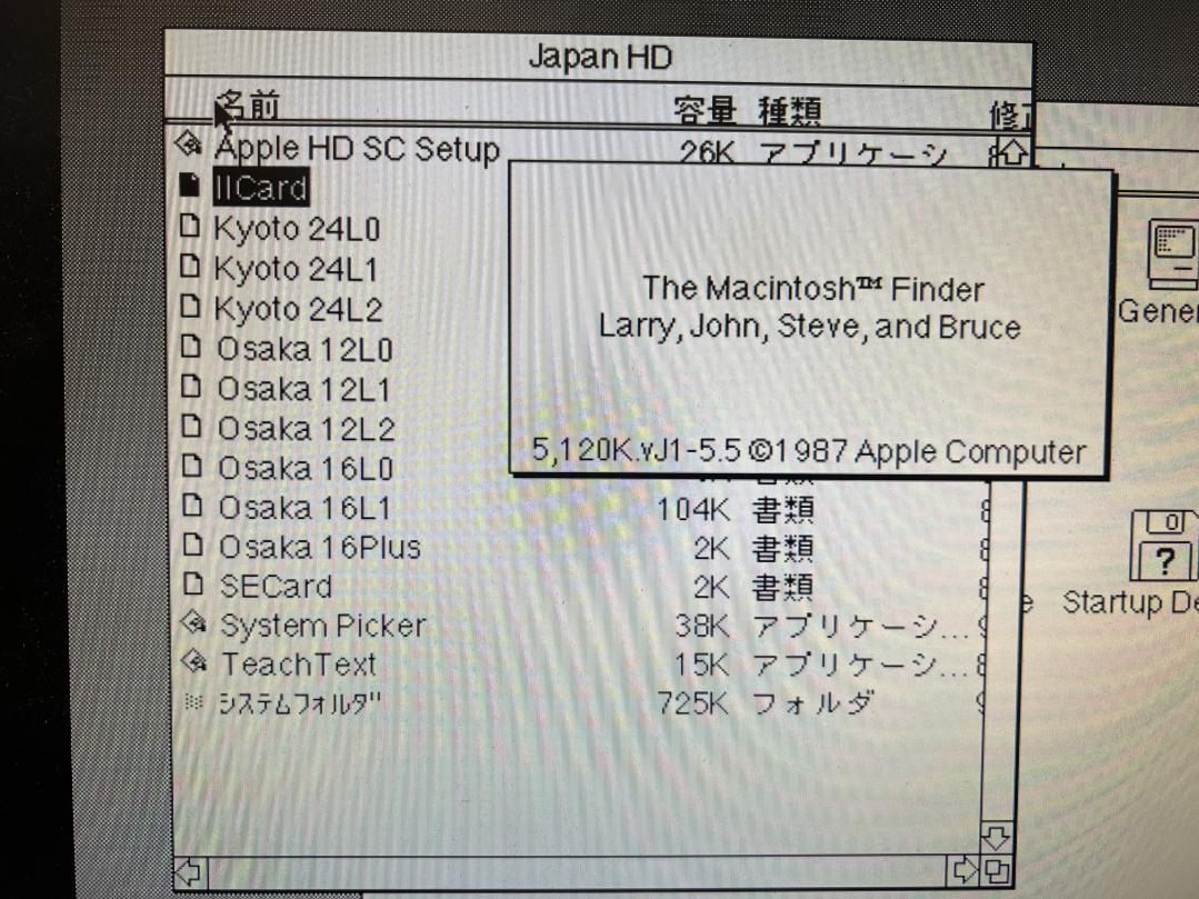

I did use this link to try KanjiTalk 2.0 (that includes Finder 5.5, 1987) from MacintoshGarden. It contains two floppy images, a Font disk and a System disk. Although maybe the elusive version 2.1 is more bug-free?
I used these disks to install the system onto a BlueSCSI. Either way, when the system boots it asks for the Font disk, you can select cancel on the dialog box and proceed to booting. But inserting the disk seems to freeze the system (at least using my FloppyEmu). If I bypass the Font dialog box, I can get to the Desktop.

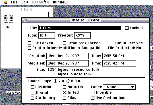

Inside the System Folder are "IIcard" and "SEcard" files. These must relate to the KanjiCards for those Mac models. Oddly enough, if I place the font files (from the Fonts Disk) into the root of the HD, or the System Folder, it still is looking for that disk upon boot. Maybe there's something more to it? A screenshot of the ResEdit info for the "IIcard" file is attached below. These files are not present on the KanjiTalk 1.0 (Finder 5.2) disk.
Maybe the HFS support in KanjiTalk 2.1 will fix my issues? Maybe my E-Machines NuBus video card is to blame? I'd love to know...
Still, the system seems very unstable when the KanjiCard NuBus card installed. So I've paused this for now. Was there a different Mac II ROM used for machines in Japan? :unsure: That may explain why my US Mac II is so unhappy...

Try it on system 1-2. Kanji Talk Talk 1.0 is System 3.0. *I made a mistake in my Twitter reply
The Japanese Mac II's onboard ROM is the same as the US version. I used MacII with System7.0.1, no problem.

I tried but it won’t boot on the Mac II.
I think it’s one version too old, judging by the Mac II’s original software version number (System Software bundle v2.0.1 - which includes System 4.1 / Finder 5.5) and release date of 1987.
Also, that system disk doesn’t seem to have the “IIcard” or “SEcard” files. So maybe it was only for the 512K and Plus models?

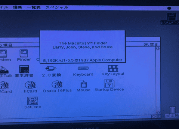

We did this on X(Twitter), not here, but the method for using this card was quite simple. The reason is that this small capacity ROM card is a ROM card that is used only to store font data even if you do not install Japanese fonts. So, in order to save a little space, if you do not install kanji fonts and use another environment for kanji talk, the characters will be displayed without garbled text.
Kanji Talk 2.0 was released in 1987 along with Macintosh II and Macintosh SE. Based on System 4.1. Two fonts have been added: Kyoto (Mincho style) and Osaka (Gothic style). It also incorporated the concept of FEP and provided "2.0 conversion" in the INIT file.
As usual, you will have to reinsert the disk several times during the installation, but when the message "フォントディスクを挿入してください(Please insert the font disk)'' appears, press "キャンセル' to cancel.
If you do that, the kanji font will not be installed on your system, so you can read the font from the card.
Therefore, in Kanji Talk 2.0, where no card is installed, there is no font, so the characters are garbled.
With Kanji Font ROM card
