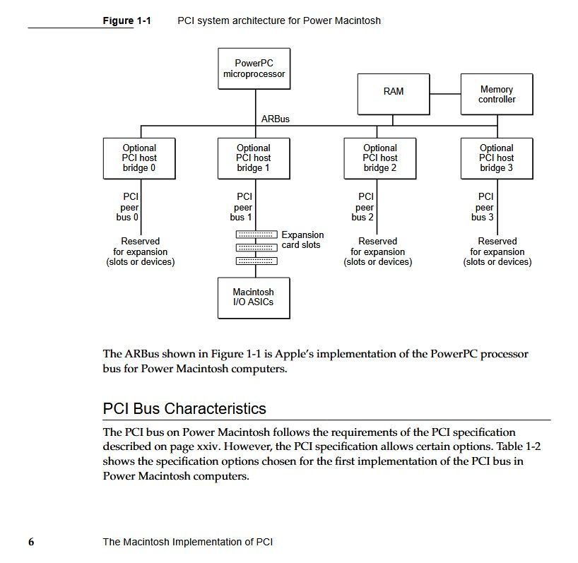

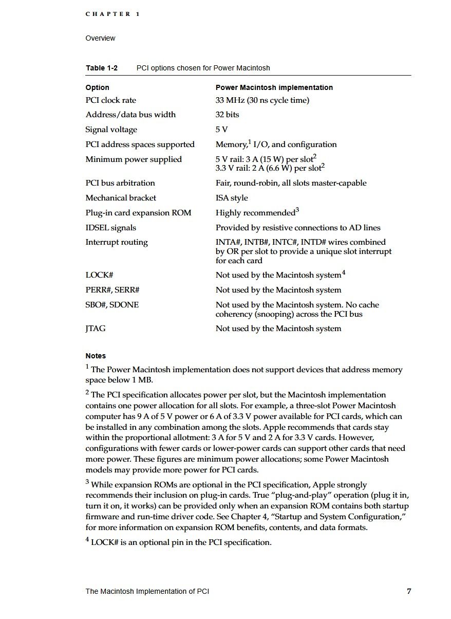

THX, will check out. Comparing these 1996 pages to the 1999 revision ATM.

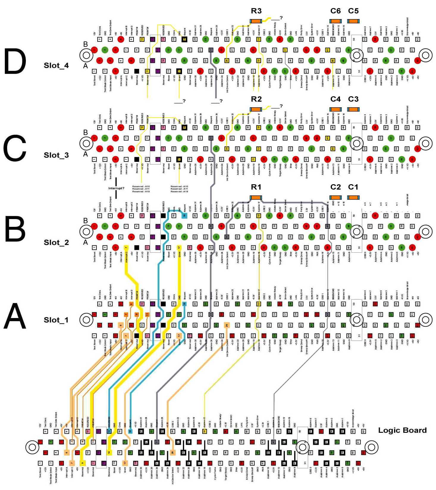

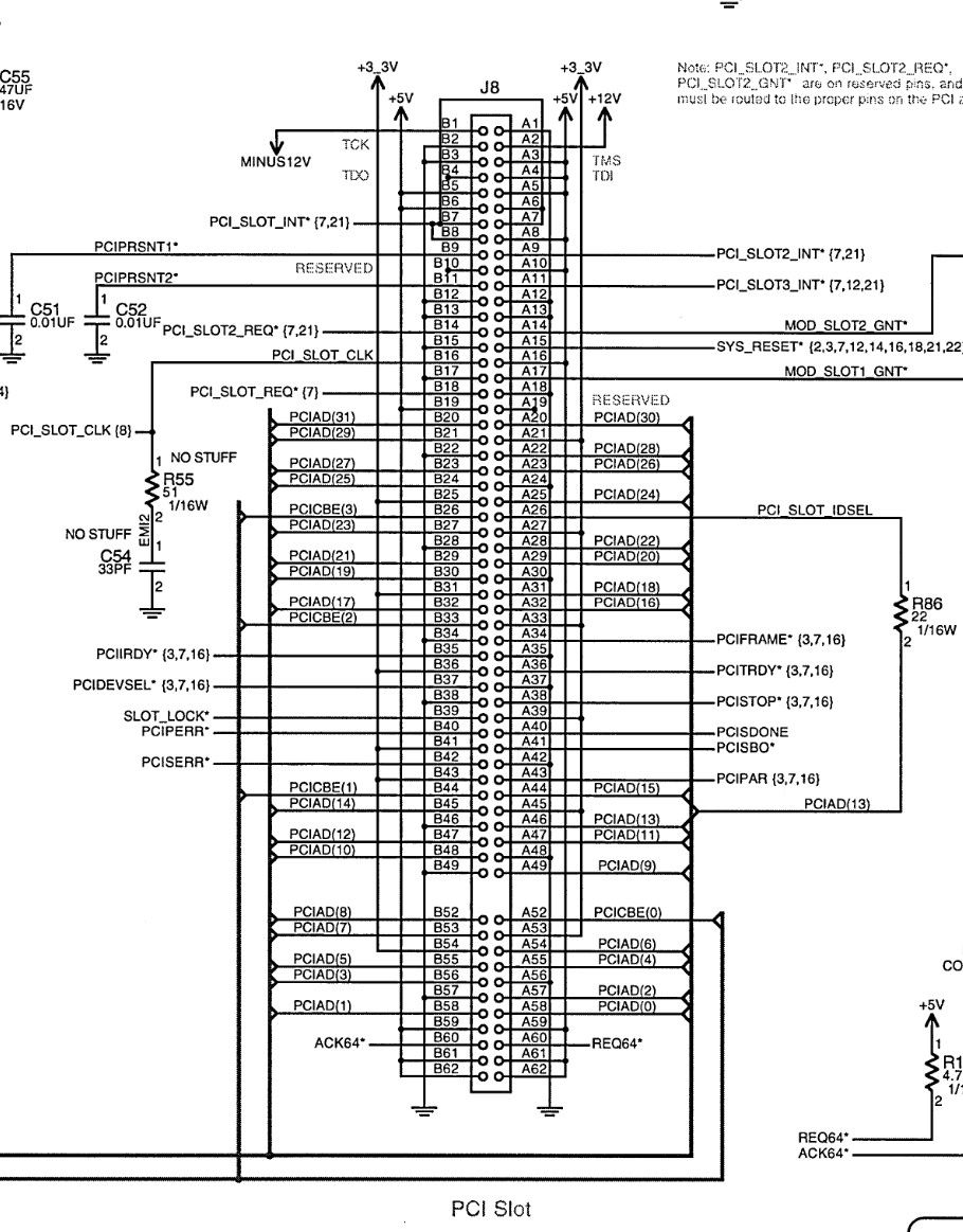

I've got a great start on buzzing the 6x00 riser. Have to recheck my findings, but it looks like nine signals only make it up to Slot A from the motherboard connector. One of which is perplexing, B18 in the PCI Spec is +5V. What gives. my mistake of something AppleFishy?
Closing in just a bit. First step will be setting one of my cable risers up as Slot_B which check board design for my TwinSlot Riser project.

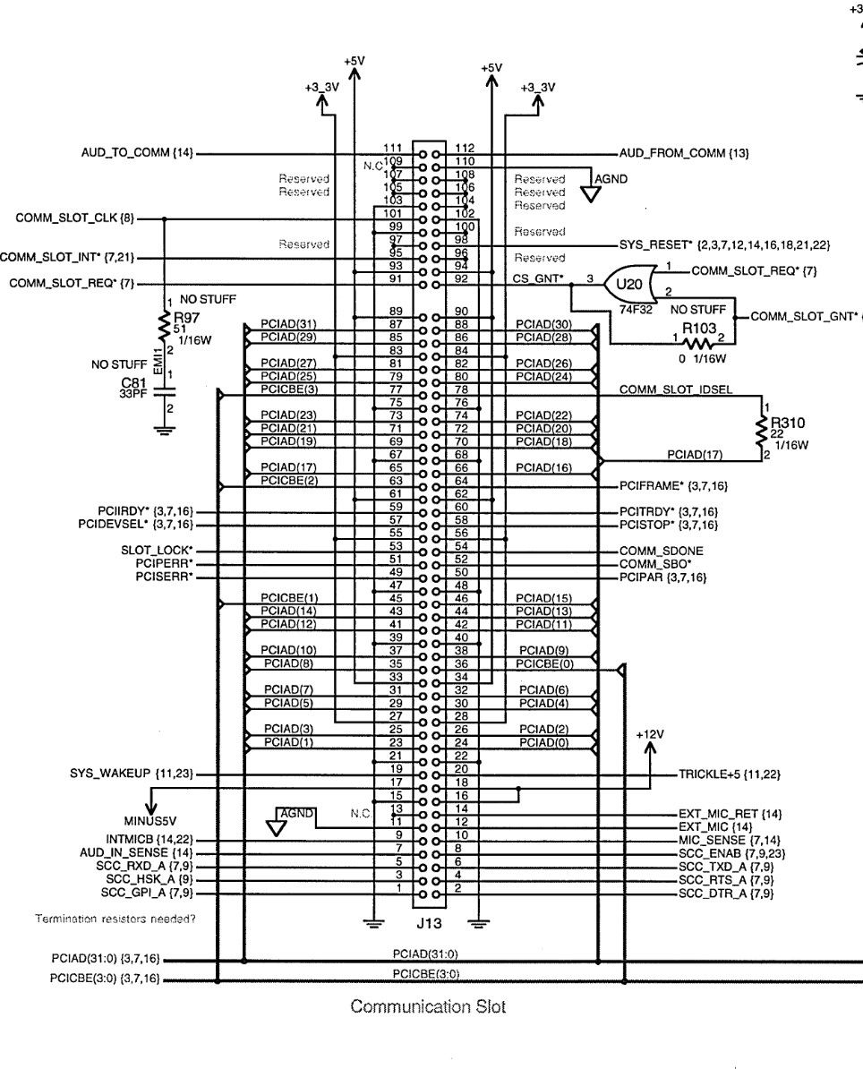

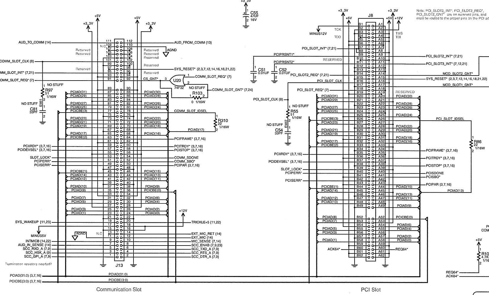

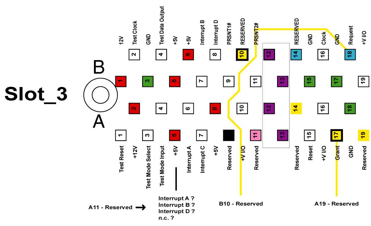

Second step will be playing musical signals with the three remaining Reserved Pins on the Logic Board connector. If that pans out and Slot_C is brought out of the crypt it'll be on to yet another blivet stuffing, a TriSlot Riser for the 6x00 drawer is looking more and more possible the more I stare at it. 🤪
Tonight's Dirty Vodka Martini Powered utter simplification of the DELTA requirements for Slots B & the Mythical Slot C:
