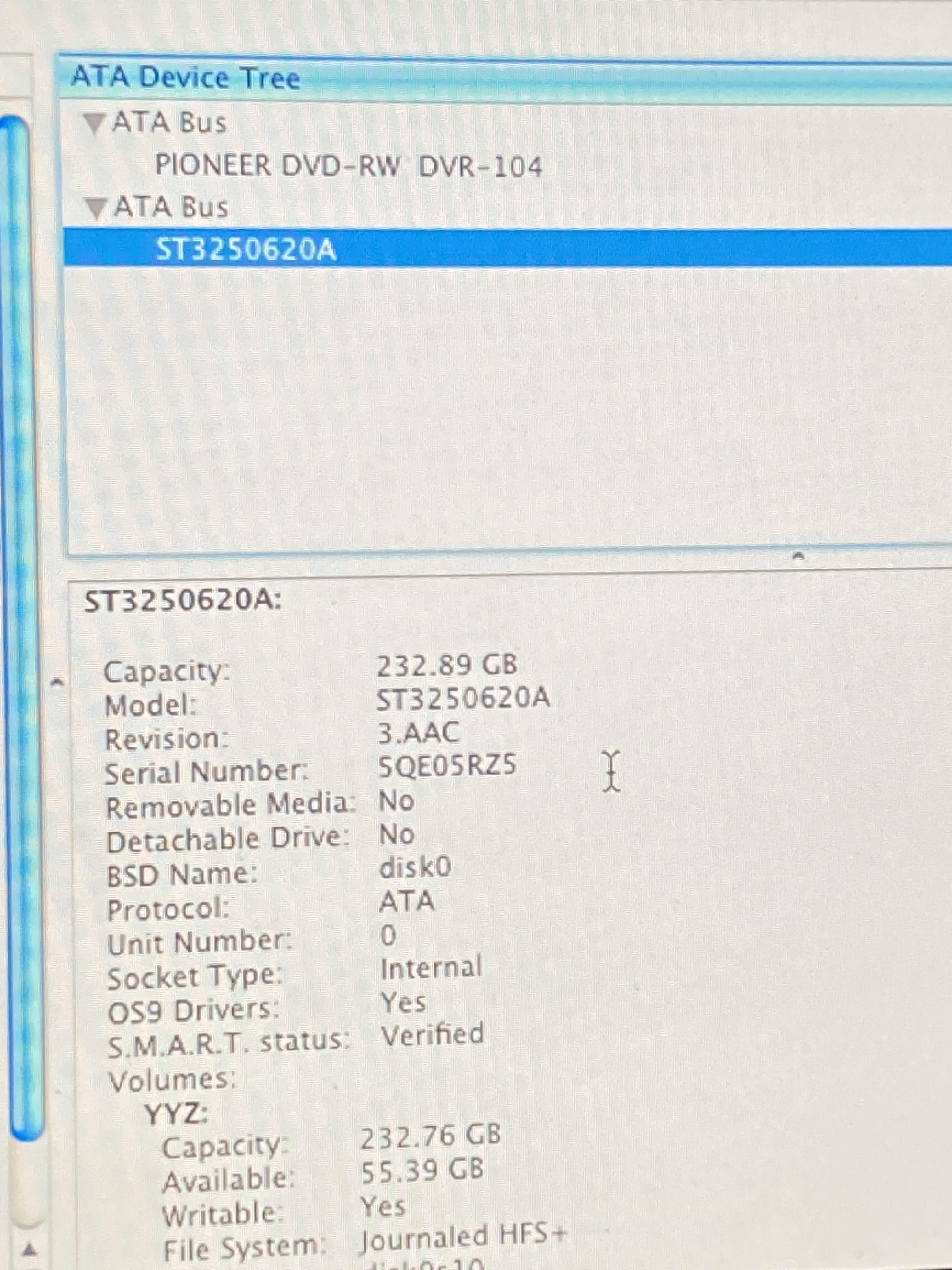

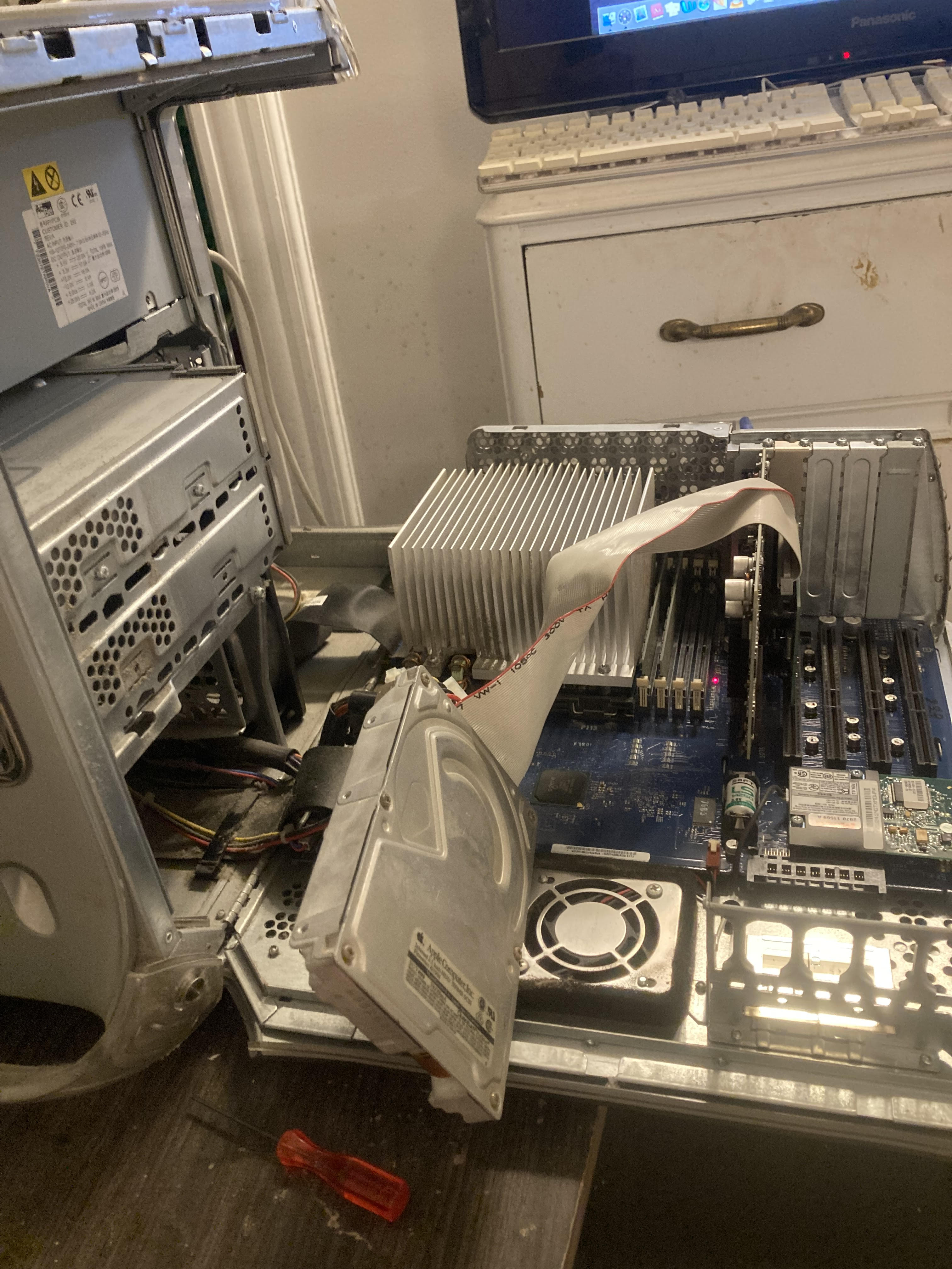

Hey folks! This is the first time I'm trying something like this. This will be a second boot up drive that will just have OS9. Reason? I'm recovering files from hard drives that were in beige Macs, and I want to be able to save them to this SSD and perhaps transfer them onto USB sticks.
I want to have the option of being able to boot up OS9 or boot up the other drive which has OSX (the original drive that came with the mirror door).
As you can see, there's already a SCSI card here. What else will I need? I'm looking at getting a 250-gig SSD.

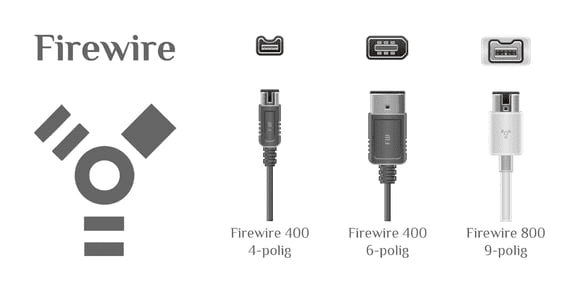

AFAIK, the only MDD that can boot into OS9 natively is the FW400 released just for that very purpose. Which version do you have there? If it's FW800 you're stuck with OS9 running in emulation or Classic(?) or whatever you call is. I call it FAUX9
Reactions: 2112st

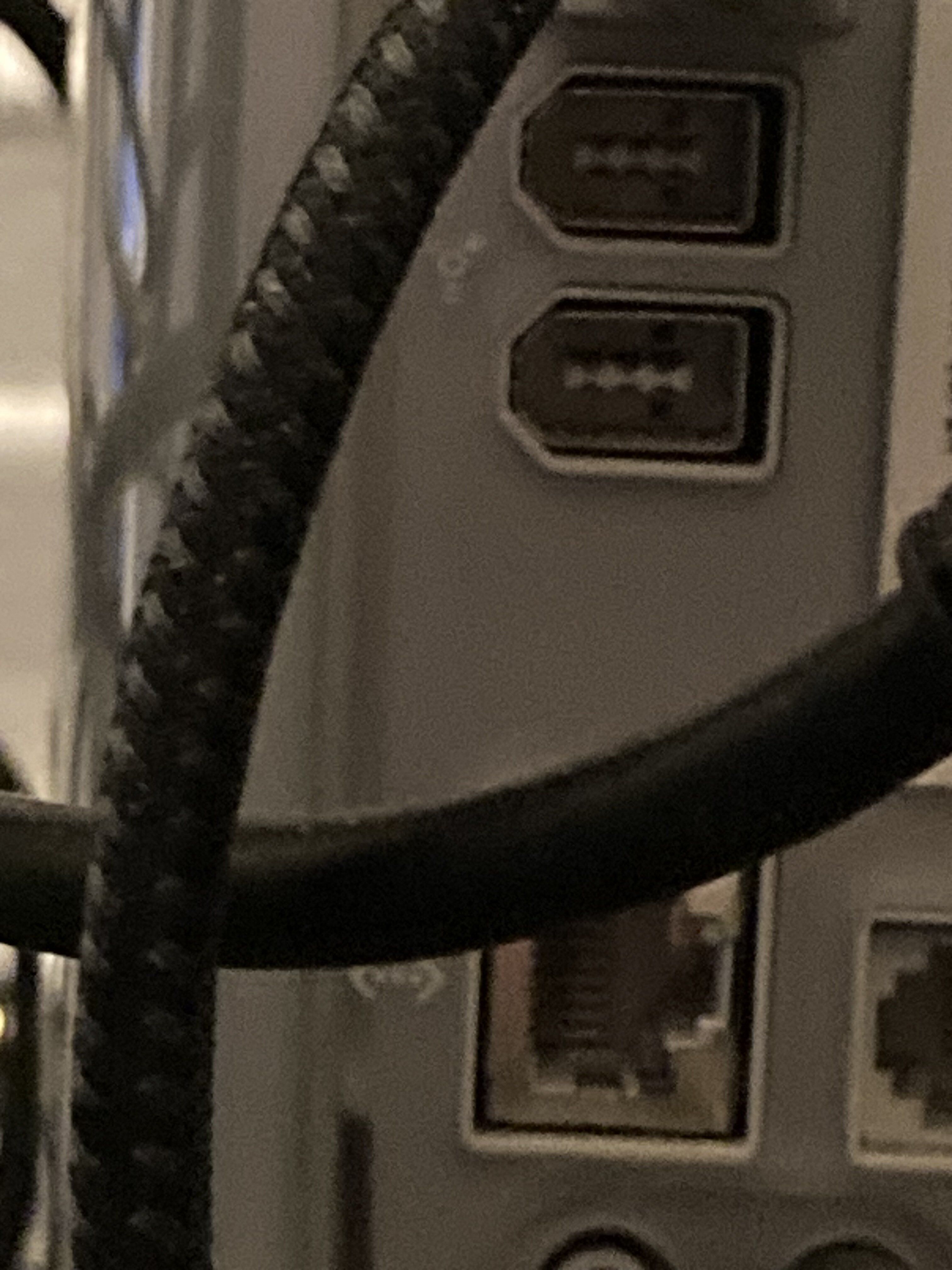

on the back of the mac, The firewire port is either 400 or 800.
If its 400 it can boot OS9
so look on the back. If its the one that is 800, then it prolly won't boot os 9 native.
(i think there is a way to hack it, but I don't know off the top of my head)
Reactions: 2112st
looks like 400 too me.
it should boot OS 9 fine.
I do remember when Apple removed support for booting OS9 . and it was connected to when they updated to FW800.
Reactions: 2112st

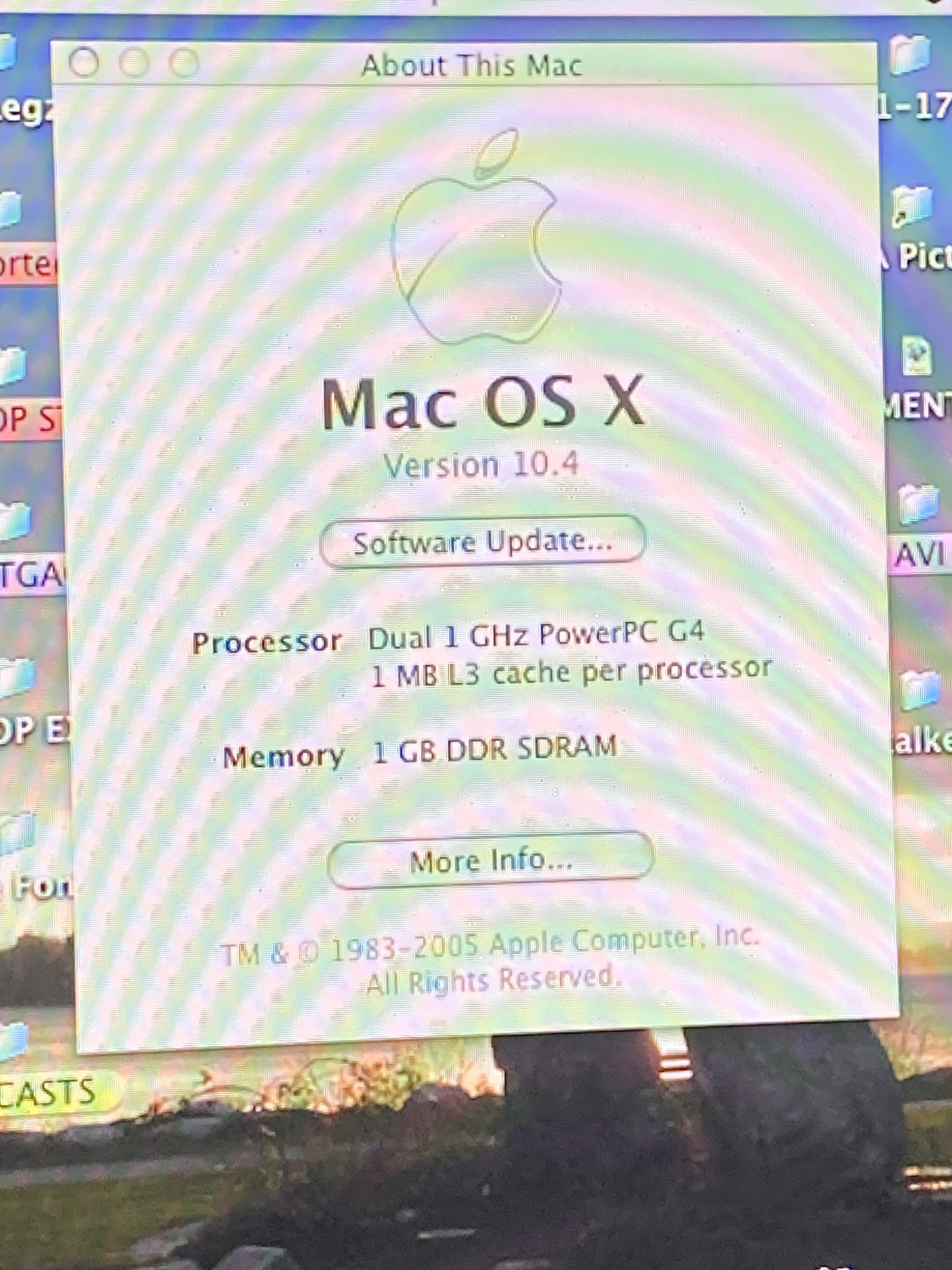

Early MDD machines were FW400. Later versions were FW800, until the single 1.25GHz model came out, using the older board.
Learn something new every day:
Three tier first gen MDD released 8/13/02 were FW400, booting into OS9 or OSX
Three tier second gen MDD released 1/28/03 had FW800 and limitation to running Classic under OSX
Last gen (re-gen?) MDD released 6/23/03 with FW400 and booting directly into OS9 again!
