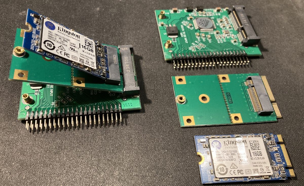

Not too long ago I tried a bunch of options in my Lombard. Ended up using a new Yansen 16GB 2.5-inch PATA/IDE 44-Pin SSD I bought from Amazon.
The somewhat pricey Ableconn mSata to IDE adapter that I use successfully in my 3400, Pismo, iBook G4 and Mac mini G4 does work in a Lombard too. I tested with three mSATA SSDs:
All worked fine. The first two I had on hand but I recently bought the 230S card as it was mentioned somewhere (which I now can't find) as working in mSATA adapters when other mSATA SSDs would not. I was dubious on that, thinking the adapter would mask any subtle differences in mSATA SSDs...
So I decided to try the above three mSATA SSDs in the two other "cheap" mSATA to IDE adapters I have with the Lombard:
These two adapters are very similar (use same JM20330 Serial ATA Bridge Chip) but have some differences in populated passive components that I had thought might change their compatibility.
The 370 and 380M did not work in either, however the 230S worked in both of them! Not sure what to make of that other than the 230S (despite the lower model number) is a newer mSATA SSD, perhaps it better supports ATA modes that the Lombard uses?
In any case the combination of a cheap green board adapter and a 64MB Transcend 230S mSATA SSD is about the same cost as the 16GB Yansen PATA/IDE 44-Pin SSD (~$36) but with 4 times the capacity...

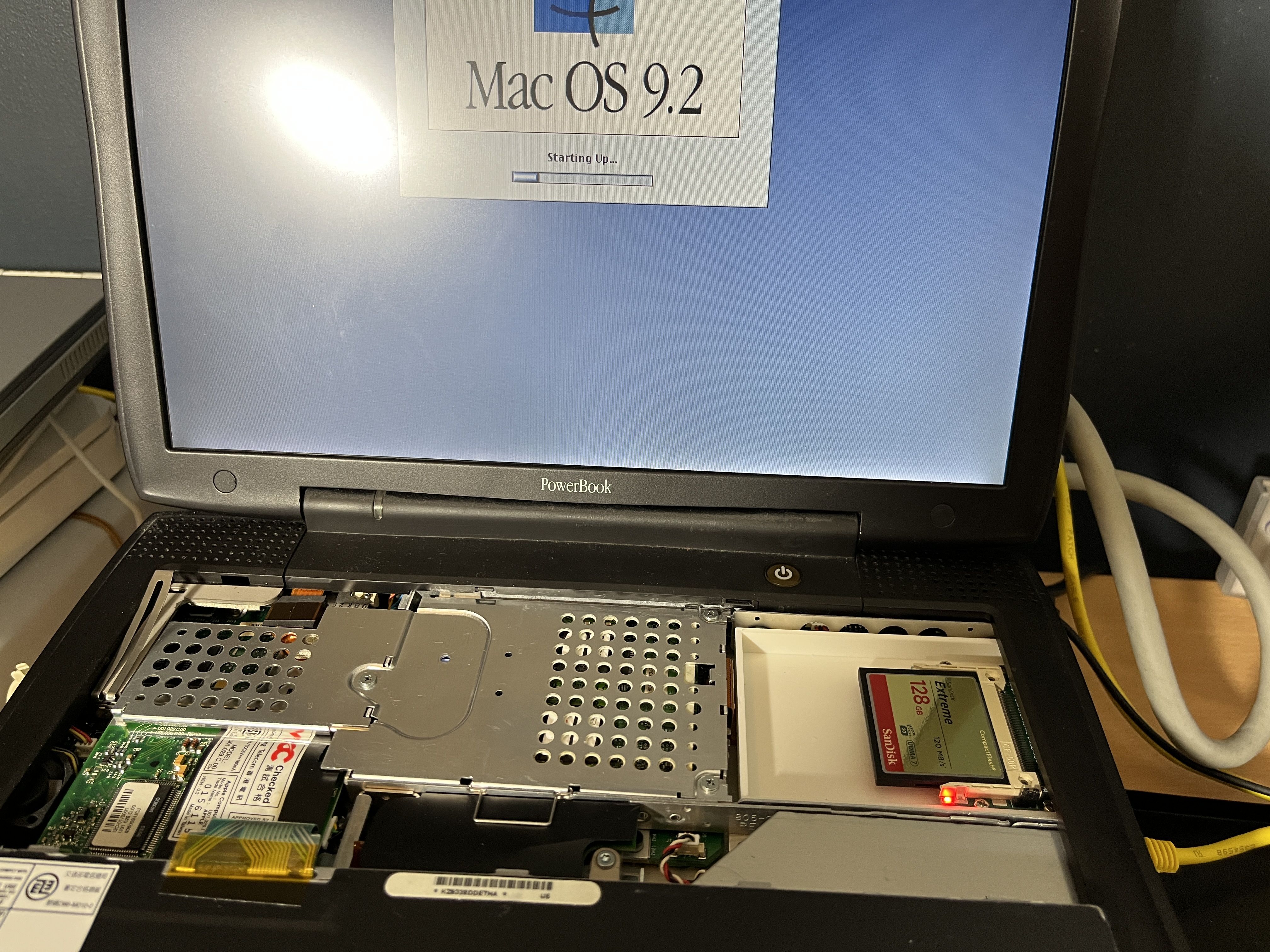

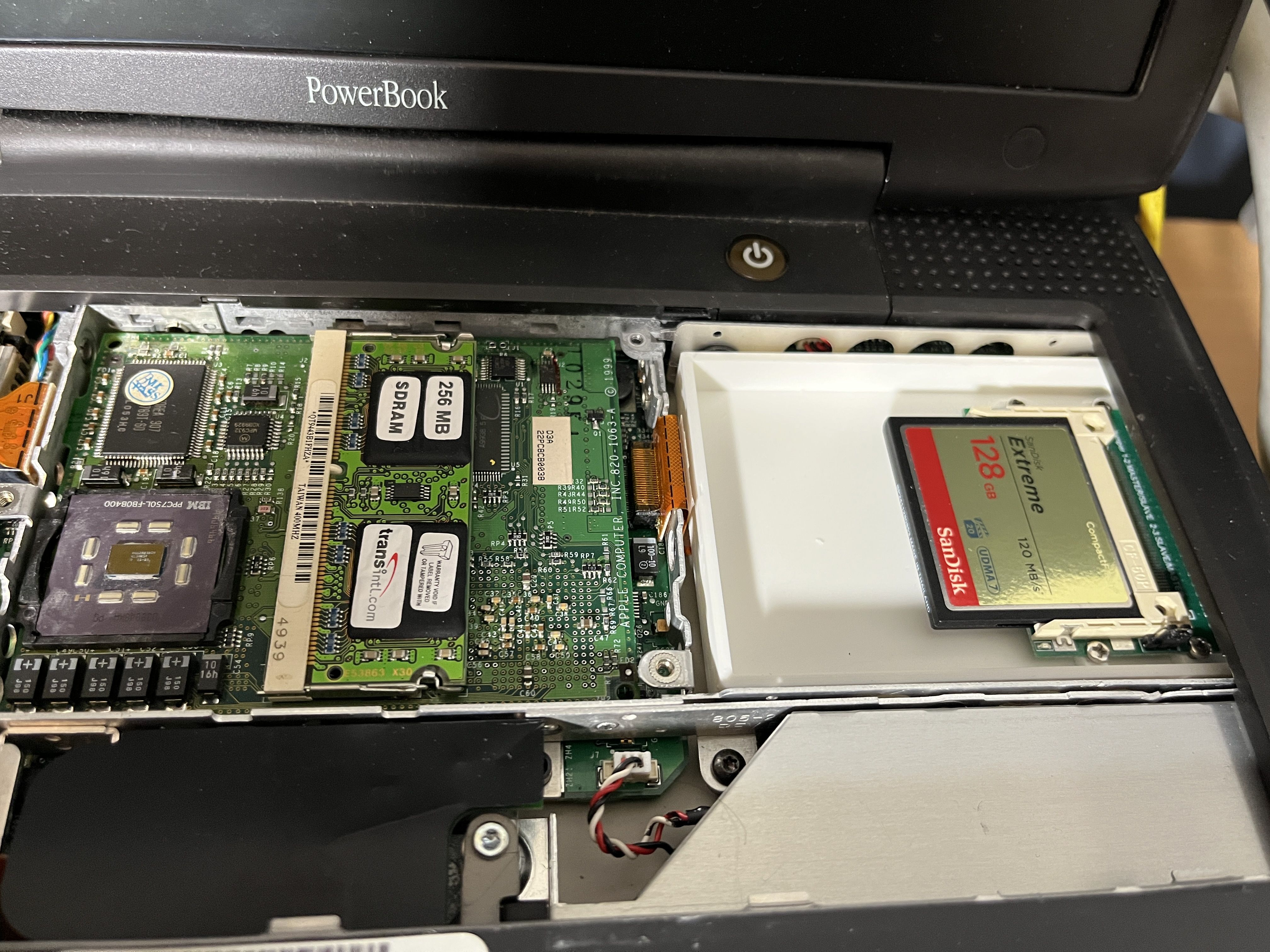

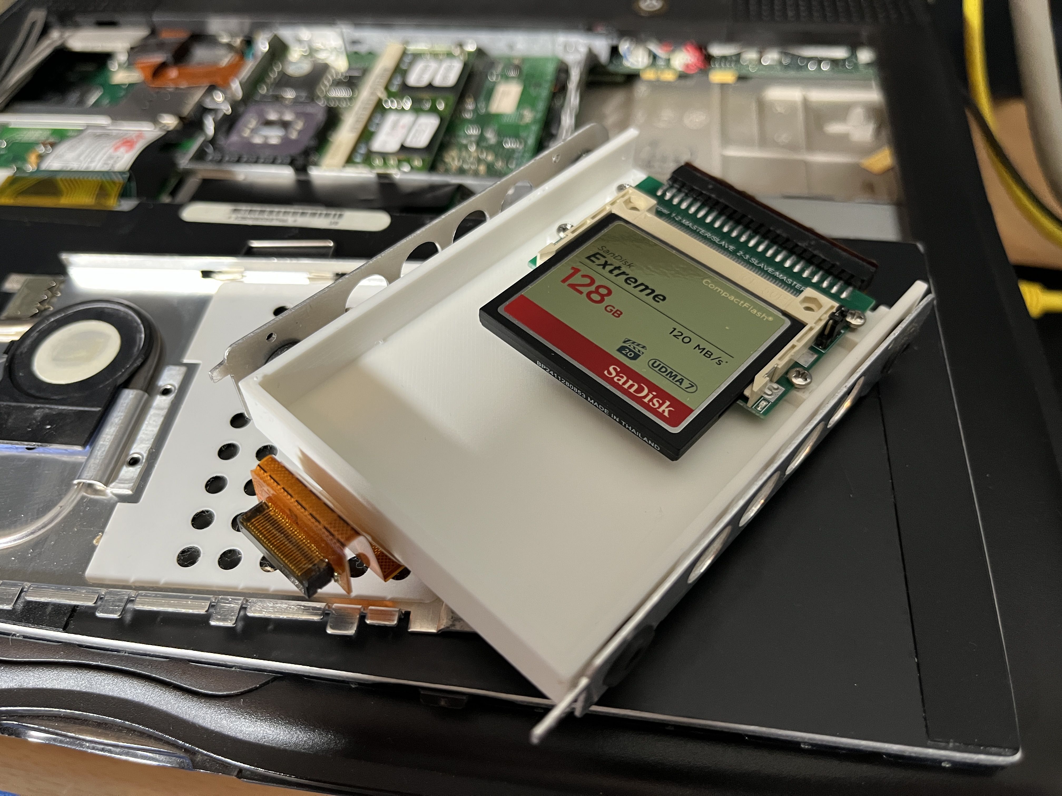

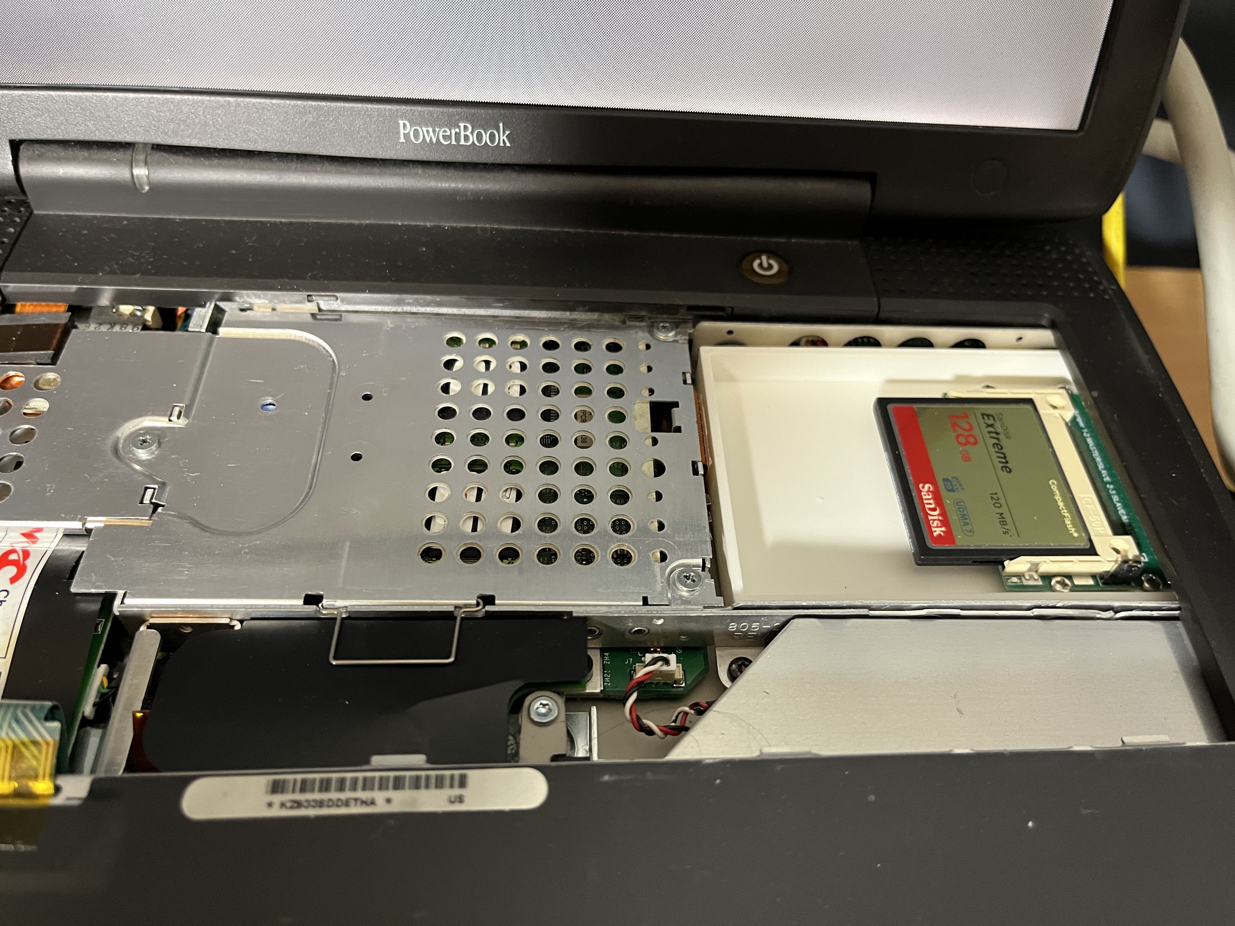

After accidentally ordering and installing a 128 MB CF Card, I corrected my error and today installed the 128 GB CF Card. It copied flawlessly and I was able to boot up and play back an old 12-track music project in Deck II. I also played the first level of Rebel Assault II which I have on CDROM but I have no recollection of ever playing. Later on I'll try to recover more old projects off of an APS DAT Backup I ordered on ebay. Thanks for all your help!

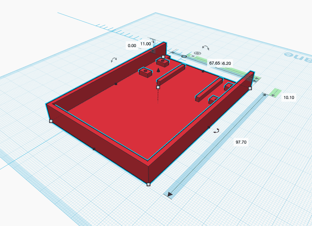

Hi everybody, I have an update regarding the use of a CF Card in my Lombard Powerbook G3. I was unhappy with the way that it was floating free inside the case so I started experimenting with CAD designs and my new 3D printer. I managed to mount the board into my printed bracket but I'm not satisfied with the screws I used. The screw heads are too big for the layout of the cf card adapter so I'd like to redesign it a bit and order some more appropriate screws. Anyway, I just wanted to share some progress.
