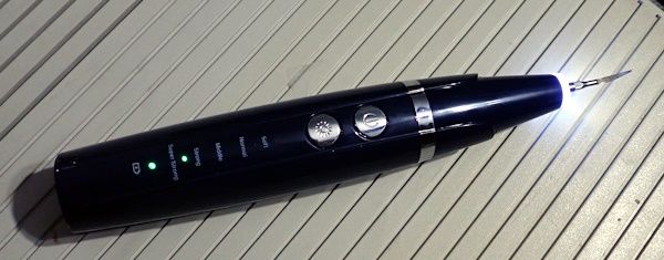

Then an idea came to me: why not use the same tool that dentists use on plaque and tartar? Amazon sells a plaque remover (dental scaler) tool for $25.
It is battery powered. It has a little metal tip that vibrates silently and imperceptively at 40 kHz. If you press it against your finger, nothing happens. If you press it against something solid but brittle, it makes a horrible screeching noise and the brittle object pops off or explodes in a puff of smoke. Think of it like a tiny fast hammer. Flexible material just bounces around. Malleable material like copper gets slightly worked. But, this hard corrosion cracks and crumbles.

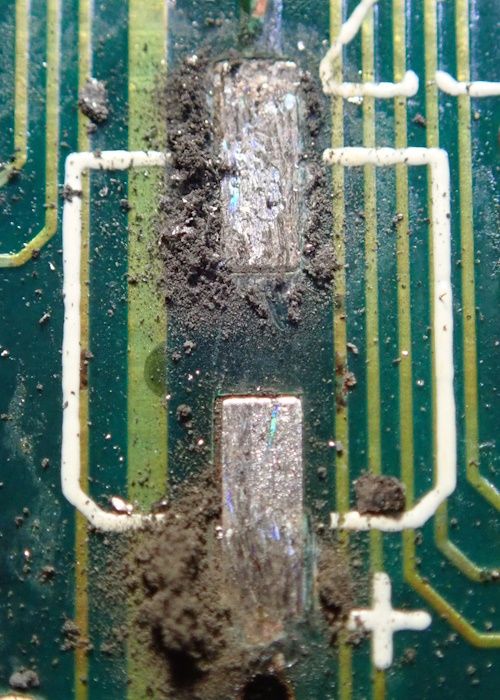

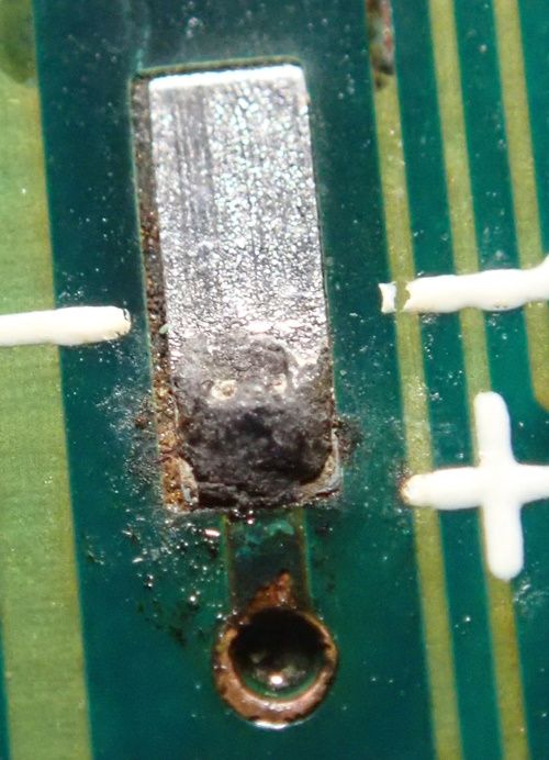

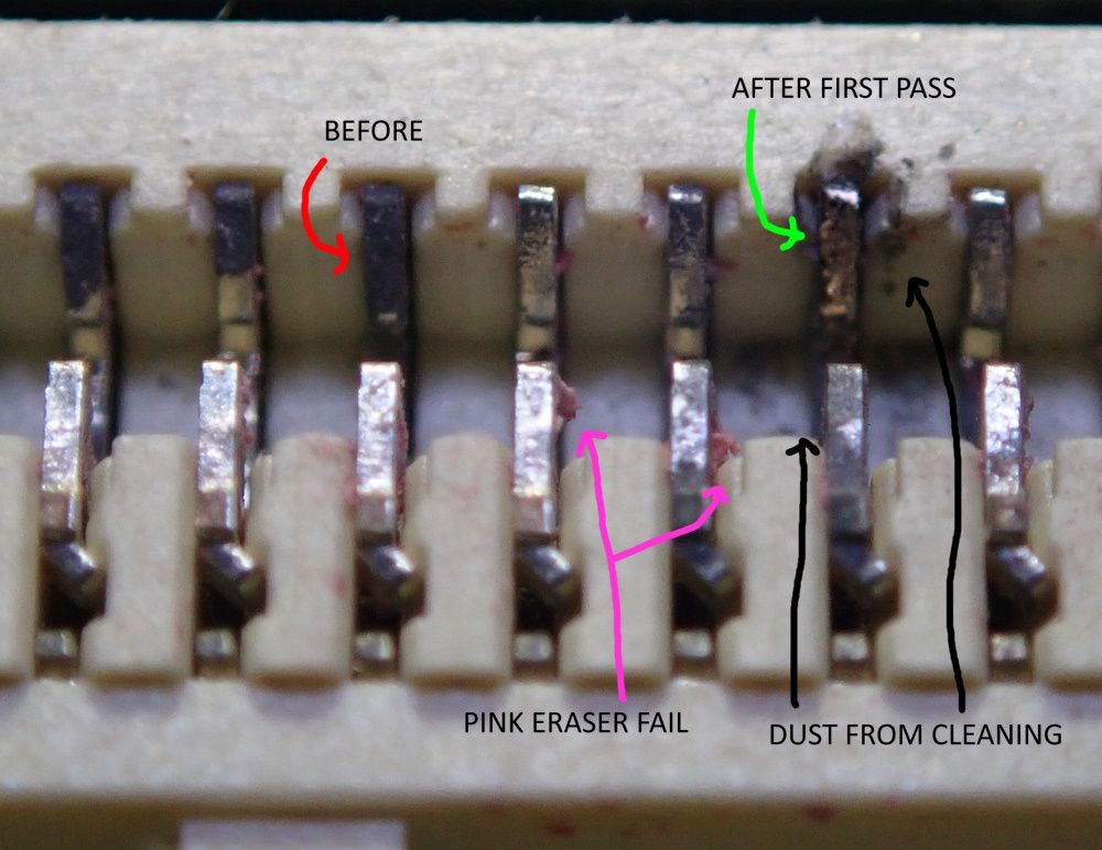

Below is an image of the teeth in the RAM socket. The black areas are non-conductive and prevent the computer from functioning. I tried cleaning them with a pink rubber eraser, which only made things worse with pieces of eraser getting stuck in gaps. But, look at the one tooth that I used the plaque remover tool on! While not yet perfect, notice all the black dust that has come off. This took just a couple of seconds.
I cleaned all of the bad teeth with the plaque scaler under a microscope. I then cleaned away the dust with a compressed cleaning solution (MG Chemicals Super Wash). Then I wiped them all with isopropyl alcohol and a sponge cleaning swab. I repeated this process. During the second pass, I noticed I was getting a mirror finish on most of the teeth. Hurray!
And guess what? It worked! The IIfx is fully operational and passes Mac Test Pro RAM tests. (I used new memory -- not the crusty sticks shown earlier).

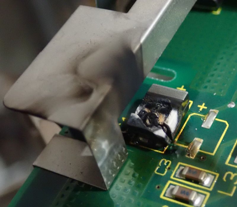

Capacitor C1 exploded and caught on fire on the first power up. This is a well known flaw, as Apple installed 16V capacitors where they should have used 25V derating. Wife asks "What's going on in there?"

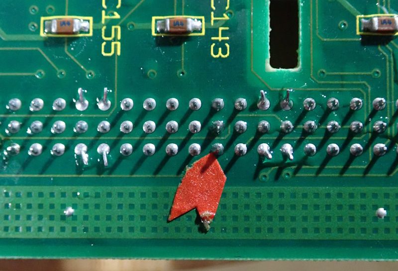

An unusual arrow sticker and possible resolder work on a couple of pins on the left-most NuBus slot. Given how difficult the board was to remove (the plastic clips had very crisp tips -- unworn), I suspect this was a factory repair.

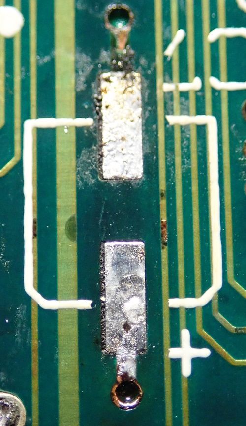

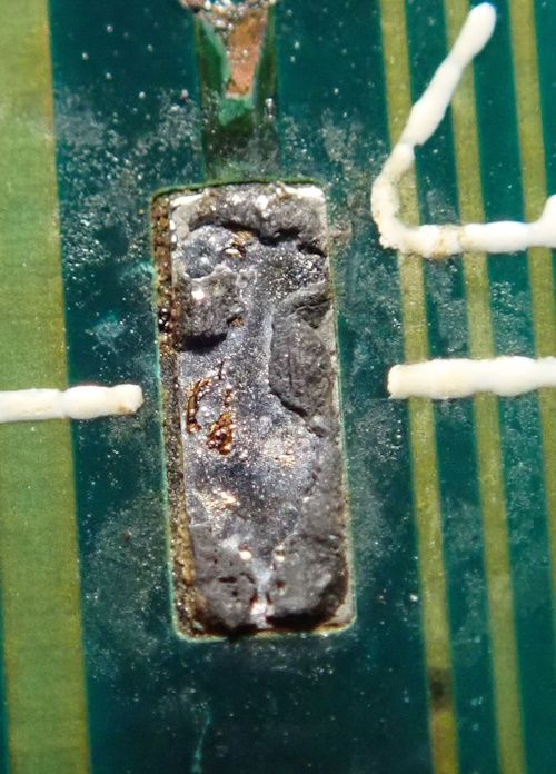

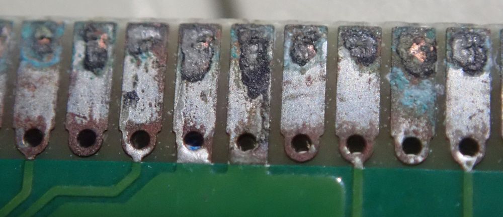

Another good use for the scaler is to remove the crusty buildup on the ends of leaky capacitor pads. This stuff does not come off easily with isopropyl or heat. I end up scatching it off with my soldering iron -- decreasing the life of the iron tip.
Here is an example on an SE/30 pad:
After using the scaler for about a minute... (I should have worked the lower portion of the positive pad a little more)
After wiping with isopropyl, braided copper desoldering wick, again with isopropyl, and retinning with the soldering iron.
