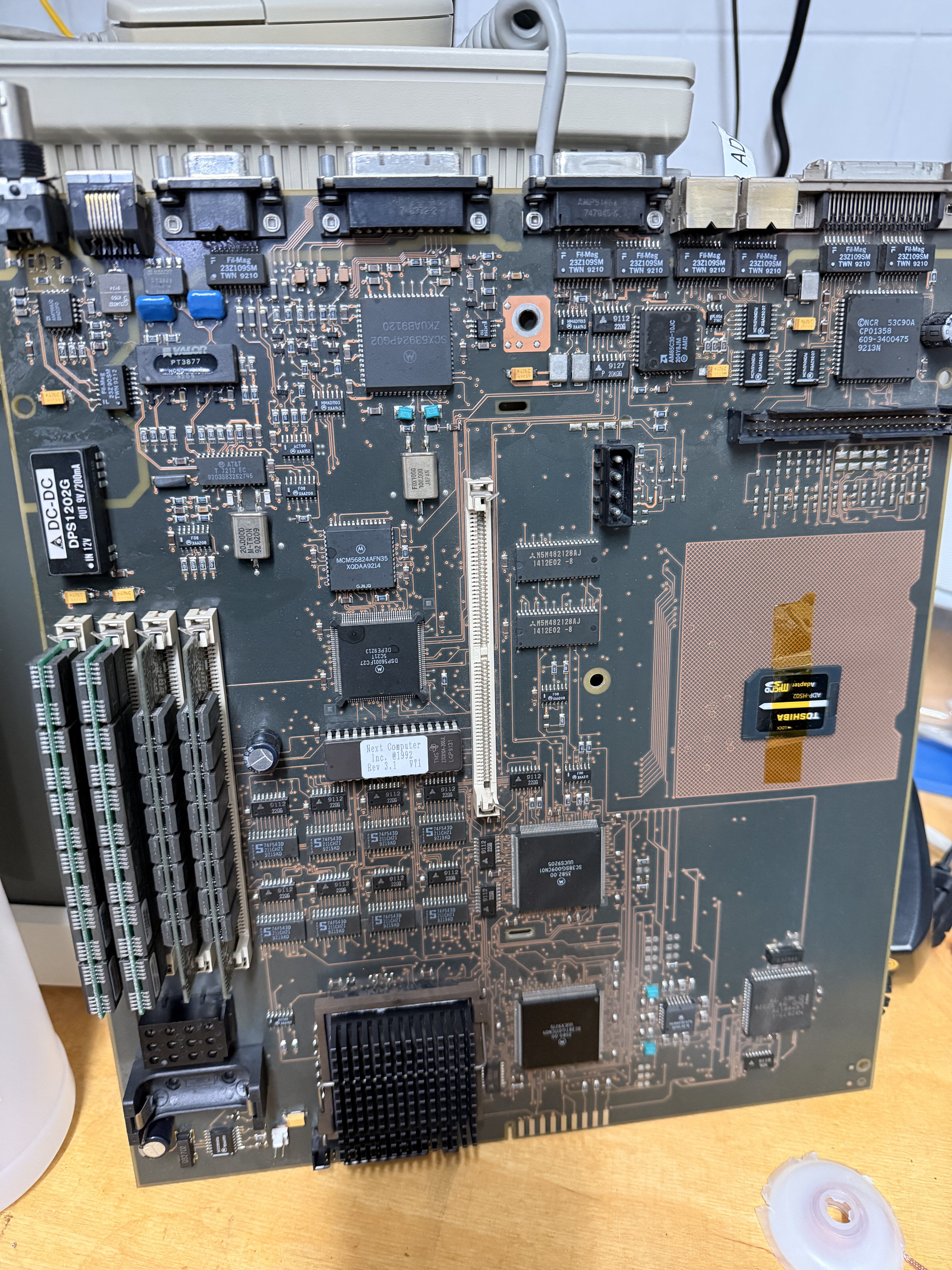

Main Logic Board​
QuantityTypeCapcitance (uF)Voltage RatingSizeLead Spacing (est.)
6SMD4716CN/A
4Through Hole2202510x125

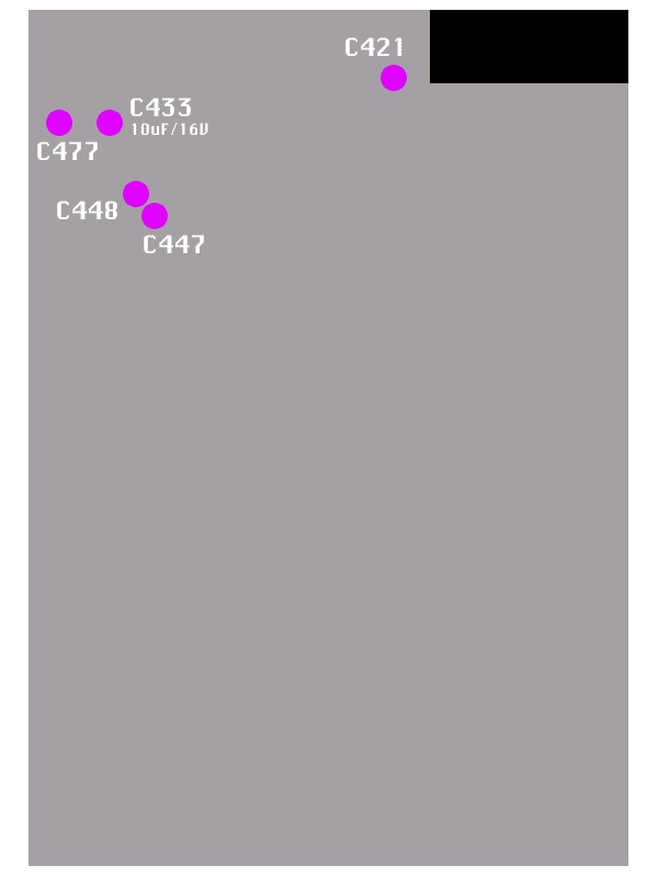

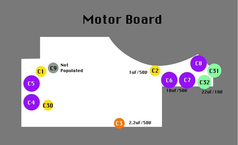

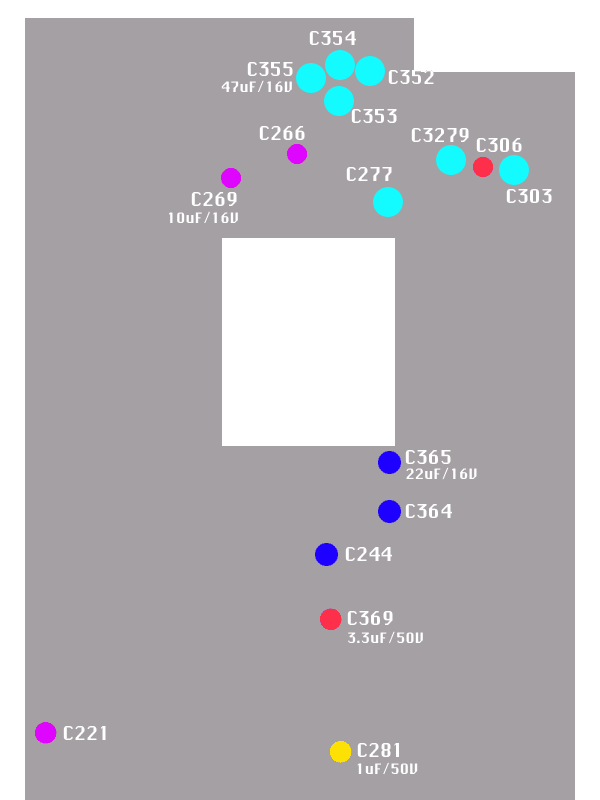

MO Drive Capacitor Maps​

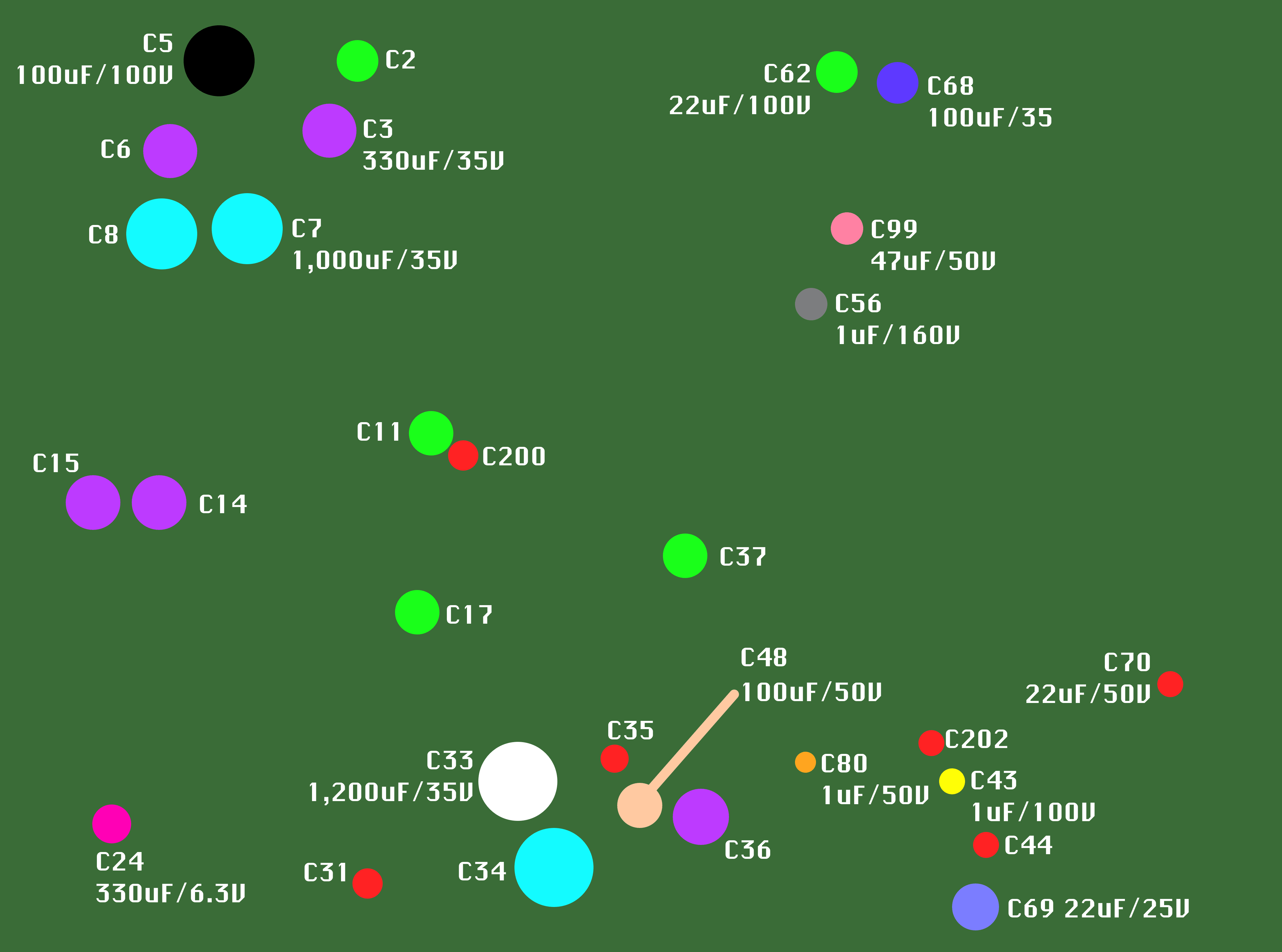

MegaPixel Display Analog Board N4000 (Revision: 1-623-855-12)​
Note: adapted from asterontech.com and not yet verified on my display.
QuantityLocation(s)TypeCapacitanceVoltage RatingSize (mm D xH)Lead Spacing (est.)
1C33Through Hole1,2003512.5x315
2C43, C80Through Hole11005x112
1C56Through Hole11606.3x112.5
1C68Through Hole100358x113.5
1C5Through Hole10010010x205
1C48Through Hole100508x113.5
3C7, C8, C34Through Hole1,0003512.5x255
1C24Through Hole3306.36.3x112.5
5C3, C6, C14, C15, C36Through Hole3303512.5x155
5C2, C11, C17, C37, C62Through Hole221006.3x112.5
6C31, C35, C44, C70, C200, C202Through Hole22505x112
1C99Through Hole47506.3x112.5
1C69Through Hole (Bi-Polar)22256.3x112.5

Added capacitor maps for the MO drive. Lots of tiny through holes. Be cautious with the 1uF / 50V caps. I was only able to find them in 9mm height where the originals are 6mm. In some cases they can be installed normally. In the board sandwich you may need to tilt it over a bit to make room.
Many of the little ones had spilled their guts and corroded surrounding pins. The majority of time spent recapping this thing was spent cleaning up all of the crud. Fortunately there didn't seem to be any major damage.

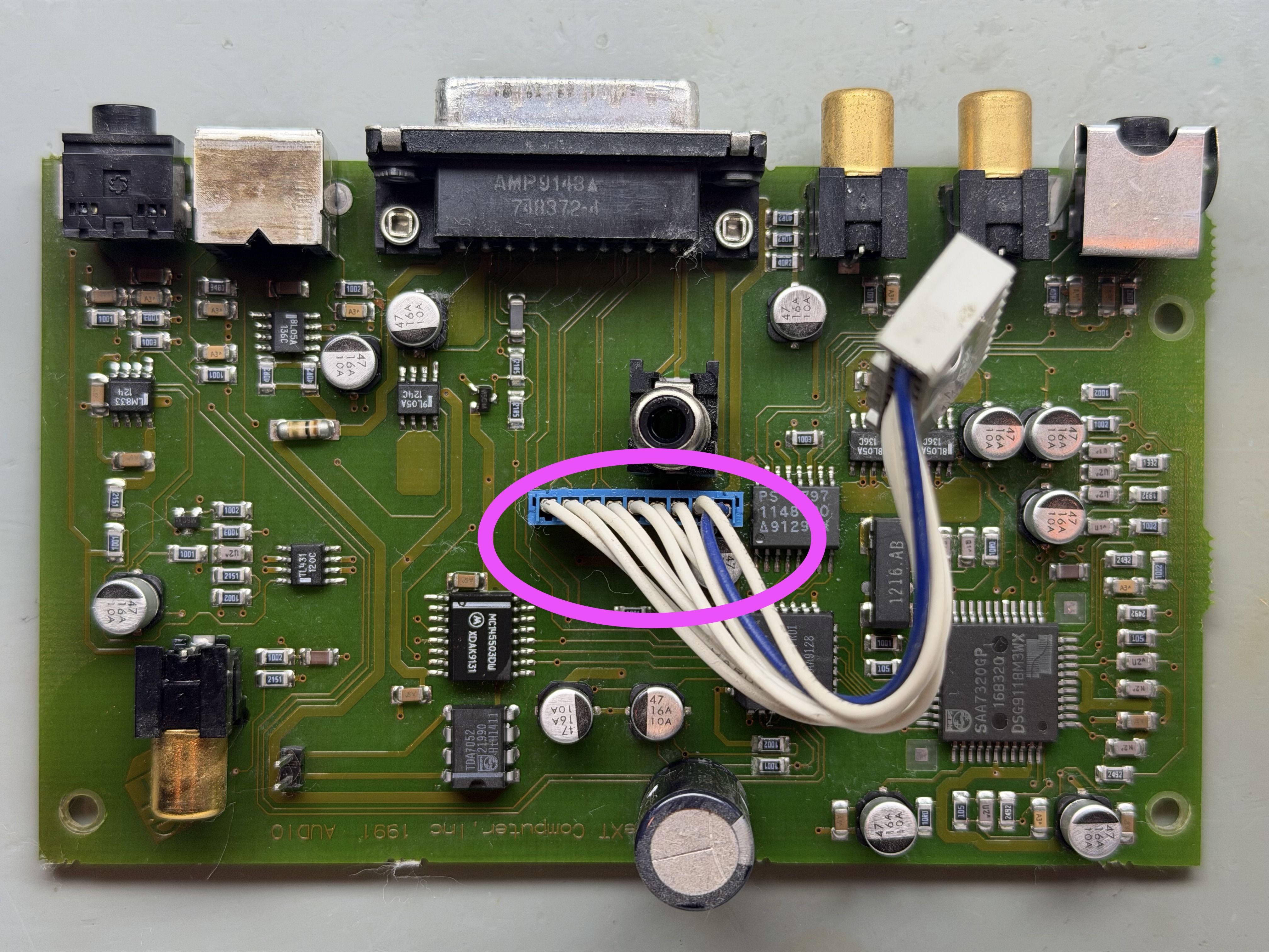

I added a cap map for the N4000A analog board and made a correction in the list: C202 was mislabeled as C1. The sound board is very straightforward so no cap map needed. But there is a connector very close to one of the 47uF/16V SMD caps. I removed that before replacing the cap to avoid melting the connector. See photo below.

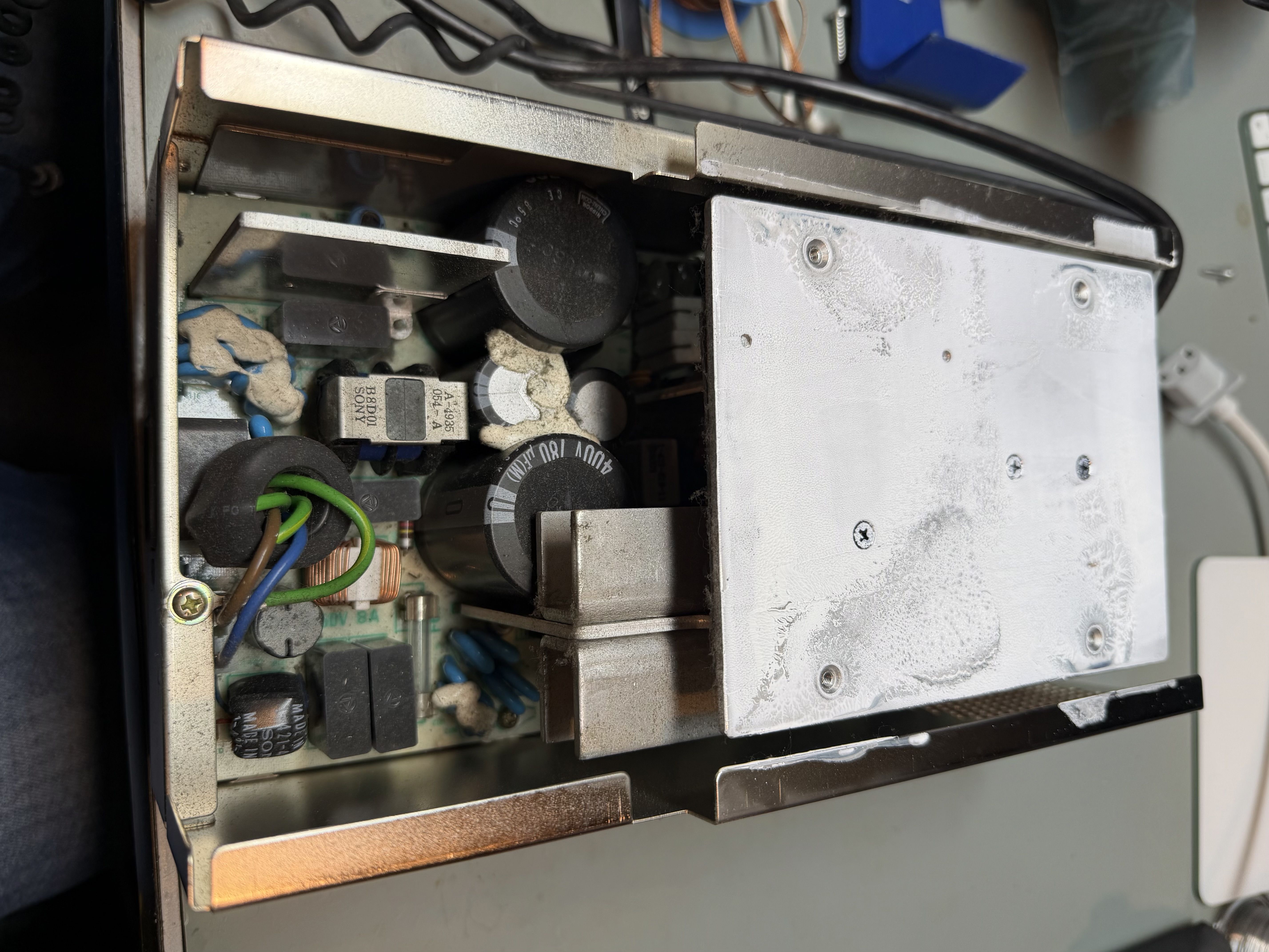

A tip/warning for anyone servicing the power supply. There is a LOT of thermal grease on the heat sink. I ended up buying an 8oz tub of 120-8 Thermal Joint Compound which seems to be exactly what was used in the factory. I recommend cleaning the old stuff off before proceeding with recapping or you'll get everything, including yourself, very messy.

Remove this connector before trying to replace the nearby cap on the MegaPixel sound board.
There's thermal grease on both the top and bottom side of this heat sink plate on the power supply.
