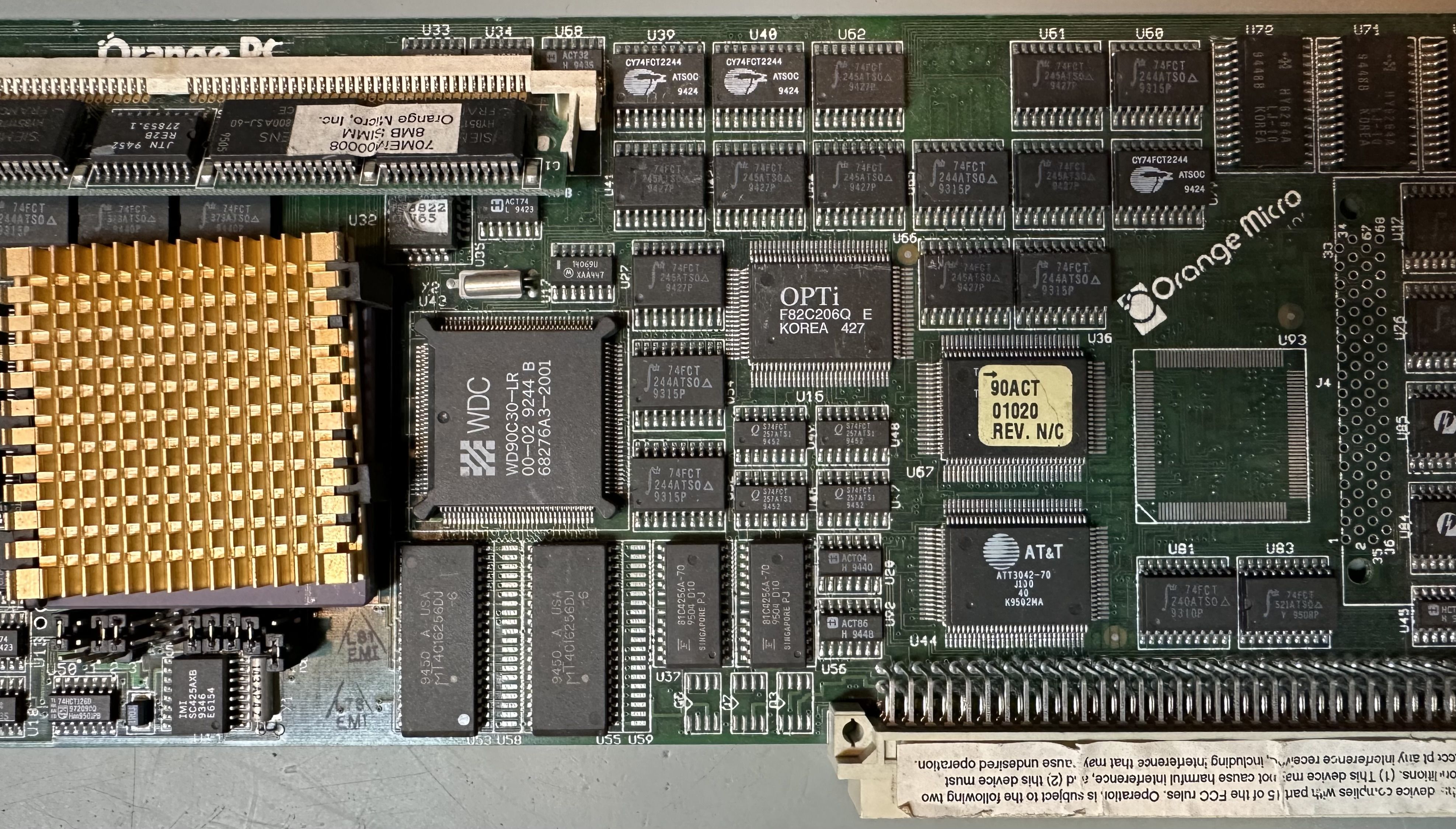

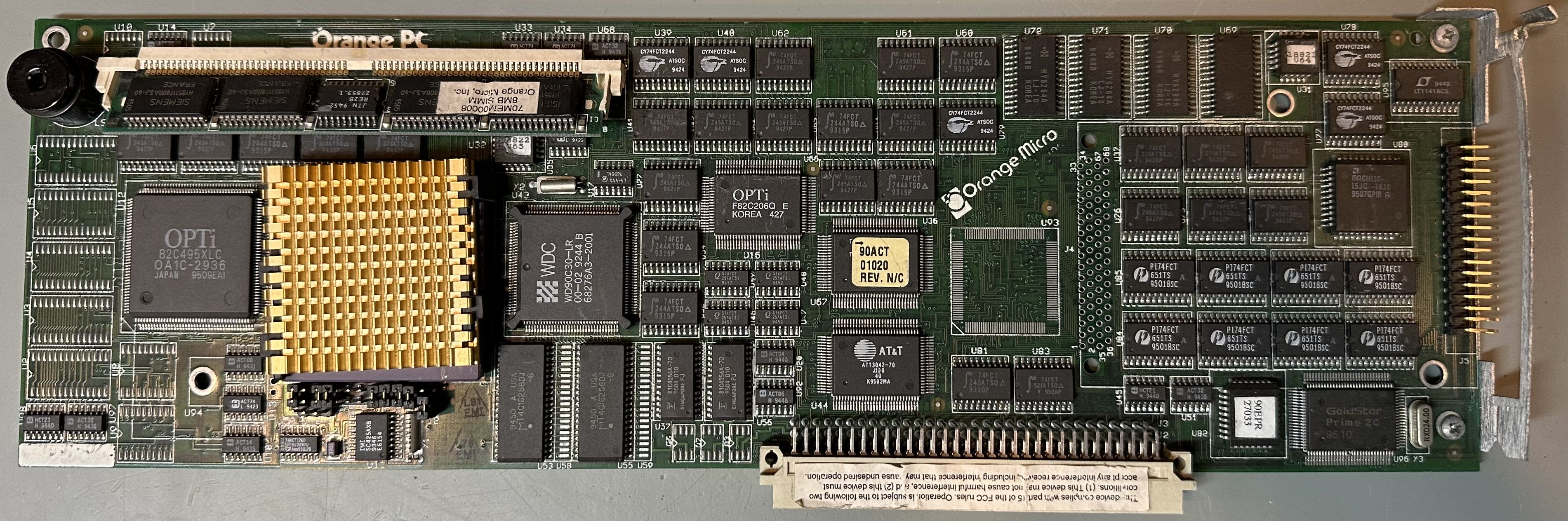

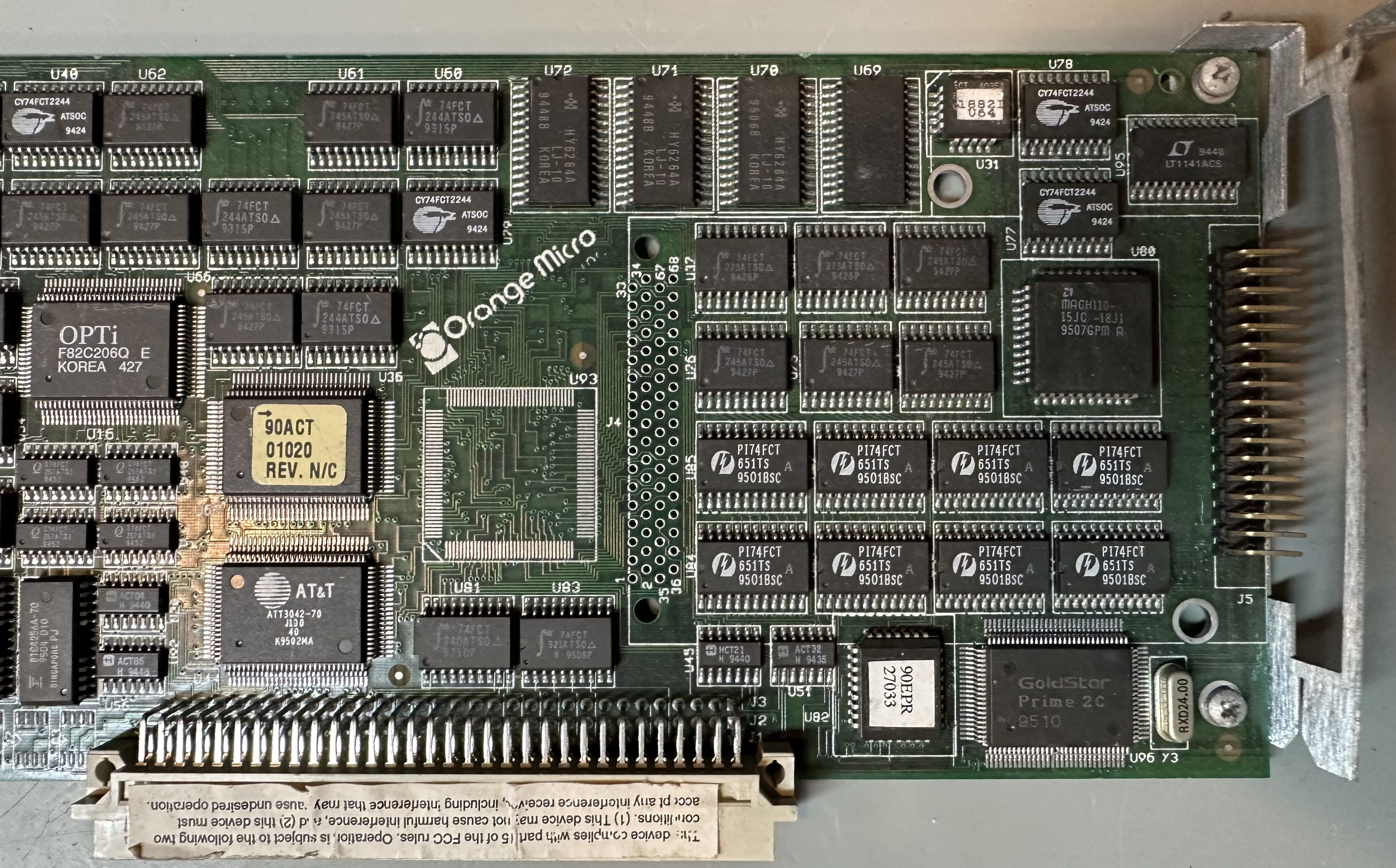

There's not a lot of info on this card online, so here are some things I've learned about it that will hopefully be helpful to others.
The OrangePC 290 is essentially a PC on a Nubus card, complete with a processor, memory, header for IO and a PCMCIA card cage on some configs for expansion. Unlike slow software emulation, this card provided a full speed PC that could run full screen or in a windowed mode on your Mac and could run in parallel to other apps on the Mac.
Config​
486DX2 66MHz
8MB RAM SIMM
No PCMCIA card cage or IC installed

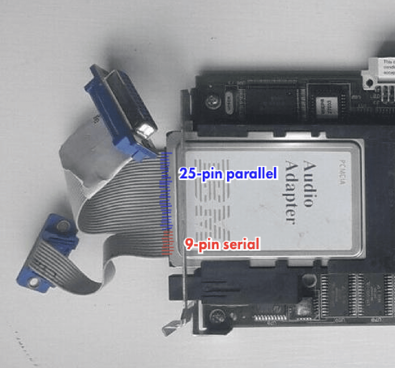

A 34-pin header breaks out into 25-pin (parallel) and 9-pin (serial) ports

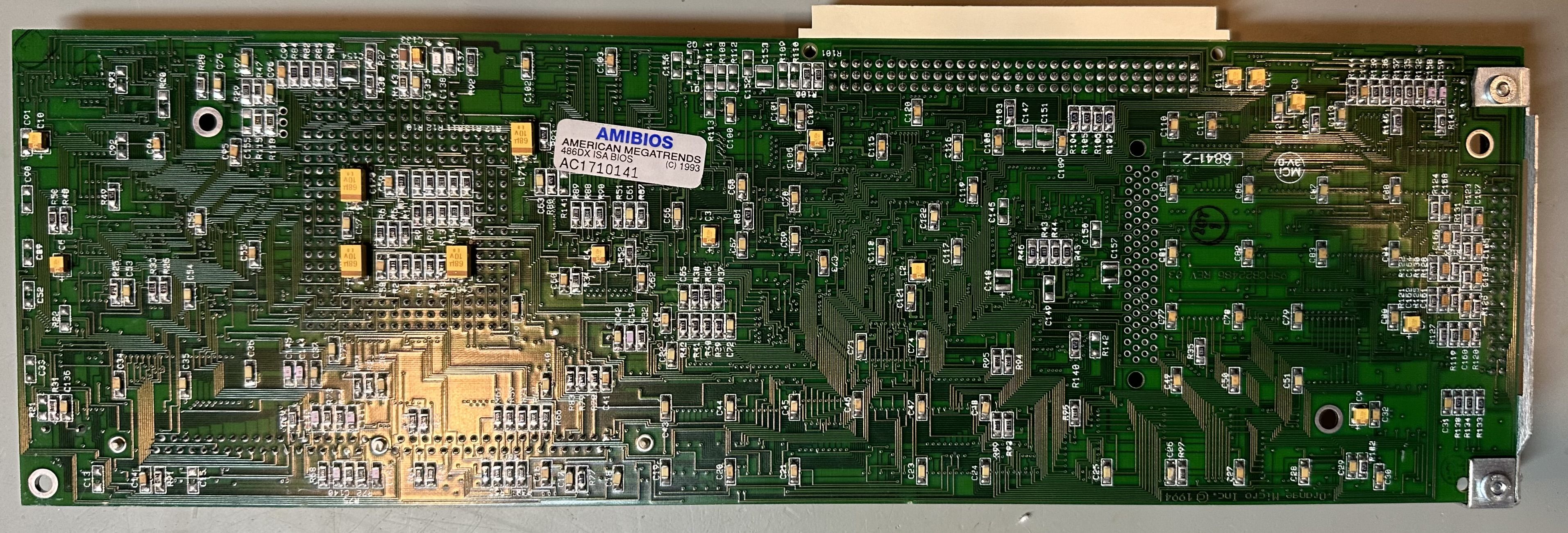

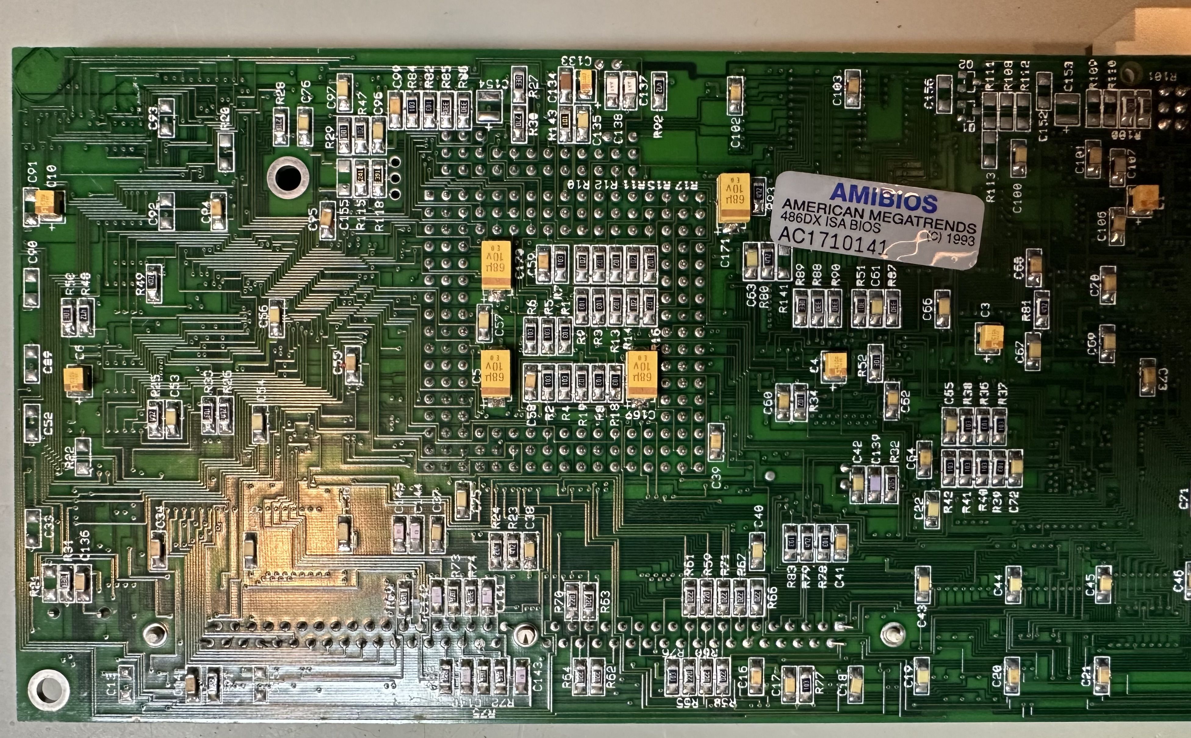

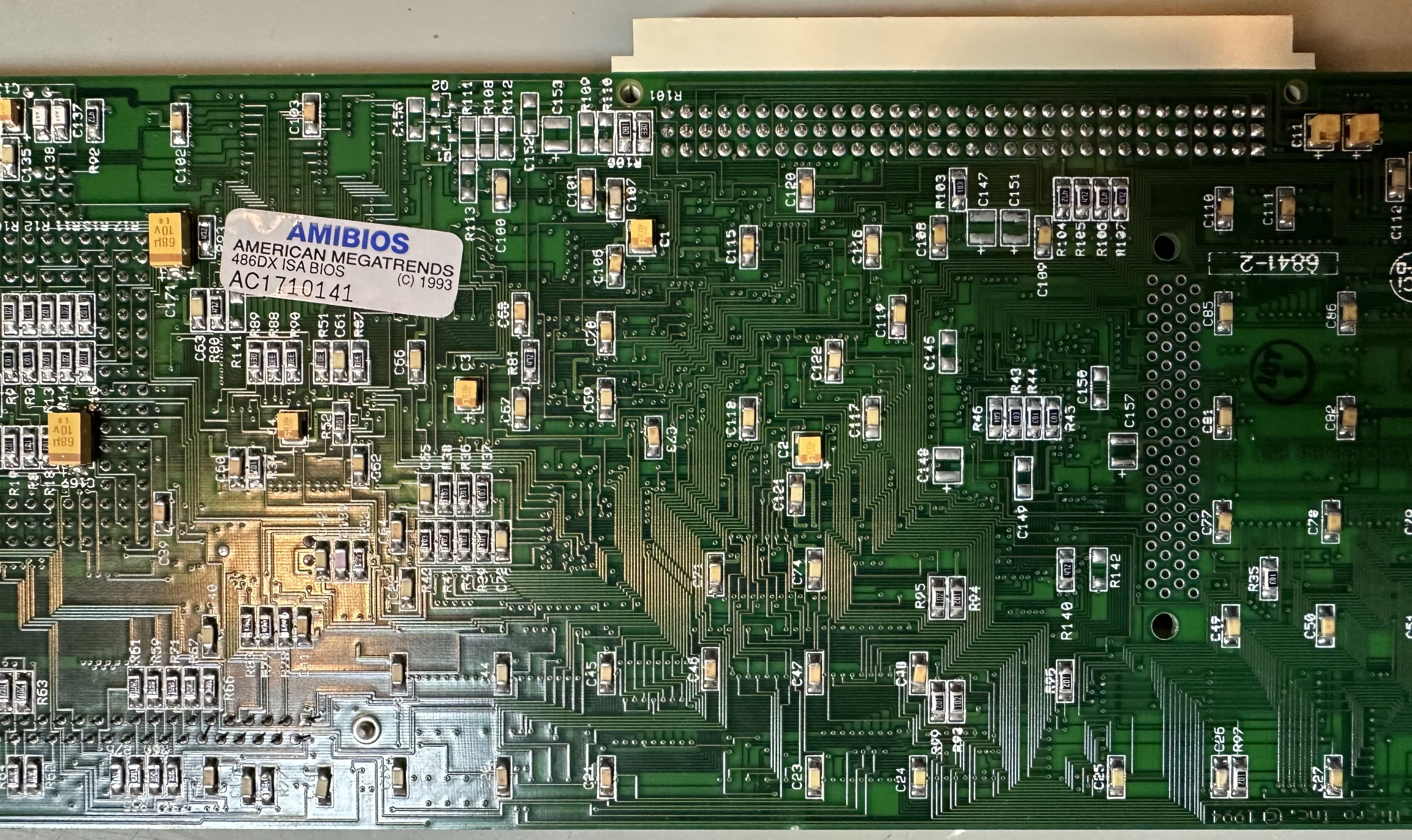

The BIOS is dated 1993. The PCB is dated 1994.
Price when new was about $2,000. Ironically there is one of these posted at this time on eBay for about the same price, even though is has a huge gash and is missing birdseed components on its backside.

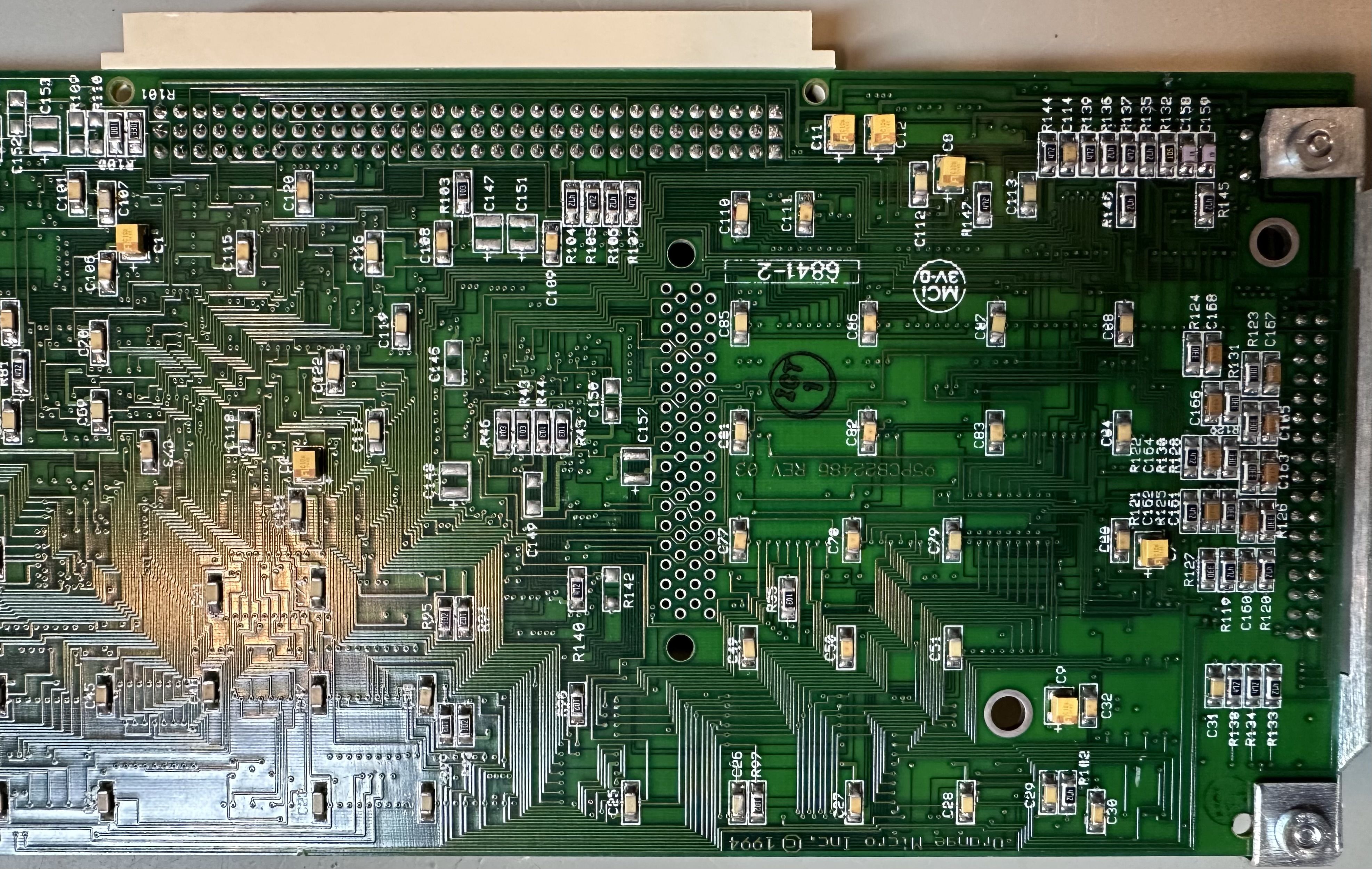

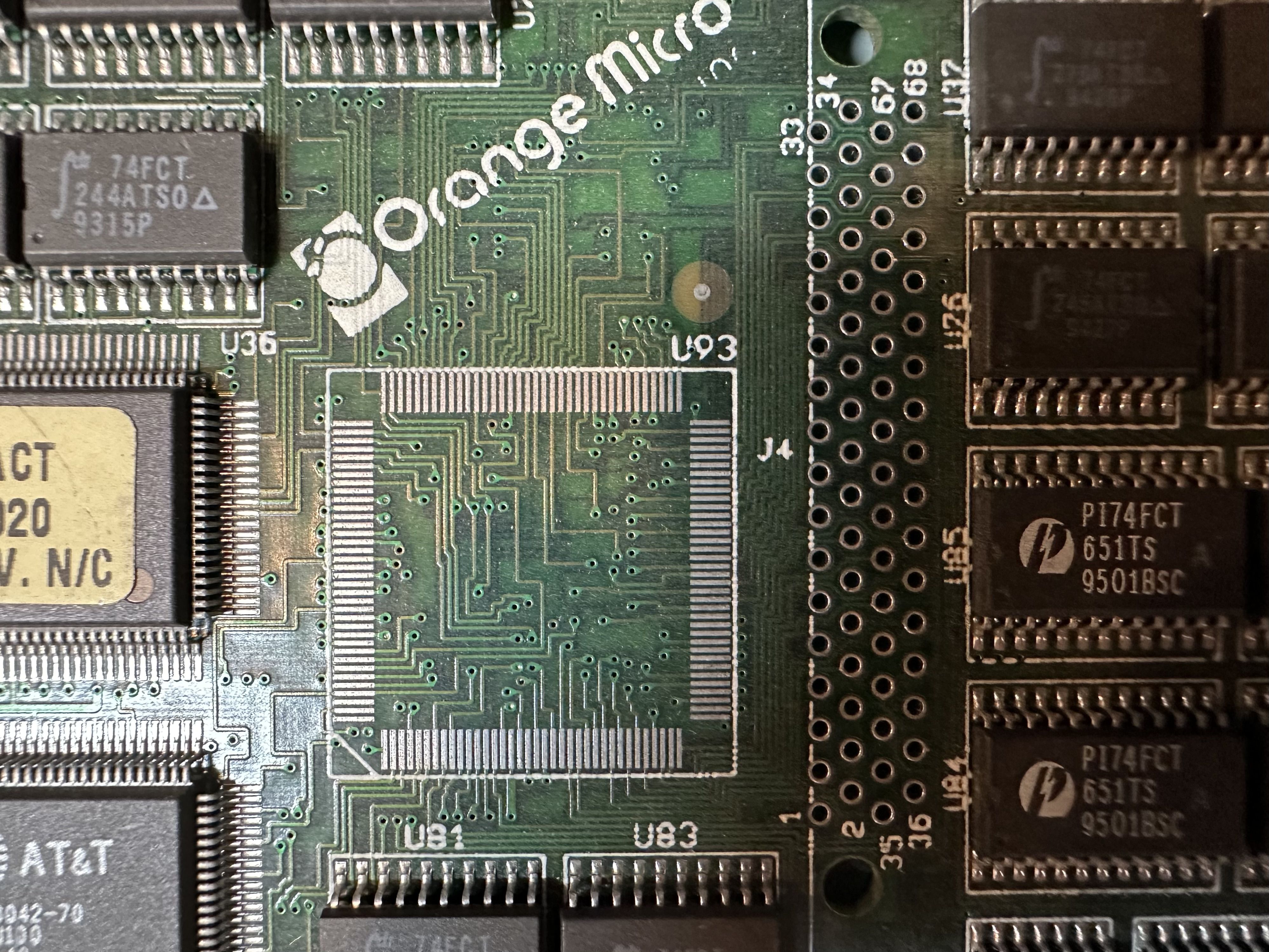

This card, as configured is great for productivity apps, but because there's no sound card, it's not well suited for games of the era. The solution for this would be installing a PCMCIA sound card. It looks like all that's missing to do so is the card cage and a Cirrus Logic ISA IC (CL-PD6710-VC-A 144 VFQP). The chips are for sale from China on eBay. The card cages are harder to find. It may be easier to find some scrap Mac or PC of the era to rip the card cage and controller out of. So far I haven't been able to find a PCMCIA sound card though. If you have one you no longer want, please message me.

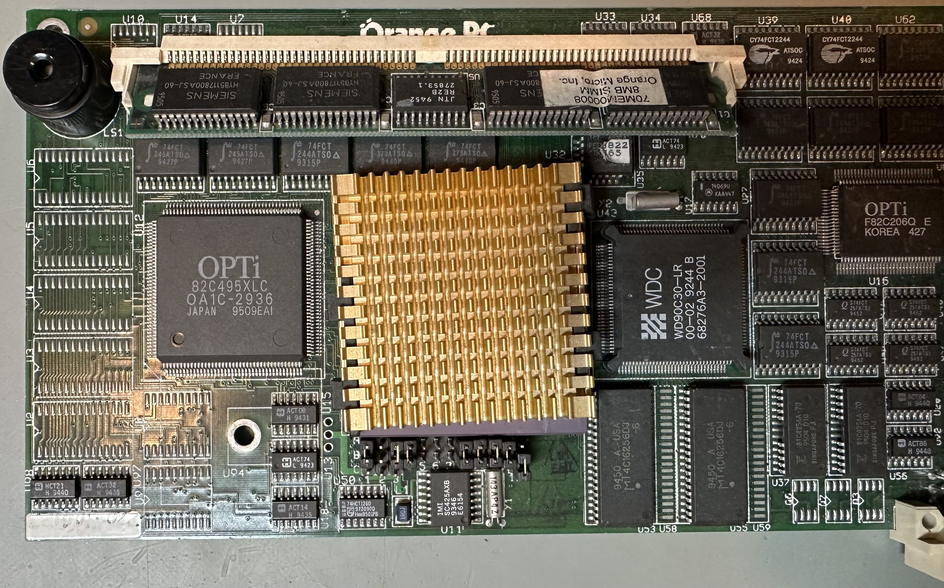

The SIMM socket on the board is at quite a shallow angle. Thick processors with interposer boards or tall heat sinks may block the SIMM from seating properly. This was a concern with the Cyrix chip & would definitely be of concern with a processor with a fan. The socket also has very delicate plastic SIMM retainers; one was broken when I bought my used card and the other broke while I was experimenting with the Cyrix chip. I have used a piece of insulated wire to retain the memory module as an expedient but plan to replace the socket with a regular perpendicular (or close to it) socket in the next months.

Closeup of the PCMCIA controller and card slot mounting points.
