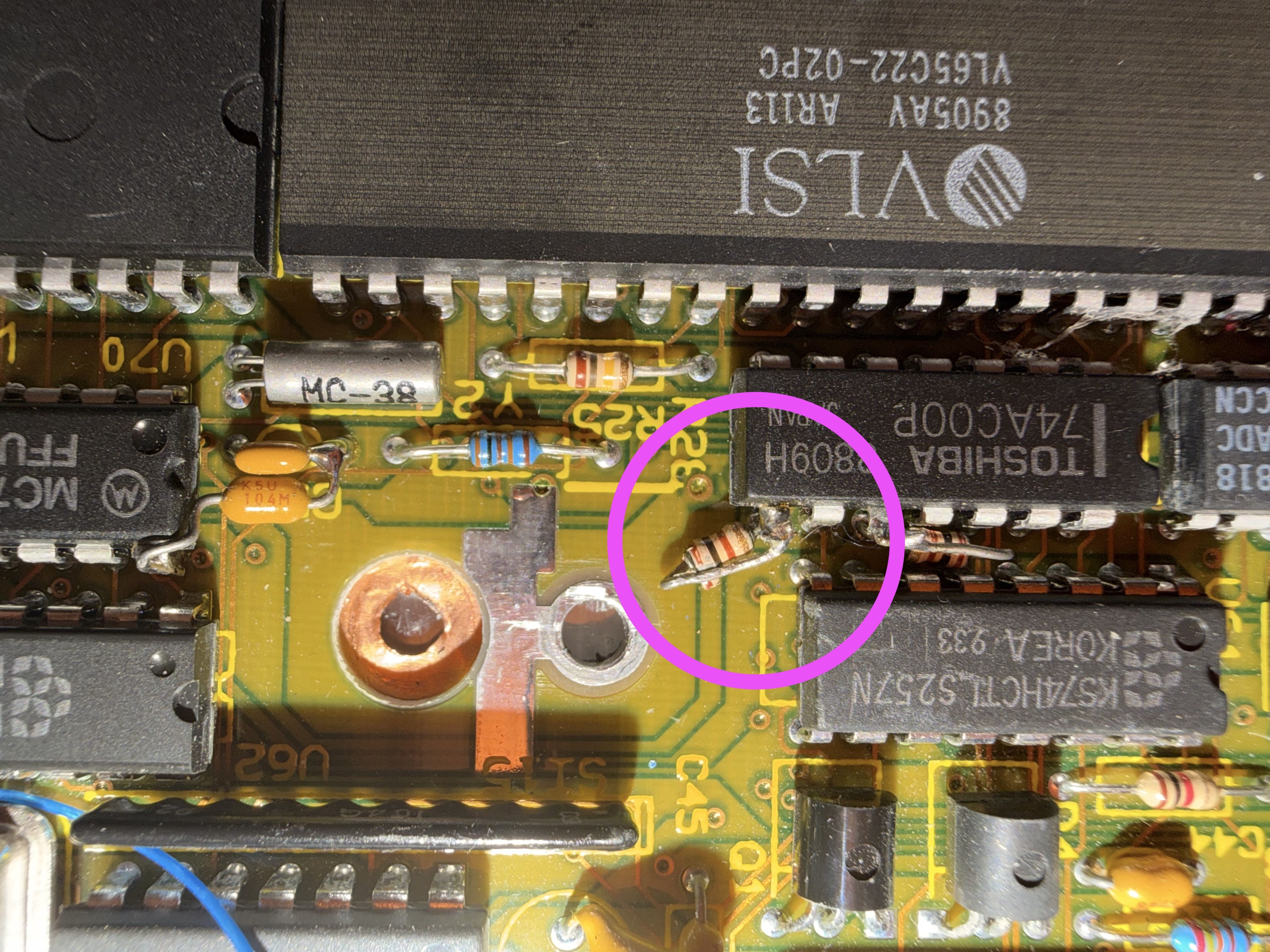

It turns out this bodged in resistor near one of the legs of the HDD bracket was shorting against it. I added some kapton tape to it and the machine turned on! 🎉

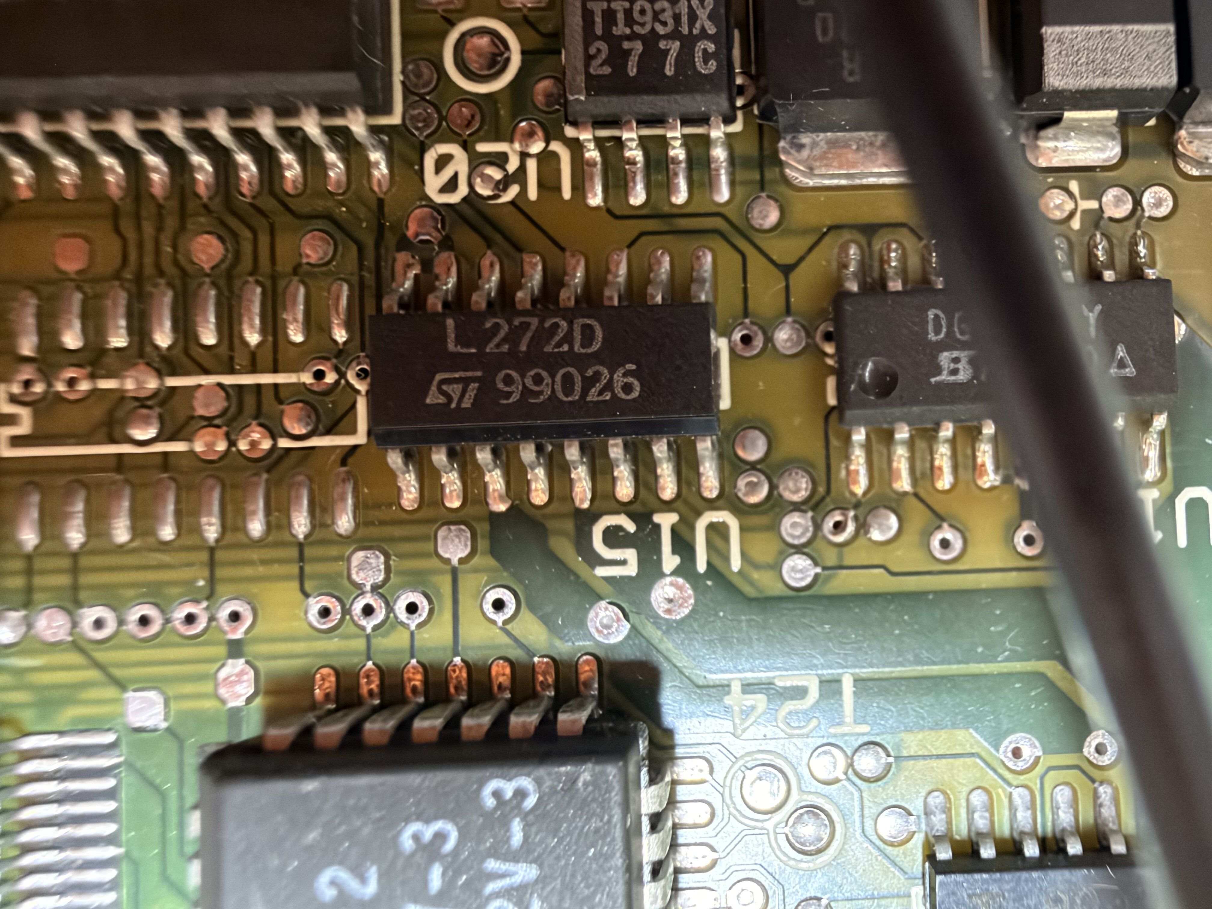

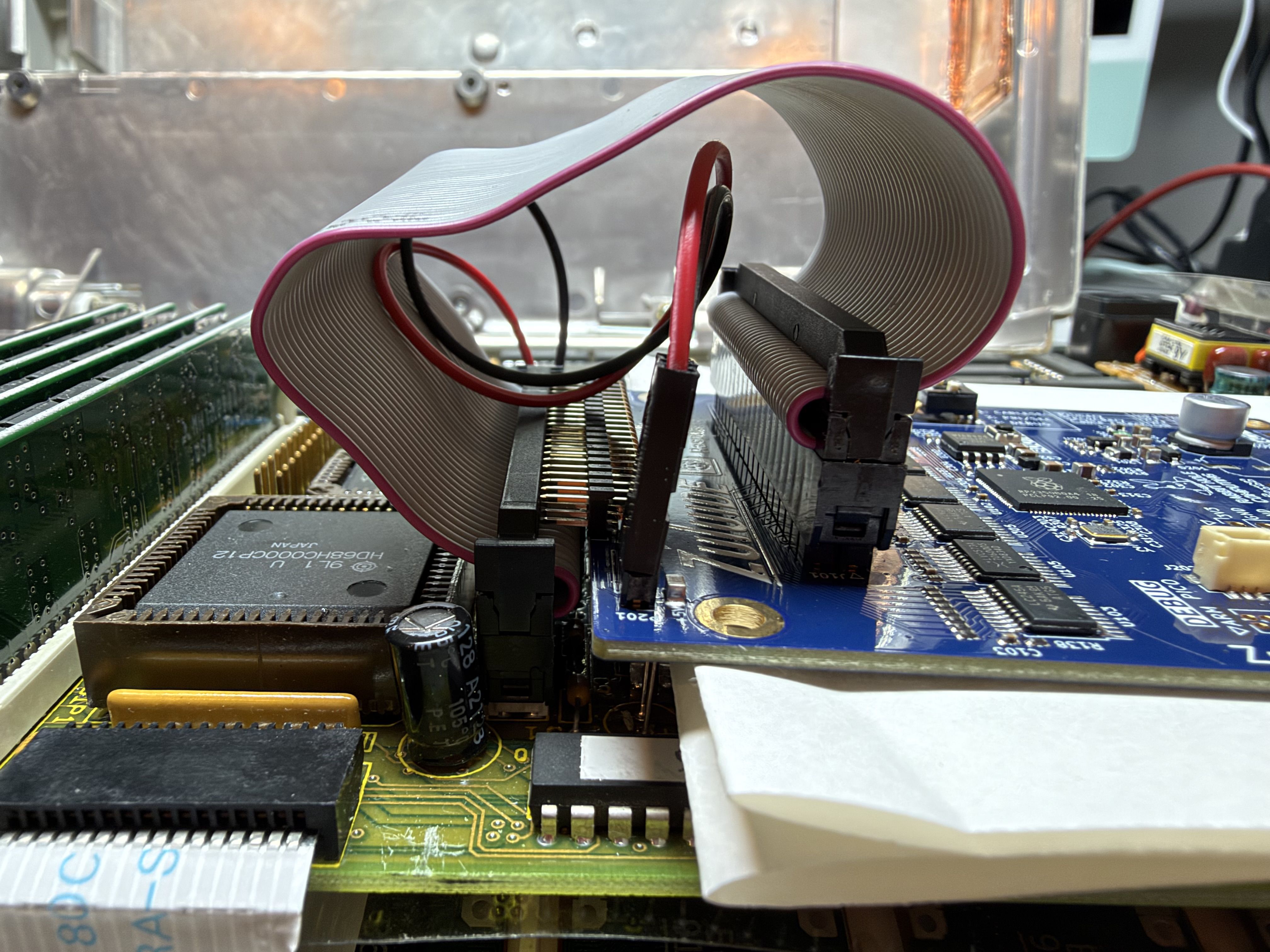

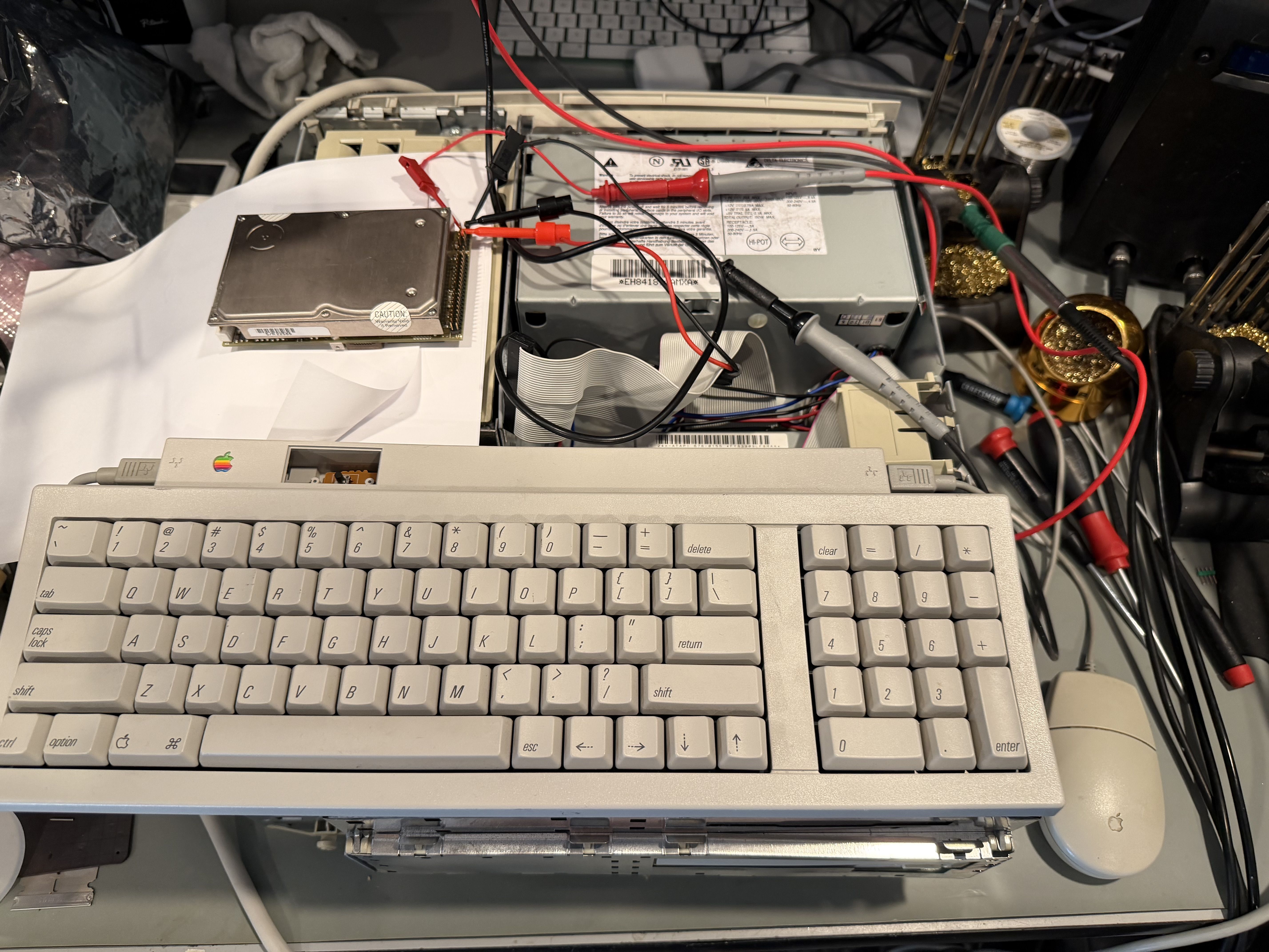

I connected the HDD's 12V/5V rails to a bench power supply and it still wouldn't spin up and was dragging down the 5V rail. Checked its main board with a thermal camera and found that a L272D at U15 was getting hot. That's an opamp that likely drives the motor. While I wait for a replacement IC, I set up a ZuluIDE V2 2.5 following @zigzagjoe's advice.
I'll post more details once I figure out how to best physically mount the ZuluIDE. But currently, I have it connected with a 10cm 40-position ribbon cable and jumper wires for +5V/Ground.
The bad L272D Opamp @ U15:
Temporary ZuluIDE connection:

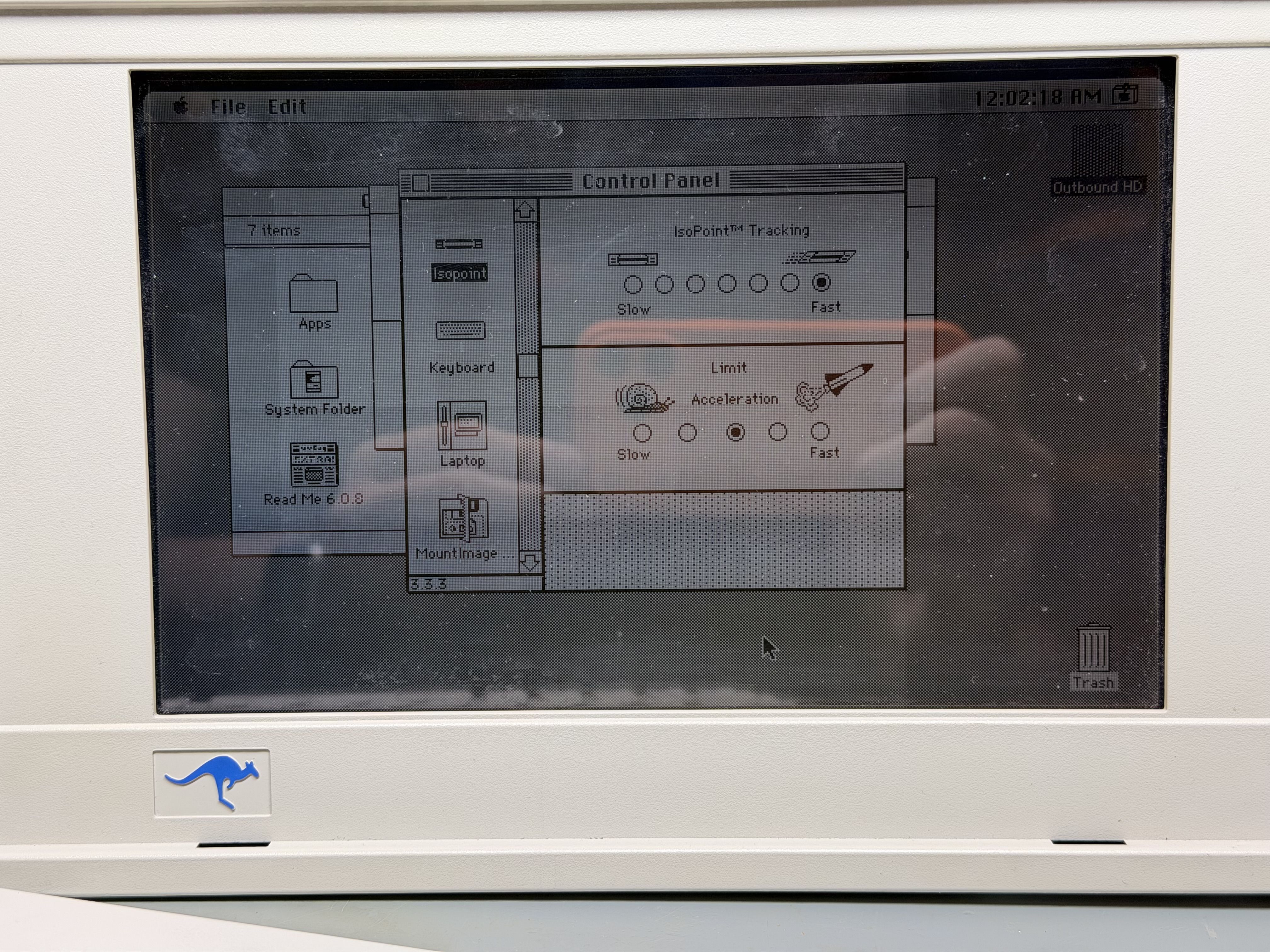

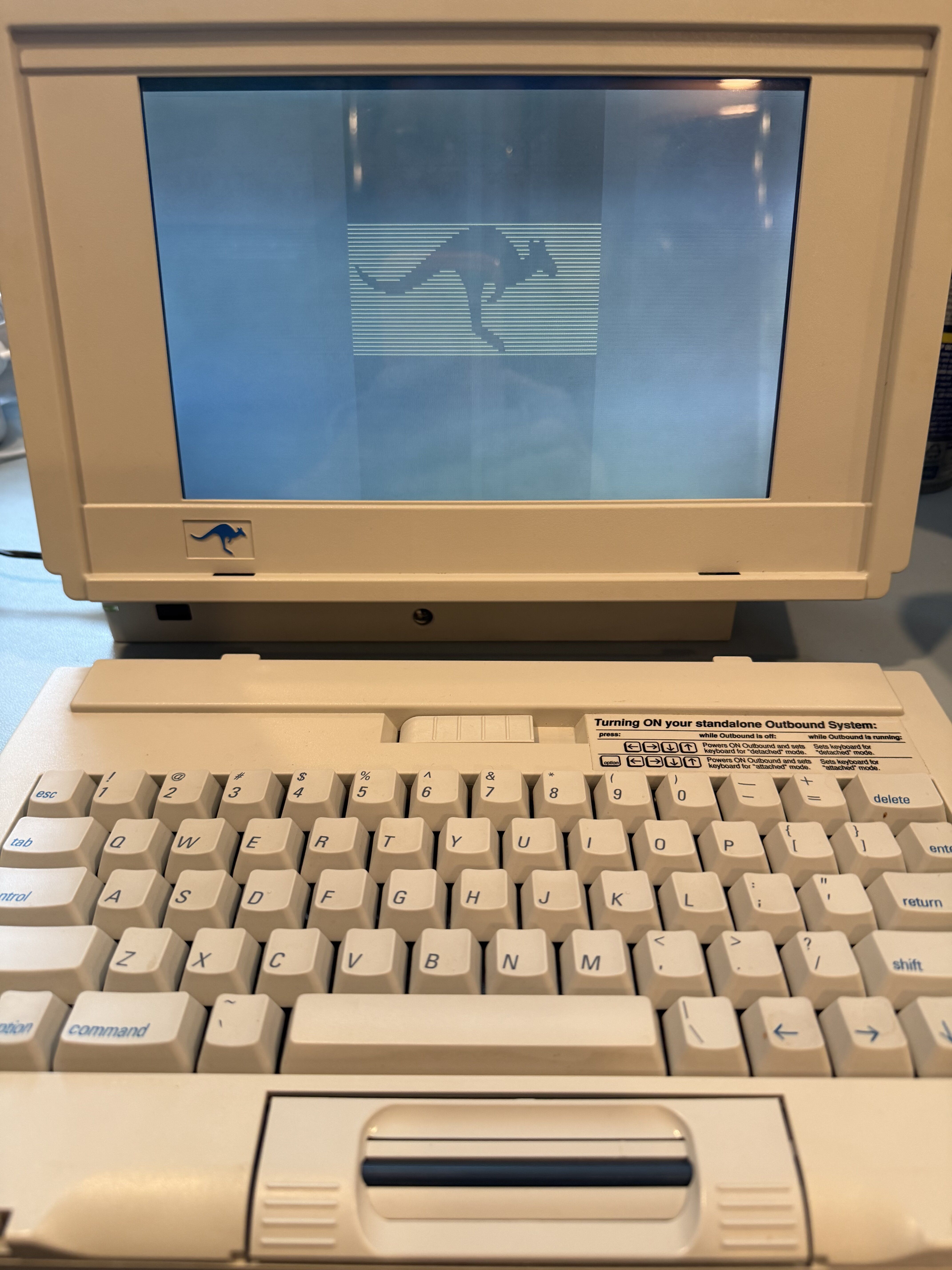

A happy Outbound!

Repair update: I did get the old drive working after replacing the blown opamp. It has Outbound software version 1.3b2, which I think is already available online, but I'm going to attempt to image the drive regardless.

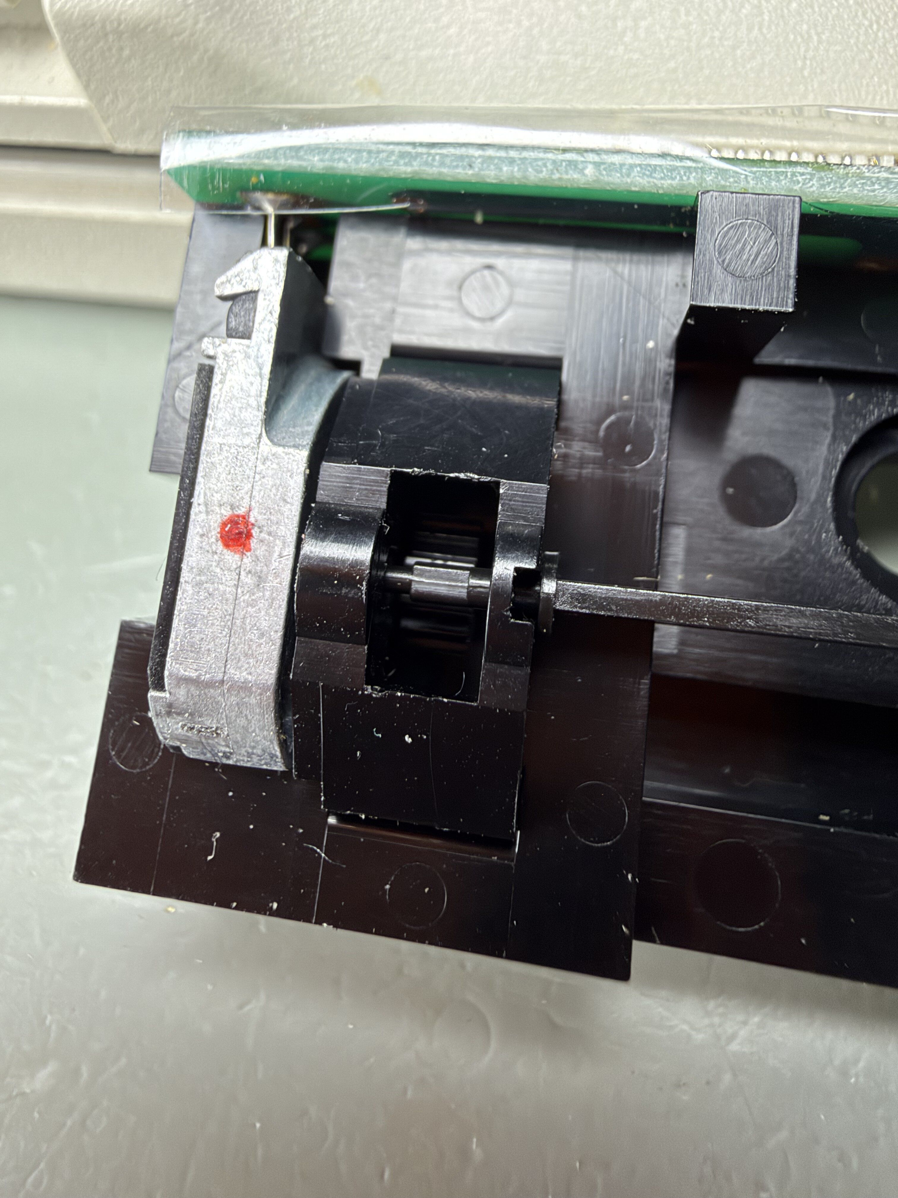

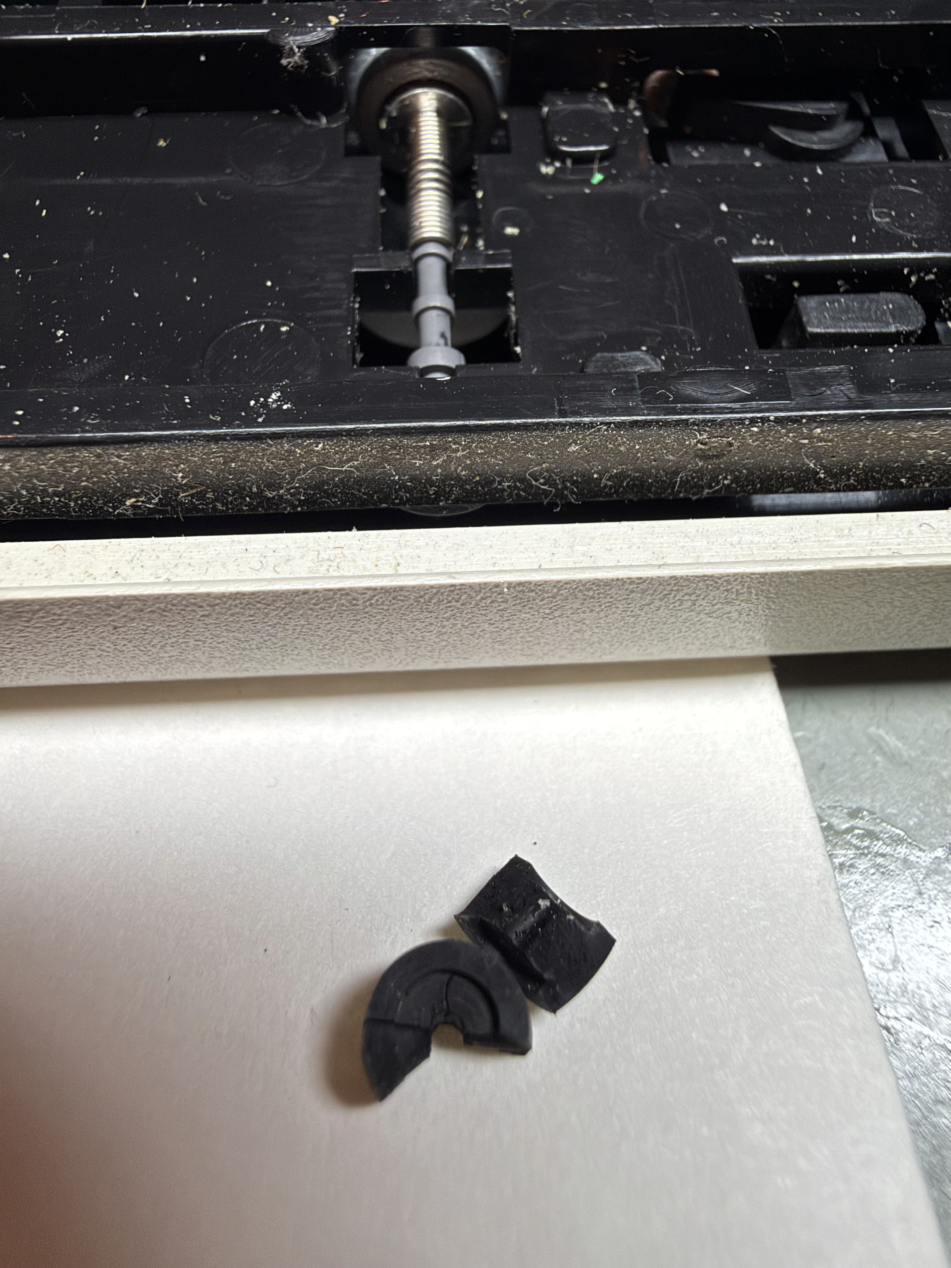

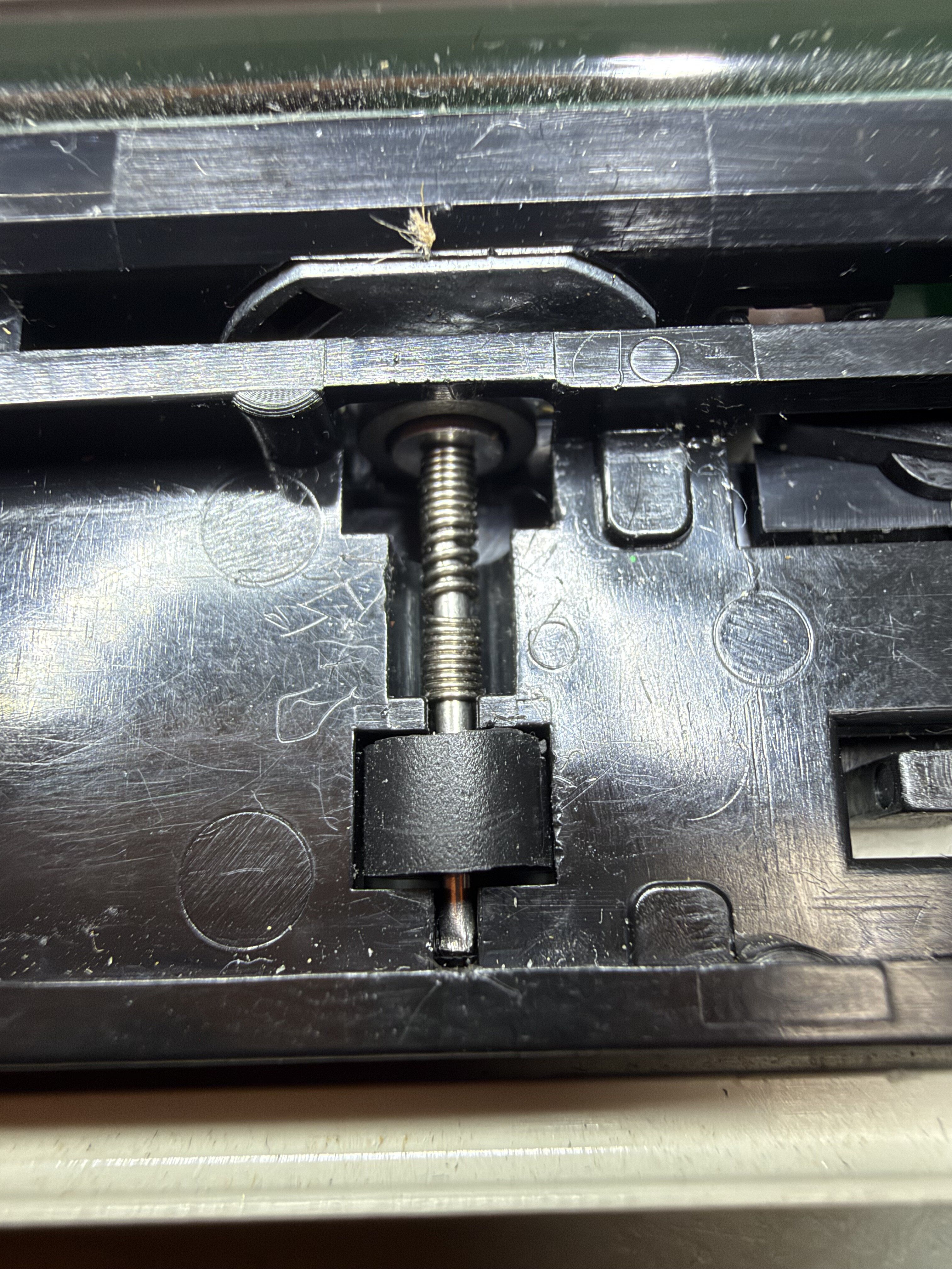

As I was working with the machine, I noticed side-to-side tracking was weird. I'd have to slide the ISOPOINT all the way to the right or left to get it to track that way, I took apart the mechanism and found the rubber wheel on the digitizer was disintegrated. I made a new one out of 5mm rubber cord and a 1mm hole punch. As I was trying to install it on the original plastic shaft, the shaft broke. I replaced it with a piece of 1.6mm solder needle which fit perfectly into the spring the plastic shaft sat in. It's not perfect, but is working well enough.

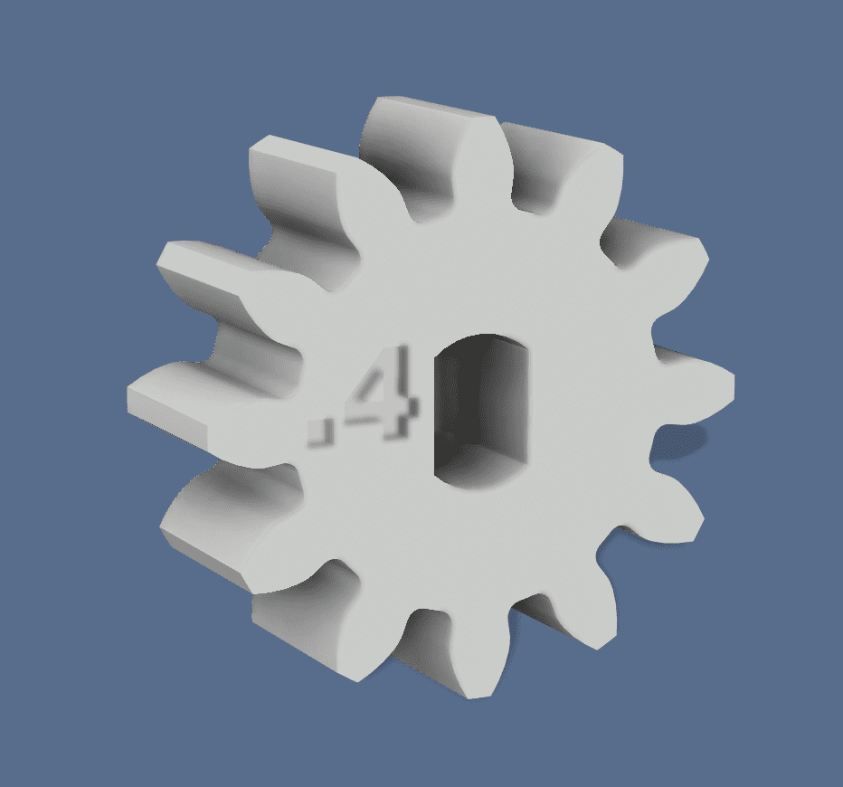

While I was working on that I somehow managed to separate a gear from the up/down tracking mechanism and couldn't find it. Maybe it disintegrated too. No idea. I experimented with a bunch of different gear sizes and found one that worked. It's 12-tooth, .4 module, and 2mm thick with a double-d bore. Printing in ABS-like resin at 102% (x/y) and then clearing the bore a bit with a 1mm round file made it perfectly friction fit the shaft. Hopefully no-one will need this, but I'm attaching the STL here just in case.
The deteriorated horizontal tracking wheel:
The homemade replacement installed:

The missing gear:
The replacement gear design:

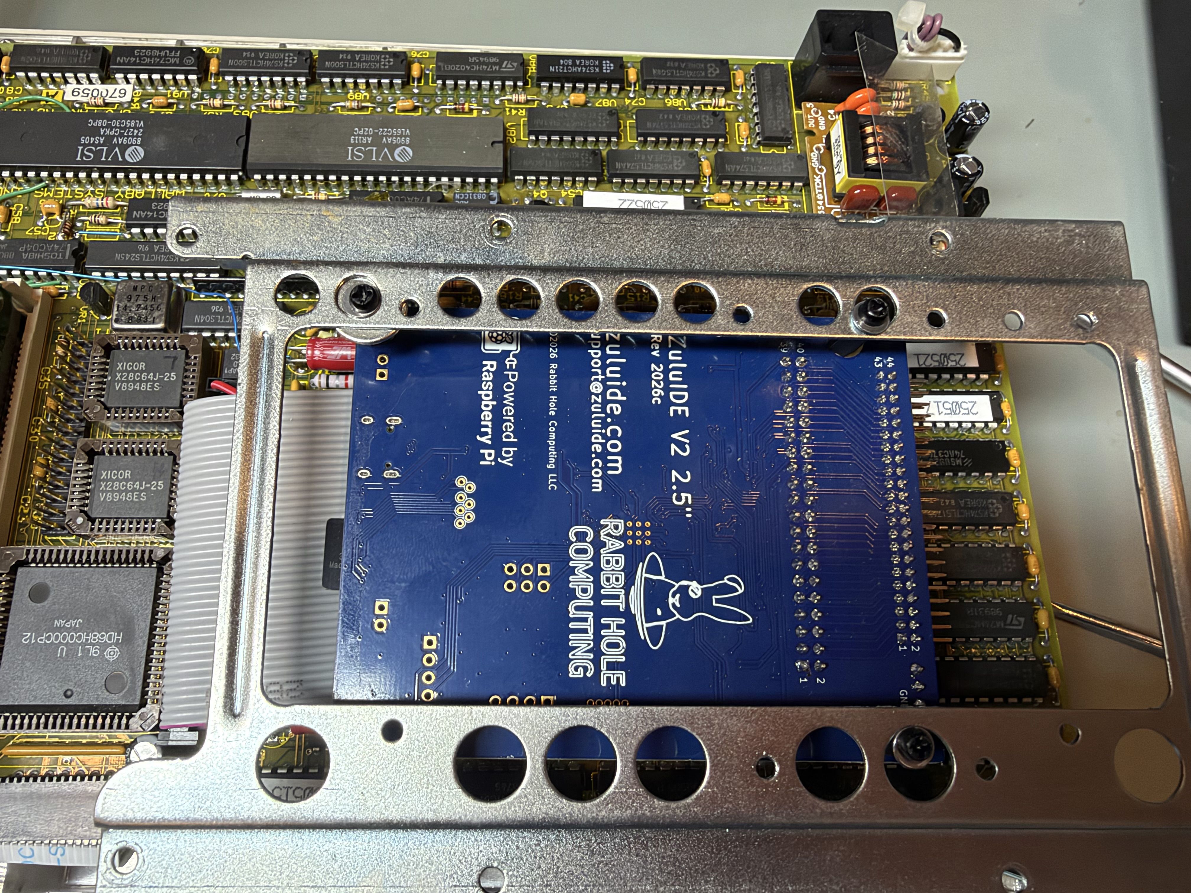

I also mounted the ZuluIDE to the Outbound's HDD bracket with some nylon standoffs, screws, and washers.
