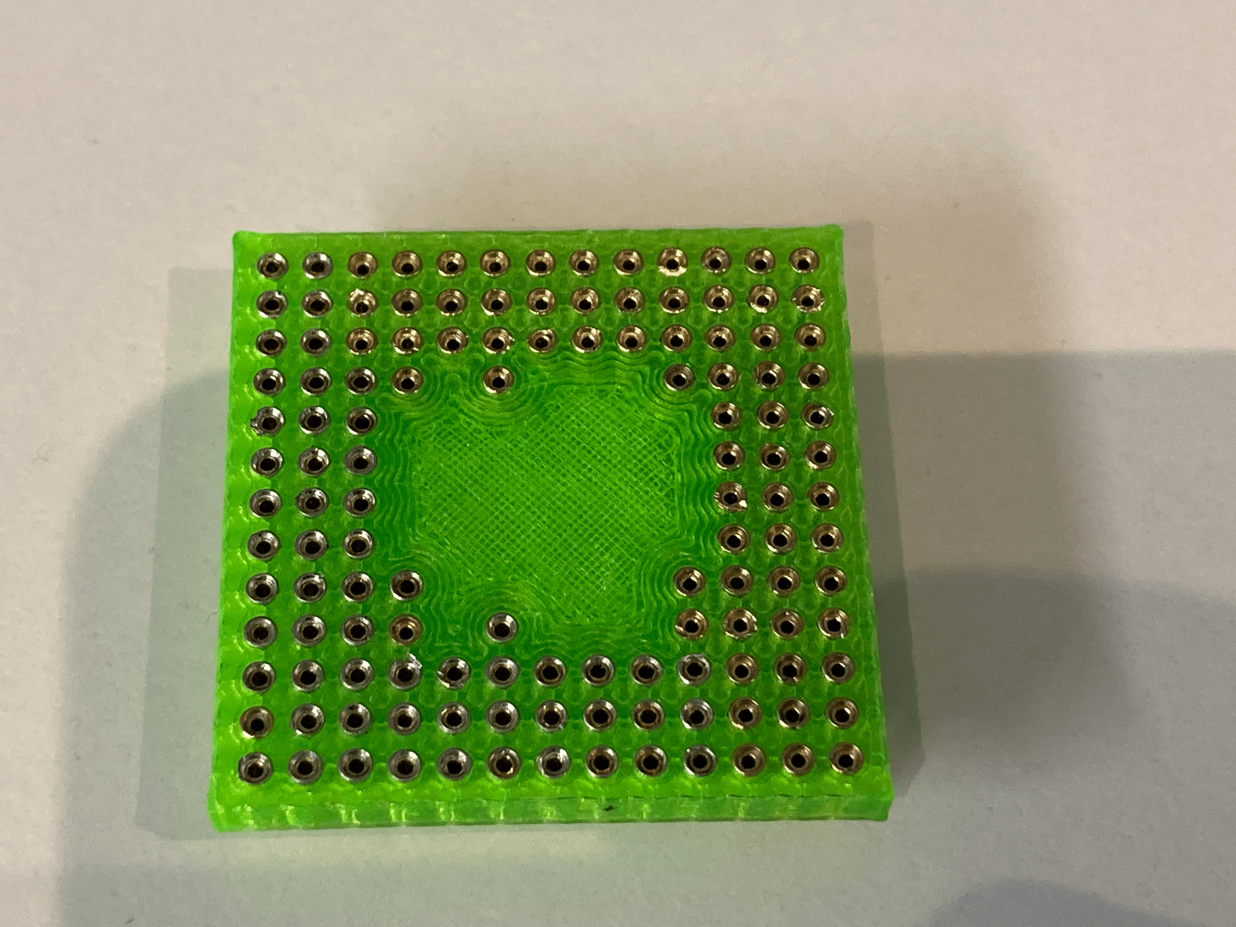

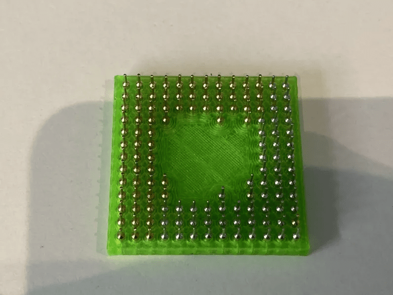

I saw @max1zzz had a try at OpenSCAD, to generate PGA sockets, so I helped and cleaned up the code, made it more parametric, so we can now 3D-print sockets for all those… The code is here.
Can confirm these work really well :)
Printed in PETG on my totally uncalibrated Ender V2. Ideally you need a chip in the socket when soldering as the pins may move otherwise
I did have to open up the size of the holes a tad to compensate for the resolution limit of the printer

I have been printing the holes at 1.8mm bottom and 2.2mm top, quite a lot bigger than the actual pin but this is partly probably down the the fact I have never really aligned my printer

Well, turns out the socket for the 182 pins version (V suffix, static core, 3V3 Vcc) of the MC68040 doesn't exist at all at preci-dip... so might need to print that one! Did a PR.
Now I really need a source for those pins :-)
