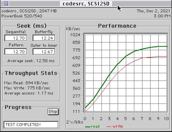

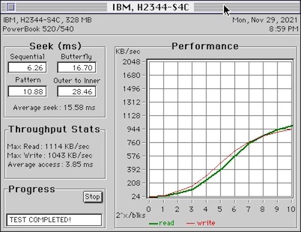

Thought I'd share my experience with replacing the orginal hard drive in my PowerBook 540c with a BlueSCSI and some tests I did to see how it compares with the original HD and a SCSI2SD I had in my PowerBook 180.

OEM IBM
PB SCSI2SD v5

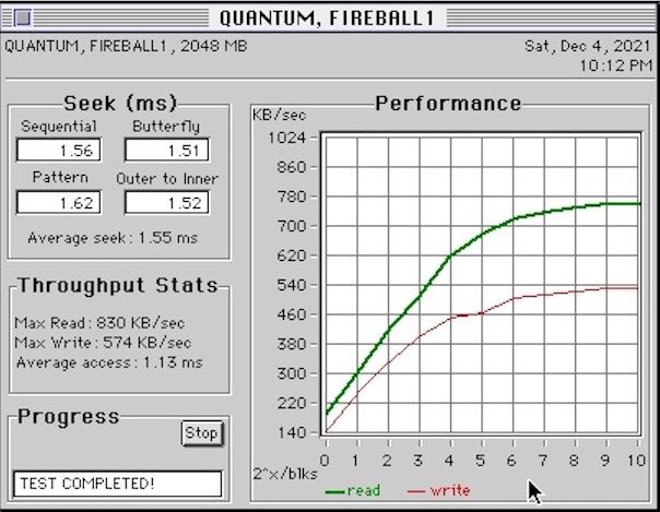

PB BlueSCSI v4
PB BlueSCSI v4 (PPC )

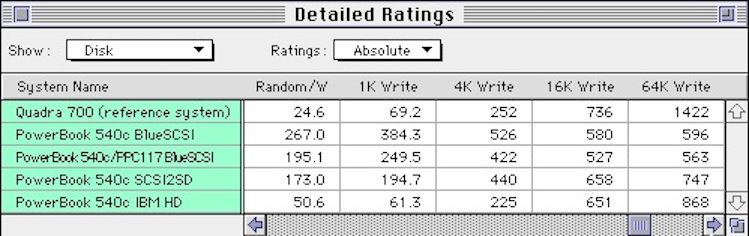

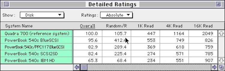

Norton System Info:
I thought perhaps the BlueSCSI might benchmark better with the PPC upgrade but I guess enough overhead exists in the 68k emulation and mixed mode where that's not the case. ...of course it could also be the benchmarking tools and OS version I used.
