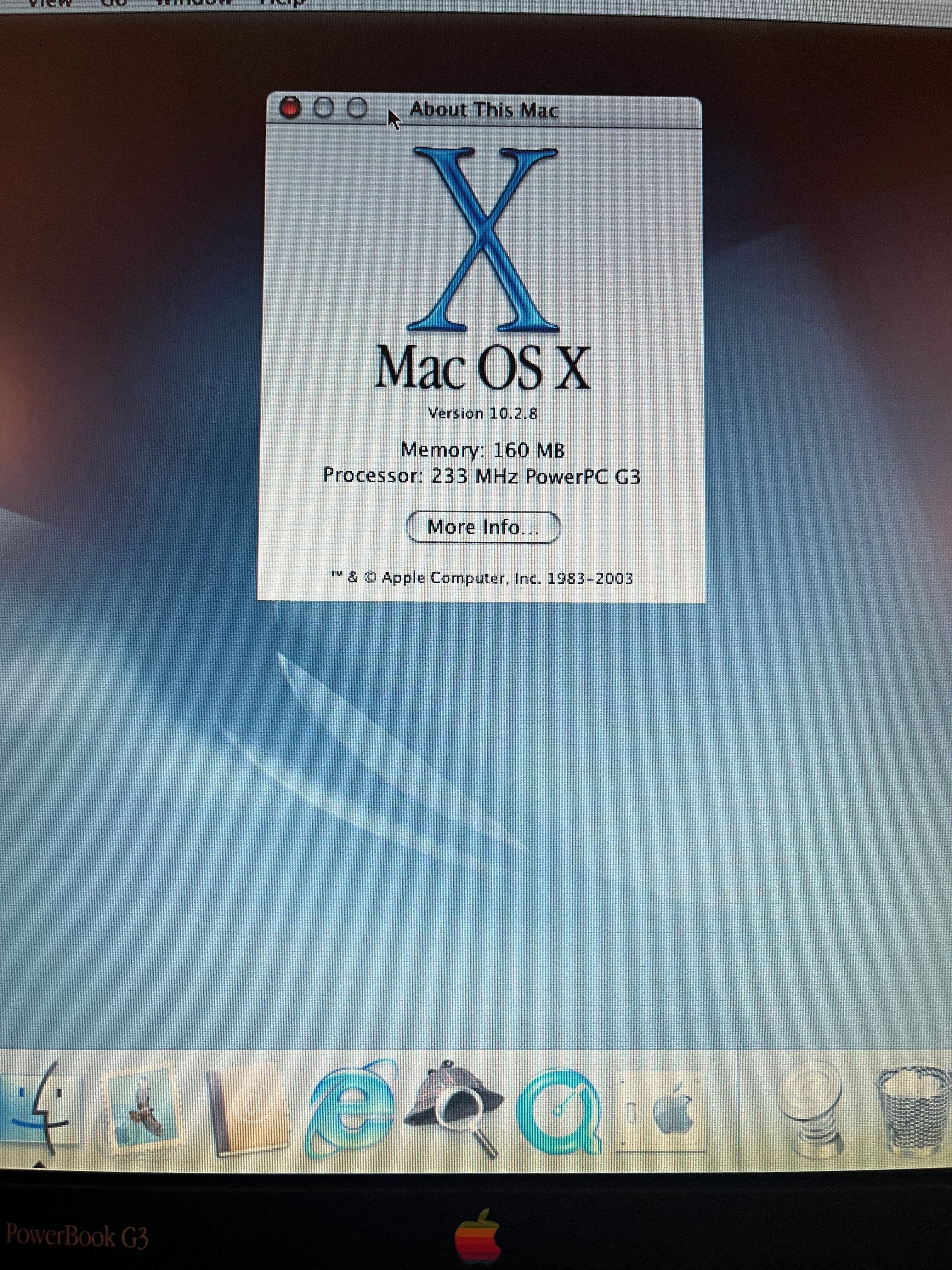

It is a finicky machine to install a SSD on but it should work. The method I used worked for me and someone else who tried it after I reported on it. My PDQ is a 233mhz machine with 160mb of ram. Here are the details:
1. I used a Dogfish 64gb mSata with a mSata to IDE enclosure from Amazon.
2. I installed the drive in an external firewire enclosure and formatted it from my PowerBook G3 Pismo using the OS 9 lives install CD.
3. I created 3 partitions. The first one was 2 GB and contains OS 9. The second partition is 4GB and contains OS X 10.2. The third partition is 2 GB in case I want to install something else bootable in the future and the 4th partition is 20-30GB for storage. The rest of the drive was left unallocated.
4. OS 9 was installed by dragging and dropping the System Folder and Applications folder from my Pismo.
5. OS 10.2 was installed using the 10.2 install CD from Macintosh Garden. I did this on the Pismo.
Both OS 9 and 10.2 work on the PDQ. Sometimes the computer freezes when I go to Start Disk to change the boot volume and I have to force restart. 10.2 takes awhile to boot up. I recently installed ONYX and Shadow Killer which has made 10.2 run much better.
I have a copy of OS 9 on a CF card that I can boot from on the PDQ using a CF Card to PC card adapter. I also use this to move files to the PDQ. The other way I move files is through a crossover cable and networking.
