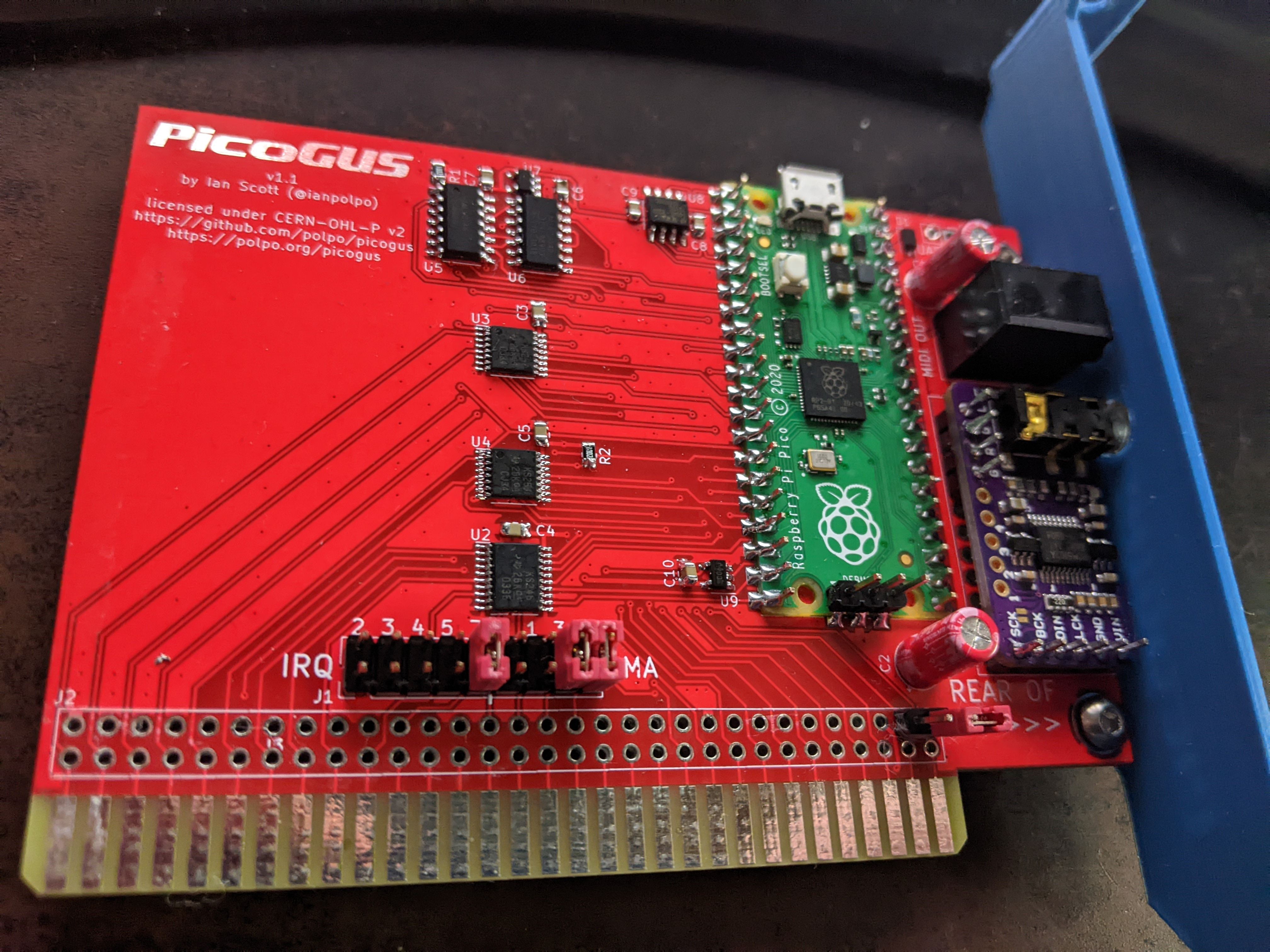

I had the PCB made by JLCPCB and ordered the mouser list found in the GitHub
Picos are NOT affected by the raspberry shortage but as I write this in March 2023, it's becoming possible to even buy the normal ones (through rpilocator, but I digress as this project is only compatible with the pico)
Here's the finished assembled product. I had the bracket be 3d printed by a friend. I had to sand down the pointy end a bit as it would not fit inside my PC case. The mouser kit does provide you with a metal case bracket, but you have to source your own M2.5 screws (iirc) and you'd have to drill down your own 2 holes for the audio port and the small midi port.
The only place I can use it in my retro gear is inside an upgraded IBM ValuePoint DX2/66 with 32 MB RAM that already had a SB16 vibra clone set at IRQ 5 DMA 1 Port 220.
Therefore, I set my jumpers on my PicoGUS to IRQ 7 DMA 3 and will set my autoexec.bat settings line with those and port 240.
The only non-intuitive step (for me) was getting the Gus firmware on the pico. I followed the steps: press the BOOTSEL button on the soldered on pico (requires a jumper that links the RESET pin to GND to force a programming mode, the guide tells you where), THEN plug it with a microUSB cable to a modern PC or other. The pico memory will show as a volume onto which you can basically only do 1 copy, after which it'll auto unmount and all is good.
I was expecting to copy several firmwares in advance (you can't) and have the files stay permanently visible when you connect it a 2nd time and on (they won't, they're consumed and then wiped).
I then proceeded to install it in my case, which is a pain to open and a heavy CRT has to be set aside...
Everything so far works!
View attachment 11260View attachment 11261

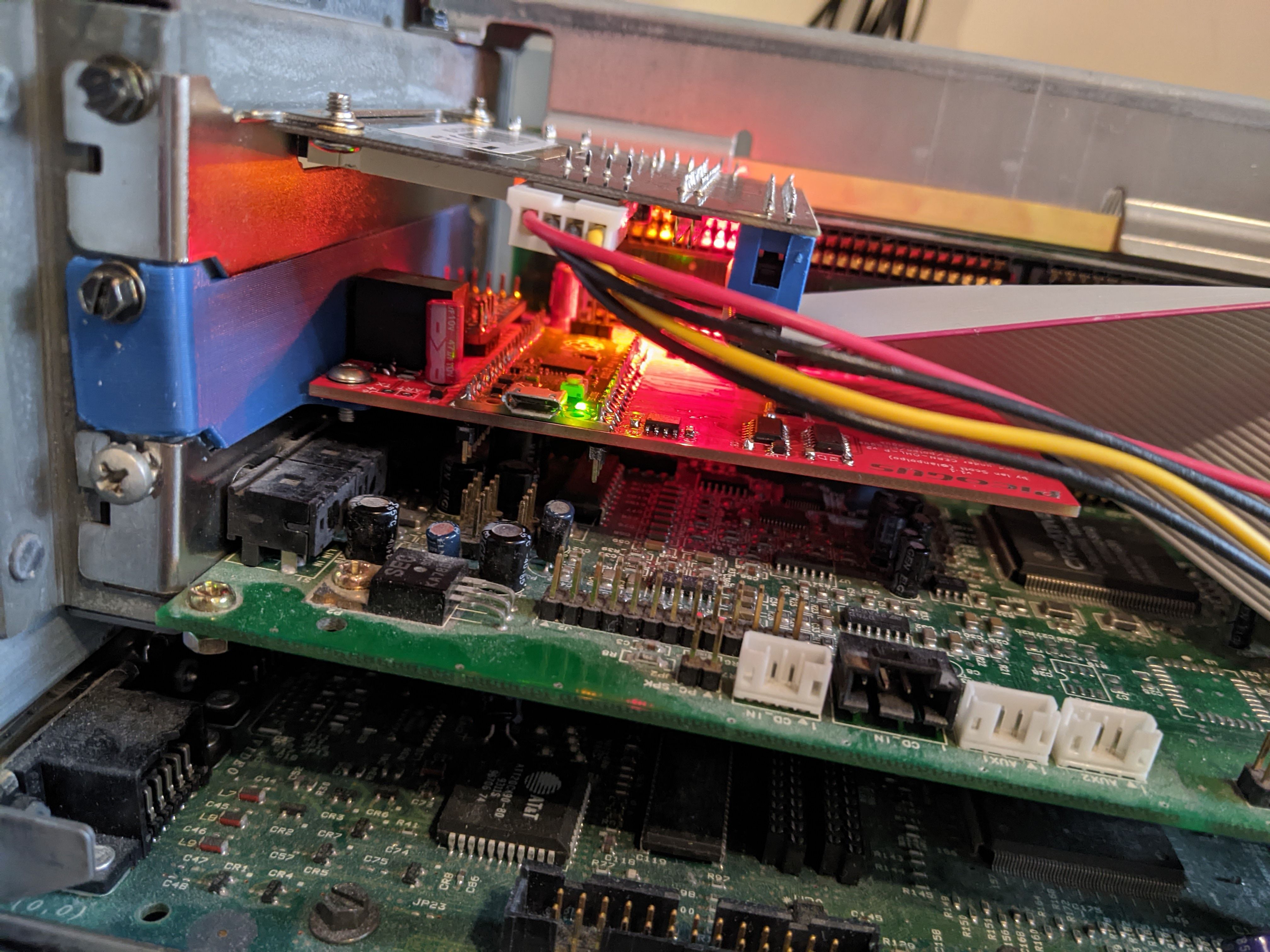

I'll capture some audio to compare my SB16 and this new PicoGUS soon!
I made myself an adlib last year which was fun, this card looks like an awesome step up to experiment with other sound fonts.
I know some soundblasters are good in the IBM 5150/5160 but I've never explored that.
I'll have to look at ordering a PCB for this!

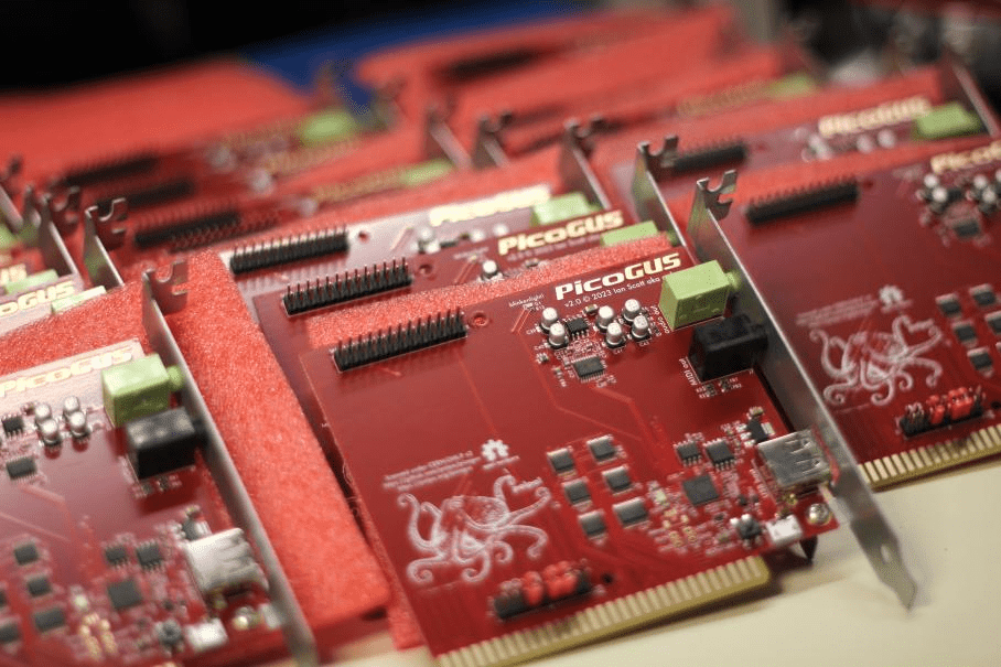

If you're interested by a hardware Gravis UltraSound but are not made of money to buy an original one and can't be bothered to solder your own board from the github project files, then the newest hardware revision v2 just hit today in Ian Scott's tindie store and you can buy your own, now with a metal bracket and joystick support via USB.
