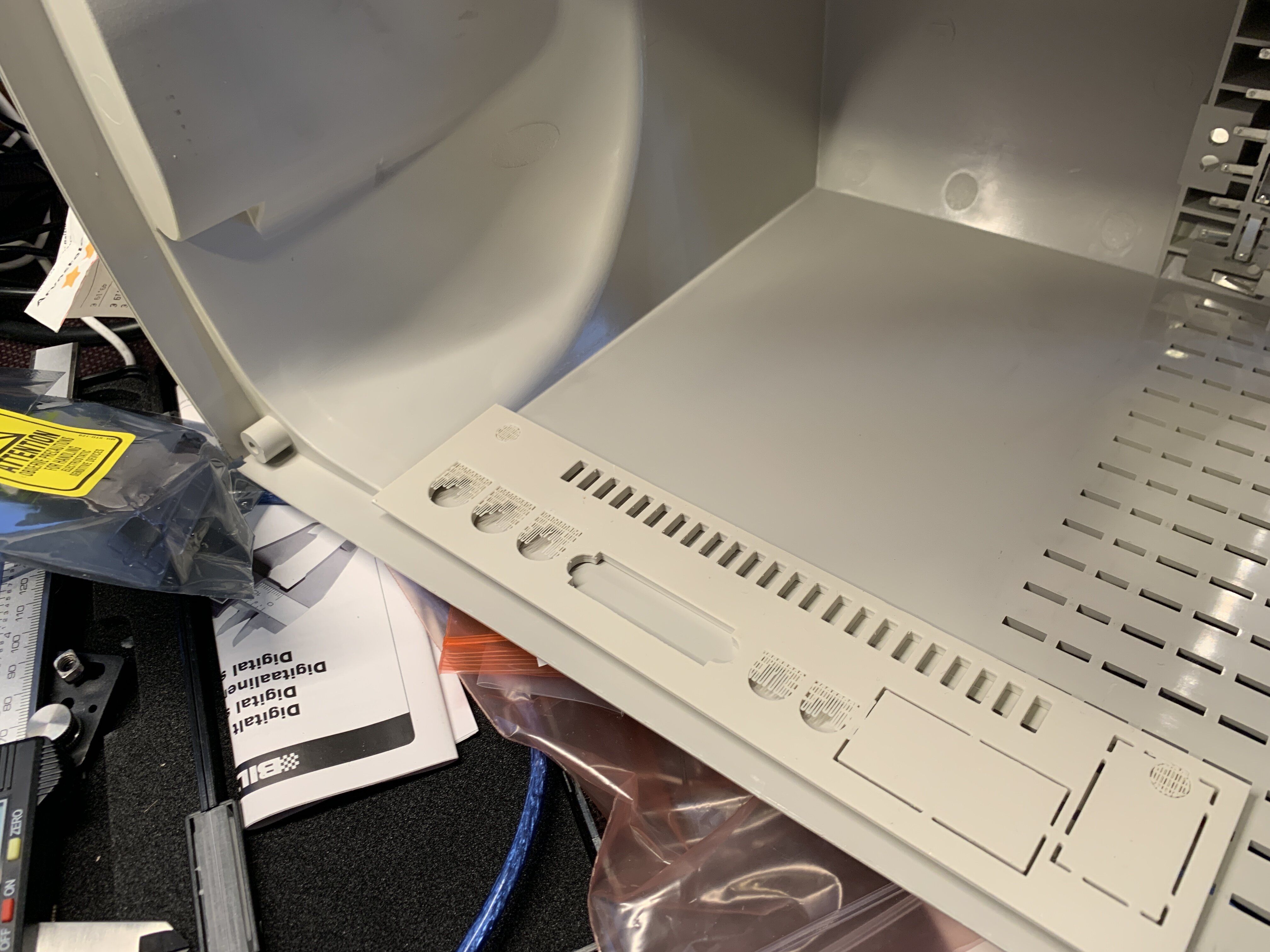

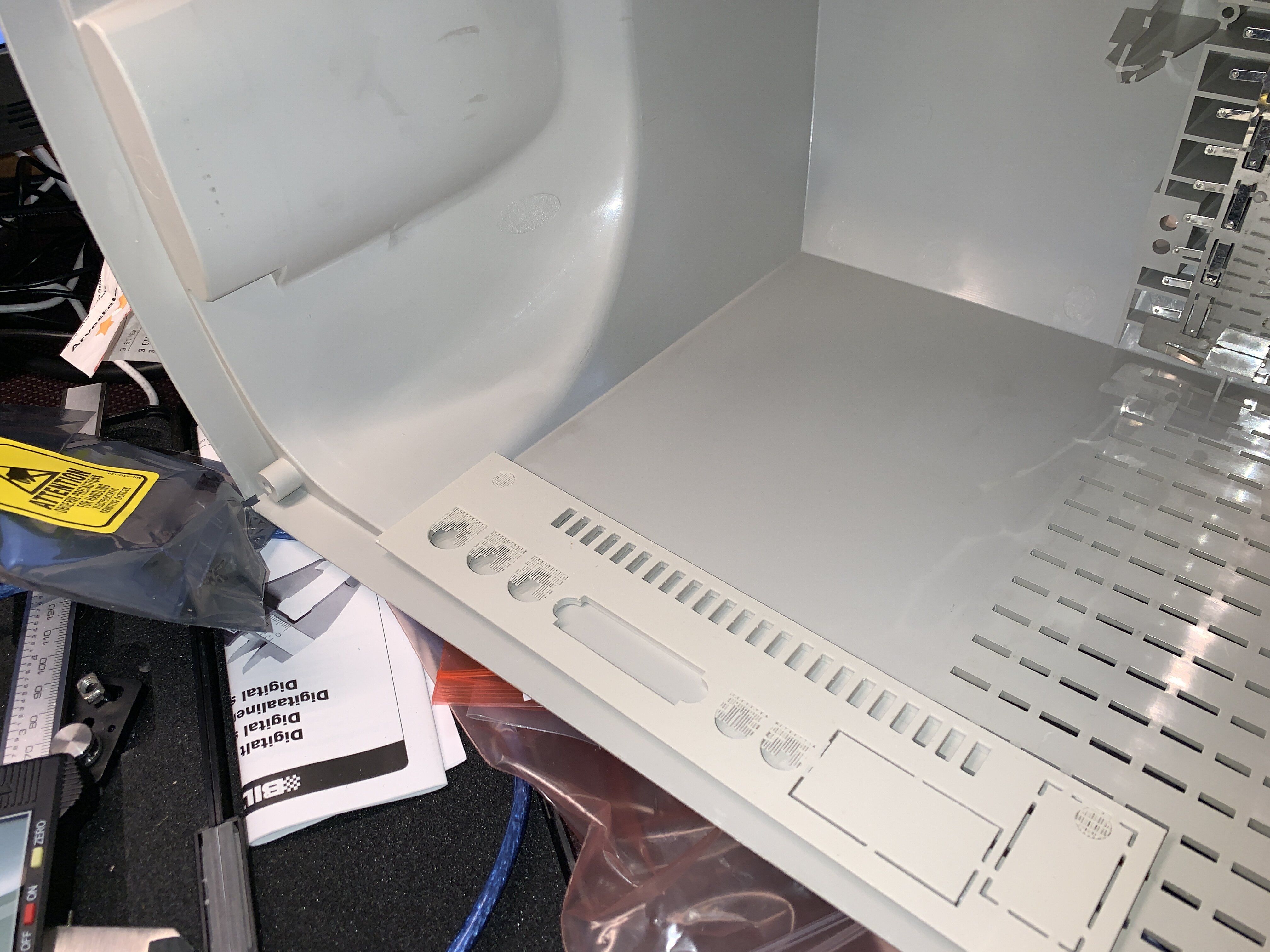

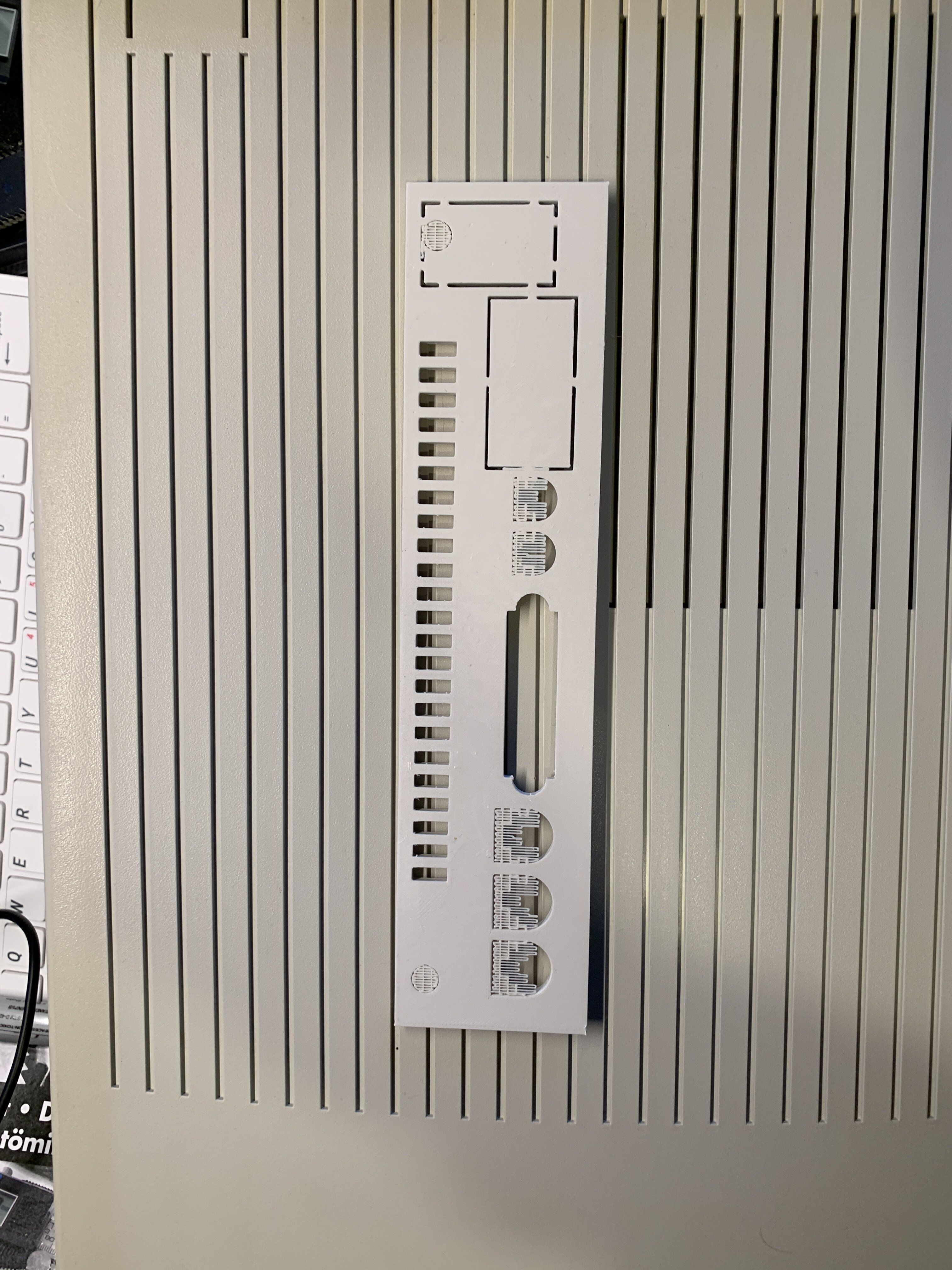

Finally I got the PLA this morning. It had been sitting at a local distribution center for a week. Anyway, as promised, here is the Mystic back-plate.
It is very close in my opinion. I don't have a perfect, untarnished plastic to compare to. The inside of the CC is closest to original I can find. There is a very clean but yellowed LC475 cover as well.
I think it's a winner. At least for back-plates, external cases for RaSCSI, etc. It prints pretty well with my regular PLA settings. I still need to dial it in further. I printed at 205C, which is more than I usually print PLA with. I had to raise it up to avoid extruder skipping.
