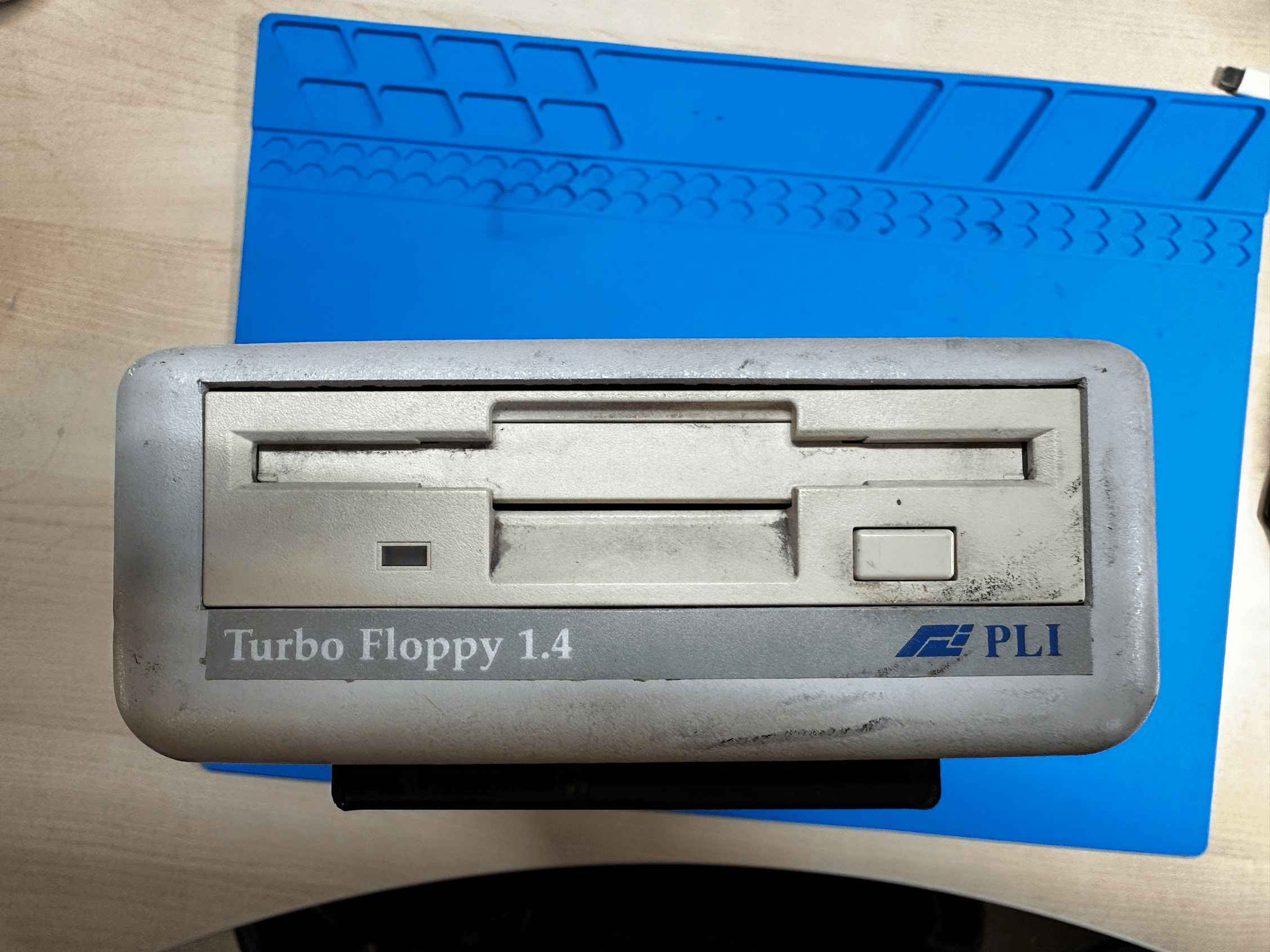

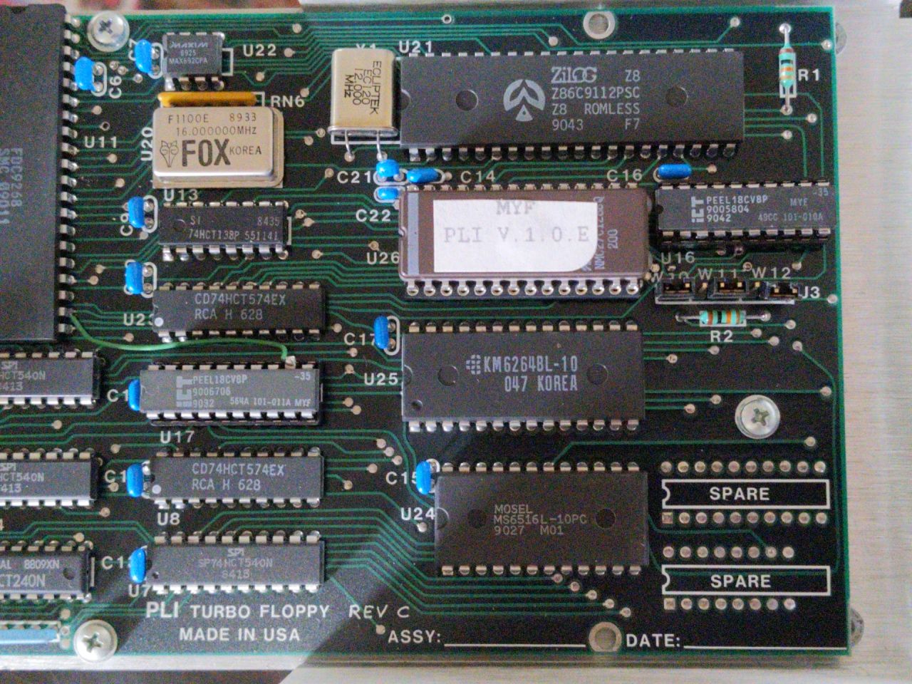

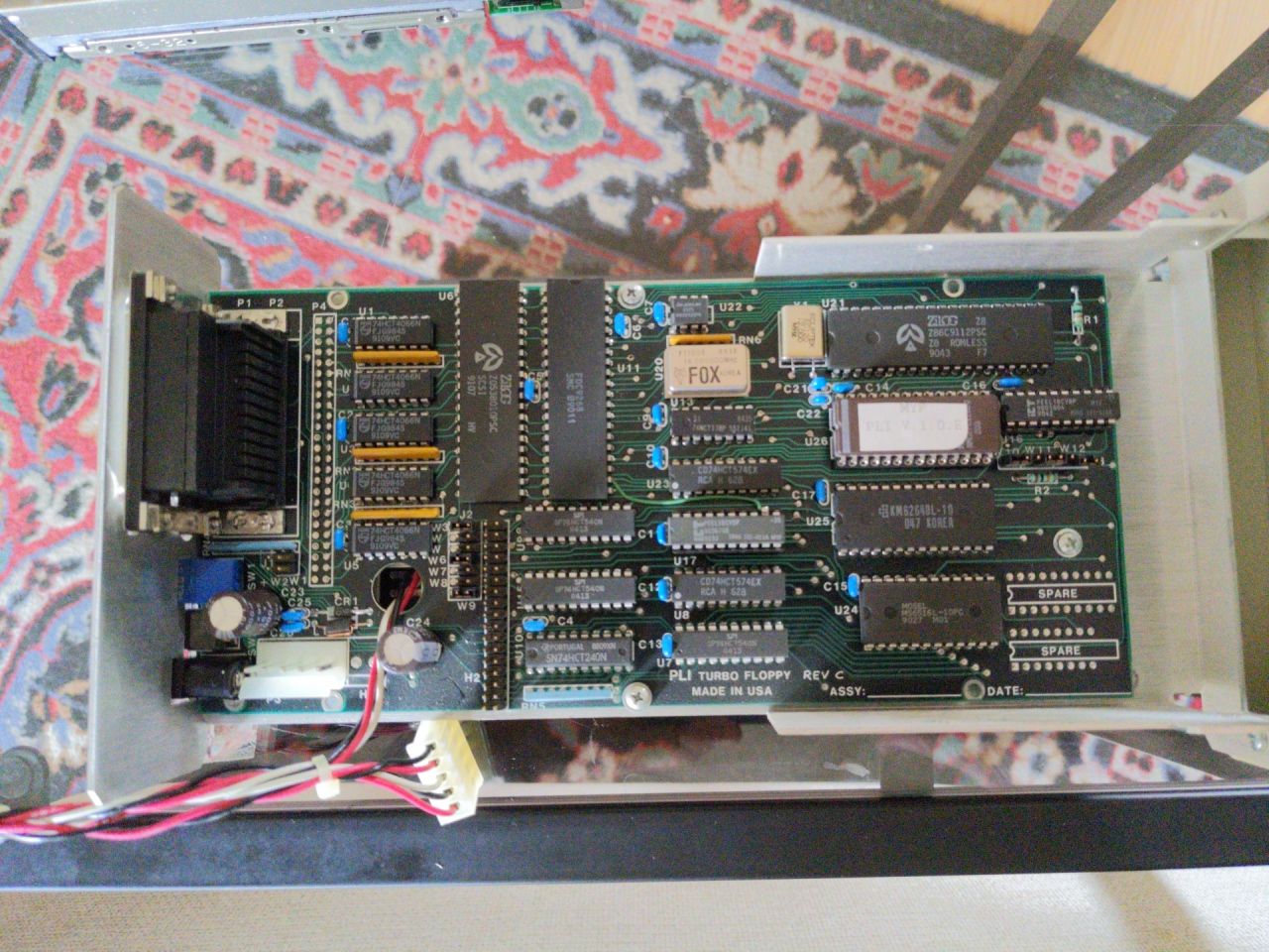

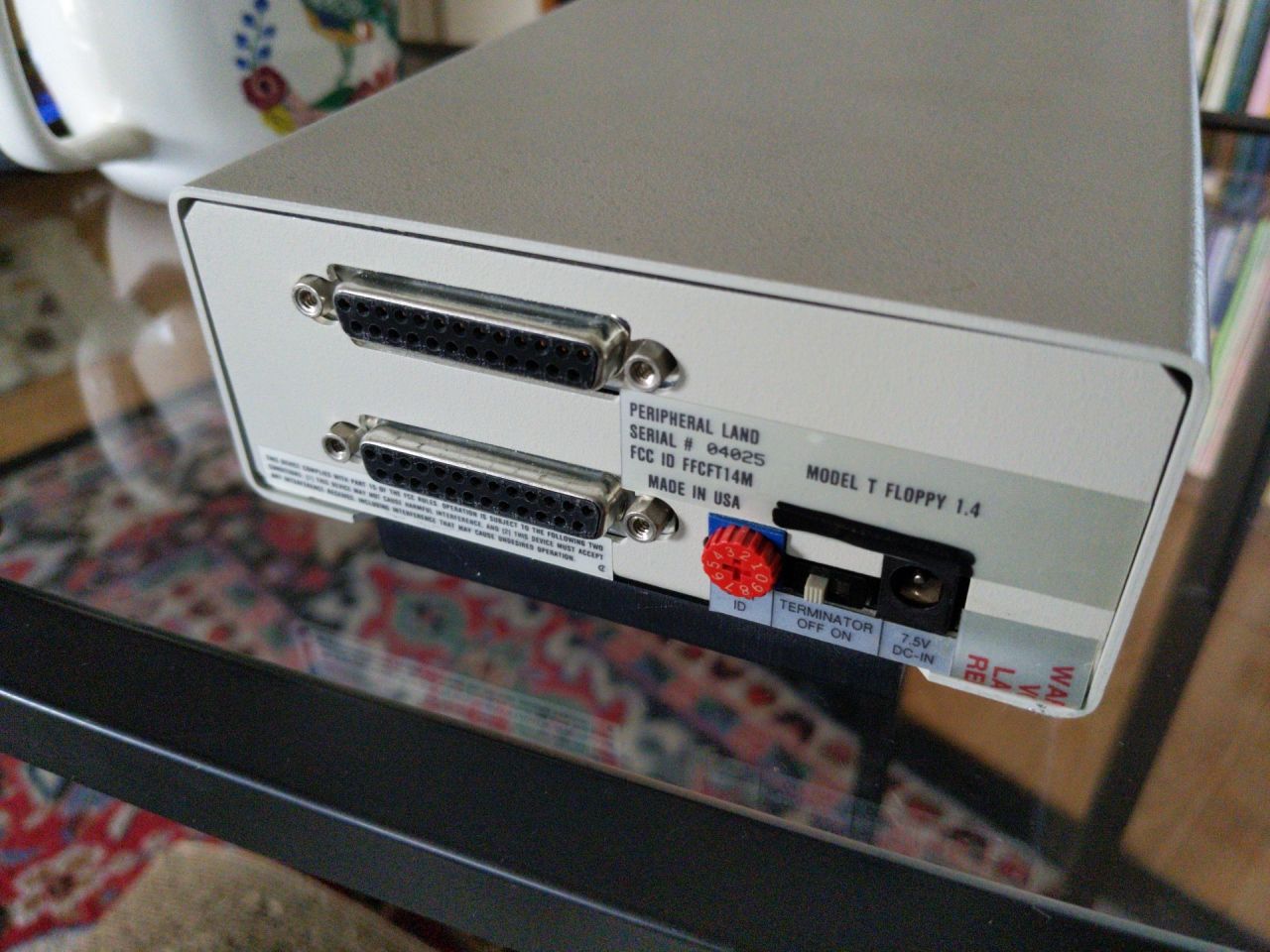

I recently (well not so recently now) picked up a PLI (Peripheral Lands, Inc) Trubo Floppy 1.44 for the Macintosh. Made a low offer and it was accepted on the bay.
This is an interesting device as unlike other SCSI floppy devices - like the IOmega Floptical - it requires no driver to work on the and can boot from 1.44mb floppies. That means you can use it on a Plus or SE or other non-Superdrive Macintosh computers.

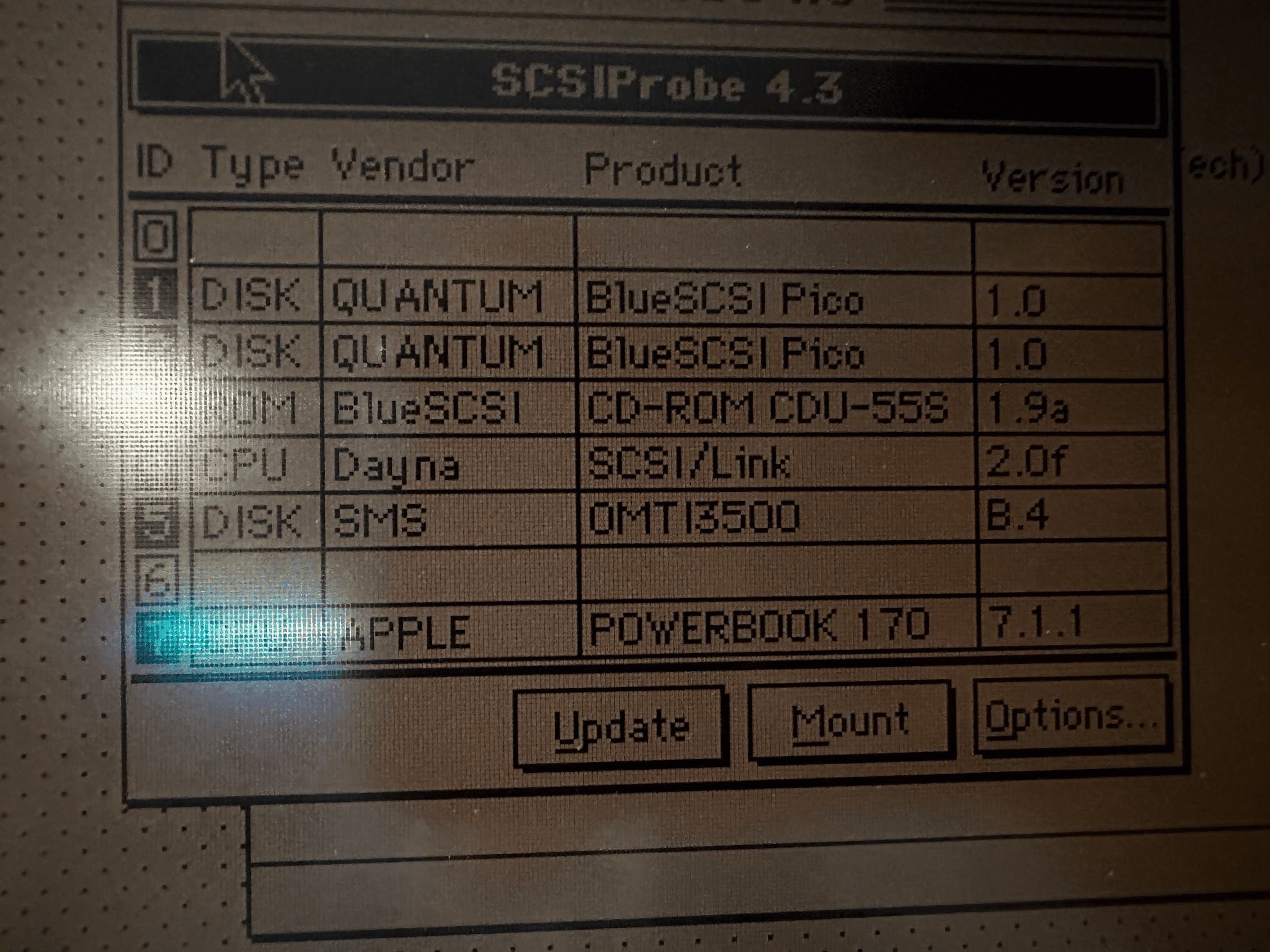

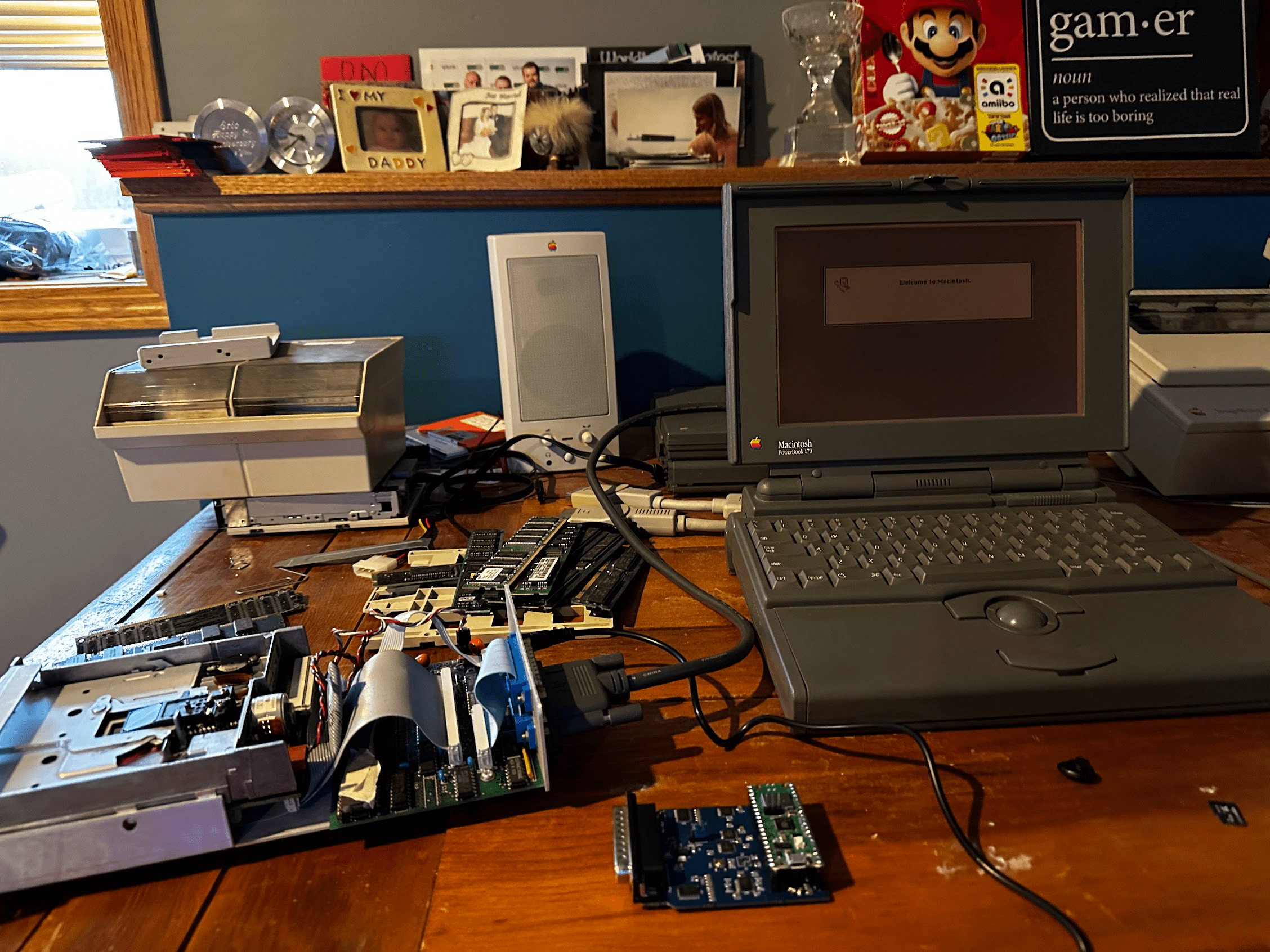

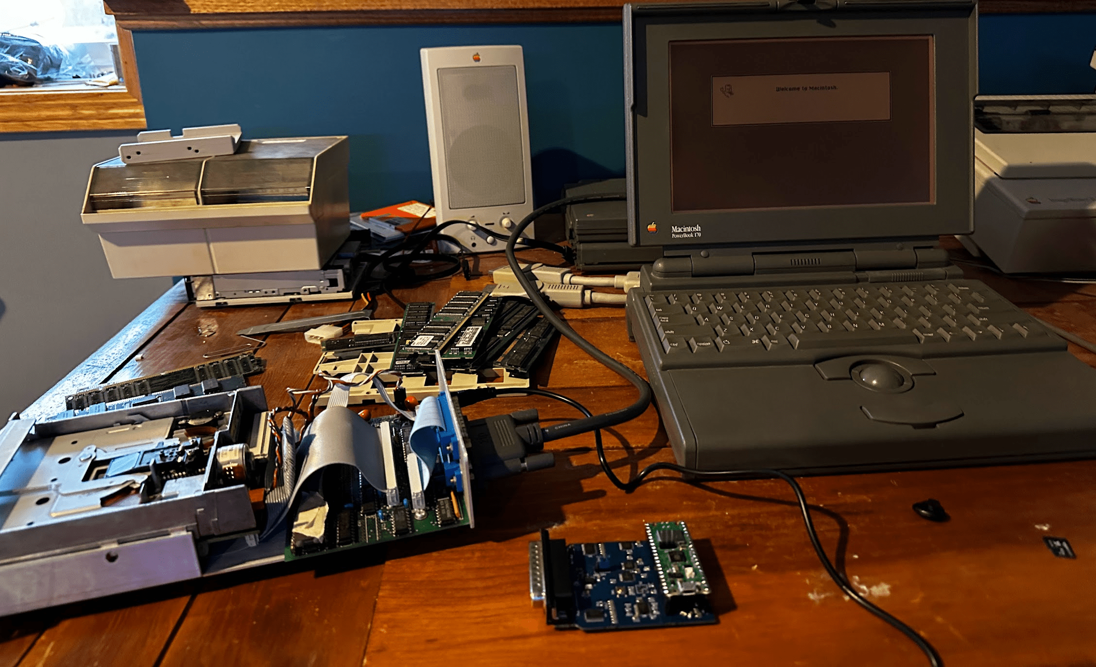

Booting From a System 7 Disk on my PowerBook 170 (just what I had setup on my test bench at the time):
Identifies as a DISK type - (ID5) - which is a bit odd - thought it would be a removable:

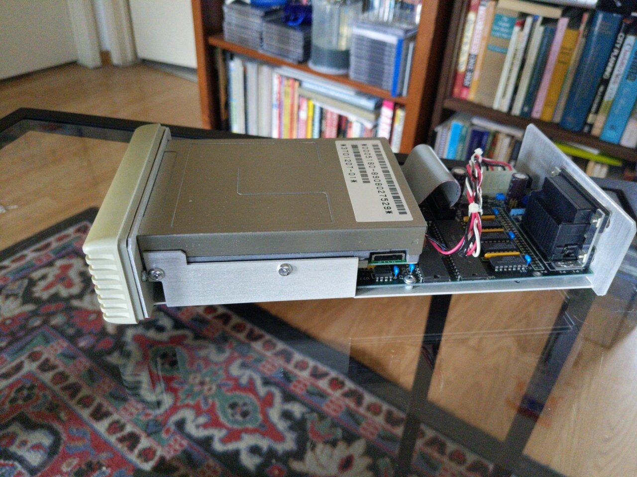

It uses a run of the mill PC Floppy drive so no 800k support (though 720k should work, haven't tested yet)

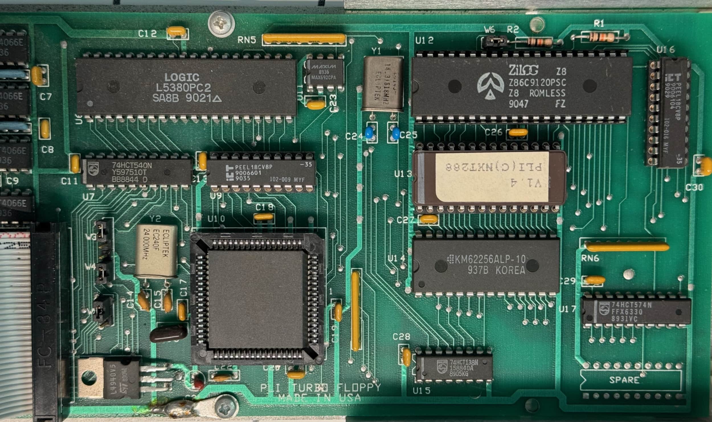

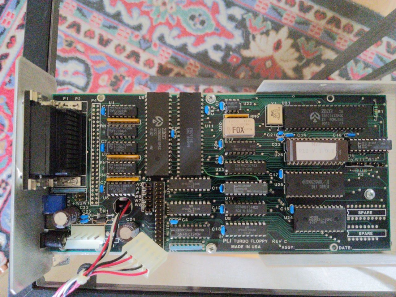

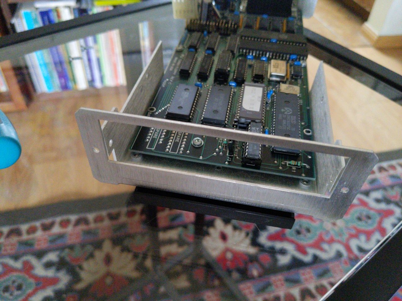

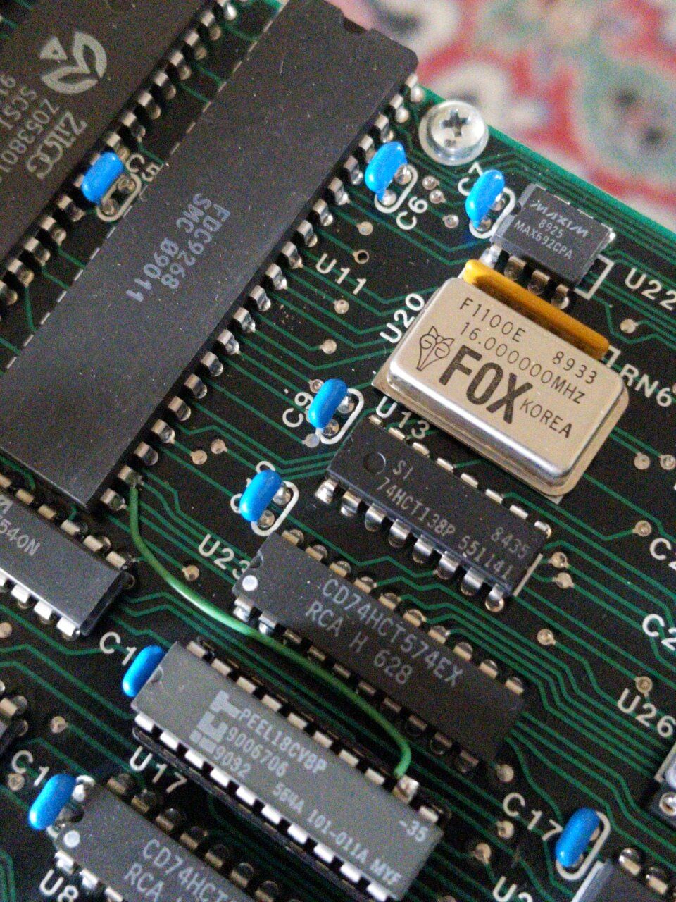

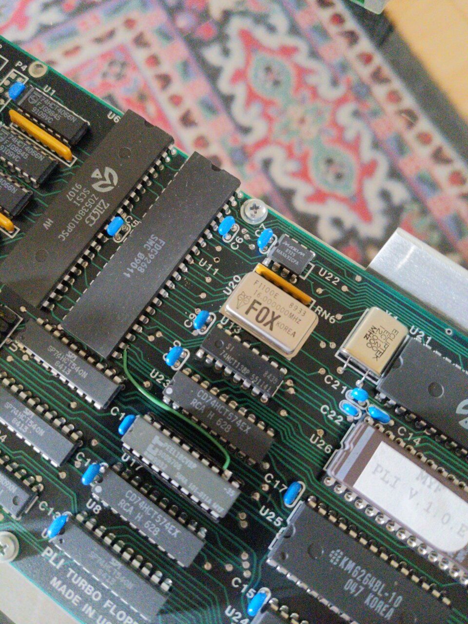

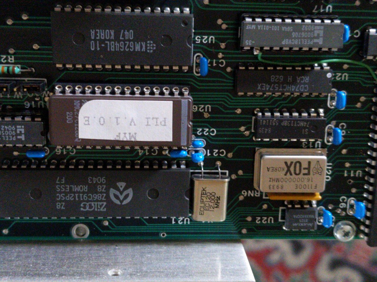

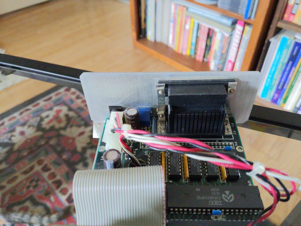

But where this gets really interesting is in the way it works - there are 2 ROMs chips on the floppy to scsi adapter board (which I've dumped) that contain a SCSI Driver and Apple Partition headers - well one does - the other one is 99% blank besides a PLI vendor string. This means if we can extract and craft the Partition in such a way we could inject it into a disk - a BlueSCSI could boot a 1.44 Macintosh Floppy image!
While that is cool - there really isn't a TON of benefit here besides academic - you could just as easily create a 1.44mb HFS HDD image and get the same results.
What I need your help in is to find some sort of copy protected 1.44 disk image that would only work from a "real" floppy/floppy drive to test if there's any benefit to perusing this further!
Note I'm only talking about 1.44 disks now - but once we get the drive/driver working in emulation we could likely adjust the size for 800k disks.
The last interesting part here is there seems to be copy protection on the ROMs themselves - after they load the Floppy driver into memory it blanks out all the driver/partition data - so when you try to do a raw read of the SCSI device where the disk driver and partition would be - it's just a bunch of `0xF6`
Interesting? Yes! Any real practical use? Who knows. But that's not why we're here - we're here to tinker :)
Lastly I'd really like to find the manual as well - I haven't been able to determine the correct way to swap disks.

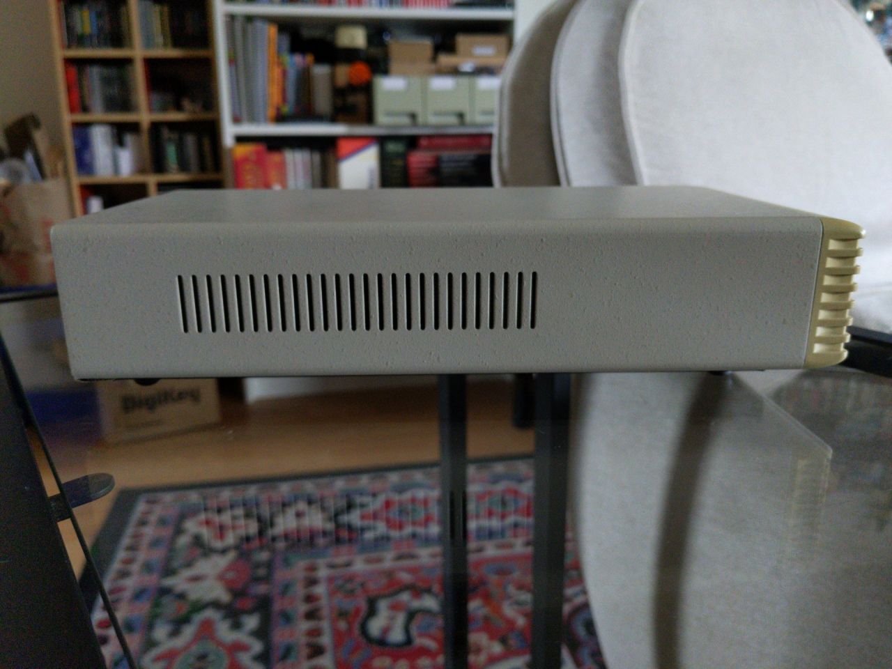

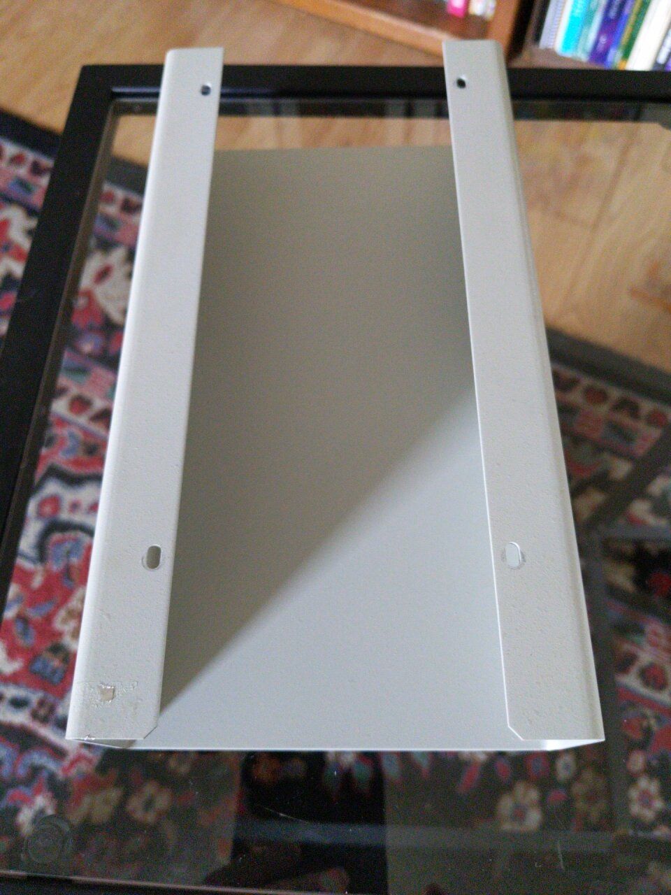

A few more notes:
1) There are two different products from PLI called "SuperFloppy":
- A platinum SCSI device, with presumably a standard 1.44 drive capable of reading both MFM (1.44M) and GCR (400k and 800k) disks.
- A black SCSI device, with a Sony 2.88 drive using a combined data and power cable - very similar if not identical to a Sony IBM part. This drive cannot read 800k or 400k disks as they would be GCR.
2) The PLI "TurboFloppy" is also a platinum SCSI device, with support for only MFM disks: 1.44M Mac and PC, and 720k PC.
Note that in the below ad, "SuperFloppy" is a misnomer for Apple's "SuperDrive", also known as FDHD, that PLI is both competing with and offering compatibility with for pre-FDHD machines. It has nothing to do with the later PLI SuperFloppy.
PLI eventually started using the term "SuperFloppy" for one of their own products, of course:
The Mac SuperFloppy was a good deal more expensive than the TurboFloppy due to the more advanced drive (versus the commodity MFM device):

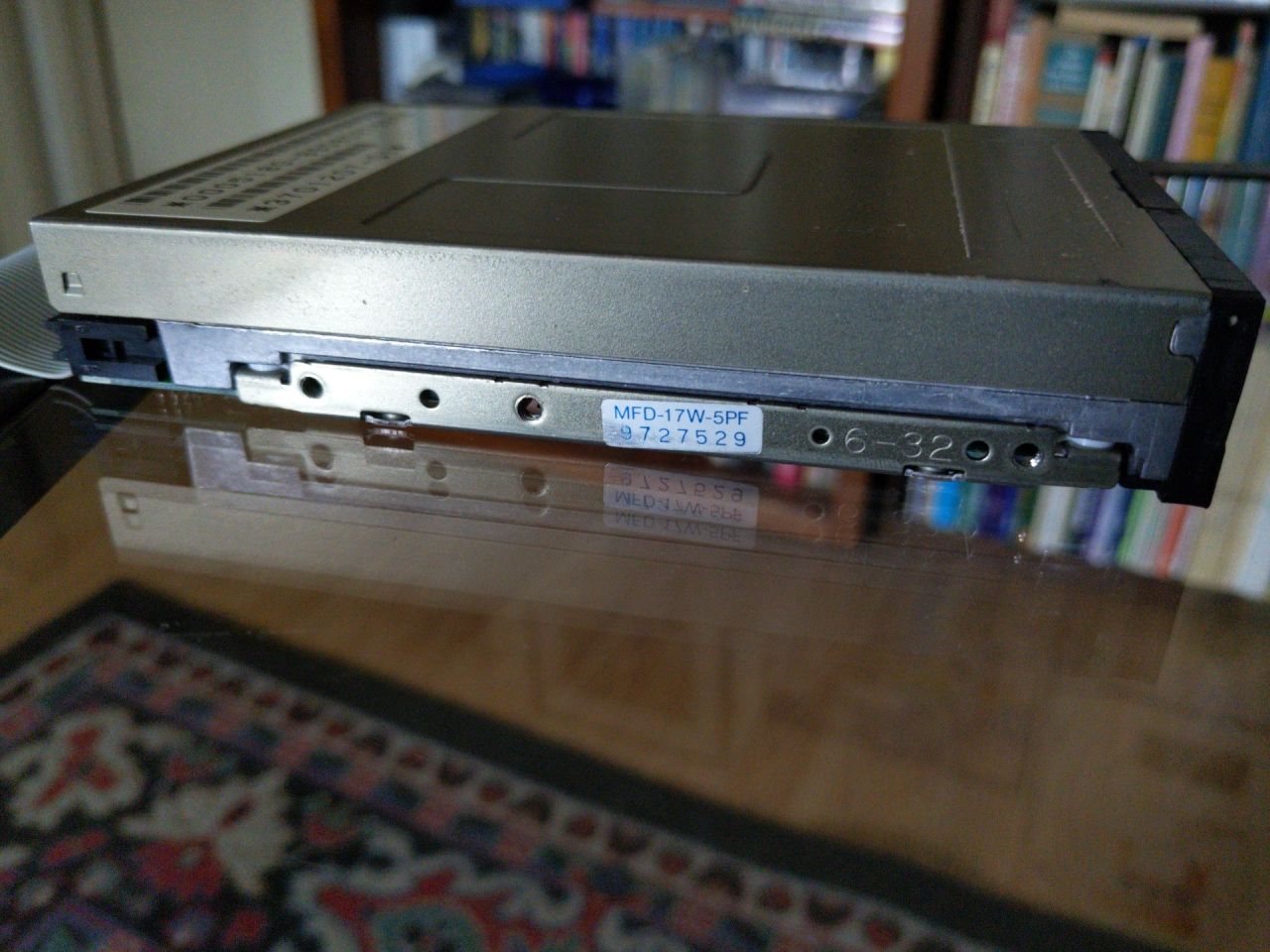

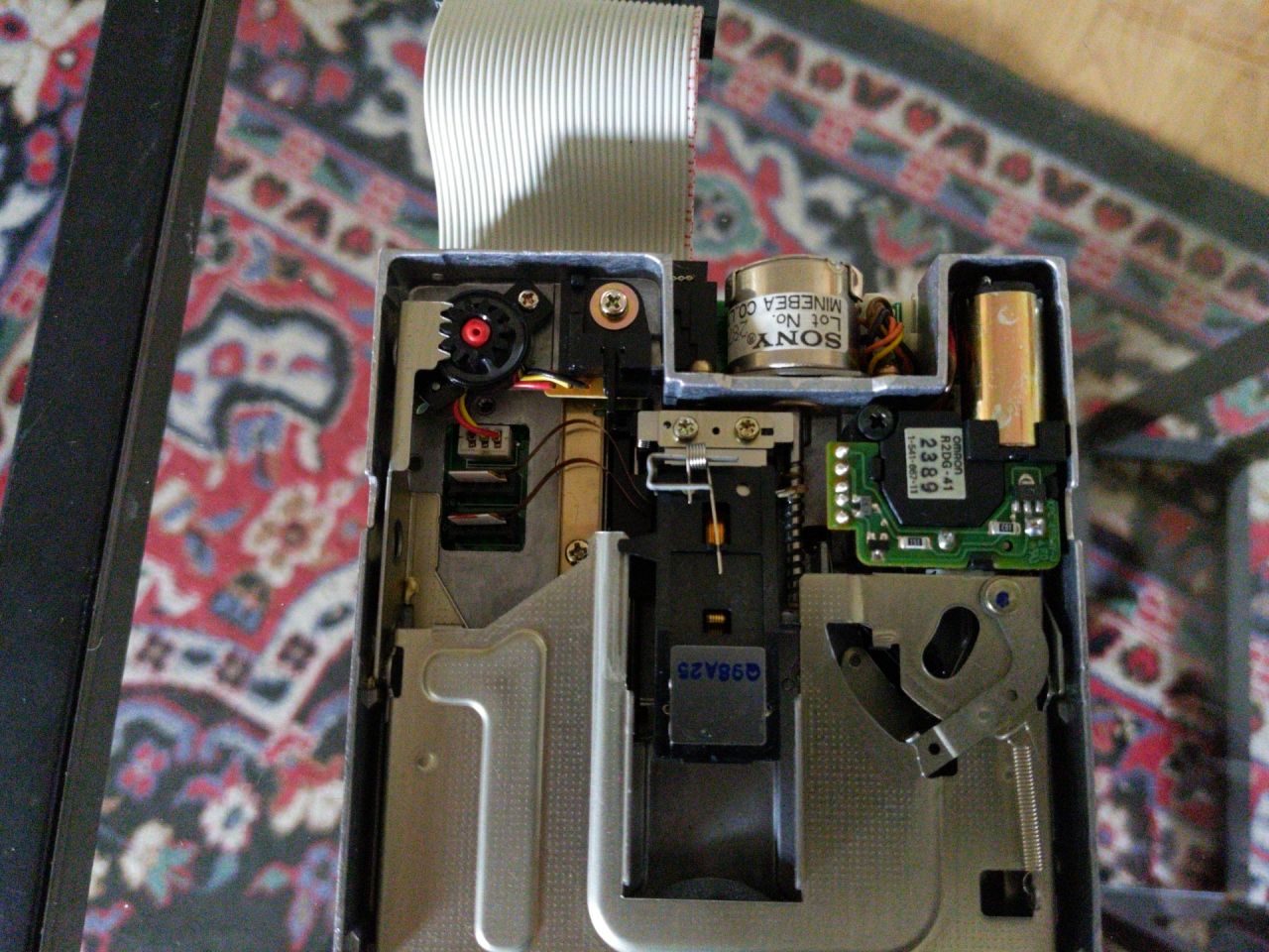

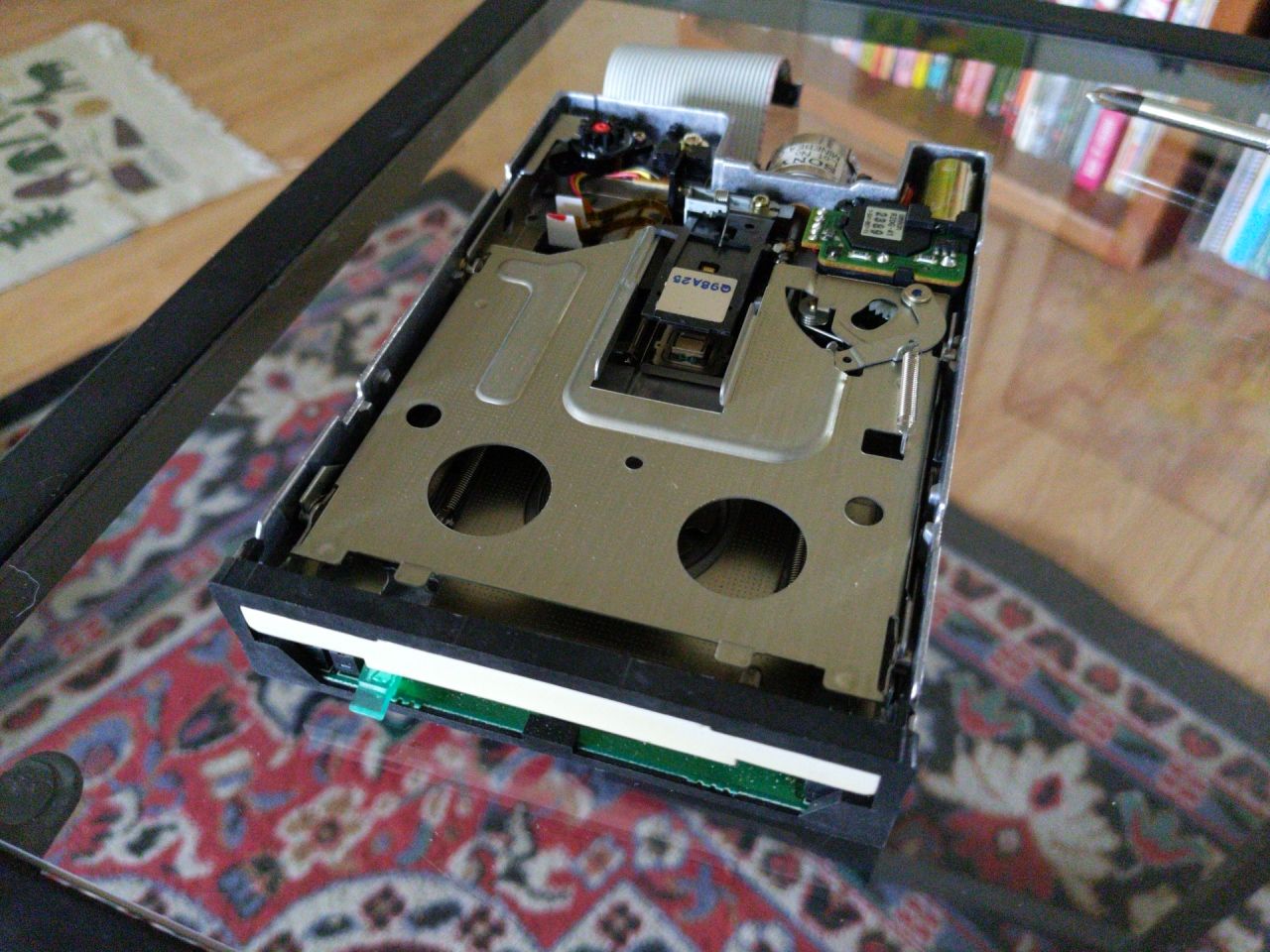

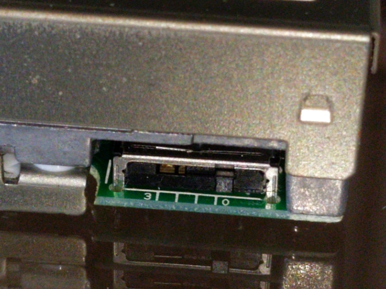

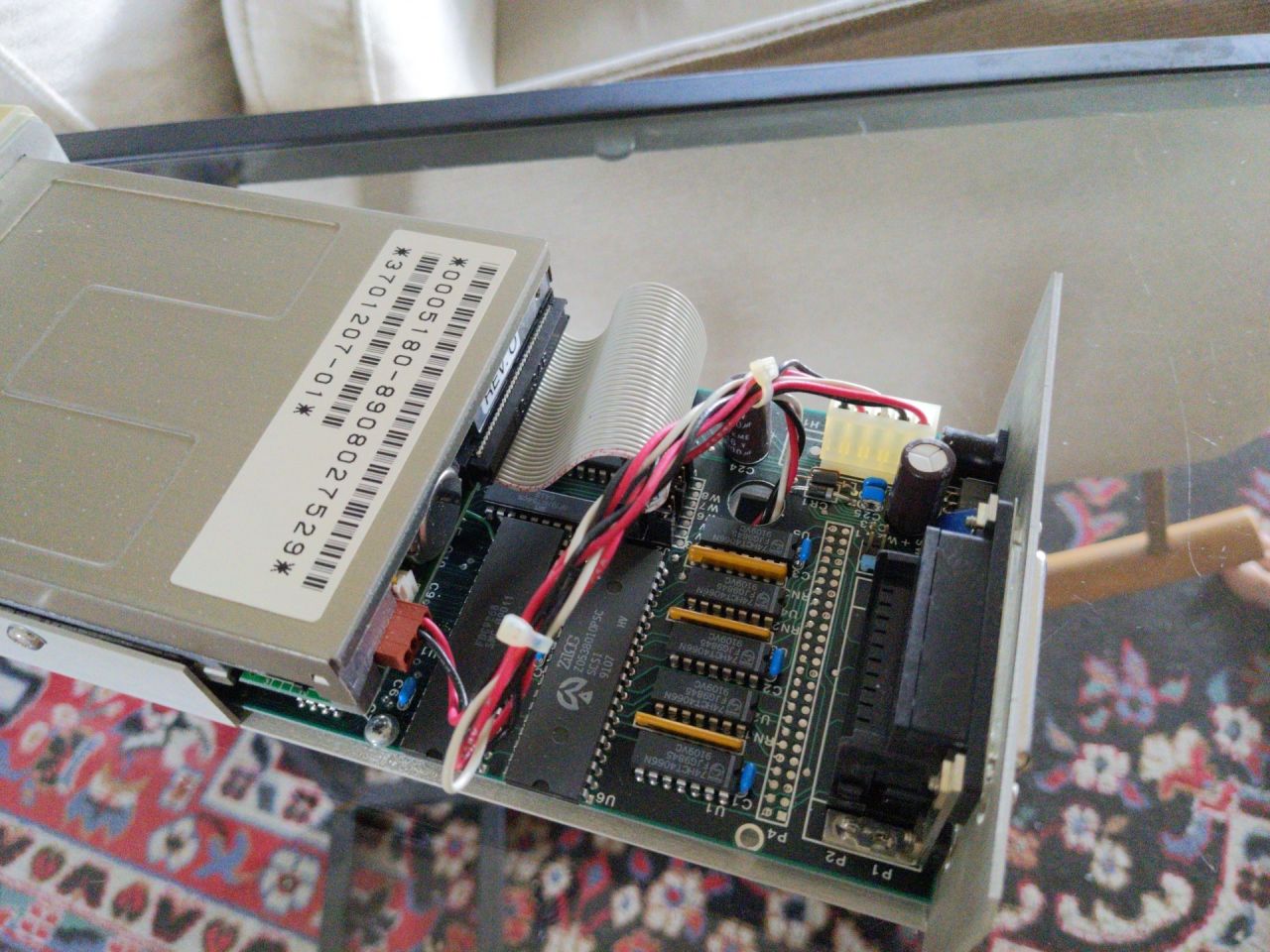

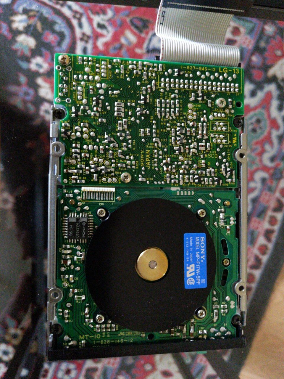

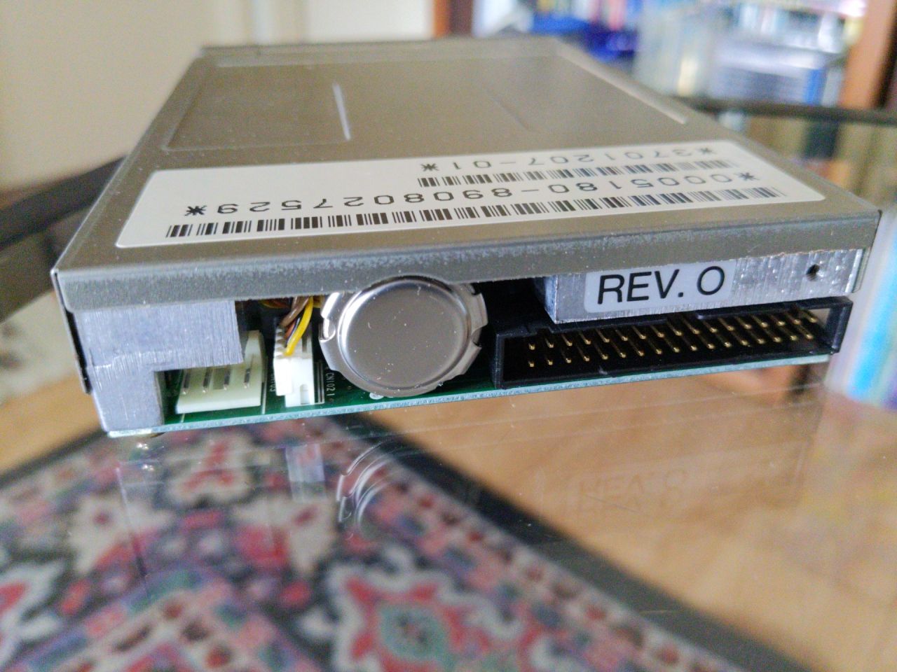

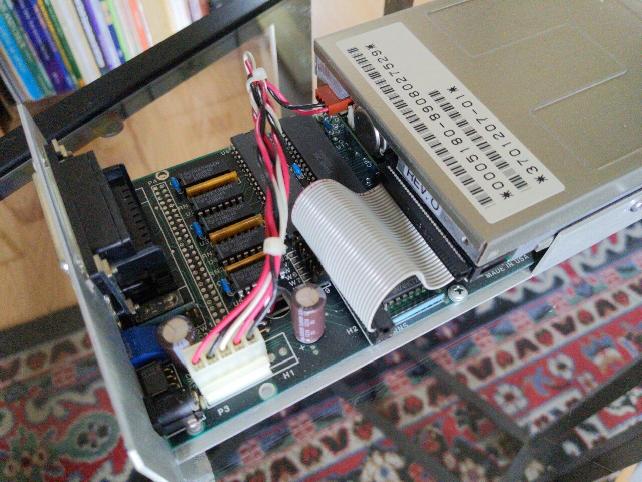

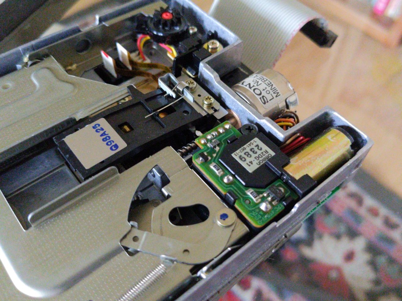

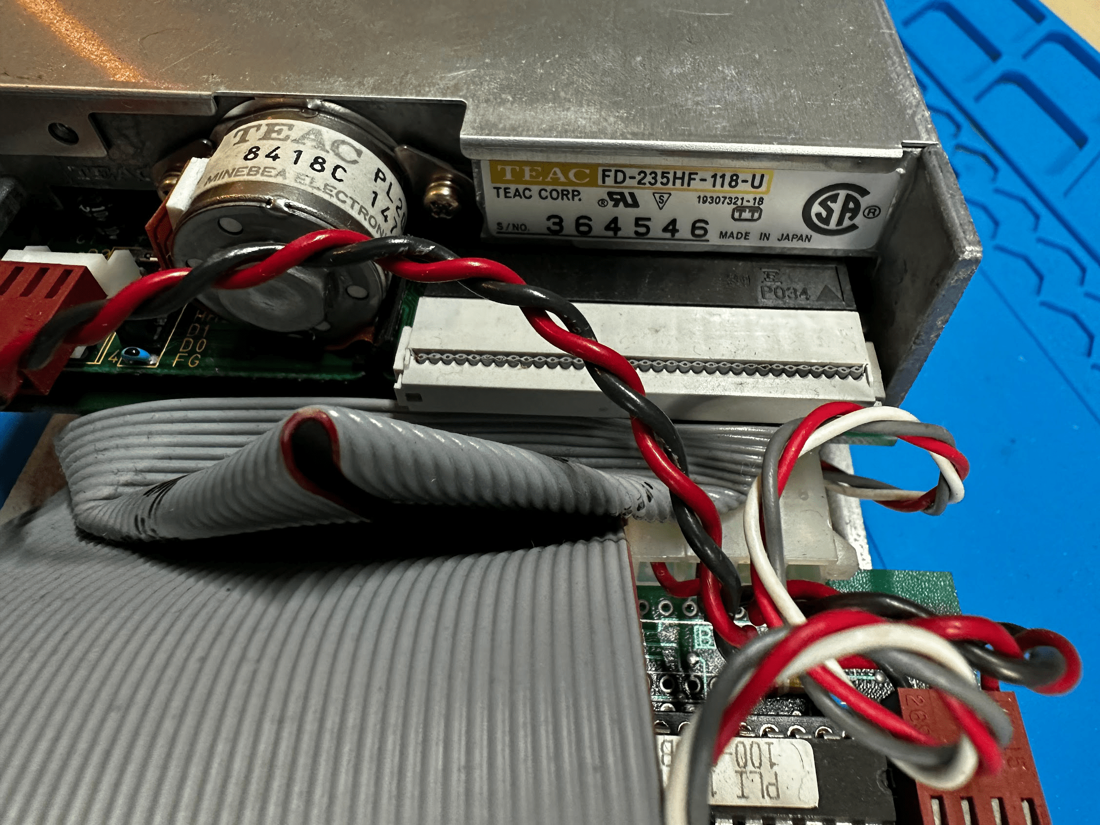

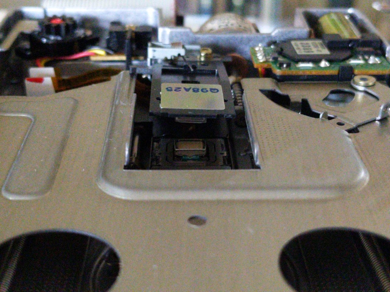

OK, back to the black NeXT "SuperFloppy". The drive inside mine is a Sony MP-F40W-1Y (spindle label) and/or MFD-40W-1X (side label). A front LED header is unpopulated, as is the space for a regular power connector at the back. (Some IBM PS/2 2.88M drives did have an activity light).

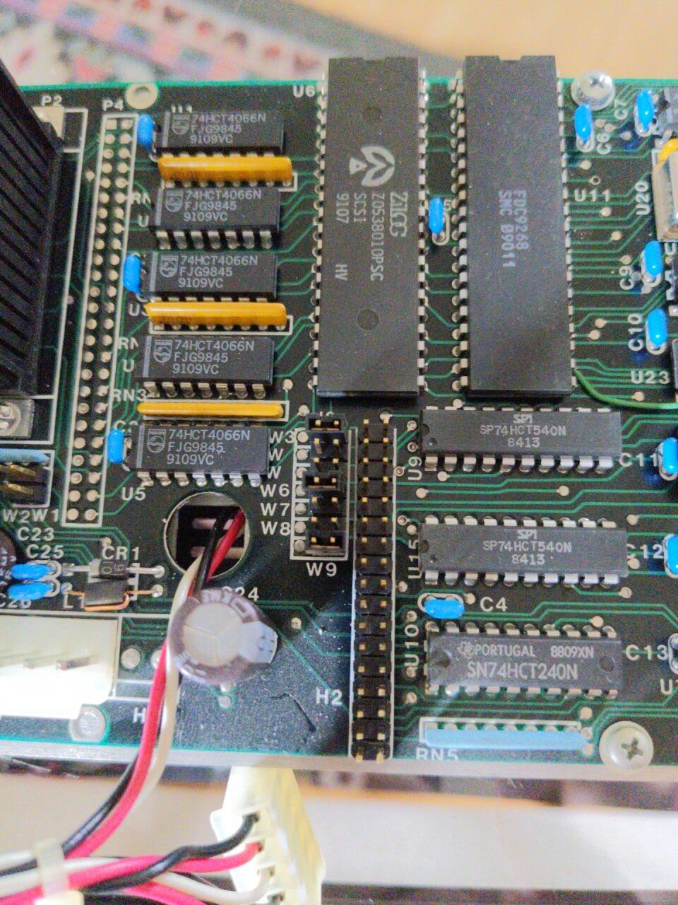

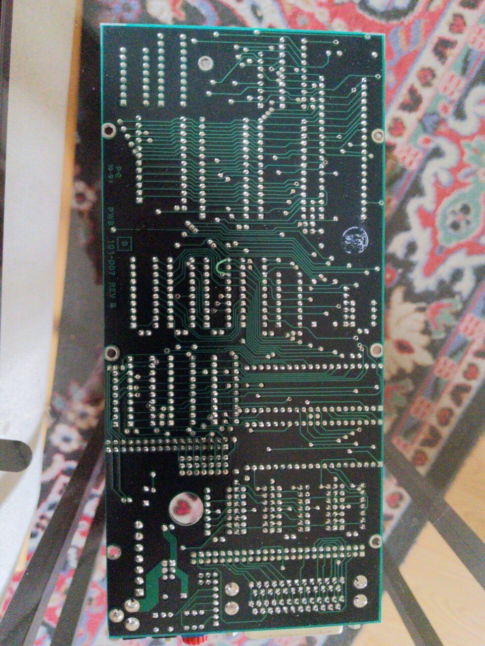

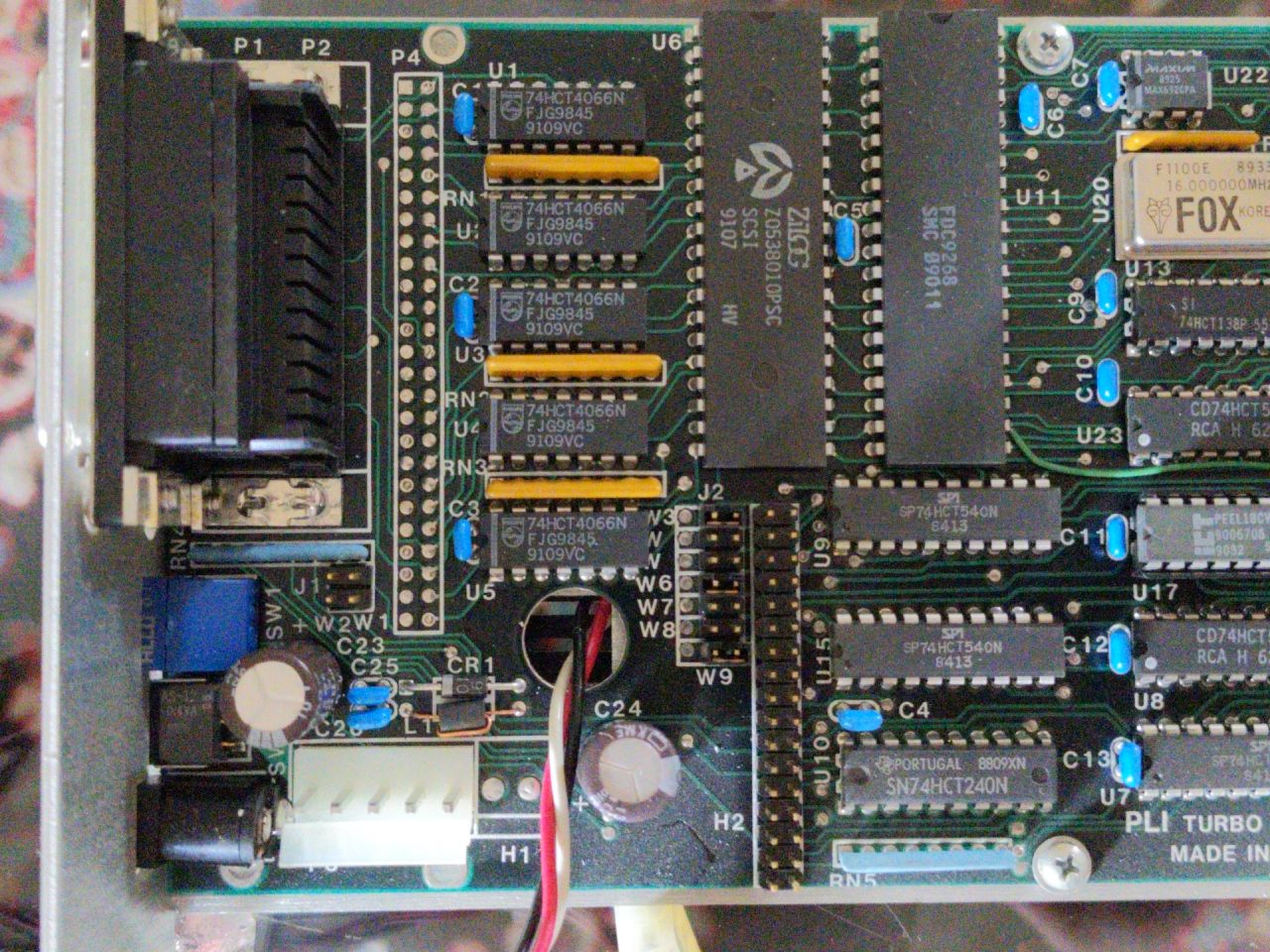

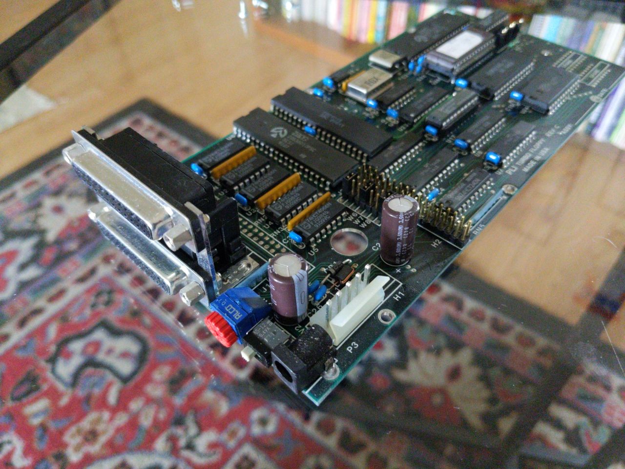

Here is a shot of the SCSI bridge board:
I'm happy to try and dump the ROM if someone can recommend the right equipment.
Reactions: eric
I dumped mine with a ti866+, just got a no name one on Ali express with a bunch of adapters for not too much money - would be interesting to compare with the Turbo Floppy.

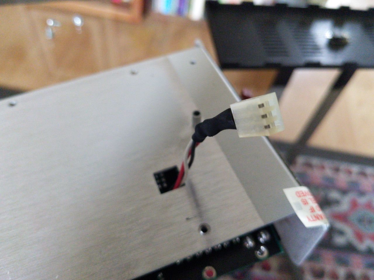

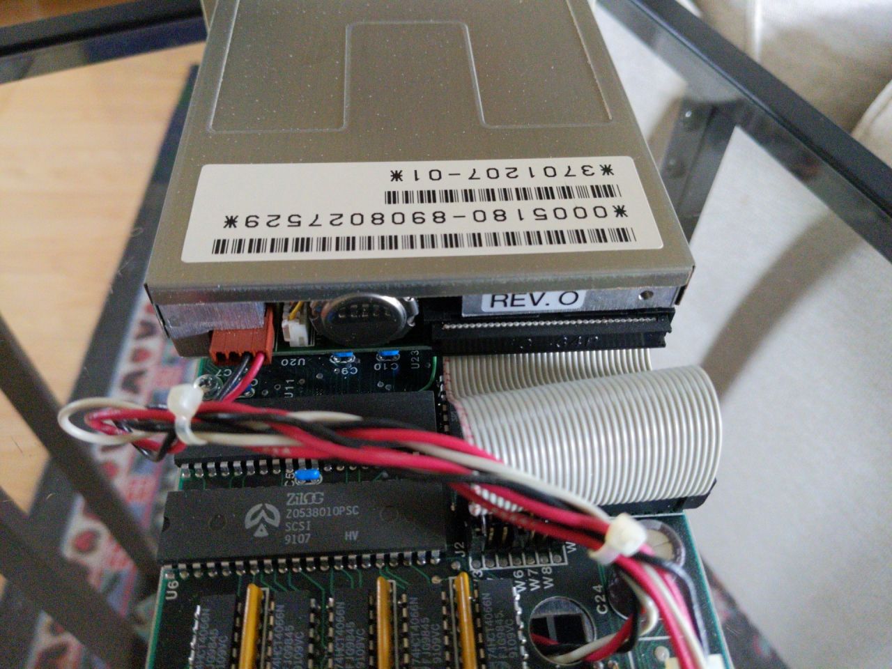

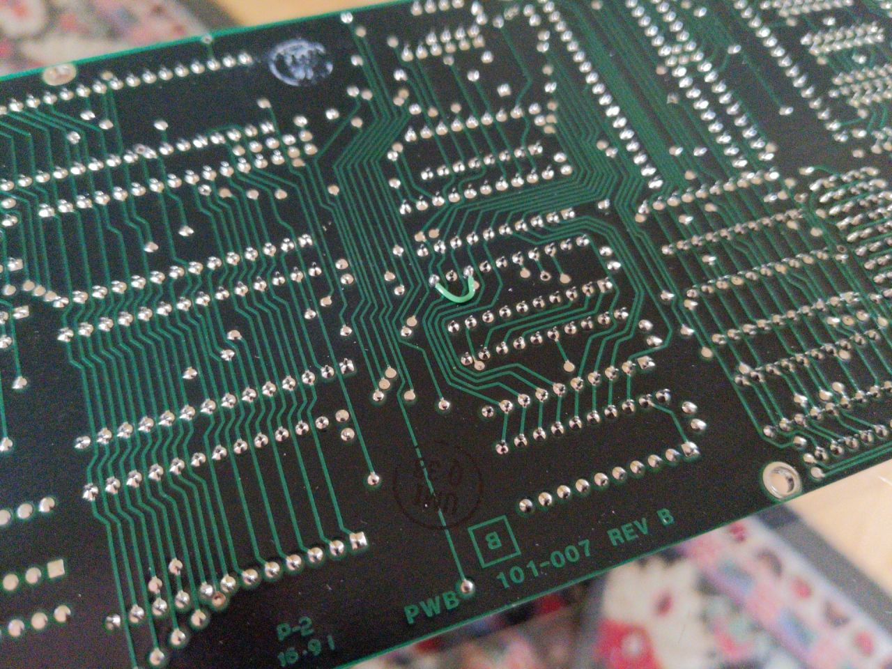

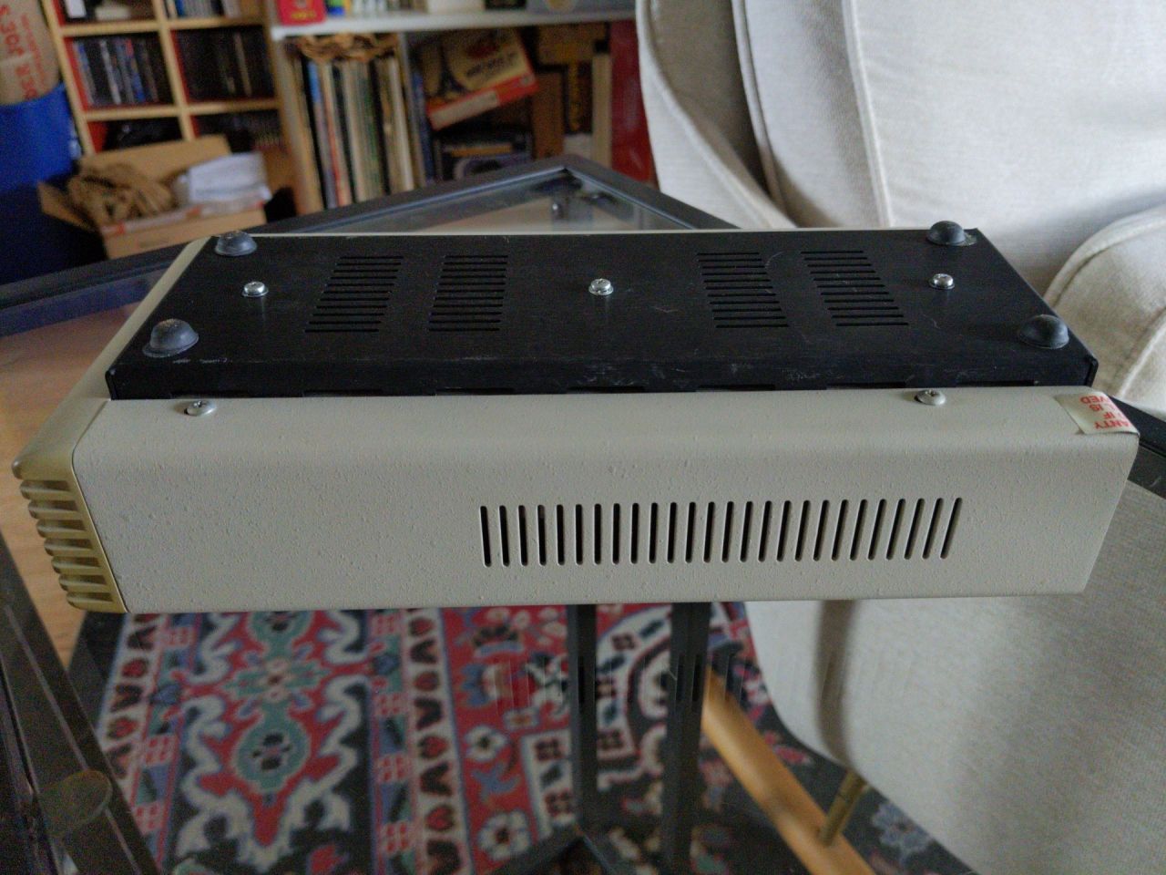

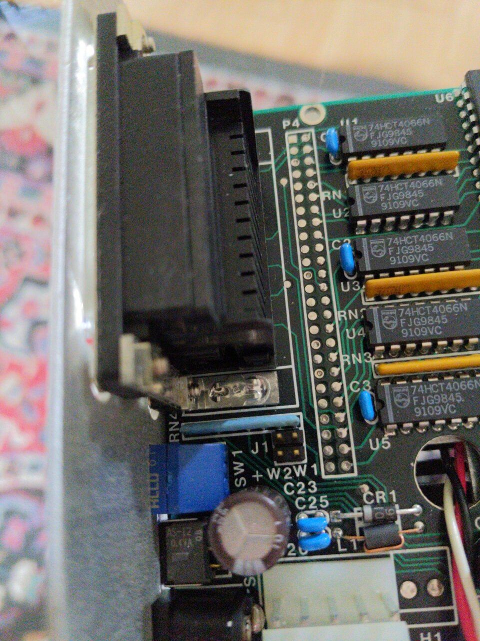

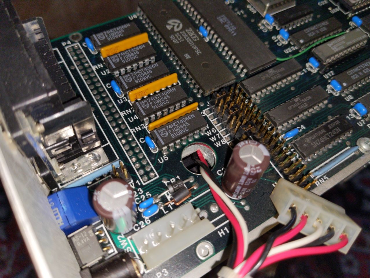

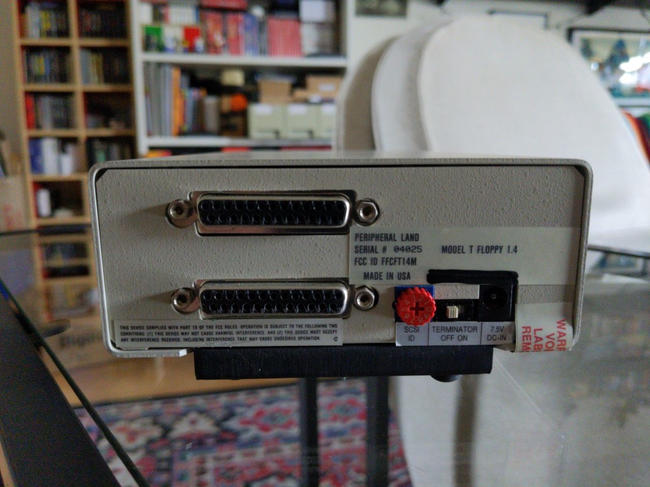

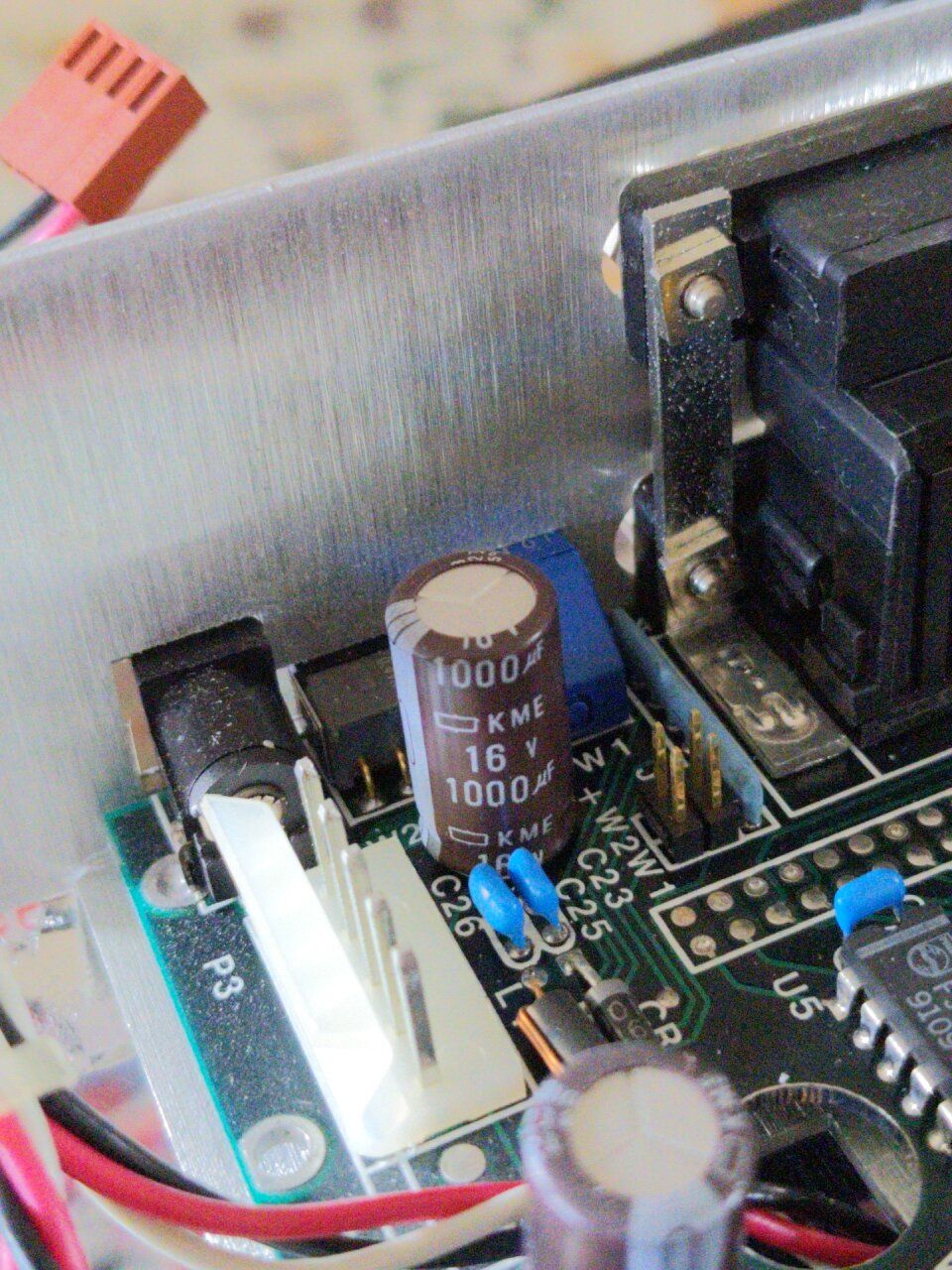

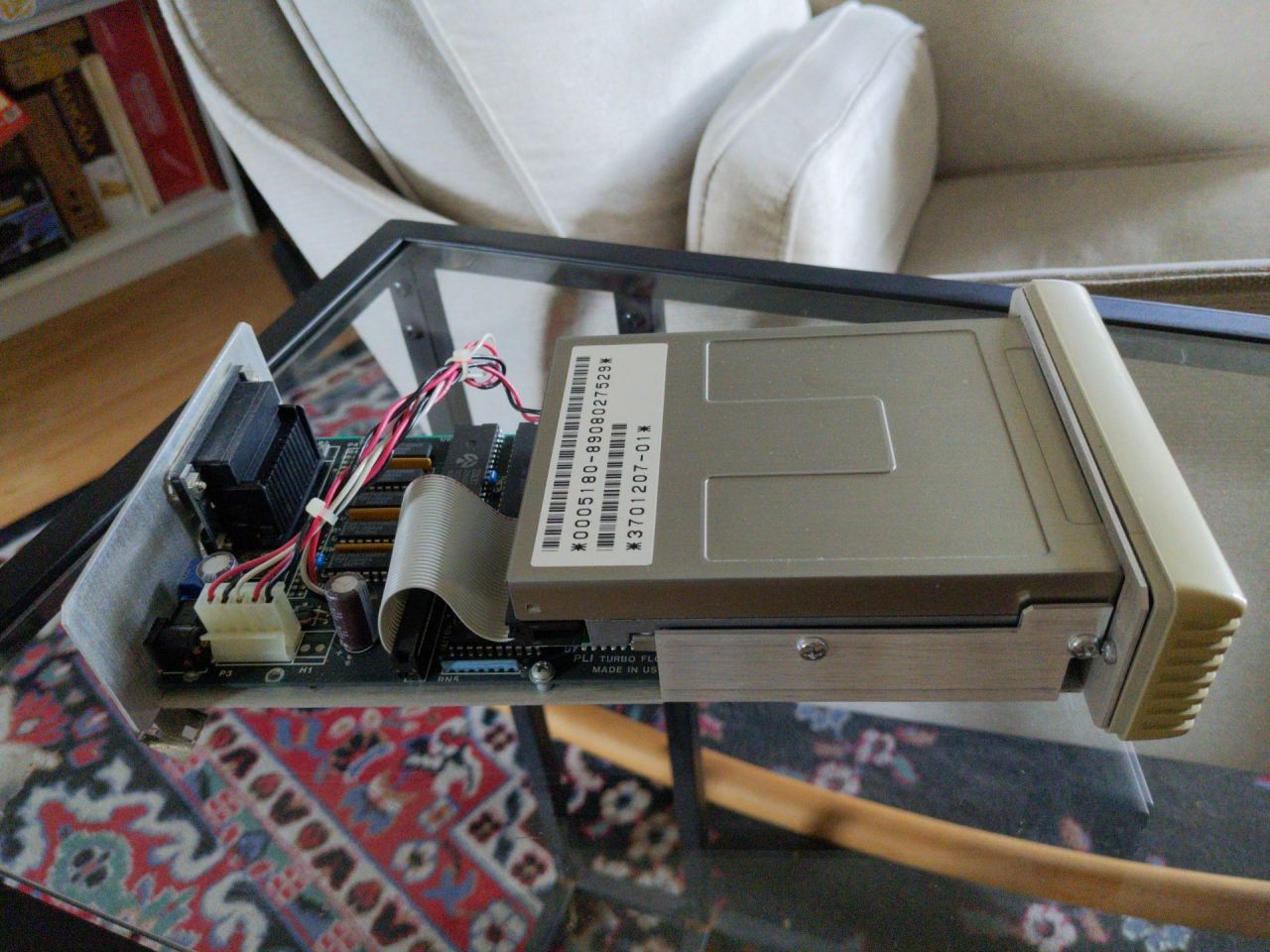

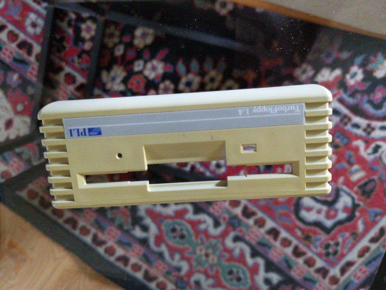

@eric Just got mine in. Before I do any testing, can you confirm the power settings you're using? Mine says 7.5VDC, but doesn't specify polarity or Amps (and of course didn't come with a power brick). I'm assuming center-positive and 1 Amp or so should be fine?

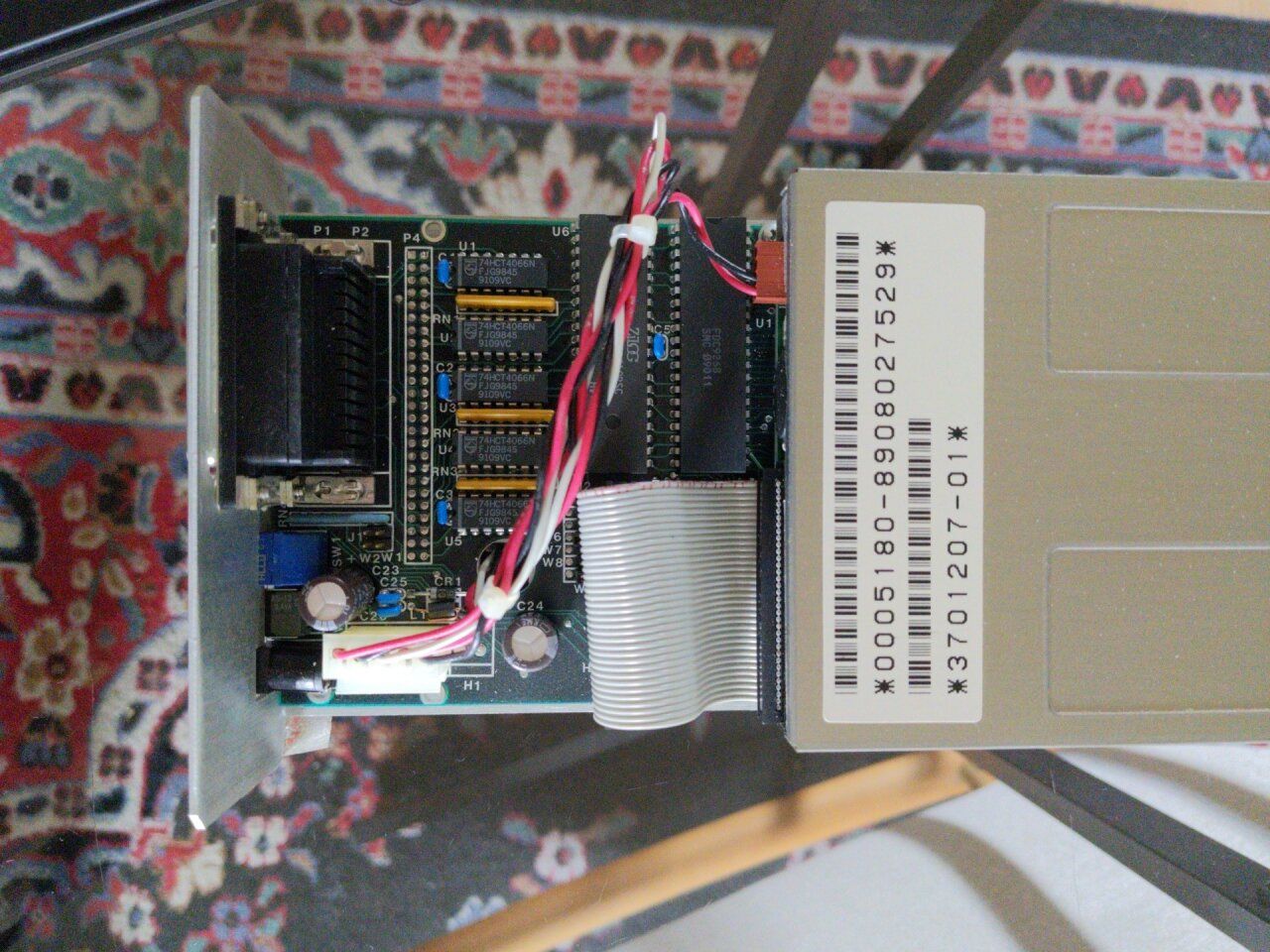

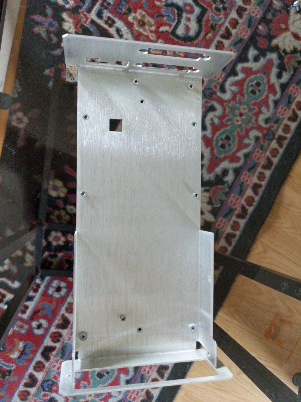

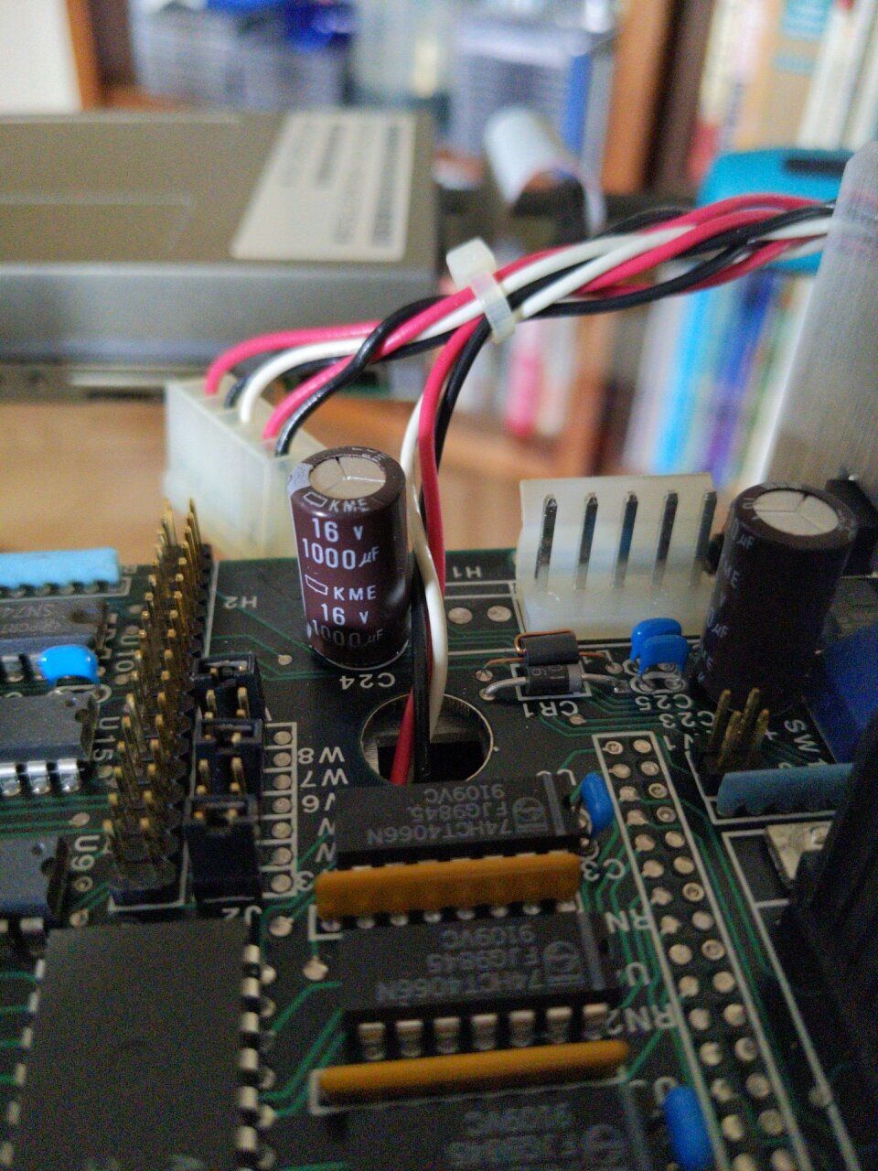

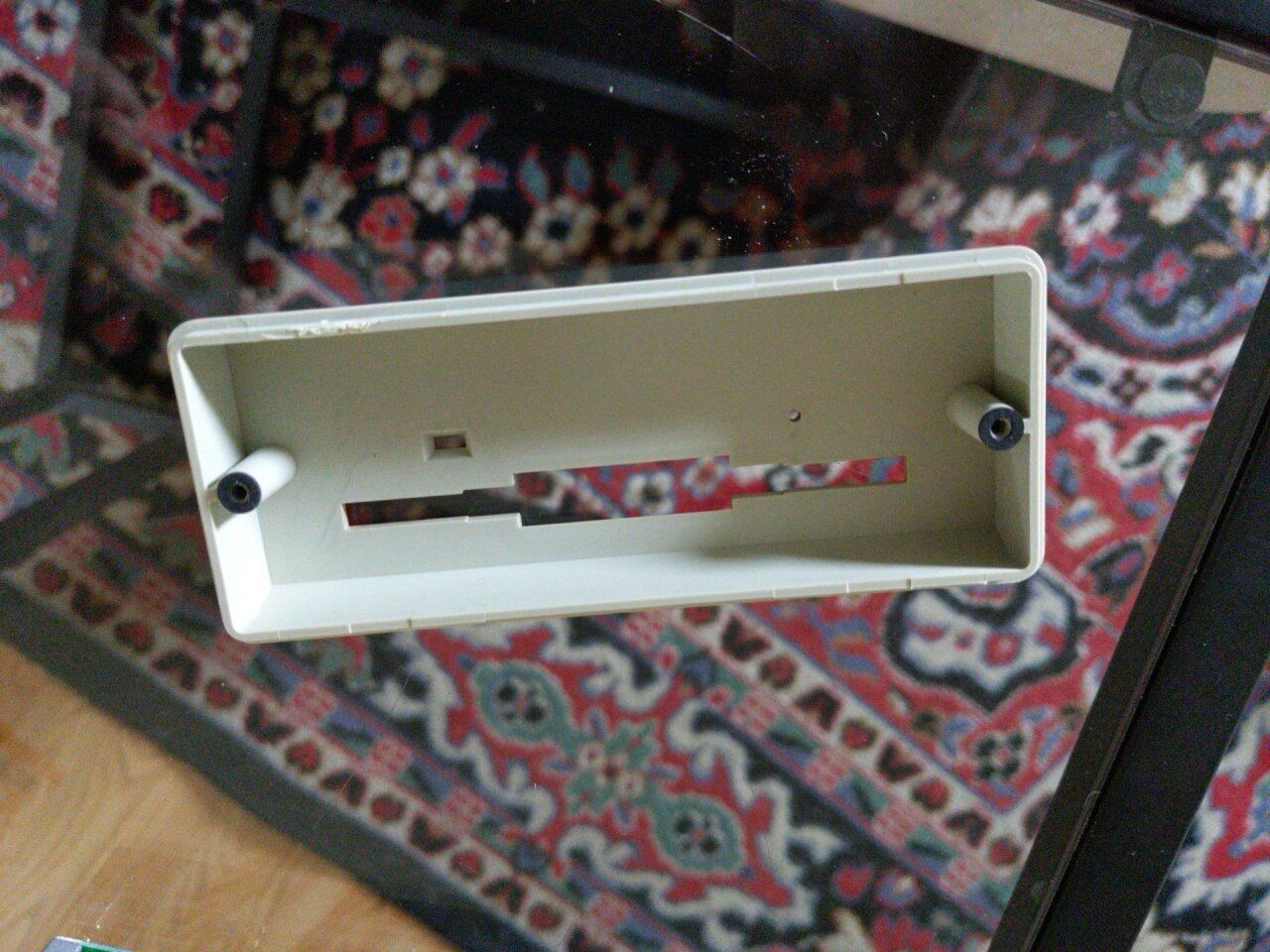

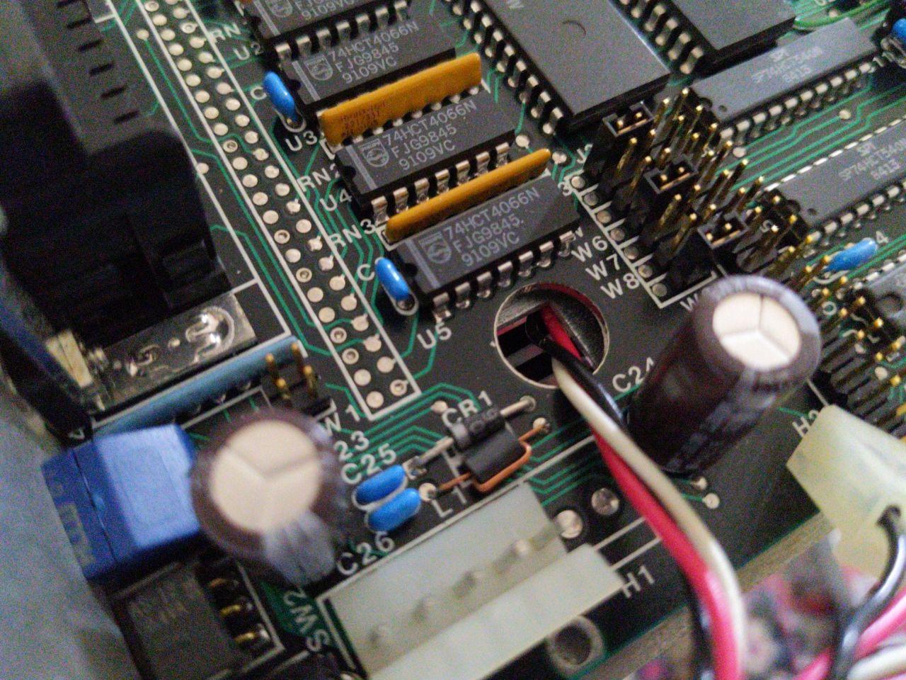

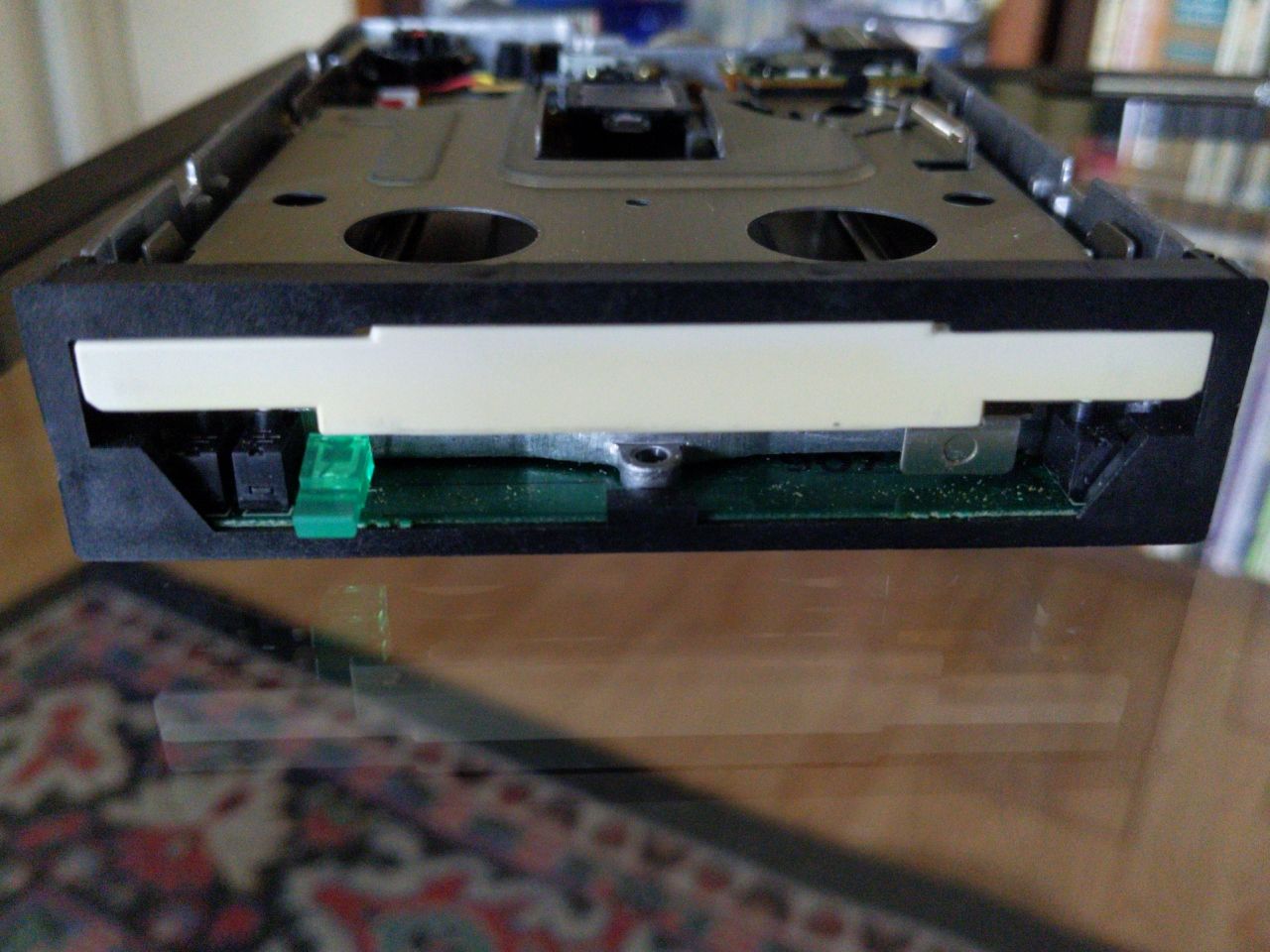

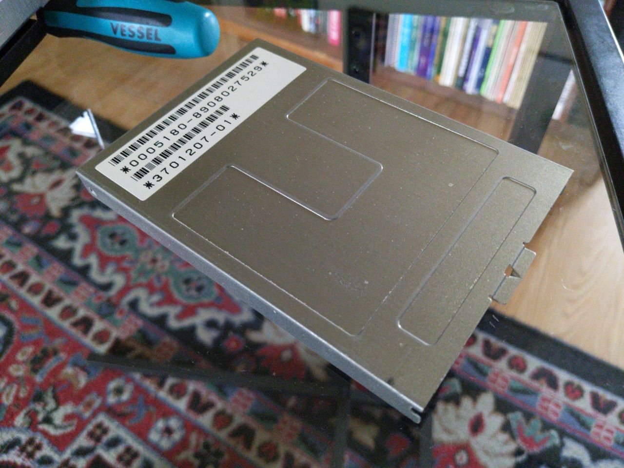

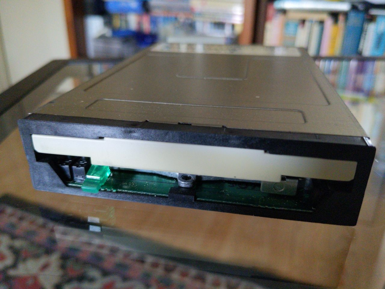

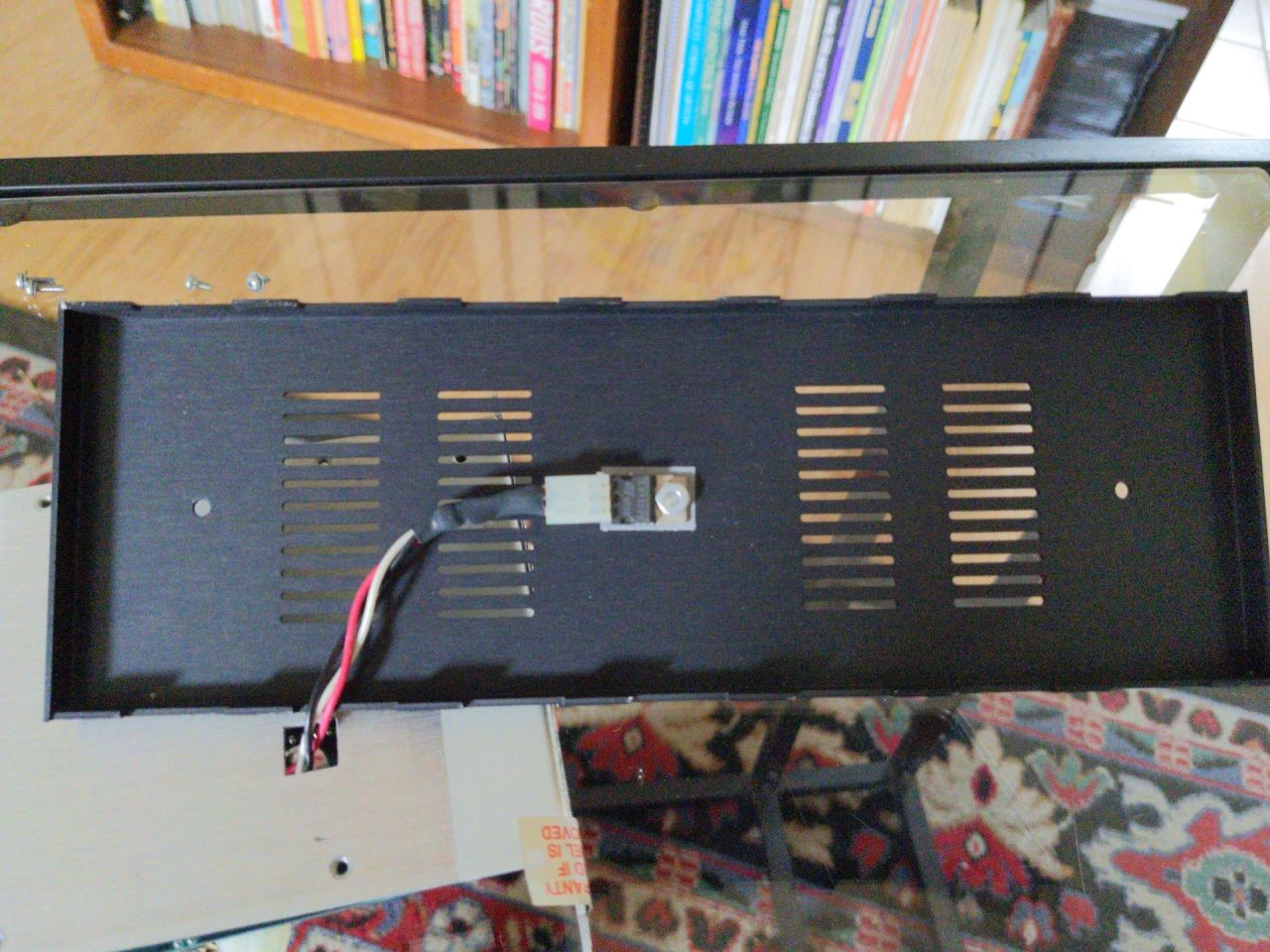

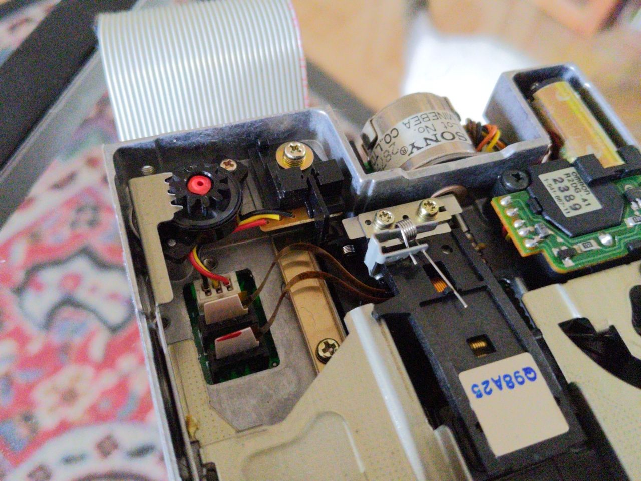

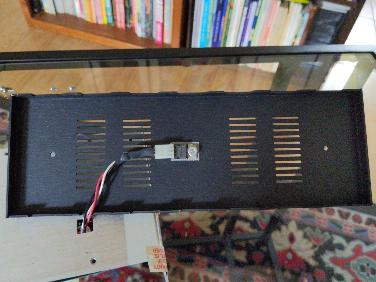

PS, some photos for people to enjoy!
I’ll be home tomorrow afternoon cst and will look
Reactions: lilliputian
It would be very cool if this drive was reverse-engineered and new ones built. 1.44MB floppies on a Plus? The PEEL 18CV8P programmable logic chips used are supported by afterburner but are most likely read-protected and will need a special technique to dump them.
As for the EPROM you can dump it with the TL866 thing everybody talks about, I use the Relatively Universal ROM Programmer
I used this https://www.amazon.com/dp/B072L81WX8 with 7.5v 2.2a center positive, seemed to work well.
It would be great, especially since it appears to be a pretty bog standard PC floppy drive. I have a TL866 and am definitely planning to dump the ROM.
