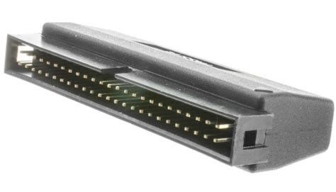

Yep, the hard drive's terminated, the optical's not. If you want to eliminate the HDD, you'll need something like this in its place:
IDC50M SCSI Terminator
Or, install termination resistors onto the board of the CD-ROM drive. I forget if the Panasonic tray loaders have the terminals for them, but I do know that the Sony caddy loaders do, next to the 50-pin connector.
