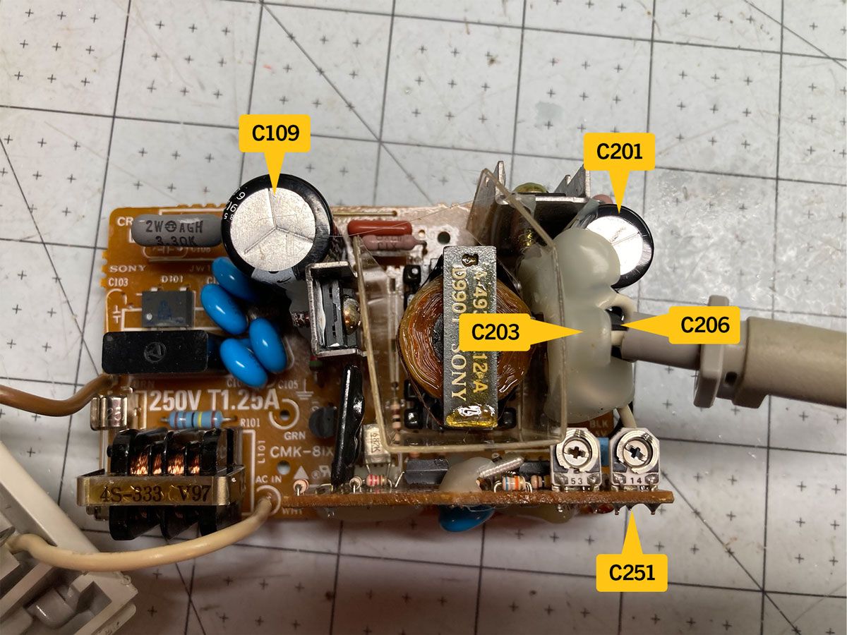

| Location | Voltage | Capacitance | Height | Diameter | Board Lead Spacing |
| C201 | 16V | 2200µF | 25mm | 12mm | 5mm |
| C203 | 16V | 330µF | 14mm | 8mm | 5mm |
| C206 | 25V | 100µF | 11mm | 5.5mm | 5mm |
| C251 (secondary side daughter board) | 50V | 2.2µF | 5.5mm | 4mm | 5mm |
| C109 (primary side) | 400V | 47µF | 25mm | 16mm | 7mm |
