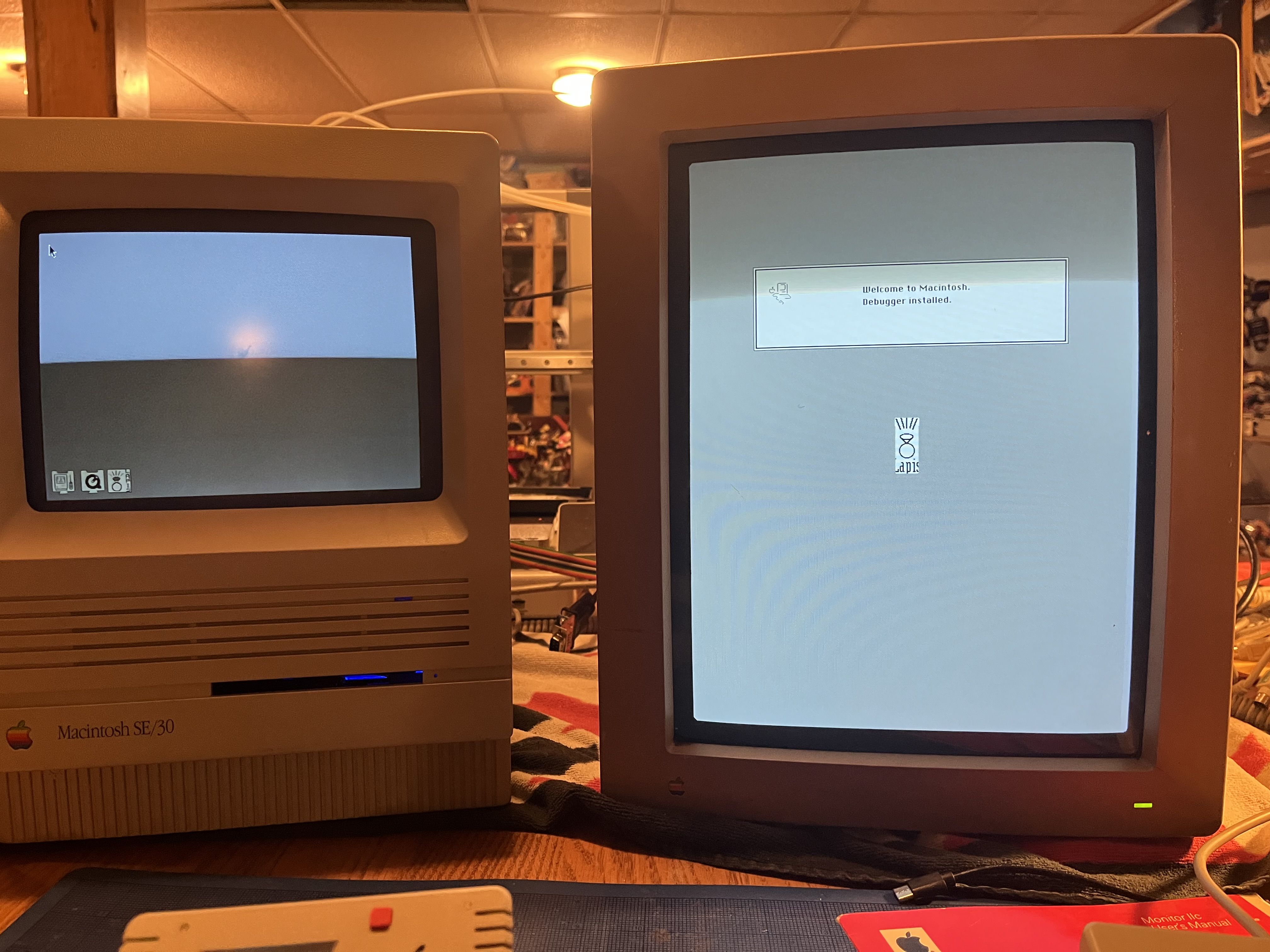

Is there anything advisable to replace on a portrait display? It’s silent and seems to run just fine, a little bit off center is all. Nice and bright with some headroom. Frankly surprised it’s in the good of shape but I want to stave off any imminent failures.
Maybe it’s better to ask what should I look out for?

I recapped mine. It was working fine before and worked fine after. Did it proactively. Found a few capacitors leaking.
Reactions: iantm
Looks like it's all be done… :)
Except I need to carefully select caps. If you happen to have an updated list, great. Otherwise I'm going to take a closer look at all of it and put together a new cart. One of the caps in the list is discontinued. One poster thought that the rating on the sweep board ones were too low.
I have relied on pre-configs kits from Console5, so selecting caps will be painful for me, but gotta learn sometime…
I'm going to work with Luke at Console5 to figure this out, and I"ll post the list when I get it
Another post has a big list, but some of them aren't available anymore, and apparently there are different revisions of this monitor tha might require something slightly different.
