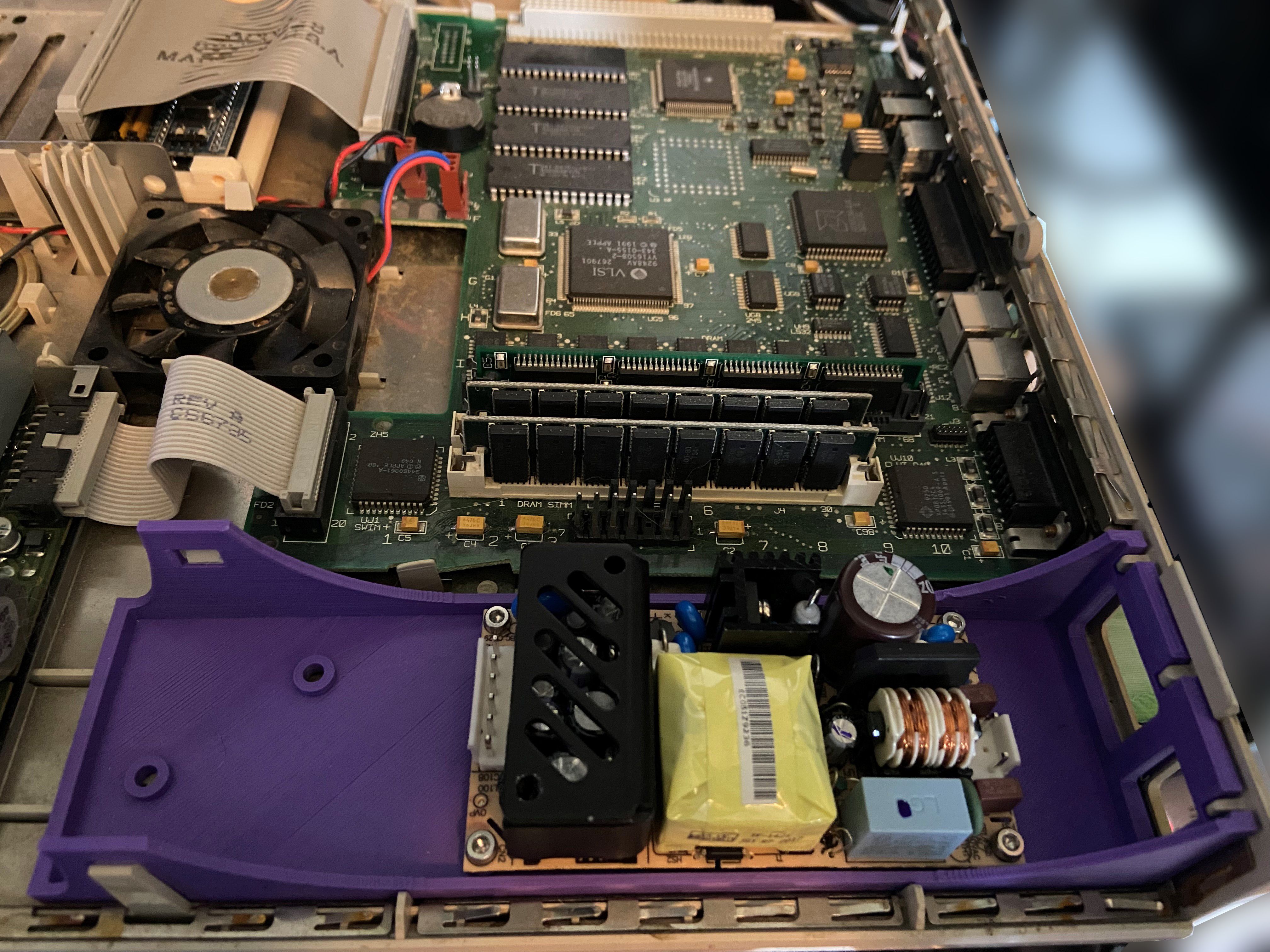

Here is some early examples of the 3d printed case

This solution doesn't technically need anything at all from the original power supply. Not the case, not the PSU to motherboard cable, nothing.
The new power supply doesn't really fit in the original supply casing, tolerances are just not large enough for it to be safe. Hence the printed bracket.
My intention is to offer probably two different options, with others available on request.
  1. A literal drop-in replacement. Power plug and switch preinstalled, all assembled and tested and ready. Pull out old supply, put in new one, done. Downside: Plug and switch are not beige. Current parts on order are black, beige ones are harder to come by.
  2. SMD parts preassembled (there are a few SMD zeners on the protection board), with all the remaining parts loose. Power plug and switch not installed, have to solder the rest of the parts together, etc. Includes the mounting bracket, of course.

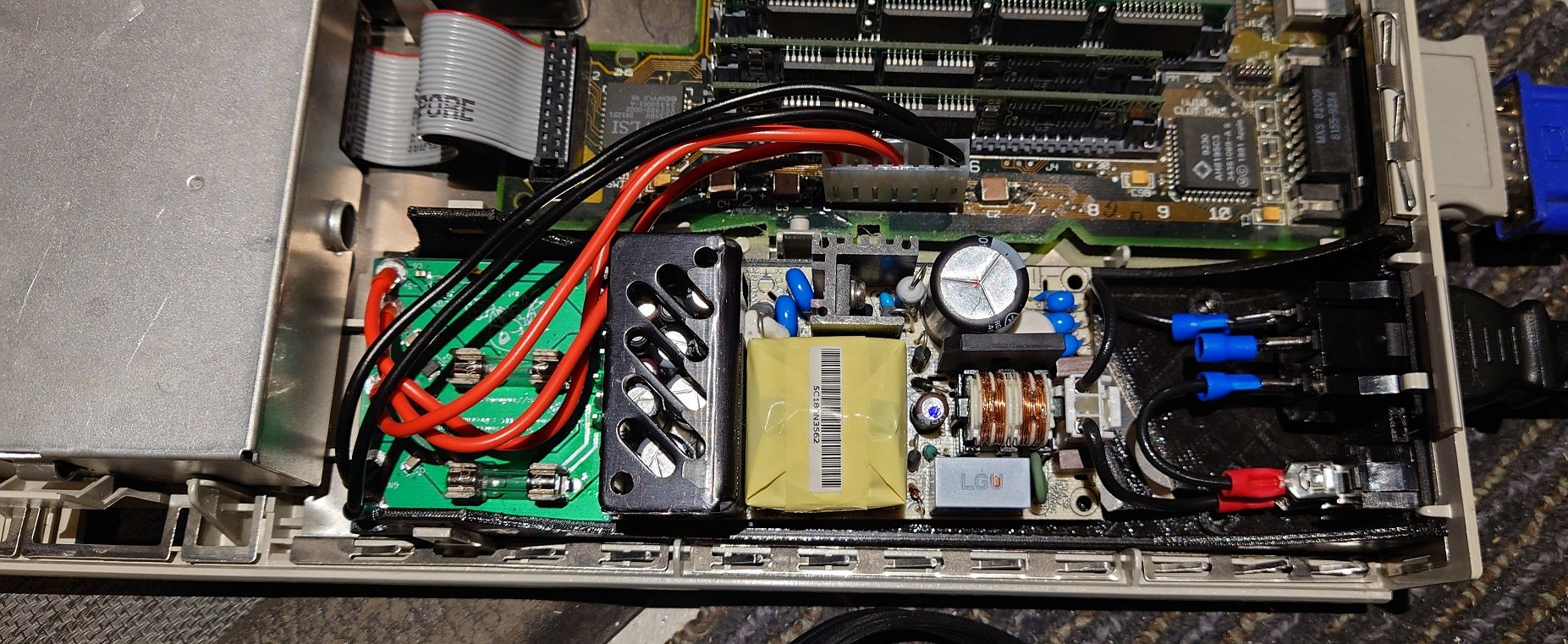

The "protection board" I mention is basically an over-voltage zener clamp on every rail (12, 5, -5), plus cartridge fuses for 5 and 12. This way (for example) if the PSU has a regulation failure and sends 12v to the 5v line "pop goes the weasel" and the zener + fuse will clamp and pop and protect the board. -5 gets a polyfuse because cartridge fuses rated that low are actually kind of expensive.

There's not a lot of accidental contact surface on the top of these power supplies, which is pretty surprising. The exposed capacitor top doesn't test as connected to either positive or negative, and most of the rest of the contact surfaces are on the bottom.
The SMD soldering will require a heat gun, because the exposed pads on the zeners are inconveniently placed on the bottom instead of the ends. Vishay SMPZ3928B-M3/84A is one of the zeners used.

Here's a picture of a test fit that I did on my LC II using spade connectors to power plug and switch. Hard soldering seems like the better idea here, given how much space the spades take up.
