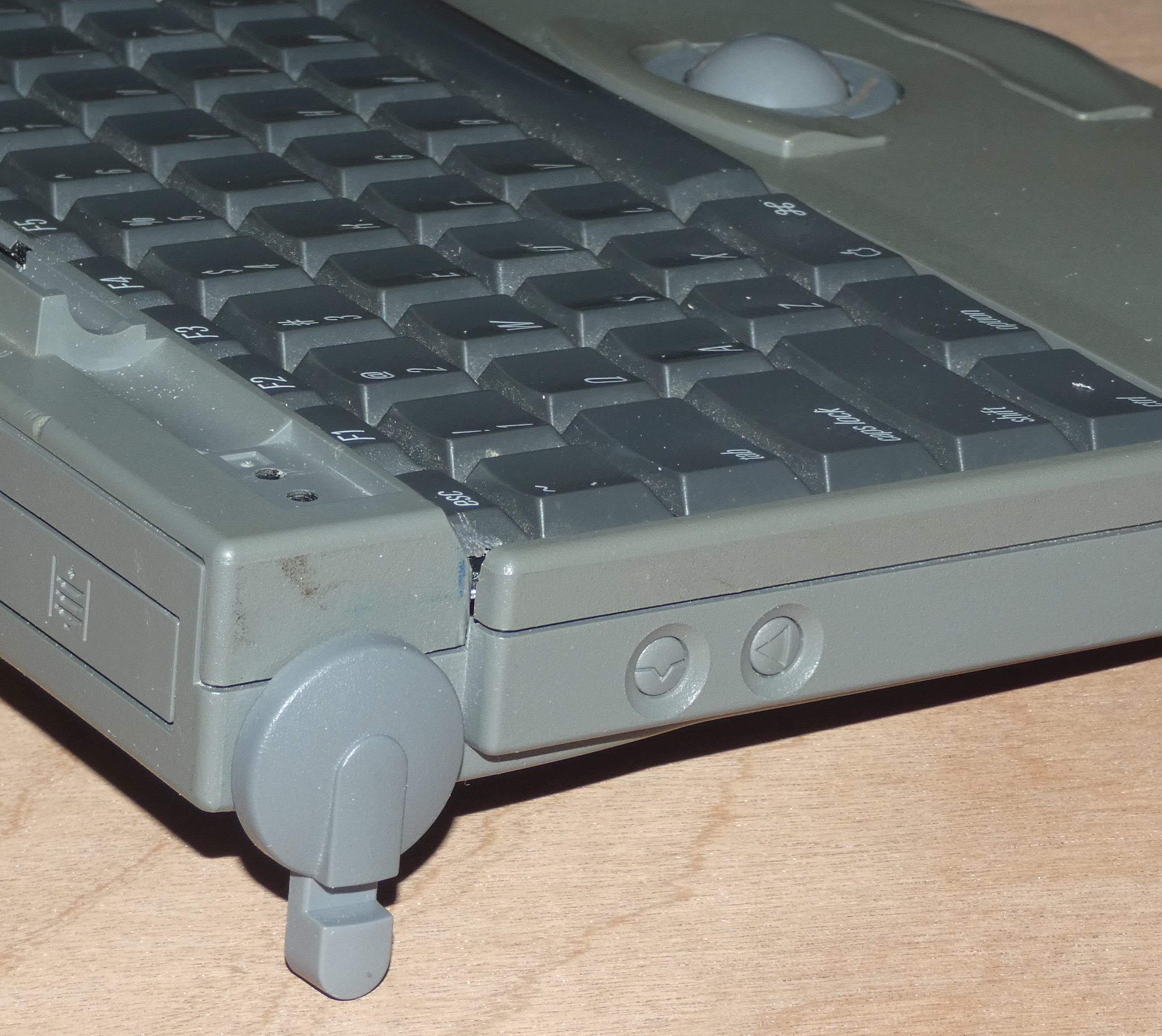

PowerBook 100/2300c LCD/Logic board upgrade has been in process for well over a decade. This revision has been on the back burner since the Compute Module 4 first came out. The I/O board makes it perfect for this upgrade of my beloved BabyPB, very first laptop, bought new and maxed out in the day. Finally got the makings for Christmas and getting started at long last!
PB100_Top-Deck.JPGPB100_Ports-Palmrest-1400cKBD-Deck.JPGPB100_Ports-1400cKBD-Deck.JPGPB100_Ports-Rear-1400cKBD-Deck.JPG

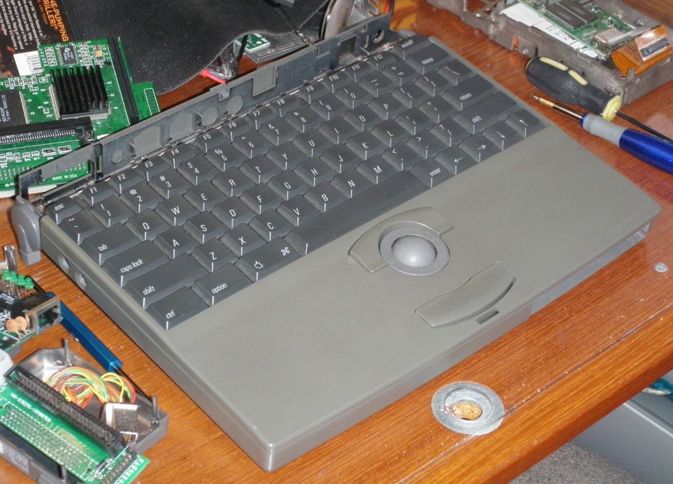

Pics sport the cutback top plate for LCD which clears the deck for utilizing the fantabulous 1400c KBD. That was done oh so long ago along with the 2300c LCD currently snugged away in the lid. That was a perfect fit.
10.1" 1920x1200 LCD is about perfect top to bottom, but I'll have to widen the bezel opening a few millimeters to fit.
Controller board fits into HDD Bay. LCD cable matches type in PB100's inter-hinge interface. If I don't wind up with this one, there are others that have what looks like a rheostat semi-circular wheel for brightness that would be perfect for interfacing with the OEM knob. Ribbon cable on those may or may not need to be replaced with twisted pair cable . . .
. . . dunno, we'll see. Now I've got pics up to play with and dream about at work. New boltdown interface for LCD Deck/KBD required. :)

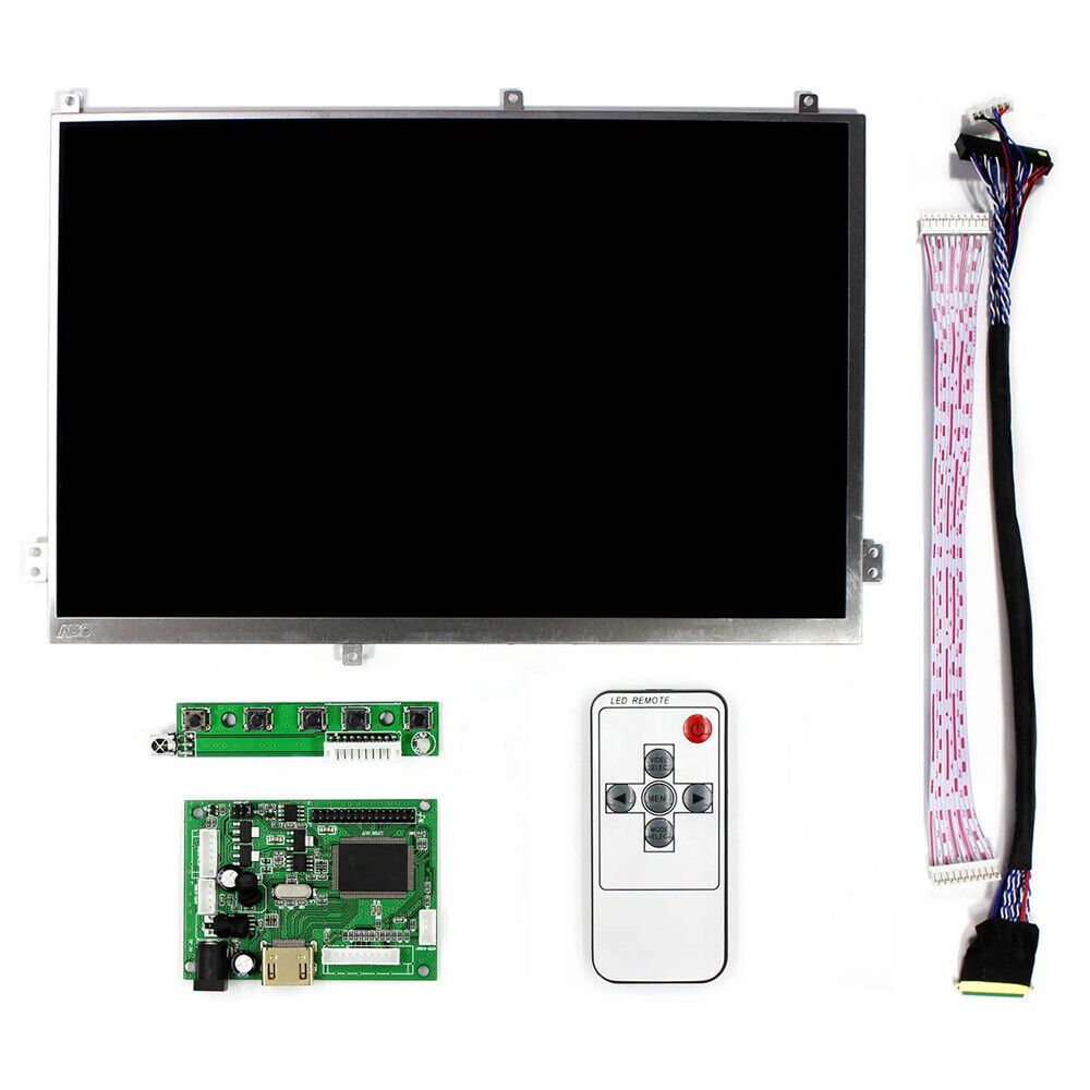

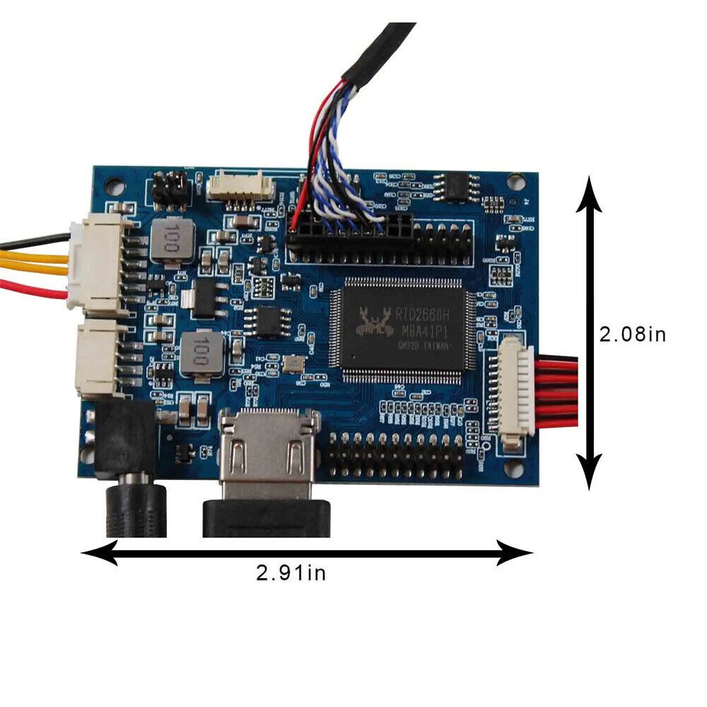

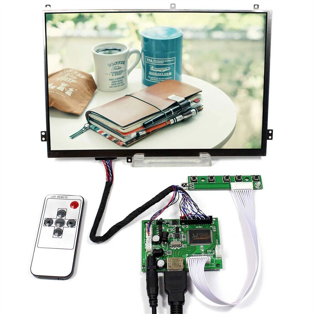

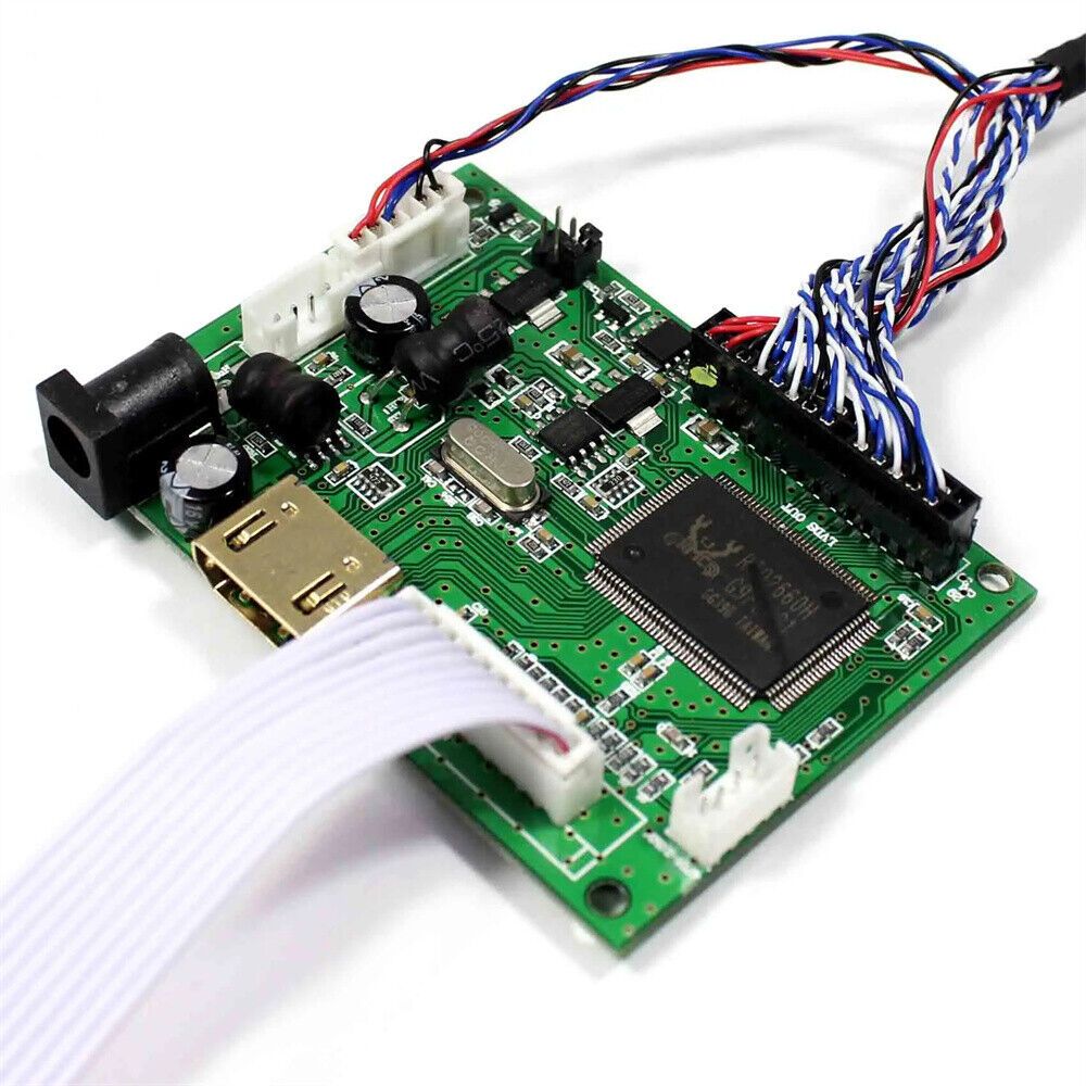

LCD Controller Board:
HDMI LCD Board Work for LVDS Interface LCD Screen
Input Power Adapter:12Vdc More than 2A.
Come In Standby Model When Not Input Signal
Standby Model <1W
Video Input: HDMI
OSD: Brightness Contrast Auto Language And So On
Language: English French German Spanish Italian And So On
Board Size:74mm x 53mm x 12mm
10.1" B101UAN01.1 1920X1200 LCD Screen:
Display Mode AHVA, Normally Black, Transmissive
Resolution 1920RGB)×1200
Outline Size 228.6 × 149.6×4.65 (H×V×D)
Display Area 216.81 × 135.5 (H×V)
Brightness 400 cd/m² (Typ.)
Contrast Ratio 800:1 (Typ.) (TM)
Viewing Angle 85/85/85/85 (Typ.)(CR≥10) [Left / Right / Up / Down]
Signal Interface LVDS (2 ch, 6-bit) , Connector , 40 pins
Backlight WLED
Input Voltage 3.3V (Typ.)

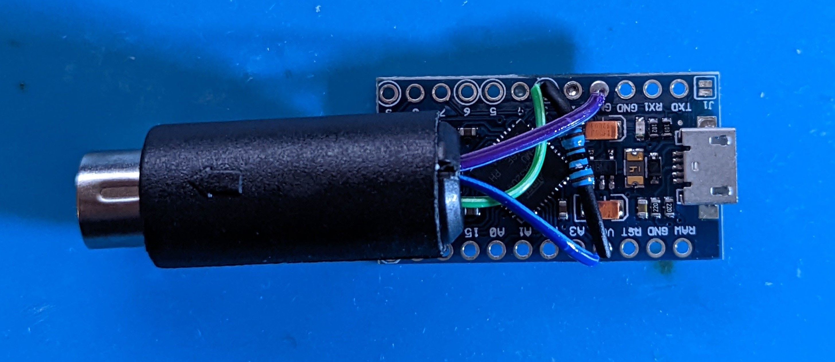

@Drake developed the perfect interface for the PowerBook 100 Trackball:

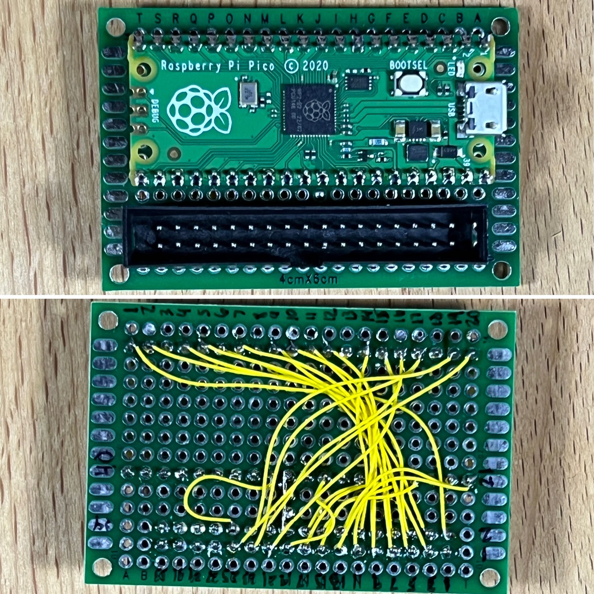

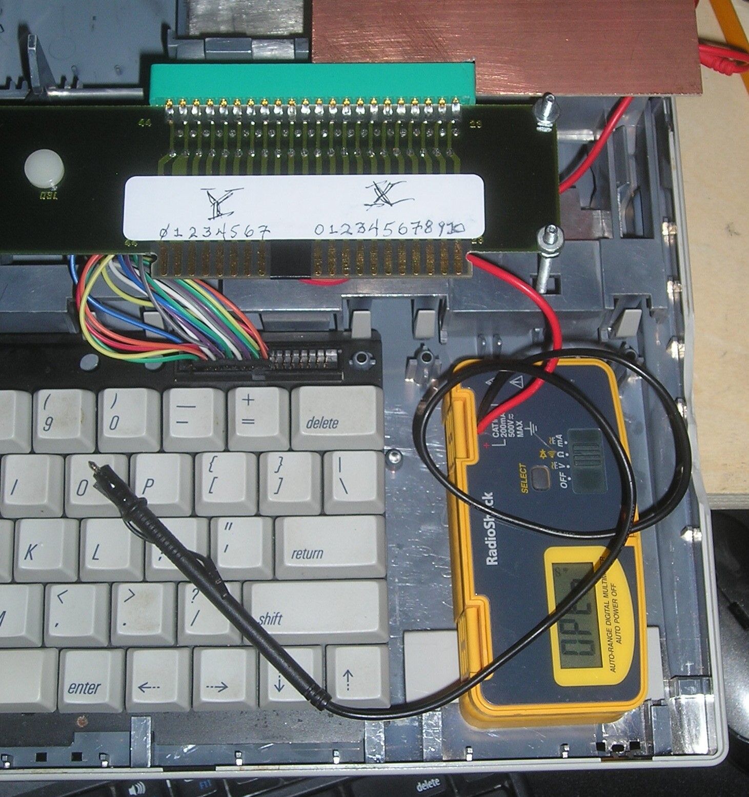

@RolandJuno over at the MLA picked up where I left off on development of the Portable's peripherals:
He came up with the perfect KBD matrix adapter. That'll make adapting the 1400 KBD soooo much easier for me! Time to fire up the Buzz-o-Matic again! Need to fab an adapter for flex cable edge card interface. IDC cable setup of the Portable was too easy. :)

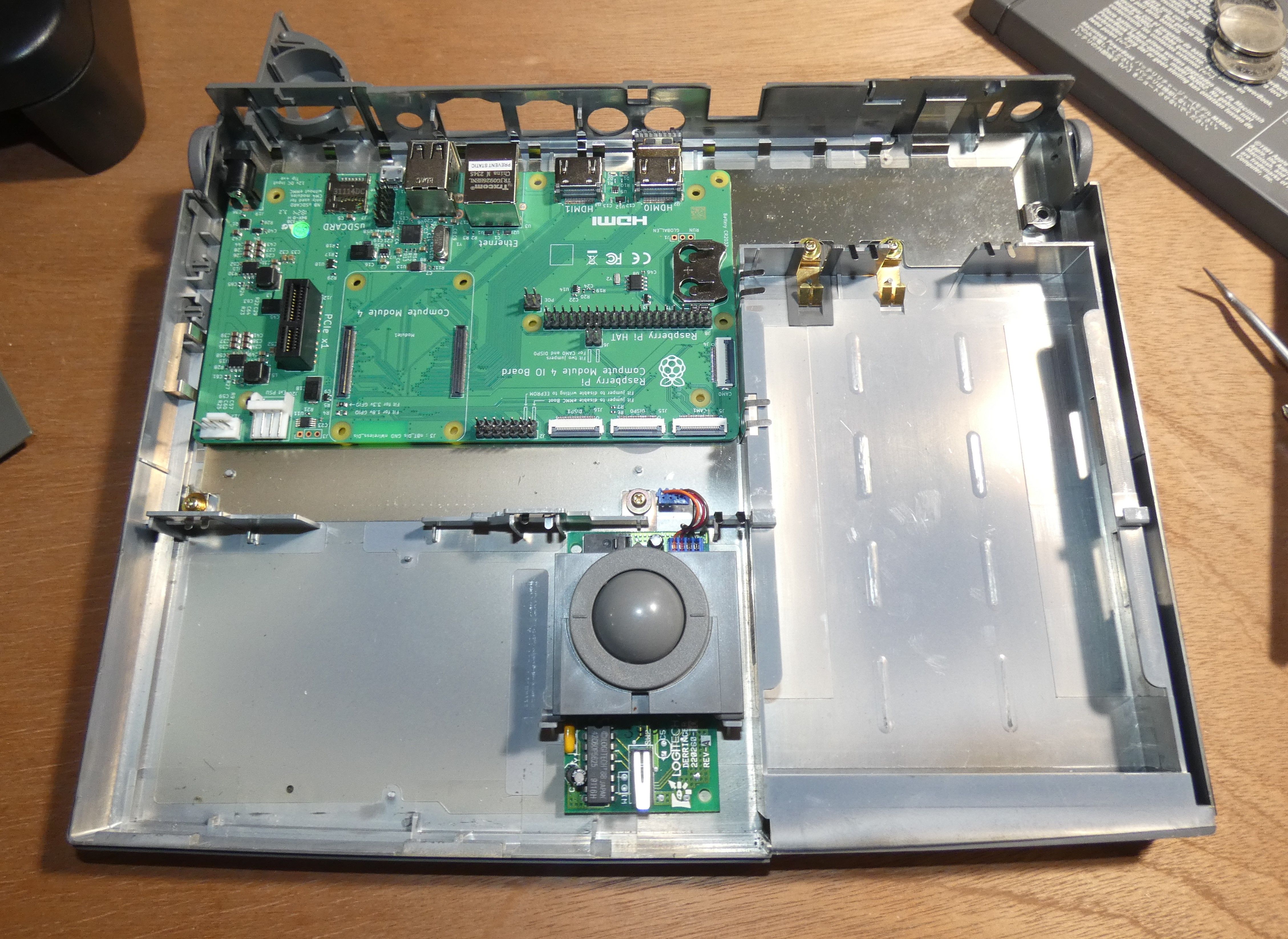

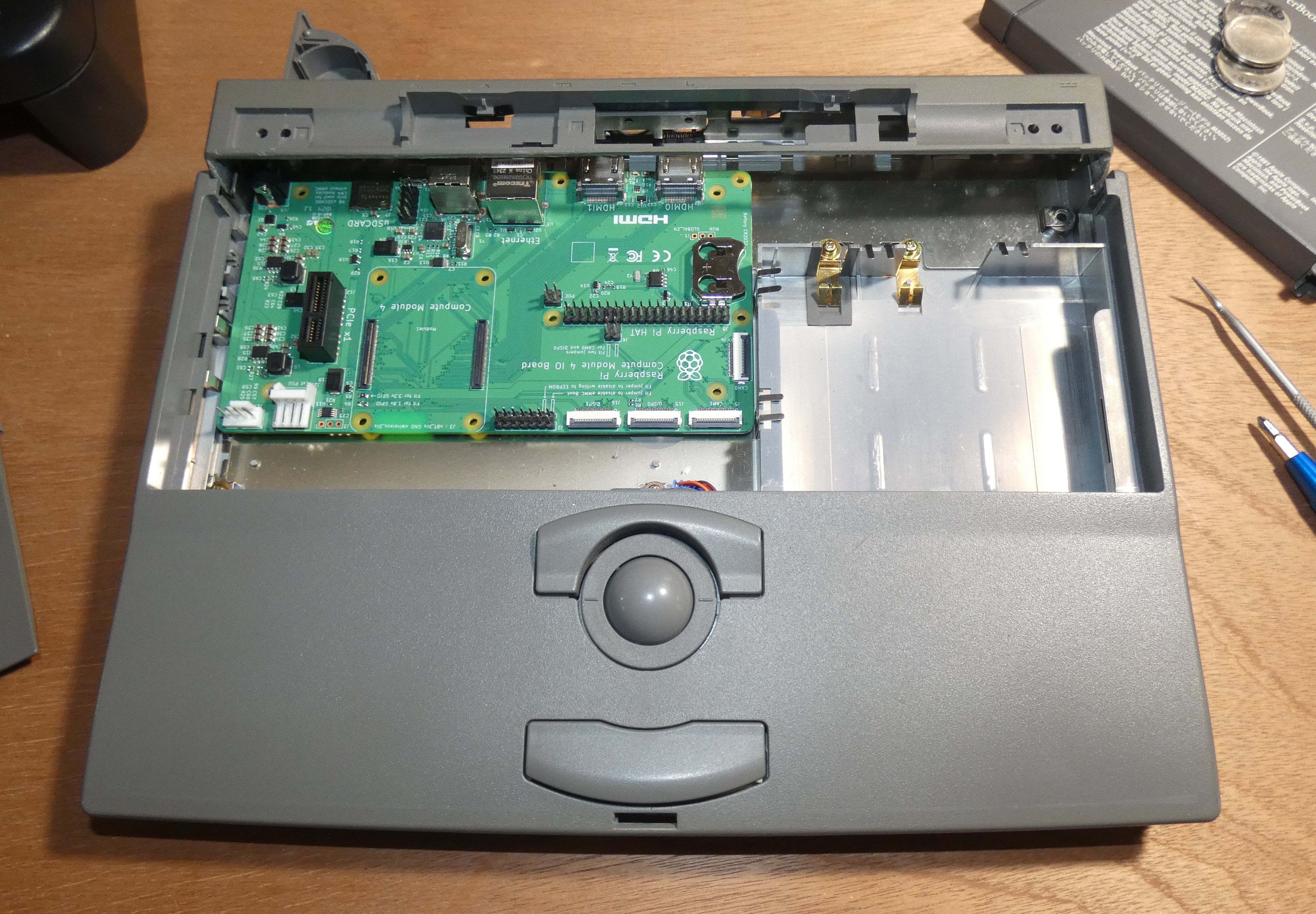

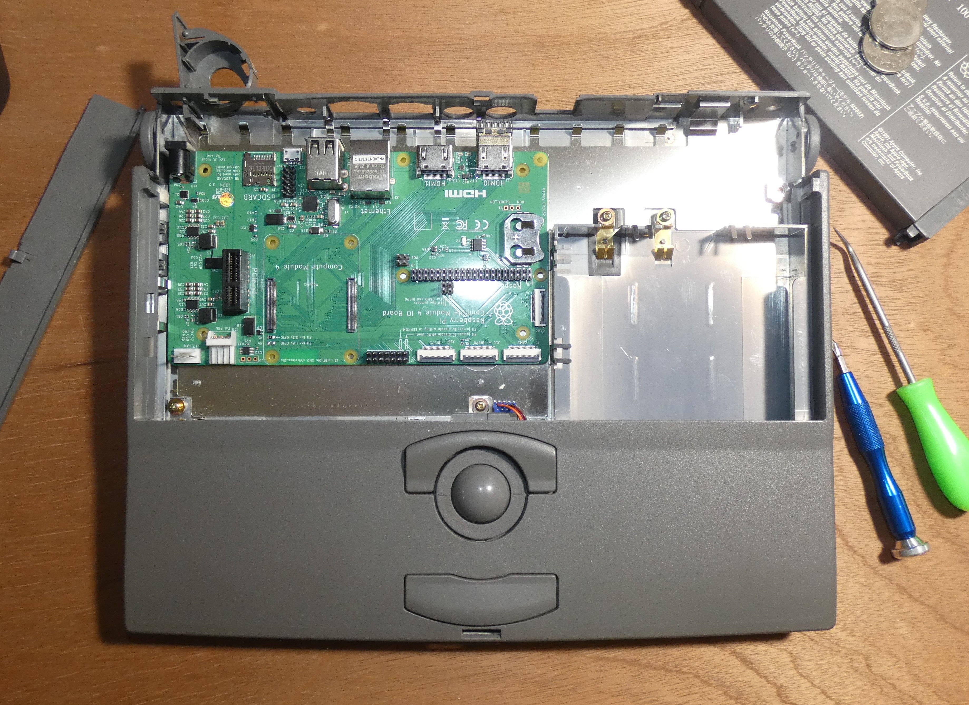

Hardware is coming together very nicely. Looks like removing the PCIe slot connector and wiring up a cable extension for the M.2 board is the only major modification I'll need.

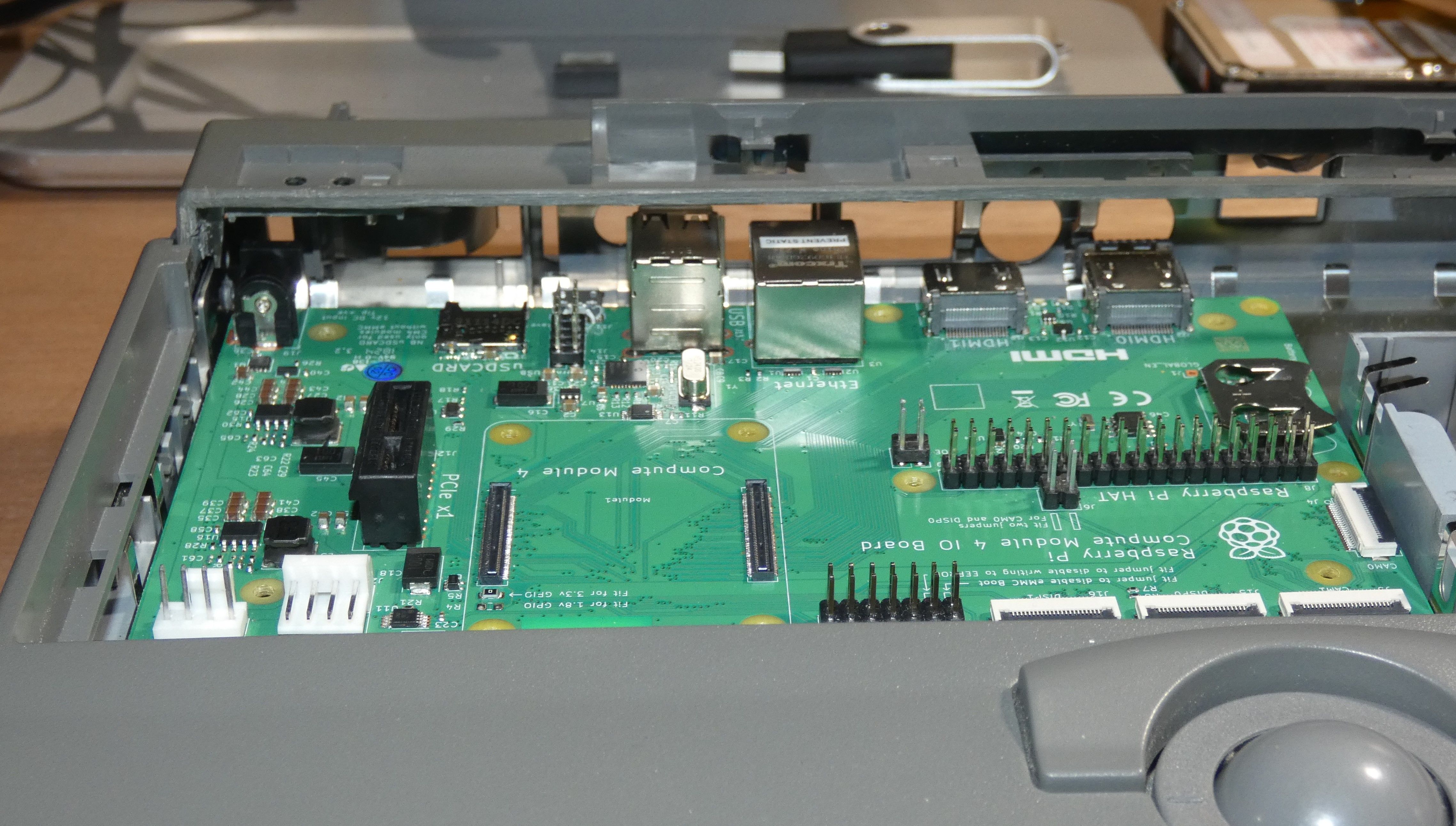

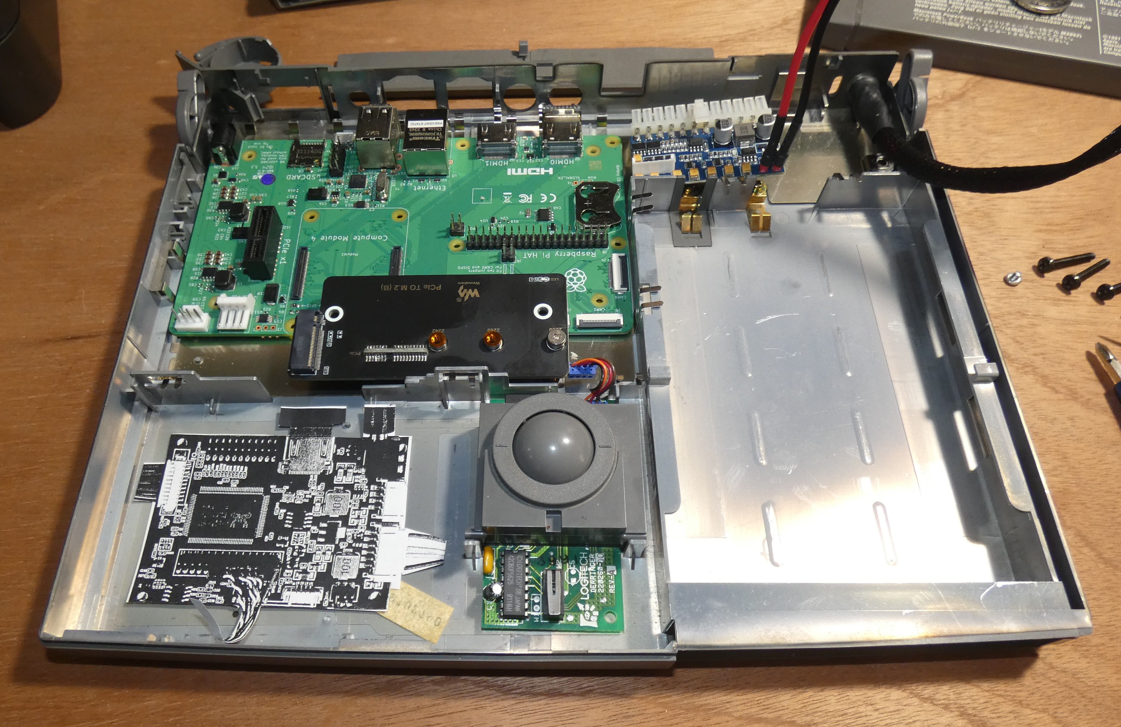

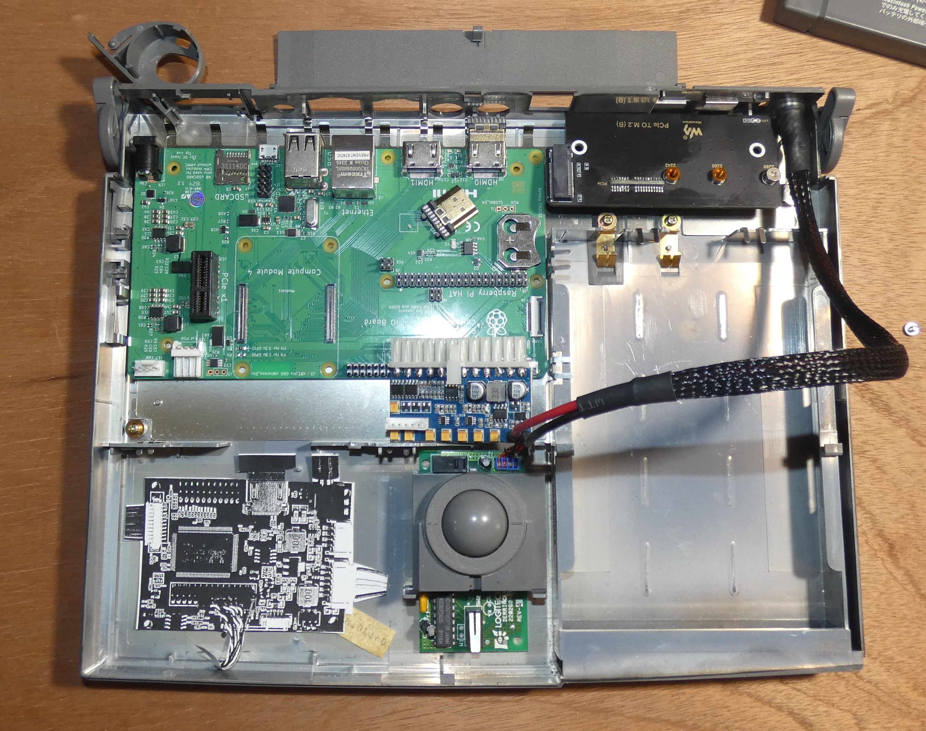

Component placement experimentation:

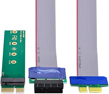

The PCIe adapter for M.2 fits into the metal case for my setup, but is about a quarter inch too tall when slotted into the board for the PB100. Pulled the two decades old MacAntFarm™ project box out and looked into the gaping maw of my DOA 165c. Might fit slotted right up in there?
I'll be snagging one of these cable based PCIe extender/adapters to solder the IDC wires into the PCIe Slot's thruholes for flexible fitment into BabyPB.

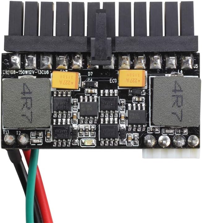

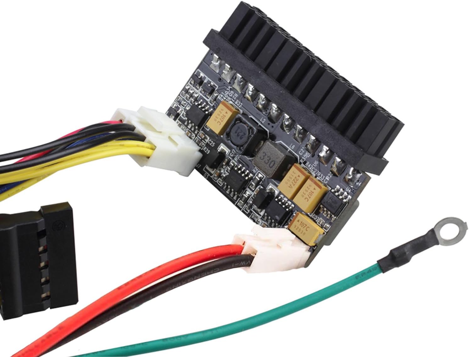

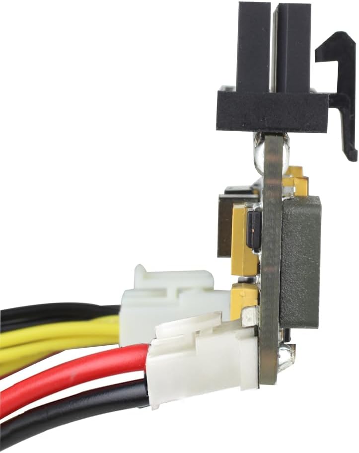

160W PicoPSU is heading back to Amazon. Illustration showed no tall components on one side, so too thick for flexibility. If a simple power conditioning board can replace the PicoPSU that's good. A complicated one allowing use of the battery developed would be better.
Absolute KISS compliance may have me purchasing this far superior 150W PicoPSU for maximum flexibility.
51R-JE0XukL._AC_SL1000_.jpg 61Wak9nsxPL._AC_SL1000_.jpg 61DnhRjk5HL._AC_SL1500_.jpg 51oIoTbbKnL._AC_SL1000_.jpg
I'll be removing the connectors and wiring PTO directly onto its pads and the 12V Power Jack wires into the connector's thruholes. No need for aux power lines or connector. That will make for a very tidy little package to be tucked away into available cubic just about anywhere.

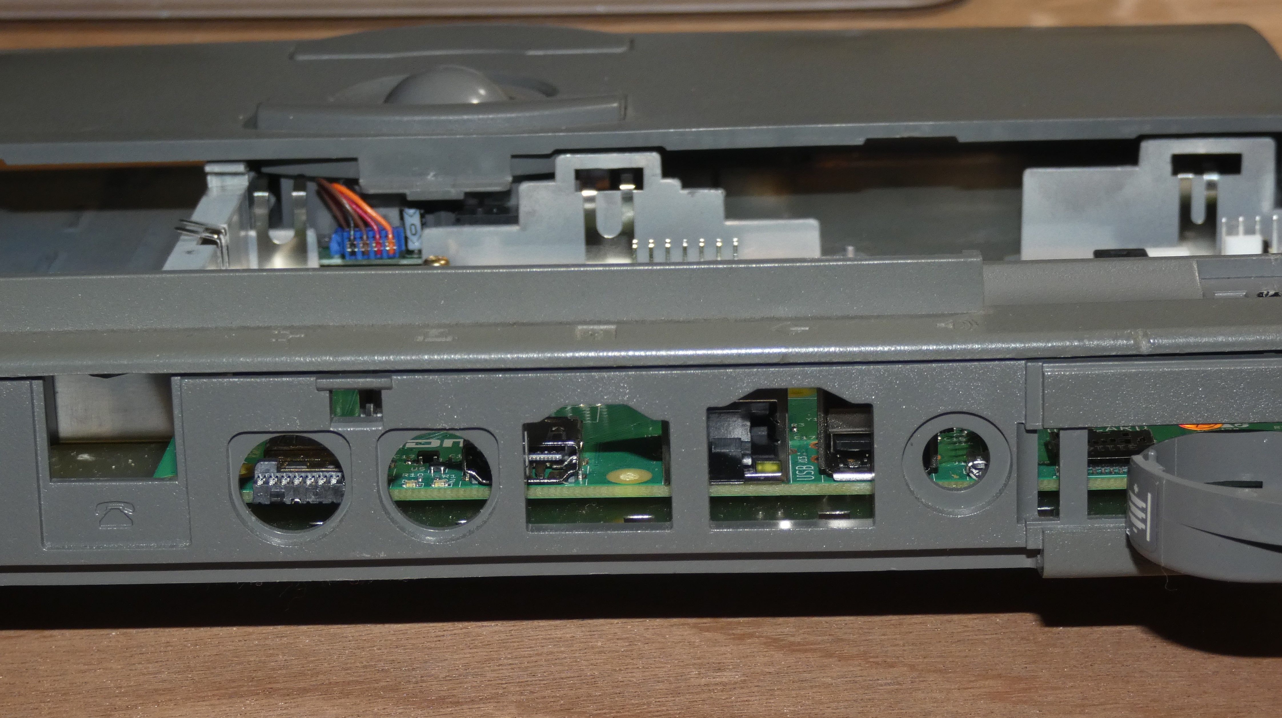

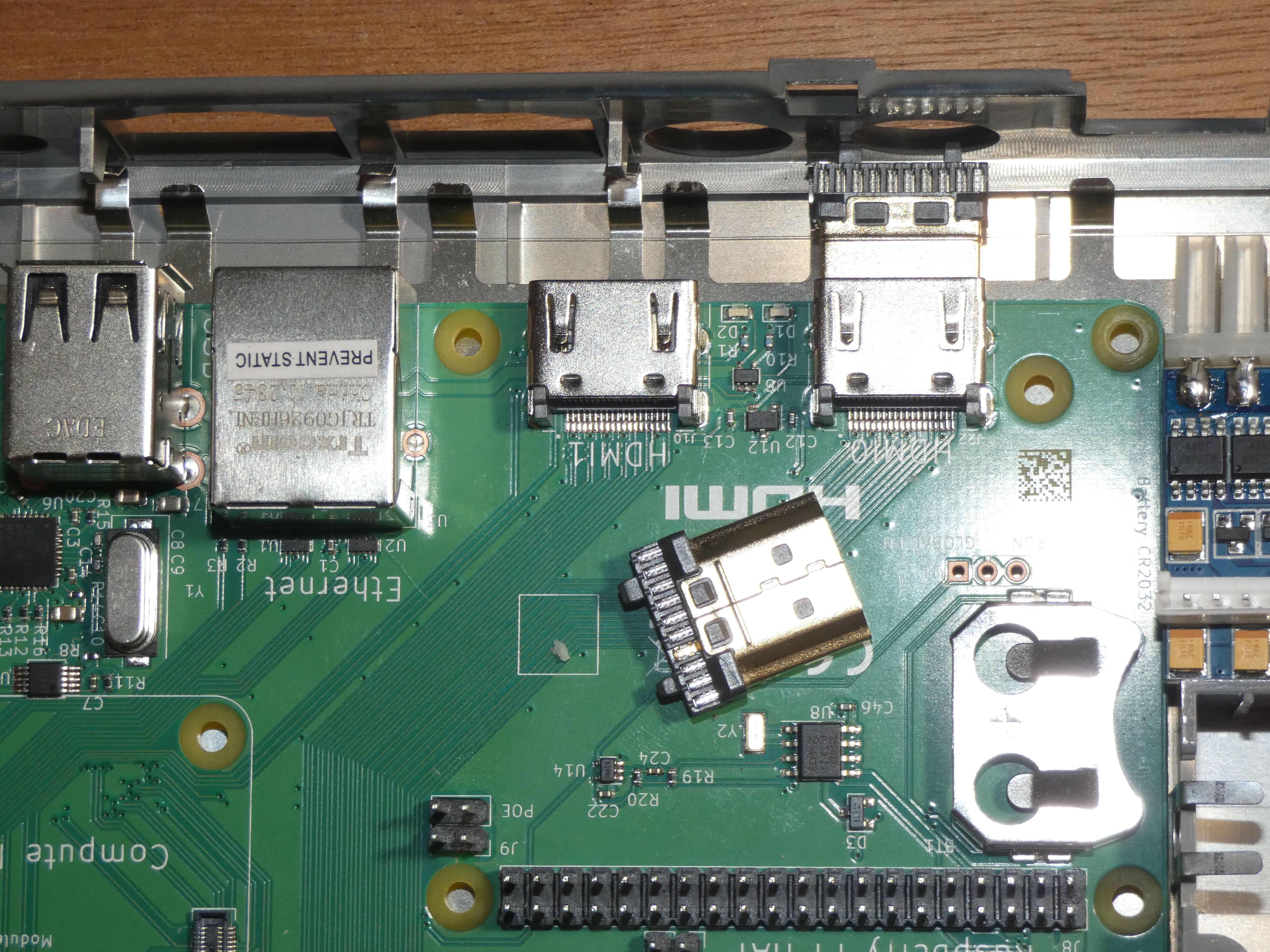

Planning to use this HDMI connector stub for the time being. That makes for simple soldering of the internal LCD controller cable using them at both ends. That pushes I/O board back into the case a bit, no problem but could use the extra cubic if flush. Looking at those SMT pads for the HDMI connector has me wondering about soldering a flat cable's wiring at that point for the connection, dunno, more looking around.
I'm wedded to making the CM4 hack work per first inspiration. Can't resist having an actual PCIe slot on board, but using it as an M.2 interface wasn't what I'd thought of back then. The Lite version has no EMMc on board, hence the far superior M.2 setup. EMMc on board disables the SD card slot, for me that was a no brainer.

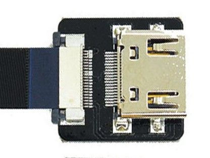

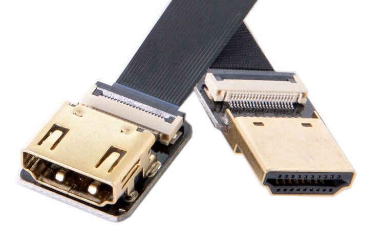

Looks like I should be able to desolder the "internal" HDMI connector and replace it with the cable connector from this board! 😀
Looks to be fine in the component placement pics above. But should this plug card protrude too far out of the HDD cubic, it should be possible to do the same connector swap on the LCD controller end of things?
A nice assortment of adapters and custom cable lengths for this bodge are available!
DRAT! Realized the pitch of the two connectors is off a tad, so back to the soldertail HDMI connectors above.

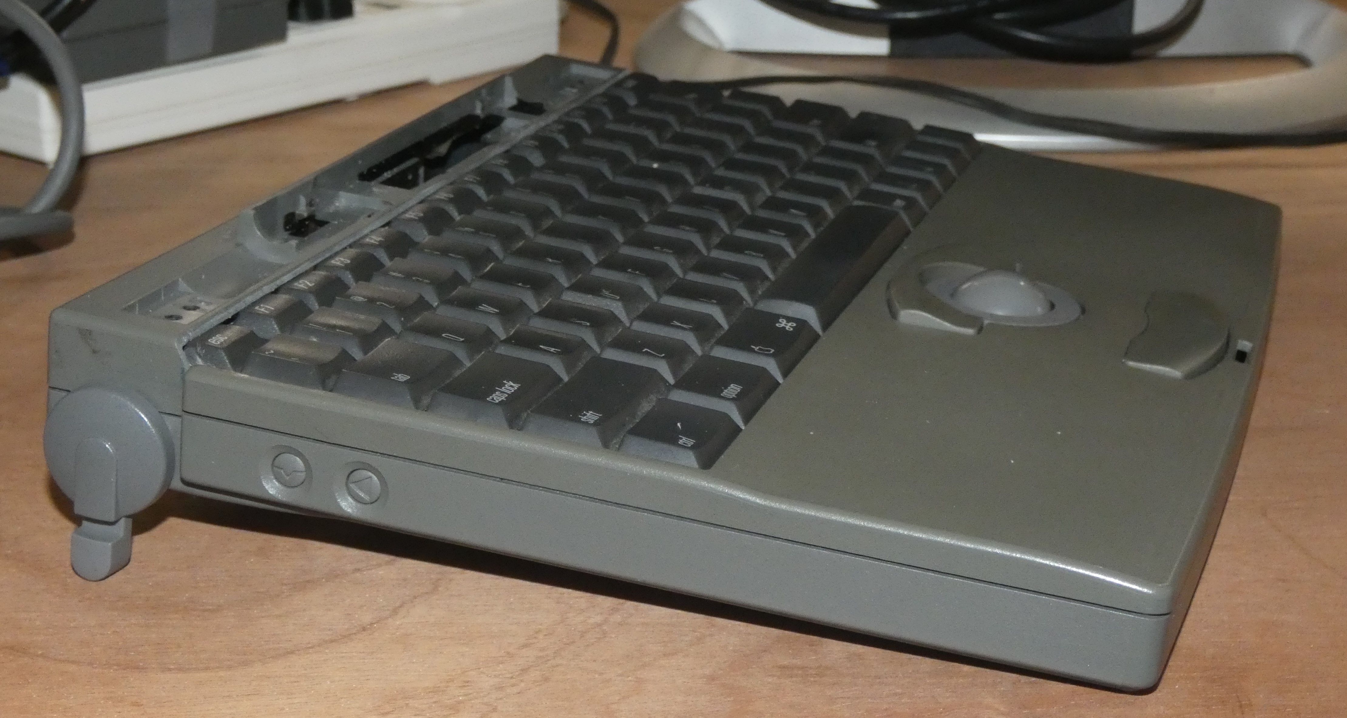

Tucked everything away and started looking for missing bits of a PowerBook 165c. I'm trying to get it back together to finally test after I snagged it for the MacAntFarm™ project two decades ago. I'd already acquired a couple of victims for that and had the unfortunate experience of bringing them back to life. So I began tearing it down immediately after snagging the beautiful thing for $10 as is at a flea market.
Be that as it may, I found BabyPB's modified palmrest section and just had to get right to snipping and filing away bits of the 1400c KBD chassis and keys. The physical modifications for the graft are now in full working order.
As you can see, I need to sand smooth and polish up ESC (and ON/OFF) key corners, but I can now stash this stuff away until parts arrive. Low res pic of the combo above is from years back.

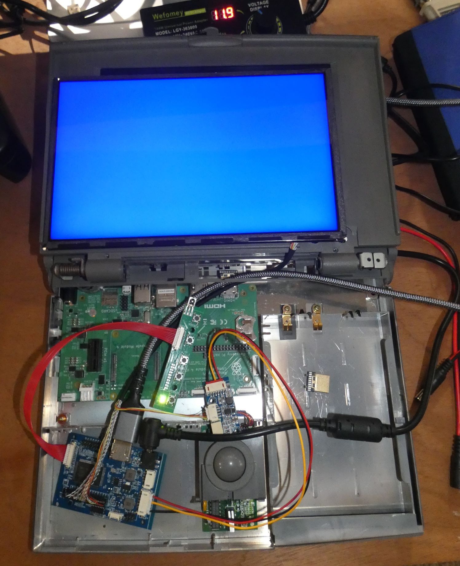

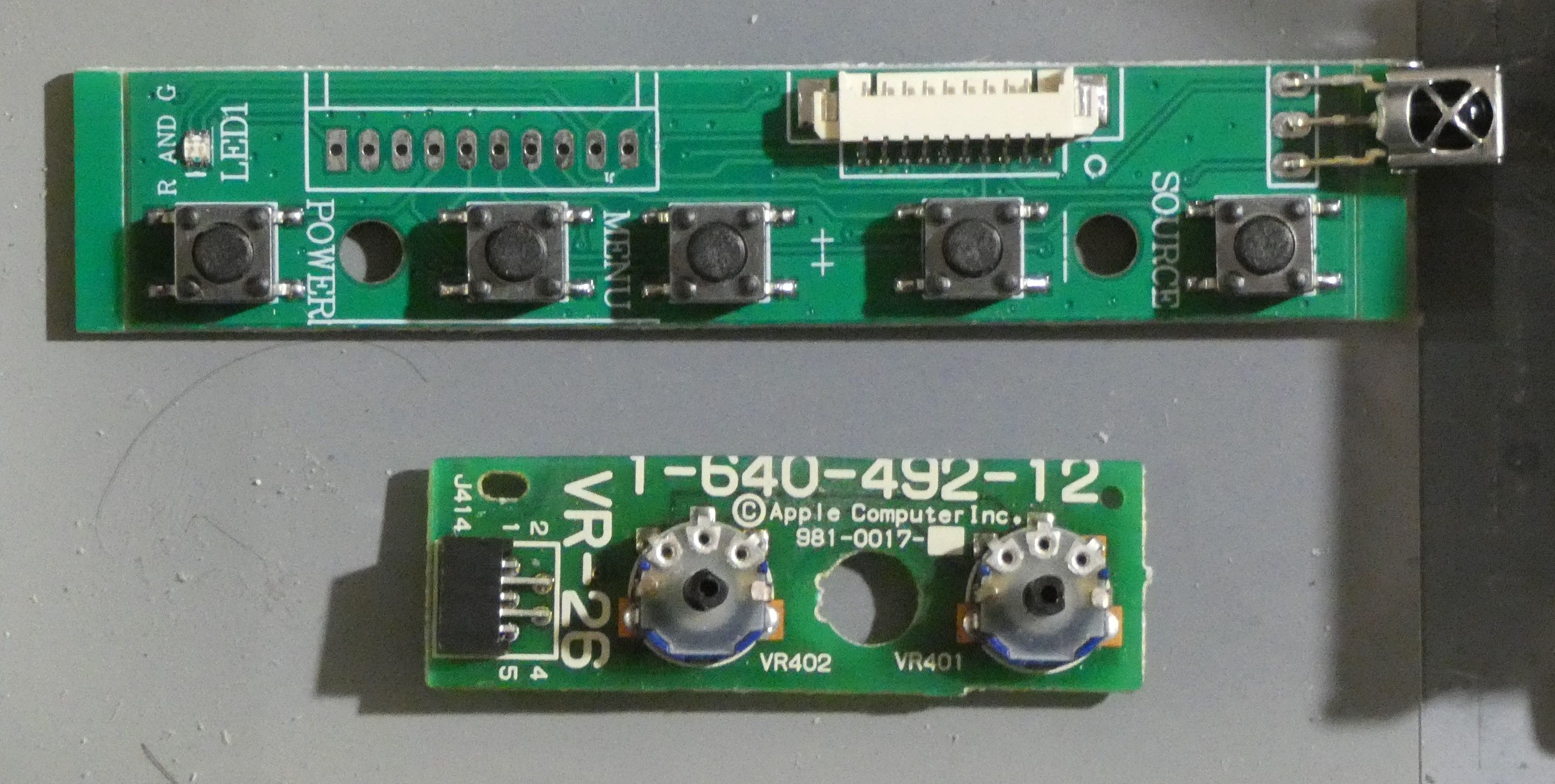

A little bit of headway made. Opened up the lid for removal of the 2300c LCD and access the brighness/volume board:

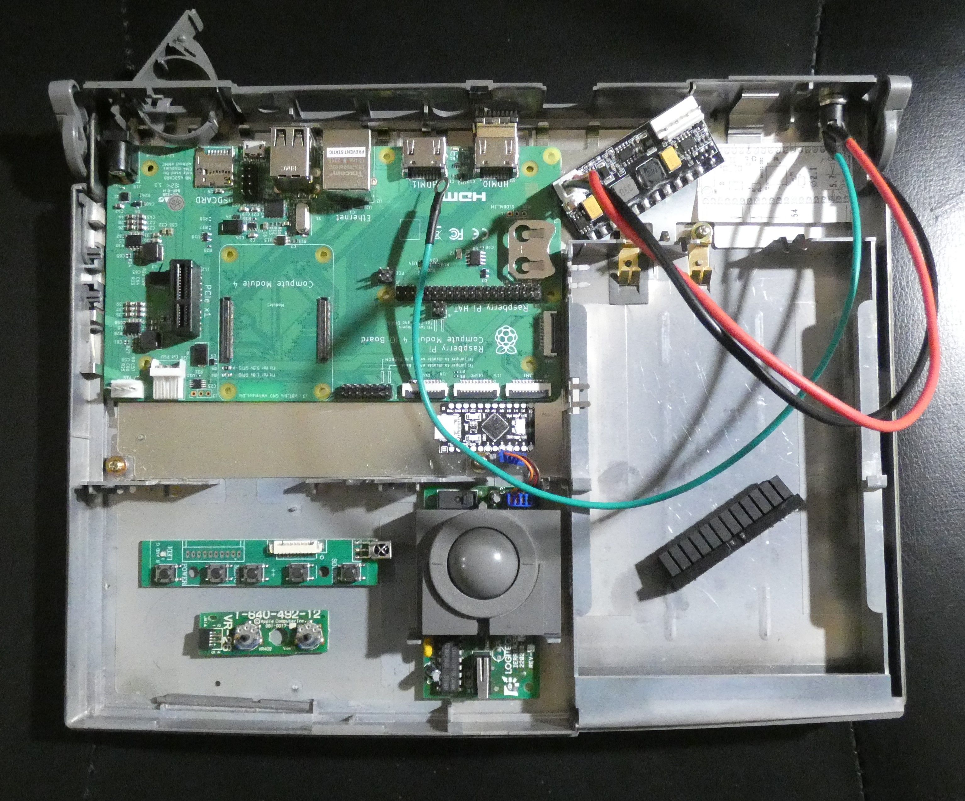

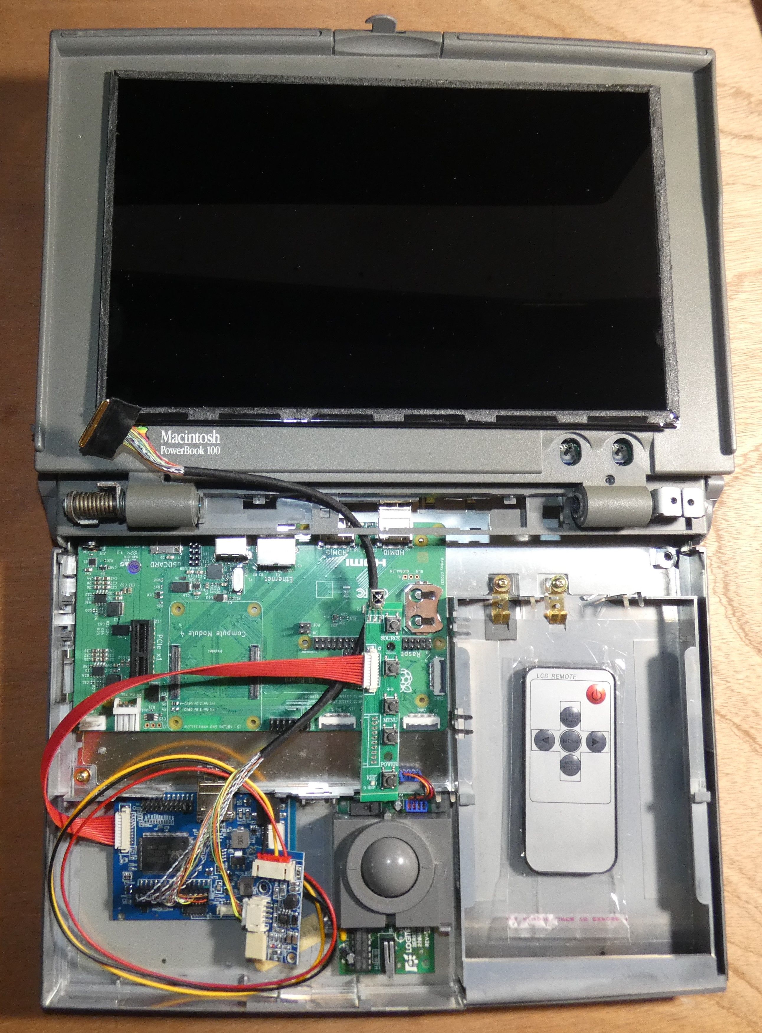

Trimmed the connector off the PicoPSU for hardwiring it to CM4 I/O Board and LCD controller. 12V input with 12V output should add little in the way of waste heat I would think? @Drake I've installed more paper components. :p
Three CPUs on board at this point, wondering if I need another!
Need help on this one gang. I'd like to develop a circuit to use the OEM board's potentiometers to act as the four Menu Buttons on the LCD Controller's input board if possible. Don't need power switch, when system powers up the screen turns on, power down and it's off.
- rotation to minimum setting blips one momentary switch input for SOURCE
- rotation of left to maximum setting blips momentary switch input for MENU
- right side pot would be + - inputs
- repeated rotations from neutral to max or min would be same as hitting momentary switch on board repeatedly
- any setting between max/min ignored as neutral (near max/near min?)
May have clearance for an internal hat to do this right there on the CM4 I/O board.
If it's not possible to do this on a CM4 hat I could throw in another CPU board for the purpose.
Backup plan is to fab a replacement PCB for locating switches and IR sensor in the swing out backup battery drawer.
Advice needed on feasibility of this analog to digital input conversion circuit notion.
Been looking into this a bit further:
Feed power to the OEM pot card
GPIO measures resistance of current induced by potentiometer
GIVEN: mid-range resistance = NEUTRAL
IF: resistance level drops to X
THEN: blip 1
IF: resistance level rises to Y
THEN: blip 2
Might be time to learn MicroPython . . . unless there's a Basic interpreter for MicroPython?
