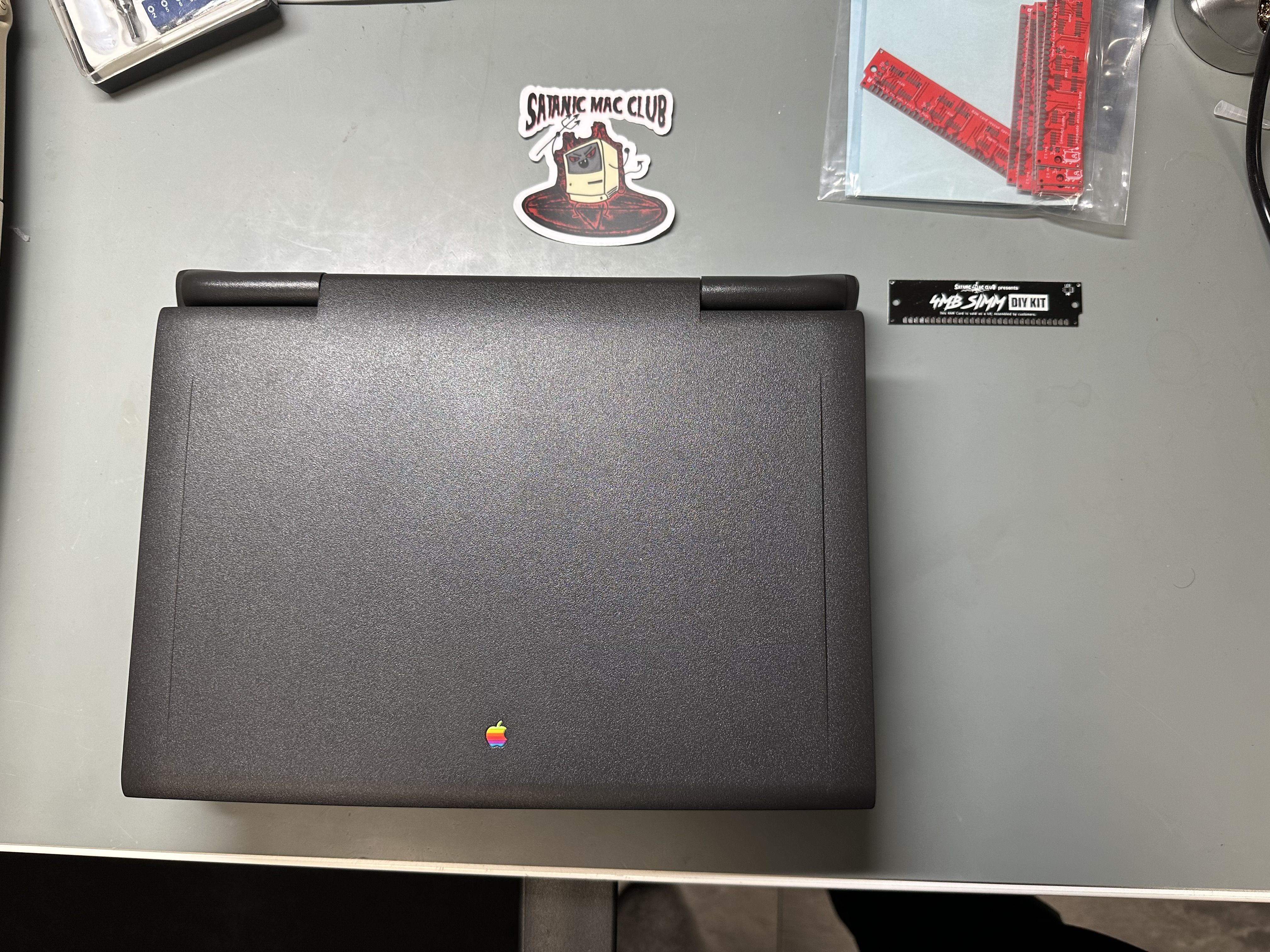

I just get a PowerBook 5300, sold for parts on eBay.
The overall external condition is pretty good, at least all plastics are nice (broken hinges for the door at the back), not broken, not scratched. Battery has died long ago. and the rubber feet... are nasty.

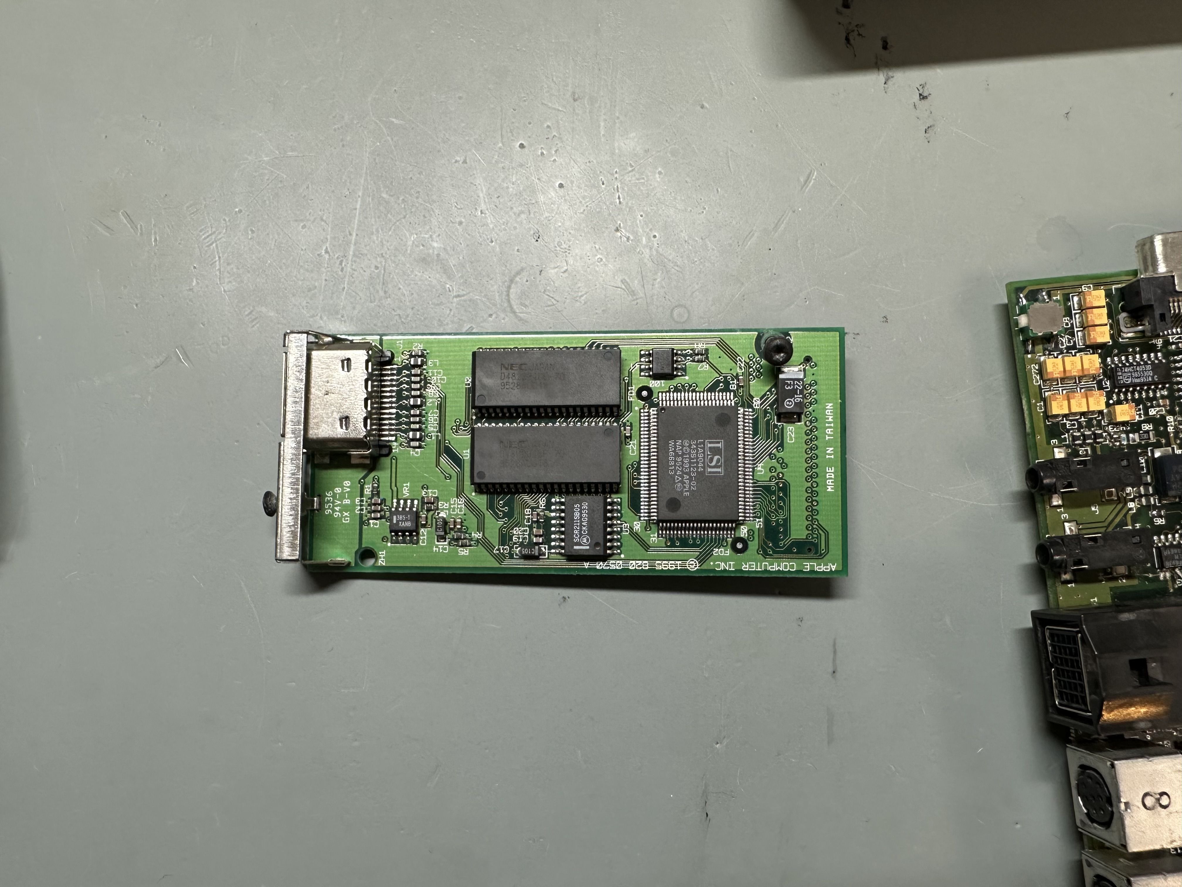

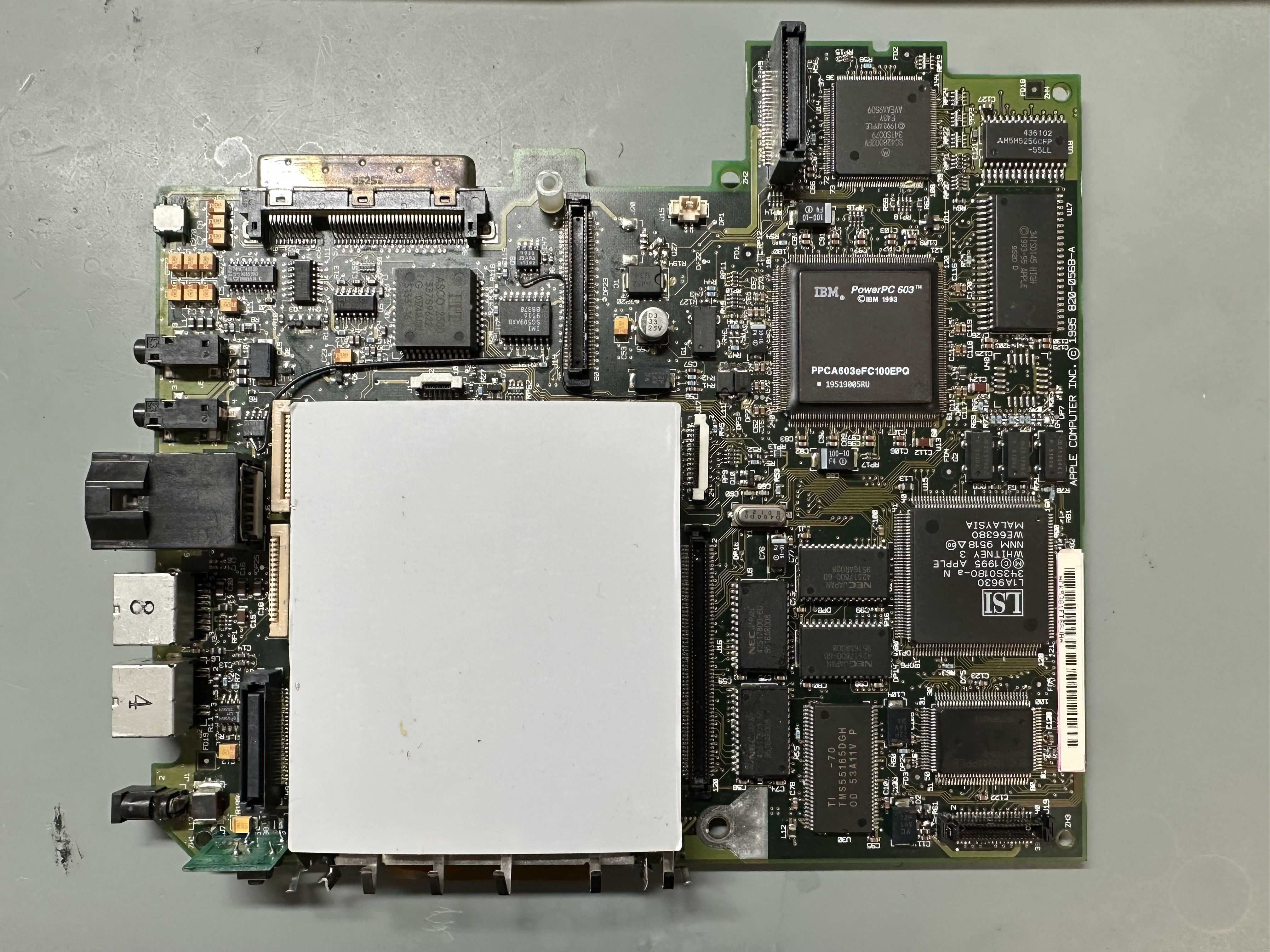

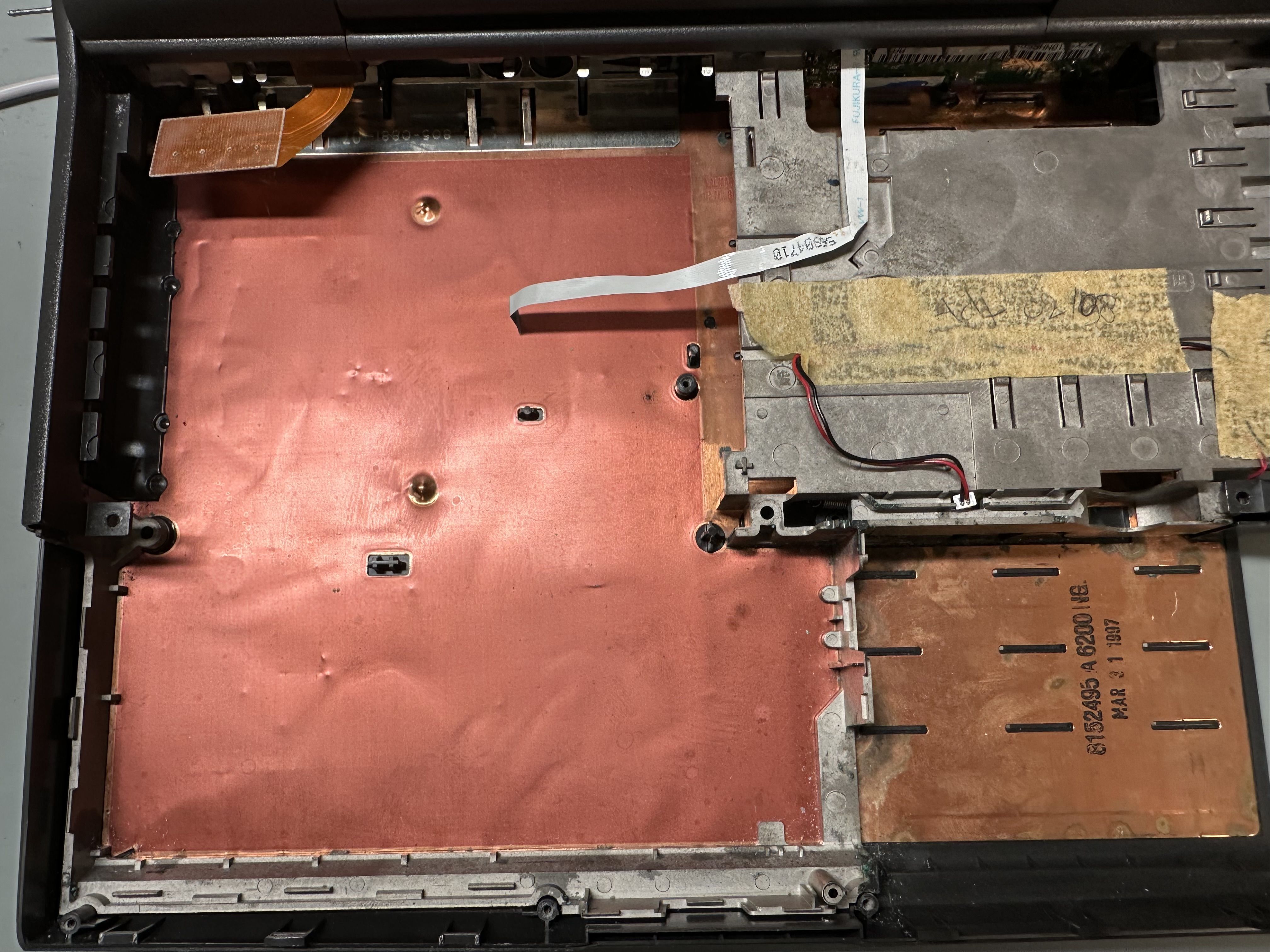

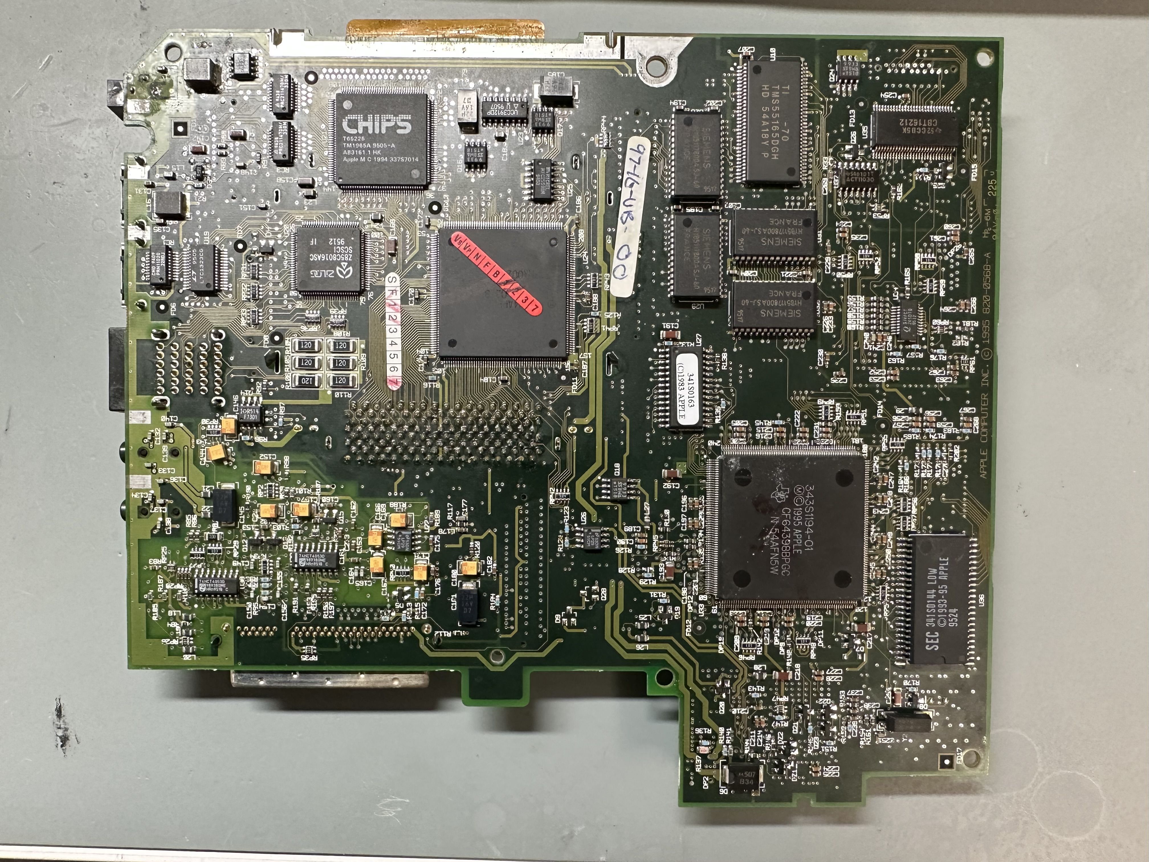

Tearing it apart, it appears at some point there was some leakage, but I think it got fixed (AA mentioned on the serial number sticker). The chassis has some traces of liquid (from the battery compartment), but the motherboard itself is in very good condition (see pictures). One of the pins leading to battery has completely corroded, but I'm not sure this will be an issue. You will also spot some traces of corrosion on the connector to the floppy bay for instance.

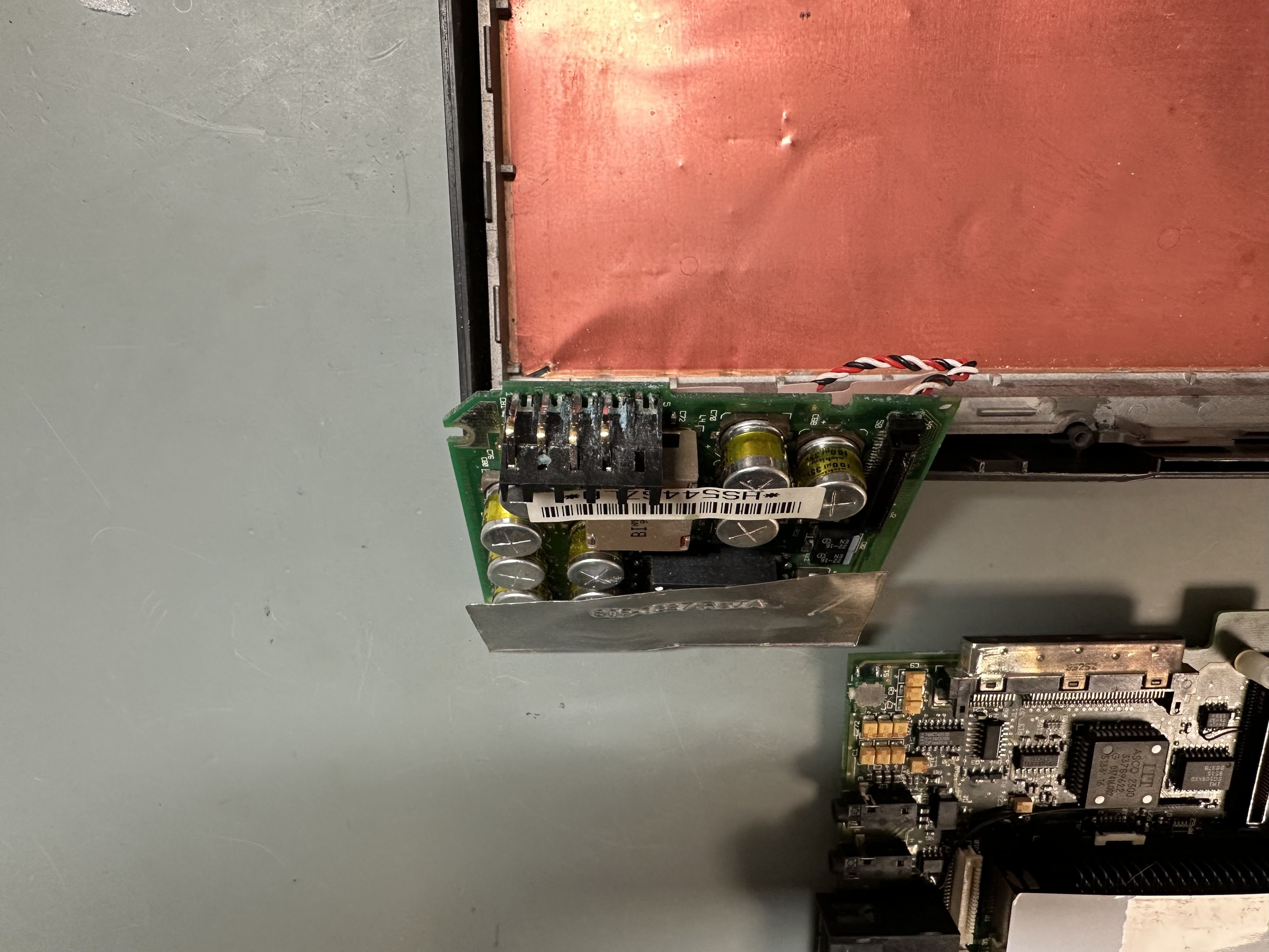

FWIW, I have not recapped my PowerBook 5300cs. I took mine completely apart for cleaning and inspection about a year ago. The electrolytic cap on the logic board looked fine (no bulging or cap juice) and the same with the cluster of caps on the DC board. I opted not to do a recap yet.
The DC barrel jack is crap. I had an extremely poor connection from the power supply to the PowerBook that improved somewhat when I desoldered the barrel jack and reinstalled it with gobs of fresh solder.

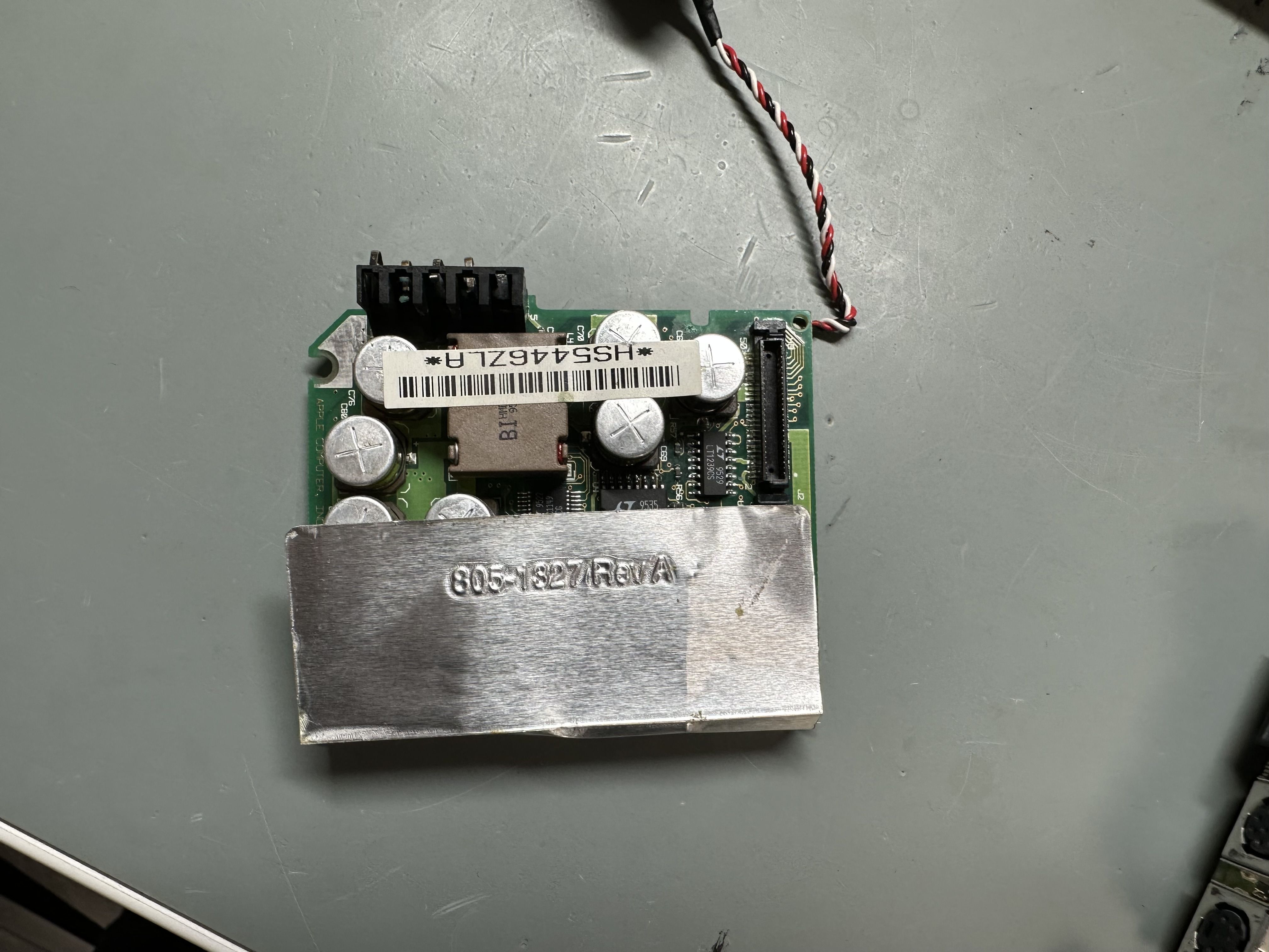

My first bet would be the DC power board (module with all the caps on it), they do go bad from what I've heard. I've had abnormally good luck with my 5300 units, both at least booted correctly (though had power-unrelated issues). I've got mine mostly recapped now (just gotta get one cap on the inverter board changed), but the power board is done. So yes, give it a recap.
Here's a link to some cap reference info on my website: https://macdat.net/cap_reference/apple/powerbook/5300c.html
I've got to add a couple things to it though, so I'll mention them here for now:
1. There is only one 2.2uf cap, I left the amount out for some reason. Also make sure to get a tiny replacement! It's a very small electrolytic, I ordered some tantalums and they were too large.
2. Get the smallest diameter 100uf caps for the power board that you can! Otherwise you won't be able to get your soldering iron in to solder them all in. I went with some Wurth caps on mine.
3. I bought the whole lot of caps for the Sharp LCD display for mine, only to open mine and find that my 5300c has a Toshiba screen with no electrolytic caps at all. Verify the model of yours before ordering if you're planning on doing the whole thing!
I'll be overhauling my 5300 capacitor guides soon with images and such.
If recapping the power board doesn't get it going, it's possible that something else has failed on it. Check for corrosion again in that case.

I took a second look at the power board, and a few caps are definitely not flat on the top. Not very visible at first glance, but suspicious. I will inspect more and recap. Also I need to look at the other board at the back.
The reset button does work, and will make the LED come black, then chime, the come green, and... nothing.
The caps on both my working power boards did also look slightly bulged, probably a sign of age and impending failure. Luckily they don't seem to be leaking (yet), just drying out hopefully? Get them replaced and it may come back. You probably have one or more out of spec power rail due to it.

No info on what to probe unfortunately, board-level diagnostics is where my skills reach their limits. I'd just recap the board and then troubleshoot further from there. Your issue a one known to be caused by bad caps.

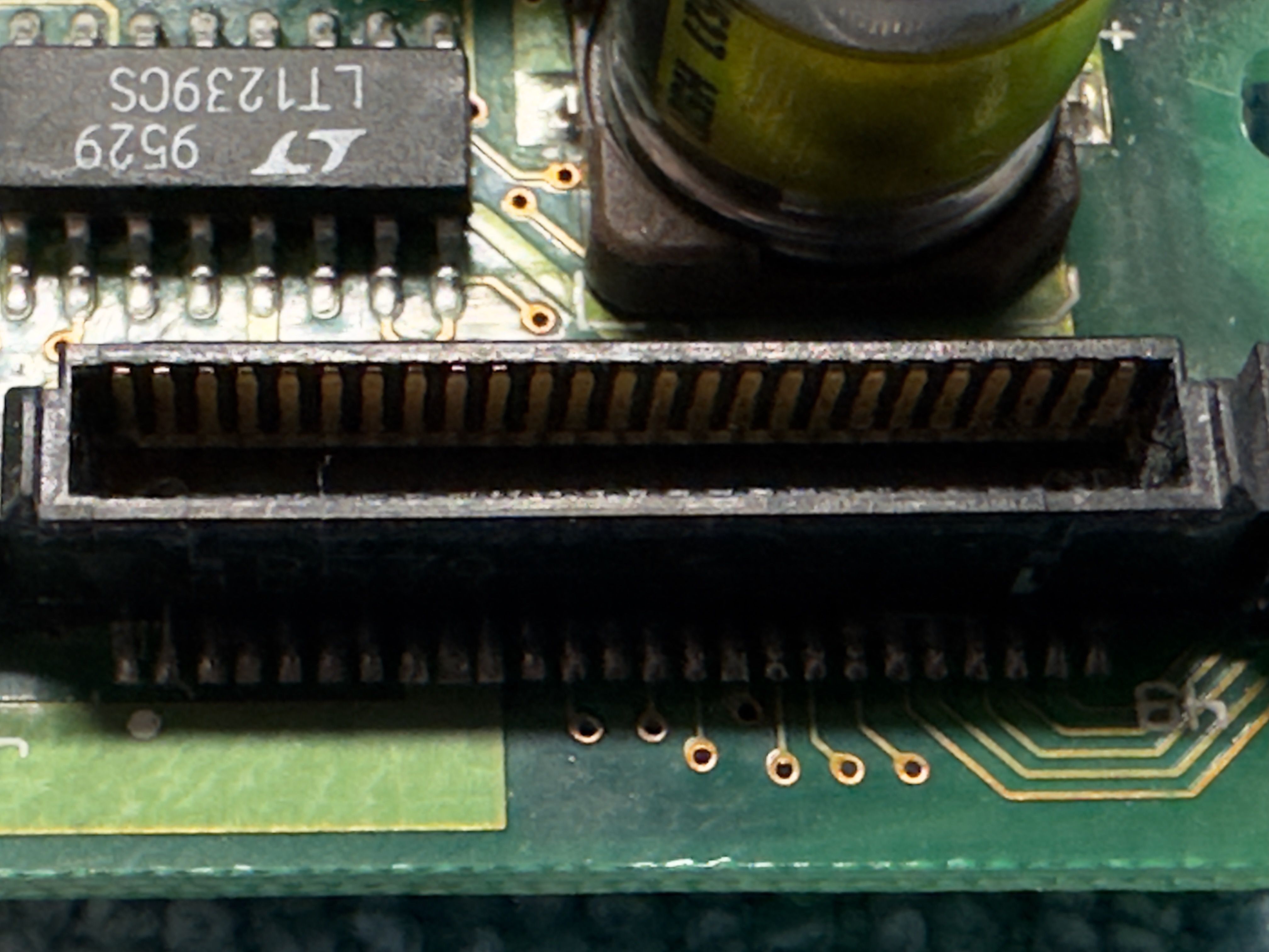

As a followup, I ordered caps to replace them all on the power board.

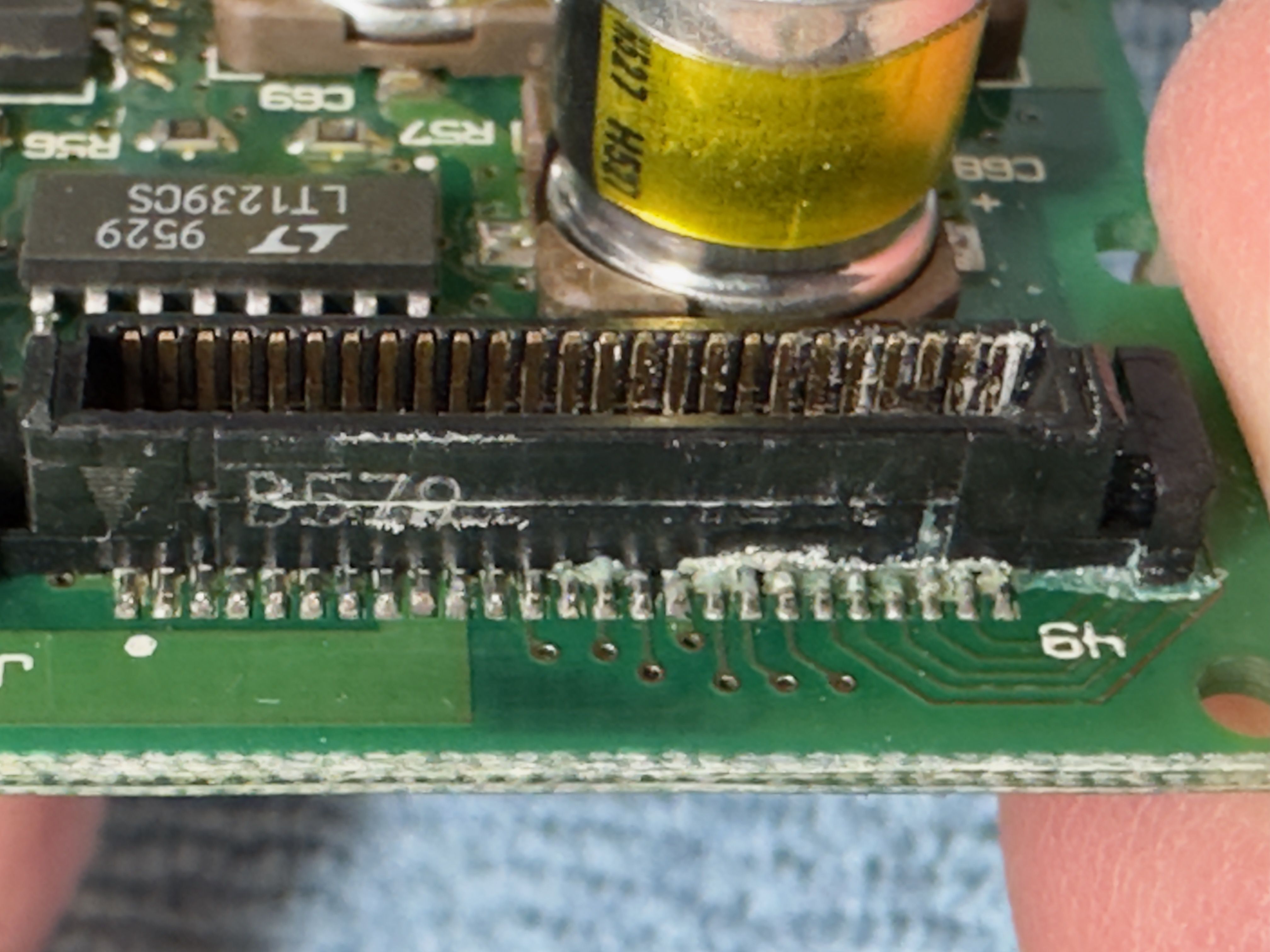

In fact, after closer inspection, I do believe that some of them may have leaked, but somebody cleaned it a bit.
Also, the connector was really dirty due to the old battery leakage. See photo below of before and after cleaning.
I've tried to find a replacement for the battery connector as well both on Digikey and Mouser, but no luck yet.
5-pins connectors do not seem to be a trend anymore ! Anyway, this is less urgent since the battery is dead anyway.
