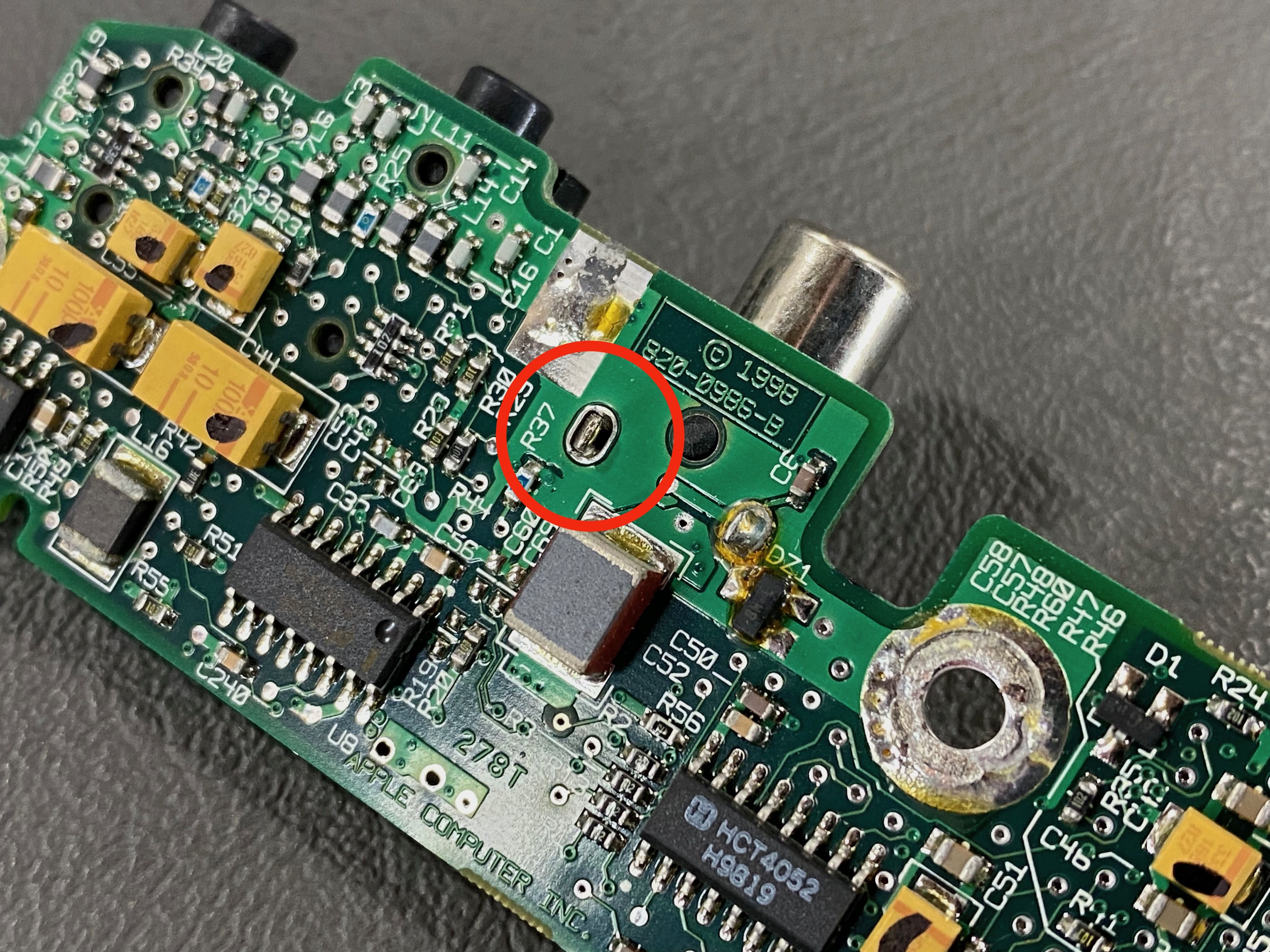

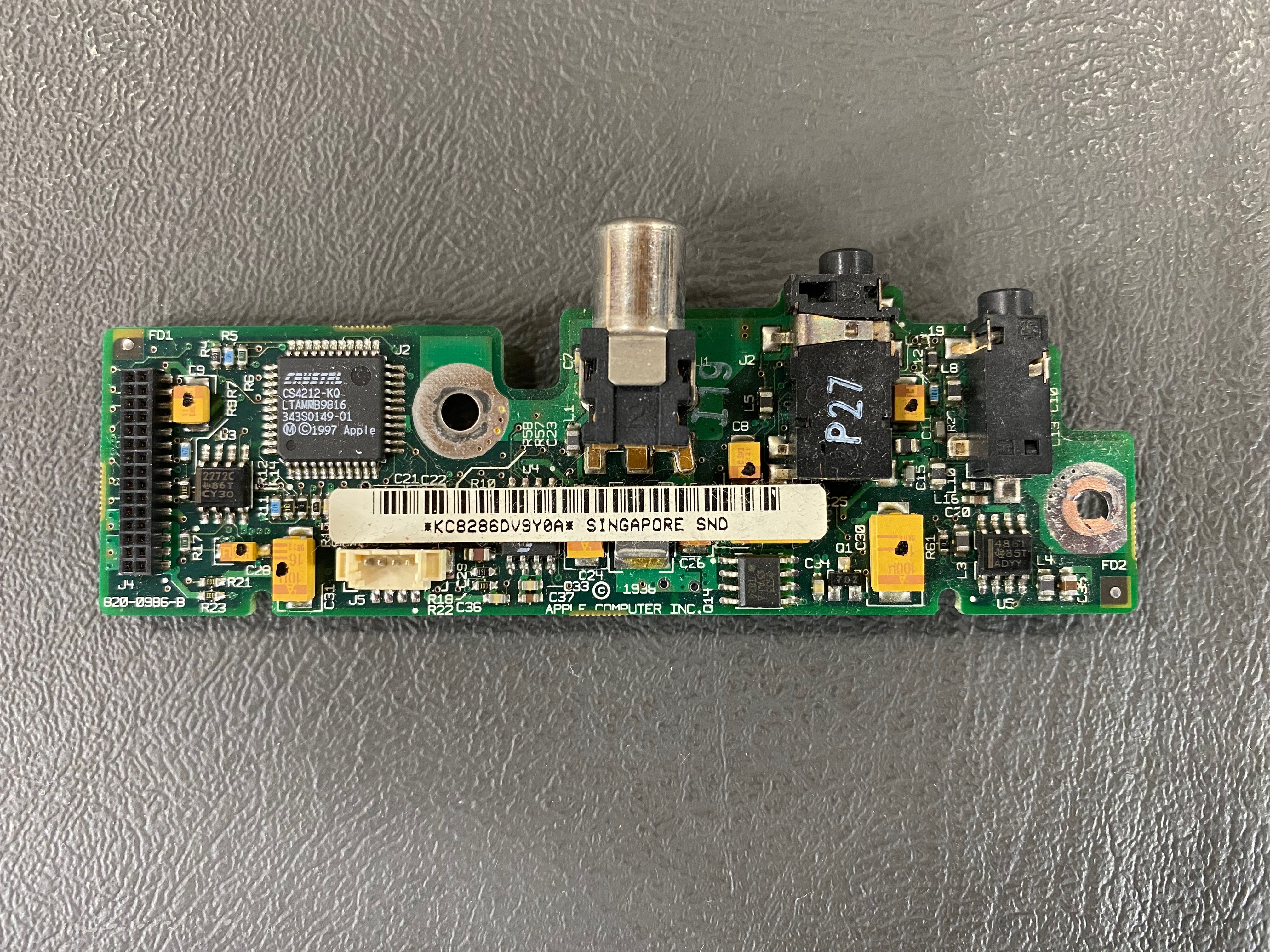

Howdy folks, I could use another set of eyes on this PBG3 power board issue:
I recently picked up a PowerBook G3 that works but has a flaky power connection at the DC input jack. The power connector has to be pushed and held in HARD for the machine to get power; as long as it's held like this it works fine. The instant you let go, the power drops out.
So I am suspecting a problem at the power jack, which resides on the power + sound board:

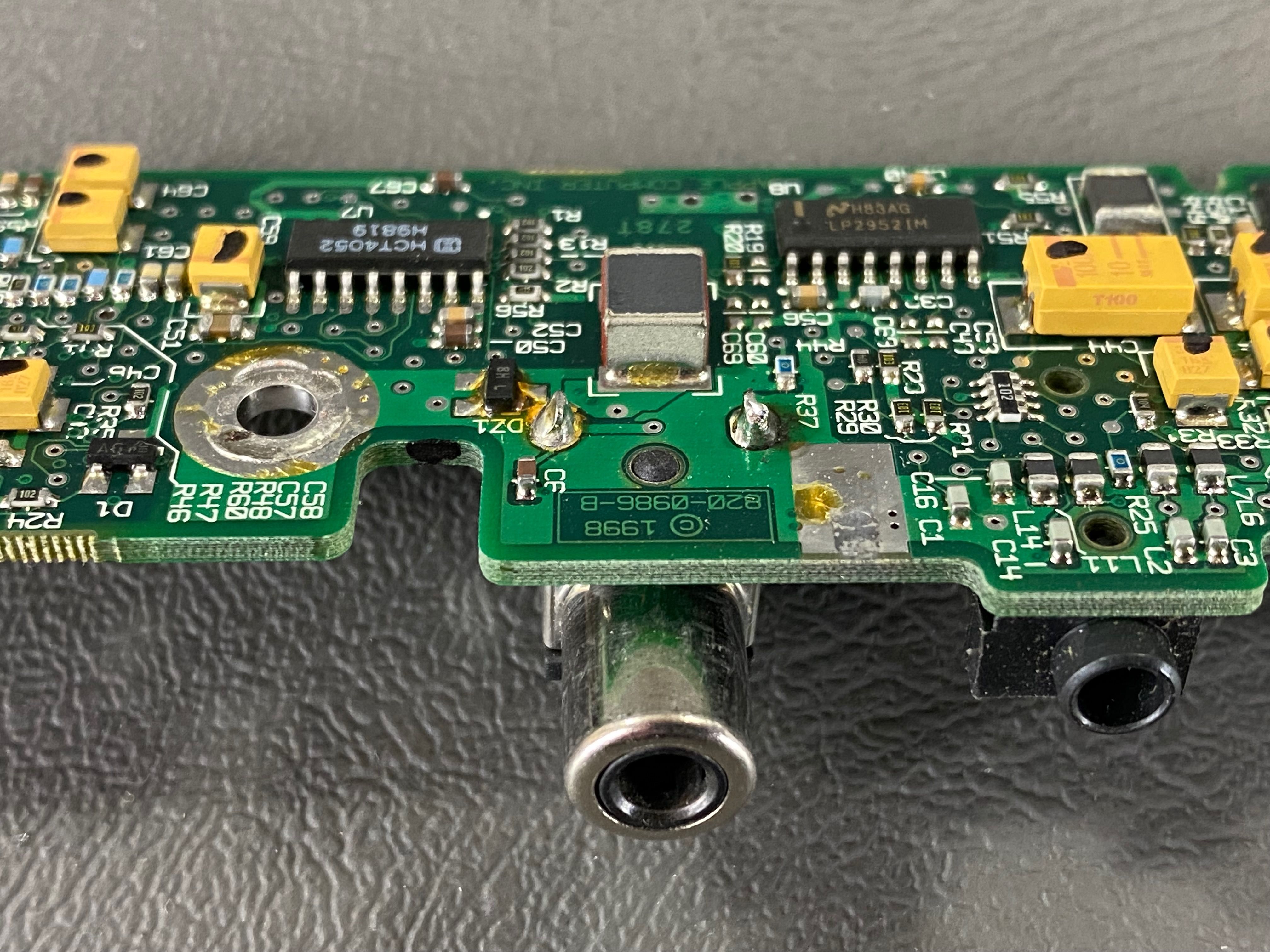

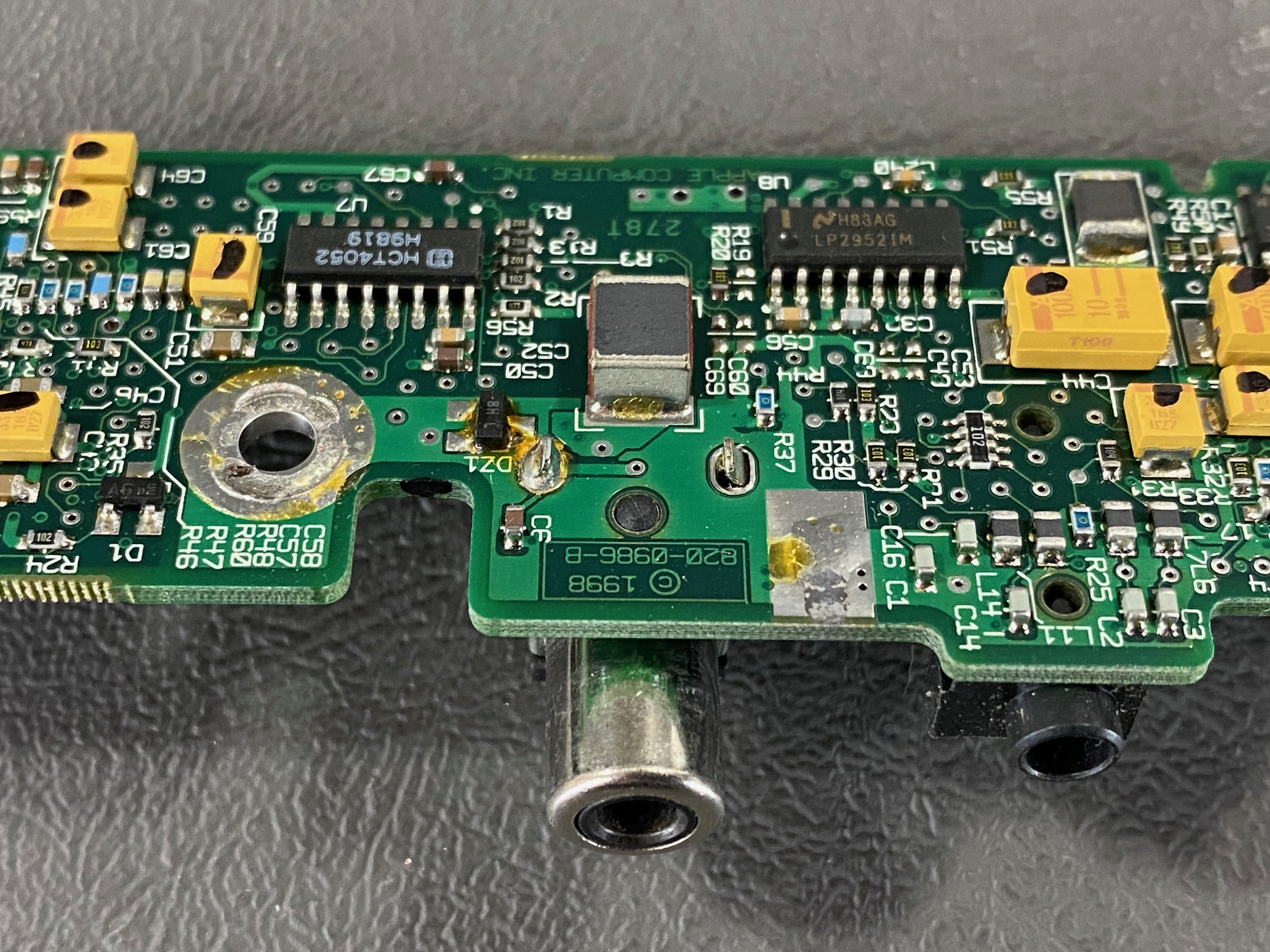

Upon initial inspection it appeared that one of the silver pins (legs) on the sides of the jack was not soldered at all (??). The jack also felt slightly loose when being wiggled. So I re-soldered this in an attempt to fix the connection.
Photos showing how I originally found it:
Photos after re-soldering this side (I am not a very good solderer):
So the jack is now soldered on both sides, and is also no longer loose - but unfortunately the issue persists (no change).

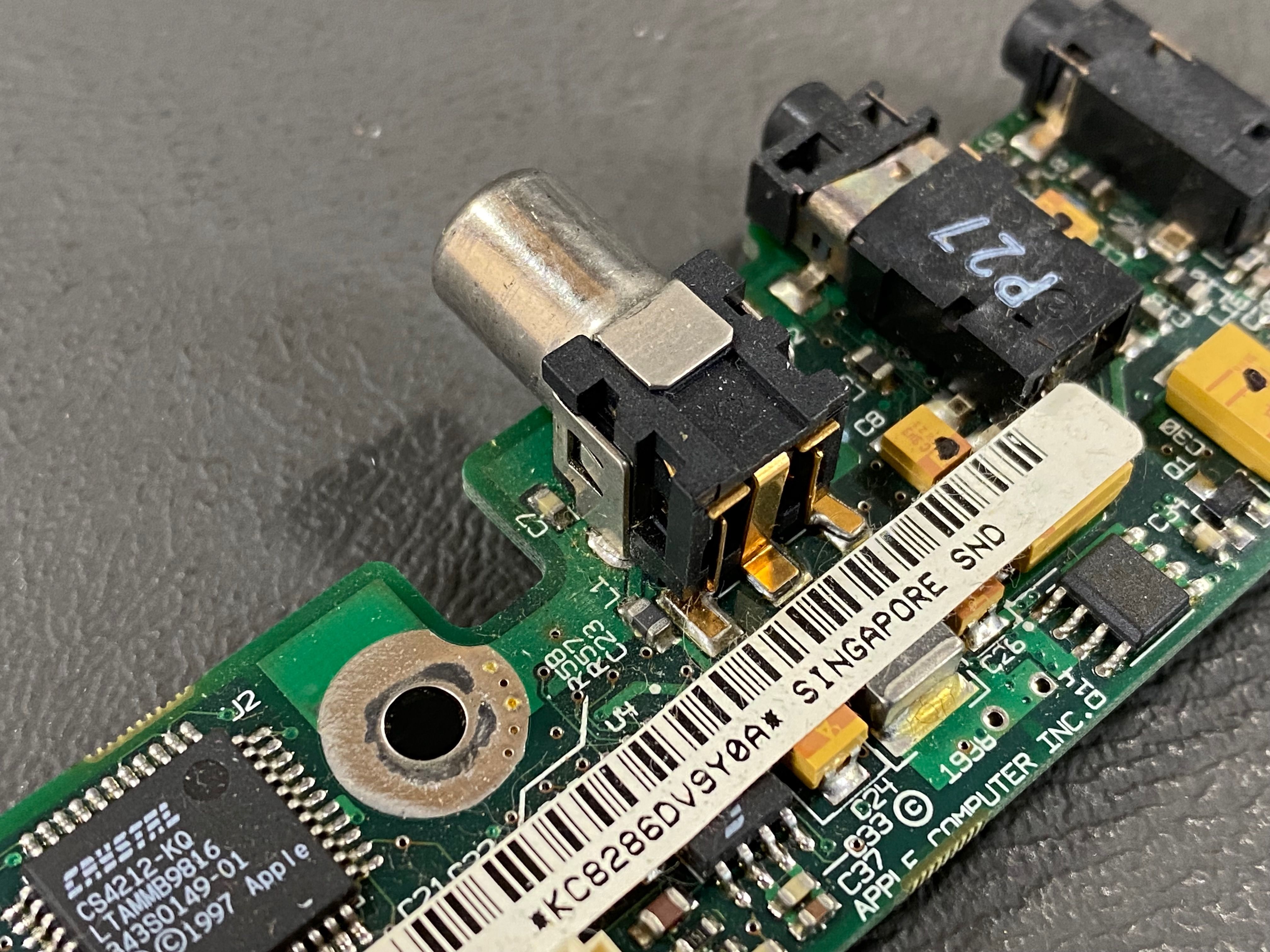

I am wondering if the issue might actually be related to these gold-colored legs on the rear of the jack. If they are also part of the connection, maybe their flat bottomsides are not making good contact with the board? This would make sense as the jack would be tilted back slightly when pressing hard, pushing these closer to the PCB.
If anyone has experience with this sort of issue or ideas regarding how to fix/troubleshoot further, would be much appreciated.
Replacement boards seem to be readily available online but I'd rather fix the one I already have if possible. :)
View attachment 19215 View attachment 19216
View attachment 19219 View attachment 19220
Take a look at the MLCC under the word 'SINGAPORE' - cracked/dry solder on those fillets. I'd add a dab of flux and reflow each side, to be sure.
Reactions: mac27

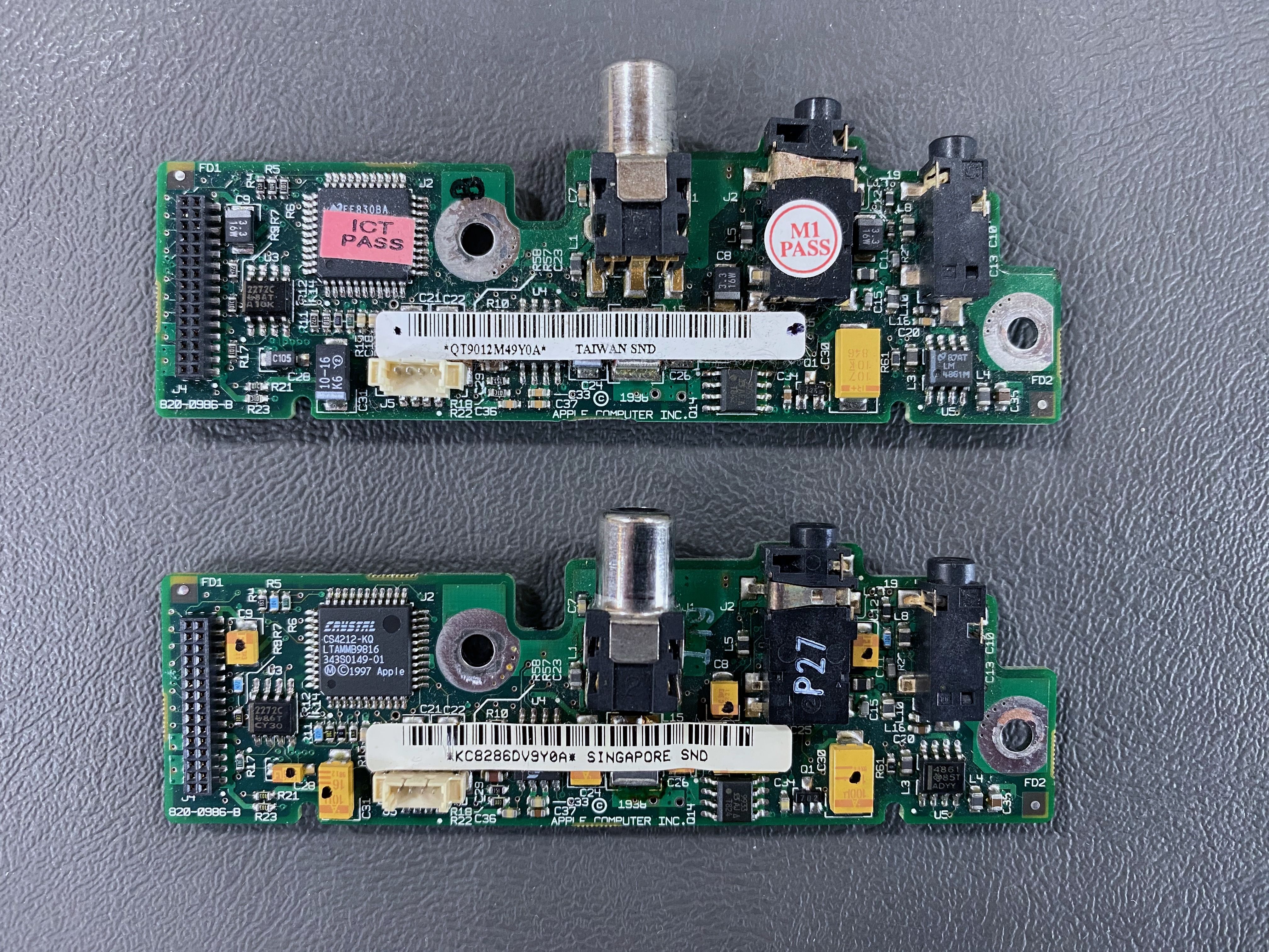

Thanks for the tip - after reflowing the connections on both this MLCC and also on both sides of the power jack, the condition has improved some but a degree of wiggling/coercion is still required. Could just be my lackluster soldering skills and equipment. I've got a tested-working replacement board on the way for a hopefully better solution.

I'm inclined to think that it was something physically wrong with either the solder or maybe some other connection(s) somewhere on the board, as once you applied pressure at certain angles it did send power through and the computer worked fairly normally. But it was just not possible/realistic to hold that much pressure for that long if you actually wanted to use the laptop.
It would seem to me like a fried component would lead to a consistent no-power condition or the like, all the time, regardless of physical pressure applied.

Yes, that is correct. If yours is suffering from a similar intermittent-power issue and you're better at soldering than me then maybe you could fix it! Luckily this board comes right out without removal of the mobo (although it does require near-total disassembly anyways). Cheers!
