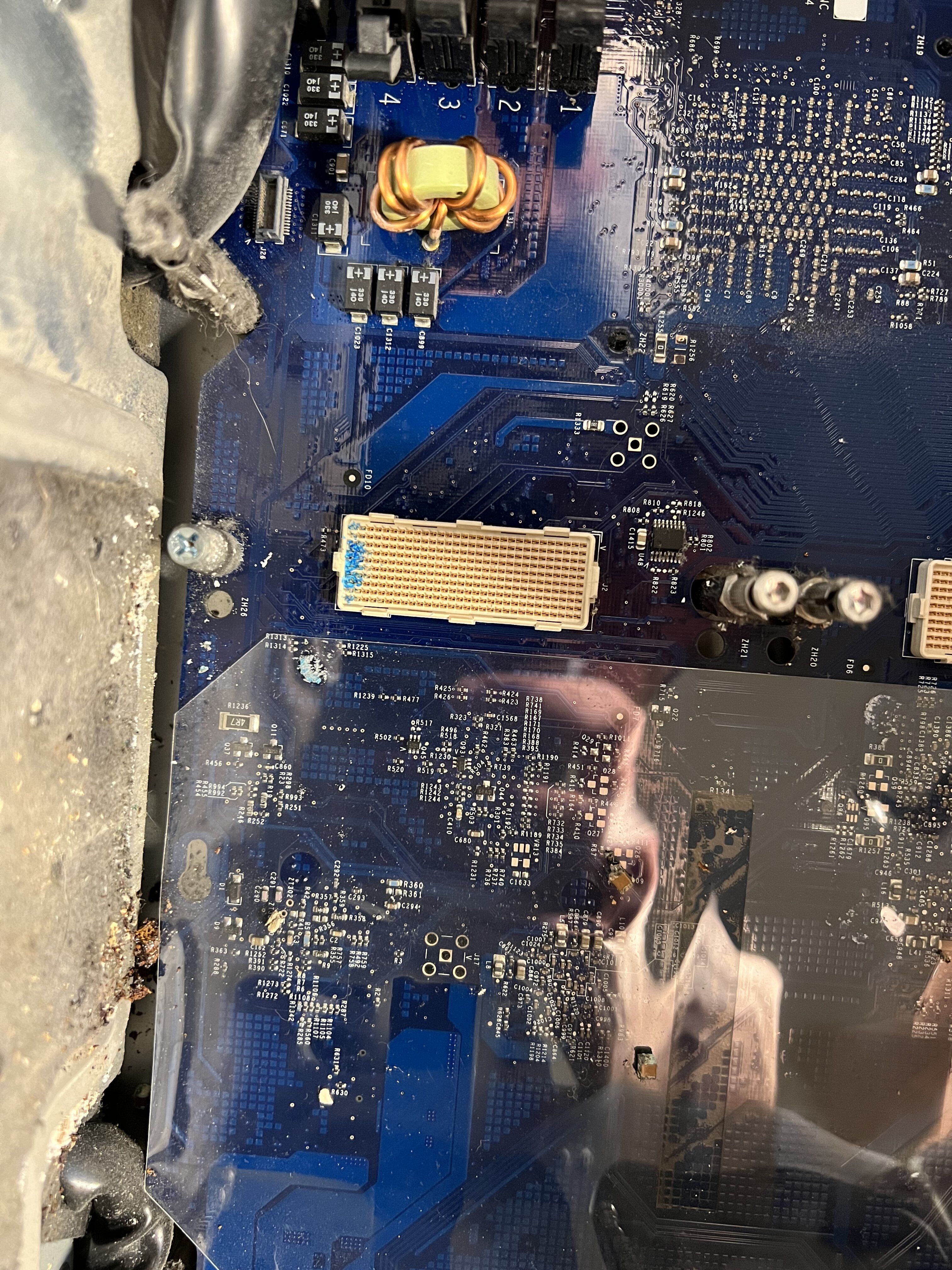

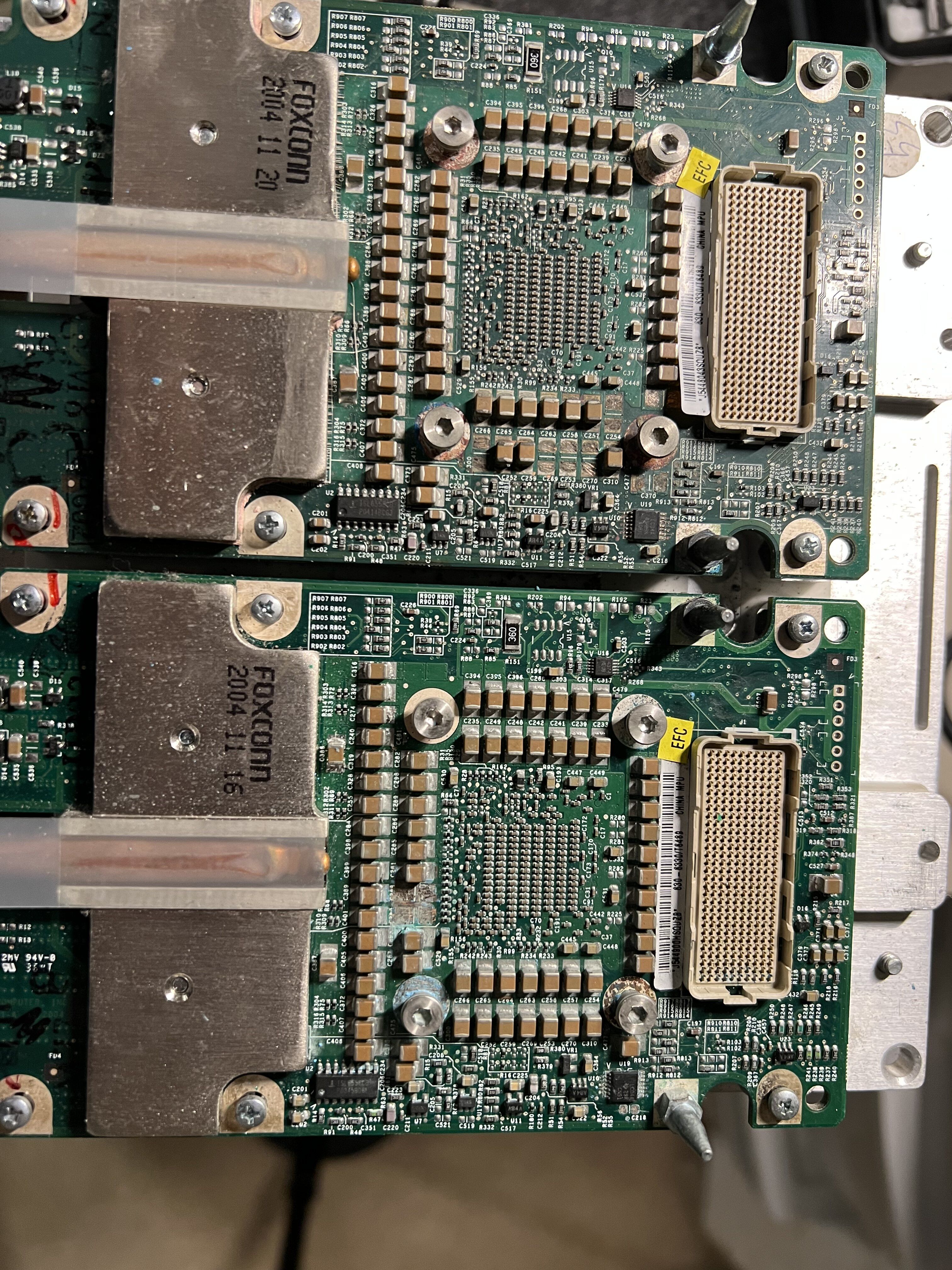

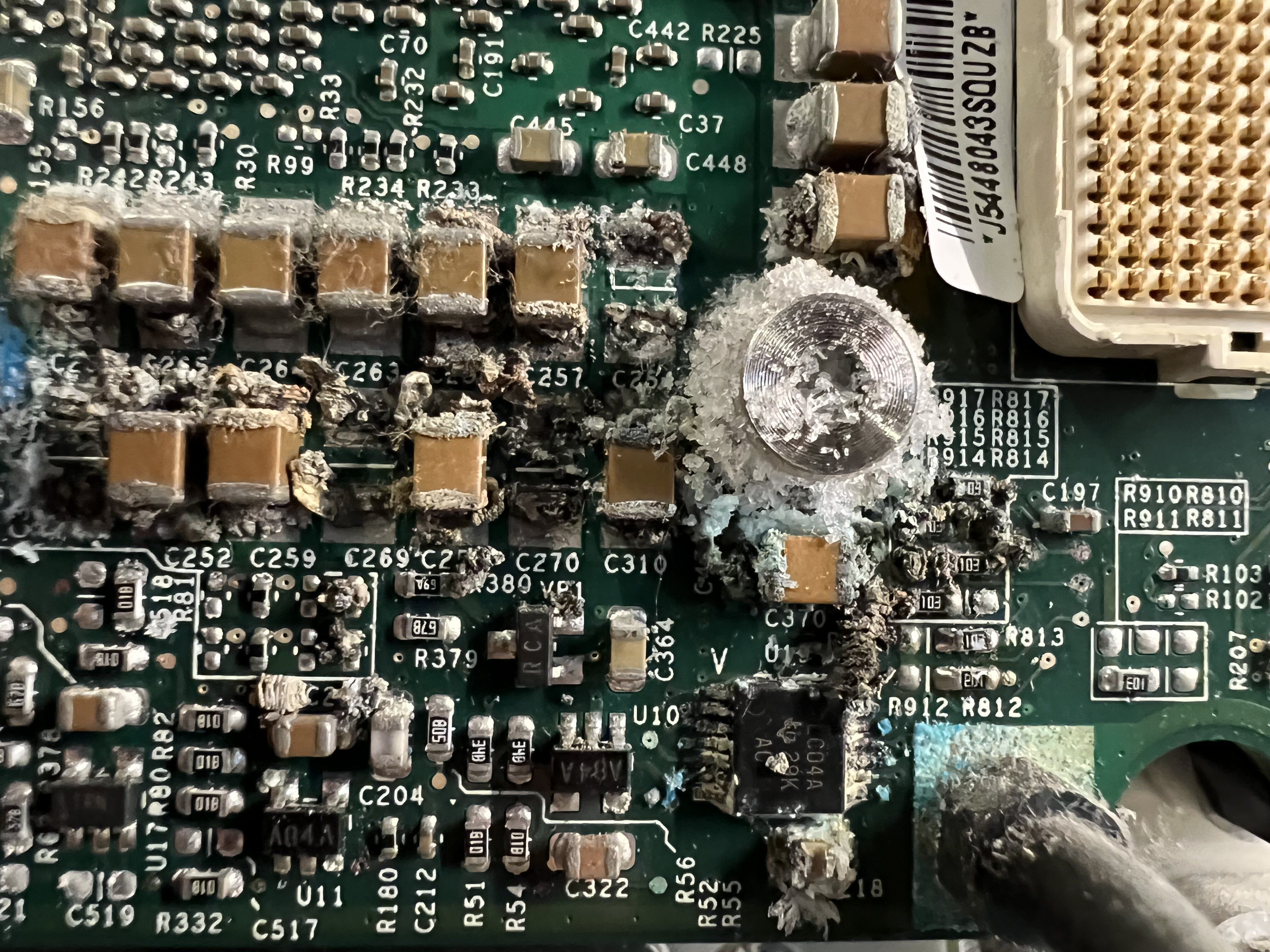

So, I finally decided to avoid the inevitable and took the CPU / water cooling assembly off and confirmed what I suspected (but was hoping I was wrong). The cooling system was leaking, but not enough to reach the PSU. However, it did leak and was corroding a good bit of the CPU daughterboard (is this CPU assembly considered a daughterboard?).

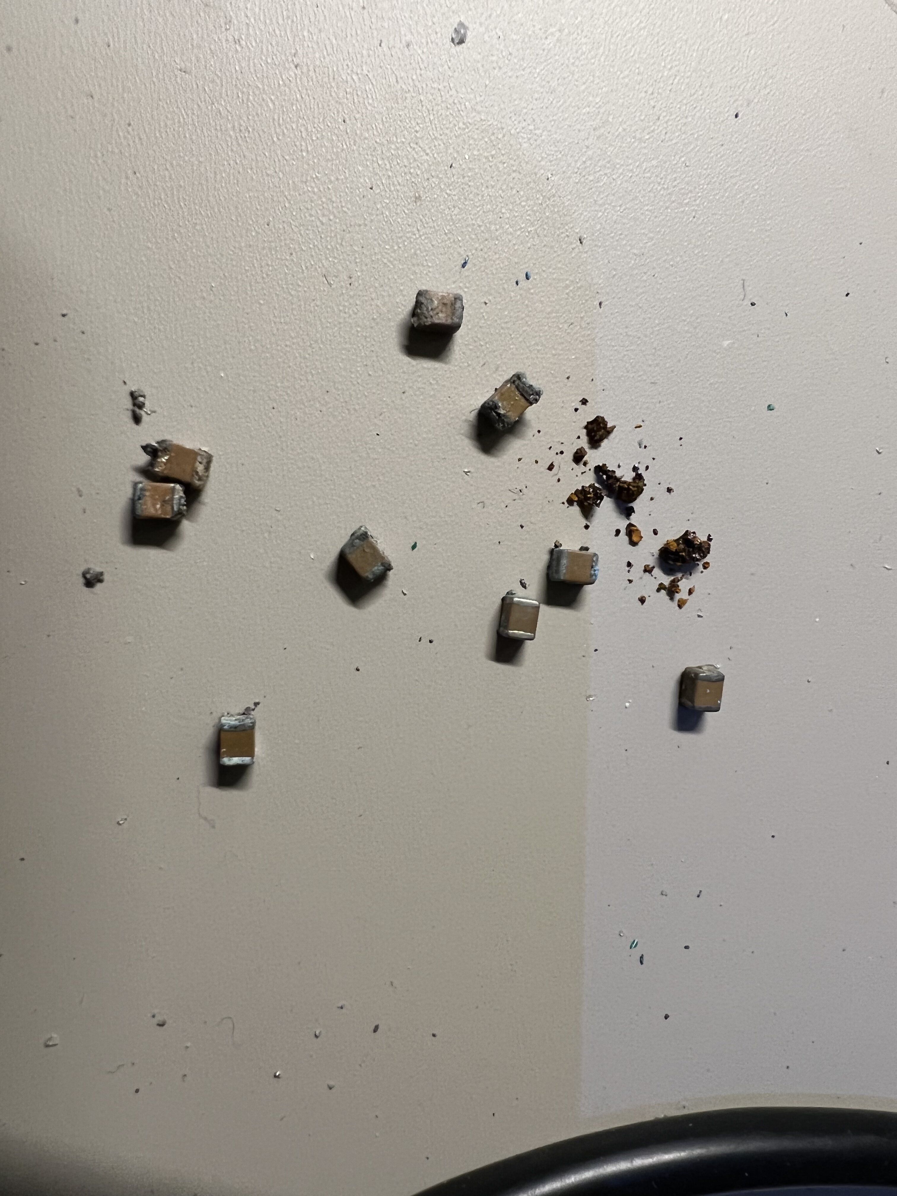

As I was trying to use a toothbrush and isopropyl alcohol to see now bad the corrosion was, caps were just falling off the board. When I was done trying to remove the corrosion, I think about 10 of the capacitors (I think they're capacitors) had fallen off.
I think I know the answer, but is there any way to restore this, solder on some new caps and recover these CPUs? If not, can I use air cooled CPUs from a 1.8GH PCI-X model I have that seems to still work (but I don't use because it smells like cigarette smoke when I run it ; tried everything to de-oderize it, but I think it's just ingrained in the power supply).
Seeing the state of the corrosion, I'm actually surprised it even booted. When I turned the machine on, I heard something rattle away, and I'm assuming it was a cap from the bottom of the board, already fallen off.
It amazes me that they decided to use a corrosive, conductive liquid for the LCS on these machines!

Easily fixable, the other processor will be the blueprint @Branchus can probably give you some soldering tips ;)
