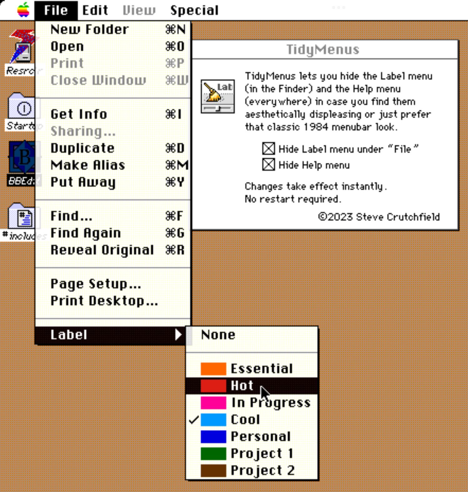

I’m happy to share here TidyMenus (a.k.a. NoLabel 2.0) https://macintoshgarden.org/apps/tidymenus , a simple little Control Panel for System 7 and 8 that can:
  • Hide/Show the Help menu in all applications
  • Re-show the Help menu across all applications at any time, just by opening the Control Panel and unchecking the box, without restarting (this was the hard part — to my knowledge no other INIT/cdev offers this feature)
  • Hide/show the Label menu in the finder under System 7. The hidden Label menu appears and operates as a hierarchical submenu under the ‘File’ menu — as in System 8. You can pop it back to the menubar or return it to a submenu with no restart required.
  • Works correctly for non-English systems, unlike the original NoLabel
  • You can hide the Label menu “out of the box” just by opening the cdev and checking the box without installing anything or restarting (though of course you’ll want to install this if you want to keep the Label menu hidden permanently)
  • Pro tip: the ‘L’ or ‘H’/‘?’ keys in the control panel are shortcuts for the “Hide Label menu” and “Hide Help menu” checkboxes, respectively.
