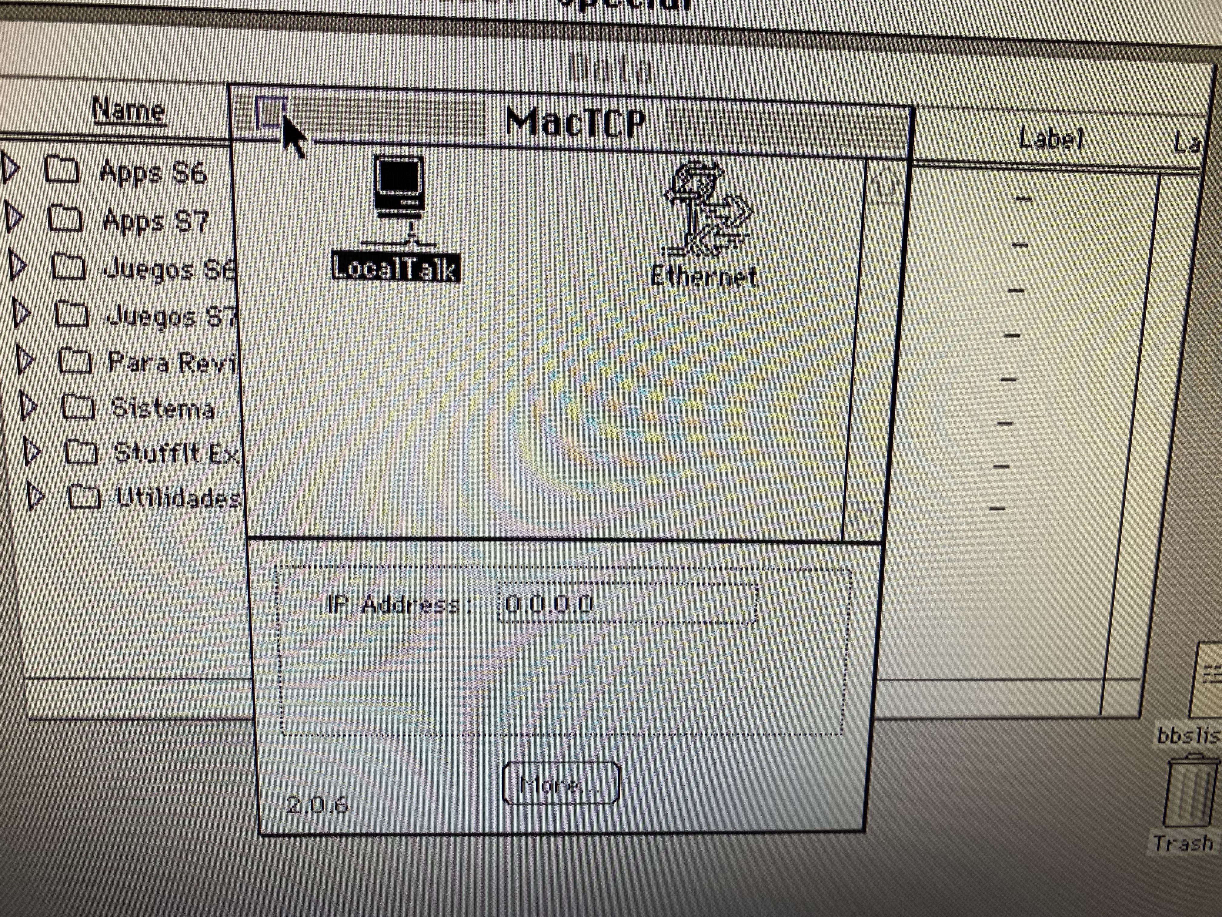

The card lights the link led, but is not detected by the System, so initially I thought it would be a software issue. I tried to install some drivers ("Apple Network Installer" is the only thing I could find) and I got no result.

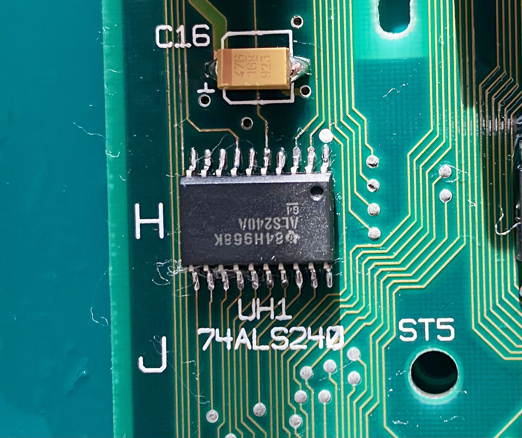

Then I tried the same card in a IIsi, using the same BlueSCSI and SD Card, and it worked at first attempt. As the System and config is exactly the same, I'm thinking now in an issue with the NuBus ports in the IIci... That Reddit post was giving the hint... The IC that acts as bus driver (74ALS240) seems to be just a bit corroded by the nearby Cap that was replaced, but maybe is worse that it seems...

Visually the chip didn't look too bad:

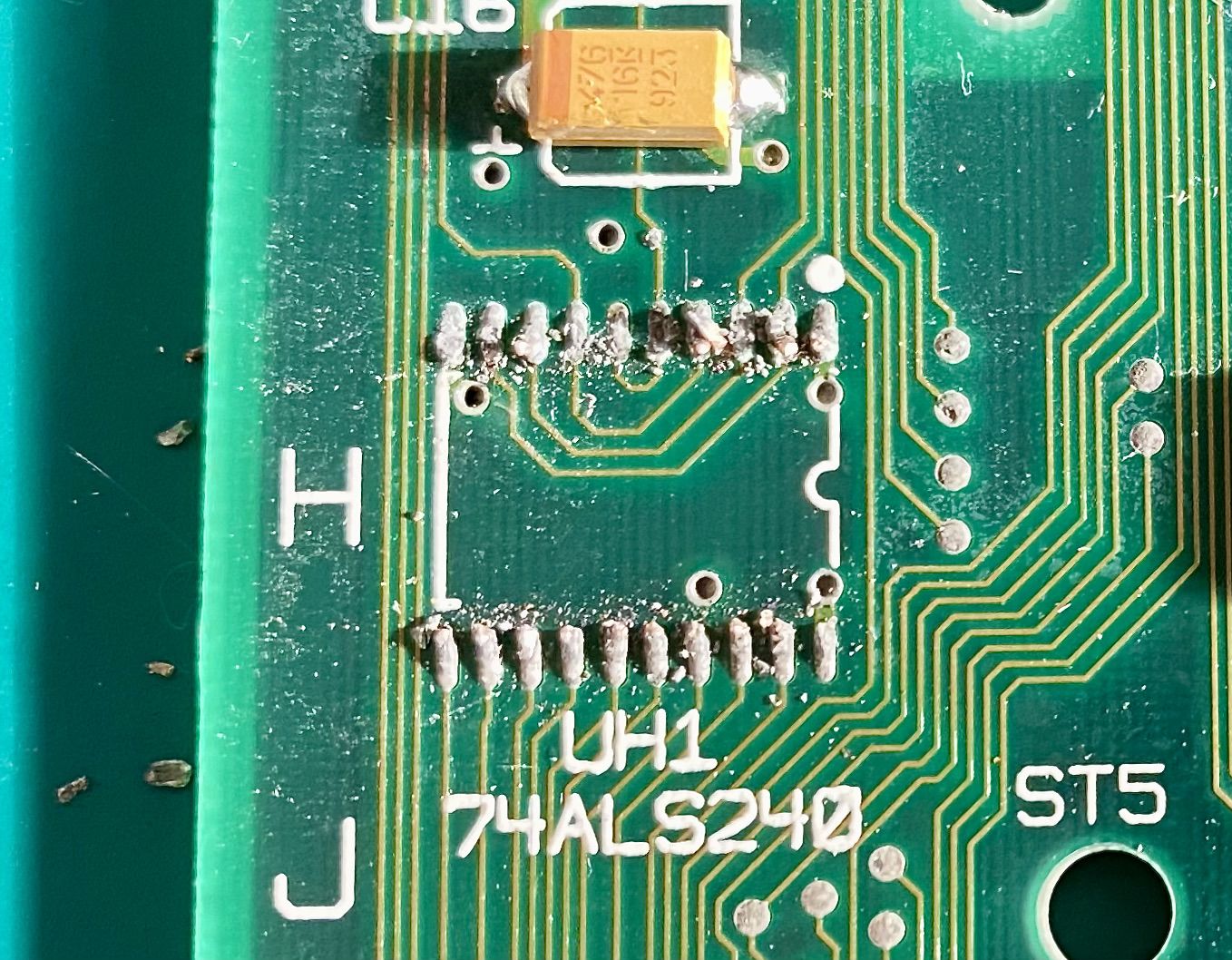

But when clipping the legs (I don't know how to use properly the heat gun, so I didn't want to risk removing a pad or something) I could see that were quite corroded, and when cleaning the pads I got a pretty nasty goo.

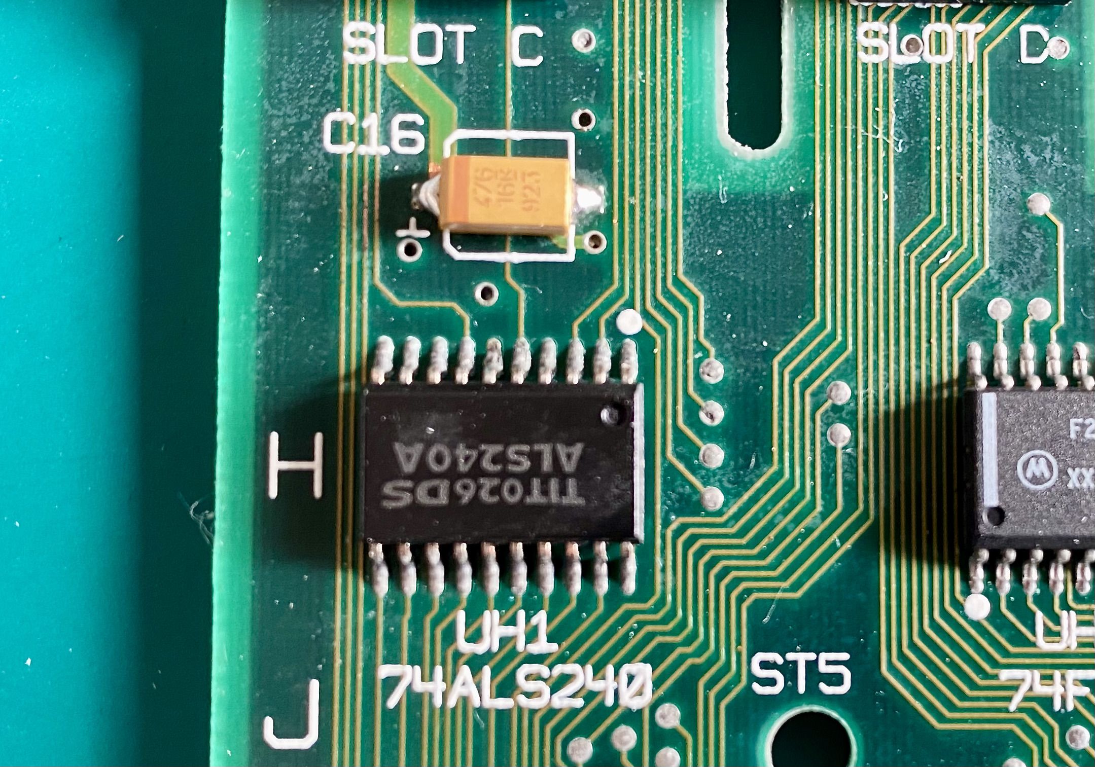

The replacement came from Aliexpress, as I could only find other options from the US and shipping was too expensive. I was a bit scared about getting something bad.
But everything works now. The Ethernet card was detected immediately, and the Macintosh Display Card 8•24 works wonderfully. So now I have network and millions of colours!
So, @Bolkonksij, this is worth of trying. The chips I got are these.
