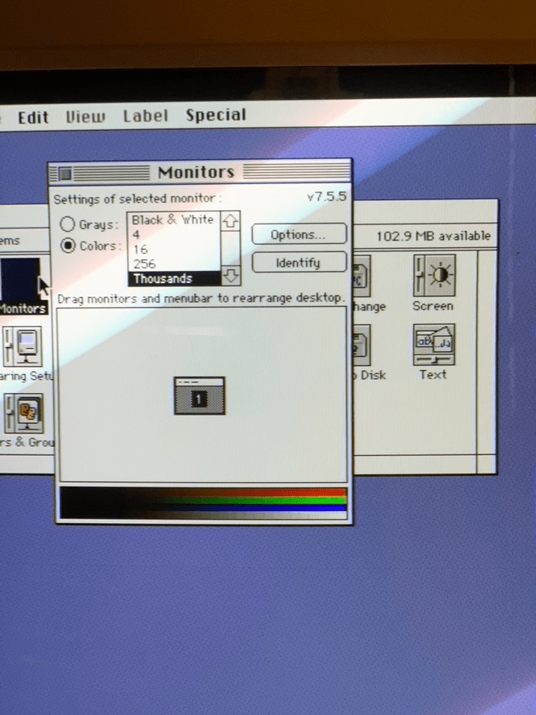

Upon receiving it with an accompanying Apple Multiple Scan 15 Display, I gave it a nice cleaning and a test boot. It fired up with no bong, and the display showed a greenish-gray tint. Fun, several items to repair! I checked with both the Monitors Control Panel and Apple Personal Diagnostics and after troubleshooting with a good known working CRT I determined that the blue color channel was not working, likely pointing to something on the logic board or on the video/sound daughterboard. I checked the Sound control panel to make sure the volume was not set to zero (it wasn’t ). Therefore, it was time to crack open the case to determine if the latter was a speaker problem or another logic board problem. I should mention that the IDE hard drive, floppy drive, and CD-ROM drive all functioned fine. At least there was that.

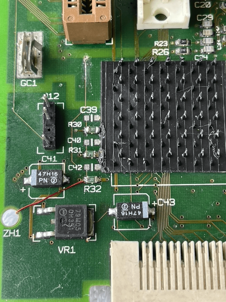

Because the Quadra 630 has on-board graphics, I decided to check the schematics of a Macintosh IIsi which also has on-board graphics to see if I could learn anything that I might apply to the Quadra 630. The one thing I noted in the IIsi schematics is that the RGB circuits are essentially symmetrical in their passive components except for connecting to different pins on the video chip. Therefore, on the logic board I expected I would be looking for sets of three passive components between the connector and the video chip for troubleshooting. But I had no idea where to look. Because the Quadra 630 uses one of those internal edge connectors like the Color Classic and 575, this was going to be a bit more involved. I started with the video out DB-15 connector and identified the Blue Video Signal (pin 9, by the way) and traced it through the video/sound daughterboard to the 34-pin connector that connects the daughterboard to the edge connector, then to the logic board. After verifying that there were no broken connections from the DB-15 through the daughterboard and cables to the edge connector, the next challenge was figuring out where on the logic board the video signals exit. Turns out it is on the lower left side, oriented where the external ports are on the top and the edge connector is on the bottom. Sure enough, there was a set of three resistors near one of the caps I replaced.

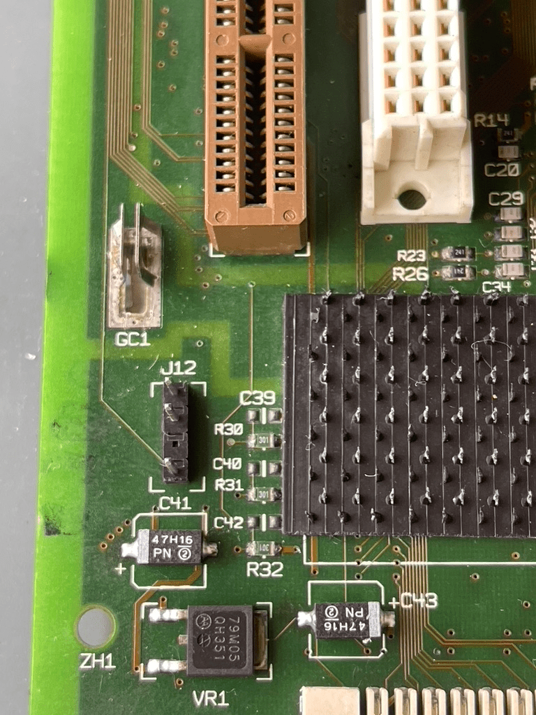

I identified the resistor on the Blue Video Signal circuit, which turned out to be R32, and measured the resistance of the cap at R32 in circuit and got 300 ohms. This matched the marking on the resistor. The other two resistors at R31 and R30 measured 60 ohms in circuit. Aha! Either the resistor at R32 was somehow bad (not likely) or there was a broken trace somewhere on the Blue Video Signal trace that was not loading down the resistance in the circuit like what was happening with what I suspected were the red and green video signals!
To ensure I was not getting false readings, I removed all three resistors and measured them out of circuit. All three measured 300 ohms.
The Quadra 630 sports a Valkyrie graphics chip onboard the logic board. I decided to check continuity from each of the resistors R30, 31, and 32 to see if they were connected to the video chip. Sure enough, R31 was connected to pin 54, and R30 was connected to pin 55. R32 did not register with any pin on the Valkyrie chip. Looking around the circuit near the Valkyrie chip, pins 53, 54, and 55 had a similar pattern of passive components, telling me it was likely that there was a break somewhere between R32 and pin 53 on the Valkyrie chip. Sure enough, after very careful tracing, I found a crusted via near the R30/31/32 cluster that was on the R32 circuit. You can see it in the photo below next to GC1, the slot connector, and the battery tacky. I added a bodge wire from R32 to the backside of the board on the circuit to pin 53 on the Valkyrie chip, reinstalled the board and crossed my fingers.
Bam! No more greenish-gray tint – full color restored!, and no smoke!
