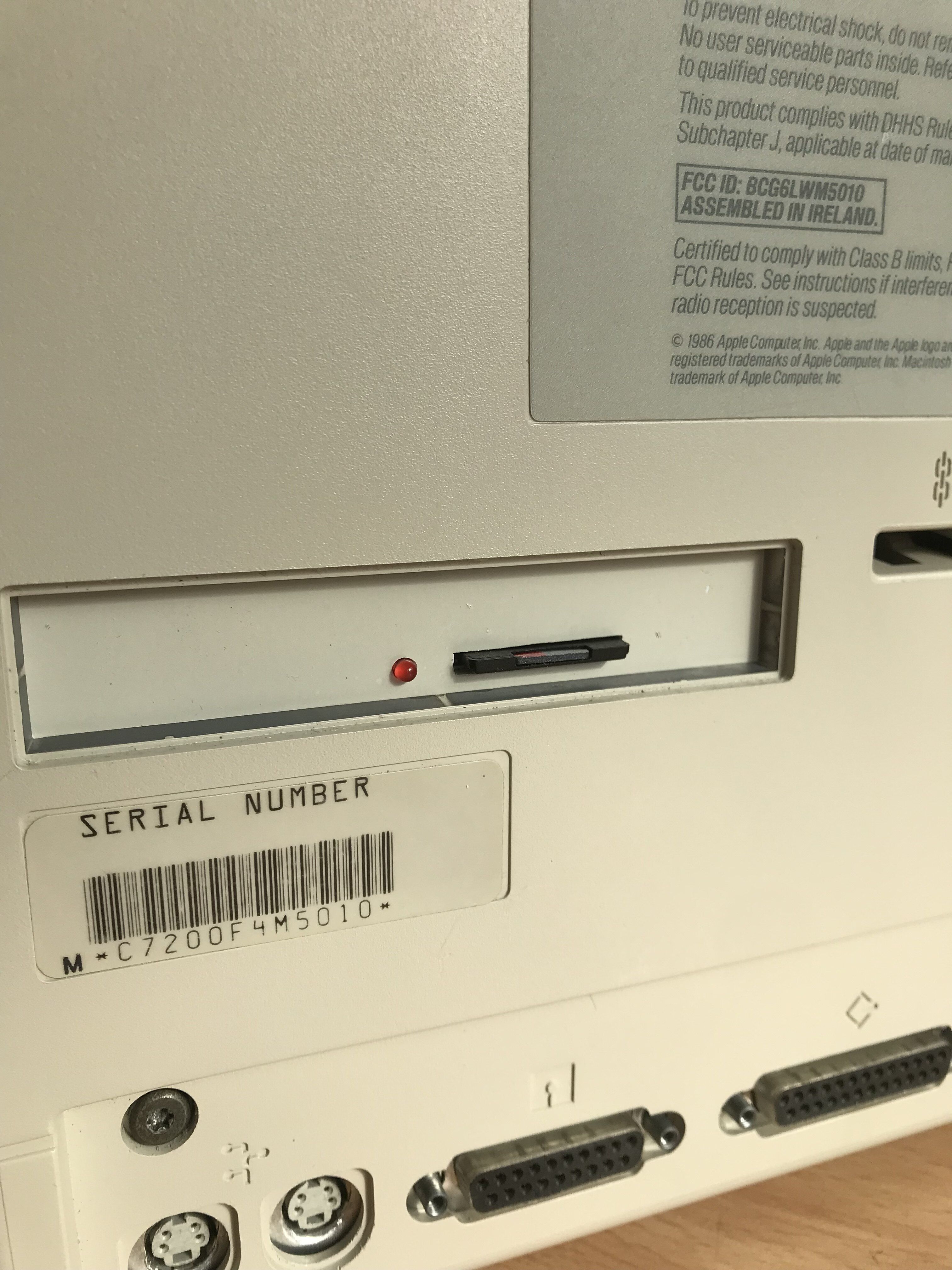

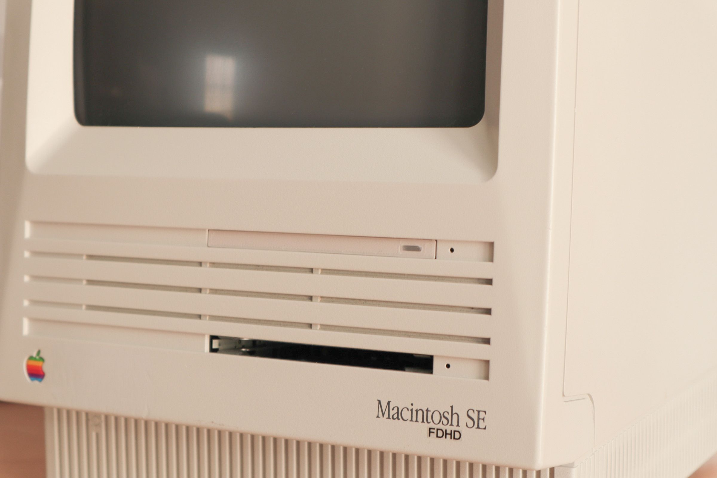

I have some really good success mixing 6:1 Ammo MIG acrylics 965 Dunkeigalb Shine and 911 grey shine. sadly the numbers on my labels is wearing offf making it difficult to identify correctly but I am fairly sure that is right. I also add 1 part black or 1 part white to adjust for age.
Regarding filament: the Polymaker brand that is mentioned in the post @eric shared/linked is terrific. big thanks to @MacintoshLibrarian for all the effort in getting this colour available to us all.
In the images attached, the SE drive slot is bare filament colour and the rear is painted with Ammo MIG The slot cover 3d print stl is available from my page on printables if anyone needs one. The rear SD slot is made from white plasticard.
