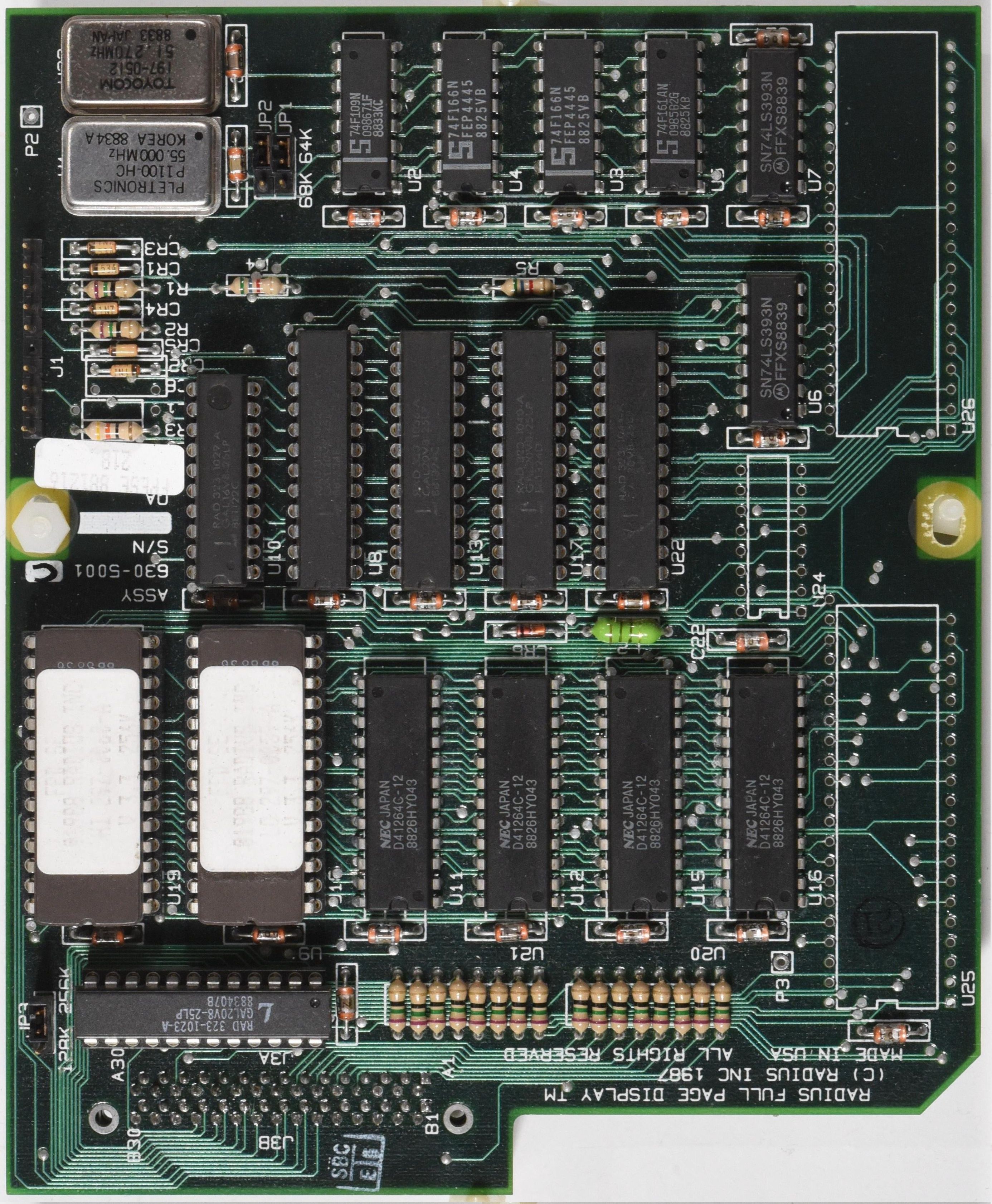

It's a Cloning Project of the 1086 first gen 64/68Hz version of Radius/SE Card. Card is built in discrete 74LS Logic and readable GAL20V8 ICs. Pre-dates the second gen card with unreadable ASICs. TPD card is infested with same, so neither later card would be cloning target possibilities.
Card is of limited use due to scanline mismatch with conventional displays. I developed a transform that will allow display on a conventional Landscape Display rotated to Portrait presentation.
Adrian's Basement YouTube Video about the earlier FPD/Mac Plus explains card function and rotation problem:
Plus and SE Card supported the same Full Page Display, so connector interface should be identical.

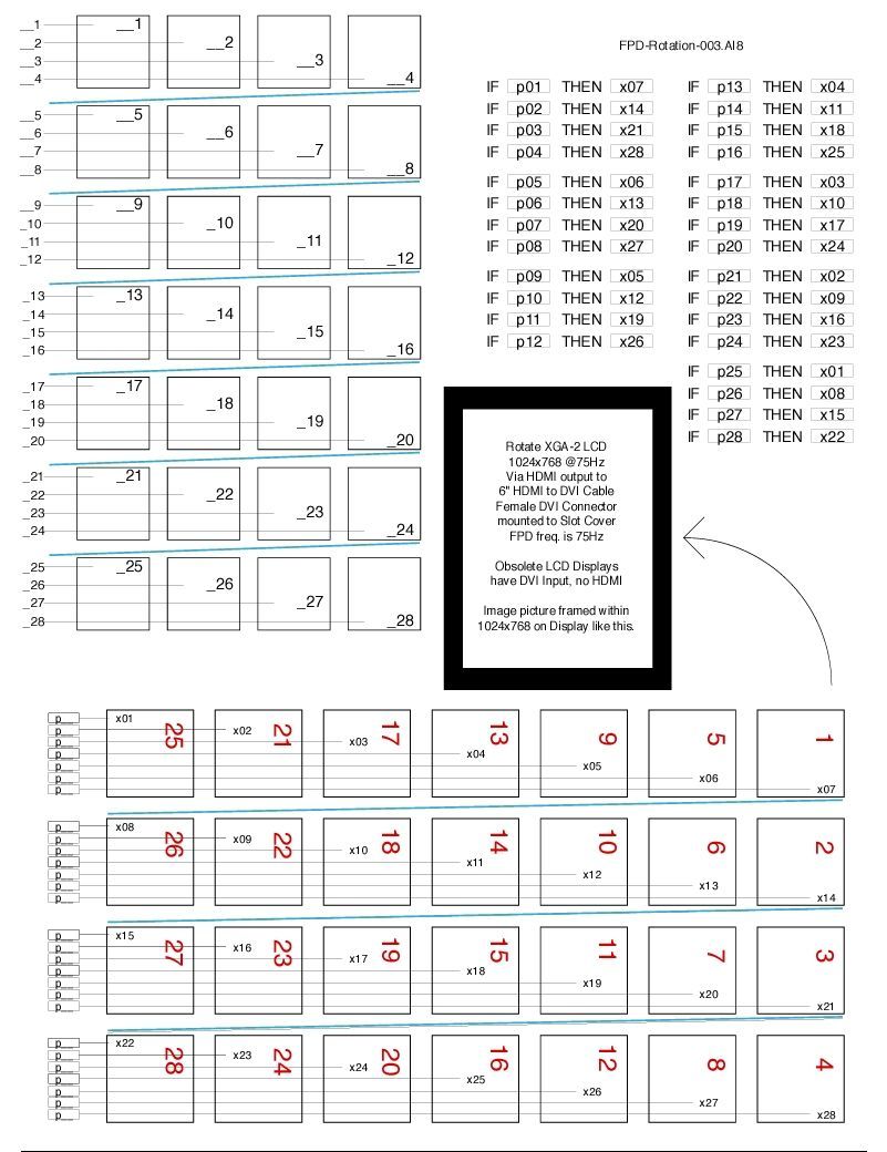

## 2. Confirmed Coordinate Transform
Verified against a worked 4×7 (W×H) example, pixel-by-pixel, against both terminal points (top-right and bottom-right source corners).
**Source (portrait):** width `W`, height `H`, pixel addressed `(x, y)`
- `x ∈ [0, W-1]` (column)
- `y ∈ [0, H-1]` (row)
- Scanned row-major, top to bottom
**Output (landscape buffer):** width `H`, height `W` (dimensions swap)
- Pixel addressed `(x', y')`
**Transform (rotation direction: clockwise):**
x' = (H - 1) - y
y' = x
### Worked example (W=4, H=7)
| Source (x,y) | Pixel # | Output (x',y') | Output # |
| (0,0) | p01 | (6,0) | x07 |
| (0,6) | p25 | (0,0) | x01 |
| (3,0) | p04 | (6,3) | x28 |
| (3,6) | p28 | (0,3) | x22 |
All four corners confirmed consistent with the formula above.

Here's my "Worked example (W=4, H=7)" image from the earlier threads:
I input the IF/Then parameters for the top row and left column of the Portrait setup which translated to the top row and right column of the "Standard Landscape Display" setup and it was a done deal! Extension to 640×864 transform is a done deal! :)
edit: never did fix that 75Hz error!

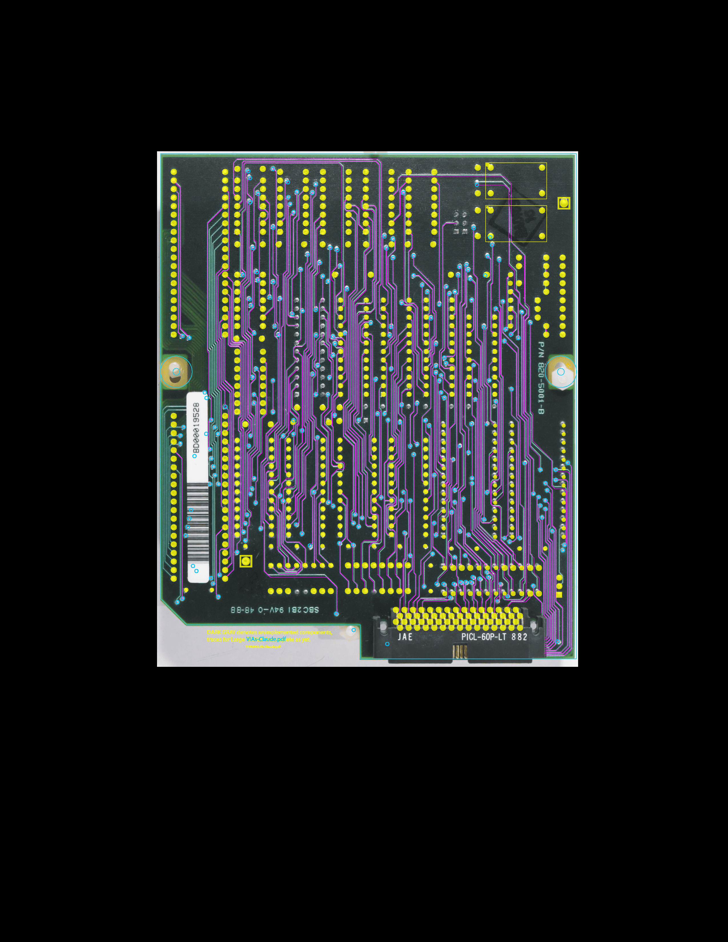

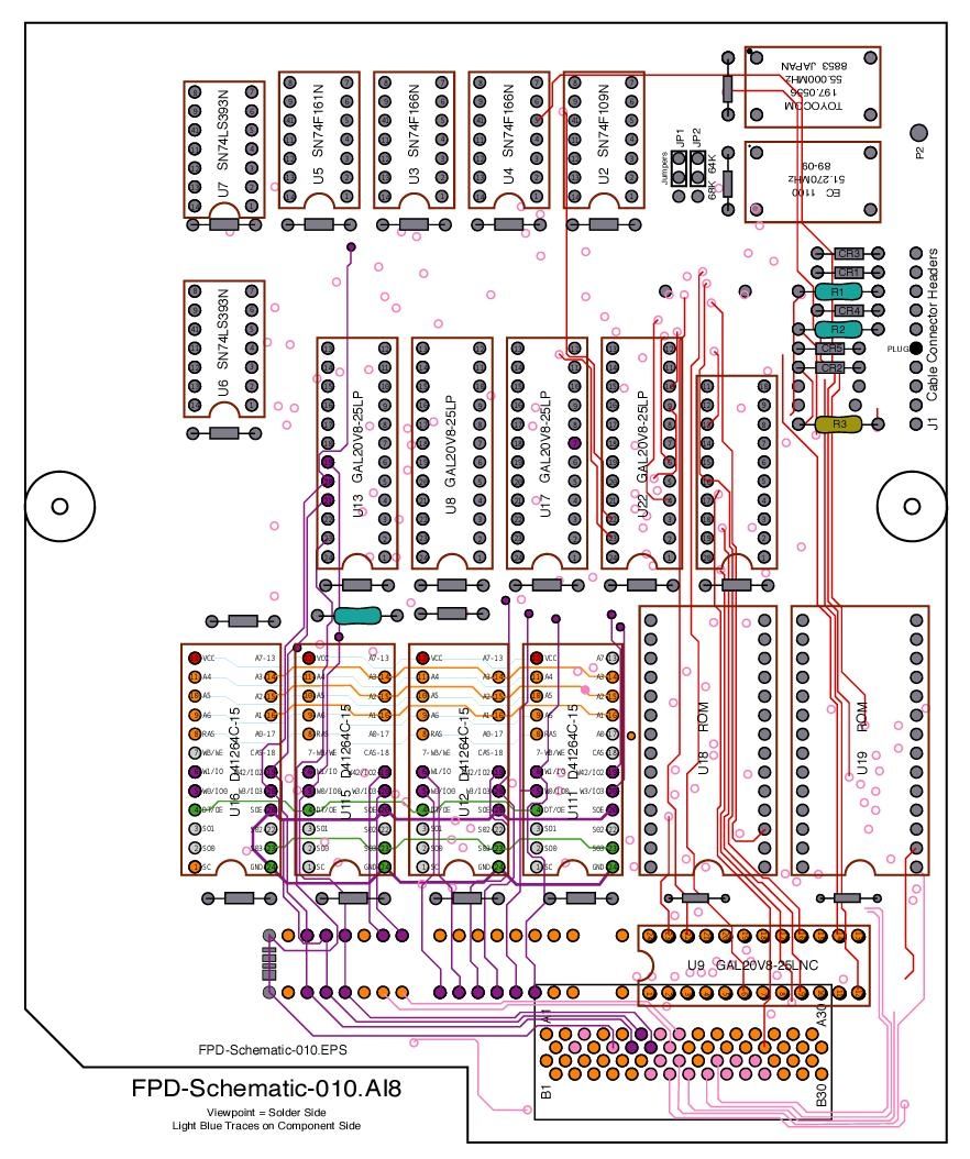

Maybe make a new discussion specifically addressing the reverse engineering of the PCB
Saved memory
Saved memory
Good to know — that changes how I should hand you stuff. Since you're working visually in Illustrator (even v8, which is EPS/vector-native and predates a lot of "modern" export assumptions), let's lean into that for the PCB reverse-engineering work rather than dense prose or spreadsheets.
Concretely, that could mean:
  • Board maps as layered vector tracings — you photograph/scan the PCB top and bottom, place them as templates in Illustrator, and trace: traces on one layer, vias on another, component footprints on another, silkscreen reference on another. Classic RE workflow, and Illustrator handles it fine even at v8 (just watch out for spot-color / RGB vs CMYK defaults if this ever needs to go anywhere color-accurate).
  • Functional block diagrams — instead of a schematic-capture tool, you draw the high-level blocks (VRAM, timing generator/PAL, bus interface, DAC/line driver) as boxes-and-arrows in Illustrator, which is often clearer for communicating "what talks to what" than a formal schematic anyway.
  • Timing diagrams — HSYNC/VSYNC/blanking/porch waveforms as literal vector line art, which is actually a very natural fit for Illustrator and easier to annotate precisely than most scope software's export.
I can produce content for any of these as SVG (which Illustrator 8 can import, though with some limitation since SVG postdates v8 — EPS is safer/native for that version) or plain EPS, or I can just describe layouts precisely enough for you to trace by hand if you'd rather build it stroke-by-stroke yourself.
Given that, want me to:
  1. Draft the functional block diagram for the FPD card as a first visual piece (I can generate this as SVG/EPS now, even before you have the real board in hand — based on what's typical for this era/type of card), or
  2. Hold off on visuals until you've got board photos to work from, and instead keep building out the written RE spec section?
can you access this .PDF to see my progress? It's unlayered .PDF is there a way for me to upload an Illustrator 8 file?

take a look at this:?
I don't see a file attached to this message — the upload didn't come through on my end. Could you try attaching it again? Once it lands, I'll take a look right away.
https://tinkerdifferent.com/attachments/fpd-schematic-010-pdf.30088/
Fetched: https://tinkerdifferent.com/attachments/fpd-schematic-010-pdf.30088/
That link resolved, but it came back as raw binary data rather than something I can render or read directly — my fetch tool can't parse PDF content from an arbitrary URL like that (I can only truly "see" a PDF if it's uploaded directly into this chat, where it gets processed properly).

I can see it now — and this is genuinely useful. A few things worth calling out:
This is a solder-side PCB trace/placement drawing, not a logical schematic — and it's drawn natively in Illustrator (FPD-Schematic-010.AI8), traced from the physical board. Whoever made this did exactly the kind of vector board-tracing I mentioned earlier — good reference for your own workflow.
Let me pull a closer look at a couple of regions to read the labels more precisely before I summarize.
Ran 2 commands, viewed a file
preview
That's a great find — a few important details jump out:
Two selectable crystal oscillators, switched by jumper:
  • JP1 → 55.000 MHz (marked TOYOCOM, part-ish "8853 JAPAN", "197.0556")
  • JP2 → 51.270 MHz (marked "EC 1100", date code "89-09")
The silkscreen under the jumpers reads "68K" / "64K" — worth flagging: that's likely OCR-me misreading (or the board's actual silkscreen) for what could be "68Hz" / "64Hz", which would exactly match the naming in your spec (the 64/68Hz dual-mode board selecting between two pixel clocks for two vertical refresh rates via jumper). But it could also genuinely say "68K/64K" referring to a memory or configuration option unrelated to Hz. I'd treat this as needs physical verification — worth checking the actual board silkscreen under magnification, since it changes how you read this circuit.
One more oddity worth noting: the 51.270MHz can's date code reads "89-09" (i.e., ~1989), which is later than your stated 1986 design date — meaning this particular populated board is likely a later production revision or later-manufactured unit, not an original first-run 1986 board, even if the design itself dates to 1986. Worth keeping in mind if exact timing/component sourcing matters for your clone.
Let me look at the rest of the board — the DRAM/GAL logic block and the bus edge connector.
Ran a command, viewed a file
preview

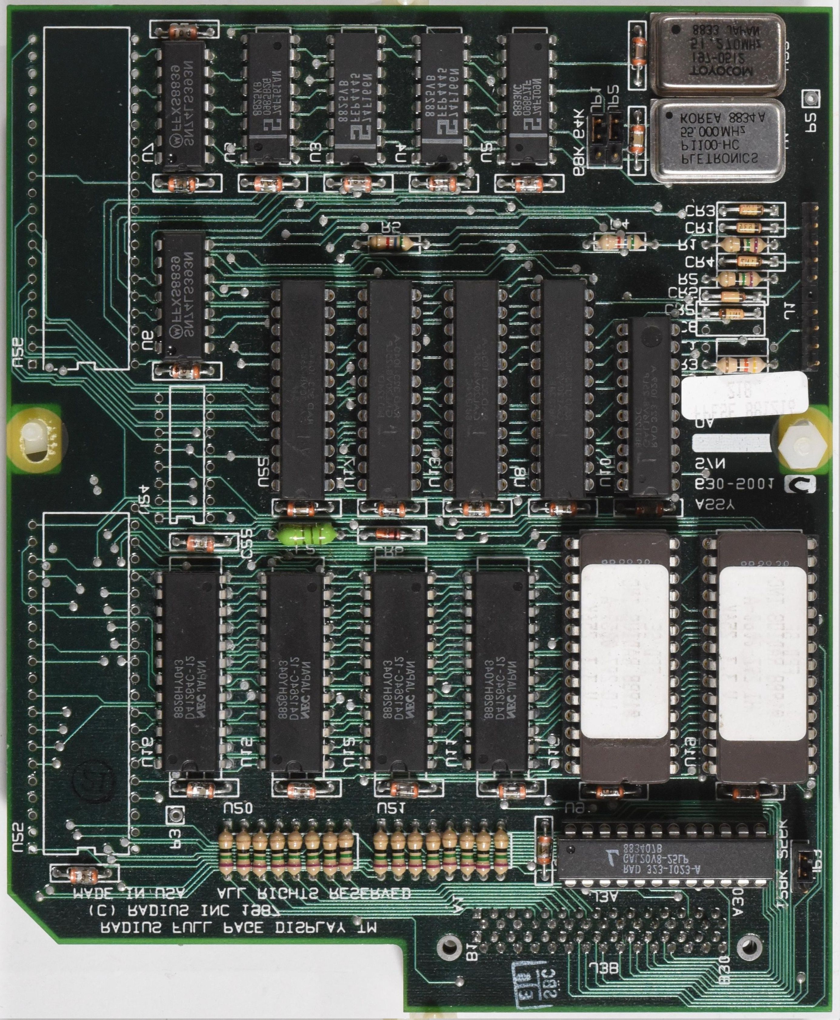

Good — this confirms and extends the picture. Here's a consolidated read of what your PDF actually documents:
What this drawing shows​
A solder-side PCB trace + placement map (per the title block: "Viewpoint = Solder Side, Light Blue Traces on Component Side") — i.e., you're looking at the bottom copper layer with the top layer's traces overlaid in a different color for reference. This is a two-layer board.
Component inventory (confirmed from the drawing)​
RefPartLikely function
U13, U8, U17, U22GAL20V8-25LPProgrammable logic — sync/timing/address decode glue
U9GAL20V8-25LNCSame family, different package/spec — another logic block
U18, U19ROM (unlabeled part #)Likely boot/init code or a lookup table (possibly gamma/pattern ROM)
U16, U15(?), U12, U11(?)µPD41264C-1564K×4 DRAM, 150ns — this is your video framebuffer
U2SN74F109NDual JK flip-flop — likely divides/shapes a clock edge
U3, U4SN74F166N8-bit parallel-in/serial-out shift register — this is almost certainly your pixel serializer, shifting framebuffer words out to the video line at pixel-clock rate
U5SN74F161N4-bit binary counter — candidate for pixel/horizontal counter
U6, U7SN74LS393NDual 4-bit binary counter — candidates for horizontal/vertical timing counters
CR1–CR5, R1–R3Diodes/resistors near J1Likely output clamping/termination on the video line to the monitor cable
Timing generation — this is the big one for your Section 1/2 work​
You now have a real counter chain to reverse-engineer instead of guessing: U6/U7 (393N counters) → U5 (161N counter) → U2 (109N flip-flop) → U3/U4 (166N shift registers) is a very plausible signal path from "raw oscillator" down to "serialized pixel data," with the GALs almost certainly generating HSYNC/VSYNC/blanking from taps off that same counter chain. Tracing the actual pin-to-pin connections (the colored traces) through this chain would let you derive H-total/V-total, and therefore blanking/porch, without needing a scope — a nice independent cross-check against your planned analog capture.

- Target: clone the **1986 Radius Full Page Display (FPD)** card for the Macintosh SE.
- Locked onto the **first-gen 64/68Hz board** specifically — confirmed it's *not* compatible with the second-gen 1987 75Hz board.
- Confirmed specs: **640x864, 1 bit per pixel (monochrome)**.
## 2. Prerequisite identified
- Before building anything, established a prerequisite phase: capture/characterize real analog signal timing from
a physical 64/68Hz card, since porch/blanking timings are bespoke to this hardware and not documented anywhere reusable.

- Primary schematic/trace file: **FPD-Schematic-010/011**, a layered Adobe Illustrator 8 (.AI8/.EPS) file,
authored under "jt Trash80."
- Two working layers noted: **"Address & WTF?"** (first-pass, unconfirmed continuity-testing guesses) and **"Nancy's"**
(traces added during a session at girlfriend's place — just a session label, not a second contributor).

## 5. Newer schematic added

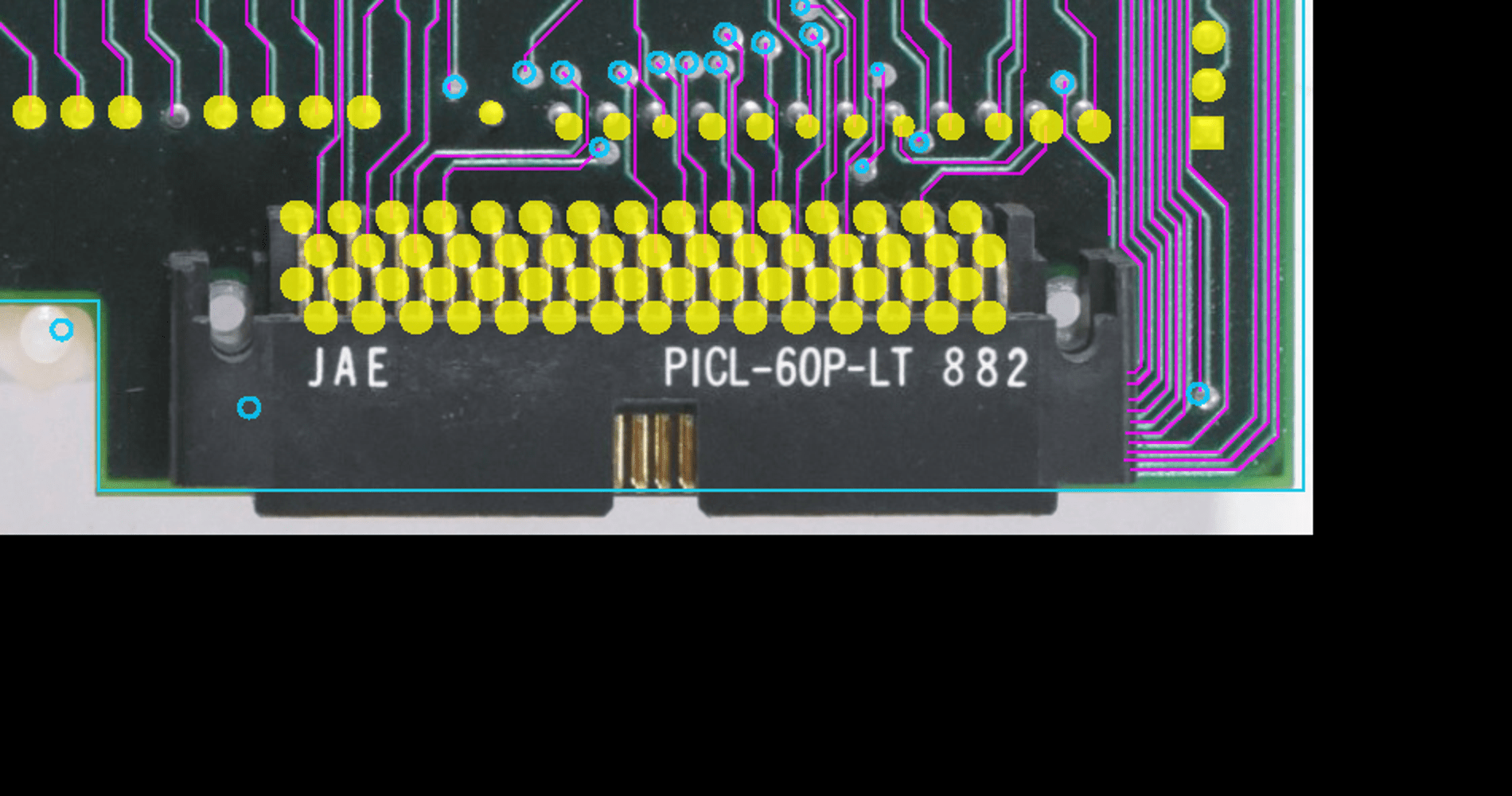

- Uploaded **FPD-Schematic-012.AI8** (solder-side viewpoint, light blue = component side).
- Its traced region only covers J1/crystal/U2-U7/ROM (U18/U19) — not the whole card. U18/U19
marked "Unimplemented IC."
- Identified the board's slot connector as a **JAE PICL-60P-LT (60-position)**, the Mac SE PDS connector — separate
from the J1 video header.

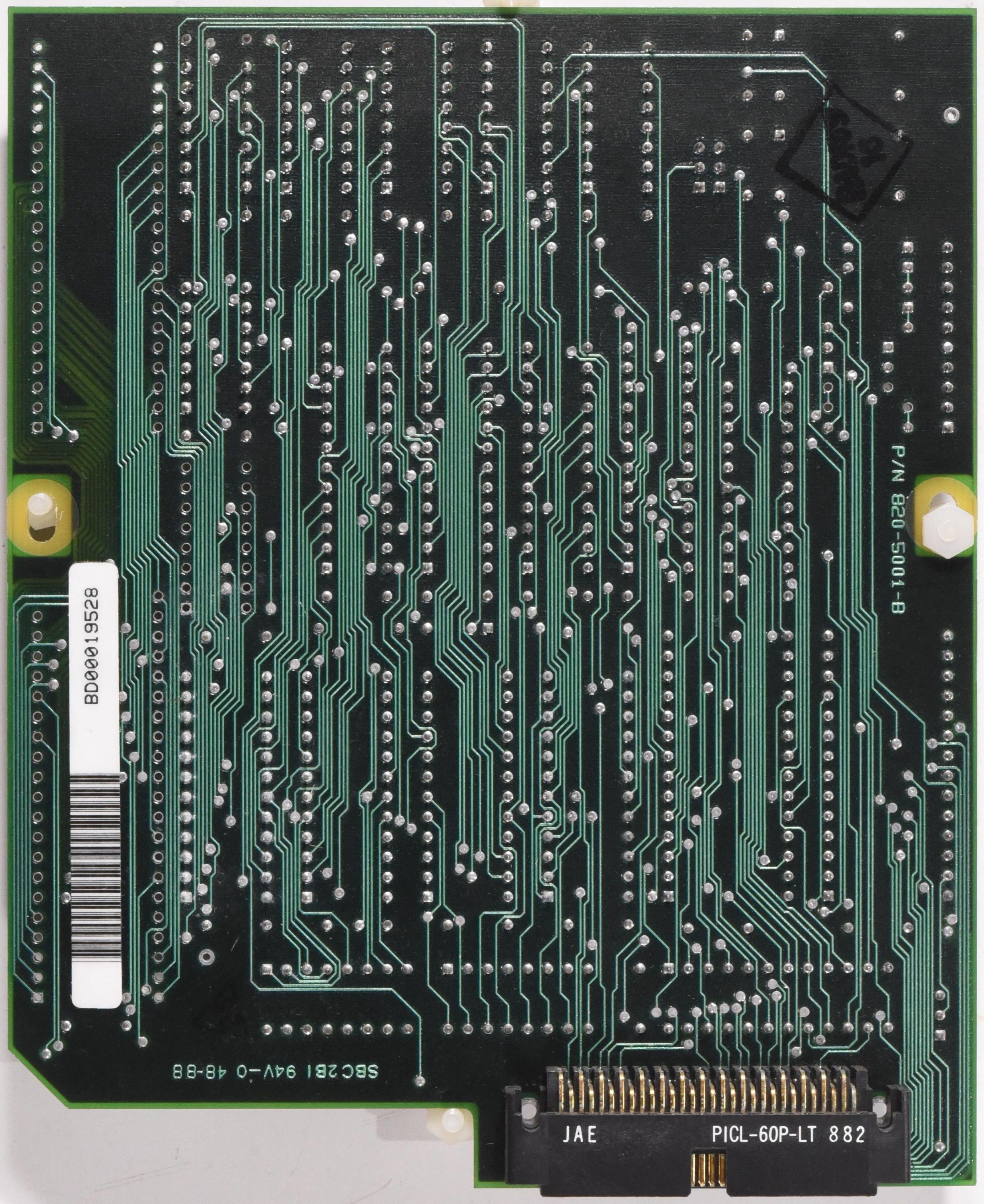

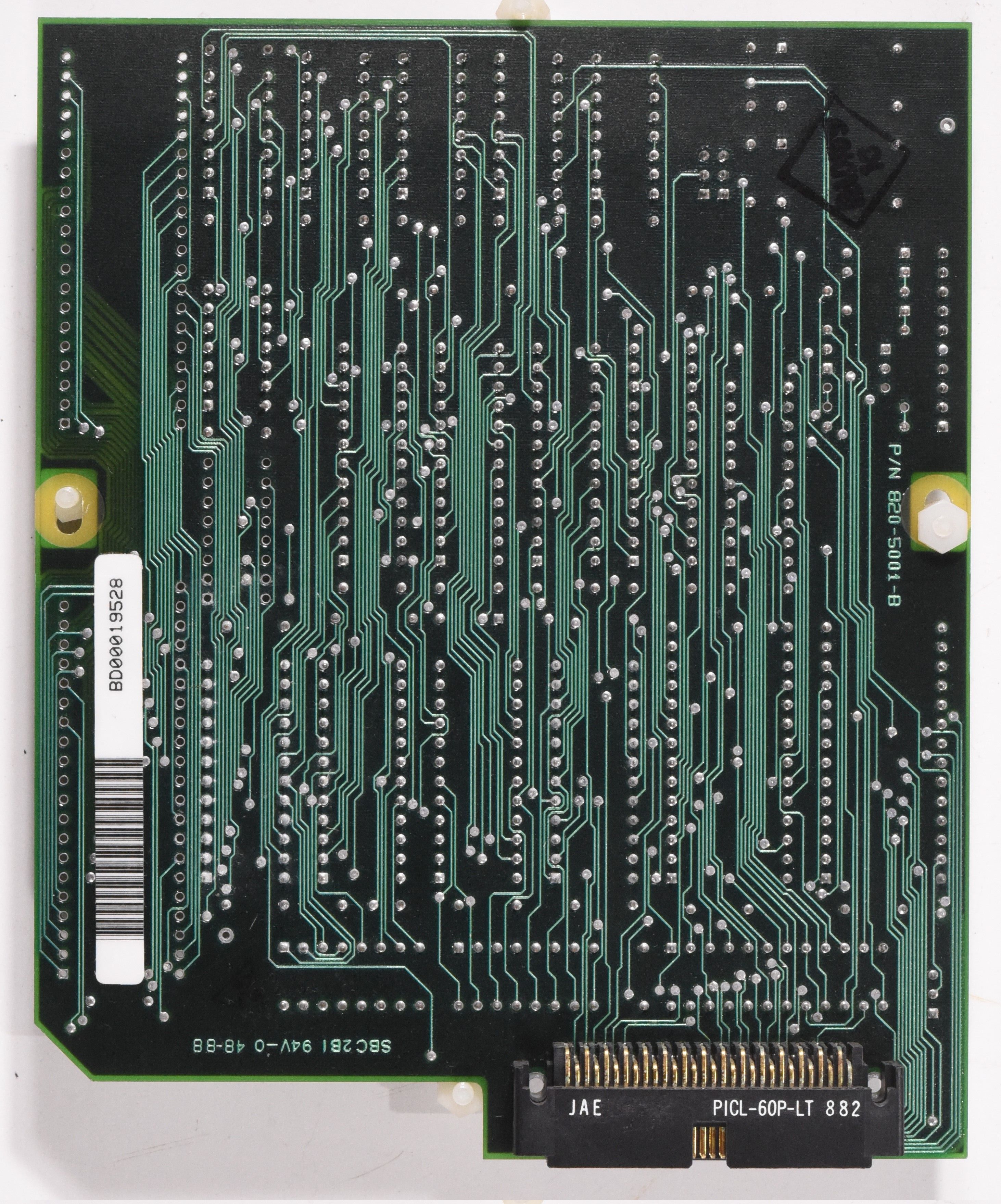

## 6. Board photography
- Uploaded three high-res photos: solder side, component side, and a mirrored component side (for reference).
- Had Claude straighten/crop all three to the board outline.
- Calibrated true scale using the known **123mm board width** (~564 DPI at native resolution) so exports would be life-size.

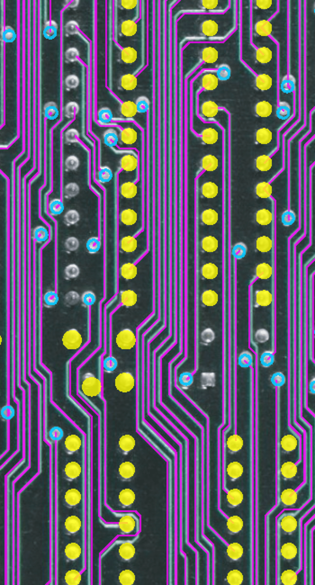

## 7. Auto-vectorization pass
- Generated auto-traced vector PDFs of the copper traces (color-threshold segmentation of traces/pads into filled paths)
for both sides, scaled to true size.
- Converted those to **Level 2 EPS** for AI8 compatibility, with the intent of merging into the hand-traced file.
## 8. Broader schematic recovered
- Uploaded **FPD-Schematic-010-2.PDF** — an export of the earlier, broader 010 file — labeling more ICs than schematic-012:
- U8/U9/U13/U17/U22 — GAL20V8-25LP PLDs
- U11/U12/U15/U16 — D41264C-15 DRAMs
- U18/U19 — ROM
- U2-U7 — 74F/LS logic
- J1 — header
## 9. Decision: hand-trace over auto-vectorize
- Concluded the auto-vectorized traces miss judgment calls a human makes (real trace vs. adjacent silkscreen/substrate).
- Decided instead to use the **true-size board photos as AI8 tracing templates** and hand-trace, merging into the existing file
rather than relying on the auto-traced vectors.

- Documented full **J1 pinout** (10-pin, 1-row, unshrouded vertical header): ground, video, sync lines identified; horizontal/vertical sync Hz values still TBD.
- Its traced region only covers J1/crystal/U2-U7/ROM (U18/U19) — not the whole card. U18/U19 marked "Unimplemented IC."
- Identified the board's slot connector as a **JAE PICL-60P-LT (60-position)**, the Mac SE PDS connector — separate from the J1 video header.

## 11. Recovered thread: scanline rotation transform (via camera photos of the crashed session)
- This thread runs in parallel to the PCB tracing work above — it's the **output/FPGA side** of the project, not the board reverse-engineering itself.
- Problem: the source video is a **portrait-orientation, row-major scan**, but the physical display panel is landscape-native and mechanically mounted rotated 90°. A compensating 90° rotation has to happen somewhere between the source scan and the panel so the image displays right-side-up.

- Rather than trust an abstract rotation formula, worked through a concrete **4-wide x 7-high (28-pixel) example**, writing out if-then statements for where each source pixel should land in the output.
- Pinned pixels by (x,y) coordinates (x = 0-3 across, y = 0-6 down) and checked them against output positions in a 7-wide landscape buffer.
- Caught and corrected a couple of small typos in the mapping along the way (e.g. p13 briefly mislabeled to the same output as p09) until the pattern was fully self-consistent across all four corners of the source/output rectangles.
## 13. Transform confirmed and spec'd
- Final confirmed transform (**clockwise rotation**), for a portrait source of width W / height H, output landscape buffer H wide x W high:
- `x' = (H-1) - y`
- `y' = x`
- Verified against both terminal corners of the 4x7 example (top-right and bottom-right source pixels) — matched exactly.
- Had Claude write this up as a short formal **"Scanline Rotation Transform — Engineering Spec"** document: problem statement, confirmed coordinate transform, and the worked 4x7 table. Spec doc created and saved.
- Discussed next-phase scope once the transform was locked: a buffer that writes source pixels in as they arrive (row-major), and a read-out address generator implementing the transform at real target resolution (formula generalizes the same way, just bigger numbers).
## 14. Deliberate pause point
- Decided to hold this thread here — until a schematic is developed and it's clear **what needs to be fed where on an FPGA project board**.
- Rationale (agreed on both sides): the math/architecture for the rotation is locked, but the actual hardware reverse-engineering (tap points, signals) is the long pole right now — no point speccing FPGA pin assignments before the schematic says what's actually there to connect.
- The spec doc is saved and ready to pick back up once the tap points are identified from the continuity-tracing/hand-trace work.

1. Starting Point​
Picked back up on the PCB reverse-engineering project after previously pausing the rotation-transform/FPGA output work until physical tap points on the board were identified. Prior session had already traced:
  • J1 pin 7 (Horizontal Sync) → U22 pin 7
  • J1 pin 9 (Vertical Sync) → U22 pin 8
  • J3 pin 3 (Video) → U2 pin 7
  • A resistor/diode network (R1–R3, CR1/CR3/CR4/CR5) sitting on the J1 input lines
2. Resistor/Diode Clamp Network​
Reviewed the annotated photo FPD-SE-Signal_Taps-000.jpg. Corrected terminology: “CR” designators are diodes (“Crystal Rectifier”), not capacitors.
Interpretation: each J1 signal line (video, HSync, VSync, and the mystery pin-6 line) passes through a series resistor plus a shunt diode before reaching the logic ICs — a standard input protection / clamp network to protect TTL inputs from over/undershoot coming off the Mac SE analog board.
Open question flagged at this point: CR3 sits near J1 pin 10, which is marked N.C. in the header pinout — worth double-checking.
3. Mystery Black Wire (J1 Pin 6) = Display Sense Line​
Identified via reasoning (later independently confirmed, see Section 5): J1 pin 6 is a 5V sense/detect line. The FPD display pulls it to ground when connected. The card's video drivers load at startup but shut down if no display is detected — so this line must be pulled low to get video output when bench-testing the board without a real panel attached.
4. Mac Plus vs. Mac SE Architecture​
Clarified the architectural difference between FPD card generations:
  • Mac Plus / 128K version: piggybacked directly on the 68000's CPU legs — a rudimentary pass-through interface, predating any expansion-slot architecture.
  • Mac SE version (this project): all signals routed through the PDS (Processor Direct Slot); this is “Slot Manager” era.
  • Implication: the SE card's ROMs at U18/U19 (marked “Unimplemented IC” on schematic-012) are Declaration ROMs required by the Slot Manager to configure the interface. Radius packed their card drivers inside those ROMs — without valid Declaration ROM contents, the SE will not mount the slot at all, regardless of whether the video-generation hardware works.
5. ROM Testing Plan​
Have older ROMs installed on the two FPD cards on hand, plus a separate set of “4.4” ROMs pulled from a TPD (Two Page Display) card. Plan: install the TPD 4.4 ROMs onto an FPD card to test under System 7.
Word is that Radius used a “universal ROM” design — ROMs interchangeable between FPD and TPD cards. Confirmed the TPD ROMs are the same package as the FPD sockets, so no adapter needed. If the universal-ROM claim doesn't hold up in practice, System 6 is the fallback (its Slot Manager is more forgiving of ROM/board mismatches than System 7's stricter declaration checking).
Also hypothesized that the oversized/unpopulated through-hole ROM footprints on the board were sized for physically larger, higher-capacity ROM chips — plausibly part of the same universal/multi-configuration strategy.
6. Mac Plus FPD Background Research​
Attempted to pull up a referenced YouTube video on the earlier Mac Plus version of the FPD card (direct fetch was blocked by a rate limit). Background research confirmed the Plus-era card used the CPU-socket piggyback approach, routing its external video cable out through the security (Kensington lock) slot rather than a PDS bracket, since the Plus/512Ke had no expansion slot.
A handwritten pinout photo (Radius-FPD-Plus-Pinout.jpg), sourced from that video, was reviewed. It labels a “Sense” pin — matching the SE card's pin 6 finding — and gives sync frequencies for the Plus card: Hs ≈ 68.8kHz, Vs ≈ 67Hz. Since both card generations drive the same physical FPD monitor panel, these are a strong working reference for the SE card's still-unconfirmed HSync/VSync frequencies.
Also noted: Radius customers were still upgrading from the Mac Plus to the SE and SE/30 well into 1989, consistent with a 1989-dated crystal can spotted on the SE board earlier in the project.
7. Diode Identification: 1N753A Zener​
Read the part markings on the clamp-network diodes: 1N753A — confirmed via datasheet lookup as a 6.2V, 0.5W Zener diode (DO-35 package).
Cathode band is oriented toward the incoming J1 signal line. A 6.2V breakdown gives headroom above a normal 5V TTL logic high while still clamping hard before voltage climbs high enough to damage a 74-series gate input — consistent with protecting the board from noisier/less-regulated levels coming off the Mac's analog/CRT board over the cable.
8. L1 / L2 Components​
Identified an unpopulated component footprint labeled L1 (same size/spacing as R3) sitting between R3 and the VRAM/GAL area. Also noted C6 (or possibly C8) appears missing/unimplemented.
Identified a large green cylindrical component labeled L2, positioned between the VRAM bank and the GAL bank, near C22 and CR6. Working identification: L2 is an inductor/choke; L2 + C22 likely form a small LC low-pass filter, isolating power-supply noise from the DRAM bank (which switches heavily during refresh) from the more timing-sensitive GAL/logic bank. L1 being unpopulated suggests this was an optional second filter stage, possibly added or omitted depending on a production revision.
9. Continuity Tracing: CR3, GAL Pin 13, and the Pin 9/11 Question​
CR3 anode: Chip-clipped the anode end (opposite the cathode band) of CR3 and re-tested the earlier reported connections; also re-verified the red-drawn line showing the Zener interconnections.
GAL pin 13: All four GALs in the bank (U8, U13, U17, U22) show continuity from the Zener/cathode net to pin 13. On the 24-pin GAL20V8 package, pin 13 is /OE (Output Enable) — supporting the idea that the display-sense signal disables all four GALs' outputs at once when no display is connected.
U3/U5 pin 11: Confirmed via continuity (marked in yellow on the working photo): U5 (74F161 counter) pin 11 [Terminal Count / Ripple Carry output] connects to U3 (74F166 shift register) pin 11 [parallel data input F]. This is a sensible signal path — a counter's “done” output feeding a shift register's reload input.
Pin 9 discrepancy: The same net was also reported connected to pin 9 on U2, U4, U3, U7, and U6. Datasheet check showed this pin serves different functions across these parts — an output (2Q̄ or 2Q2) on some (U2, U6, U7) and an input (CLEAR) on others (U3, U4). Multiple outputs sharing one net would create contention, so this doesn't add up as a single continuous bus.
Working theory: Raised the possibility that DIP pin-numbering was thrown off if the notch orientation was assumed backwards on the physical board (easy to do on a mirrored/rotated photo). If mis-counted, “pin 9” and “pin 11” readings could actually be different physical pins.
Next step identified: On U3 and U5, the notch faces the bypass caps — need to confirm numbering is correct. Recommended approach: locate VCC and GND directly by measuring voltage while the board is powered (VCC ≈ +5V, GND ≈ 0V / continuity to ground), since these sit at fixed, known pin positions (pin 16 and pin 8 on these 16-pin parts) — then count pins from there with certainty, independent of notch orientation or photo mirroring.

RADIUS FPD-SE CLONE PROJECT — SESSION SUMMARY
Pinout-Check Verification Pass
CONTEXT
Continuing PCB reverse-engineering work on the 1986 Radius Full Page
Display (FPD) card, first-generation 64/68Hz board for the Mac SE.
This session picked up mid-project to verify/correct IC reference
designators in the hand-drawn "Pinout-Ux-designation_Check" doc
against high-res photos of the physical board.
GOAL
Confirm that reference designators recorded in the pinout-check
document match what's actually silkscreened on the board, catching
any transcription errors or duplicate designators before they get
carried forward into the AI8 schematic / continuity-trace work.
FINDINGS
1. U19 — "Hi" ROM
Confirmed by direct photo zoom. Silkscreen is legible and matches
the doc exactly. No error.
2. U9 — GAL20V8-25LNC
Initially suspected as a possible duplicate (the doc separately
lists a "U18 ROM" for the second large ROM-like chip, and a
"U9 GAL20V8-25LNC" elsewhere for a GAL). Close photo inspection —
including contrast-enhanced zooms to rule out misreading the
digit as a 5 or 6 — confirmed the "U9" silkscreen label sits
directly at the top edge of the horizontal GAL chip
(RAD 323-1023-A, GAL20V8-25LP) near JP3/128K/256K, not on either
ROM chip. U9 is correctly assigned to that GAL. Not a duplicate.
3. "Lo" ROM — designator illegible
The second large ROM-like chip (to the right of U19) does NOT
carry a legible "U18" as the doc had guessed — that assumption
doesn't hold up under zoom. Its actual silkscreen designator is
too worn/faded to decipher at the current photo resolution.
RESOLUTION
Rather than block progress on one worn label, the "Lo" ROM chip is
being designated "Ux" — a placeholder reference used for continuity
tracing and AI8 schematic work until (or unless) the real silkscreen
designator can be confirmed via better lighting/resolution or an
external reference (e.g. a service manual).
Final corrected designator set for this cluster:
U19 = Hi ROM (confirmed)
Ux = Lo ROM (placeholder — illegible silkscreen)
U9 = GAL20V8-25LNC (confirmed, not a duplicate)
All other designators previously checked in this document — GALs
U8/U10/U13/U17/U22, DRAMs U11/U12/U15/U16, logic ICs U2-U7, and the
J1 header pinout — were already correct and required no changes.
NOTE ON METHOD
Several rounds of pixel-cropping/zooming/rotating photo crops were
needed to pin down exactly which silkscreen text belonged to which
chip in this tightly-packed cluster — a good reminder that a human
eye tracing physical relationships on a real board in-hand still
outpaces an AI squinting at cropped upside-down JPEG fragments one
tile at a time.
Session conducted with Claude (Anthropic)

I have completed vectorizing the solder side traces in my AI8 file. Would you be able to verify my work by examining of the jpeg image you cleaned up for me? Your StreamLine like autotracing was terrible. Might checking traces against bitmap image work out much better?
No files came through in this session — the container's a fresh environment, so the cleaned-up JPEG and your new AI8 export from the earlier session aren't sitting here for me to compare.
To actually verify your vectorized traces against the bitmap, I'd need you to upload both:
  1. The cleaned-up true-size JPEG (or the grayscale version I made for your PowerBook) — whichever one you traced from
  2. Your vectorized AI8 file's traces, exported as a PDF or flattened image, ideally at the same scale/crop as the JPEG so I can overlay or compare region by region
On your suggestion — yes, checking your hand-traced vector work against the bitmap should work much better than my earlier autotrace attempt. Autotracing (StreamLine-style) is threshold-based and easily fooled by silkscreen bleed, pad shadows, and trace/substrate contrast — exactly the judgment calls you already flagged as the reason you moved to manual tracing. Comparing your manual traces against the same source photo is a much more tractable image-diffing problem than generating trace geometry from scratch, since I'd just be checking alignment and completeness rather than trying to segment copper from noise.
Go ahead and upload both when you're ready.
Understood upload requirement before asking about possibility of verification. I’ll prep files on my Neolithic graphics workstation for upload next session!
Sounds good — talk to you next time.
________________________________________________________________________________________________________________________________________
I need to dissect that massive block of TXT in order to review it. Will edit in reformatted gobbledegook later on. ;)
Testing a new way to document/report play by play. Is this post a better course than having Claude summarize the session and posting that?
Reactions: Froggy814
I have PDF files for:
VIAs
Thruholes
Traces
Template
. . . almost ready to upload for layout verification. Unfortunately, the PDF file only has memory enough to show the top 60% or so of the image. I’ll upload the full image .jpg used in the AI8 file as the template. In AI8, the image is scaled 50% to match the life sized vector art. The .PDF with partial image will show positioning relative to the board outline. Will that suffice?
Should mostly work, but I want to flag one distinction before you go through the trouble of uploading, since it affects what "verification" actually covers:
Is the memory limit only affecting the Template (raster) layer, or the vector layers too? A raster image embedded in a PDF is heavy and plausibly the thing choking your PowerBook's export — but the VIAs/Thruholes/Traces layers, if they're pure vector paths, should be lightweight regardless of board complexity and shouldn't hit the same ceiling. If it's just the embedded template JPG getting truncated in that PDF, no problem — you're already solving that by uploading the full JPG separately.
But if the truncation is actually cutting off vector path data in the bottom ~40% too (not just the raster preview), that's a real gap — I'd only be able to verify traces in the top 60% of the board, and the bottom portion would be unchecked. Worth confirming which case you're in before uploading. If it is real data loss, exporting a second PDF scrolled/cropped to the bottom portion would cover the rest.
On the scale mismatch (50% in AI8 vs. full-res JPG): that part's fine. I don't need numeric pixel-registration between the files — I'll be doing this by eye, aligning on shared board features (J1 position, IC pad clusters, board edges) rather than overlaying at a fixed coordinate scale. As long as both files show the same board orientation and I can see enough shared landmarks to orient myself, the scale difference won't matter.
So: full JPG template + complete vector PDFs (confirmed not truncated) should be enough. Let me know on the vector-layer question when you upload.
Life size board outline (vector) intact with truncated image in PDF is set exactly as the whole image is set up in the template layer in AI8. Hoping that setup will allow your positioning of the full JPG in comparison?
Yes — that's exactly the setup that makes this work well. If the vector board outline is complete and positioned/scaled identically to how the template image sits in AI8, then that outline is a solid registration reference: I can line up the full JPG's board edges against your vector outline, and from there everything else (traces, vias, thruholes) should fall into correct relative position even though the PDF's raster preview cuts off past 60%.
The truncated raster in the PDF isn't actually needed for verification then — it was only useful as a sanity-check overlay, and the full JPG replaces that role better anyway. What matters is the outline being untruncated and accurately scaled, which you've confirmed.
Go ahead and upload the four PDFs plus the full JPG whenever they're ready.
This overlays extremely well — traces, thruholes, and vias all land on the actual copper pattern with tight registration. Let me zoom into a few regions to check for finer misalignment or missed traces.
Registration is excellent — traces, thruholes, and vias all land tightly on the actual copper across the whole board with no drift anywhere I checked. Your approach (comparing manual traces against the source bitmap rather than my earlier autotrace) works much better, as you suspected — this is a solid way to self-check.
Two things came out of the check:
1. Alignment: clean. I overlaid all four layers directly on the template photo (they share identical PDF canvas coordinates, so no manual registration was needed) and tiled the whole board into a 3×4 grid to check every region. Traces track the copper exactly, vias and thruholes sit centered on pads throughout.
2. Found a handful of un-traced pad groups — not misalignment, just missing markup. Beyond the U25/U26 ROM area you already flagged, I spotted several other spots where physical pads exist in the photo but have no yellow thruhole marker or magenta trace at all:
  • A full ~16-pin column (a whole IC's worth) roughly centered on the board, positioned just below-and-left of the two unimplemented ROM footprints
  • A shorter run of unmarked pads a bit further down and right of that
  • A short horizontal row of small unmarked pads directly above the J1/PICL-60P-LT slot connector
  • A couple of small 2-3 pad clusters near the top-right mounting hole and lower-right corner
Here are the two clearest examples:
These are likely just chips/pads you haven't gotten to yet in the trace pass rather than errors — but worth checking against your working file so nothing silently gets left out when you move on from this board area. Once you've got the new (sticker-free) template photo for that section, that'd be a good time to fill these in too.
Here are the files for trace verification. As noted in the files, the traces for large ROMs at U25 and U26 are as yet incomplete. I just pulled the big white sticker off and need to take a new template pic for tracing.
Traces are correct, silver showing mis-alignment is due to the original (slightly distorted) pics employed in early iterations of the model. Current (uploaded) template images used are the squared up/rotated perfectly, aligned images you generated for me earlier on. So some things don’t quite line up. Thruholes and Vias were done from the uncorrected images and left in place.
gap-example-2-above-connector
One missing thruhole pad, but all else is correct. Thruhole misalignment same as mentioned above. Originals were done on a copy stand with board set upon the nylon standoffs seen in the pics so both sides of the board were in the same focal plane/focus. Center of shots are spot on, edges suffer a bit from perspective of macro lens, most apparent at top and bottom of card. Incomplete traces are due to connector obscuring PCB. Thruholes in pic were set in the component side view so will be consistent between both sides. Buzzing connections will allow me to complete the partial trace connections.
As noted above and in file itself, the traces you did in blue for U25 and U26 are a work in progress. I only recently removed the big sticker covering U25. New pic and new tracing coming up.
What’s most interesting in that pic I’ve intended to bring up. Thinking it may be a four layer board. Sub-surface traces make up a net connecting U25 and U26. It looks to me like Radius pulled a fast one by implementing that net as part of the Power or Ground layer?
