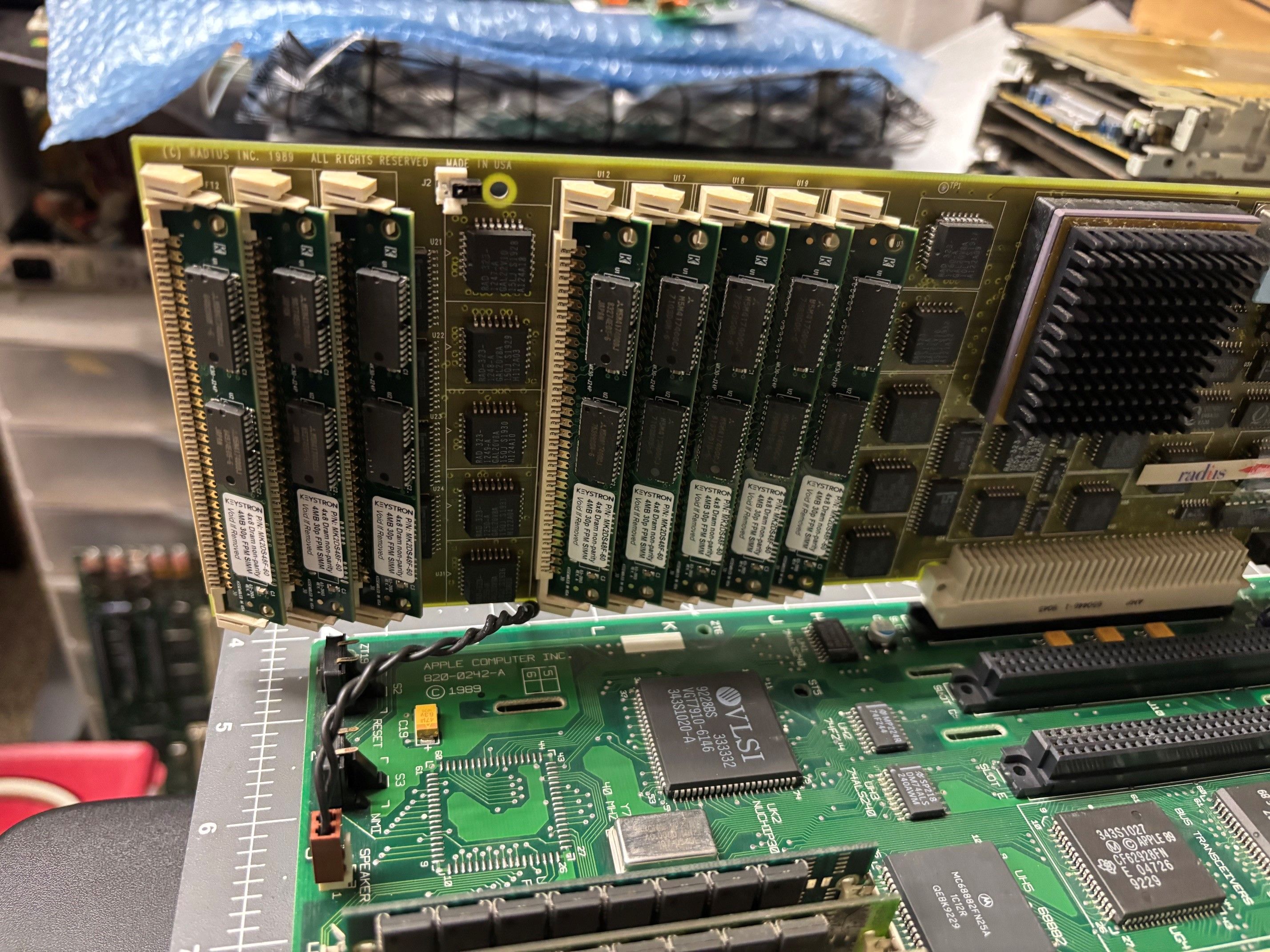

A few months back, I picked this card up from eBay sold as "untested." I've never had a Rocket and was excited, so I paid too much and pulled the trigger. Finally got around to testing it last night in my IIci. First I installed RocketWare 1.5 under System 7.5.3. After some reading, it appears the rocket only supported System 6-7.1, so I downgraded the IIci to System 7.0.1. Thinking that this v1 Rocket was also not compatible with the RocketWare 1.5 software, I installed RocketWare 1.3.

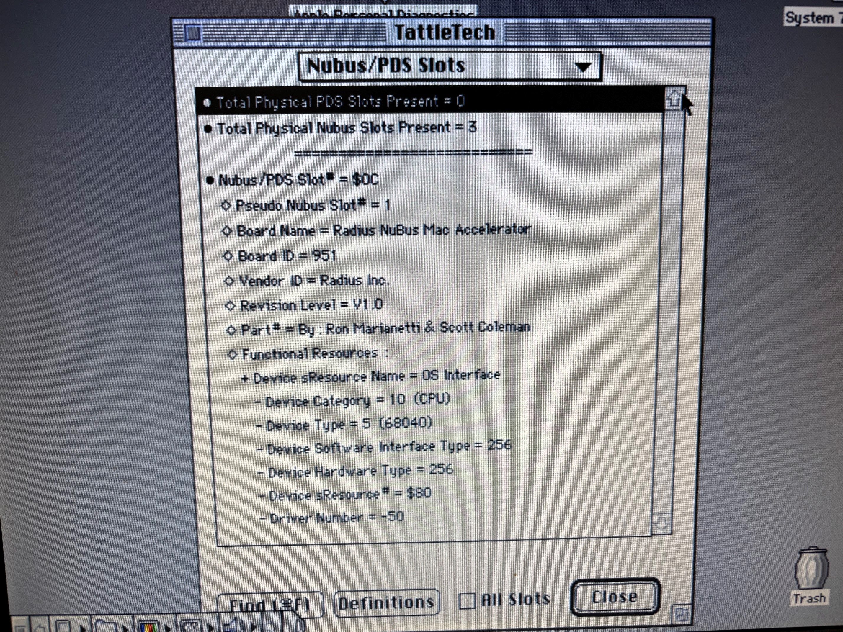

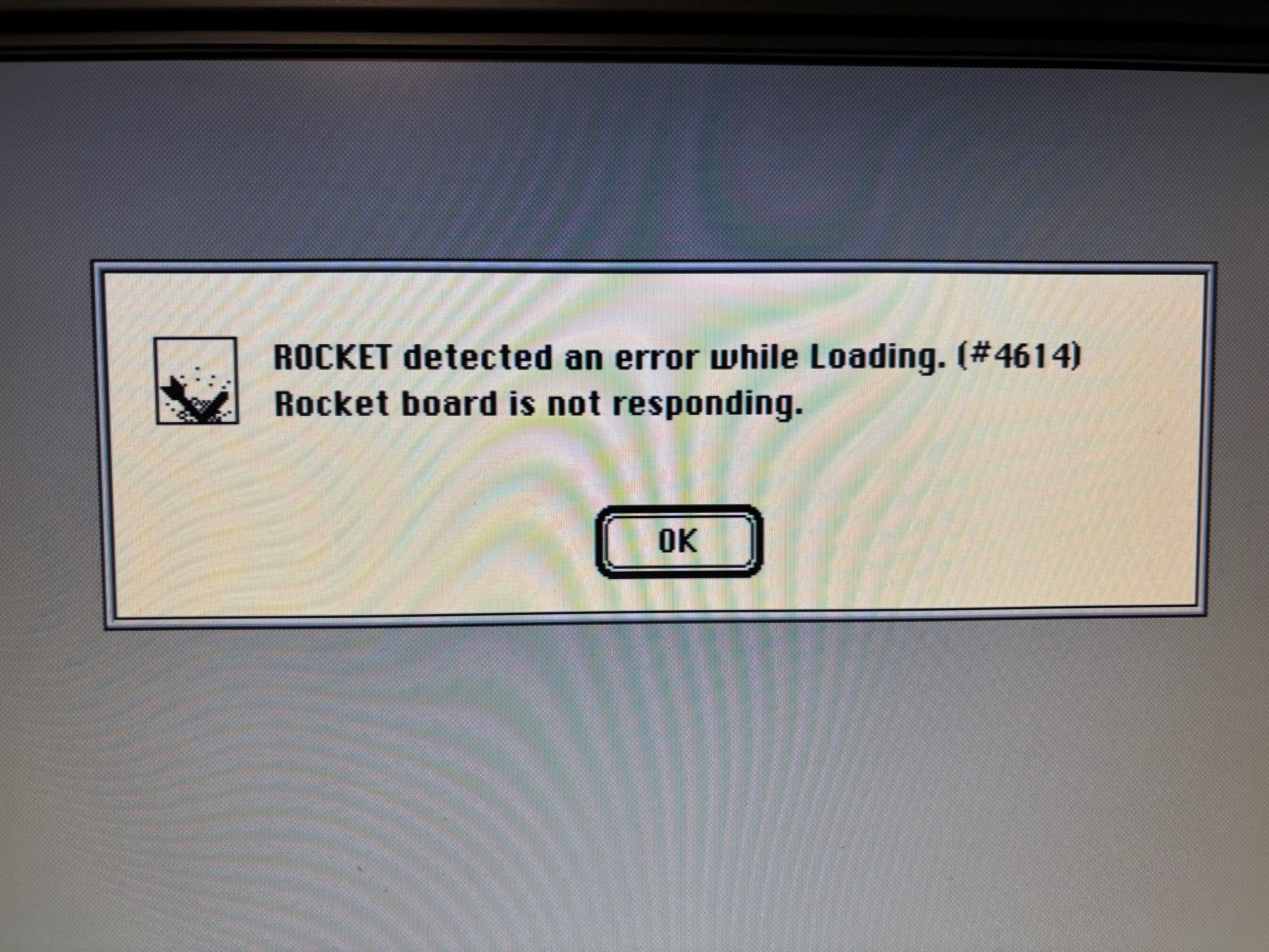

What happens regardless of the version of OS or Radius driver, is the rocket extension loads (with splashscreen and fun sound effect), it sits idle for ~1min, then a dialog box appears saying the Rocket isn't responding. I know the system is detecting it, because the card shows up in TattleTech. This tells me at least the ROM is likely valid.
Rocket experts - what am I doing wrong? Is my combination of driver/OS never going to work? Should I be looking at something else entirely? I can't find any documentation to tell me what Error 4614 refers to (if anything). I also have not touched the RAM installed on the card. I don't even know if it's required for successful initialization.

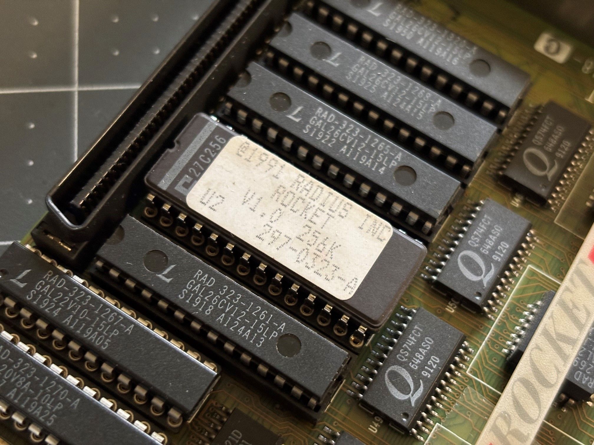

If you are able to carefully remove the 040 CPU and somehow test in another card or computer, then you could then safely rule out the CPU as being the root problem. But it could be one of those socketed chips either being bad or needing to simply be re-socketed. With that said, I must defect to owners of that edition Rocket because they most likely have experience with its hardware quirks.
If you are in a hurry, then I would suggest that you join the Vintage Apple Macintosh Enthusiasts group on Facebook so you can post about it there and tag Petar Puskarich, who owns a rather large number of Rockets and has all the documentation too.
While I don't know specifically what that error code refers to one specific thing I have found with the IIci is that often GAL rockets don't work with Rocket Share when installed in the slot closest to the PDS slot. There is no logical reason for this as there is nothing special about that slot but I have observed it on multiple IIci's with multiple clone rockets (which are a exact hardware clone of the original so should act the same)
Have you tried Rocket Share to see if it acts any differently?
You can use the latest versions of Rocket Share / Ware with the original rocket so that's not your issue ans 7.0.1 should work fine though personally I used 7.1
RAM is required for it to function (and you need a minimum of 8MB installed), it looks like the card has a bit of a random assortment of sticks so it might be someone just threw whatever random RAM they had to hand on so I would start by swapping that out for known good sticks (or at least testing them in annother system)

The RAM (while a hodge podge of sticks) does work fine, and totals 8MB. I installed these old 1MB SIMMs into my IIci and installed 8 new 4MB SIMMs in the Rocket. No change to the Rocket's functionality with RocketWare.

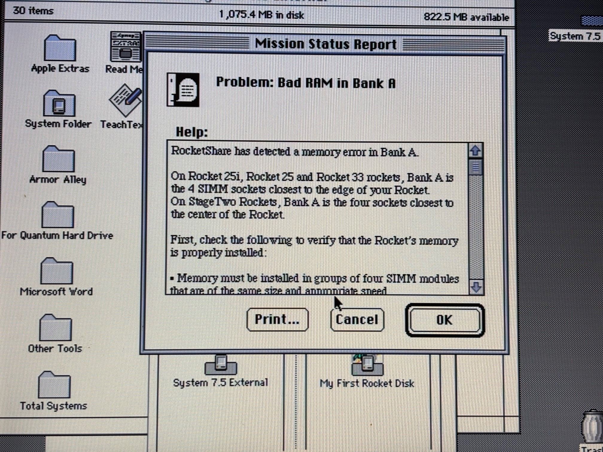

I uninstalled RocketWare and installed RocketShare. The extension loaded and I was able to open Mission Control after entering the serial number. Unfortunately, on the right side of the window where the Rocket info would be, I got a message saying Hardware Problem. I was able to open up the "Test" dialog, but the program crashed shortly after. I have never been able to re-open it (crashes with error type -1).
Not very great news so far. Next I will swap the CPU with a known working one. I have never seen a 68040 go bad, but I don't want to rule anything out yet. Keep the ideas coming!

I found a manual online, and shockingly there's a section at the end for error codes.
Error 4614: Rocket encountered a RAM test timeout. It could not confirm the integrity of its SIMM cards within a certain amount of time. In this case, turn off the RAM test feature in the RocketWare Control Panel. If this problem persists, replace your SIMMs.
Hmm, not very useful as I have the RAM test disabeled and have tried three sets of known good SIMMs. I also tried leaving bank B empty for a 16MB total configuration.
The CPU swap was also not the answer, same behavior. I did reinstall RocketShare to try and get the error screen back up. Here are some screenshots:
It's still complaining about BANK A RAM.
One thing I do notice is the RAM SIMMs and GALs nearby get very warm to the touch. Not so hot I will burn my hand, but much much warmer than the RAM installed on the IIci logic board. Is this to be expected? I don't think anything is shorted out, because a short should put the PSU into protection.
Reactions: DevyDevly
Again, my Rocket is the ASIC version that differs from yours. I also don’t have a huge amount of experience with Rockets in general, so I will need to defer to owners of the GAL Rocket like @max1zzz regarding the heat of chips you are seeing.
The only thing I can offer are general job, shooting ideas. Since the error seems to be ram related, the first thing I would do is use a high magnification lens to check and see if the Sim sockets have any crud or oxidation on them that could possibly be cleaned off with 100% IPA in a toothbrush or something like DeOxit D5.
Once that is done, and if it’s a determined that cleaning didn’t help, the next thing I would do would be to take a high magnification lens and examine the traces that lead to the SIMM sockets to see if any of them might have a tiny scratch across a trace that has broken it by accident. I think that’s a good idea because cards of any kind are inserted and removed and sometimes throw down on the hard surfaces, and deep scratches that are very small can and sometimes do happen.
