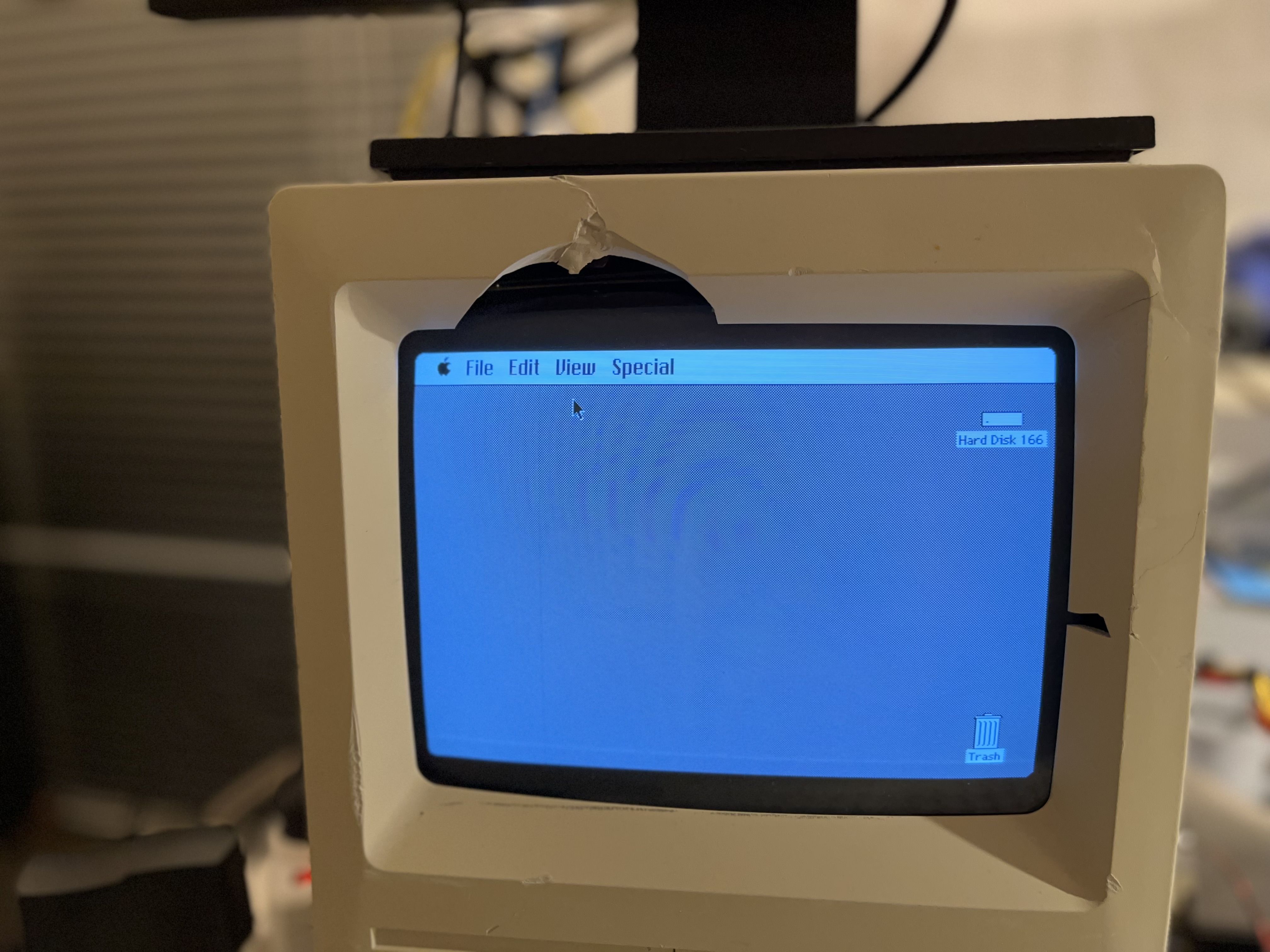

I have purchased this Radius TPD few weeks ago and just had a time to check today. I have no Radius TPD monitor, so I just plugged into my Frankenstein SE to see if it "does" something.
Hard to say... what was the result...

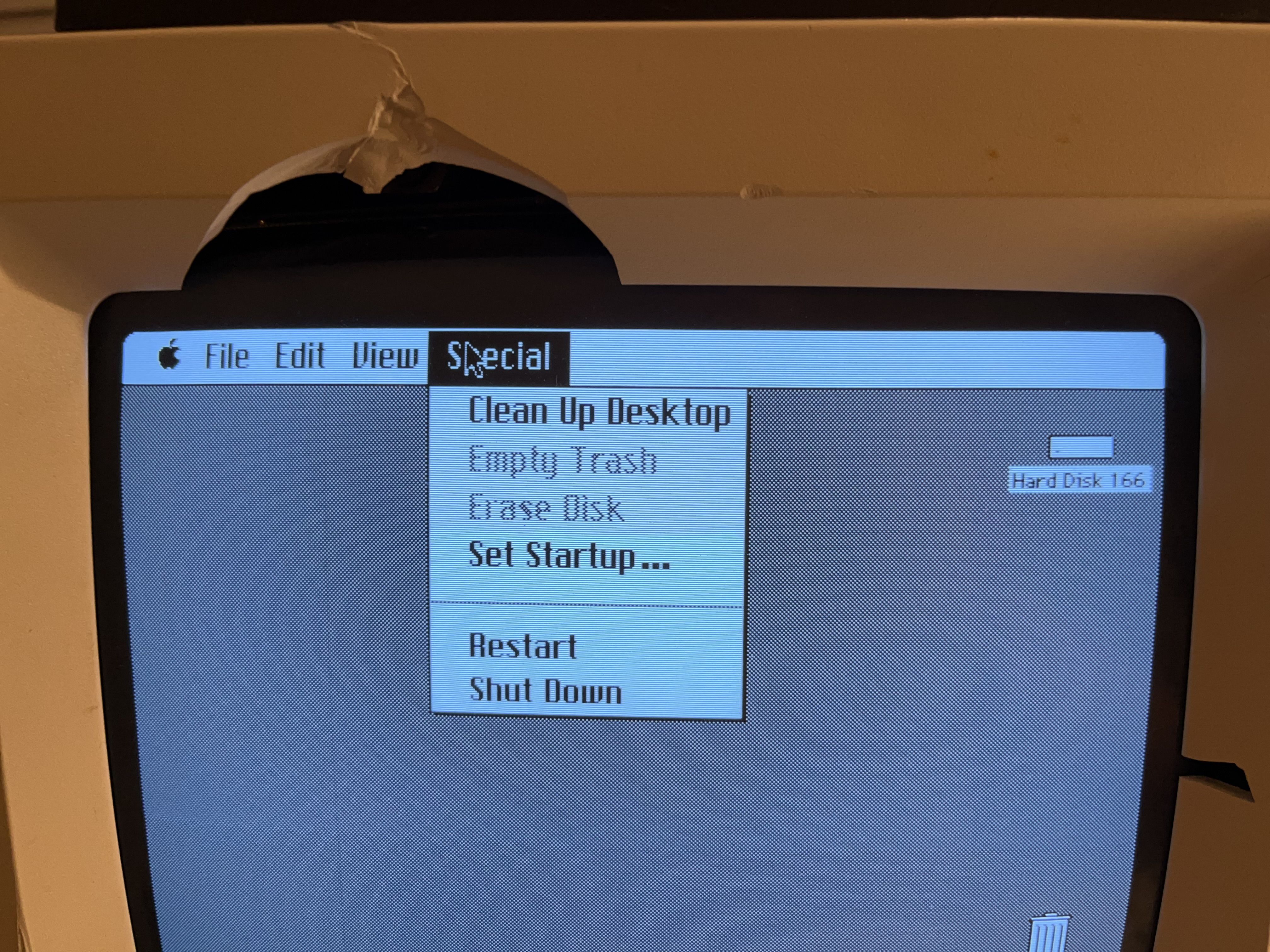

If you see the pictures, the menu bar is double thick and the font size is also much bigger than the usual 20 pixel. If I connect "anything" to the BNC connector, it does not boot at all. It does chim up, RAM test ok, Happy Mac, but then just a raster gray picture what I can see. If I remove my 50 Ohm BNC terminator, then it boots into this "oversized" menu - but everything else are "normal" sized.
Do you have any idea, how to be sure the card works well?

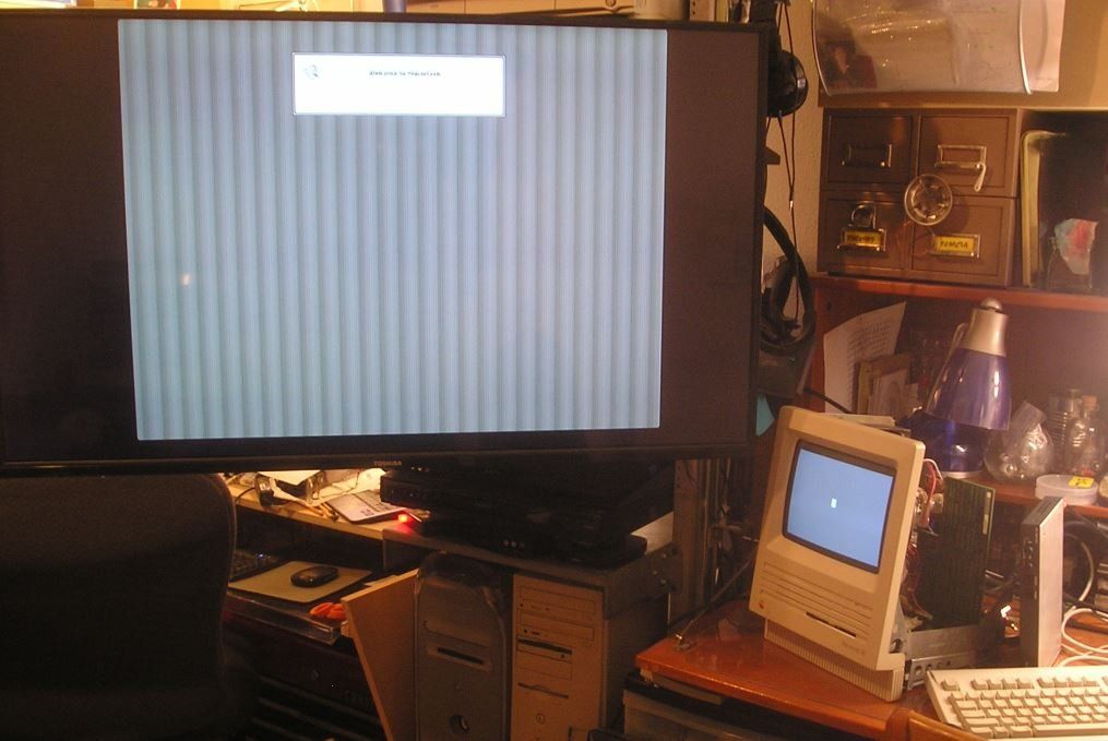

Hmmm...I don't have one of those either PrecisionColors monitors either. I wonder if I have VGA on a multi sync LCD, if there's a converter somewhere? I actually have an LCD with composite inputs, I wonder if that's closer to the BNC TPD signal?
Extron Scaler suggestion is my boilerplate answer for this kind of thing. Never got the TPD dialed in, but shouldn't be a a problem.
I dialed in the far more interesting SuperMac Spec/8 SI to perfection. Never did do any more RTPD/SE playtime after that first "just set it up and try it" test of the Extron above. Should work out fine for any HDMI equipped display. Let me know the settings when you've got it dialed in. ;)
Someone else here or there bought the Extron at my suggestion recently. Don't recall feedback on final outcome. Thread linkage here would be great. One day I'll try to get all my oddball video card threads linked into one topic for easy reference.
Thanks for the tip, that’s pretty cool. But I do have a question. My TPD has a BNC out, how do you connect that to the scaler? Does not look like the scaler has BNC input. Thanks!
I actually already own one of the retroTink scalers, I wonder If that would work also, but that also has no BNC connectors LOL

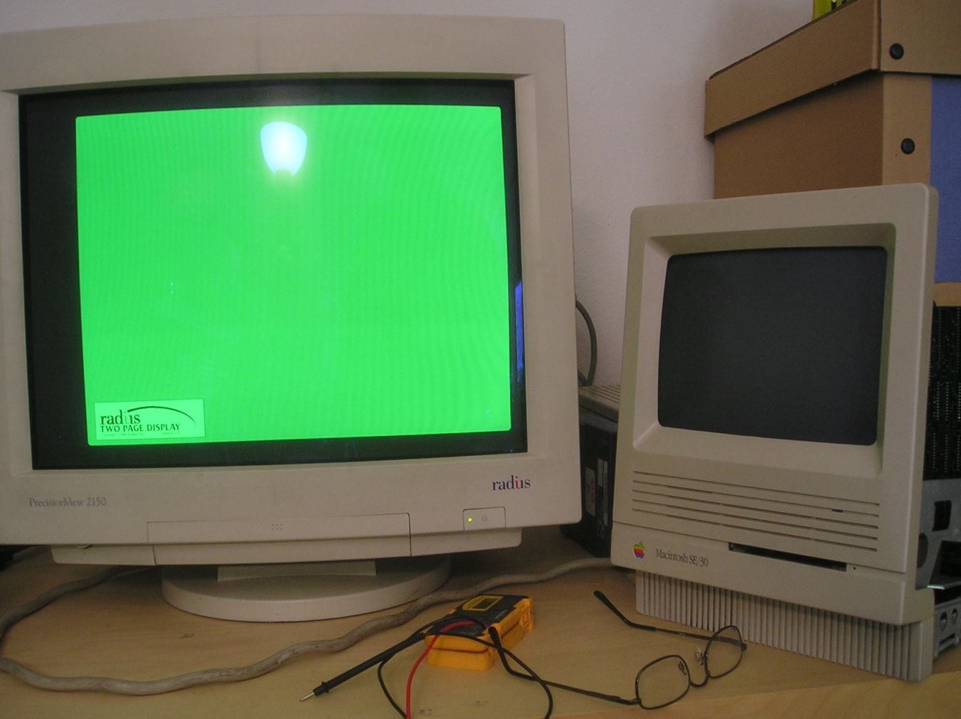

BNC->HD15 VGA connector bodge is(was?) detailed in the thread I linked in my first post. I used if for my first foray into the depths of the RTPD/SE morass.
. . . definitely was documented as Pics went redirected in the forum software migration. I'll have to dig them up to post here and repost there.
I did search out the delinked origin thread:
So I had hooked up the PrecisionView the first time around. SE/RTPD boards were installed in the SE/30.
