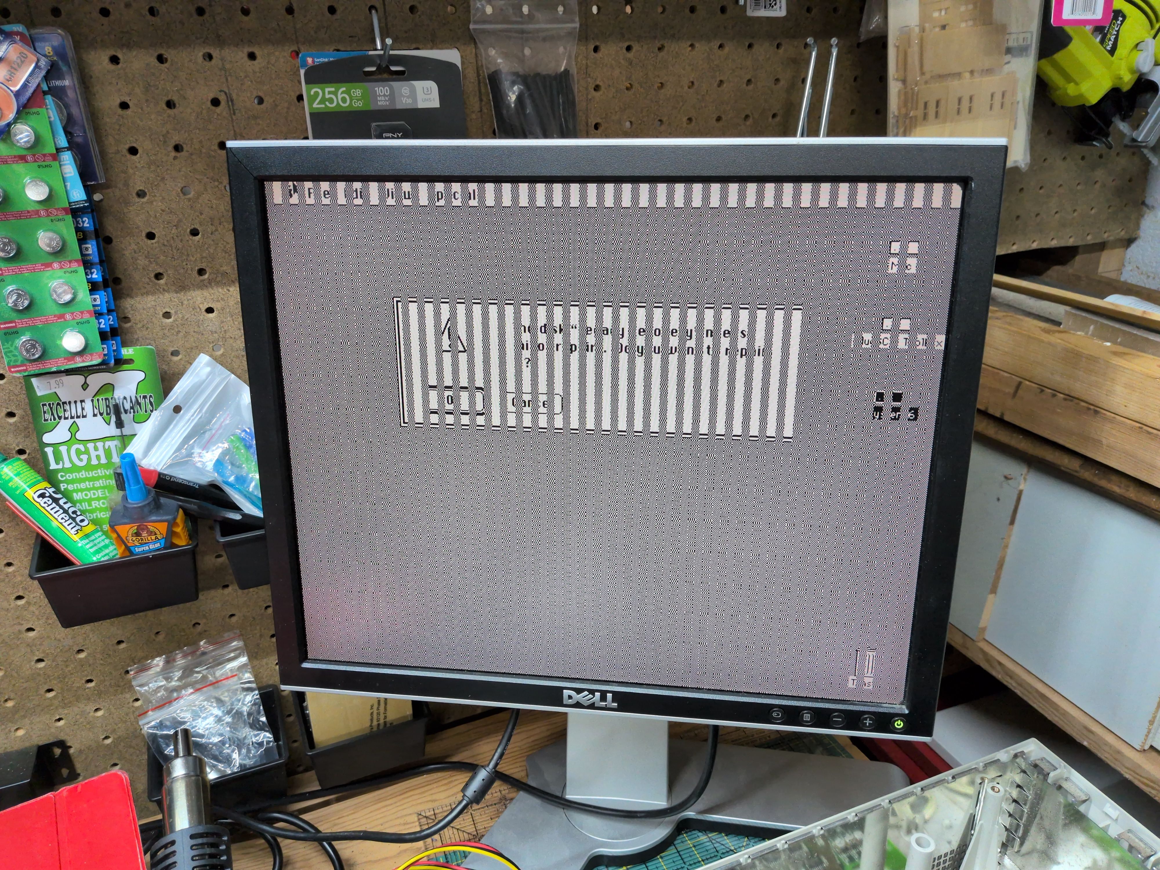

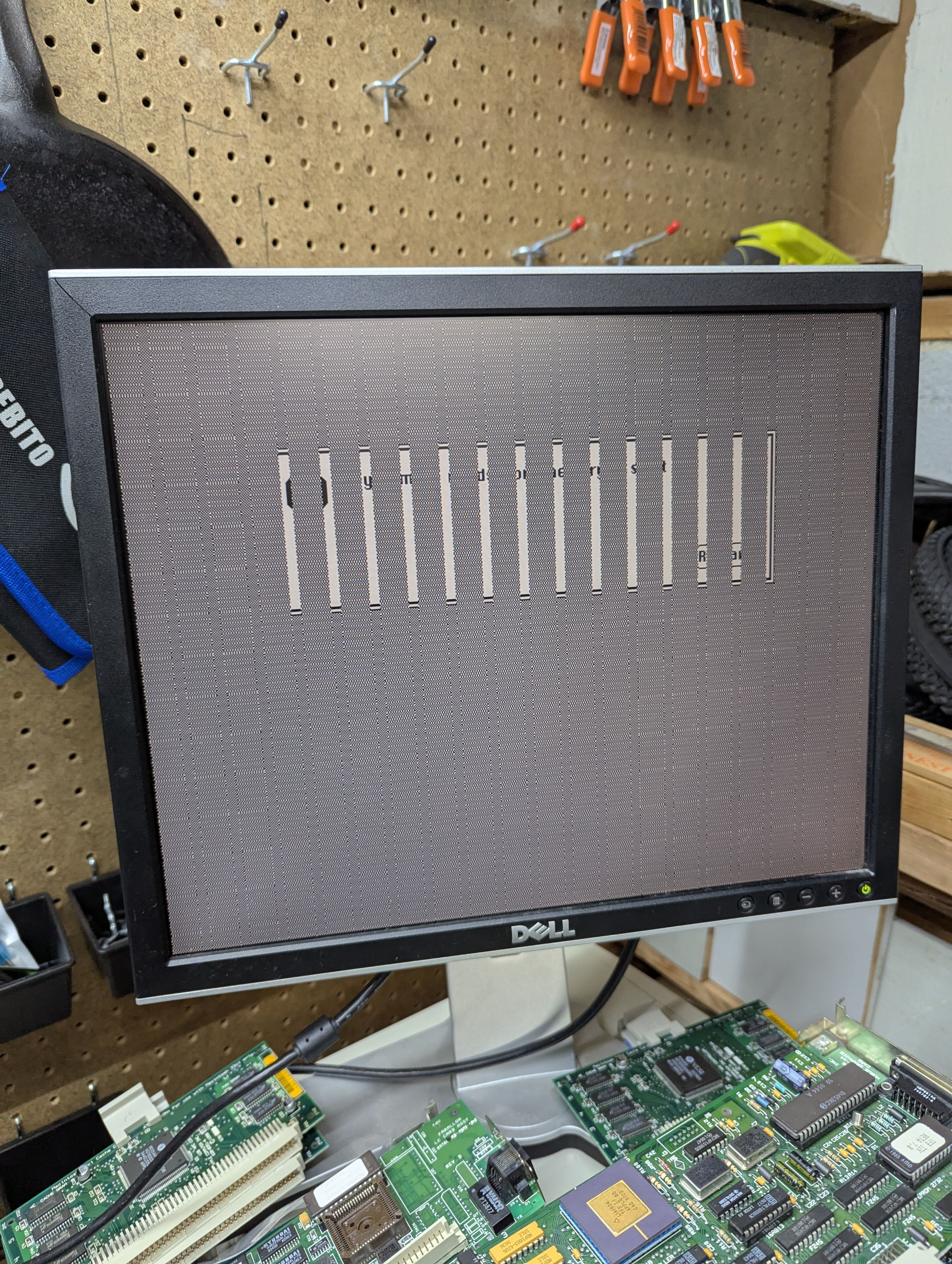

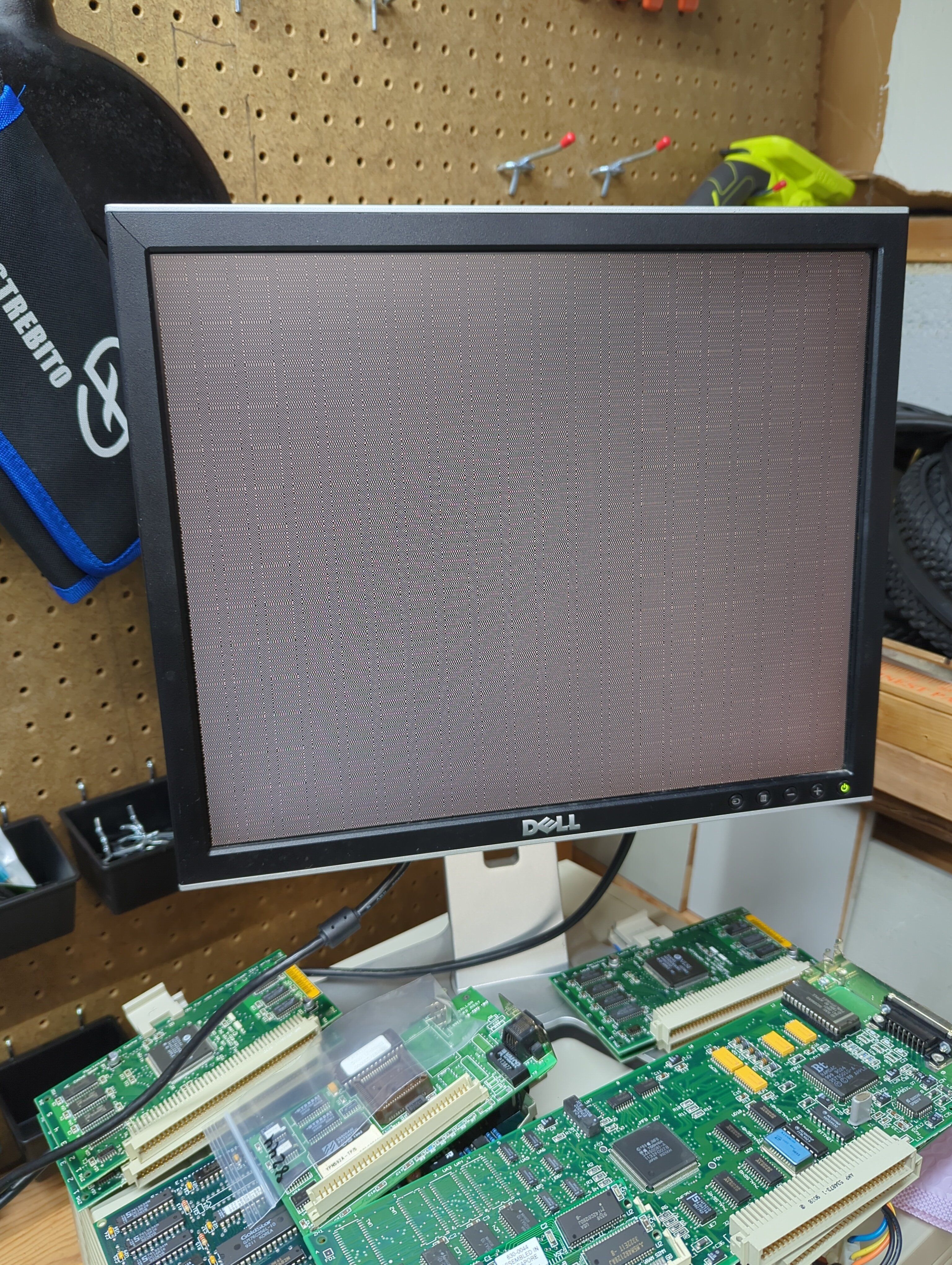

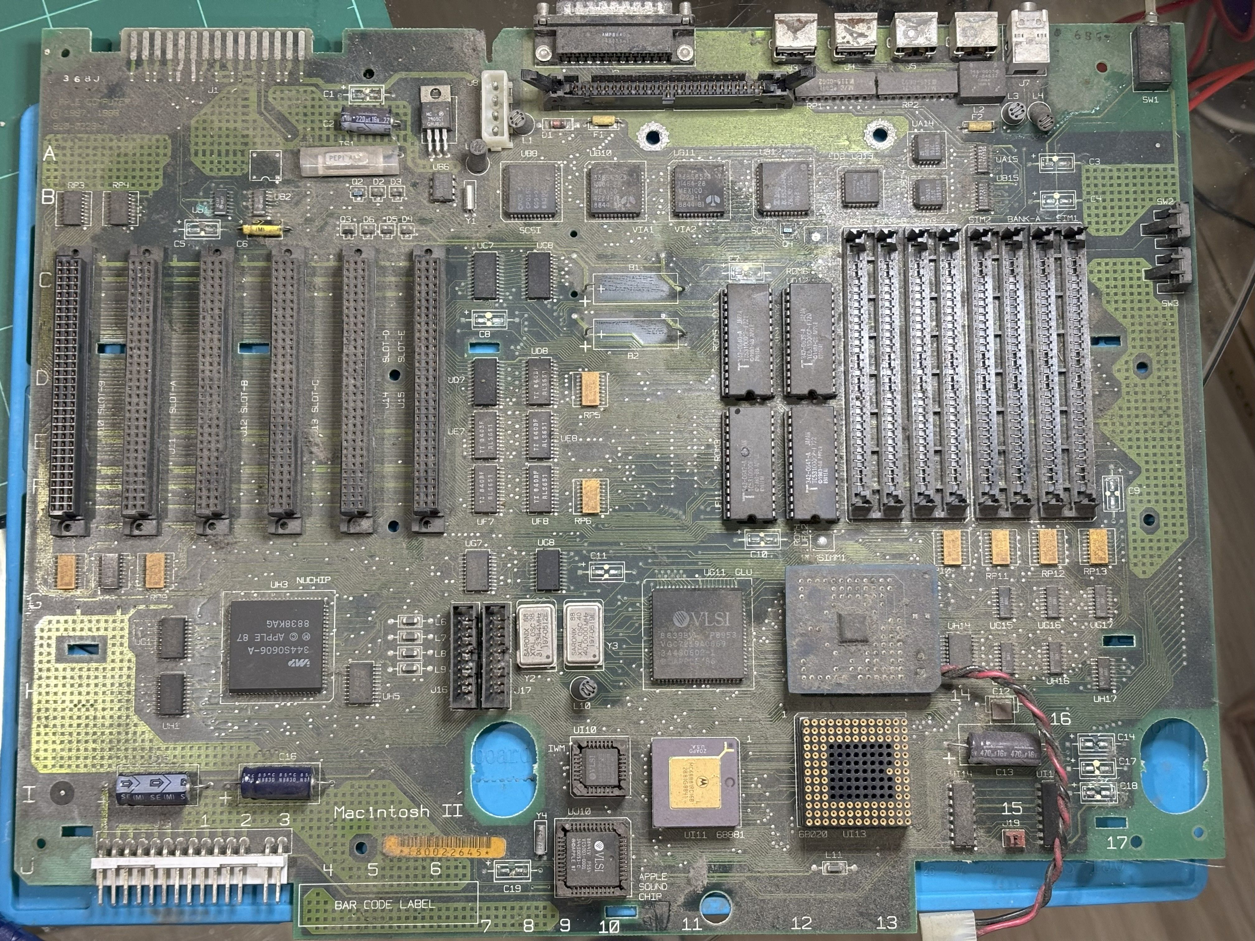

I replaced the SMD electrolytics with tantalum caps on this Macintosh II board 820-0228-A. The board boots, and sound is good, but the video appears with a scrambled pattern. I can see the cursor move between the broken up columns. I'm using a known good Macintosh Display Card with correct DIP switch settings. I've tried booting with known good RAM SIMMs pulled from working earlier revision Mac II boards. I did find a broken trace from D5 to B1, I bodged that with some wire and ensured continuity. Nearby the broken trace, UC7 was the worst-looking chip on the board with highly visible corrosion. I removed it to clean it up and reinstalled but the issue persists. Looking around the NUCHIP, nothing looks visibly awry. I've checked more traces but I'm running up against the limit of my abilities.
Any suggestions on further troubleshooting would be appreciated!

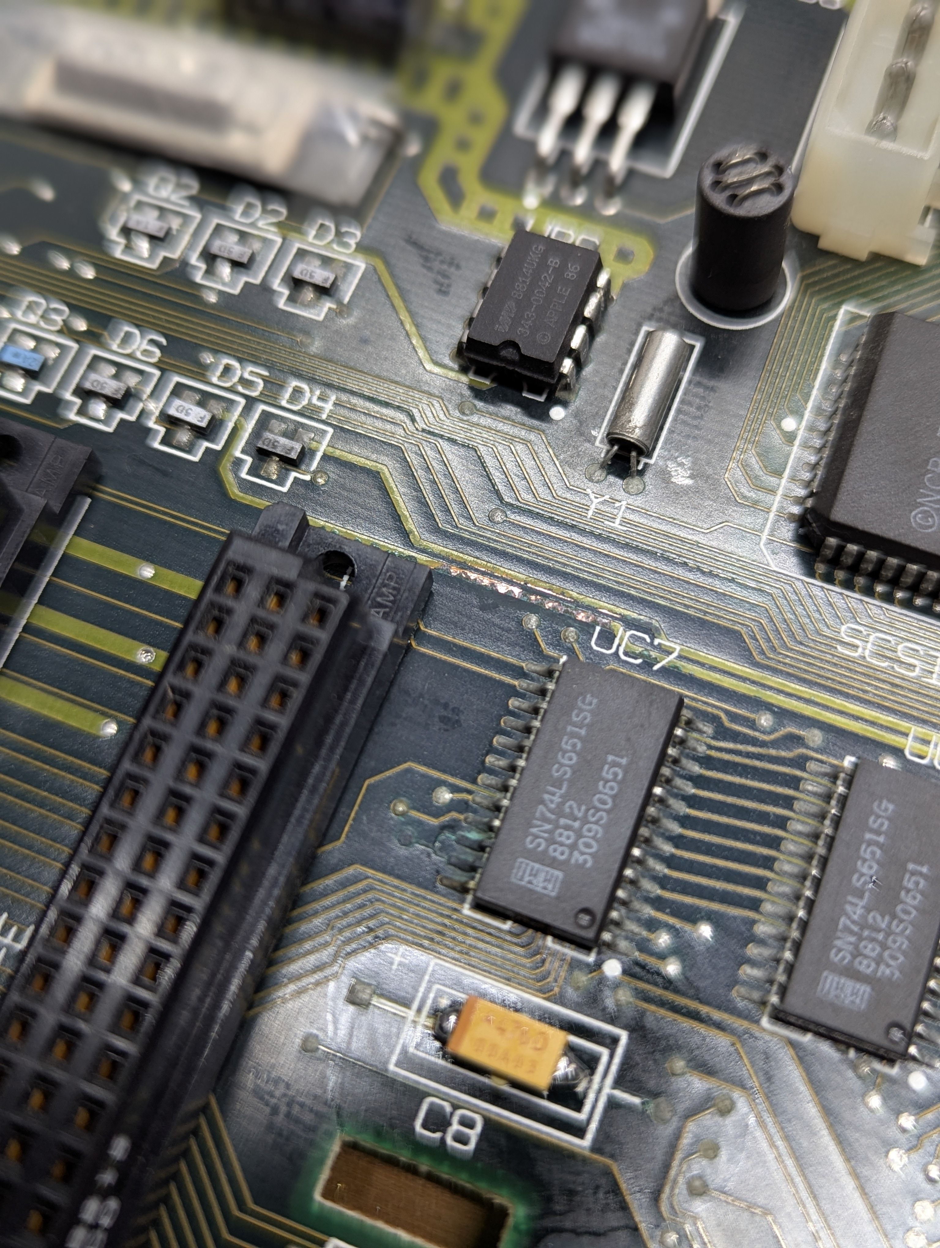

I was working on my board last night, I ended up replacing every 74ALS651 with chips from a Mac II with working video and no change, so that doesn’t appear to be the root issue. I measured some of the replacement caps and noticed they were under voltage, some were 5V others were less than 1V. I guess I didn’t do a great job with those connections? I reflowed all the capacitors and re-measured and they all measure 5V now, with two (I think?) of the axials measuring 12V. After I reflowed the capacitors it did, for a second, have a slight change in behavior, there were no vertical bars and I could see the whole mouse. I didnt have a mouse attached so I couldn’t check how it looked if I moved it. The Missing Disk icon was still only partially showing. Unfortunately, after a reboot, it reverted to showing the vertical bars with missing video data.
I’ve also swapped the CPU, FPU, 68851 and all the ROM chips with the board that works just to rule any of those out.

RE: Cap voltages. Remember those caps near the burn in edge connector are negative voltages, so measure the other side.

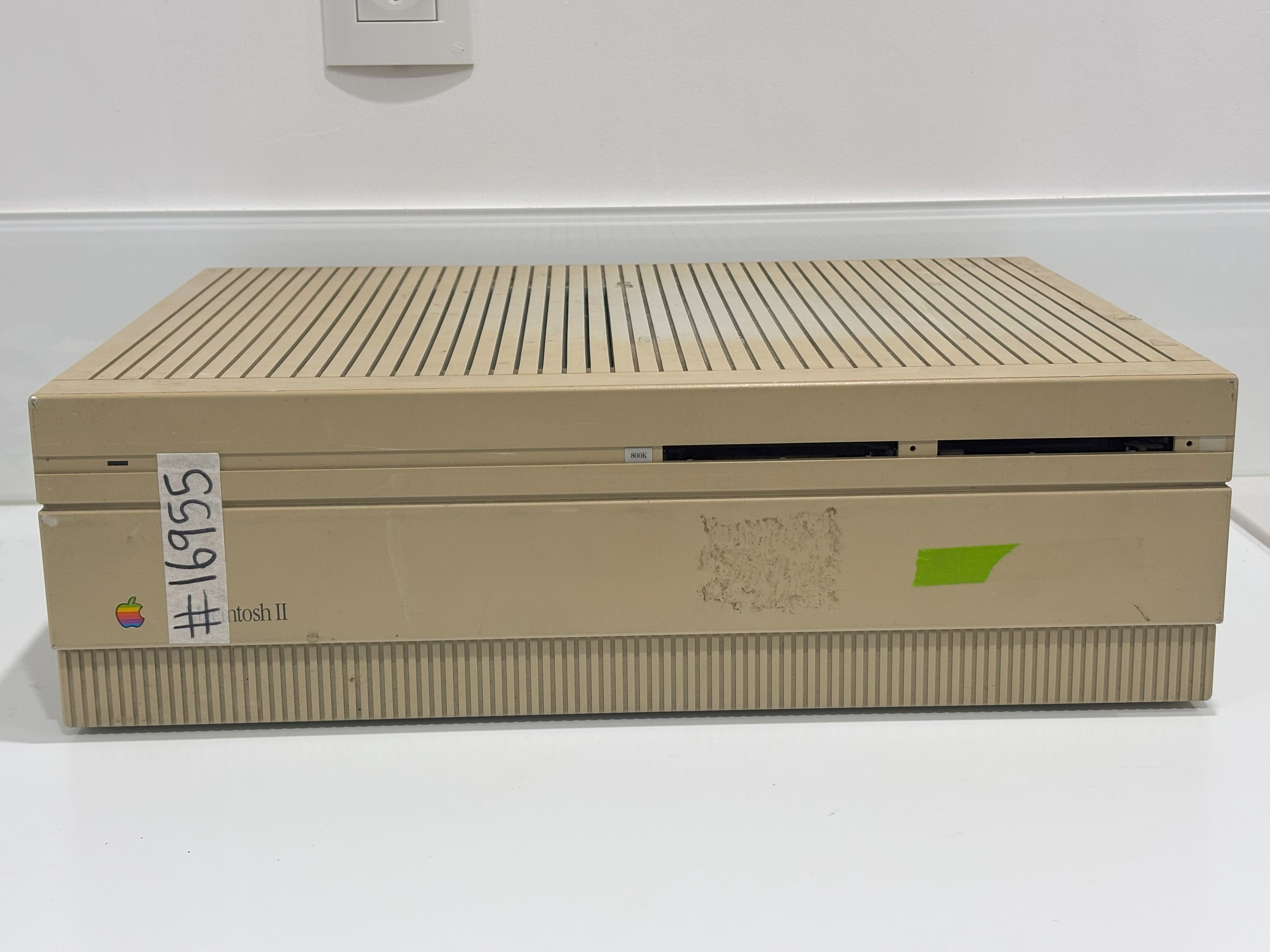

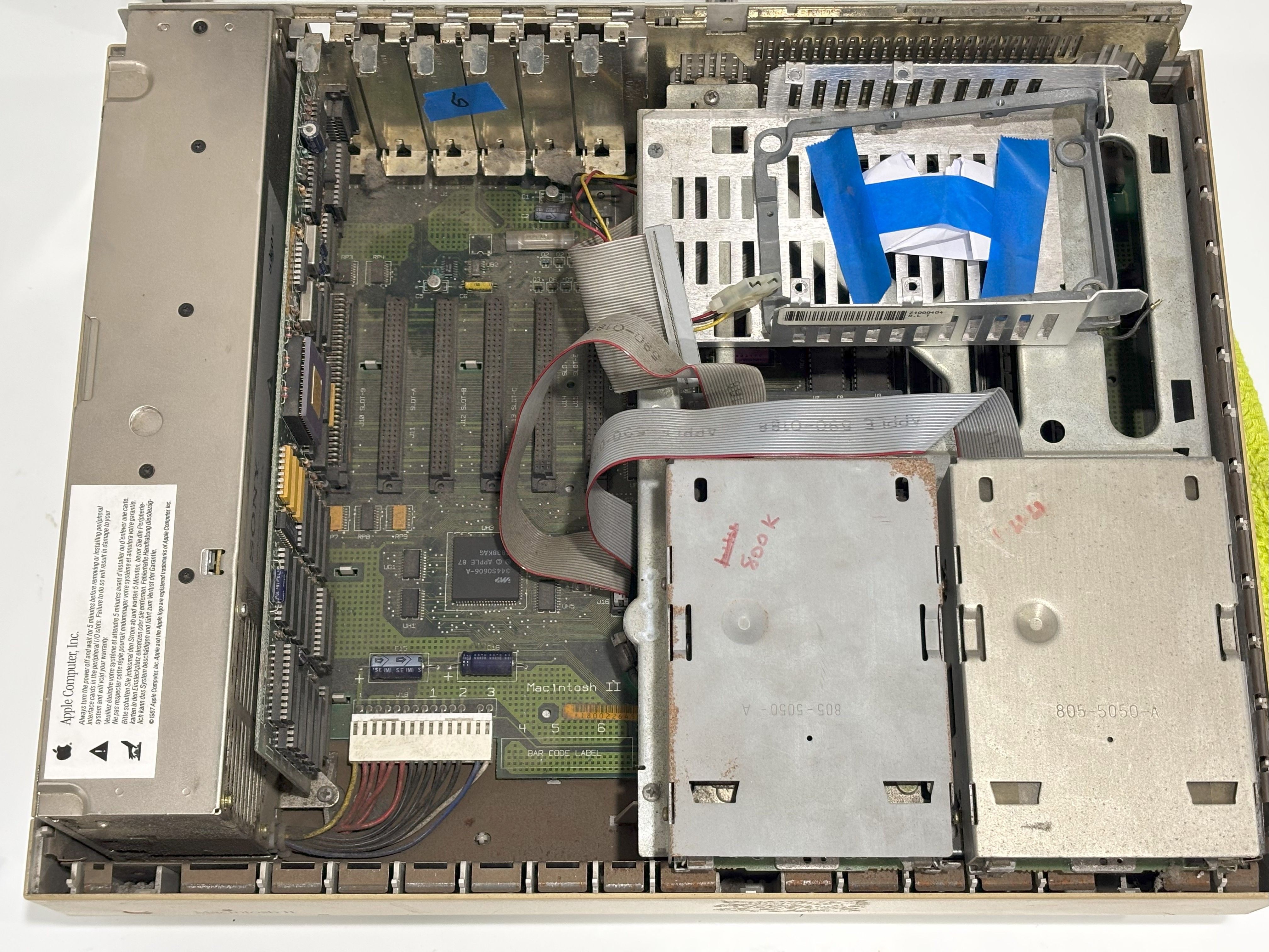

PS Here's what I started with... crimes were committed against this machine...

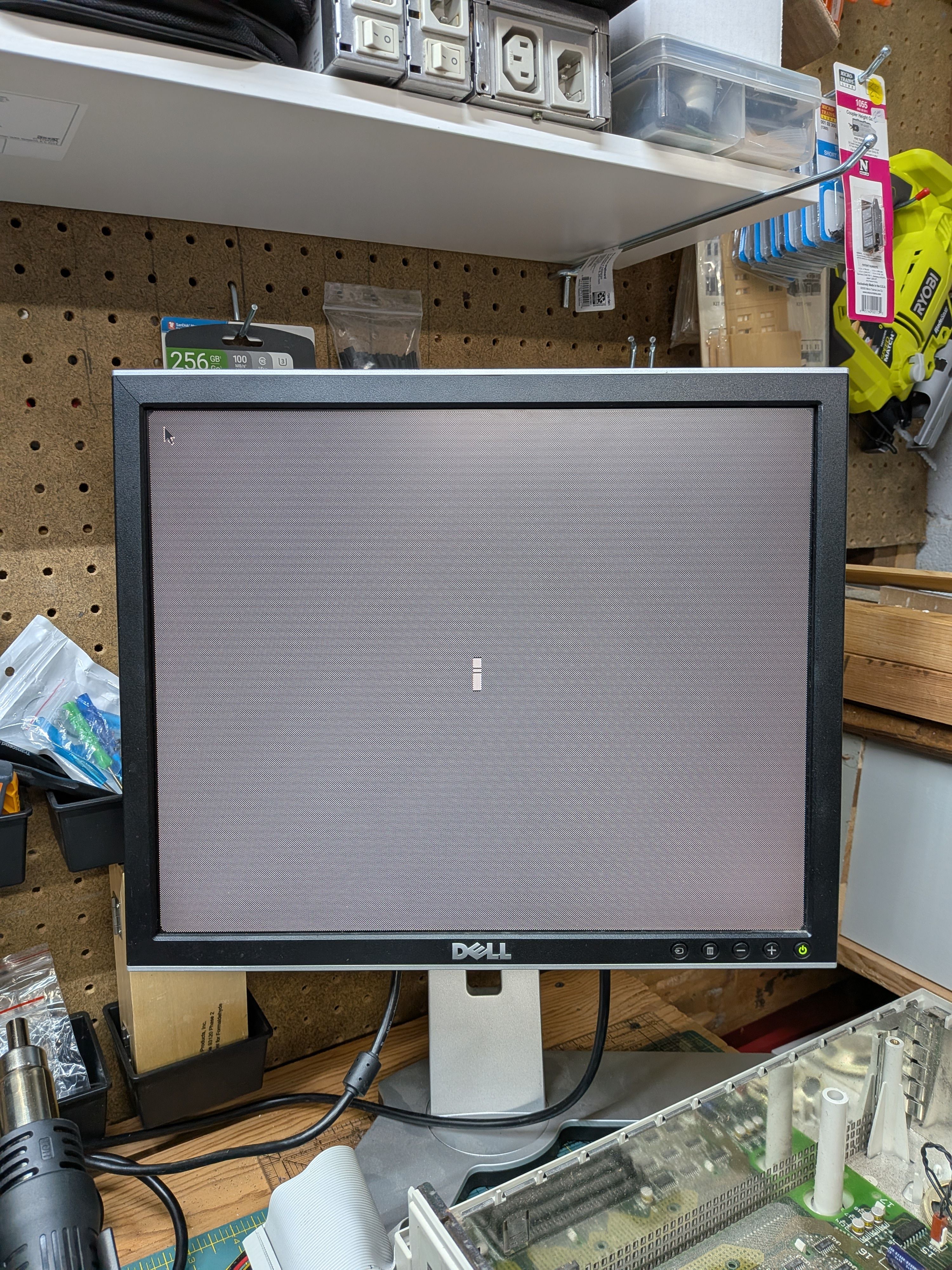

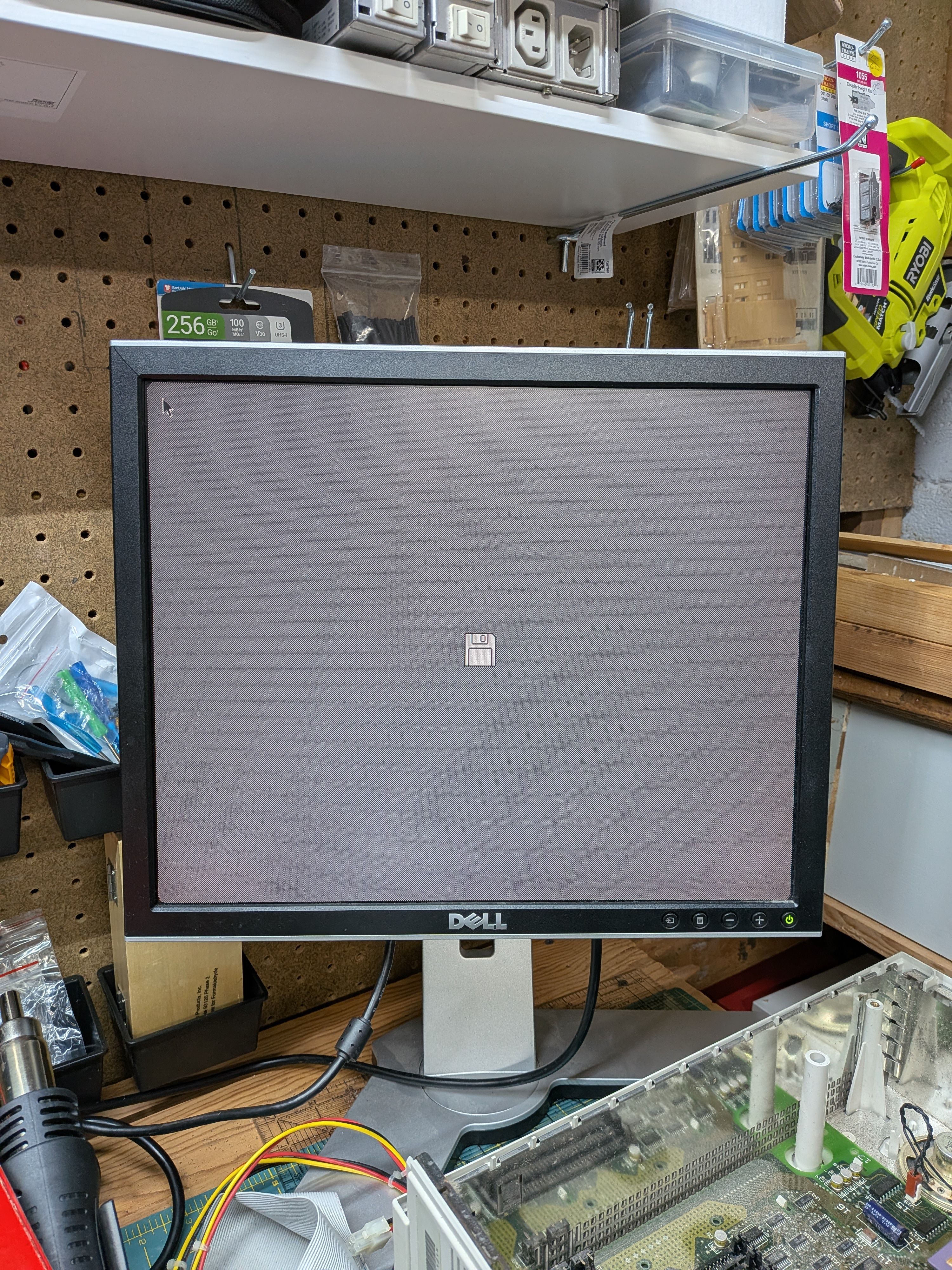

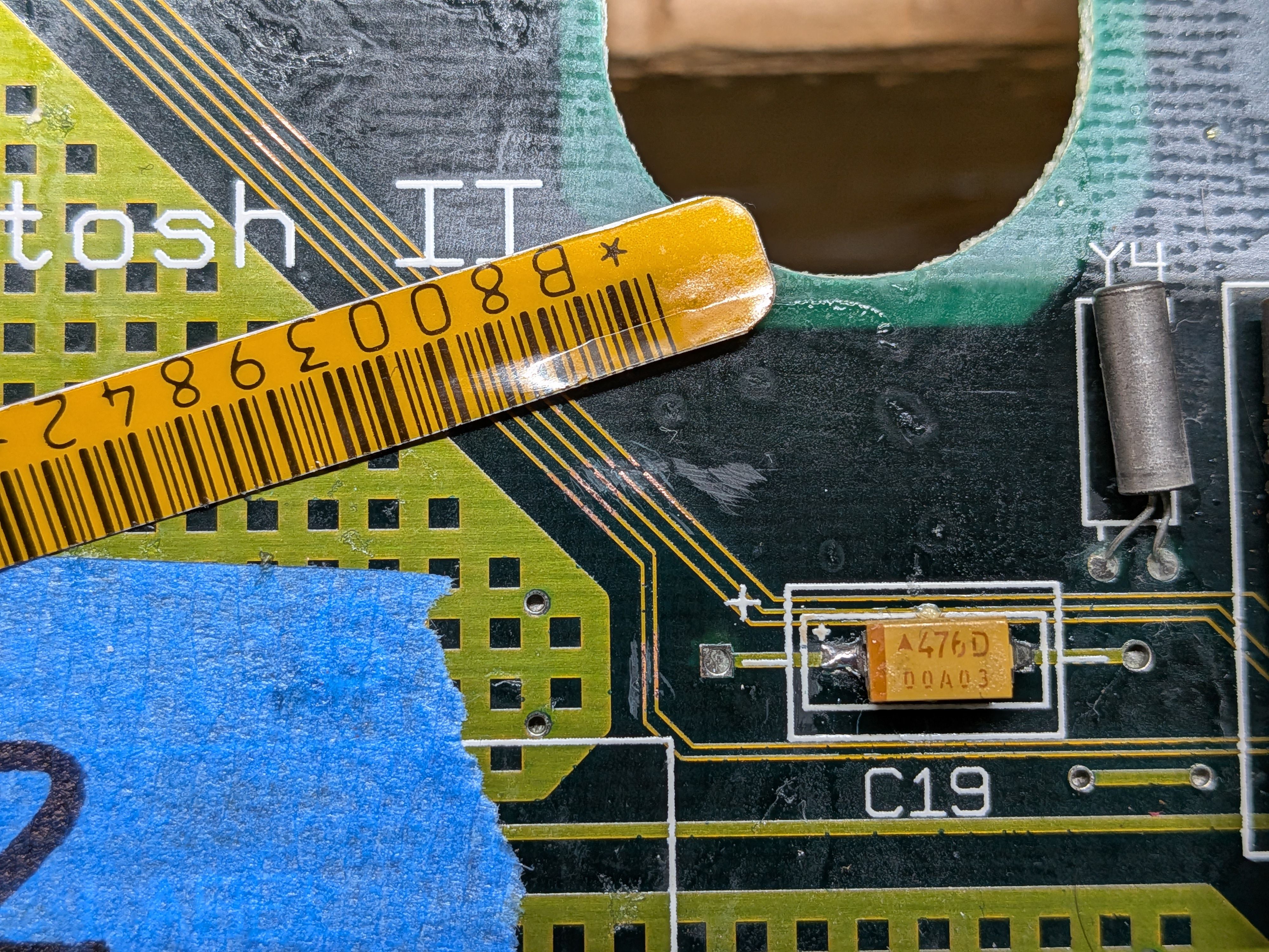

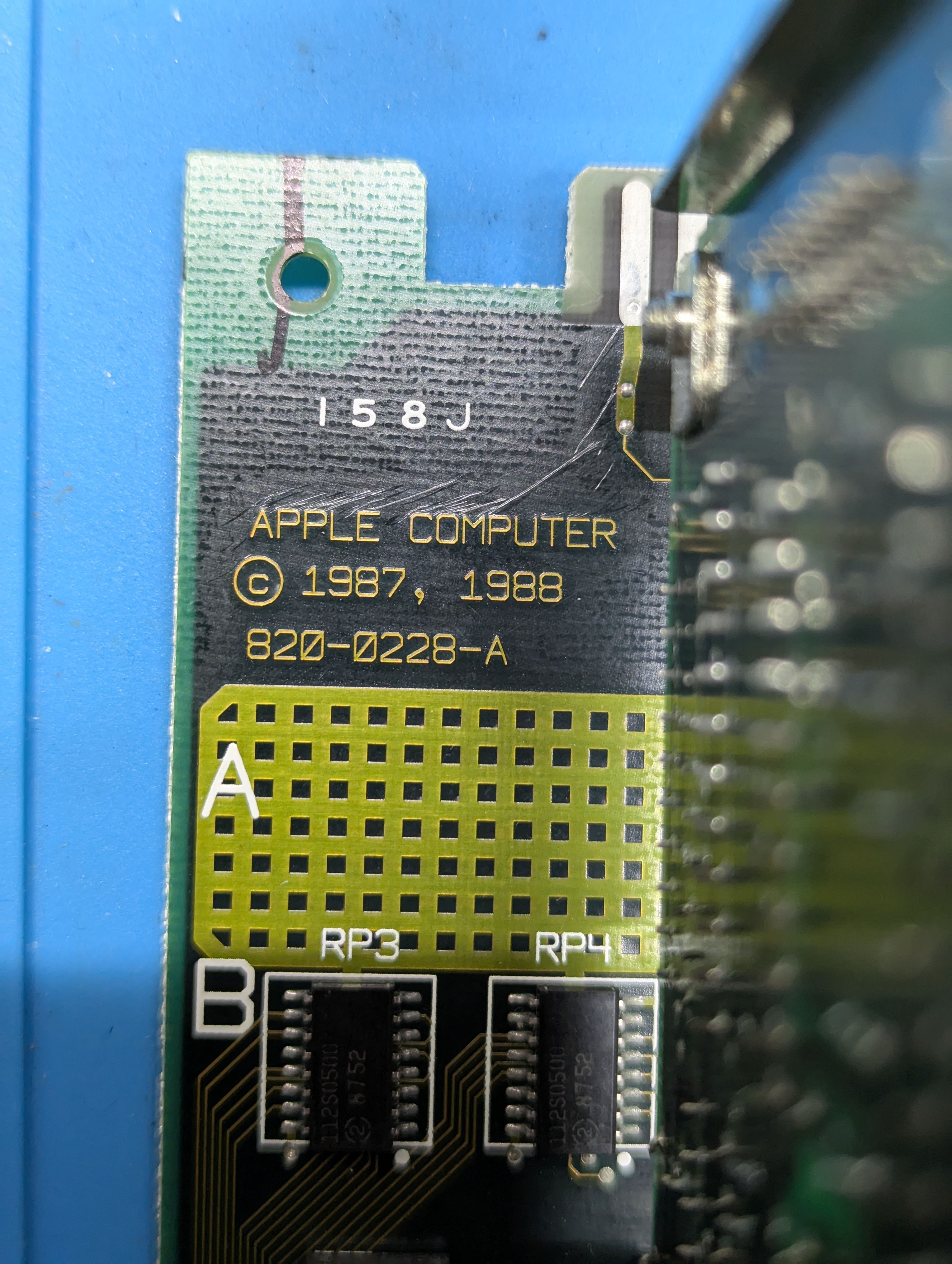

Some progress made. In a bout of frustration I started following some traces in other parts of the board I haven't scoured over yet. When I got to the barcode, I noticed it was covering the traces near C19 and it had some suspicious looking discoloring right near the edge of the label. I lifted it up and started scraping away at the mask and discovered two traces with hairline breaks. The label must have collected some of the electrolytic juice along it's border and made a clean cut, this was really not suspicious looking at all!
I was able to locate the related vias and ran some wire to connect them, the break was connected to pin 4 of the Apple Sound Chip. I booted the machine and for the first time got a completely clear video image!

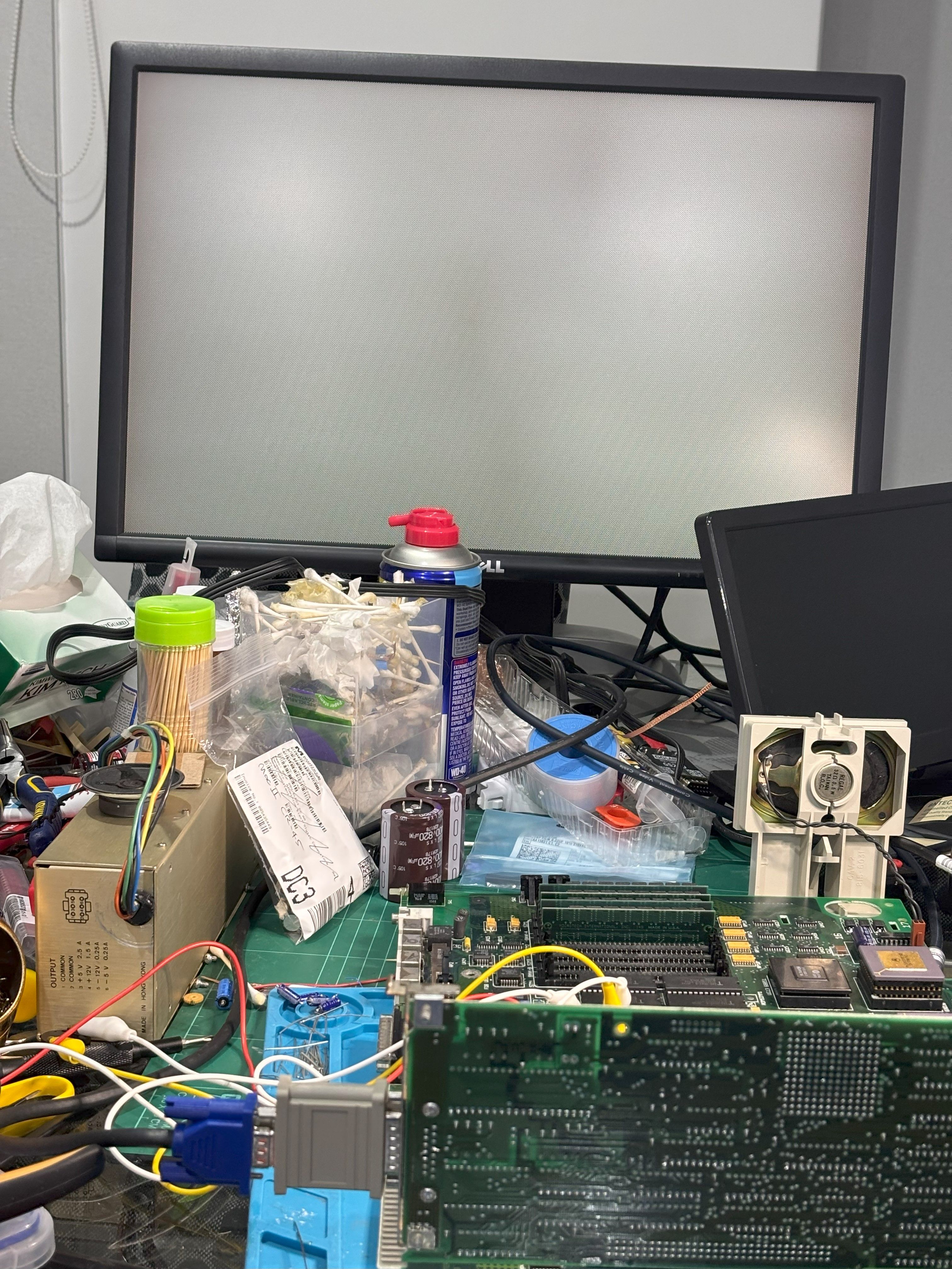

My luck didn't last, unfotunately. When I came back to the machine later in the day, the bars were back, albeit, not as bad as before. This is the second time during this repair that the vertical bars have disappeared and returned after a reboot. I've been following the schematics as best I can and have been beeping everything out, especially related to data lines and address lines. Tonight I checked the rest of the pins on the ASC and SWIM chips but didn't find anything. The work continues, but the ASC pin repair seems to have restored more of the video data if you compare to the image from my first post.

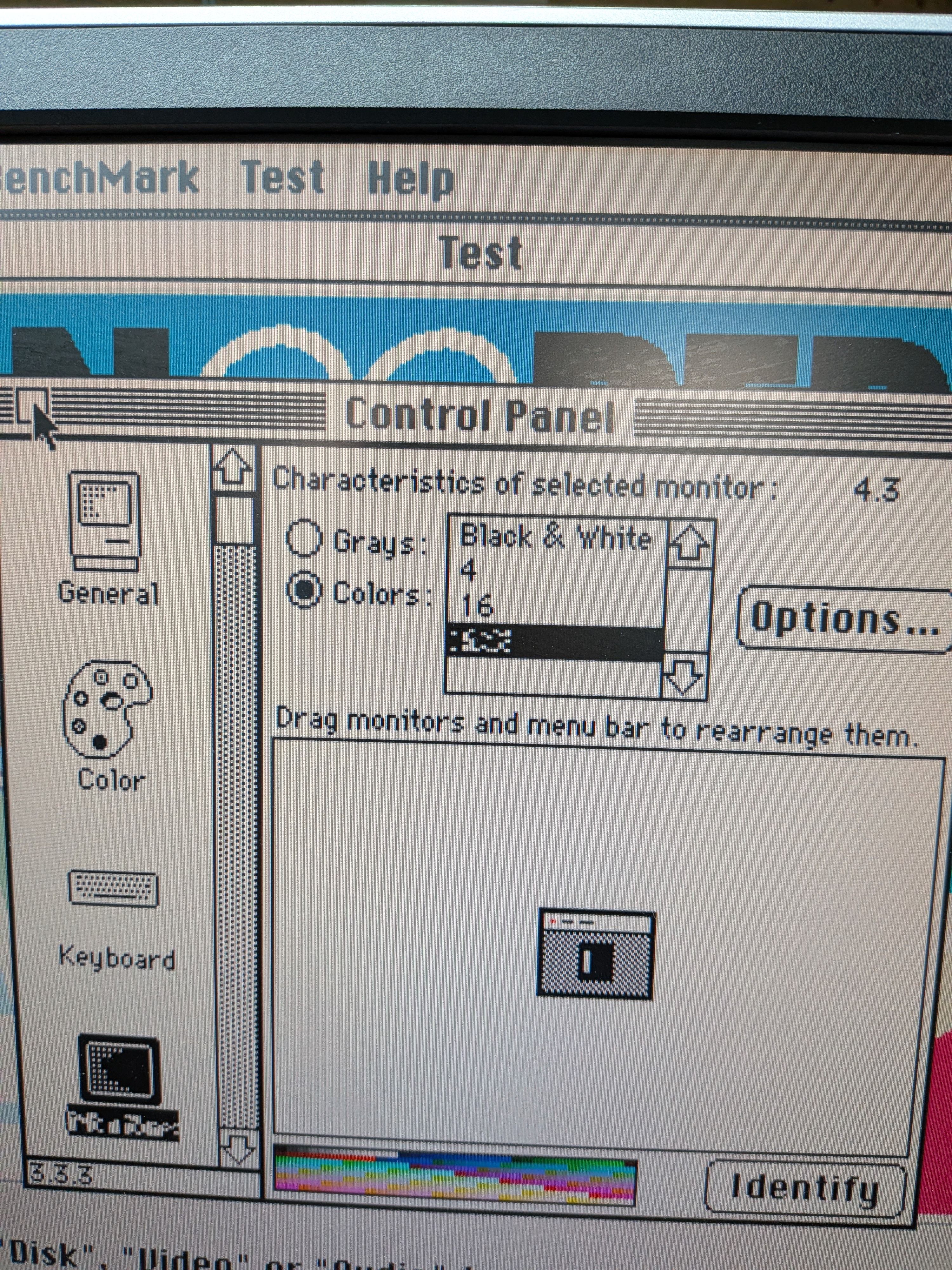

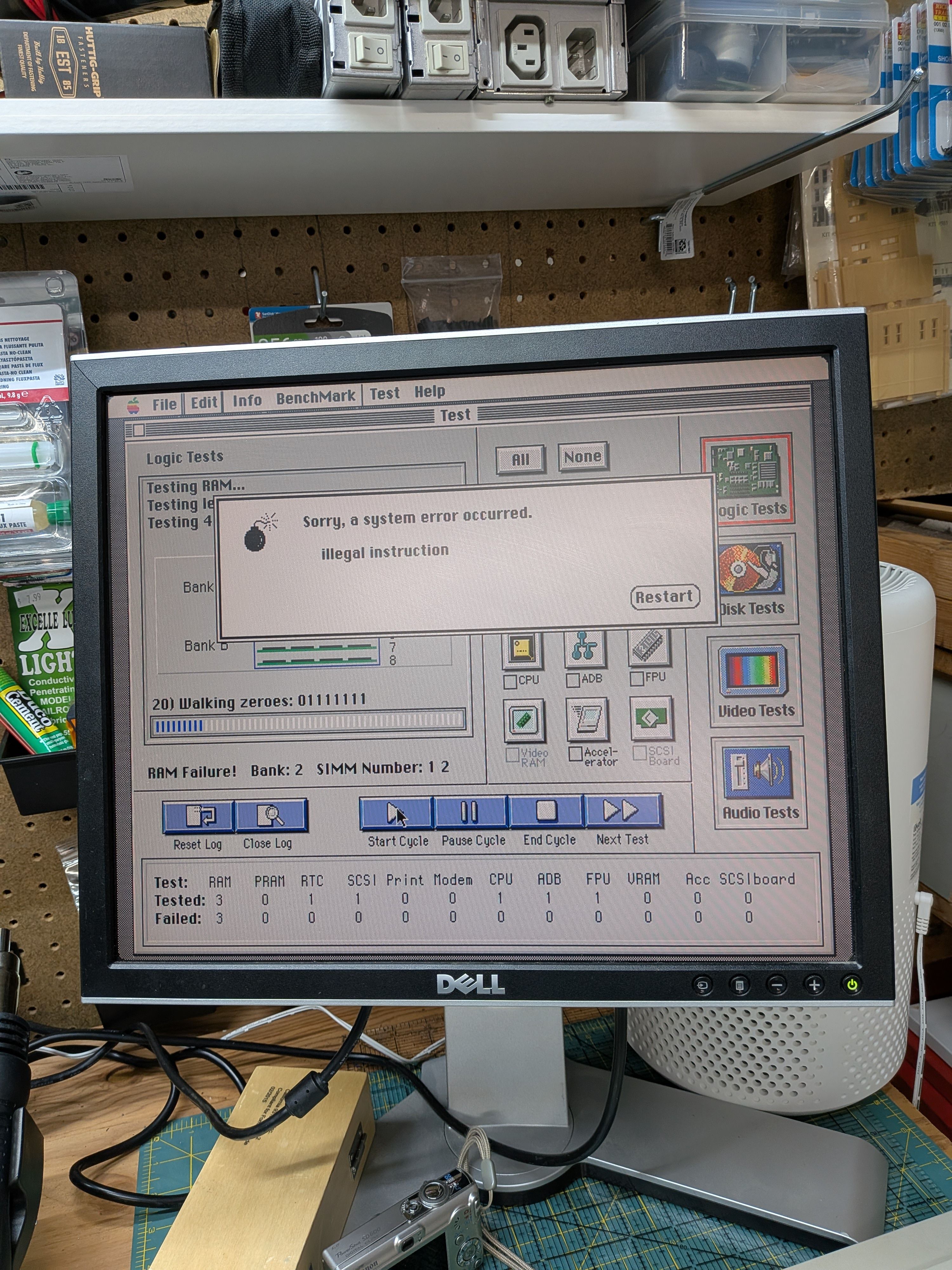

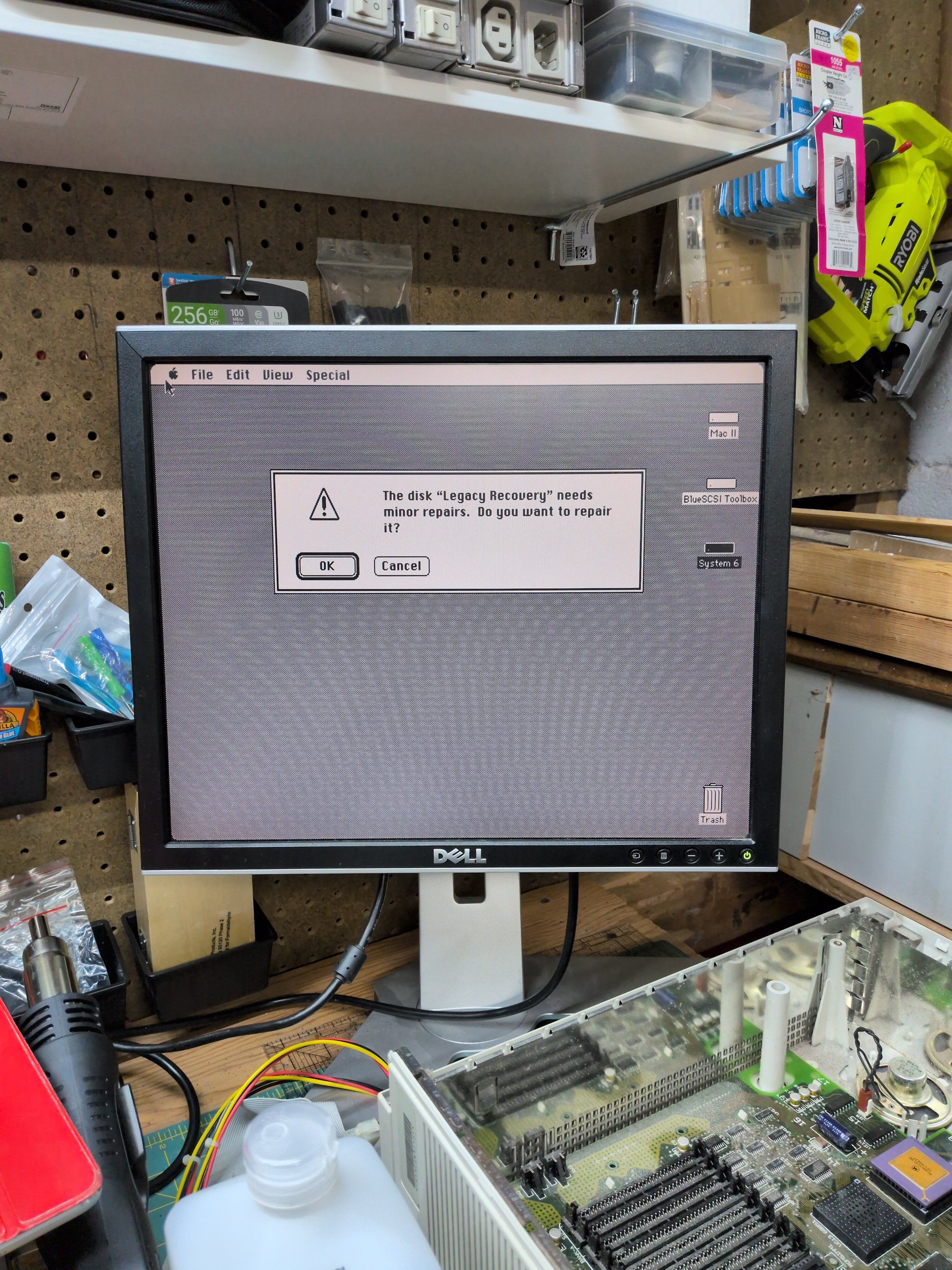

After failing to find any further broken traces, I decided to soak the board in IPA yesterday for about 8 hours. There was starting to be a fair amount of flux residue left over so I wanted to rule out that a dirty board was exacerbating things. I let it dry over night and booted it this morning with (mostly) working video. The issue now is any highlighted text displays with some strange artifacts. This happens on the Desktop or any dialog window.

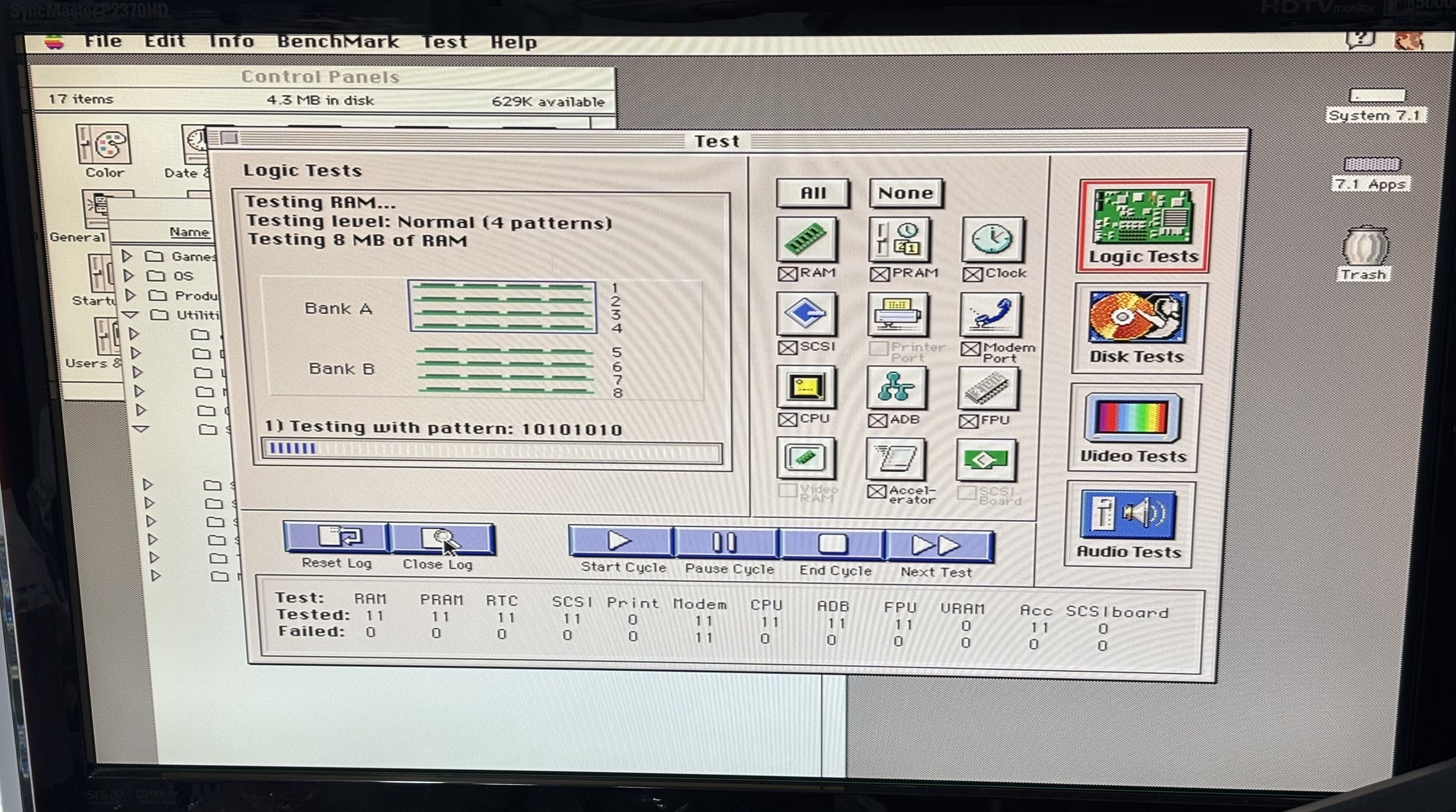

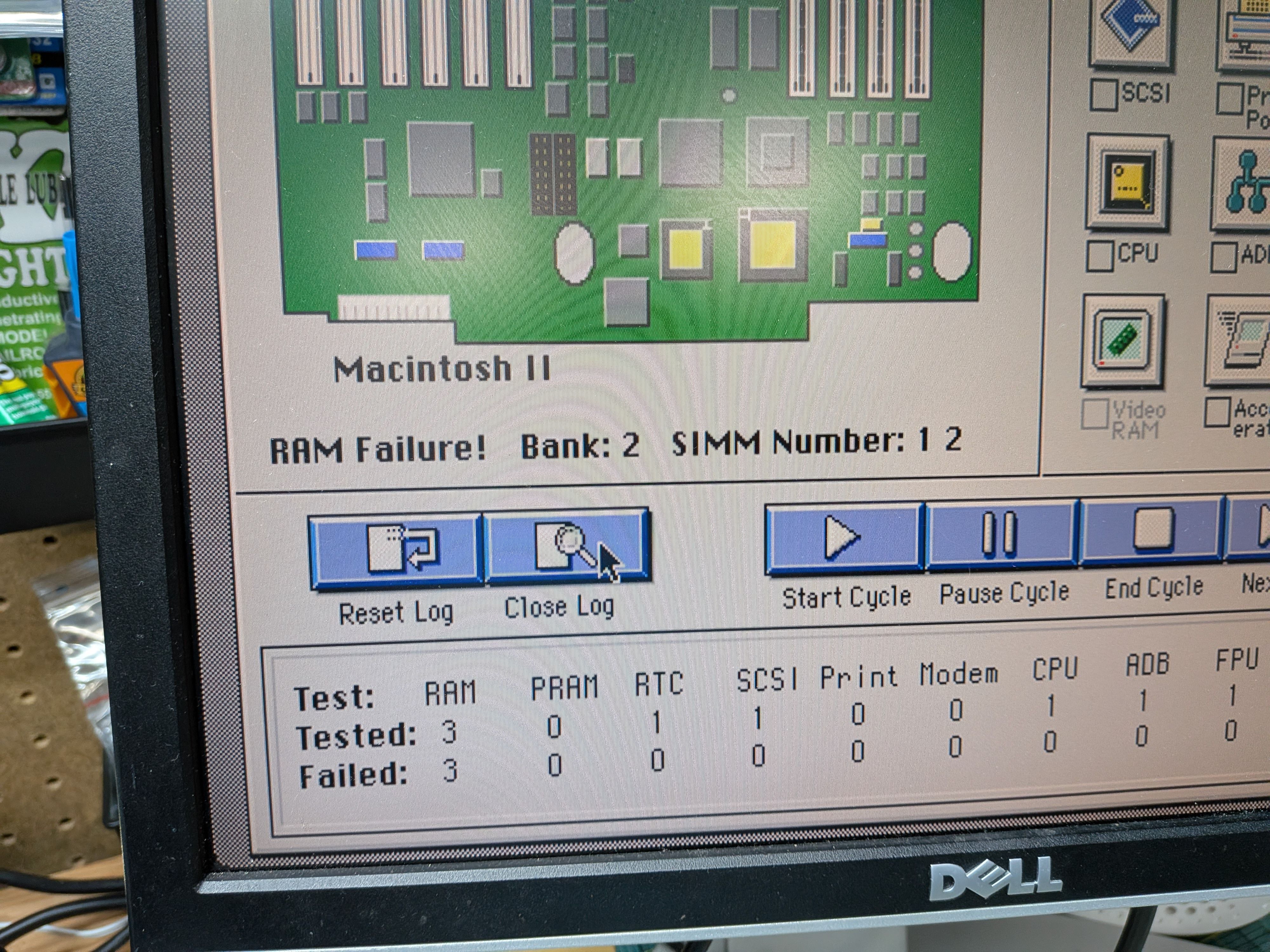

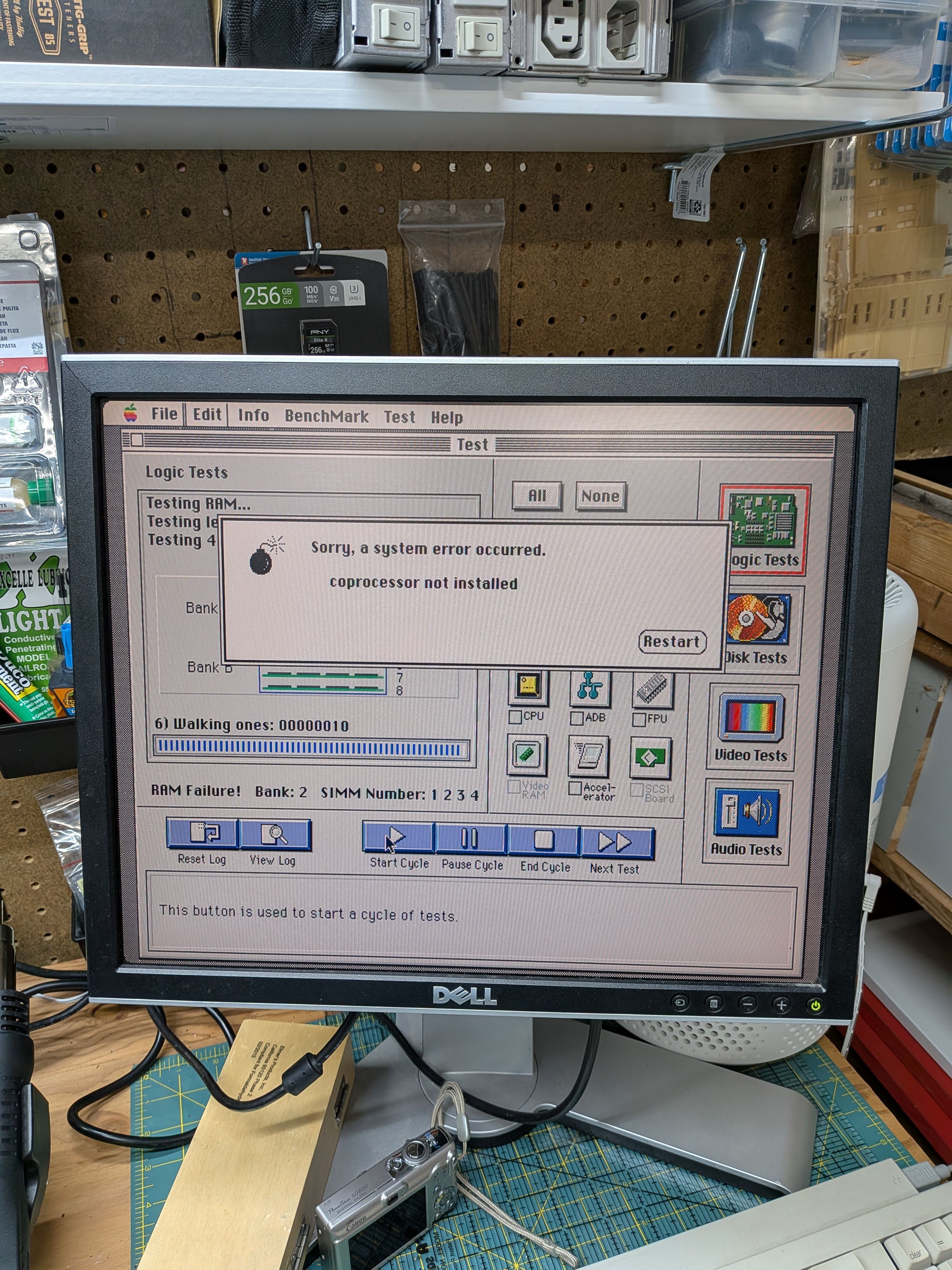

I ran Apple Personal Diagnostics which reported no issues. Snooper 2.0 seems to think there's a problem with the Bank A, SIMM 2 slots, though it's been inconsistent about which slot is the problem. I've also tried swapping in a different set of SIMMs, but it still gets angry about SIMM 2. I didn't find any continuity issues when I was testing the RAM slots, but I'll probably go over them again in case I missed something. It's also possible I just have bad RAM SIMMs?

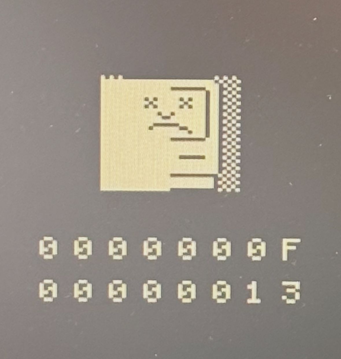

When I've configured the RAM tests to try 20 patterns, I've gotten some interesting bombs (FPU tests pass, fwiw):
Getting closer, but still not there. We'll see if the video holds out this time!
Reactions: DevyDevly
Small update: I've been booting from a BlueSCSI V2 and I setup a new image with a minimal install of 7.1 to try out. There are no video artifacts afaict and Snooper has been running the 20 pattern RAM tests all afternoon with no errors. I'll have to try a full install of 7.1 and maybe a reinstall of 6.08 on a new image. Perhaps something was just messed up with the image I was booting from this morning.

Oooh - I like Snooper, particularly how it shows the RAM test patterns and banks.
And the benchmark tests are nifty too.
And “BlueSCSI” is actually reported on the SCSI Bus Info.
