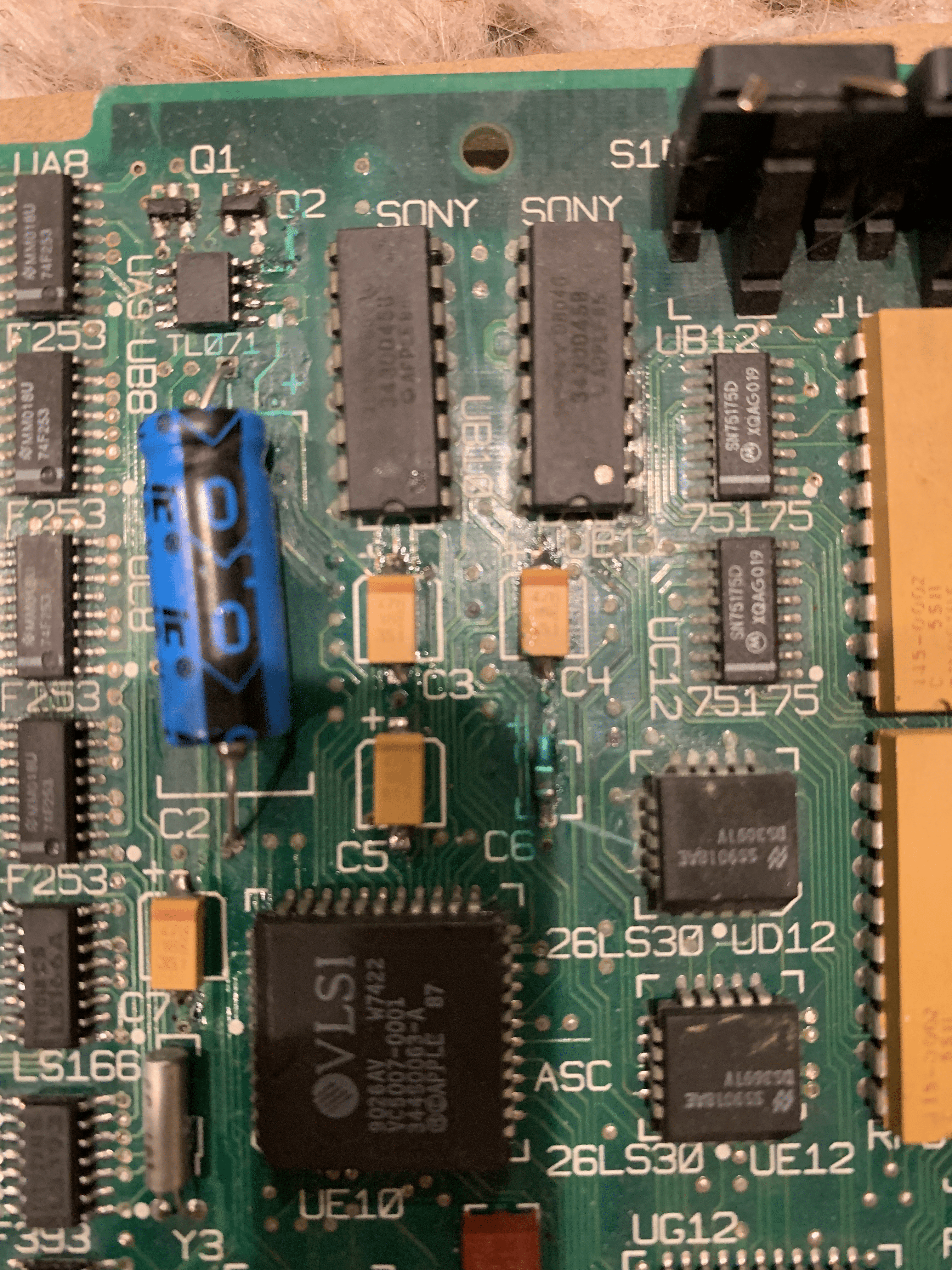

About the only thing I could spot is extra flux here...
But as you can see from my board photo below, it's the GND side of axial cap C2, which isn't an issue...

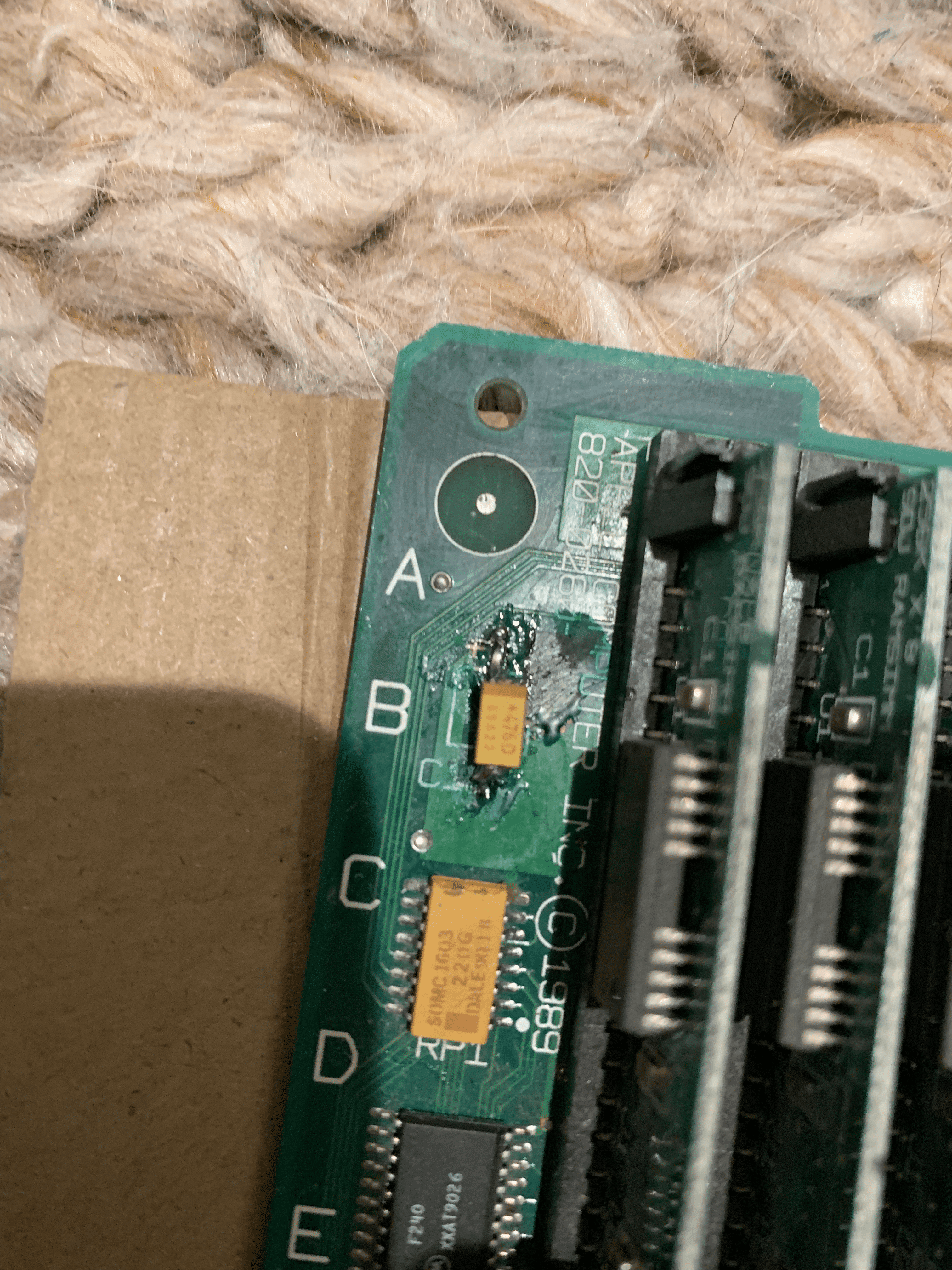

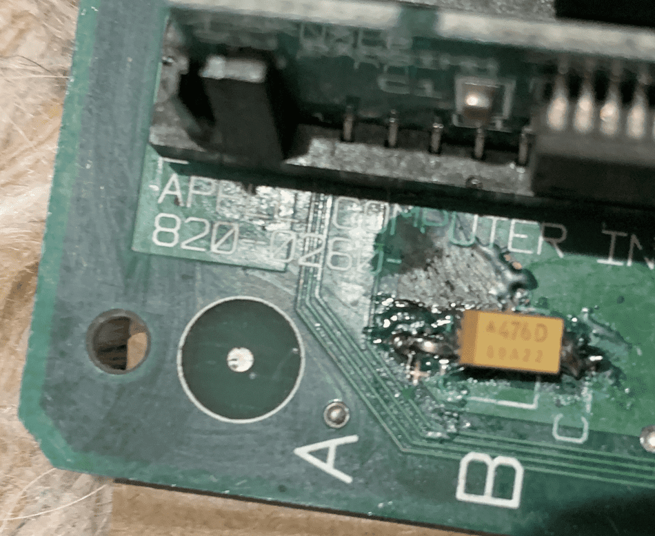

There were a few things that I noted that look strange. Below are some photos of said areas.
Note weird, blue colored component at C6:

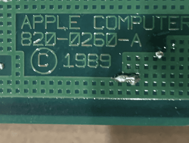

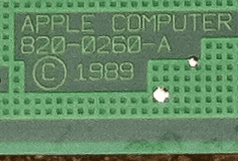

Note the bridged connection just below the "9" in 1989

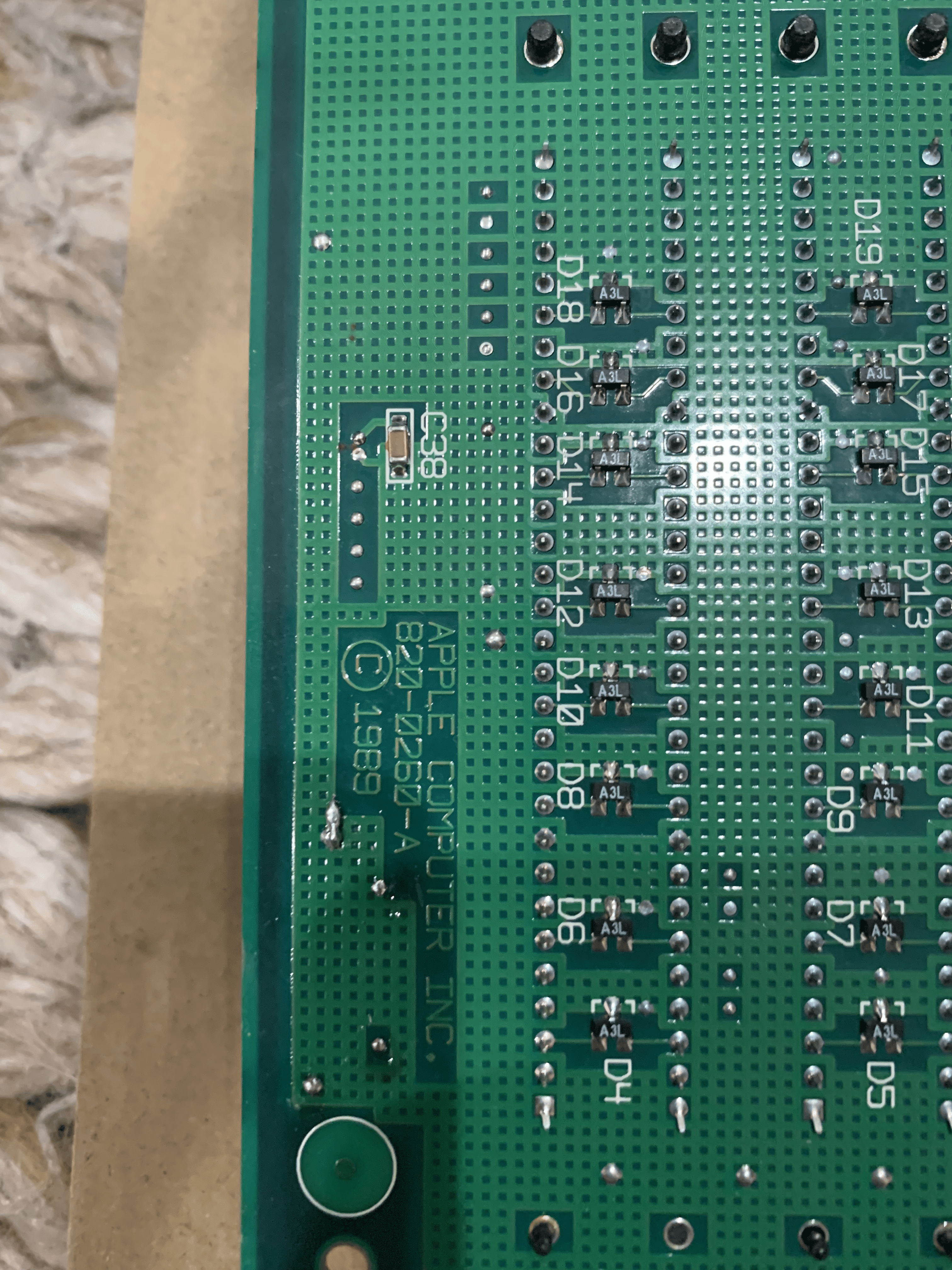

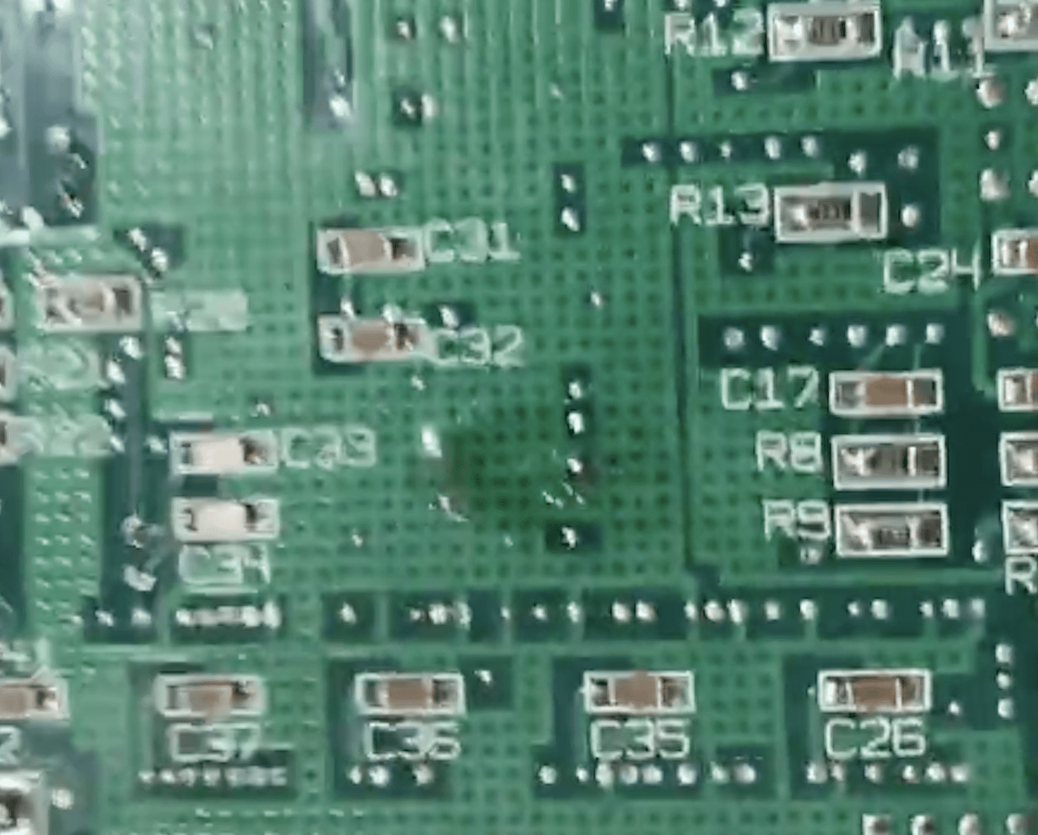

Note the weird black substance:
UV solder mask. I guess Amiga of Rochester used that to cover exposed copper traces. Not an issue that I can see.
Note necessarily a bad thing at all.

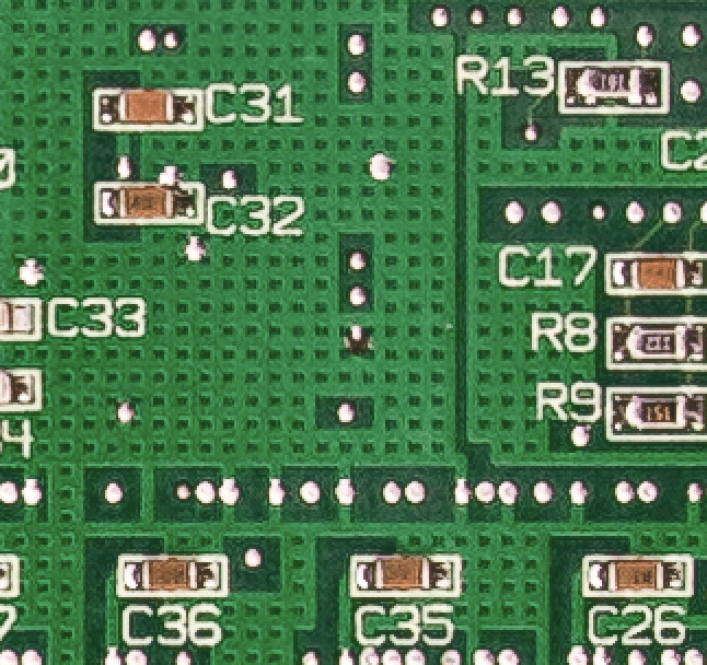

My board looks like this on bottom...
And like this on top...
Again, that's UV solder mask, used to cover exposed copper. Not an issue at all that I can see.
You can clean up that area if you like with alcohol. Just dip a swab in it, scrub that area, then wipe with a tissue. May take a couple applications. Won't solve your problem. Just something to make those areas look better. It won't remove the UV solder mask, so no worries.
