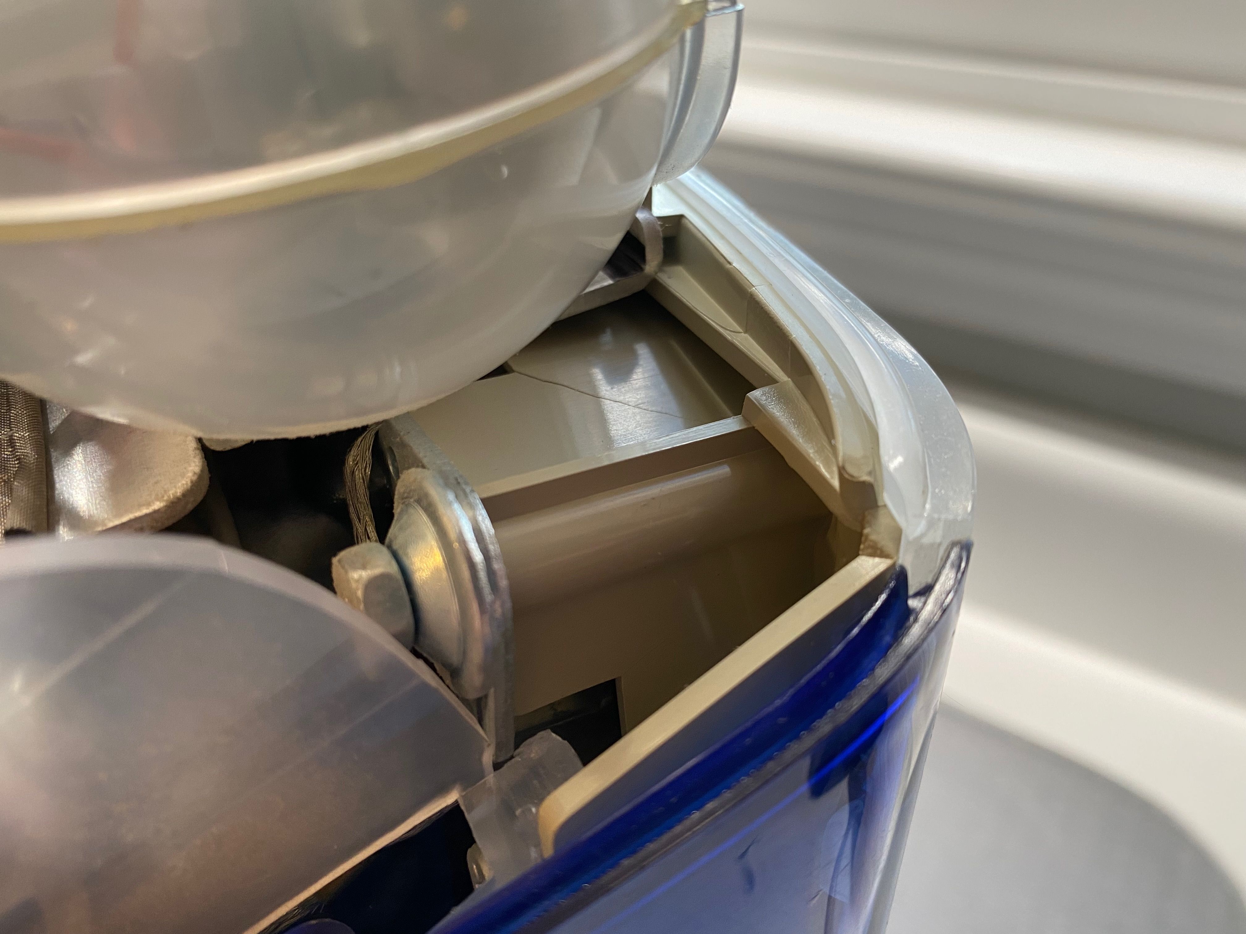

The original one in my Indigo is in pretty good shape from the outside, but it is fairly yellowed and there are cracks on the CRT screw posts. So I have been looking forward to replacing it for quite some time.

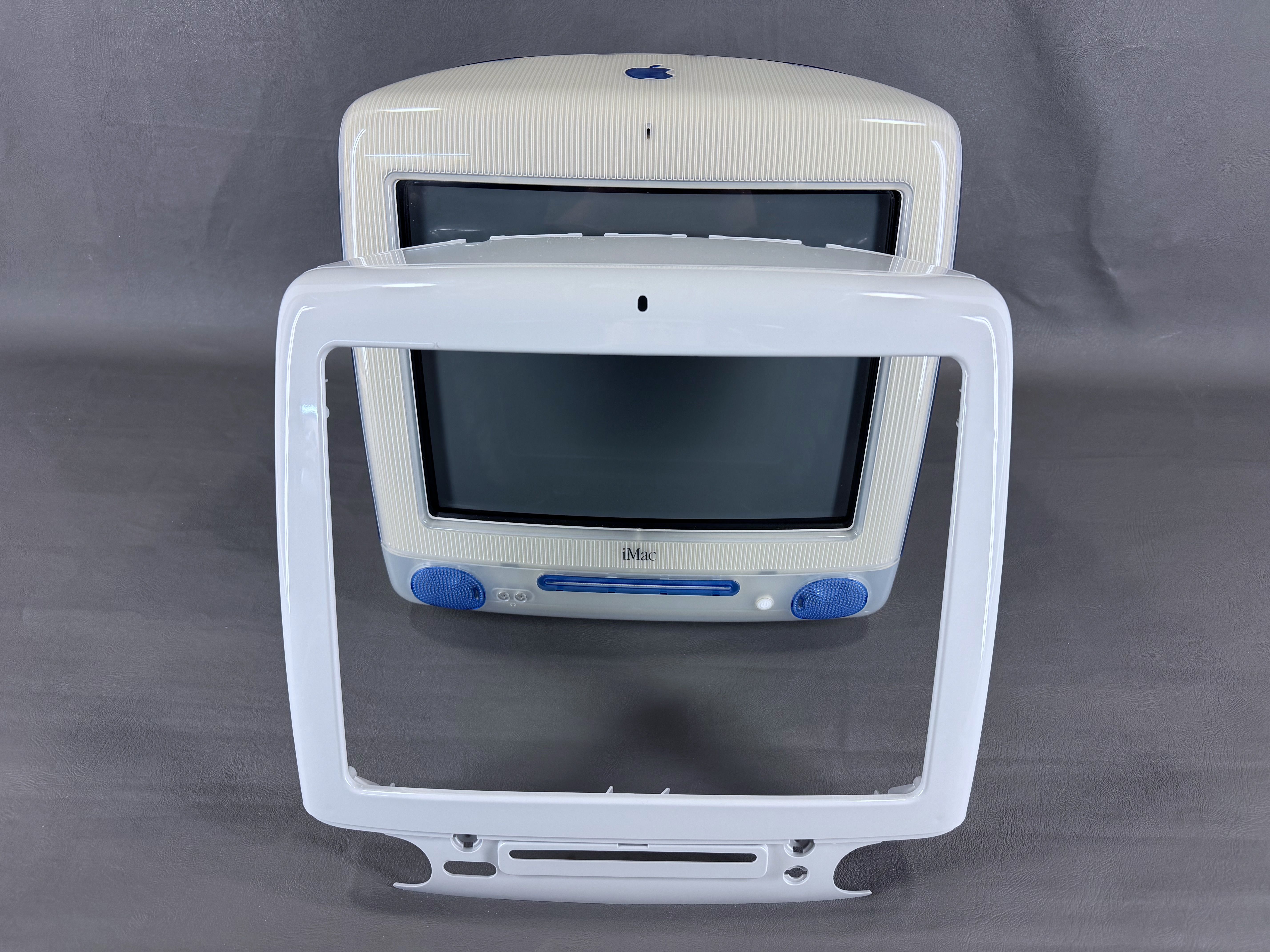

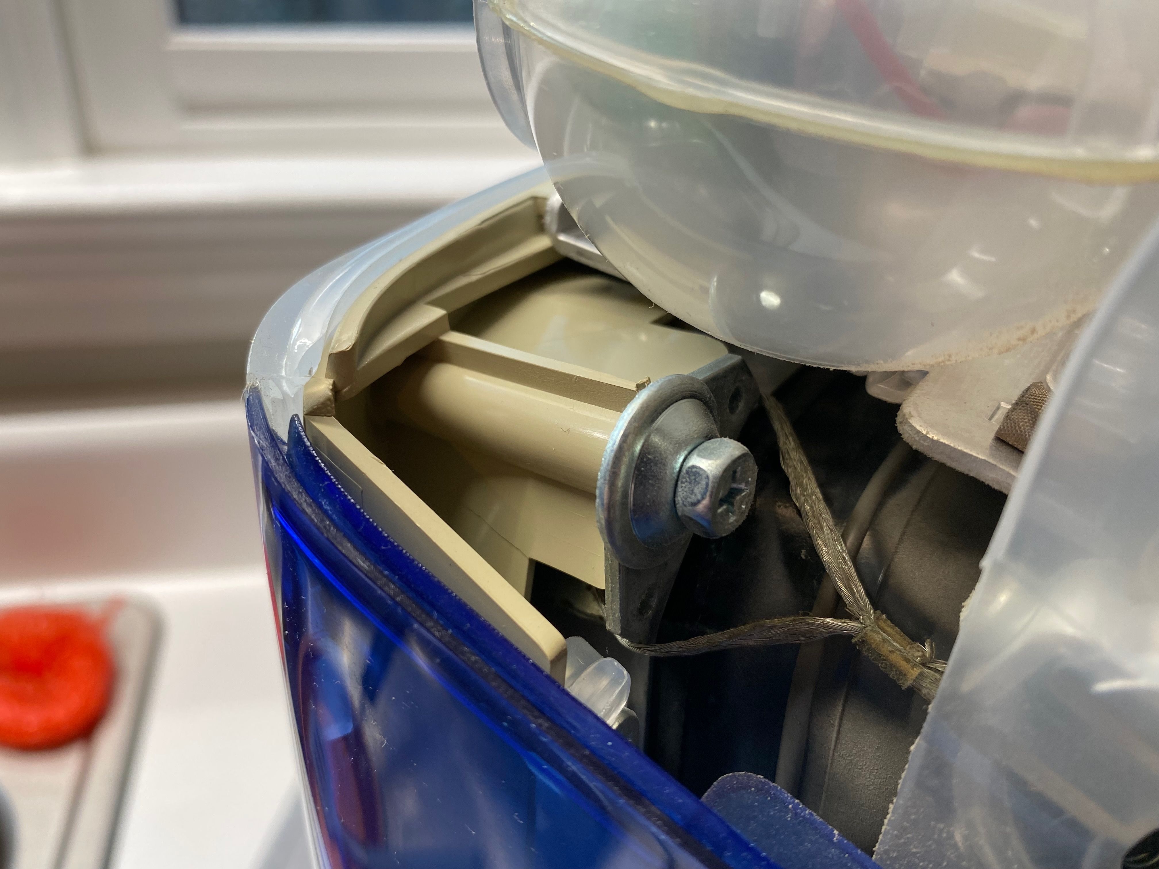

Got the new inner bezel installed. It went pretty well; took me about 3 hours (including time to document it) but obviously very much worth it. The original one was more brittle and yellowed than I'd previously known.

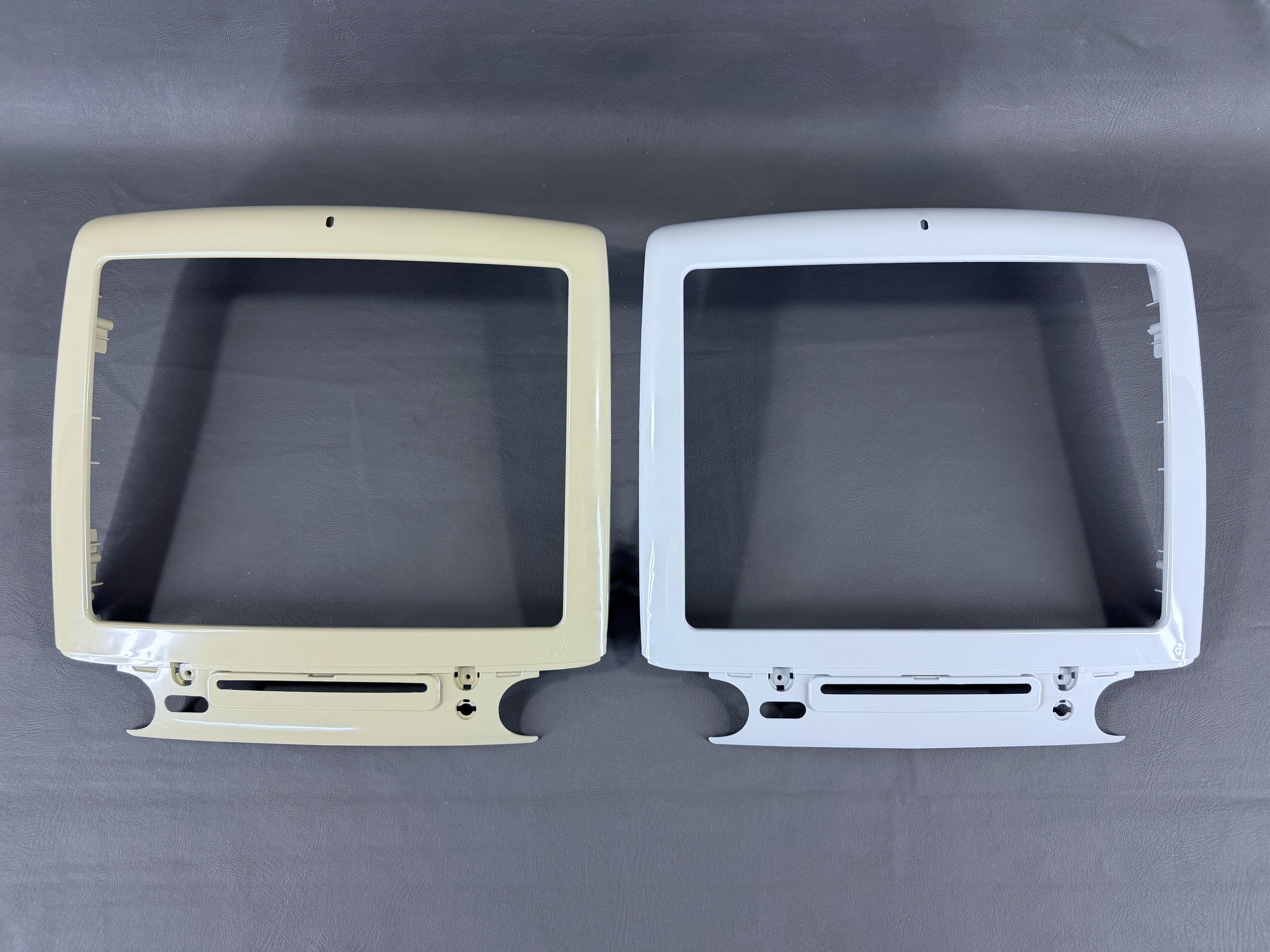

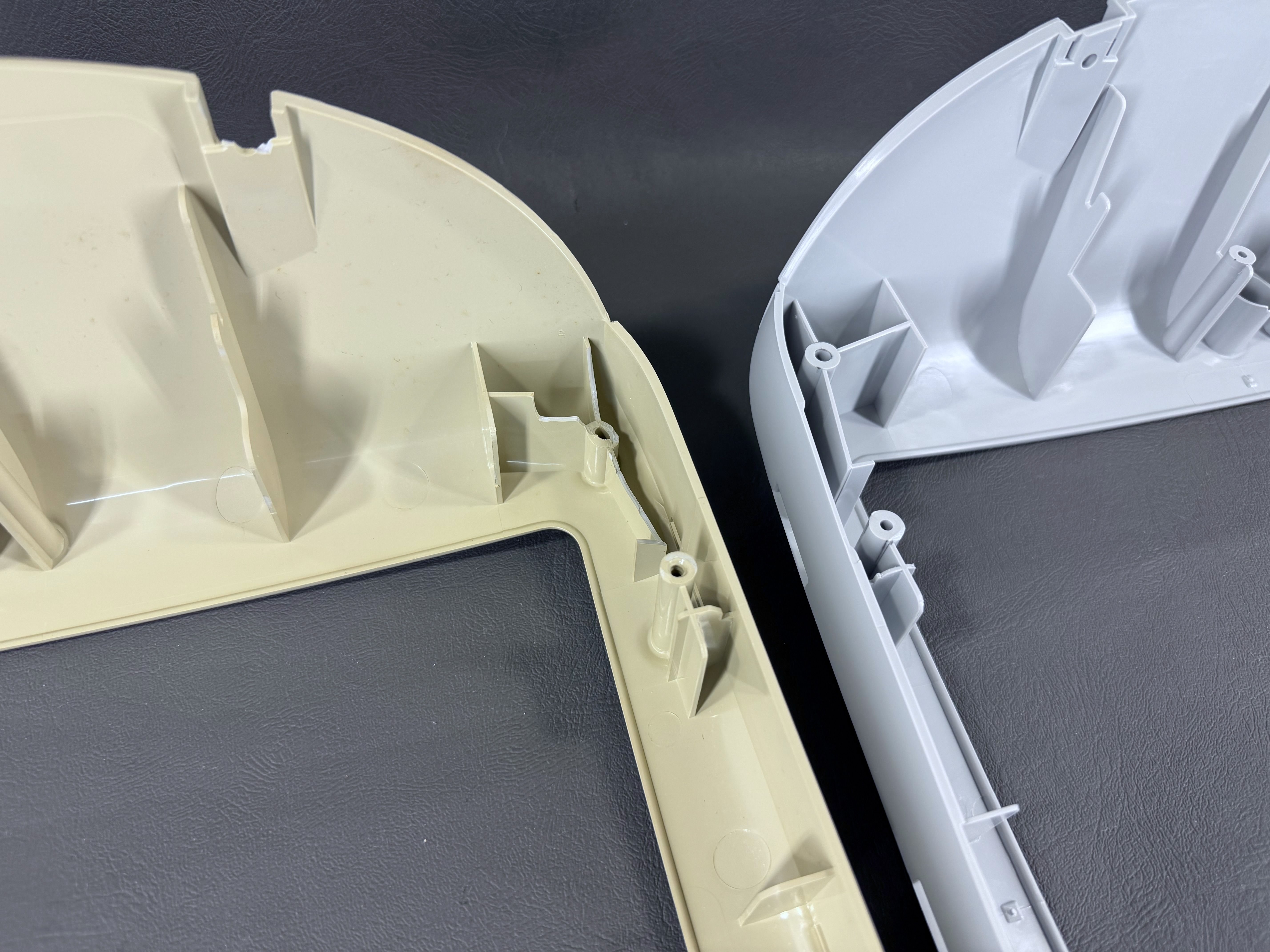

Old (left) versus new (right) - feat. one of several broken screw standoffs for the CRT mounts.

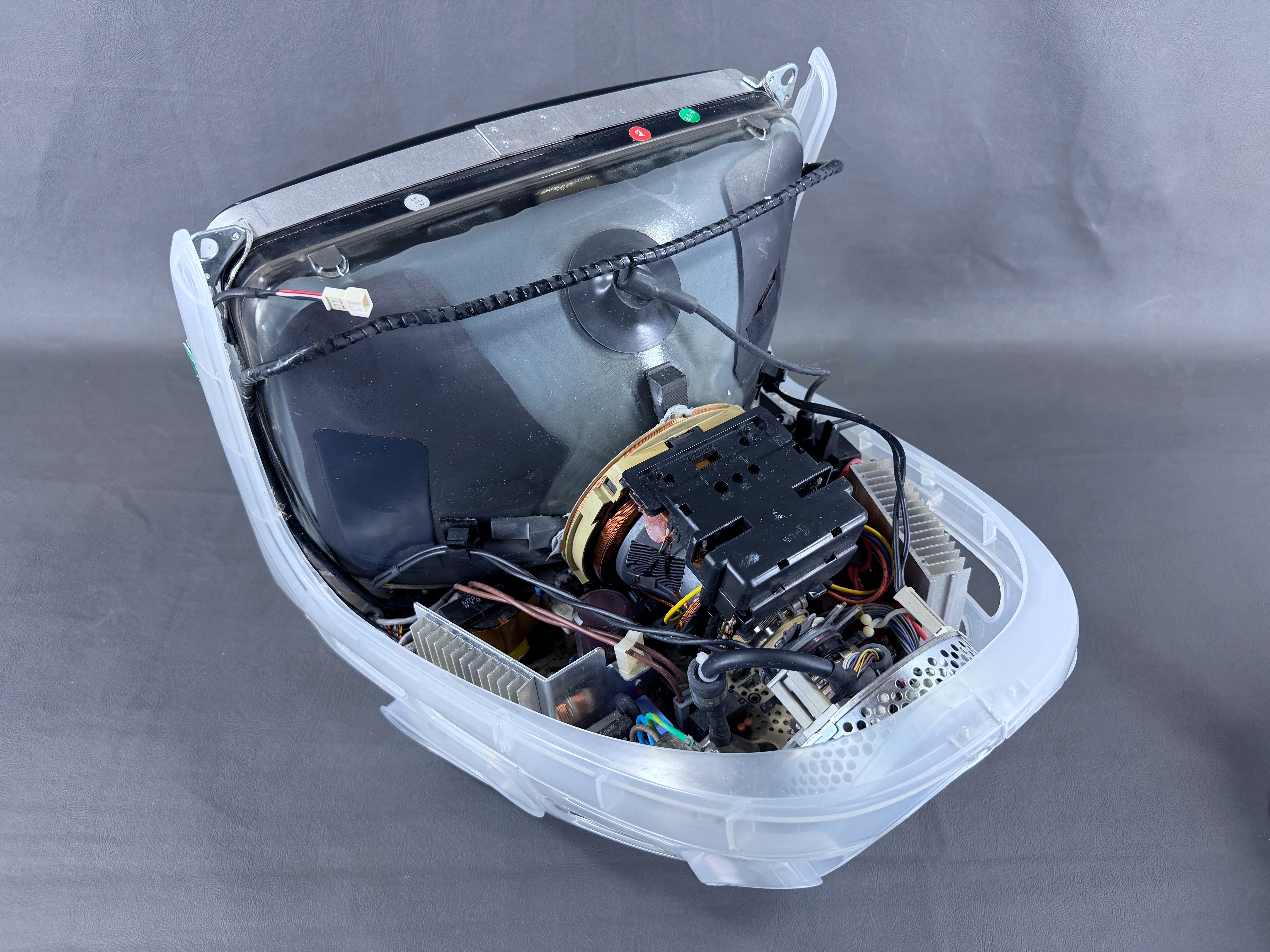

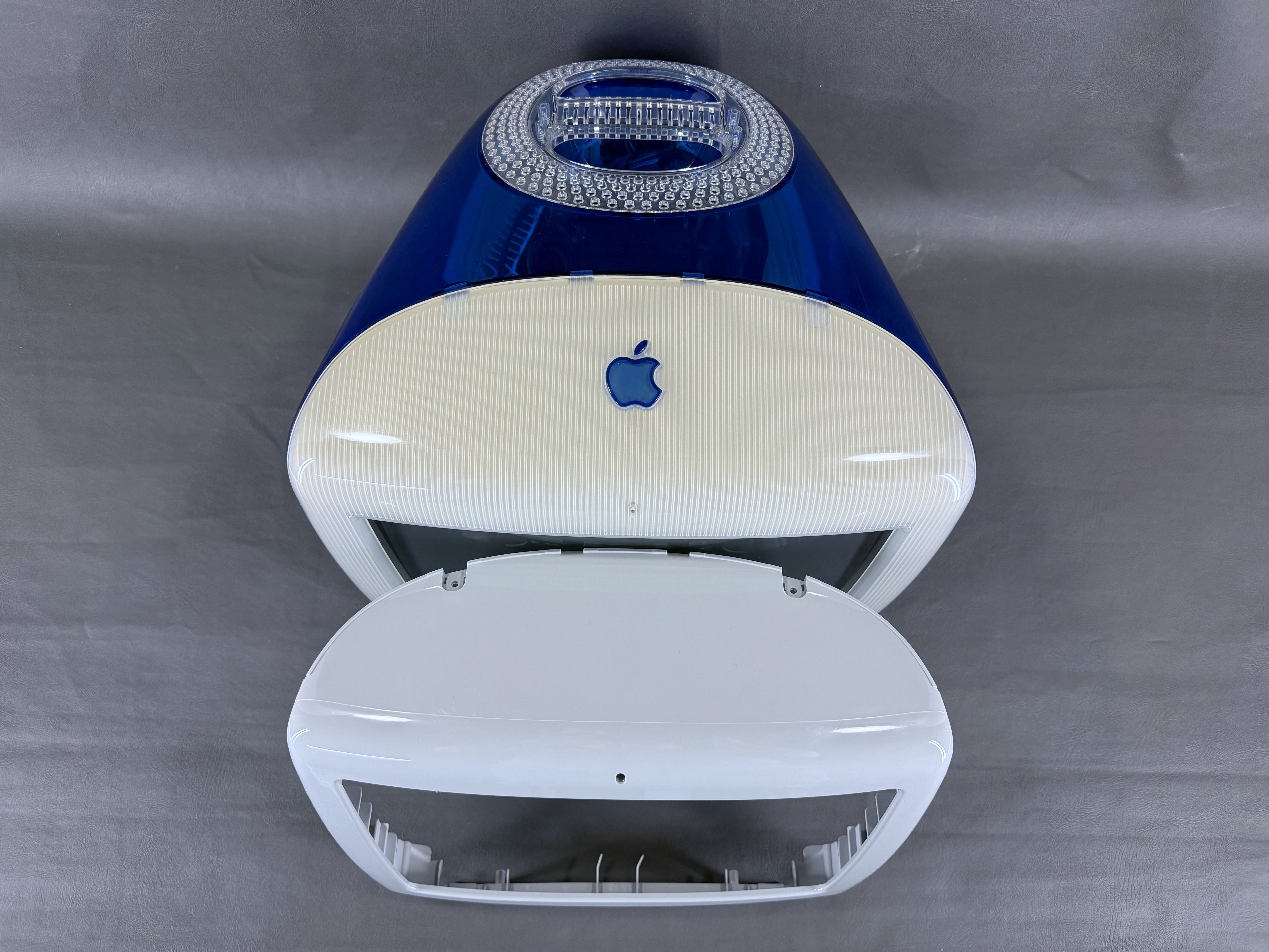

Disassembled iMac, midway through the process - thankfully CRT discharging is not necessary.

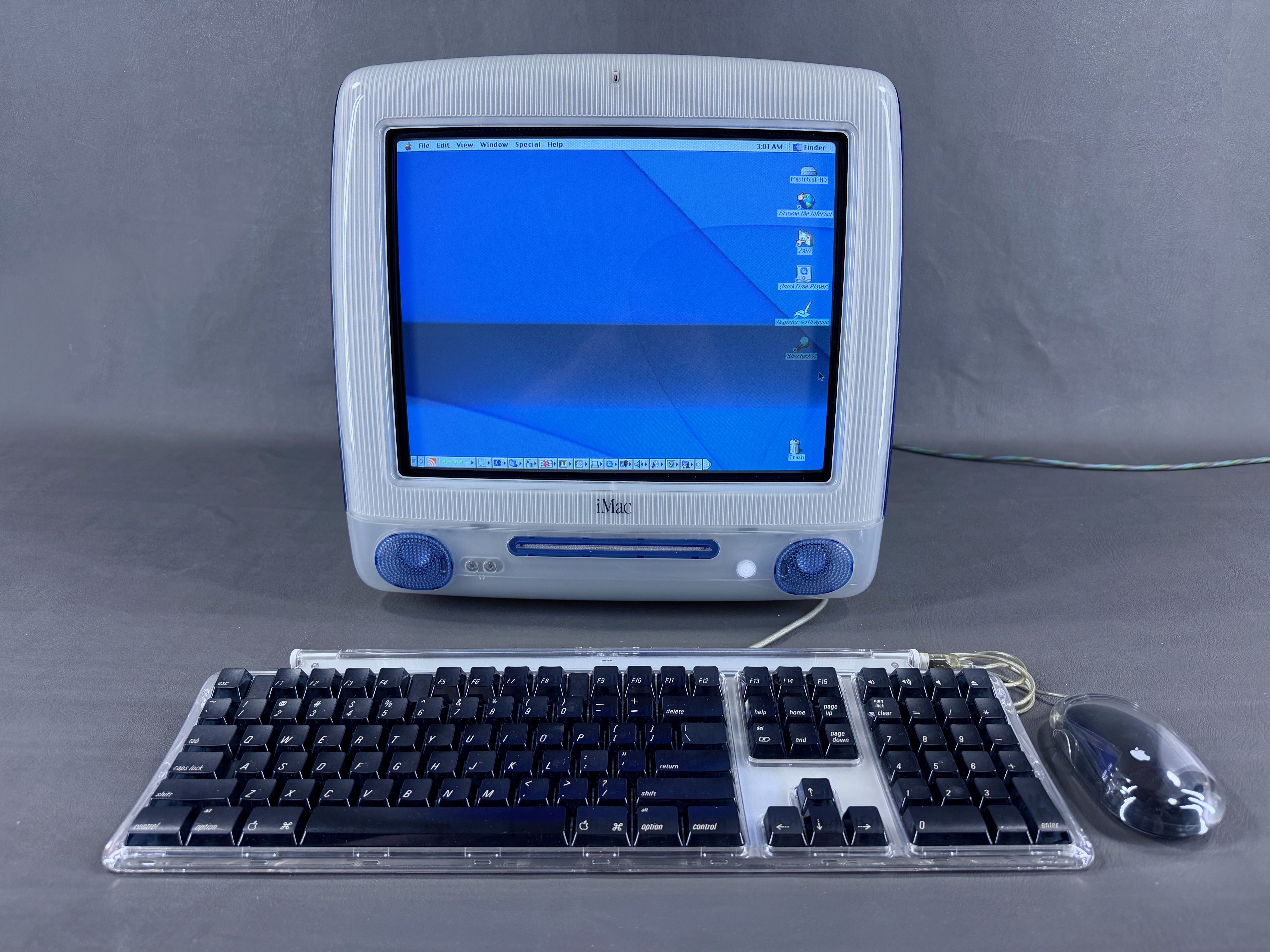

Happy Mac with new bezel installed!
