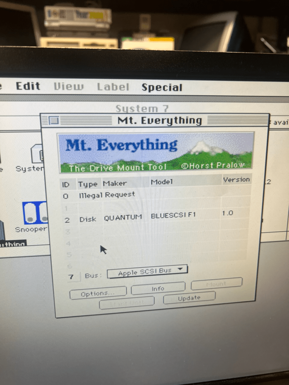

Utilizing that trick I can boot from System 7.1 on my BlueSCSI (System 7.5 will hang on boot). Snooper says SCSI termination on the bus is "OK". But the drive doesn't automatically mount. If I open a program like Mt. Everything, I'll see the device listed as ID 0. Unfortunetly it says "Illegal Request" and won't let me try to mount the disk.

I'll try SCSI Probe, I had the wrong version of it on the disk and it wouldn't work on System 7.1 / 68k machines. Mt. Everything is very similar to SCSI Probe, but I'll try that and SCSI Director 4.

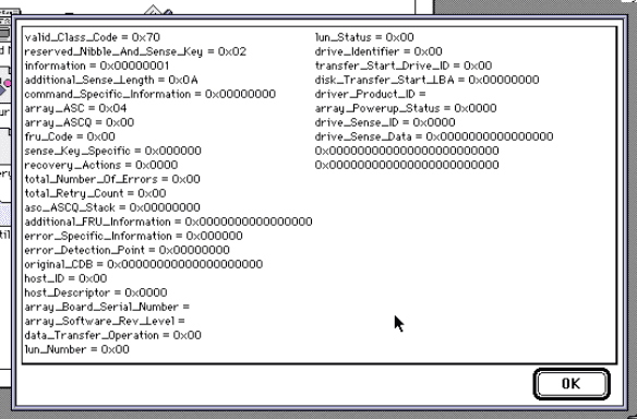

Update:

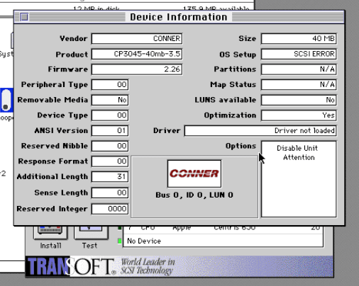

SCSI Probe 3.x and 4.x show the devices in the list, but I can't select them or select mount anything.

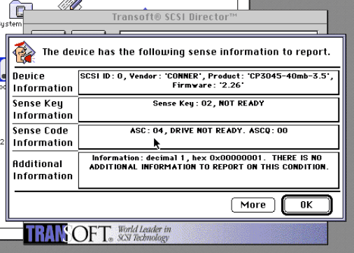

SCSI Directory 4 Pro will hang for a period of time, but it does provide some information. For a moment a dialog suggested the partition table was damaged and asked if I wanted to mount it anyway, I said yes but it just repeated the device information screens.

The drive is NOT READY, so it cannot be mounted.
An illegal request in this notion appears to be the response when the SCSI drive cannot be identified or understand the request. Perhaps the parameter(s) given was unexpected, so it is an illegal request.
It is a SCSI error at the OS level.
Some sectors on the drive may be messed up that the OS can't read it to mount. So, how about reading the blocks to see to delete garbage to get the Mac to reread and mount it?

If you're seeing not ready from the drive, that usually means the drive's self-check failed so it refuses to come online.

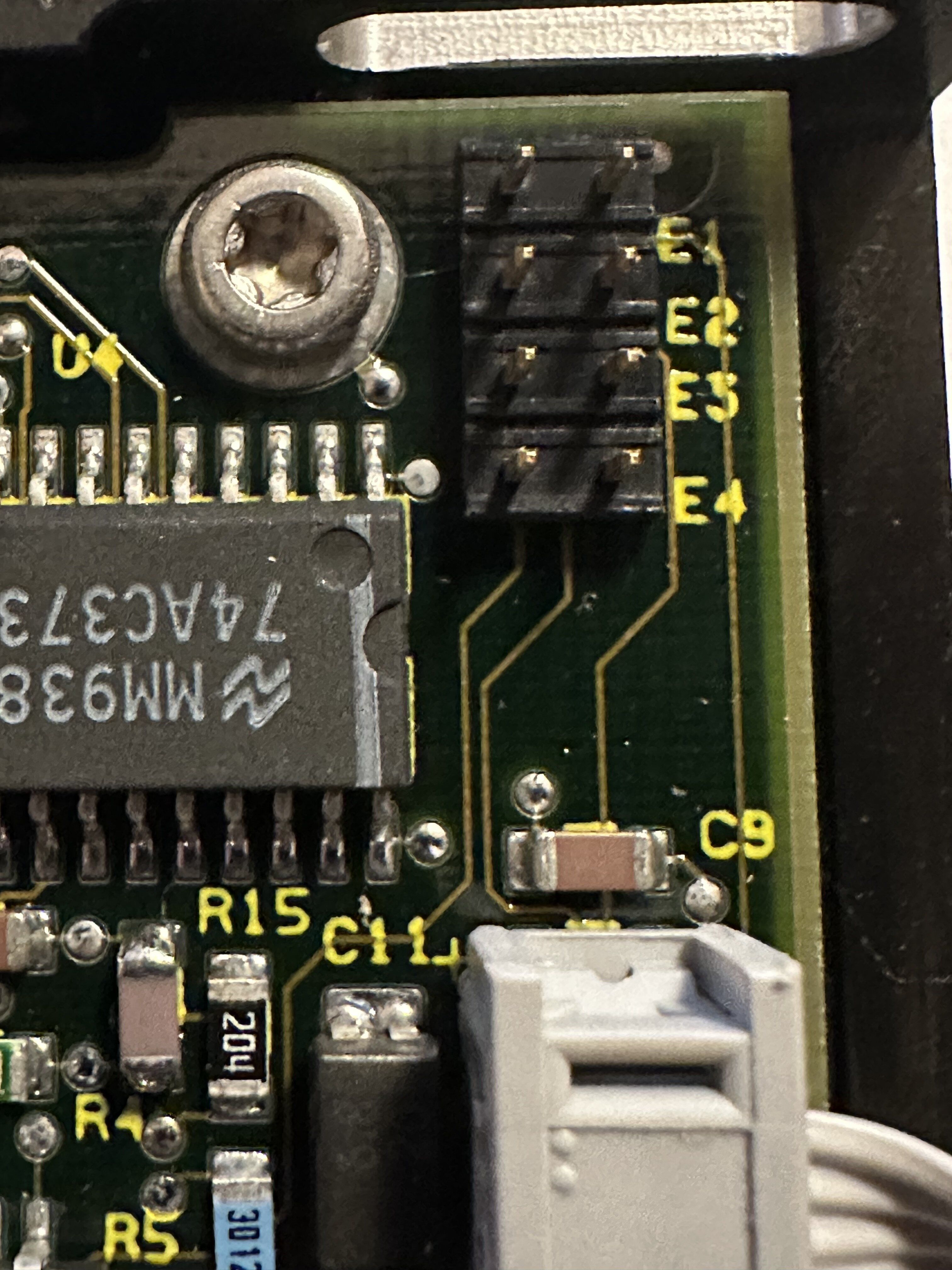

On the bottom of the drive are jumpers E1 through E4. E1-E3 set the SCSI ID, and I believe E4 disables parity. By default no jumpers are installed.
I don't think there's a way to disable termination without desoldering the SMD resistor network.
The other header is supposedly a "serial" header, however I've never checked to see if it provides any useful information.

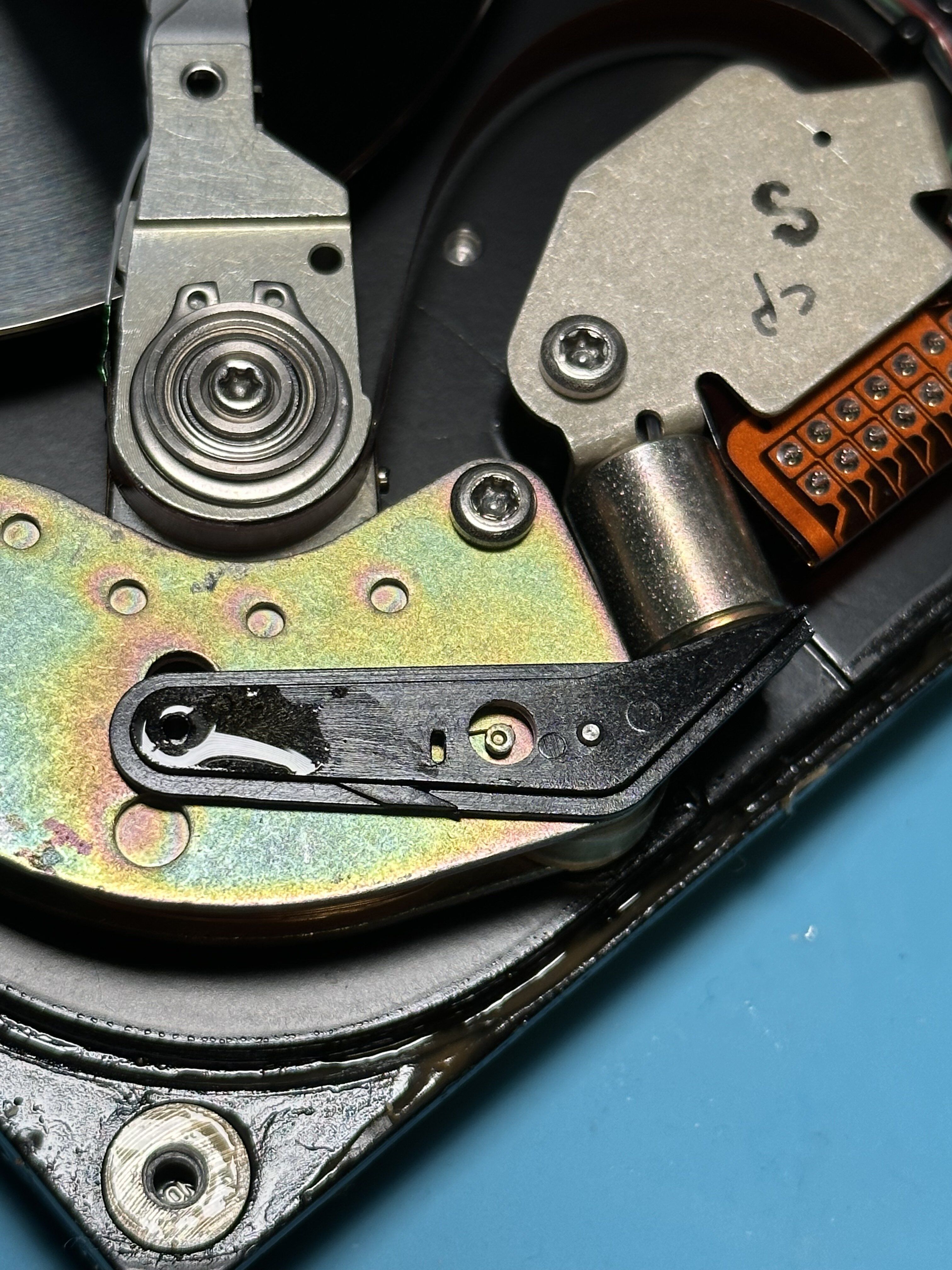

I wouldn't recommend it, but I did open the top lid of two of my drives.
One drive I opened up seemed to be having trouble with the head parking mechanism. I moved it a bit and it came to life, and I was able to dump the drive.
Another one had crazy amounts of some sort of ferrous shavings or dust covering the magnet, though I could never see anywhere that it came from. I tried swapping the platter from that one to another working drive, but I never did get it to read.

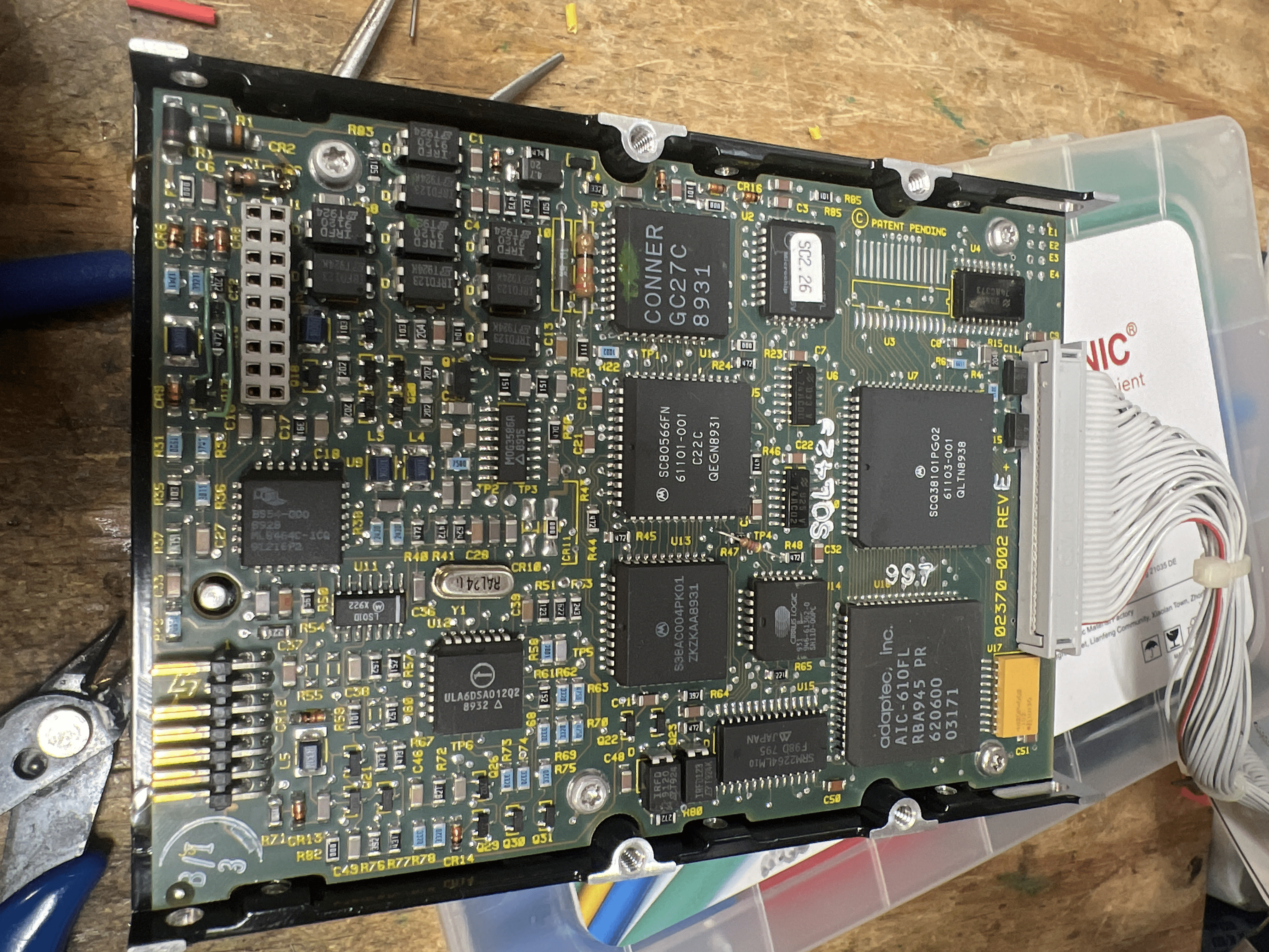

I found my Conner drive from my LC II, it's a Conner CP3040A, the board looks quite similar to the Portable's too, except for the bigger SCSI port and termination blocks.
I swapped over the board and the magnet (as the Portable's was quite worn) to the Portable HD and plugged it in. When the Mac boots I get an error saying the volume "MacintoshHD" couldn't be read due to an error. Some SCSI tools didn't seem to want to mount it either, saying it recovered from a device error.
So I guess that's an improvement? I did try the replacement magnet alone (without the LC HD's drive board) didn't seem to do much.

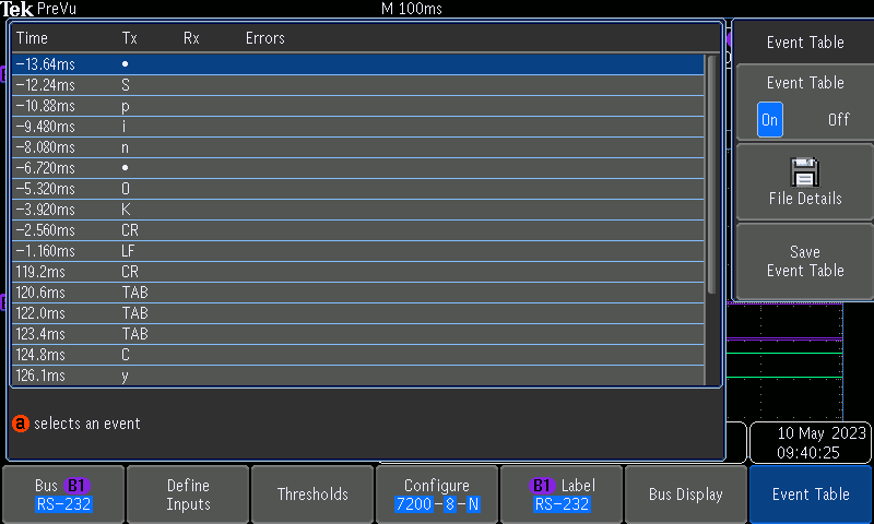

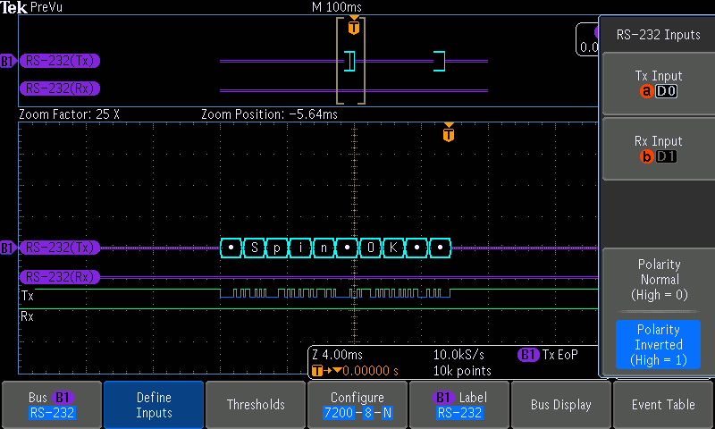

Looks like it was much simpler than I thought. I decided to do some probing with the scope, and looks like it's outputting 5V TTL at 7200 baud:

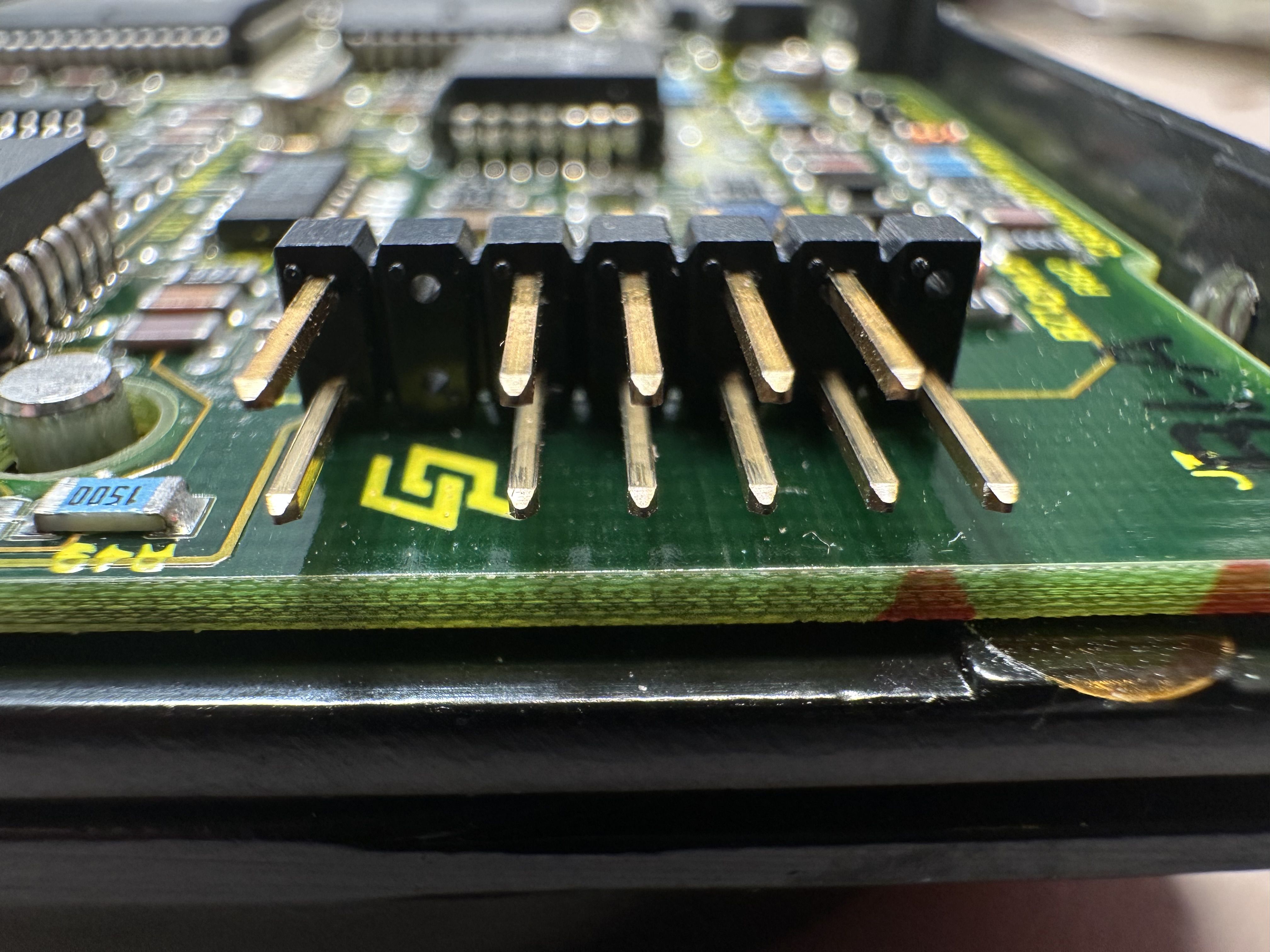

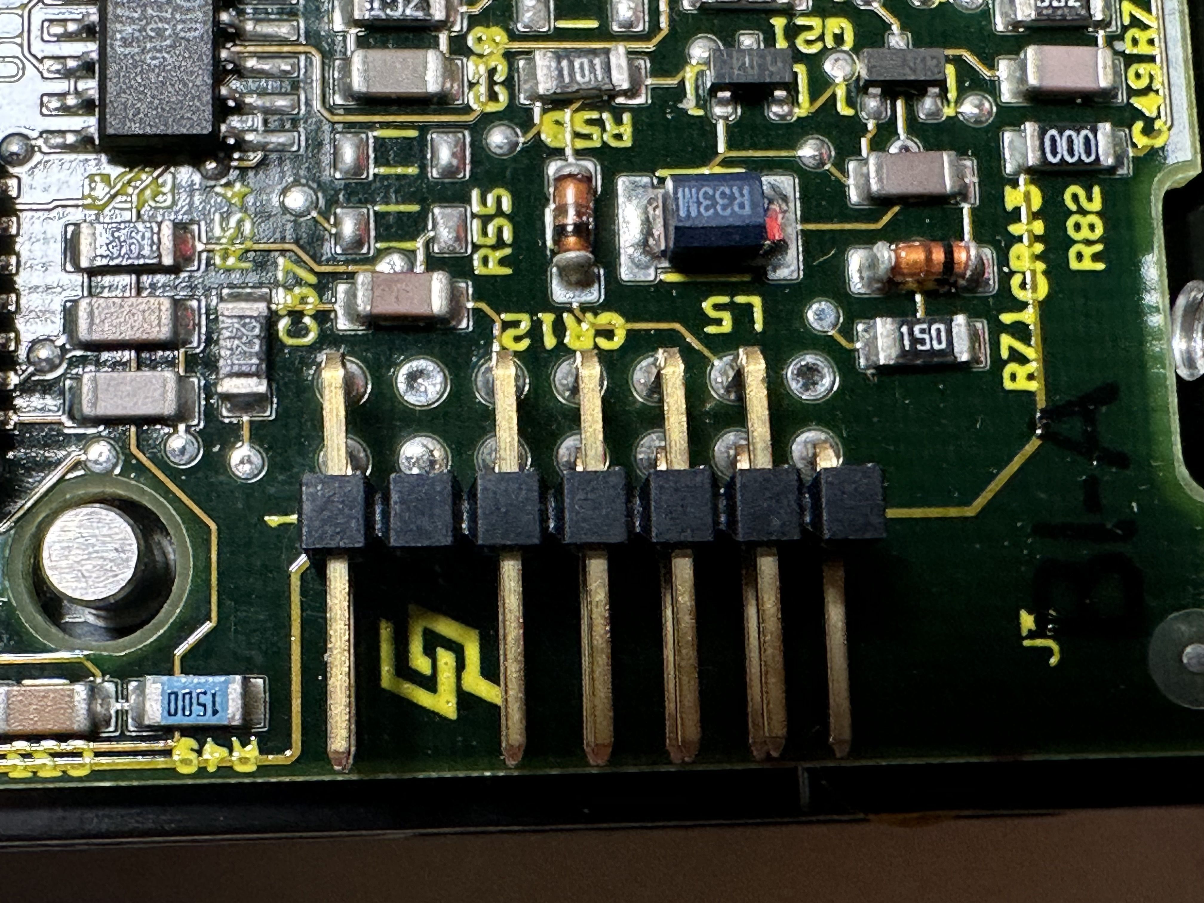

Here's the pinout from what I can see:
[ 2 ] [ X ] [ 6 ] [ 8 ] [ 10 ] [ 12 ] [ XX ]
[ 1 ] [ X ] [ 5 ] [ 7 ] [ 9 ] [ 11 ] [ 13 ]
1 - LED?
2 - LED?
3 - Not present
4 - Not present
5 - Ground
6 - Ground
7 - RX
8 - TX
9 - ?
10 - ?
11 - +5V
12 - ?
13 - ?
14 - Not present
Perhaps at this point this is getting a little off topic, but here's where it starts to get interesting. I apologize in advance.
I decided to hook it up with a USB to TTL interface and see what I got out of it.
Here's what I got at startup:
Code:
 Scaries  - 2.26
Begin test 40
Ref 1F - Xsition 1F - Full spd 086 - Data lock - Spin OK
            Cyl 200
That Cyl value counted up to 200.
And then it just sat there. There was no more output as the computer booted. But it has both TX and RX pins, so I started pushing buttons...
