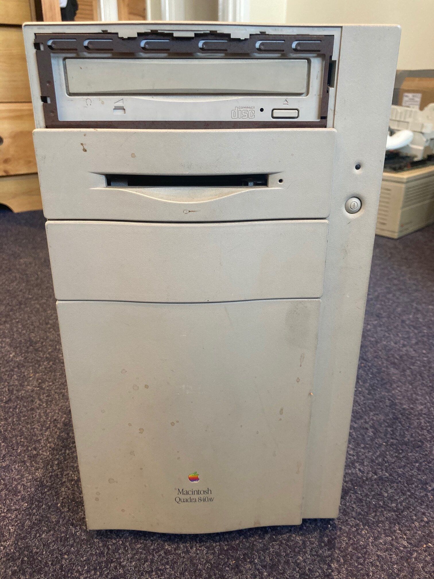

Quite a few years ago I got my hands on a Quadra 840av for a very reasonable price (£20)
I wasn't really looking for a Q840 and tried to avoid buying it, but no one else at the sale I got it from seemed interested in it and given it's very reasonable price I couldn't resist it in the end!
That was way back in 2014, since then I have done exactly noting to it except powering it up twice to see if it chimed (Ok that's not fully true, I removed the battery and at some point stole the HDD from it and didn't replace the mounting sled....)
It's perhaps a good thing I am not a collector that looks for pristine examples because this is far from pristine, It's missing the CD bezel, the plastics are pretty yellowed and that metal part of the case has it;s fair share of dents and scrapes

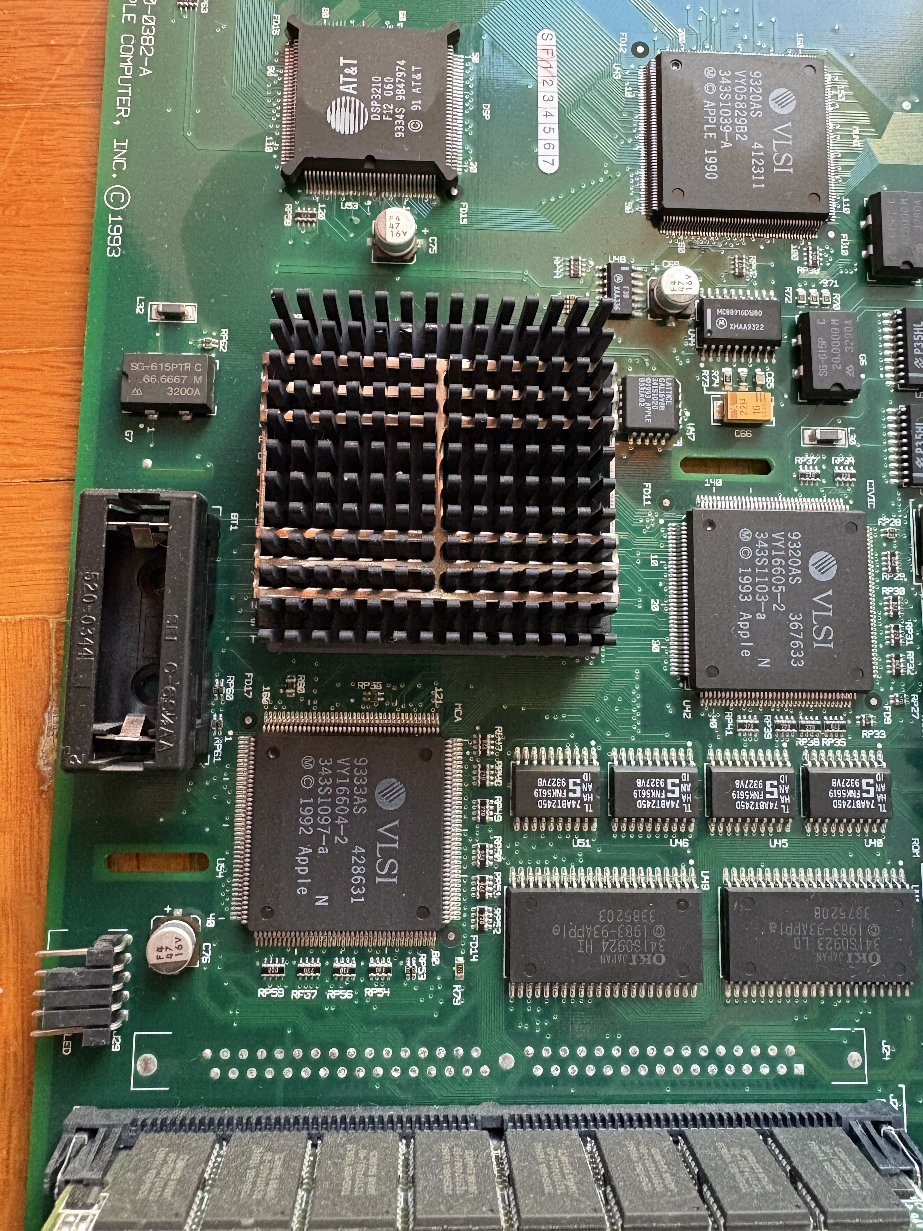

Anyway, the case can wait for another day (year?) It's time to have a look at the logicboard, I seemed to remember that although it chimed back in 2014 the board did not look in great shape and given it hadn't been recapped in the intervening years I was expecting the worse
Yeah not great.... The camera is actually doing the board a favor here, it looks much worse in real life (the top row of pins on the AT&T chip in the first picture and ALL the pins on the ITT chip in the third are green even though they don't really look it in the pictures)
It's going to be a long process to get this board cleaned up as lots of chips need lifting for cleaning underneath and there is lots of corrosion to deal with
However there is good news! as bad as the board looks I have lifted several chips off it now for cleaning and am yet to find any trace breaks :)
Hopefully a good clean and recap will be all the board needs, I don't want it to end up like @Mac84's Q840 board :)

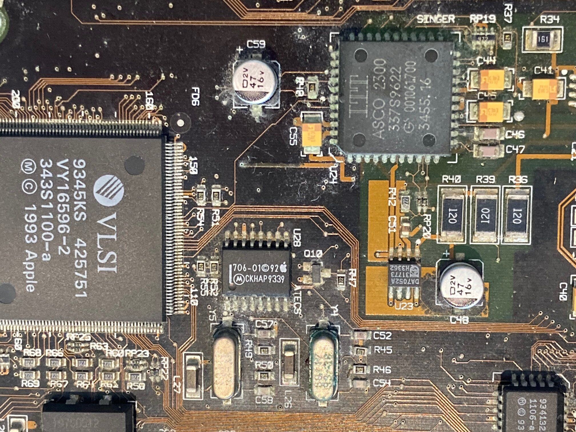

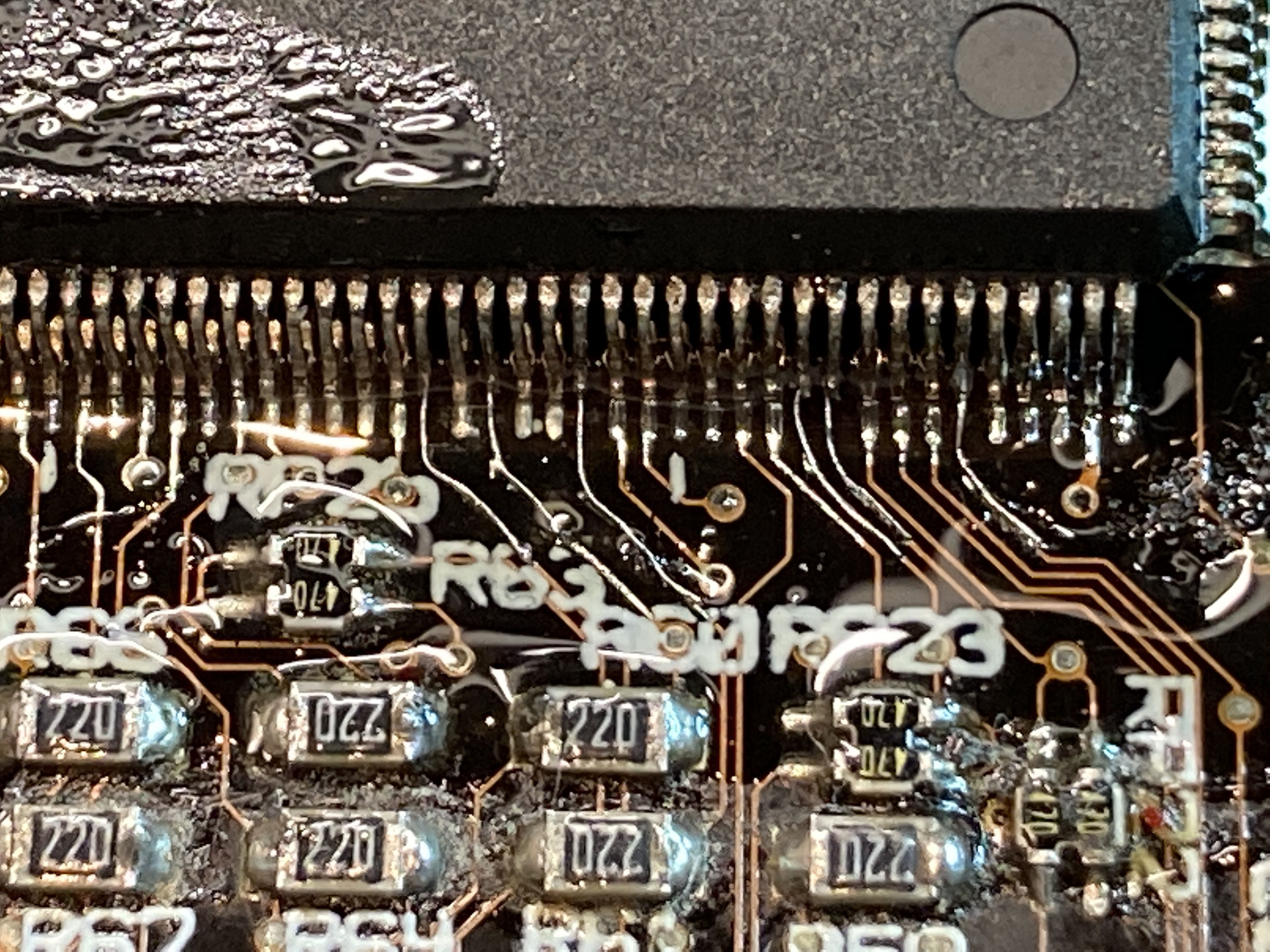

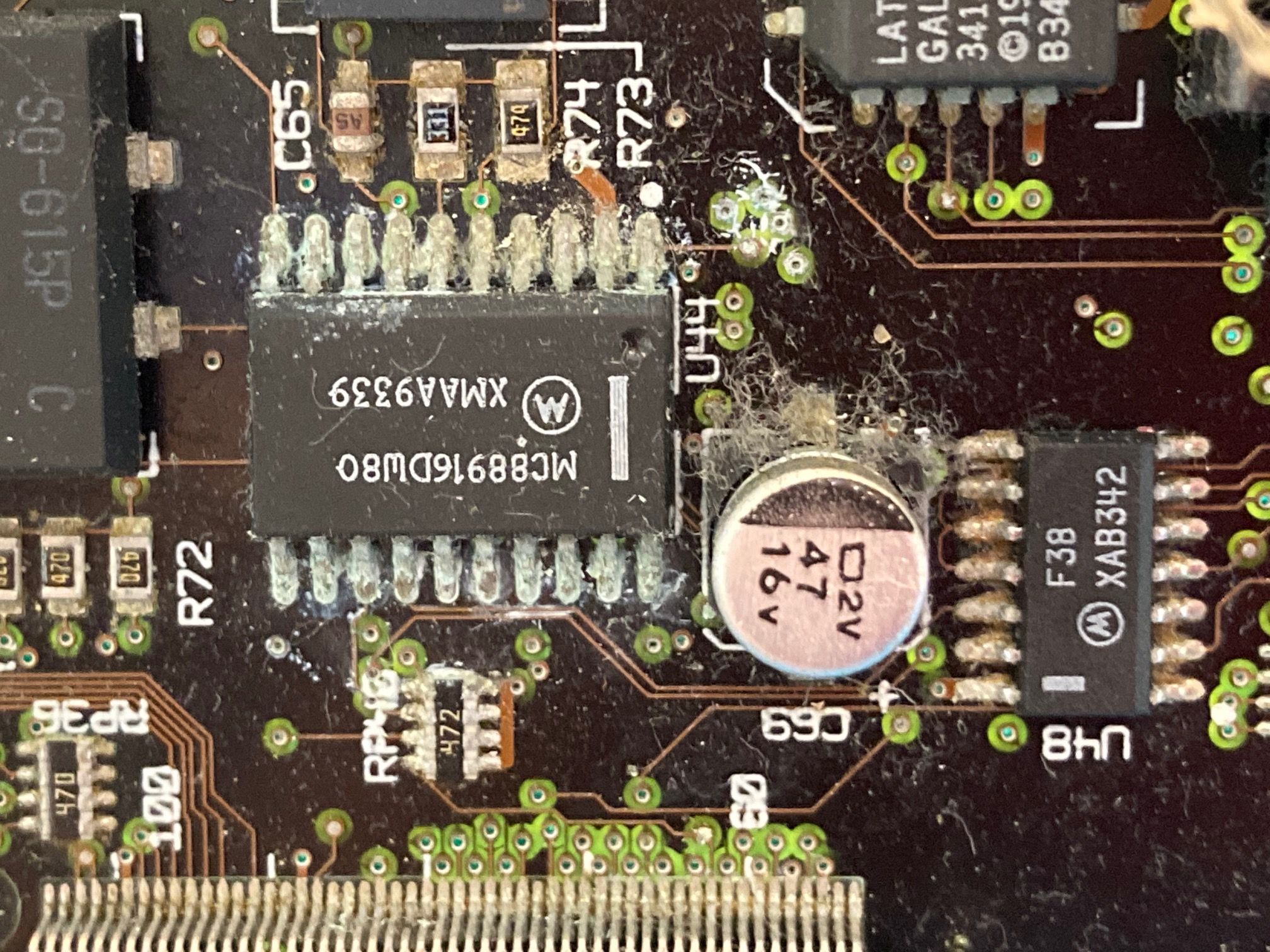

View attachment 4815View attachment 4816View attachment 4817

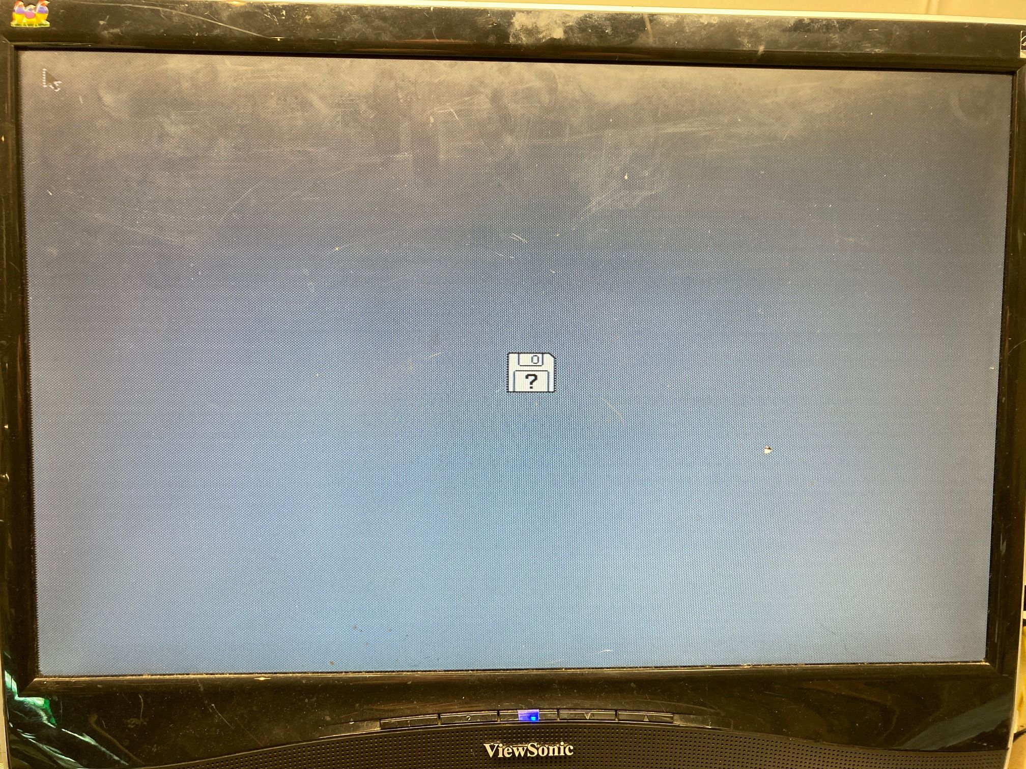

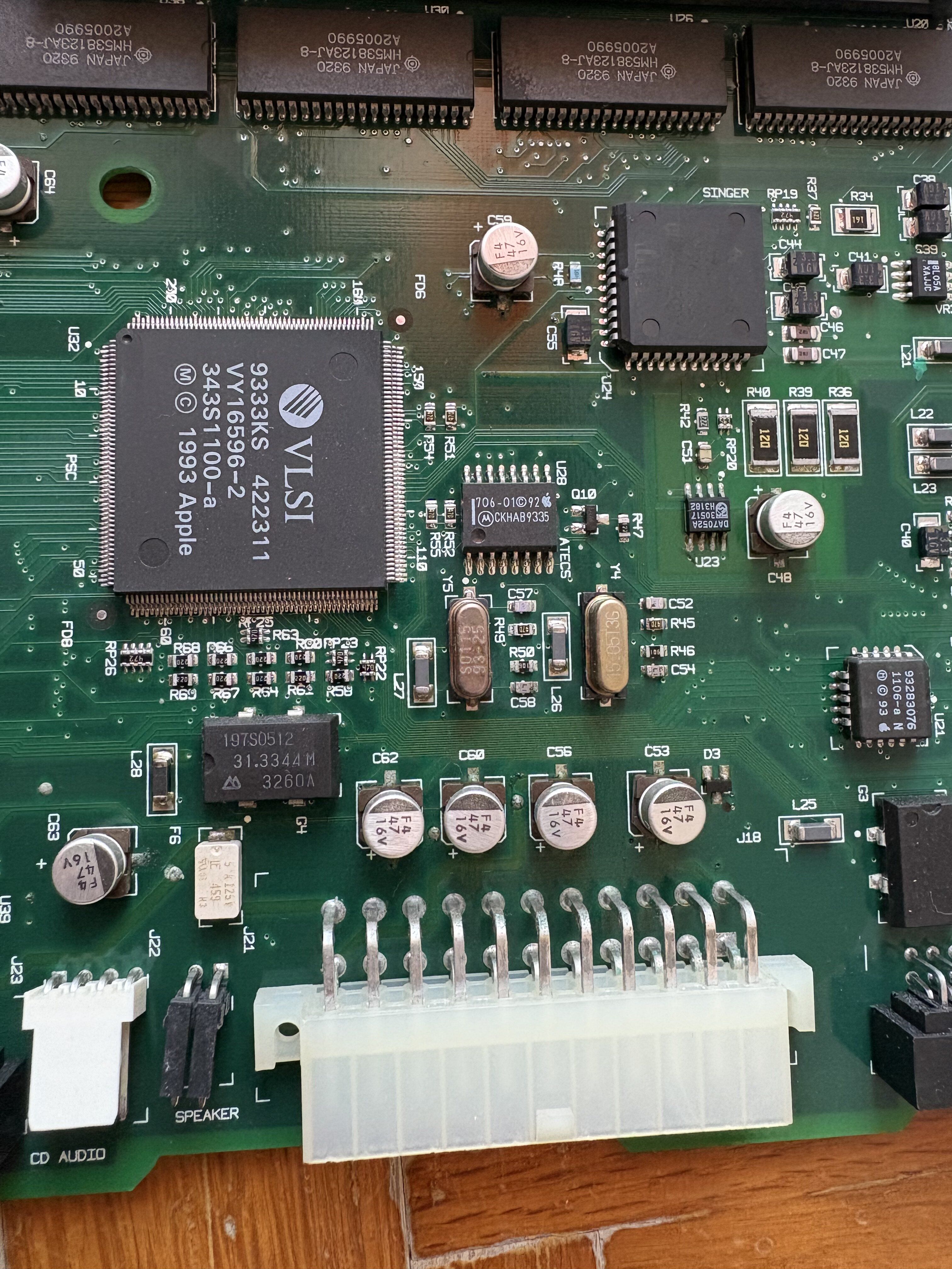

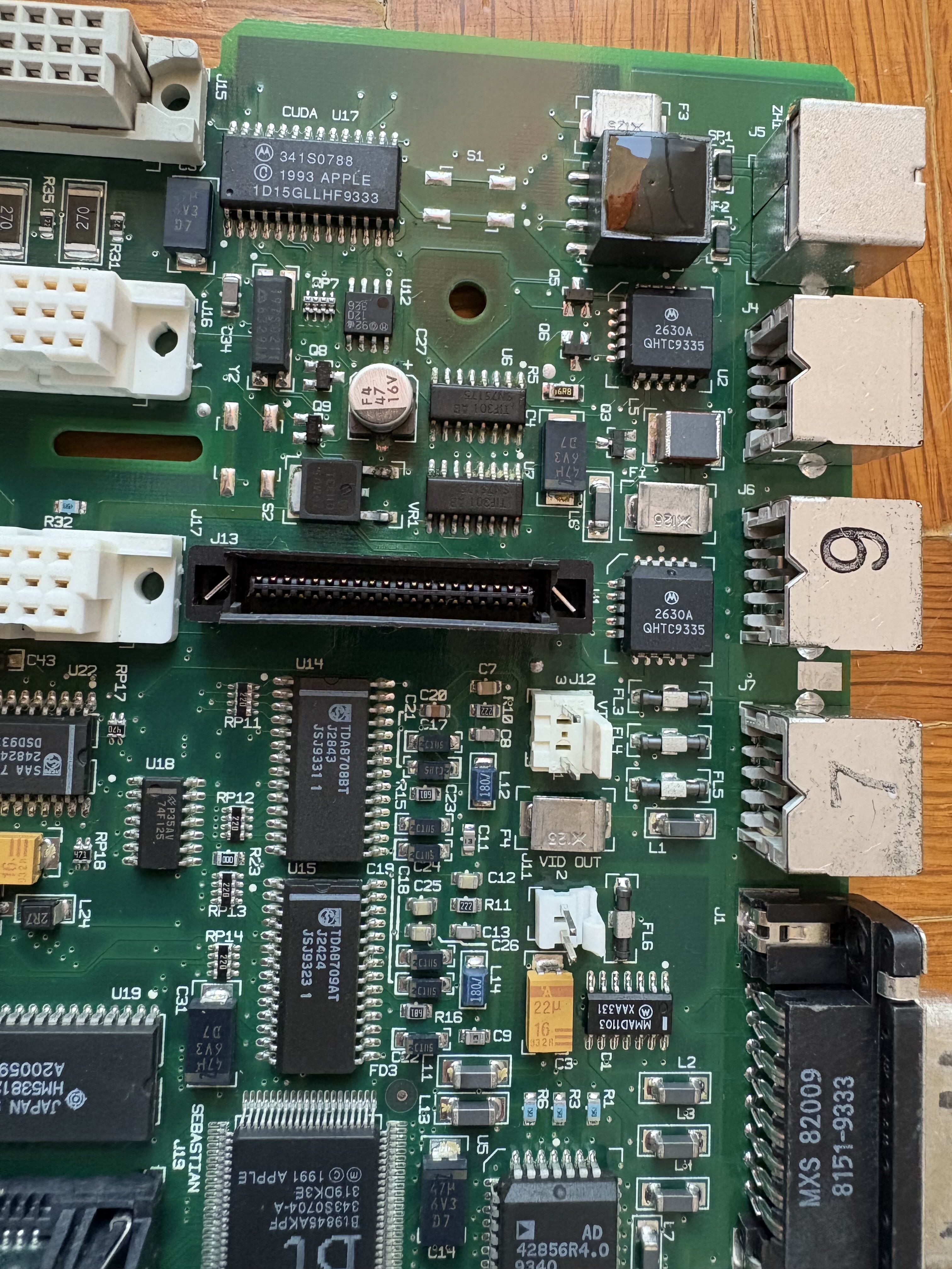

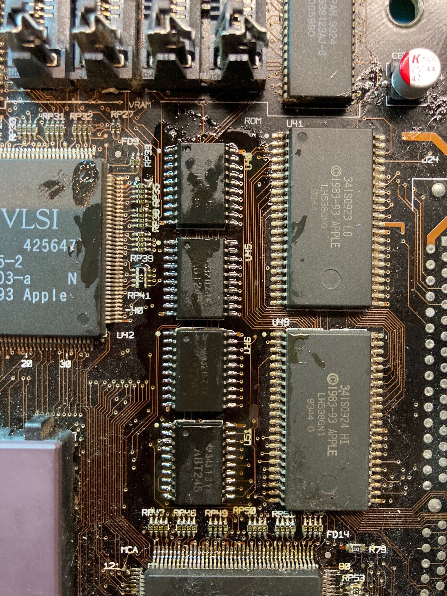

Time to return to this after another 18 months, With progress this time!
It lives :)
How did we get here?
Well first off I ended up killing the PSC when removing it for cleaning. This was entirely my fault for using too much heat as I couldn't be bothered to get the IR preheater out or the low melt solder and just tried to use hot air only. One loud pop later and 5V and GND where shorted together.
At this point I thought the board was done for, the PSC is a custom chip that is only used on the Q840 and Q660 so is not exactly a easy part to track down but I asked around and @RetroTheory had a spare Q840 donor board which he was willing to send my way :)
I then went down a bit of a rabbit hole, when I got the donor board it actually looked in better condition than my original so I decided to use my original as a donor and repair that board but whatever I tried I could not get this board to do anything, it would power on but not chime or do anything else. The closer I looked at the board the more scratches I found on it, I found and fixed a few trace breaks but never managed to get it to boot, I strongly suspect there is a scratch through a trace somewhere preventing it from booting but could never find it
After 18 months of prodding and probing the board I decided last night to swap the PSC and DSP (Which was missing from the board RetroTheory sent me) back on to my original board as although it is not on great condition I knew it at least chimed back in 2014, after swapping these the board started powering on but like the other board did noting else. A couple of hours of prodding and probing revealed nothing untoward except the pins of the ABT245's under the ROMs looking a little green, I didn't think they looked bad enough to be a issue but since I had my RCT on the desk from working on another project I figured it was worth quickly removing them and verifying they where all good
3 of the 4 failed.
I pulled 3 ABT245's off the donor board, verified they worked with the RCT and soldered them on. The board then booted on the first try :)
The root cause of all the original issues where these guys:
(shown after replacement as I honstly didn't think they where bad so didn't take a picture beforehand)
And this is why I originally tried to repair the other board, my original board is one of those ones that pads start falling off as soon as you apply any heat to the board
Soldering wires to the legs of those chips is not fun.
Next step will be to run this guy through the ultrasonic after which I can finally thing about putting it back together. Hopefully after 10 years I might actually be able to play around with it :)
And thanks again to RetroTheory for sending me the donor board, without that it would have been impossible to repair this board :)
It lives :)
3 of the 4 failed.

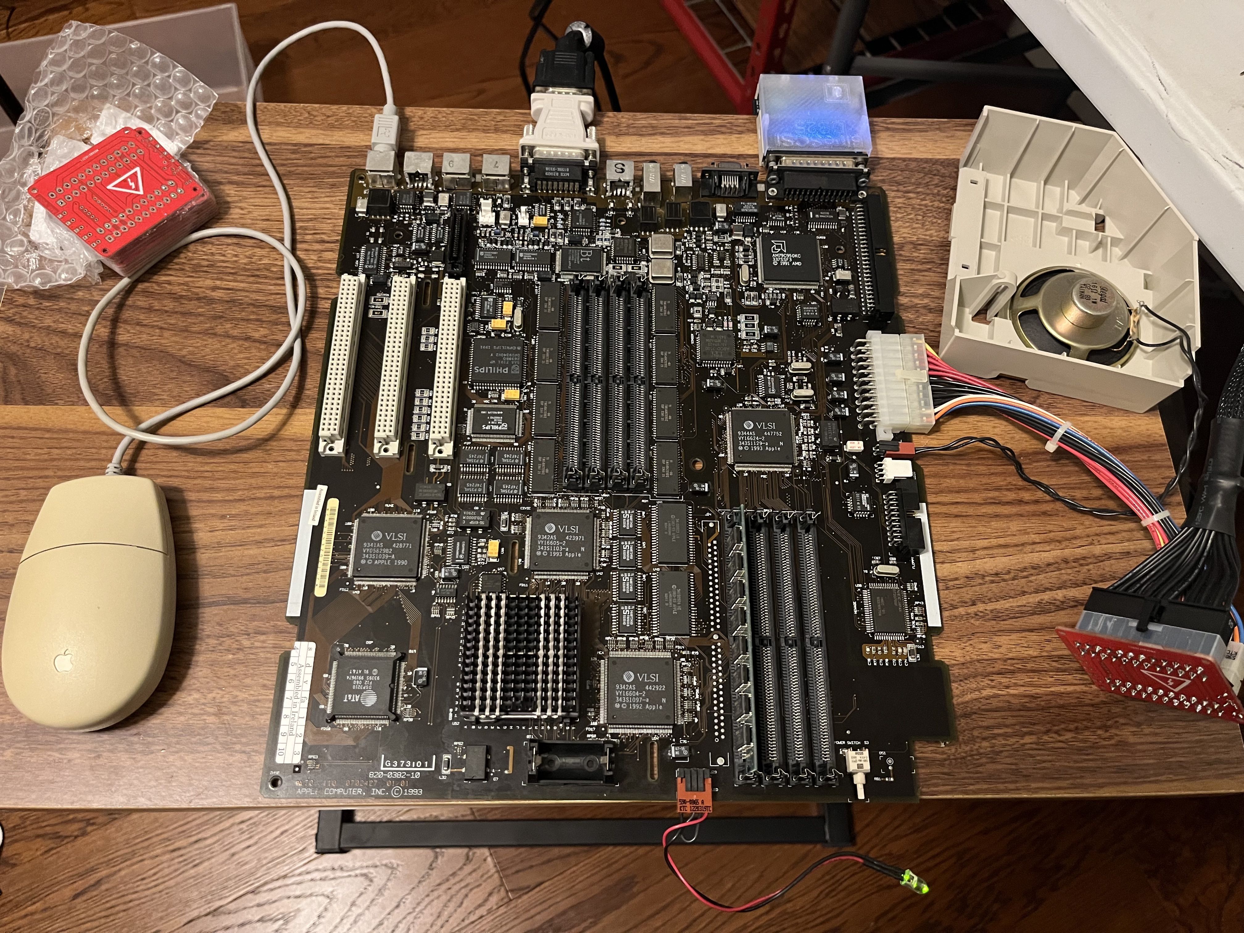

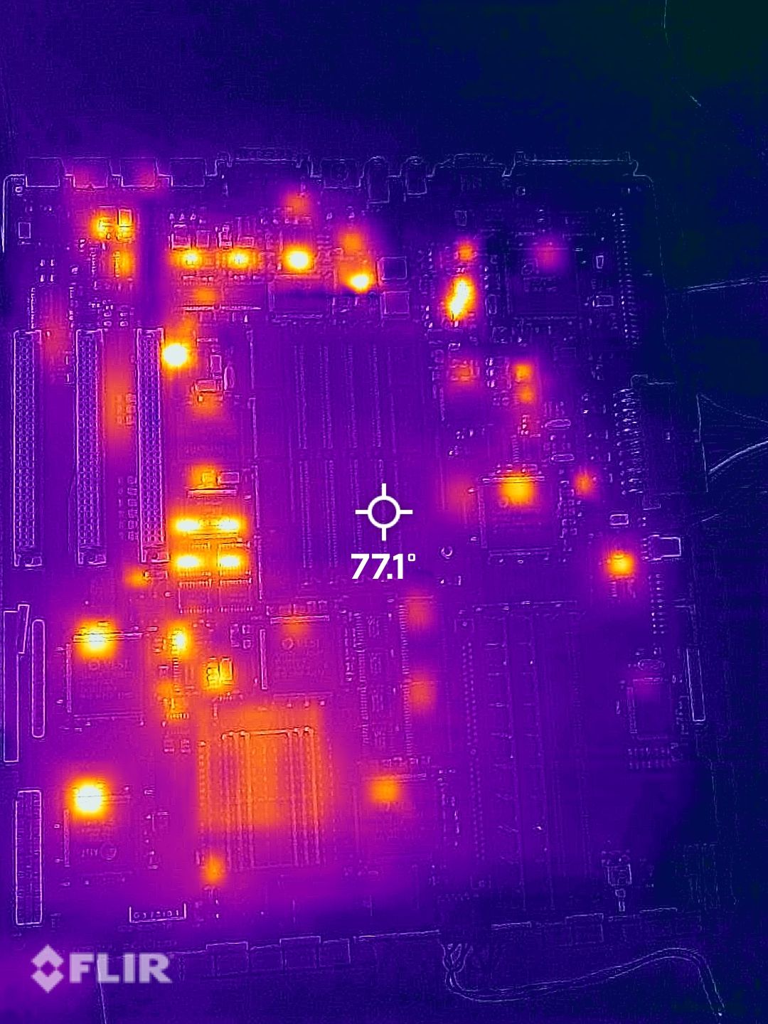

Max I need to look at these chips to see if this is the cause of an inconsistent boot, I am very confortable with soldering and have an omniscospe for the small stuff lol but at the end of the day I am an amateur electronics tinkerer but very willing to learn. My question is if I desolder these chips how to check them with the RTC device you mentioned. not a step by step but a helpful link to get going :).
Current setup for mine is logic board is flat on my bench, I am using an ATX power supply with a MACATX adapter I found online and ordered the PCBs for. No simms or vram. the board will only chime if I put pressure by bending the corner upwards around were the memory simm slots. I have visually verified cold solder joints on CPU, RAM slots and power connector basicly all the holethrough joints an reflowed. I also put pressure on top of all the VLSI chips and others in that area but do not believe it is a cold solder joint on the small legs of any IC since I've looked with microscope. I do hear a cracking noise when I bend it slightly. Maybe its one of these chips? worth it to look into, I am attaching also a thermal image I took to see it would help but it looks very similar to another working 840av board I have.
Any suggestions are welcome, and BTW if I keep the corner bent a little, I can boot with DB25 Bluescussi and mac runs fine.

As it turned out it was a leg of the ROM chip U41 that had a cold solder joint, I had tested continuity on those legs but just a bit of pressure was enough to lift the pad and give inconsistant chimes, I had already caught several others on the VLSI chips ( huge pain to reflow lol) and on the underside of the board so not surprised at all and if it wasnt for the omniscope I would have missed them entirely. There was alot of rot but luckily no broken traces and I have tested a good chunk of the board point to point using bomarc schematics. So glad its over, now I need to figure out how to do hardware tests inside the operating system and see if the MAC does operate fully.

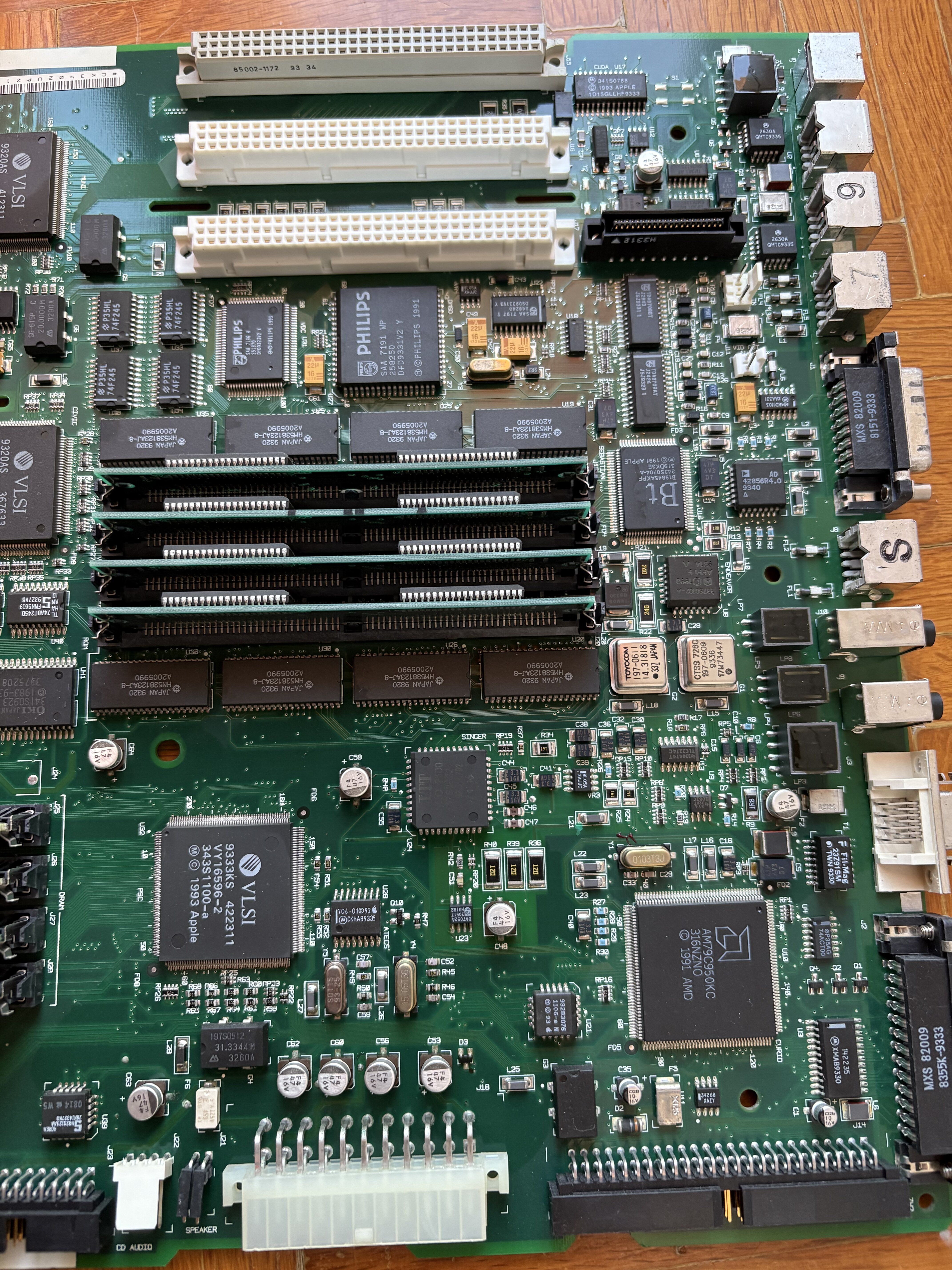

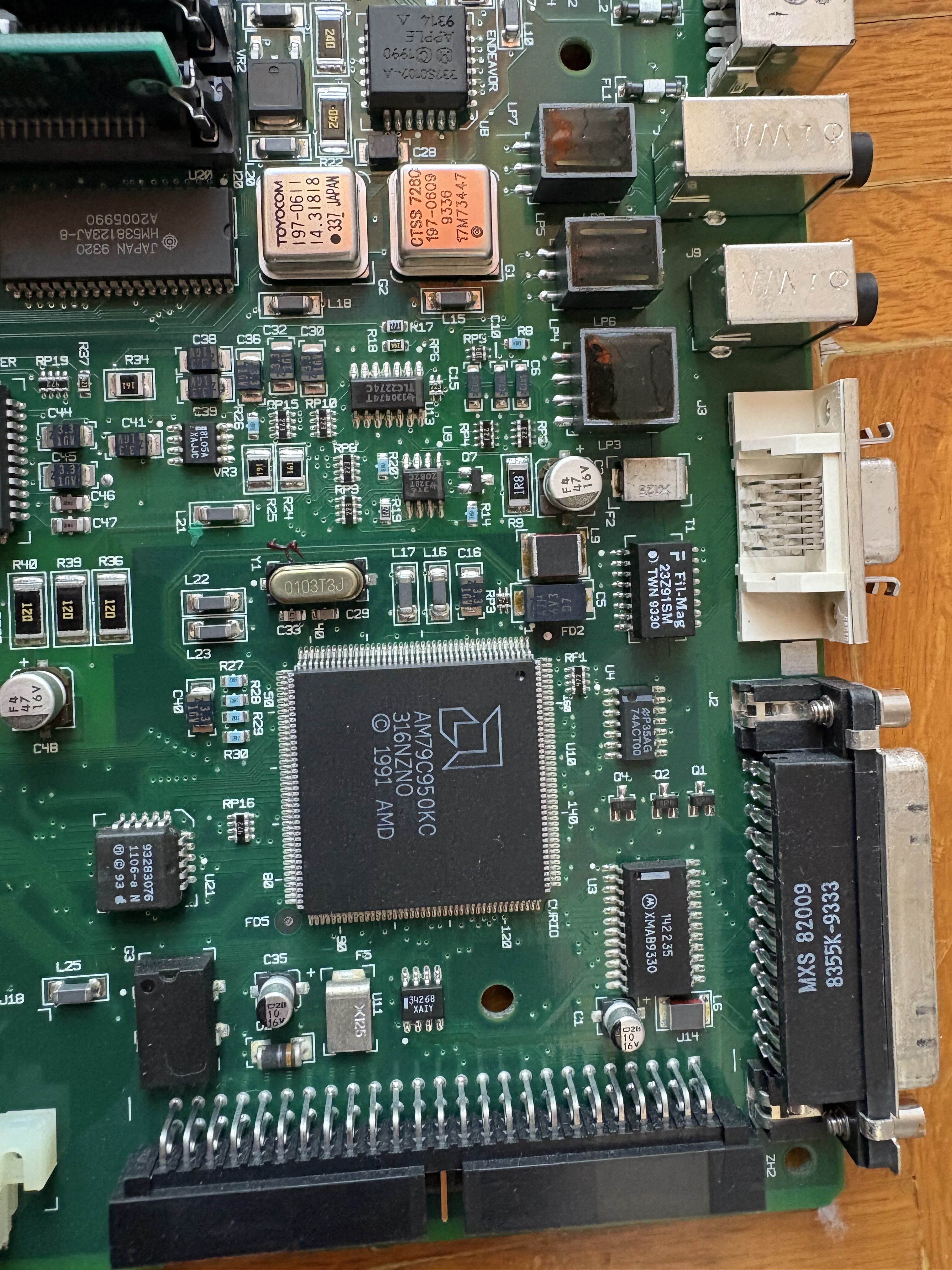

I fixed my 840AV. After cleaning up and recapping it was powering on but not chiming. I found a single broken trace going to the AT&T DSP, I ran a wire and then it came fully to life. 100% working.

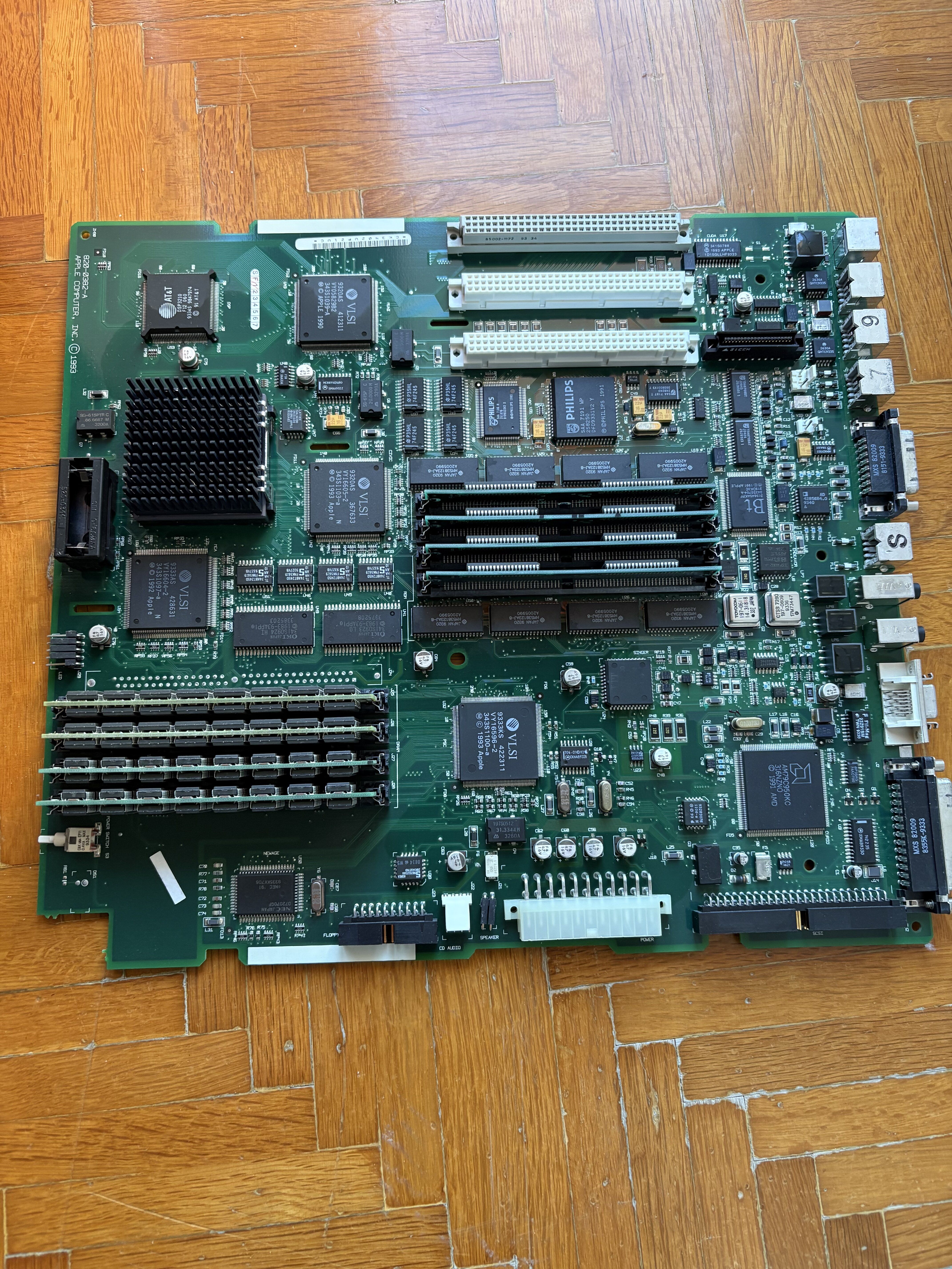

I’ve fixed another 840AV board! It was in such appalling condition, having been ravaged by the worst cap corrosion I’ve ever seen plus some nasty battery leakage on top of that.
It’s taken most of the year, but not 5 years like @Mac84 :D

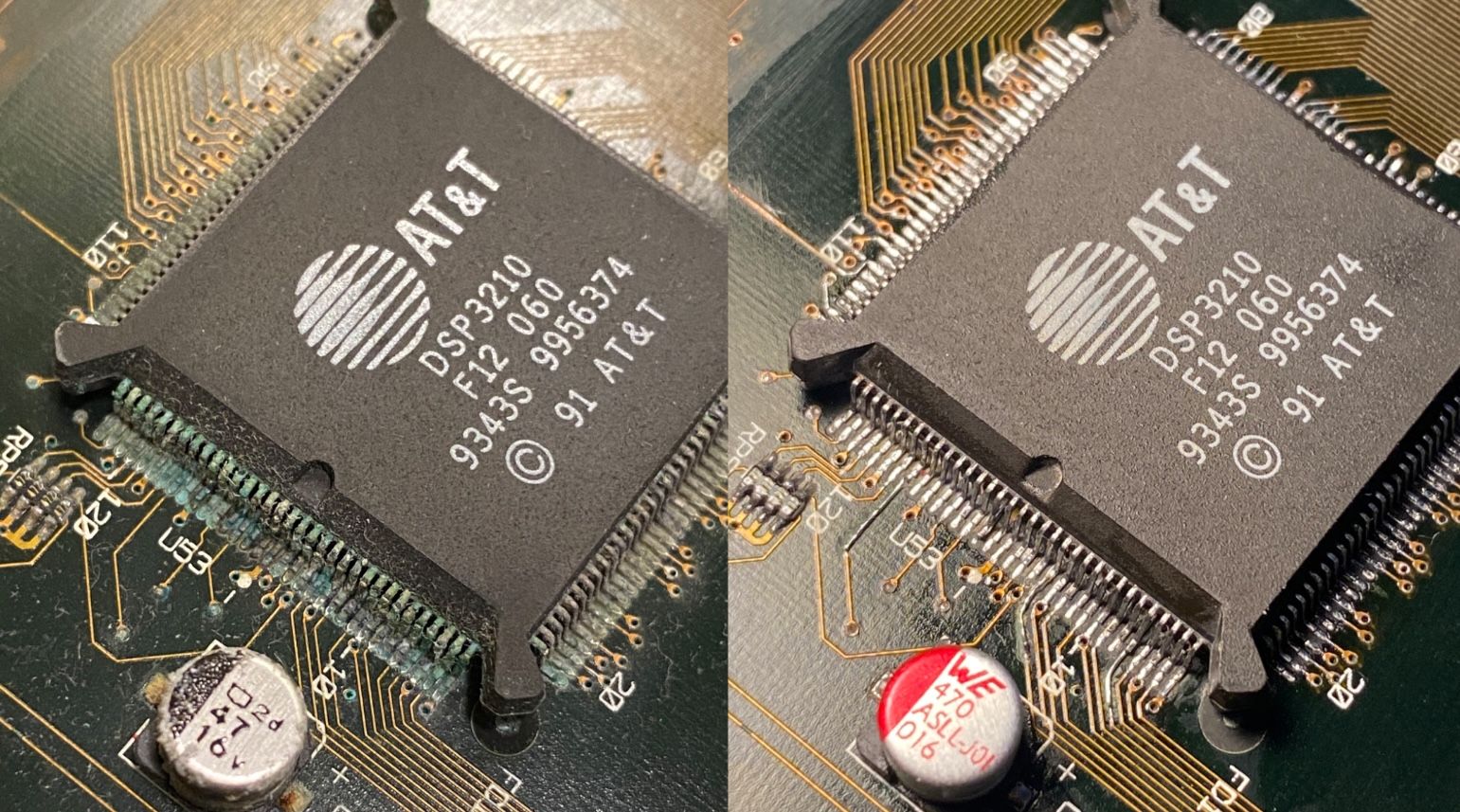

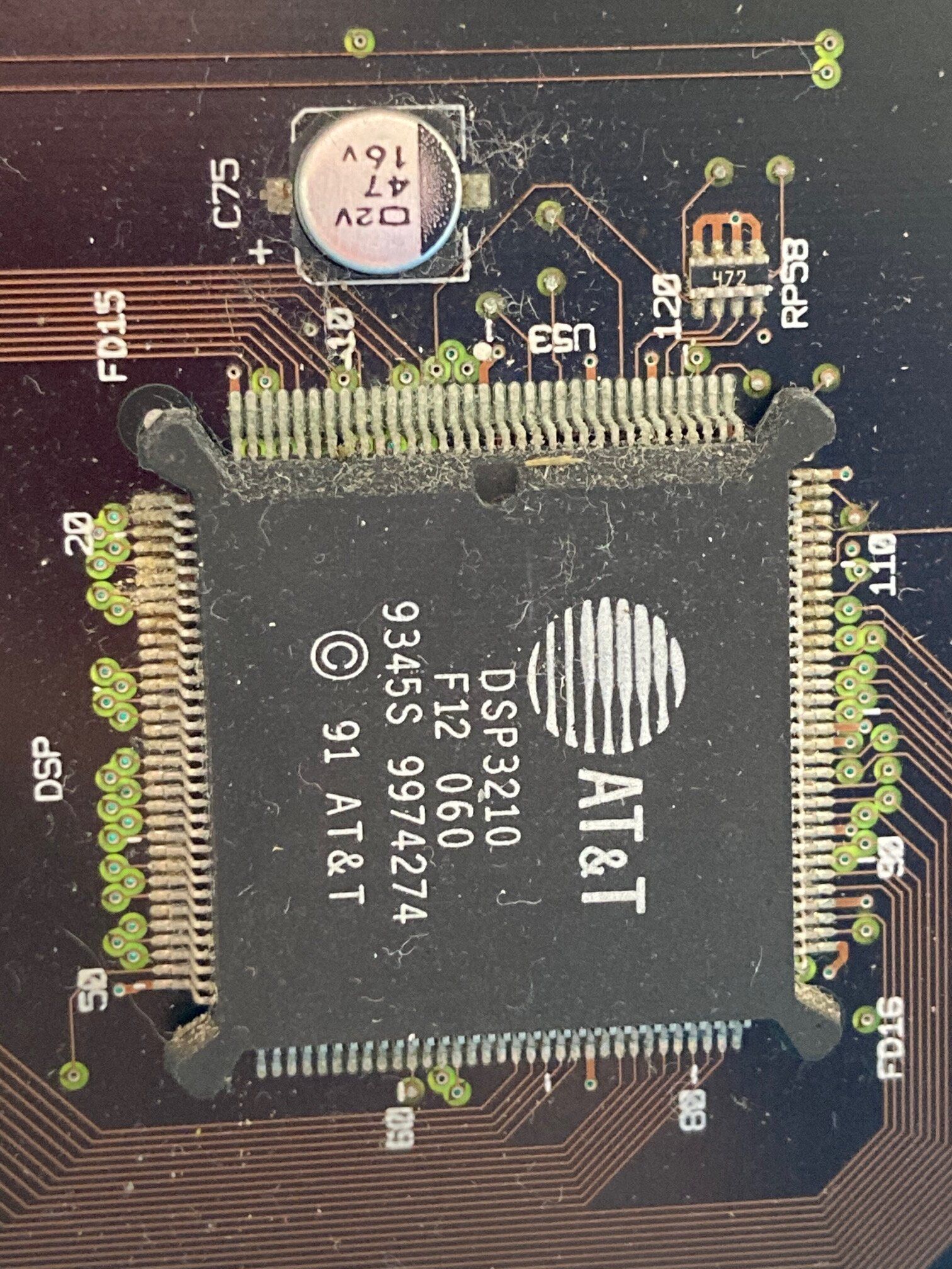

I’d previously recapped it, desoldered/cleaned/replaced the DSP, and fixed several broken traces and components around the battery. It was powering on, but not chiming. The other night, I discovered I’d missed six more broken traces right by the CPU socket, so I addressed those, and now it proudly chimes and boots.
Unfortunately, there is a problem with the built-in video - it puts out a sync signal, but the image stays black. I’ll have to investigate that. For the time being, I’m using a Nubus video card.
Here’s a quick pic of the painstaking work I did to refurbish the DSP:
