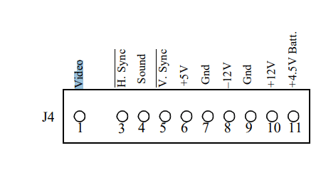

classic2.pdf can instruct on the analog board video subcircuits:

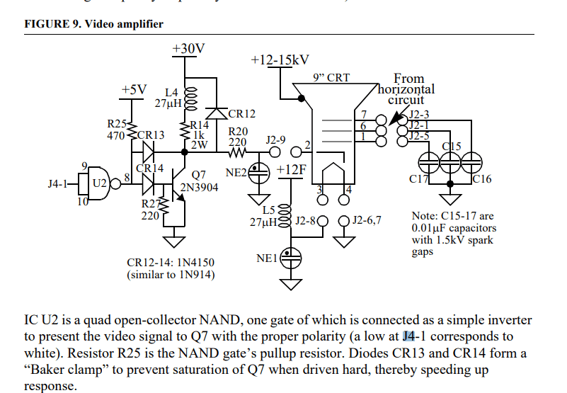

J4 seems to be the place to hook my 4 wires to go external to my RGB2HDMI. Instead of having an exposed external metal piece, I have to add wires either on the backside of the analog board or squish new ones in the plastic connector. Any advice on the best way to proceed?

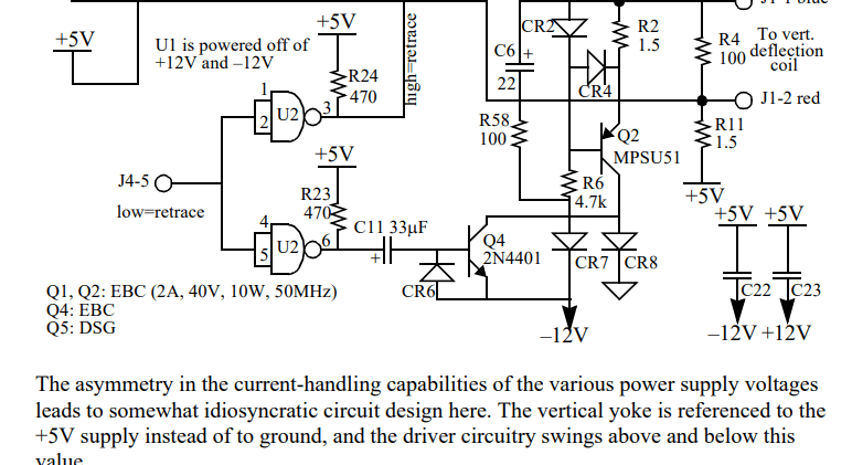

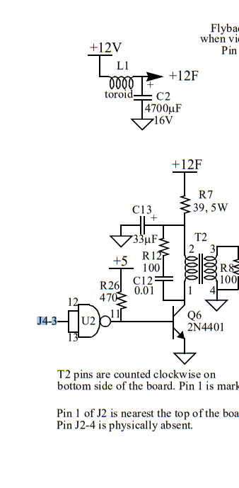

One difference I have with the Classic schematic is what happens to J4-1, J4-3, J4-5 before they're sent to the CRT - they are inverted with nandgates and tied to pullup resistors like so:
Hsync is discussed here:
Vsync:
In light of all this, do I go righ from the J4 connector or do I intercept stuff right at the exit of the gates? I'd really like the assurance of someone more seasoned in TTL video signals so that I can avoid a potential costly mistake.

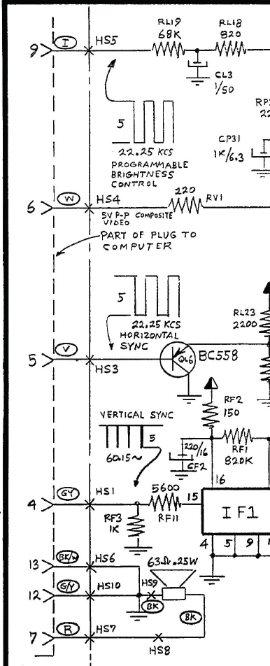

The Mac Classic schematic for its analog board was better documented and way simpler; it even tells what form of signal to expect for each of the 4 needed lines (6 W = video, 5 V = hsync, 4 GY = vsync, 12 G/Y = gnd). The RGB2HDMI can deal with inversion variations just fine (you can set it as H+V+, H-V+, H-V- or H+V-).
