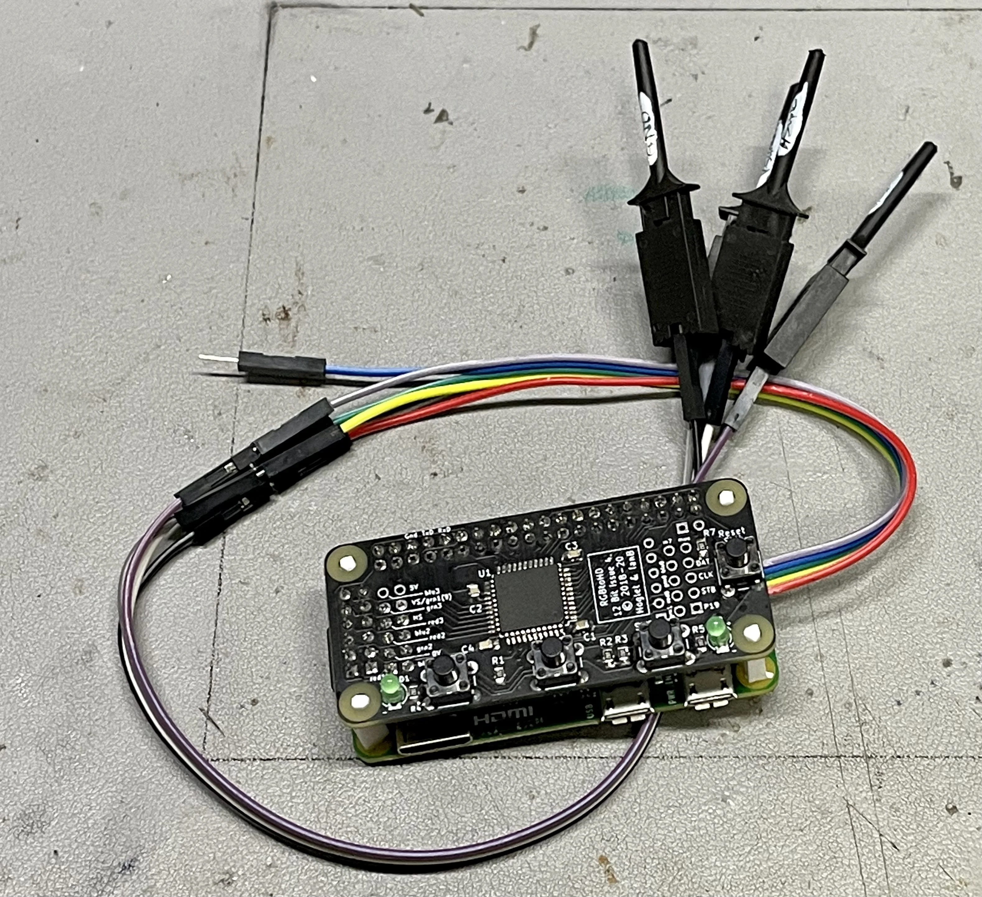

Adrian's preset is for the Macintosh Classic, which seemingly uses a different signal schema. I have a preset which I've created for the Macintosh Plus (it also works on the 128k and 512k). I haven't tested this on the SE or SE/30 yet.
Save the attachment to /Saved_Profiles/6-12_BIT_RGB/ on your RGBtoHDMI SD card. If you don't get a perfectly crisp, perfectly aligned image from HDMI then there may be issues with your wiring or logic board.
This is my setup:
