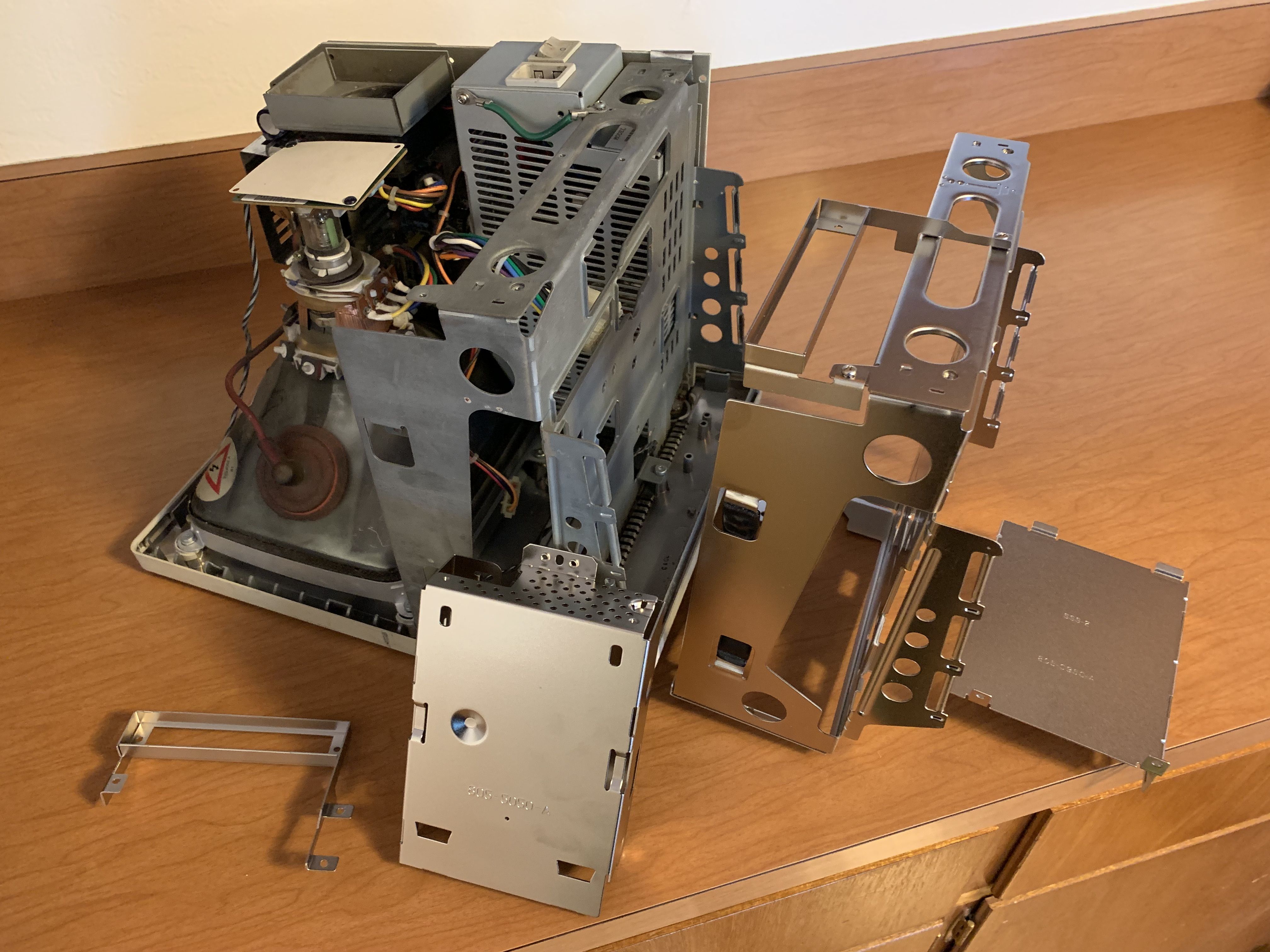

If you really want to make it nice, and keep it conductive, you could electroplate it. I had some SE frame parts done in zinc and this example in nickel. I sent them to a local shop, but it's definitely doable DIY too, especially for a smaller part like the MLB frame.
I had all the internal metalwork in my clear SE/30 nickel-plated too. In the end it cost me $100 but looks amazing just like @Elemenoh 's photo. I think it's worth it (and if you have other frames to get plated or can bring on some friends who do) the incremental cost to add more isn't much.
Yeah if you pay a shop it’s advantageous to have them do as large of a batch of parts as possible. I did a bunch of SE/30 parts along with a full set of Lisa frame parts. It was also about $100 or so. But for the small MLB part you could do it yourself with a little piece of nickel or zinc you can get on amazon and a bench power supply or car battery. There’s not much to the process.
