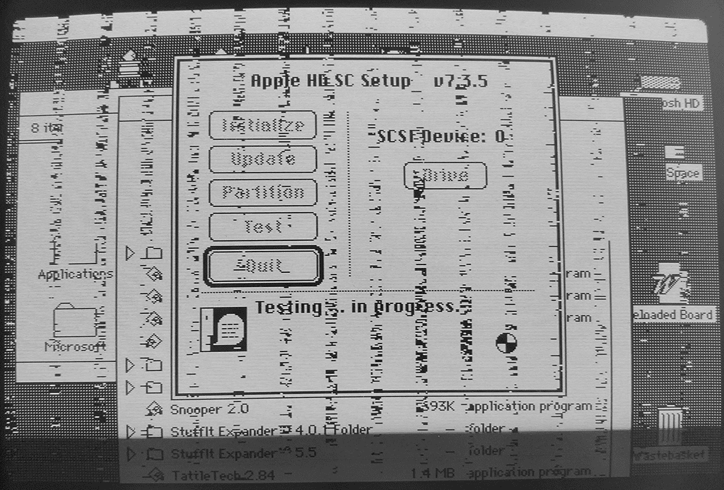

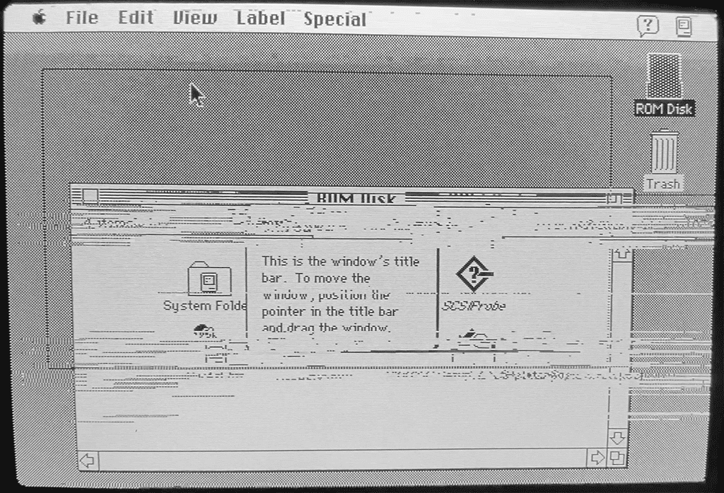

I've been working to resolve an issue with my SE/30 Reloaded builds and it's become something of a serious endeavour. The issues manifest as graphical anomalies, typically on a cold boot after around 6-8 minutes, peaking in intensity, then clearing up around the 20 minute mark.
One of two types of visual disturbance appears depending on which version of the PAL chips are inserted at UE6 and UE7. Apple put out two versions over the lifetime of the SE/30.
It's not bad chips or a soldering issue – I have meticulously assembled three PCBs from JLCPCB doing exactly the same thing. I've checked all the new parts to make sure they're in spec. And I've spoken to at least a couple of other users with the same issue but between us, so far, we haven't found a solution.
Has anyone else seen it? Photos below.

The type 1 artifacts I would guess are related to the VRAM address muxes.
The corruption is confined to the display rows which are being written at the time.
The timing on the input select lines of 74F253 (UA8, UB8, UC8, UD8) pins 2 and 14 may be marginal due to signal reflections.
You could try a 110-220 Ohm resistor between each of the A/B select lines and ground (2 resistors total).

Interesting - it's similar to my type 2 issue with dashes that build up in columns, but yours are squares and your columns are closer together. I can screenshot those too, but not the type 1 issue with horizontal tearing.
