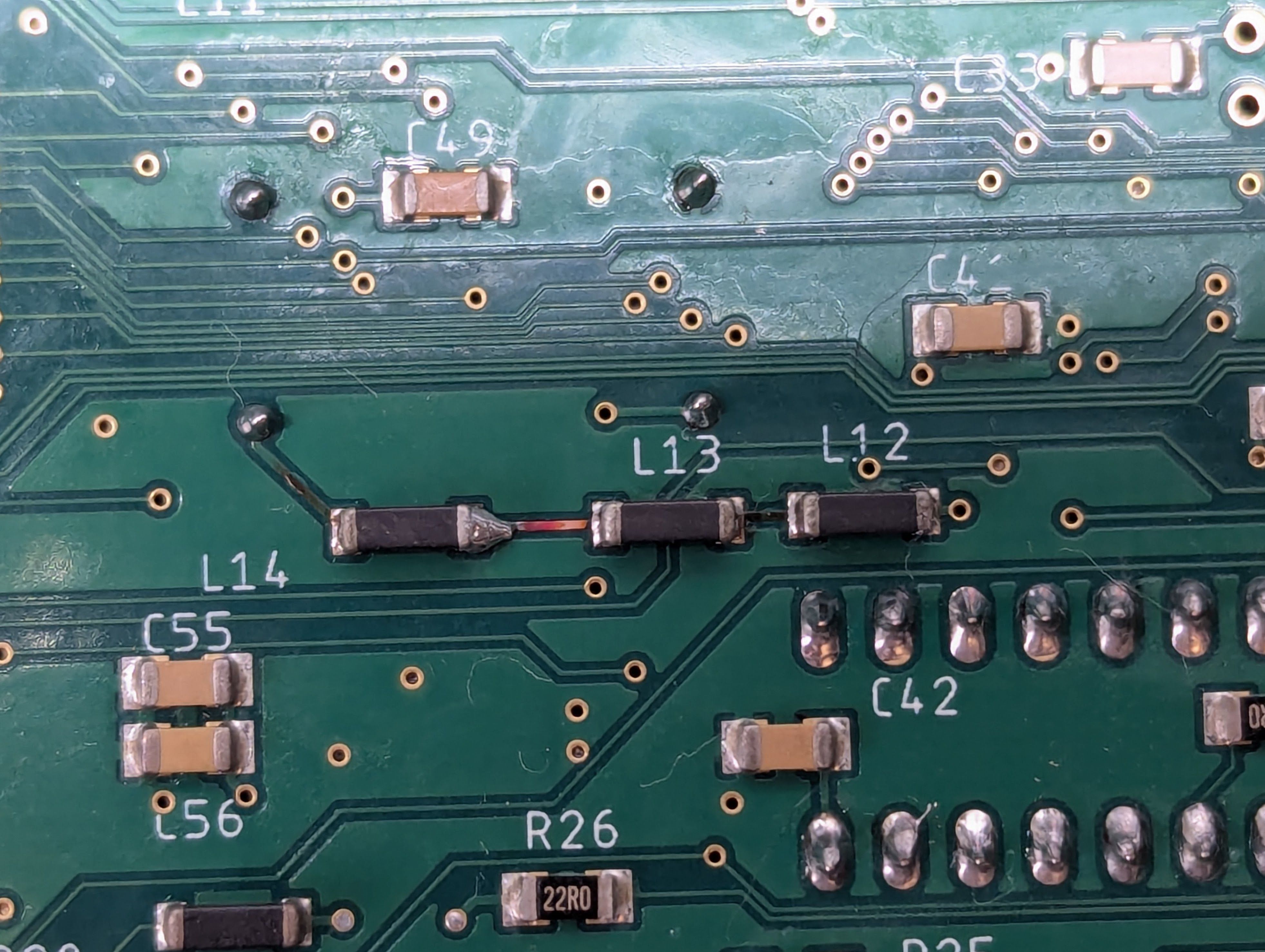

I did make a stupid booboo when powering this board on for the first time. I put the 32Mhz oscillator in a makeshift socket for reasons and that socket didn't have anything under the little plastic standoffs on the bottom of the (grounded) metal oscillator body. This allowed the 5v metal pin socket hole to touch the oscillator body, shorting 5v to ground. The trace going to the oscillator's 5v pin (above L14 in the picture) burned up, breaking continuity between L14 and L13 and cutting power to the oscillator. I found the problem with my nose and restored continuity:
But, since that was the first time I powered up the board, I don't know if the current problem was caused by that mistake or already present. Did I fry something, or did that trace act like a fuse? :)
