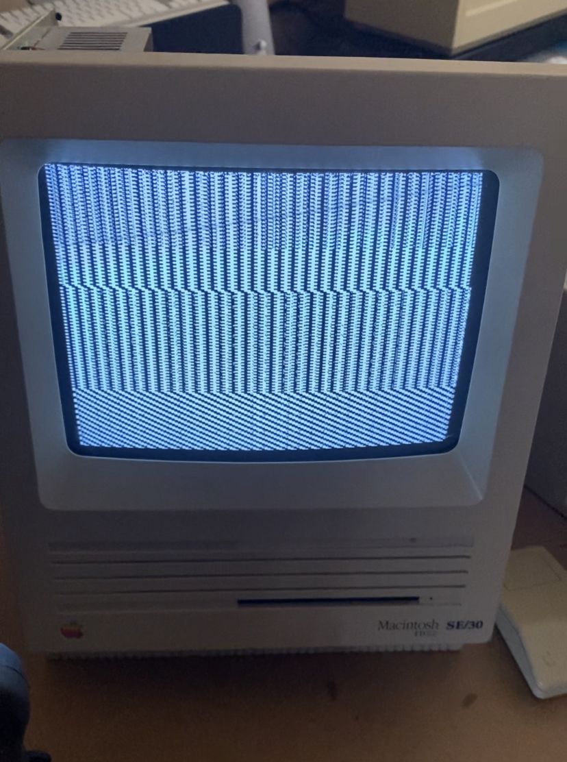

I still have my working se/30 going well, but still cant find an answer as to why the zebra pattern shows up on initial turn on, then 12 seconds later it chimes, screen turns normal, and then boots / works normal. If i hit restart, it acts completely normal no zebra screen. vram? I pulled off ue8, and ones around it, cleaned pads, and legs of chips. Still does it. All ram slots work fine, zero issues when running or using it.

Well, it does the same thing in my se chassis. Will have to do analog board anyways, but still think it is something on logic board
