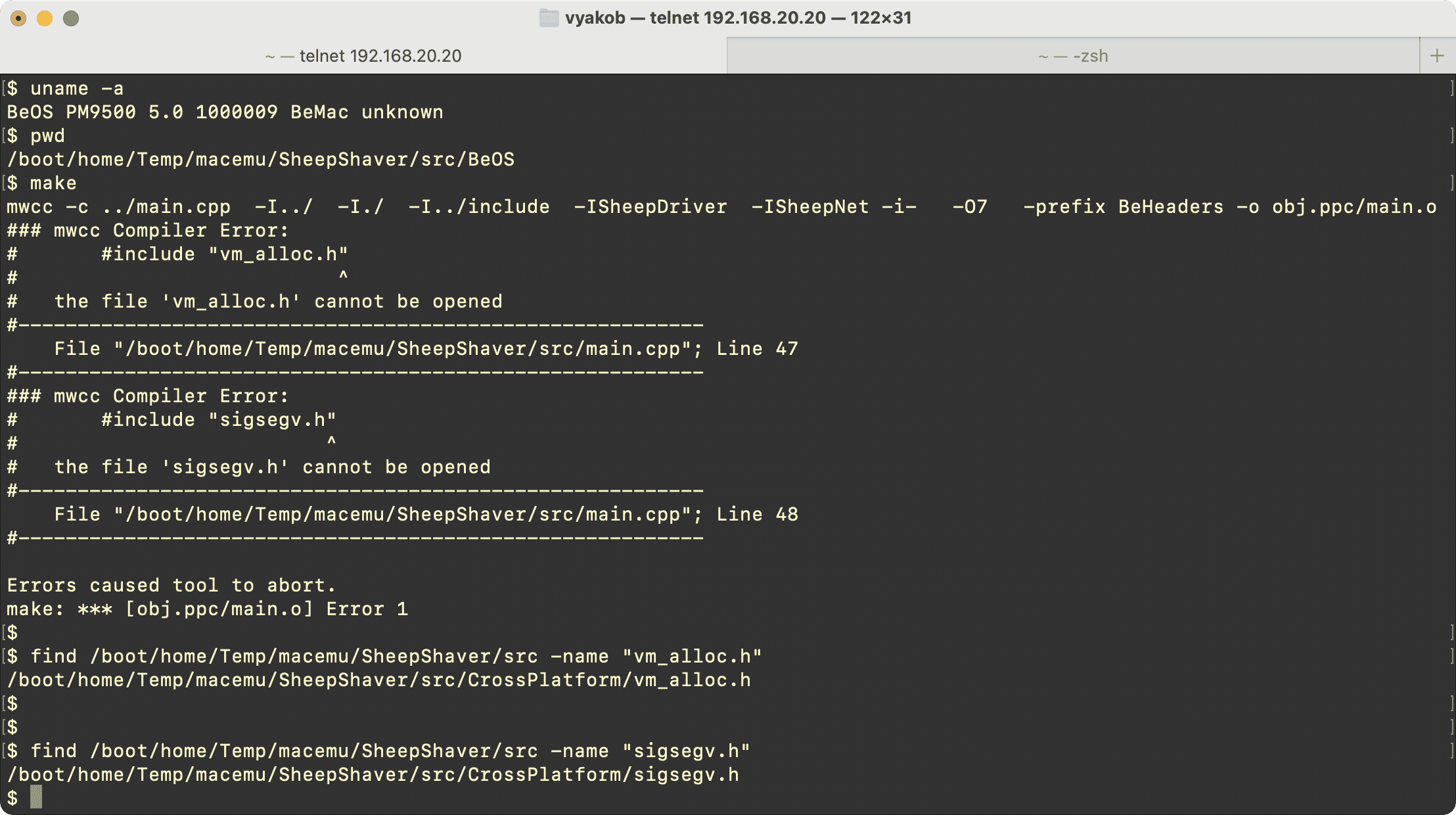

There is a Power Macintosh 9500 running BeOS 5. I want to try running SheepShaver and BasiliskII on this OS. However, I couldn't find the finished packages, only the source texts. But there was a problem with the compilation.
I'm not a programmer, so every time I have various problems when building.
How to do it?
I transferred the archive "cebix-macemu-96e512b.zip" to BeOS via FTP and connected to the telnet server console.
Code:
$ uname -a
BeOS PM9500 5.0 1000009 BeMac unknown
$ pwd
/boot/home/Temp/macemu/SheepShaver/src/BeOS
$ make
mwcc -c ../main.cpp  -I../  -I./  -I../include  -ISheepDriver  -ISheepNet -i-   -O7   -prefix BeHeaders -o obj.ppc/main.o
### mwcc Compiler Error:
#    #include "vm_alloc.h"
#   the file 'vm_alloc.h' cannot be opened
    File "/boot/home/Temp/macemu/SheepShaver/src/main.cpp"; Line 47
#    #include "sigsegv.h"
#   the file 'sigsegv.h' cannot be opened
    File "/boot/home/Temp/macemu/SheepShaver/src/main.cpp"; Line 48
Errors caused tool to abort.
make: *** [obj.ppc/main.o] Error 1
Files that cannot be opened by the compiler exist
Code:
$ find /boot/home/Temp/macemu/SheepShaver/src -name "vm_alloc.h"
/boot/home/Temp/macemu/SheepShaver/src/CrossPlatform/vm_alloc.h
$ find /boot/home/Temp/macemu/SheepShaver/src -name "sigsegv.h"
/boot/home/Temp/macemu/SheepShaver/src/CrossPlatform/sigsegv.h
Who can say what needs to be done so that the building of the application was successful? Or can someone share the already collected packages and give recommendations for installation or launch in BeOS?

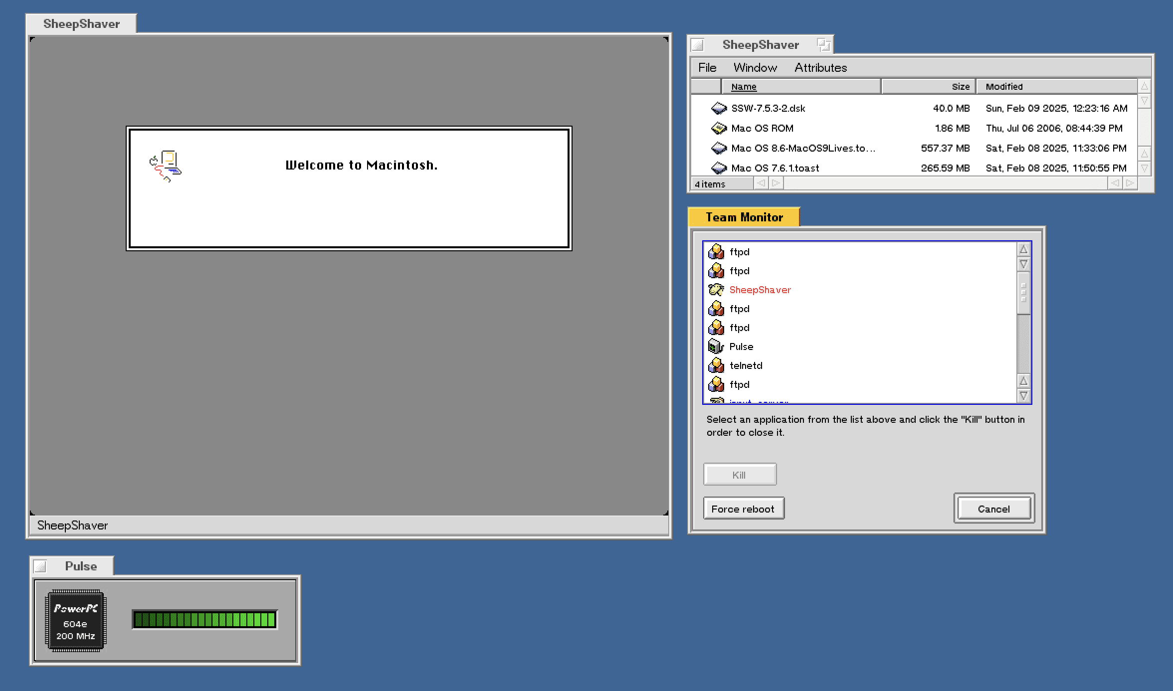

Booting from the CD is not performed.
An attempt to boot from a disk image is unsuccessful, Mac OS boot hangs. I tried to wait 10+ minutes, but nothing changes.

I noticed that I have a "Mac OS ROM" file from 2006, maybe there was something older for version 2.1 SheepShaver?
You shouldn't need a ROM file - it uses the one built into your logic board on a 9500?

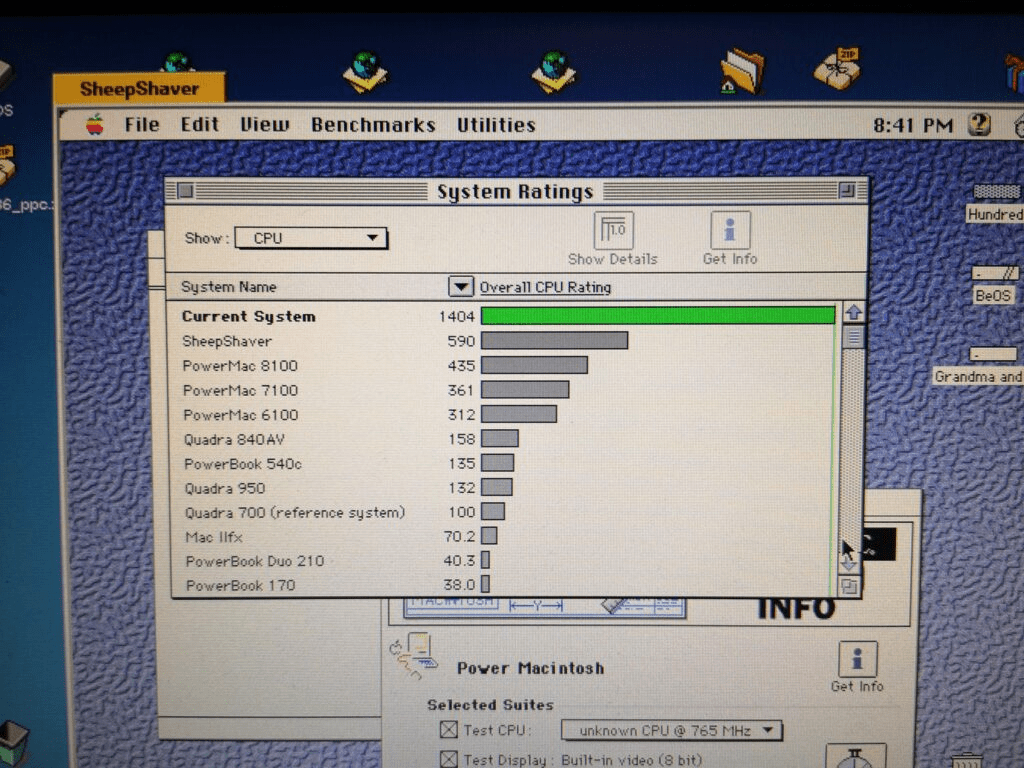

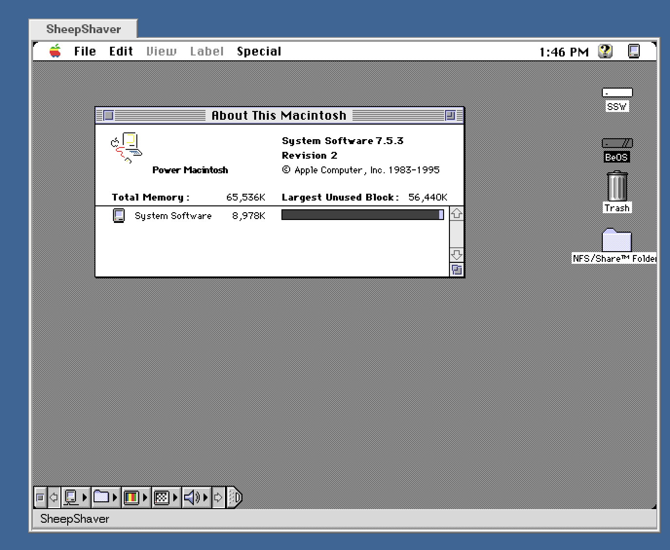

After I removed the ROM in the settings, it worked. The connected disk with SSW 7.5.3 will start, but it's sooo slow.

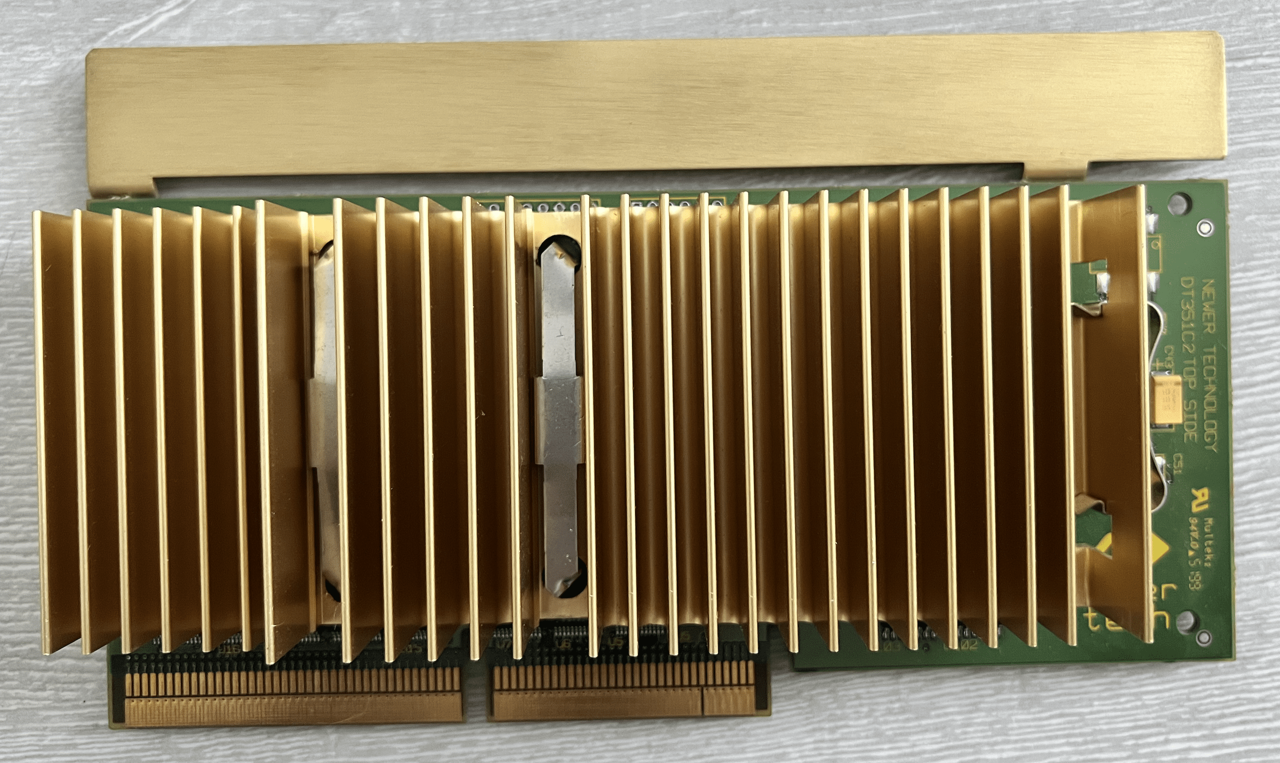

I have NewerTech G4 350 Mhz, but I don't know anything about modifying the extension so that it loads earlier than BeOS bootloader. Do you have any information about it? Maybe if it boots in Mac OS and then use the switching utility in BeOS?
It is probably just visually slow (the SheepShaver window updates at a fixed framerate). Change the setting for the framerate in SheepShaver's settings. Set it to 30 or something (don't go too high or it hogs processor that could be used for computation). If you benchmark it, it shouldn't be much slower than running natively.
That is a perfect card for the setup. My point was that if you have a Newer Tech card (like yours), you don't need to mess about with the extensions for the speculative bug, but it might still help for the cache...

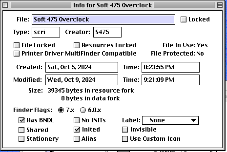

To make the Newer extension load really early, use ResEdit to change the "Type" setting to "scri". Leave everything else as it is. It should then load before the BeOS bootloader. Remember, we're talking about the OS running on the 9500 here, not the SheepShaver one (just making absolutely sure that is understood although I'm sure you realise).

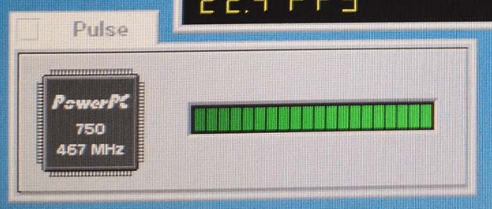

For interest, this is what you get when you use a 466MHz G3 upgrade :
... and this is what you get with a 400MHz G4 upgrade.

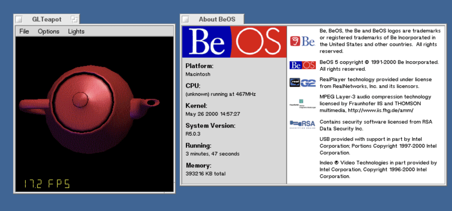

Note how BeOS 5.0.3 is aware of what a G3 is (PowerPC 750), but doesn't know what to call the G4. It also gets the MHz wrong for the G4 (but right for the G3).

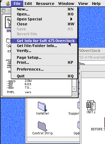

I use ResEdit 2.1.3 and open MAXpowr Extension for editing, I opened all the available items, but I did not see such a menu as in your screenshot.

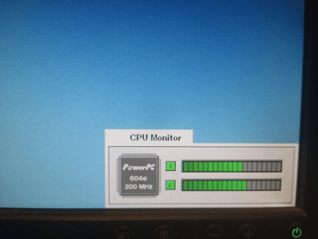

Judging by the load processor, apparently the best solution would be to find dual 200 Ghz from PM9600, which should work here.
Although it always seemed to me that G3/G4 should be better and faster than double 604e. Although FPS. which is not much visible suggests that G3 466 gives out 22, which is much more than one 604e 200 Mhz, where in my opinion the kettle spins at a speed of 9 FPS.
But if the extension already loads before the BeOS loader, then you don't need to make the change. It wont make any difference.

This has already been done, apparently that's why the extension is loaded immediately, even before the BeOS download option appears.
But again, BeOS does not load with the extension loaded.

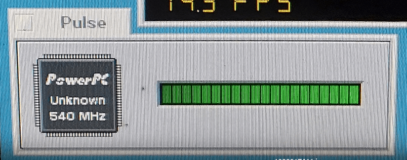

This is without a loaded extension.
The Mhz of the processor is also not displayed correctly. 467 instead of 350. That's what confused me, and I thought it was 450.
I've already come across such oddities with the processor from Sonnet, when System Profiler shows something completely different.

Reporting the wrong speed and "Unknown" is what I mentioned above - BeOS doesn't completely understand G4s.
