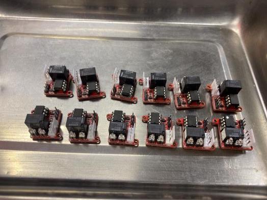

Below are final, assembled units ready for happy BlueSCSI owners around the world!

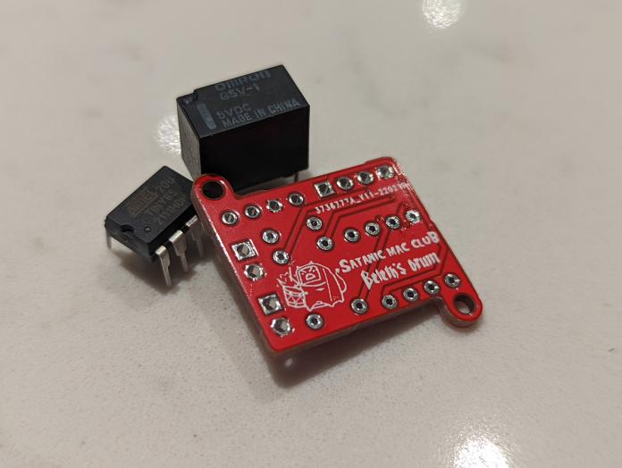

The idea of making a noise board with a small relay has been around for a while. I chose a small microcontroller to solve this easily. I made this with ATTiny85, but I may change it to ATTiny13A due to availability issues. Now that these aren't available, I've created two programs to work with both.
The prototype was made with a universal board. It sounded pretty good, so I handed over the schematic to Stephen and he designed the PCB. Drake was in charge of drawing the cute artwork. I think this has become a pretty fun device.

The Beleth ’s Drum PCB is fixed with 1mm double-sided tape or 2mm screws. The layout is up to the user. If you replace the double-sided tape with a sponge, the sound will be less reverberant and muddy, and if you attach it directly with screws, the reverberant sound will be loud and a little noisy. Also, if you wrap a sponge and mute it, the volume will drop to the point where you can hear it faintly, so it should sound more realistic.
