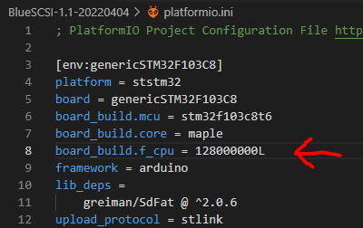

Early adopters can download the latest code on github. In platformio.ini file in the [env:STM32F103C8] block - add
Code:
board_build.f_cpu = 128000000L
128MHz, you can try any value between 72 and 128MHz - your mileage may vary (if it does let us know below)

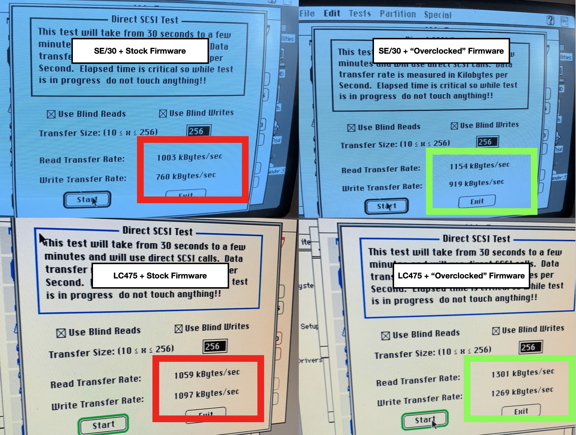

I was able to finally get my platform.io extensions working right to flash the modified code to the BlueSCSI. Well, results speak for themselves and I'm very impressed. I tested two systems briefly and found a modest increase in both write and read speeds. I know, I know, I didn't use SCSI Director benchmarking (too lazy to update the image on my SD card - ha).
See the attached image with my results. I am using the same cheap Amazon 8GB SD card with the same 7.5.5 boot image in all tests. I am curious if others have similar results to these. Hopefully more BlueSCSI users will post their results too.

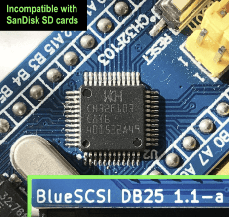

If you have an APM32 they only run at 96 and 128 mhz - we've found some of these chips that are marked STM32 but really a clone APM32 chip. You can tell if it only runs at 96/128 and if it has 256kb of flash.

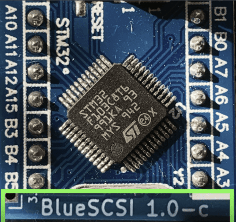

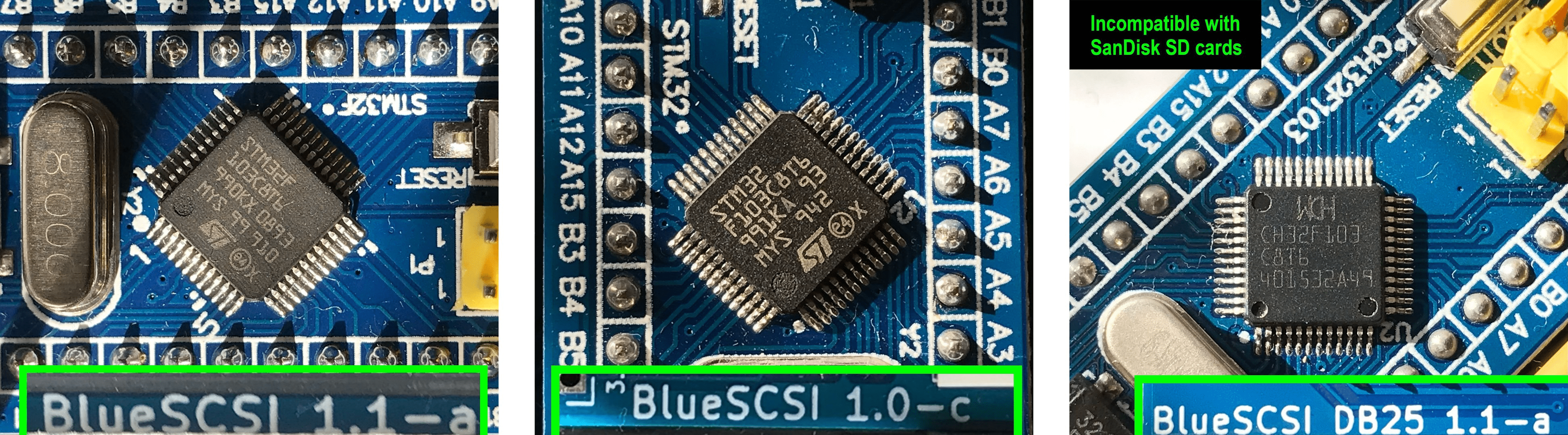

I have 3 "high quality" (well constructed) BlueSCSI units that I acquired from @Kay K.M.Mods, each with different processors...
After a discussion with @eric yesterday, I decided to proceed with overclocking these units to see what would happen. My rather straightforward method of firmware flashing might compel some of you BlueSCSI owners to give it a try, But first, you need to make sure you have at least the April 2022 firmware installed already -- mine had that. You then want to check the LOG file on your SD cards to see if you have "USB" in the "VER" line. For example, I flashed mine to the newest Dec. 2022 firmware, which then shows this in the LOG file...

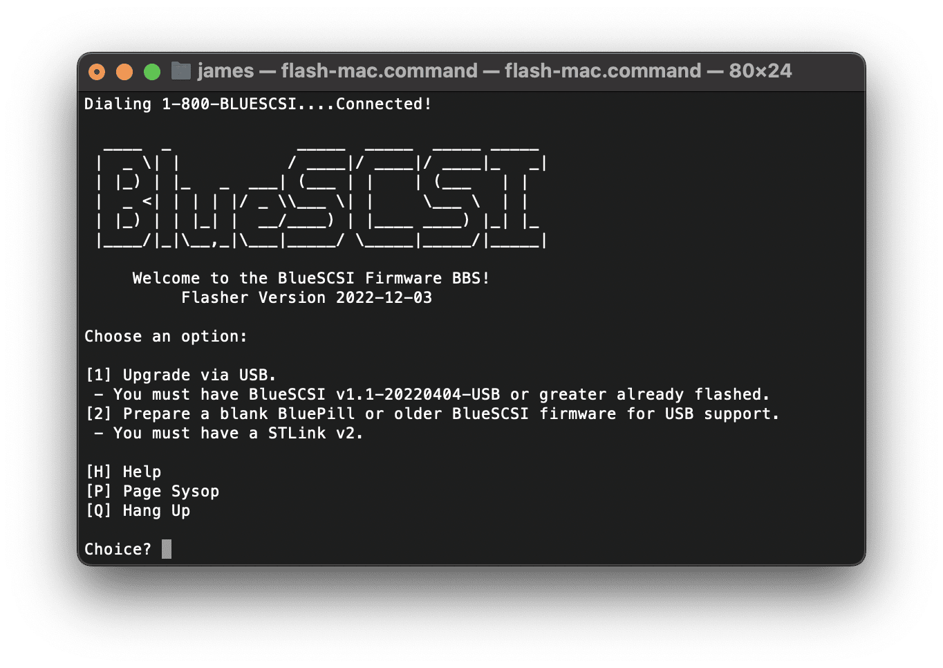

You should first flash that to your BlueSCSI to ensure it works well, which is done simply by double-clicking the file named: flash-mac.command
That opens the MacOS Terminal and shows this...
I always type 1 and return, then follow the instructions to flash. (But again, you need MacOS Monterey and Home-brew installed for it to be seamless. Or use Windows, I guess. But I don't know about that because I don't do Windoze.)

In the end, 2 out of my 3 BlueSCSI devices were able to be overclocked. 👍

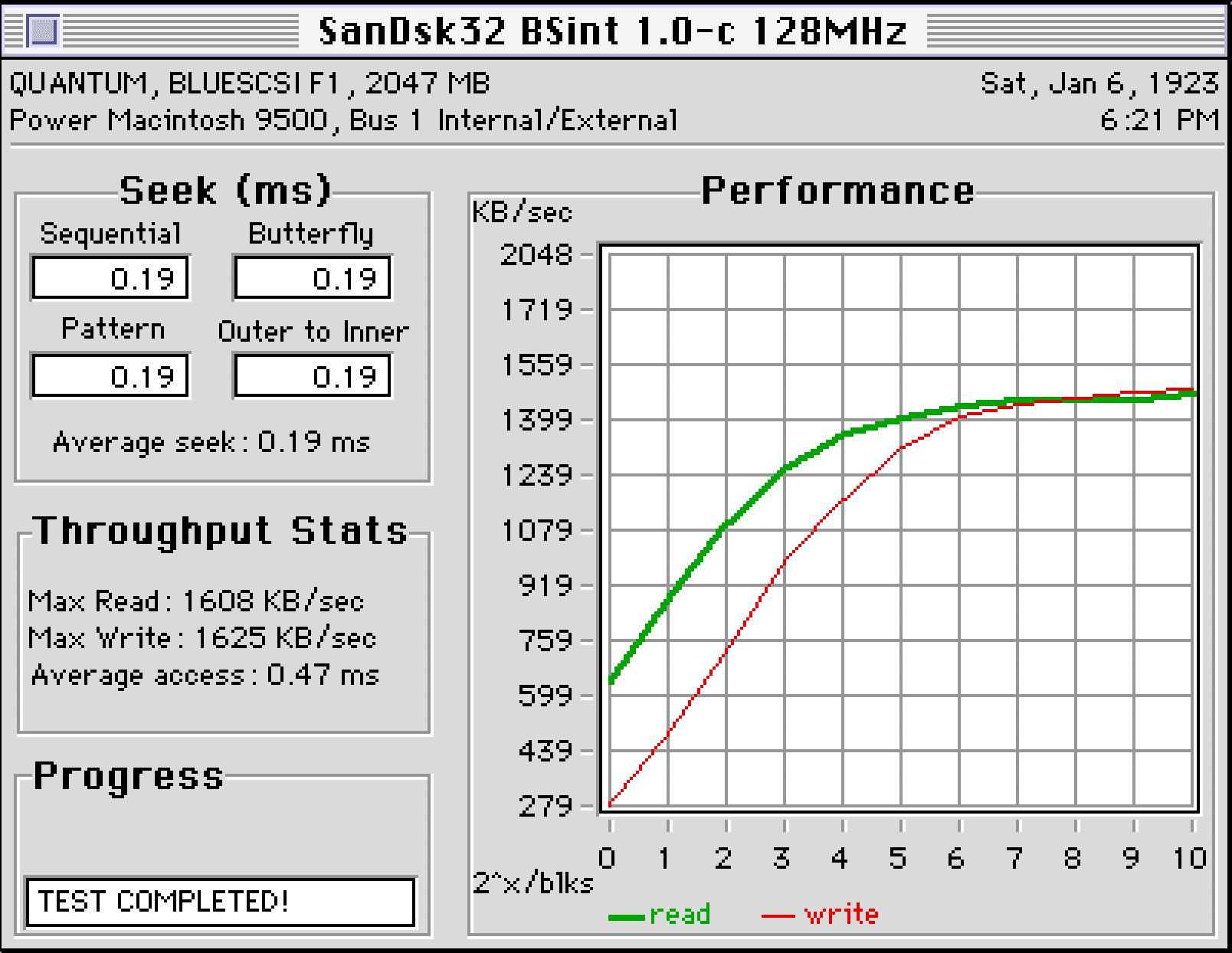

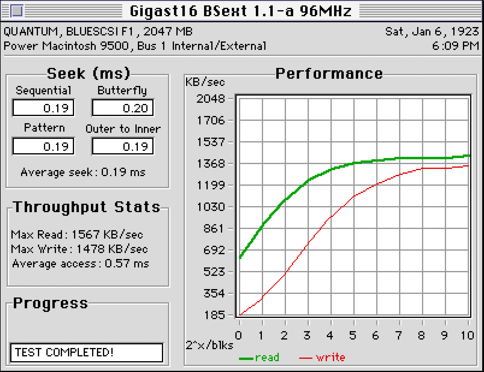

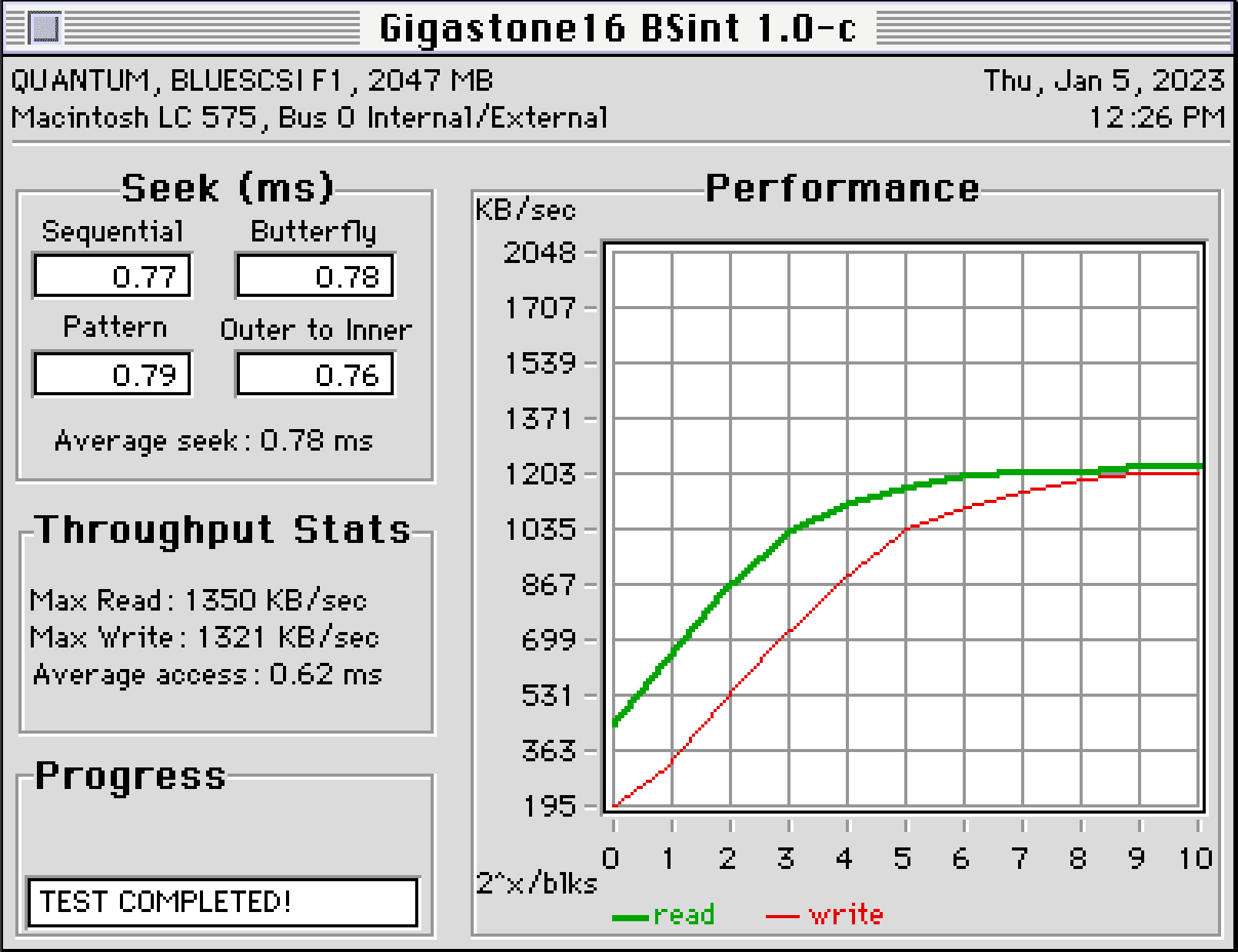

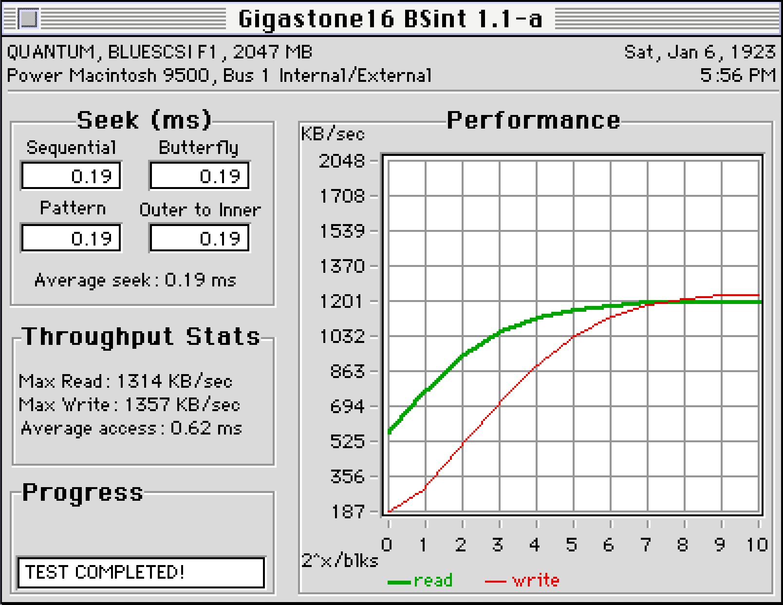

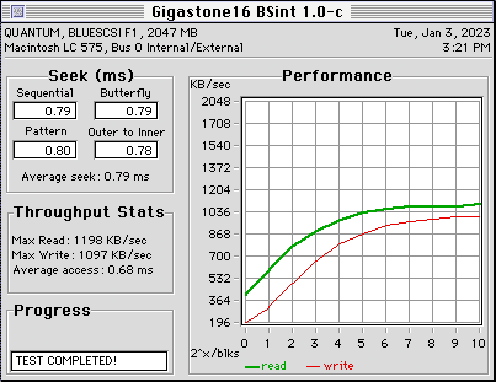

I made some time after work this evening to test all 3 of my BlueSCSI units (2 of which are now overclocked) on a PowerMac 9600/300 with a Buffalo 400MHz G4 (7400) CPU card installed. All were connected externally, with the internal type BlueSCSIs connecting via OverEasy II Rev.B. The minimum OS is 7.6.1, so I booted into that and ran SCSI Director Pro 4.0 to yield the following results.
1. BlueSCSI internal type 1.0-c overclocked to 128MHz, with SanDisk Extreme 32GB V30 A1 SD card.
2. BlueSCSI internal type 1.0-c overclocked to 128MHz, with Gigastone 16GB V30 SD card.
3. BlueSCSI external DB25 1.1-a overclocked to 96MHz, with Gigastone 16GB V30 SD card.
4. BlueSCSI internal type 1.1-a (not overclocked), with Gigastone 16GB V30 SD card.
