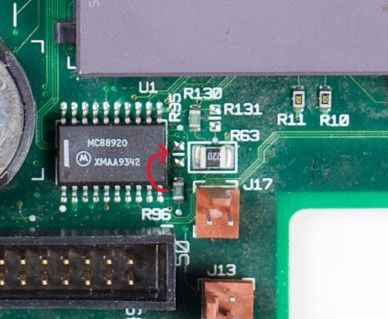

This is confusing because
PowerCC.org's Mystic page doesn't mention ResEdit at all and instead mentions the need to mod the LC575 motherboard ("logic board mod"). People show that process on the
68kMLA here. Indeed,
@Mr. Fahrenheit said he ONLY did the ResEdit hack but
got a Bus Error, and he later had success
doing the LC575 motherboard mod, and he later added that the motherboard mod worked for him
WITHOUT the ResEdit hack.
I never had to do any of that ResEdit or 575 MB hacking because after installing the 575 board in my CC, I only booted into S7.1 and therefore only needed Enabler v1.1. I didn't try S7.5.5 until I did the
68.4V VGA mod. I more recently switched to the
84V 13" High Resolution mod which also gives me 640x480. What I wrote above is info I gleaned from the internet and is not something I have personal experience with. Nevertheless, I do hope it helps (sorry, quite belated)
