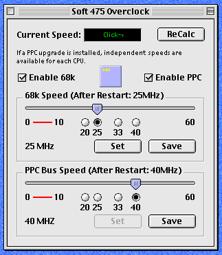

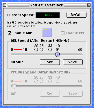

Latest version :
Edit - actually, now like this, because I realised the sliders were sort of pointing the wrong way. Also I used a top secret trick to make the PPC bit enable for the screenshot :

Latest version :

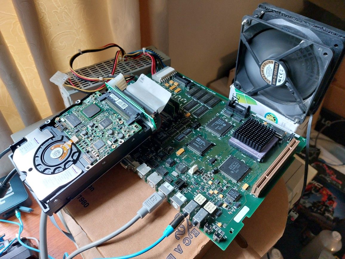

Interesting - how have you connected into the edge connector? Or is that the problem?
You can find the schematic for the 575 here : https://www.macdat.net/files/pdf/apple/schematics/apple/lc_575.pdf
If you want to just get it running, most Macs will boot with only 5V, so you can probably carefully inject 5V (and gnd) at the hard disk connector bit of the edge connector (solder onto the pins on the reverse. Page 14 of the schematic. Serial and sound wont work but it should boot.
It sounds a bit like my Q610 :) (the bodges are my repairs after the previous owner damaged the board trying to recap it)
I don't have a case or anything - it arrived as a non-working board only. I've managed to get it to run reliably at 40MHz and it will boot at 50, but it crashed during the benchmark I ran at 50MHz. I do have some ideas for making it more reliable at 50MHz though, funnily enough, based on some of the code from this thread.
Edit - to get video out is a challenge though. You could potentially find an LCPDS Video card, but that isn't easy. Its easier with the LC 580 board because you can pick up a video adapter that goes in the GIMO port for not too much money, but there isn't a GIMO port on the 575.
