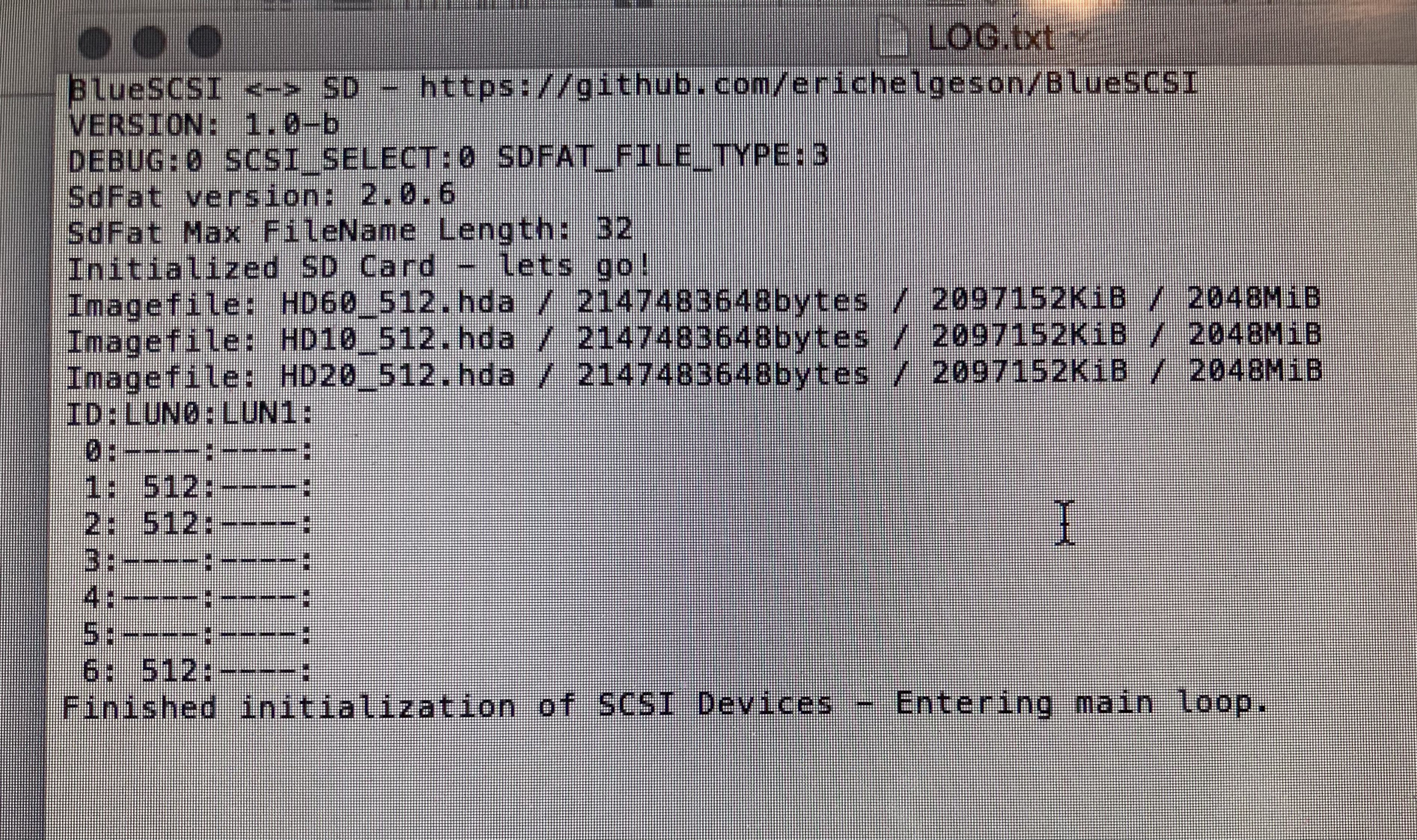

I have revision b and wonder if there was speed improvement in revision c or should both had the same speed?
Revision C was mostly to facilitate using it on Mac that don't provide termpower (a B can be easily converted to C).
IMHO, the speed increase, if possible, could come by a optimisation in the firmware, but I think the software is stable since long ago.

Ok, thanks for answer. I have updated the drivers with Disk Drive Setup 1999-2000. Will try to reformat the card with exFAT so will have to use Windows not Mac to write the disc images on..

Well, I will leave it as is. Formatting it to exFAT made a 100% increase in speed! 🤯
Testing with Norton System info the drive made a score of 55 (Just a little above Mac SE and below LC II), updating drivers made it a little above 60. Formatting the card made it 125 just above Quadra 700, 950, PowerBook 5300 and Duo 2300 which got 113 ...
