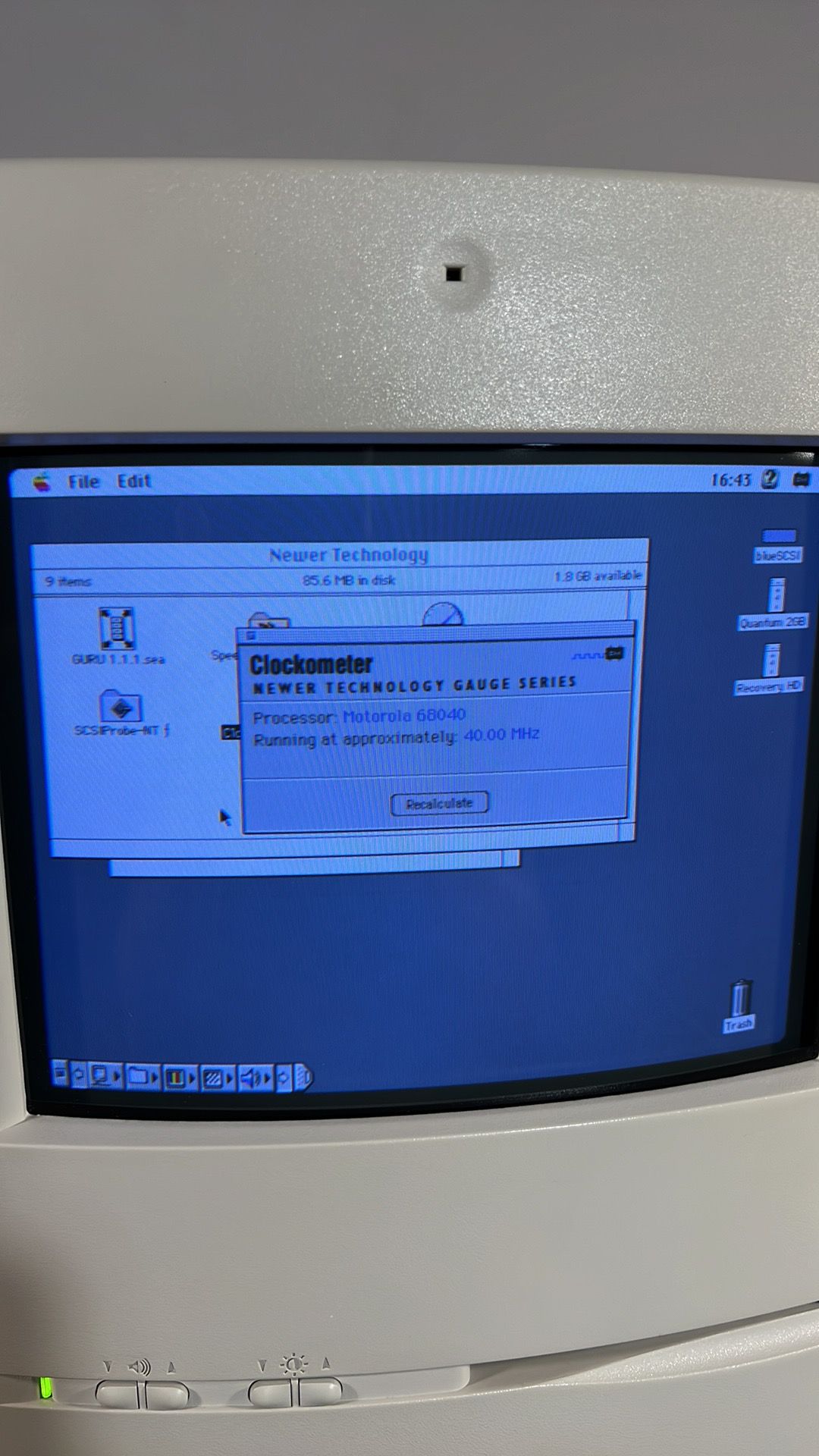

Right now I just have it at 40Mhz until I get the VRAM I need to test that fully. (It’s steady at that speed with stock VRAM). I have OS-CON readily available but I need a better soldering iron to apply them, preferably the one from your video. Your videos have helped me a lot in creating the Color Classic of my dreams.

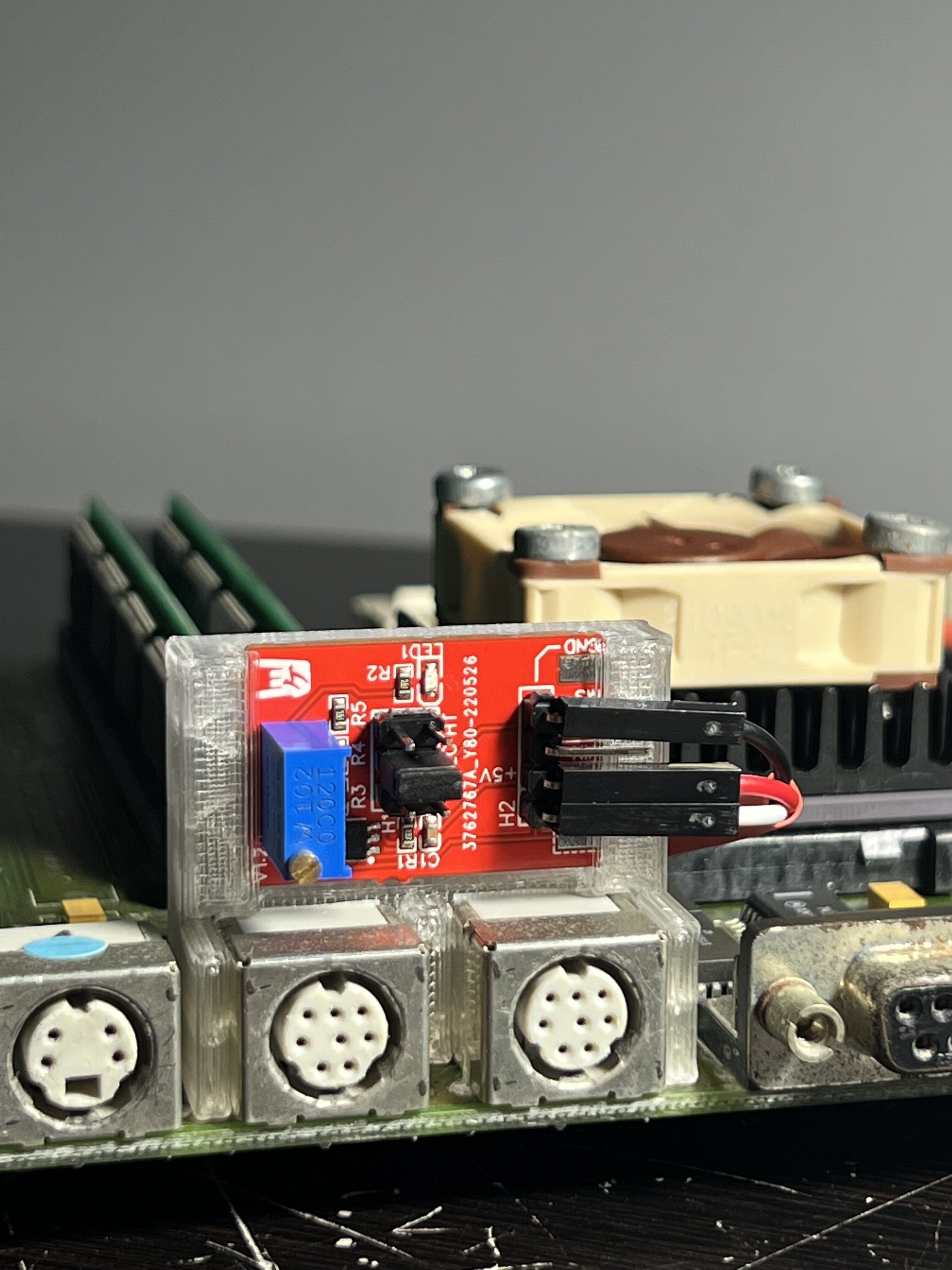

I plan on replacing the tantalum ones with my OS-CON I have on hand when I receive my new VRAM. Once I do that I will definitely be documenting how high I can go with stable reads. I plan on making a proper post once I have every I need to benchmark. But here is how it looks so far!

if it works fine... You should remove the tube and keep the 5v line and clock line from sticking together. It is preferable that the GND line is in between them. I think you can overclock up to 42MHz even with tantalum capacitors.
