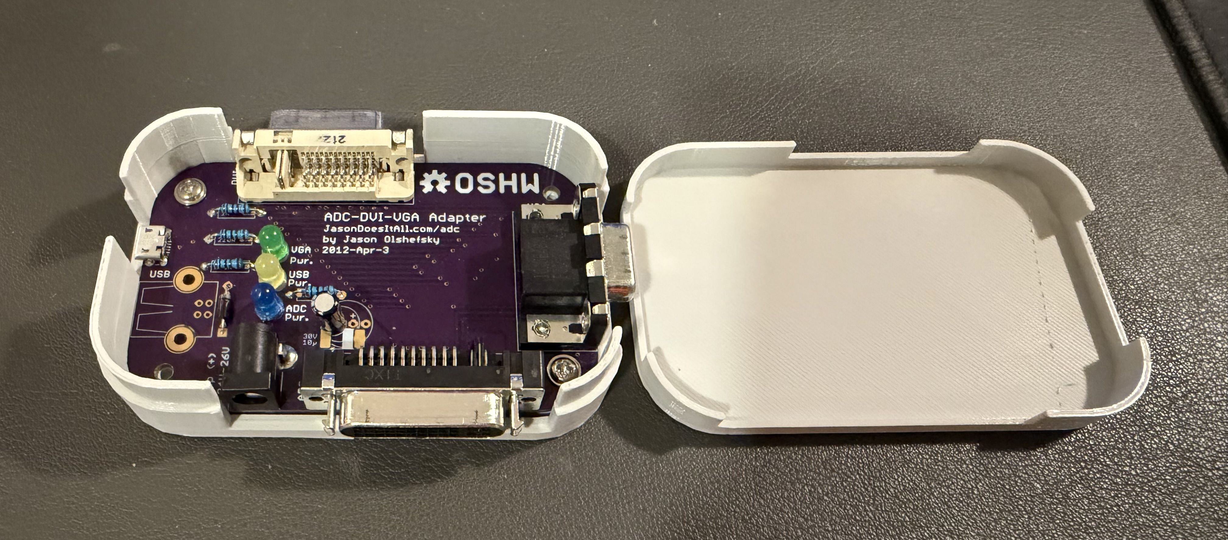

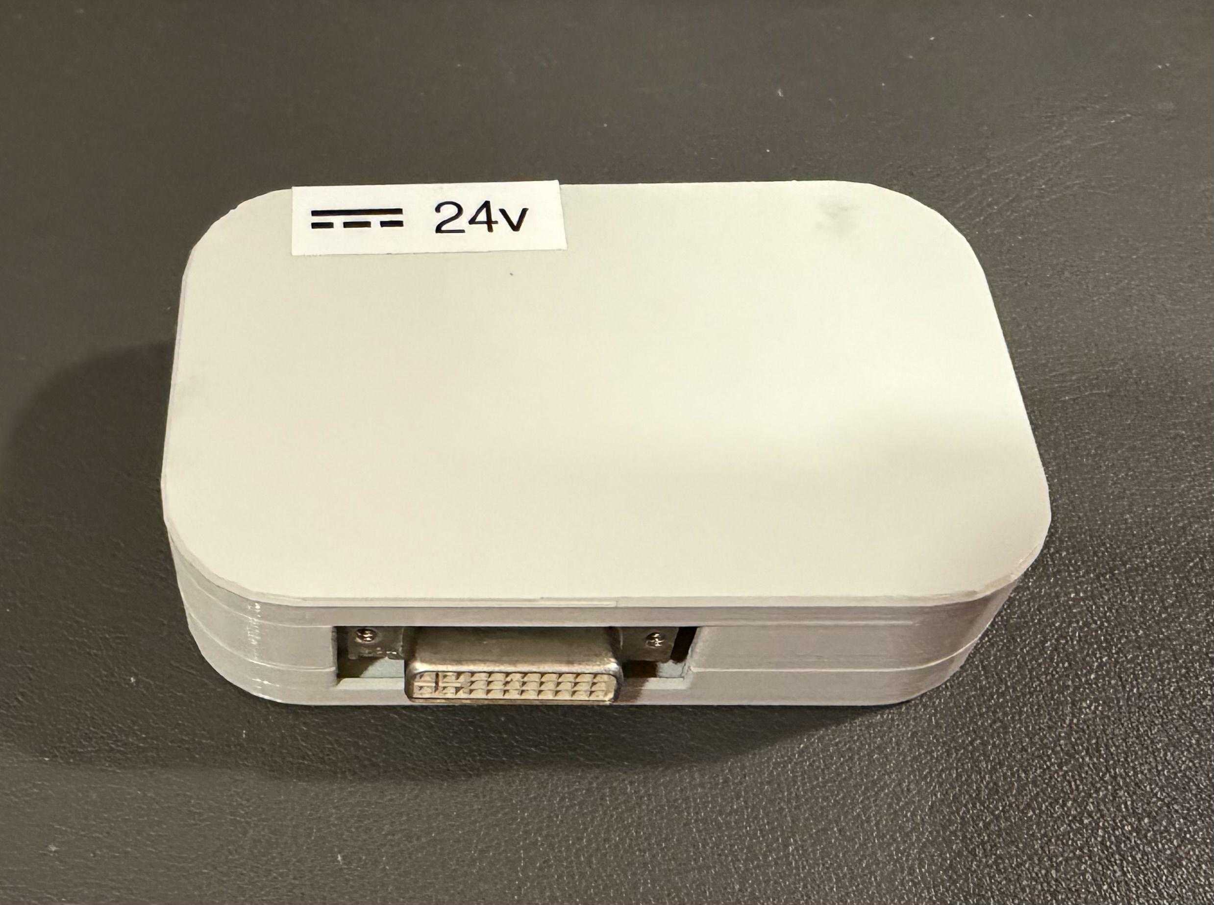

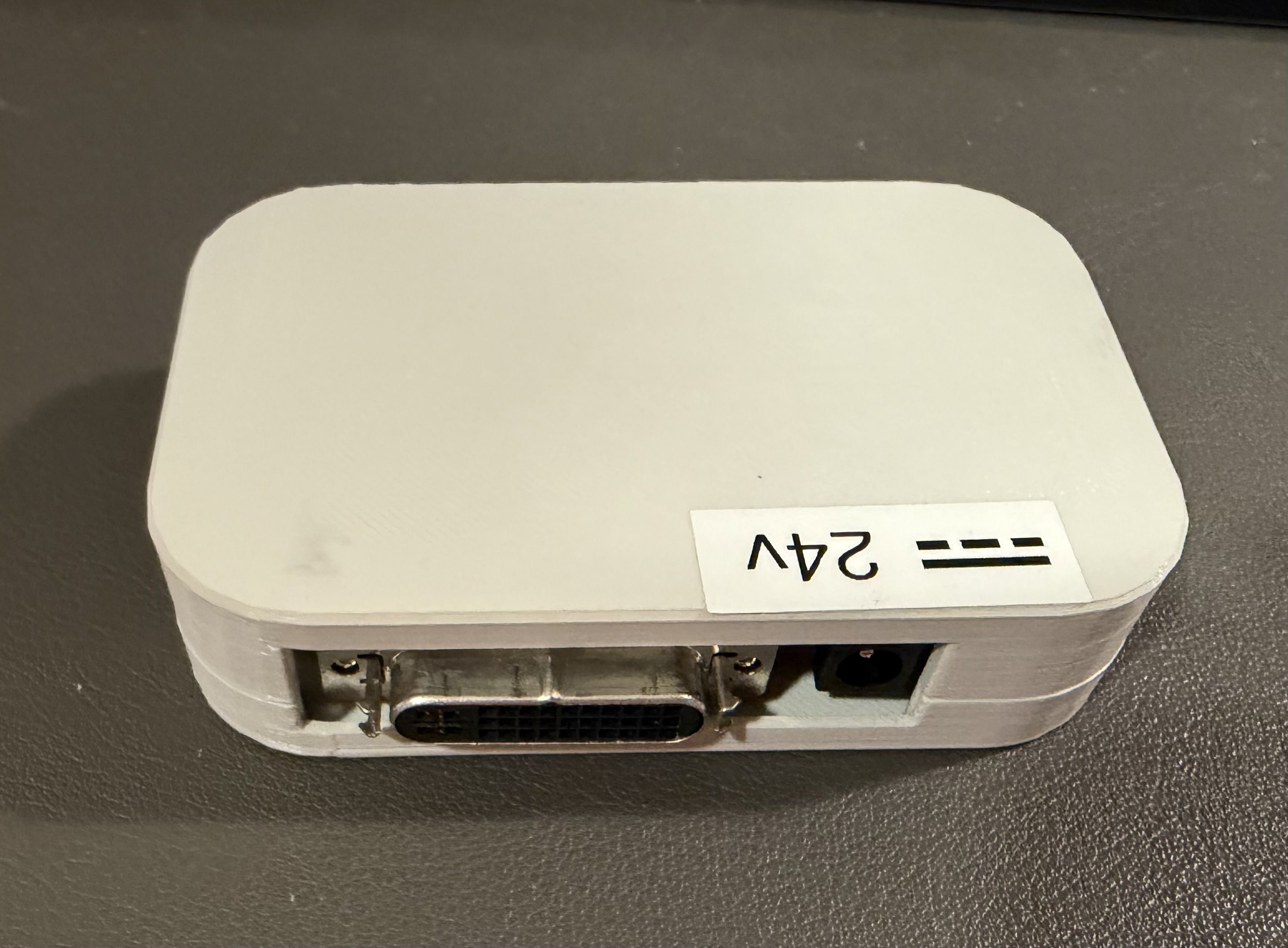

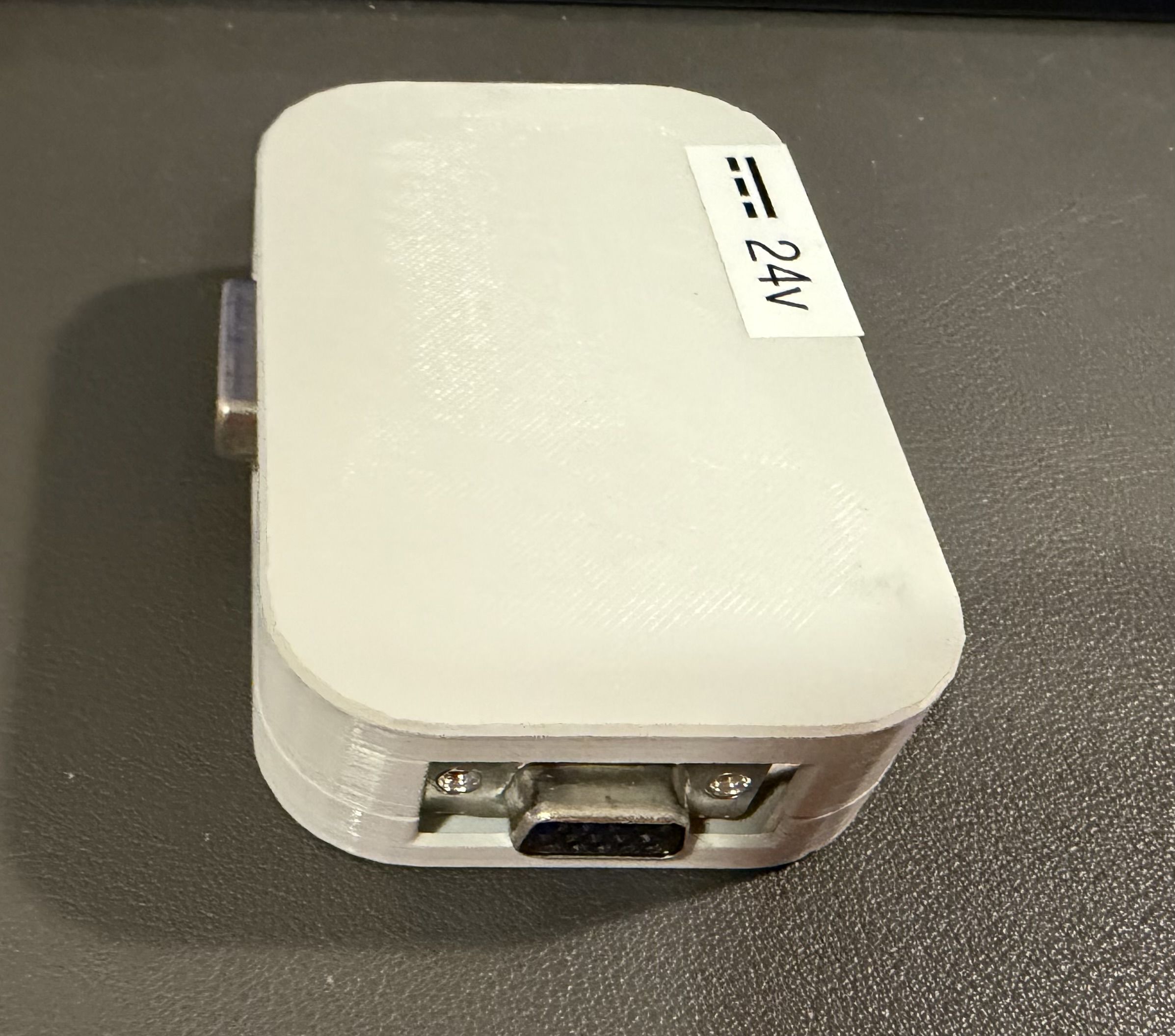

Hey, I haven't forgot about you. I have the adapter I just haven't gotten around to finding a box and getting a shipping quote. I will try to get one in the next day. Still wasn't able to get them to work - hopefully you'll be able to get it to work. Also, you'll need a decent 24V power supply.
Sorry for the delays. Things have been hectic at work and home.
Correct me if I am wrong, but there is no magic (logic or conversion) in this box either. The only thing analog that it connects is the Analog pins in the ADC to the analog pins on the VGA port. So your "modern PC" needs to have a VGA port on it. If you want to use a DVI-A connector, then you will have to wire in pins C1-C4.
